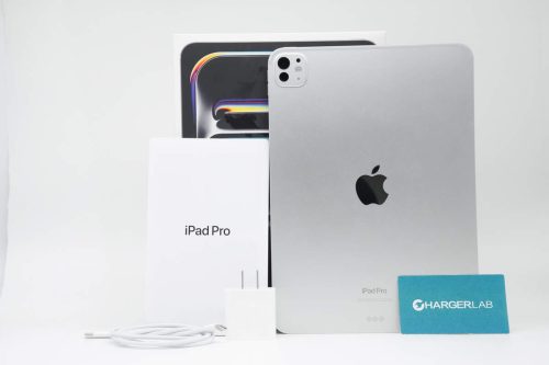

The packaging is in Apple's usual style, with a picture of the tablet printed on the front.
As Thin As 5.1 mm | Charging Review of iPad Pro 11-inch (M4)-Chargerlab
The box contains the iPad Pro 11-inch (M4), a 20W USB-C charger, a dual USB-C cable, and some documents.
