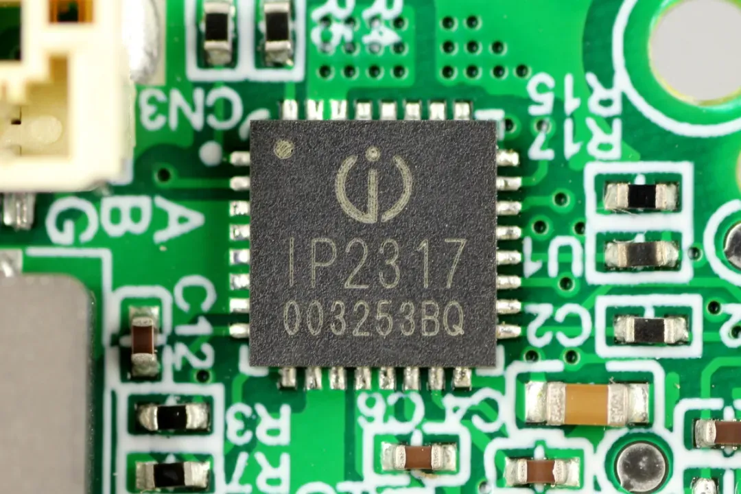

ChargerLAB teardowns confirm that Injoinic has introduced the IP2317—a cutting-edge single-cell lithium battery synchronous buck charging chip. By packing a synchronous Buck power stage, multi-protocol fast-charge handshaking, and thermal safety monitoring into a compact QFN32 package, the IP2317 redefines integration. The IC actively negotiates 5V, 9V, or 12V input profiles with standard power adapters, drastically cutting recharge times. Combined with a stripped-back peripheral BOM, it’s the ultimate go-to for engineers looking to maximize charging speeds while minimizing PCB footprint and production costs.
Injoinic Unveils the IP2317 Single-Cell Lithium Battery Synchronous Buck Charge IC for High-Efficiency, Highly-Integrated Fast Charge Designs-Chargerlab
The IP2317 excels in both protocol compatibility and thermal-electrical management. It natively supports USB-C DRP, along with USB PD2.0, PD3.0, AFC, and FCP protocols, utilizing CC and DPDM lines to precisely query adapter capabilities. Operating at a 600kHz switching frequency, its synchronous buck topology hits peak efficiencies of 93% (5V/2.9A), 92% (9V/2A), and 91% (12V/1.5A) at a 3.7V battery baseline. With maximum charging currents pushing 4.8A, it delivers true high-power fast charging. Safety-wise, it manages the full charge cycle—trickle, CC, CV, and auto-recharge—while supporting 4.20V to 4.40V battery chemistries via simple external resistors. To handle unstable grids, a built-in VBUS input voltage loop dynamically dials back charging current during bus voltage sags to prevent adapter lockups. Robust protections against input over/under-voltage, overcharging, 135℃ over-temperature, and abnormal NTC thermistor readings—plus I²C interrupt reporting—ensure bulletproof system reliability.
