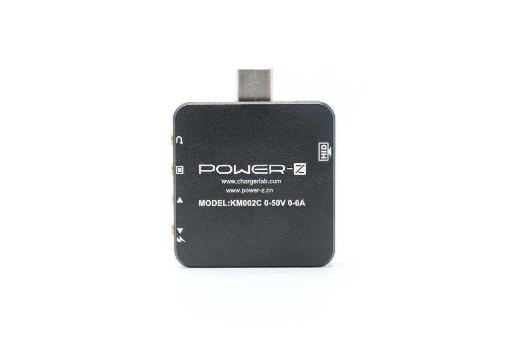

The four buttons on the left side are the "Back", "Confirm", "Left" and "Right", from top to bottom, respectively.

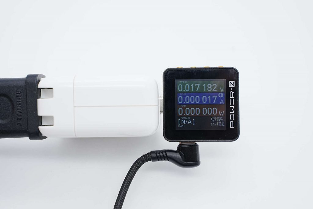

First, connect the POWER-Z KM002C to the Apple charger (we take the Apple 35W charger as an example). After connecting the charger, the tester will be turned on.

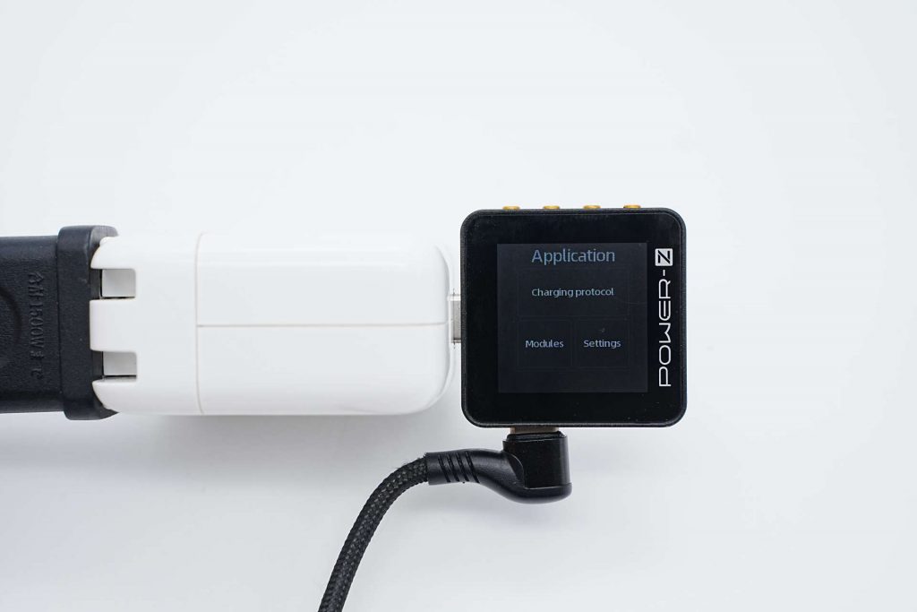

Then, press the "Right" button again, and we can see the Application Menu.
How to use the ChargerLAB POWER-Z KM002C PD3.1 tester to check the serial number of Apple charger?-Chargerlab

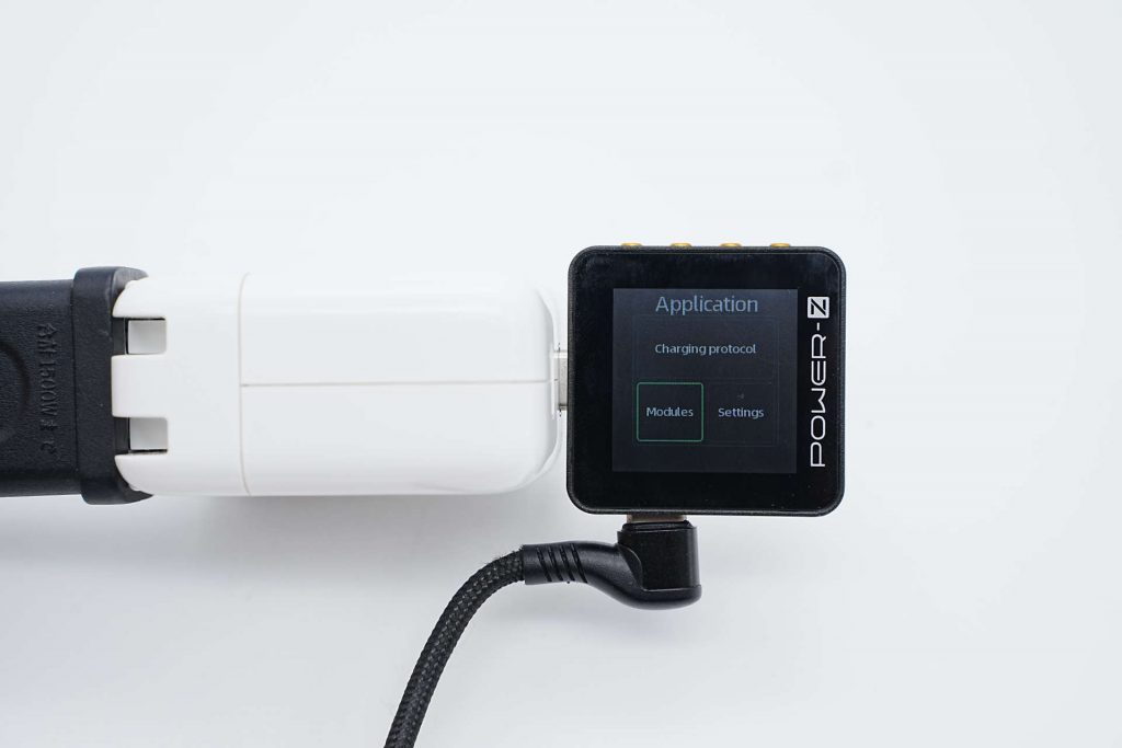

On the Application Menu, press the "Confirm" button and "Right" button to select the "Modules", and then press the "Confirm" button again.

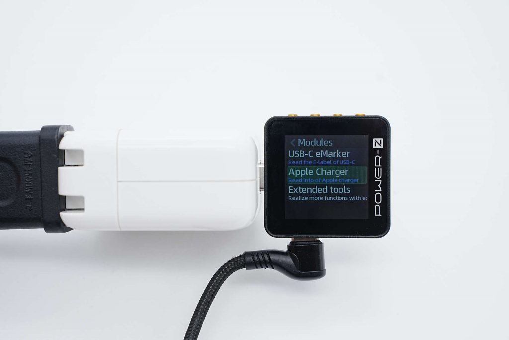

After entering the "Modules", press the "Right" button to select the the second item, "Apple Charger, Read info of Apple charger", and then press the "Confirm" button.

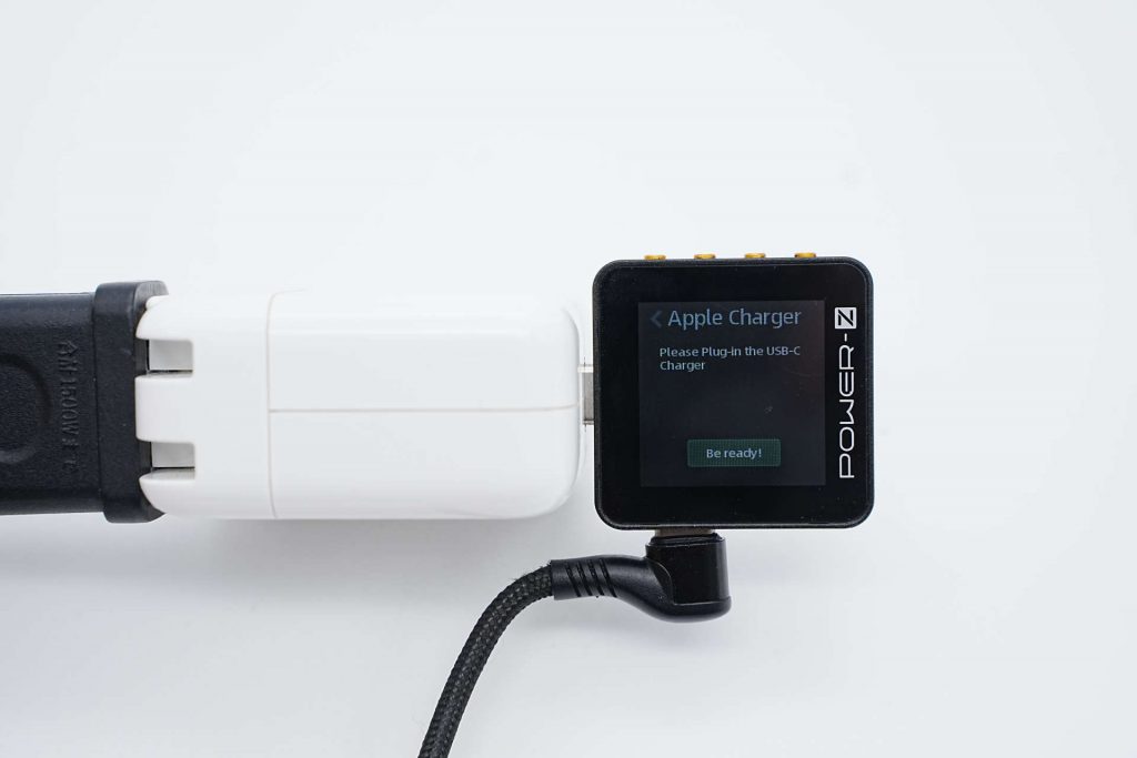

Then the display shows that you should plug in the USB-C charger. And after the charger is connected to the socket, you should press the "Confirm" button again.

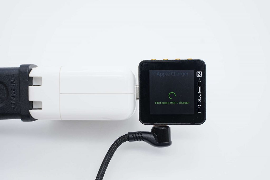

The tester is reading the information of the charger.

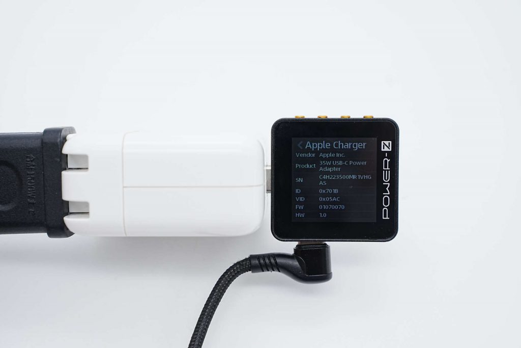

Now, you can see all the informations of the charger, including the serial number. The serial number of this Apple 35W charger is C4H223500MR1VHGAS.
