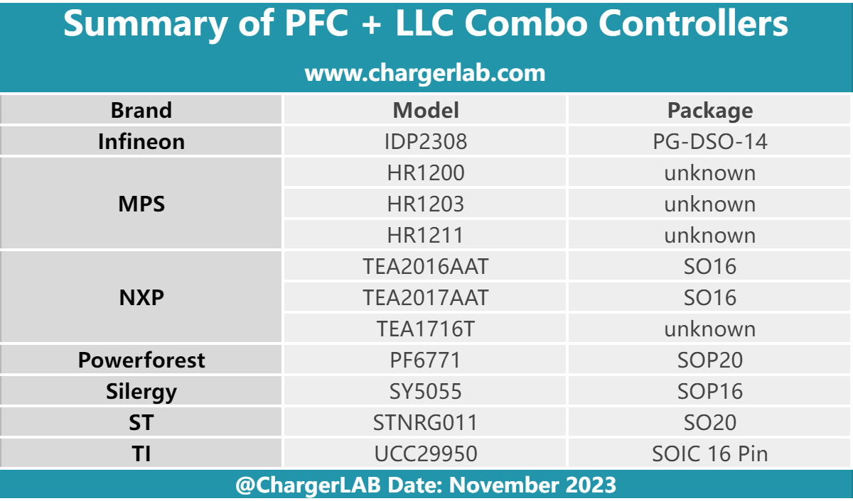

ChargerLAB has compiled several popular PFC + LLC combo controllers available in the market, as listed below. Let's now delve into the parameters and features of each controller.

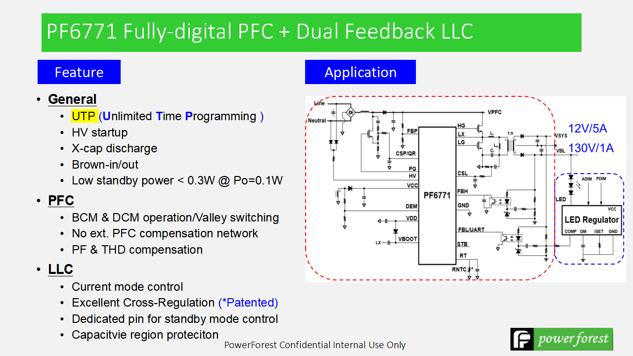

Powerforest
PF6771
Next is Powerforest's PF6771, a PFC and dual-feedback LLC integrated digital controller capable of outstanding performance and powerful features, meeting the needs of applications with two fixed outputs below 250W.
In the dual-feedback LLC architecture, NMOS and PMOS correspond to different outputs; for instance, in a TV system, PMOS corresponds to the system's 12V/5A switch, while NMOS is the backlight 130V/1A switch. Through their duty cycle ratio variation, PF6771 meets the wattage requirements of two different outputs, reducing efficiency losses in the primary backlight boost and additional power components, enhancing efficiency, and saving costs.
High Efficiency | Summary of Eleven LLC + PFC Combo Controllers-Chargerlab
Its PFC operates in BCM mode and employs digital compensation design without external PFC compensation networks, effectively compensating for power factor and harmonic distortion. The LLC adopts current-mode control. Additionally, it has dedicated pins for standby mode control, providing flexibility and control options.
