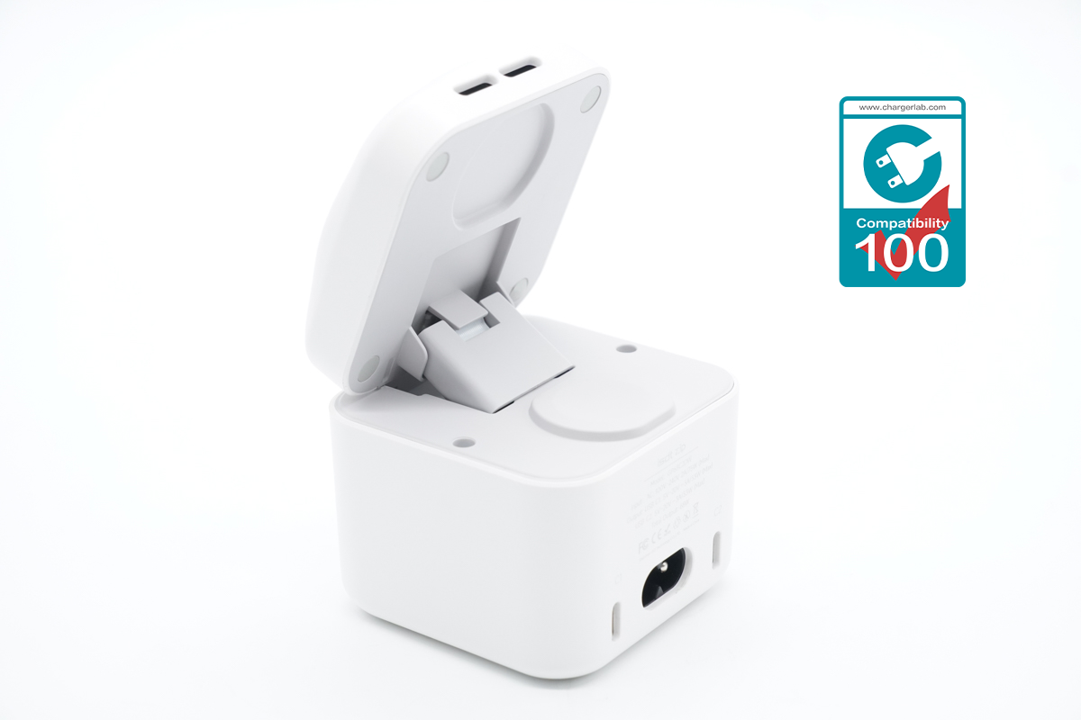

This ISDT Zip charger features a cube design, employing a flip-cover structural design. It's compact, occupying minimal space, meeting the charging needs of multiple devices in a confined area. Additionally, it has both magnetic wireless and wired dual fast-charging modes. The USB-C port's compatibility is quite good, suitable for most household scenarios.
In conclusion, the ISDT Zip 3-in-1 MagSafe Charger successfully passed the ChargerLAB Compatibility 100 Test. Below is the compatibility 100 test report issued by us.
