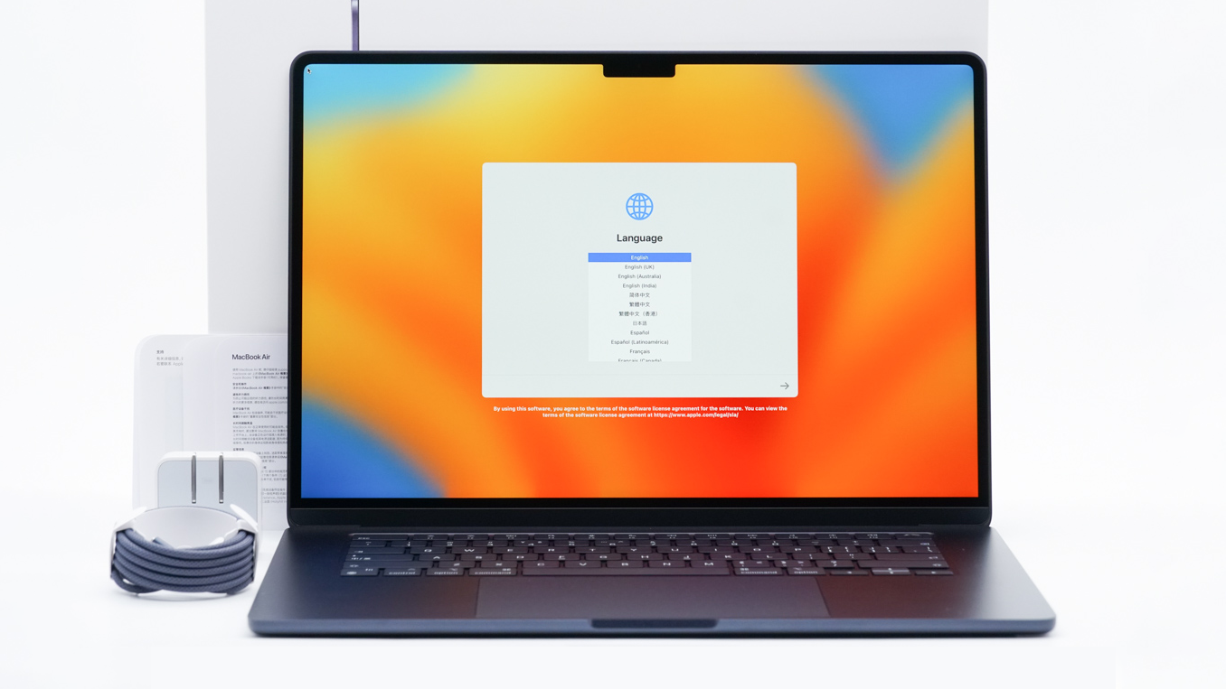

This brand new 15-inch MacBook Air is the largest model in this product line, boasting a maximum brightness of 500 nits and features such as P3 wide color gamut. It serves as the perfect choice for users who desire a larger form factor than the Air series, while not requiring the extensive power of the Pro series. It truly hits the sweet spot for those seeking the ideal balance of size and performance.
Charging Review of New Apple 15-inch MacBook Air (A2941)-Chargerlab
In addition to the laptop, it also comes with a 35W dual USB-C charger, MagSafe 3 cable, and an instruction manual.

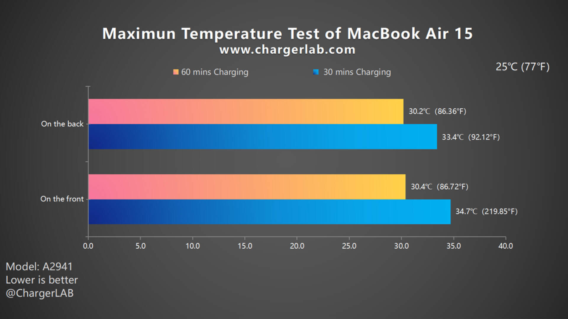

Temperature Test
When testing the full charging curve, we put the charger into a 25°C (77℉) thermotank and got its surface temperature.

Then, let's move on to the 70W charger. After 30 minutes of charging, the maximum temperature on the front is 34.7°C (94.46°F).
And 33.4°C (92.12°F) on the back.
After 60 minutes of charging, the maximum temperature on the front is 30.4°C (86.72°F).
And 30.2°C (86.36°F) on the back.
This time, the overall temperature is a little higher than 35W, at around 32°C (89.6℉).
Well, that's all the tests we made for this 15-inch MacBook Air. The larger size not only brings a larger display, but also a larger battery and better heat dissipation performance. So, even if it's fast charged for an hour, the temperature will not exceed your body temperature. It also has good compatibility with different charging devices. But for the fastest charging speed, we recommend choosing Apple 70W charger or other third-party PD chargers beyond 70W.
