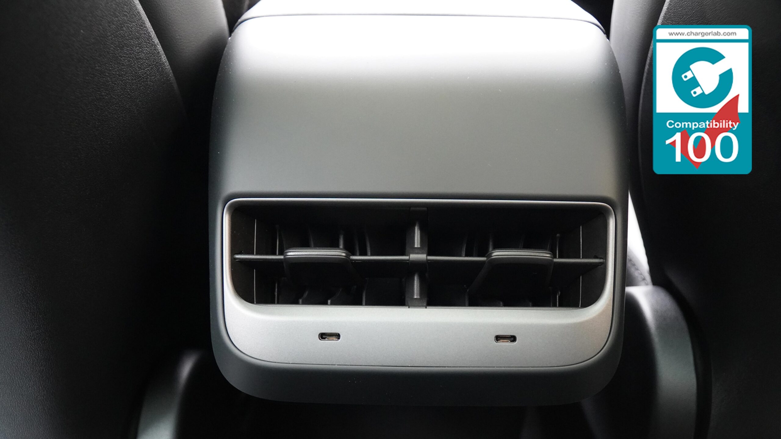

A few days ago, ChargerLAB presented a compatibility 100 test video for the Tesla model Y. Now, we will provide a detailed textual description, including more data, to give everyone a clearer understanding of the charging compatibility of this EV.
Exploring the Charging Speed of Tesla Model Y for Your Phones - ChargerLAB Compatibility 100-Chargerlab
In today's world, an increasing number of electronic devices come with fast charging ports. When it comes to this aspect, electric vehicles often invest more effort than traditional fuel-powered cars. Recently, ChargerLAB conducted a test on the charging power of the back seats USB-C port in the Tesla Model Y, revealing that it can deliver 27W and supports the PD fast charging protocol. Now, let's delve into its charging compatibility and see how it performs.
Charging Compatibility Test
ChargerLAB conducted a comprehensive test on the compatibility of the USB-C port in the back seats of the Tesla Model Y, evaluating its performance with a selection of 100 charging devices. These devices include smartphones, game consoles, wearable devices, tablets, and laptops, aiming to cover the majority of users' charging scenarios.
