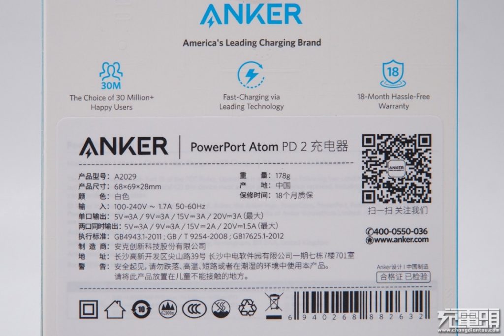

Model: A2029
Weight: 178g (6.28 oz)
Size: 68*69*28mm (2.68 x 2.72 x 1.14 in)
Made in China
Input: 100-240V~ 1.7A 50-60Hz
Single Port Output: 5V/3A, 9V/3A , 15V/3A , 20V/3A
Dual Port Output: 5V/3A , 9V/3A , 15V/2A , 20V/1.5A

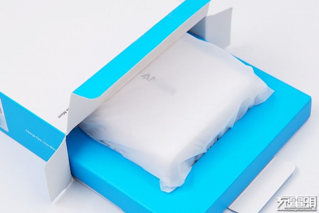

The charger lays inside the blue paper tray.

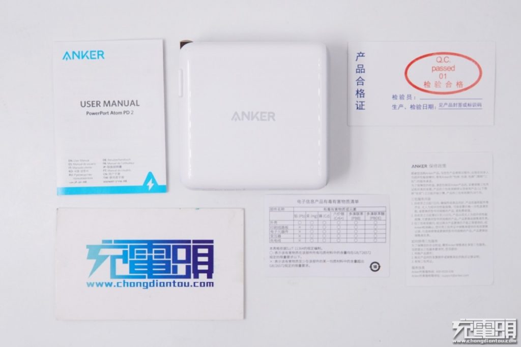

Package contents: charger, user manual, warranty card, qualification certificate, and list of hazardous substances in electronic products.

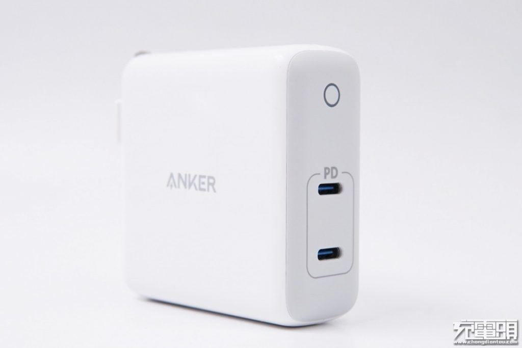

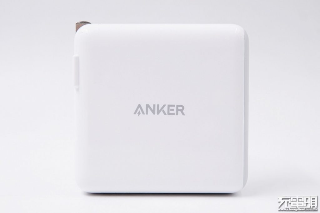

A classic ANKER charger design in glossy white which is made of flame-retardant plastic.
Anker PowerPort Atom PD 2 (A2029) Review: Power Duo-Chargerlab

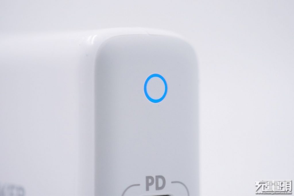

The output panel is light gray with a matte finish. It has 2 USB-C ports which are all in signature Anker blue color with PD lettering on the top. There is a ring-shaped power indicator on the left, which emits blue light when the power is turned on.

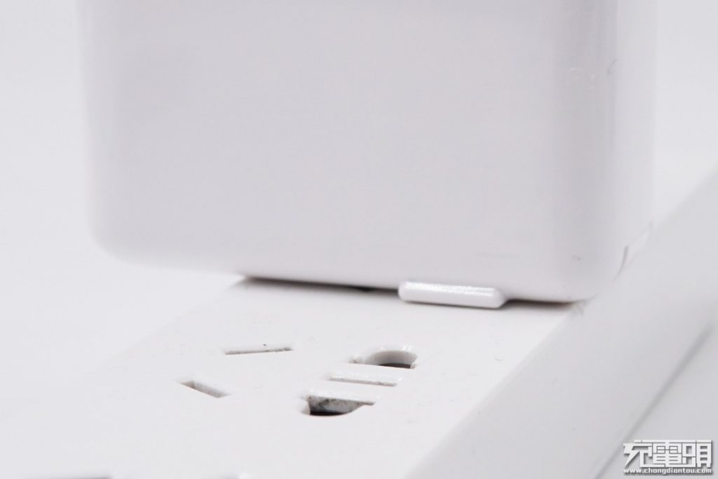

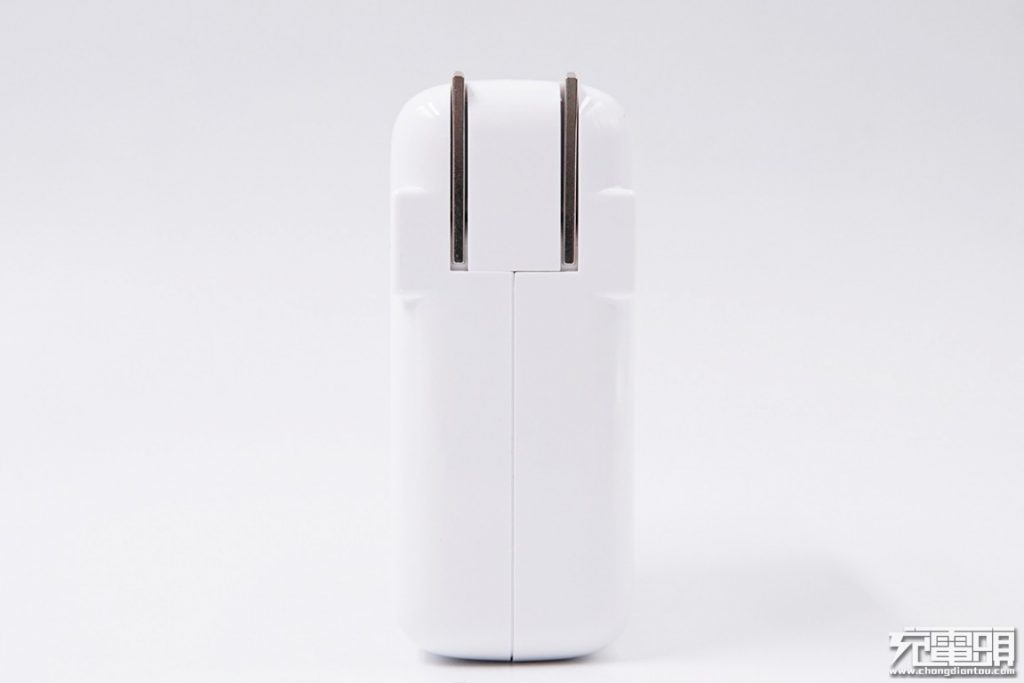

Foldable prongs offer better portability while two-wing design provides greater stability.
Close-up of the two-wing design.

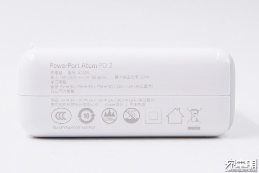

Specifications on the bottom.

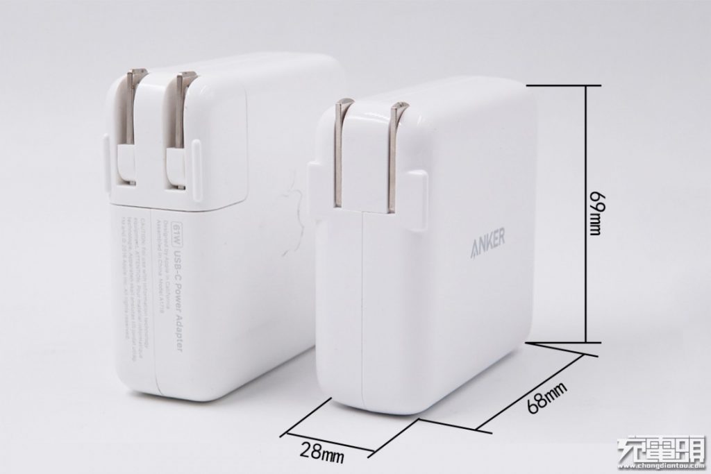

Compared to the Apple 61W PD charger, the ANKER PowerPort Atom PD 2 is about 15% smaller. Dimensions: 68*69*28mm (2.68 x 2.72 x 1.14 in).

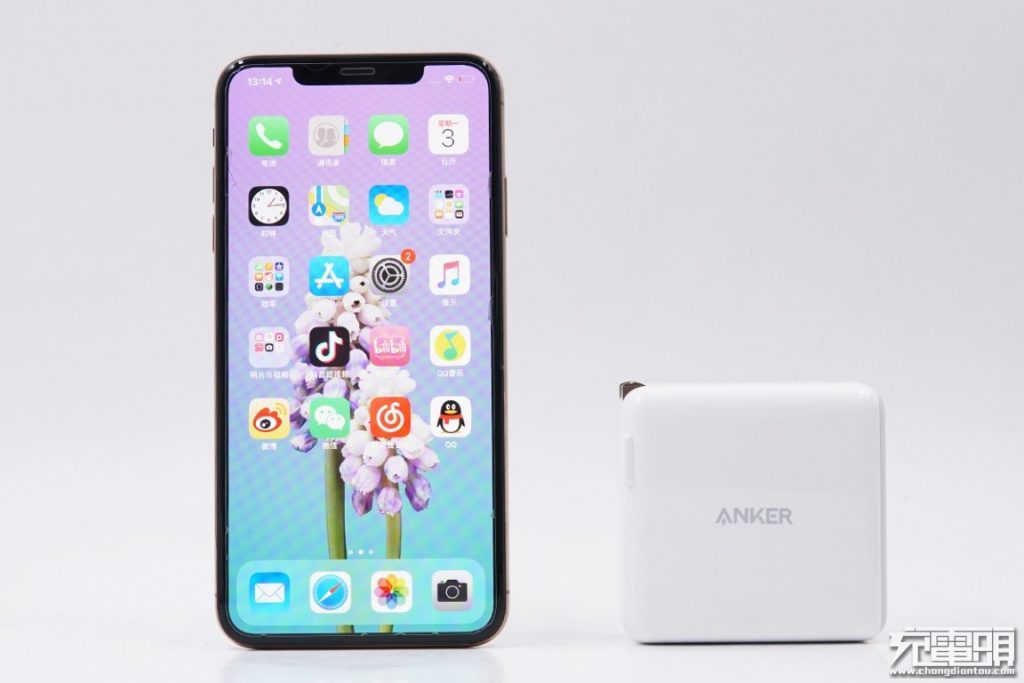

Compared to the Apple iPhone XS Max.

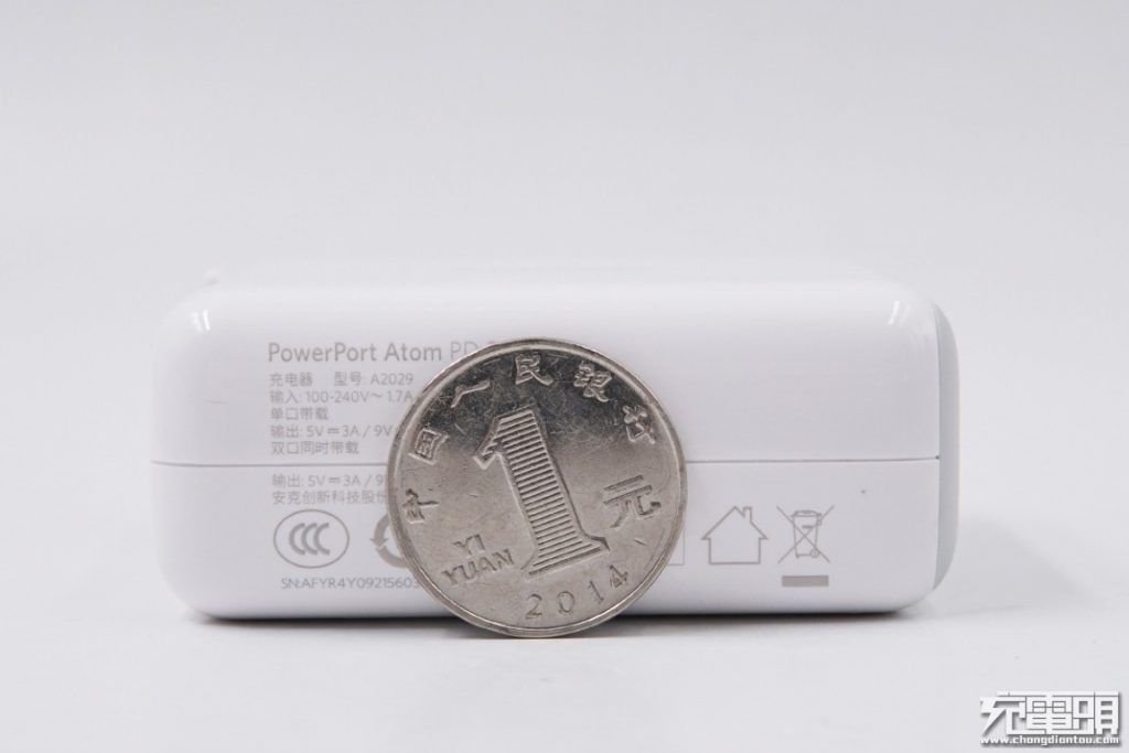

Compared to a 1 Yuan RMB coin.

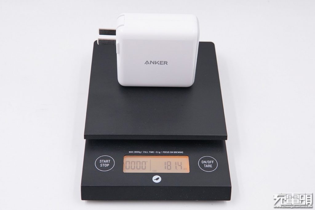

It weighs 181.4g (6.4 oz)
Despite the use of GaN technology, the size and weight control of the ANKER PowerPort Atom PD 2 is not particularly outstanding. But please note it offers two USB-C ports instead of one.

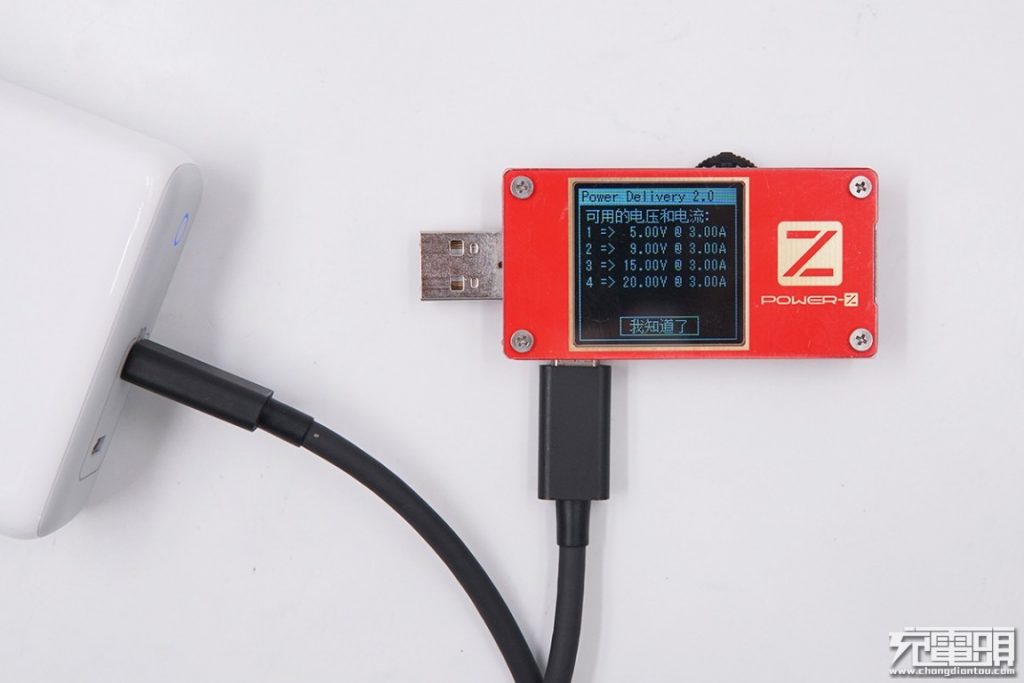

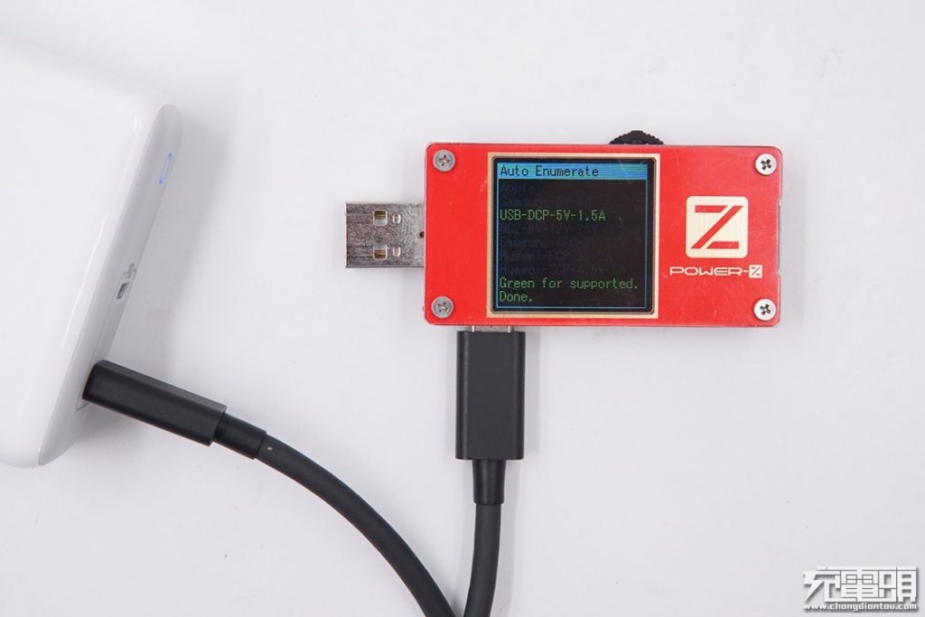

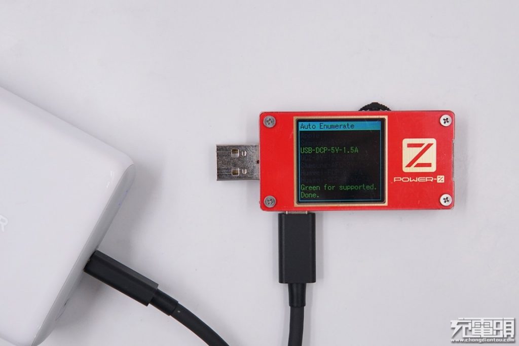

With ChargerLAB Power-Z KT001 USB power tester, we know that its upper USB-C port supports DCP protocol.

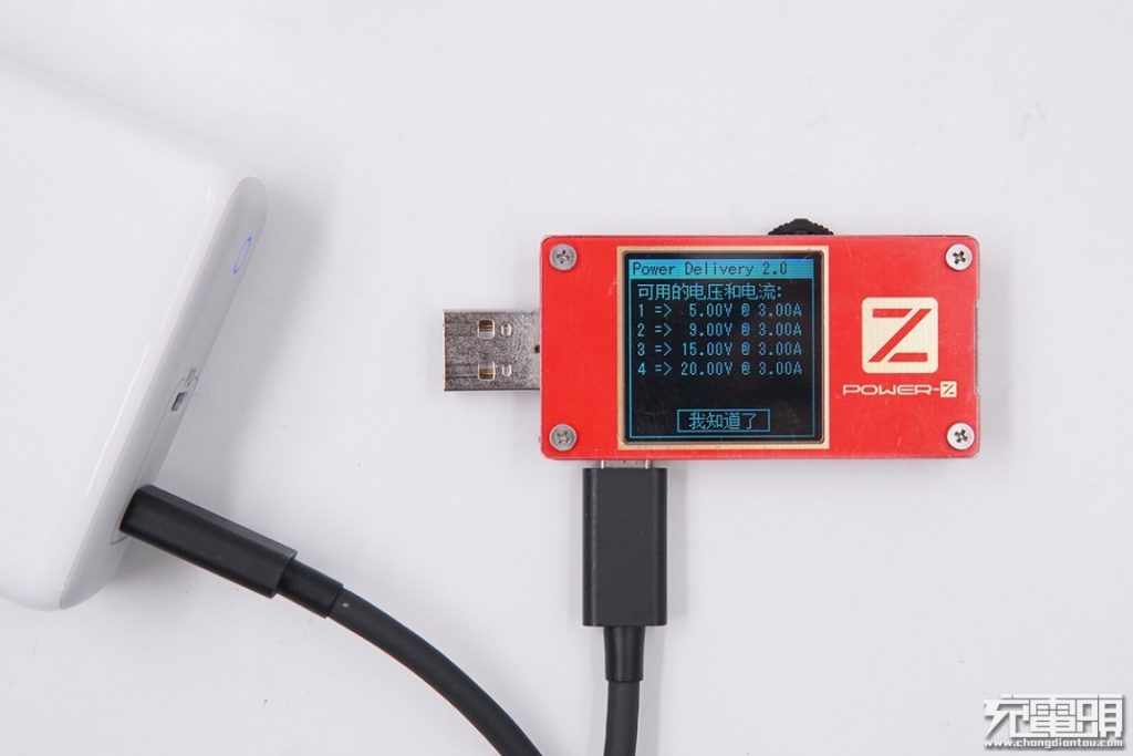

PDO information reveals it supports PD2.0 quick charging output in 5V/3A, 9V/3A, 15V/3A, and 20V/3A, 60W max.

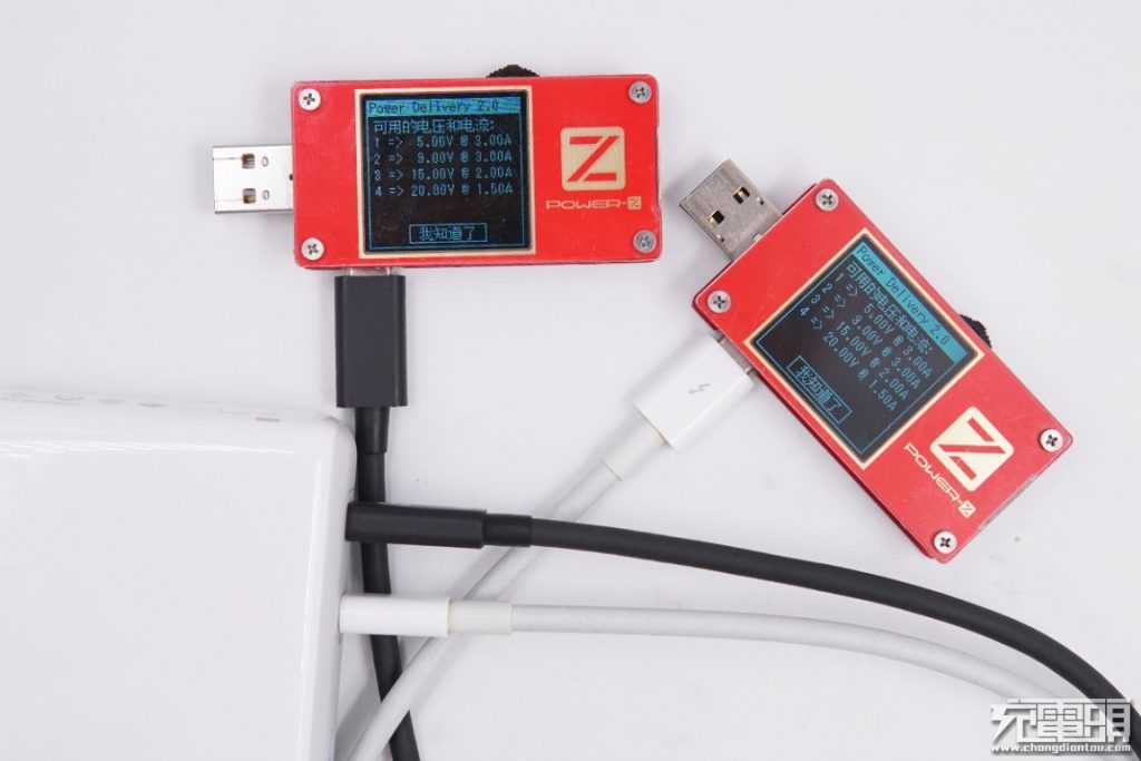

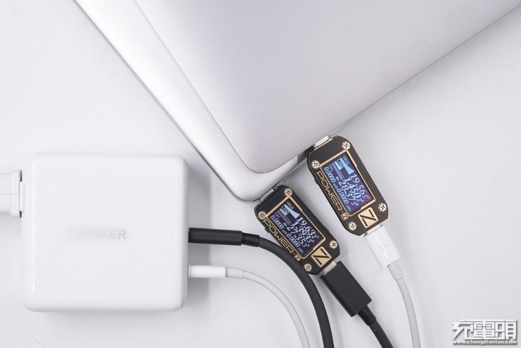

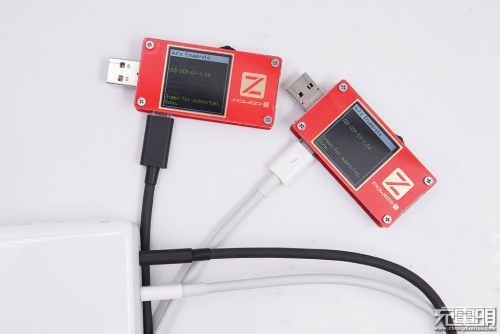

Using two ChargerLAB Power-Z KT001 USB power testers, we know that each USB-C port supports DCP protocol.
And they support PD2.0 quick charging output in 5V/3A, 9V/3A, 15V/3A, and 20V/3A, 60W max at the same time.

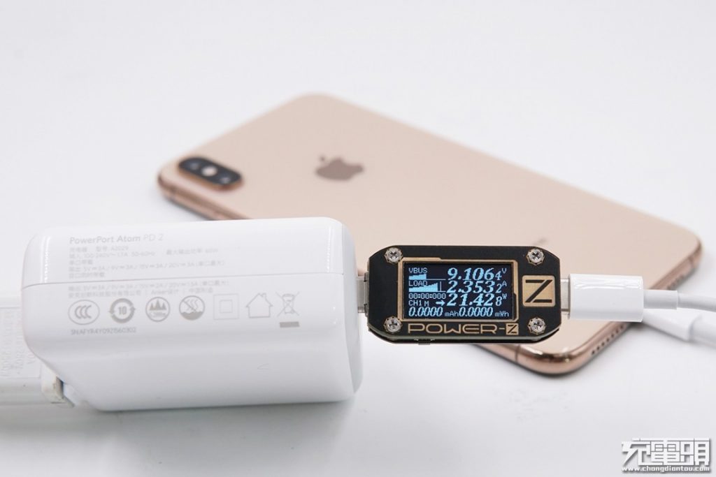

Charging the iPhone XS Max, we are getting 9.10V 2.35A 21.42W, under PD protocol.

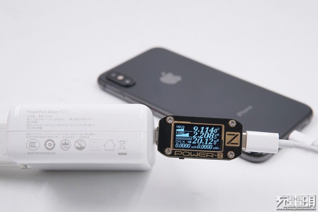

Charging the iPhone XS, we are getting 9.11V 2.2A 20.12W, under PD protocol.

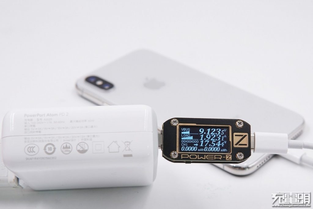

Charging the iPhone X, we are getting 9.12V 1.92A 17.54W, under PD protocol.

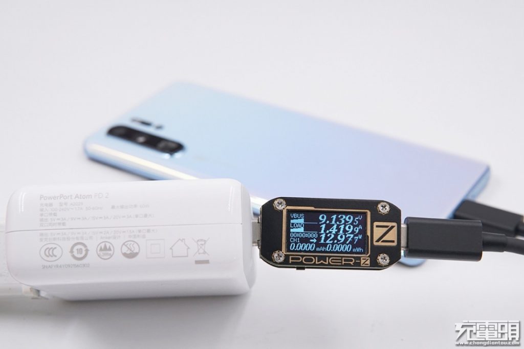

Charging the Huawei P30 Pro, we are getting 9.13V 1.41A 12.97W, under PD protocol.

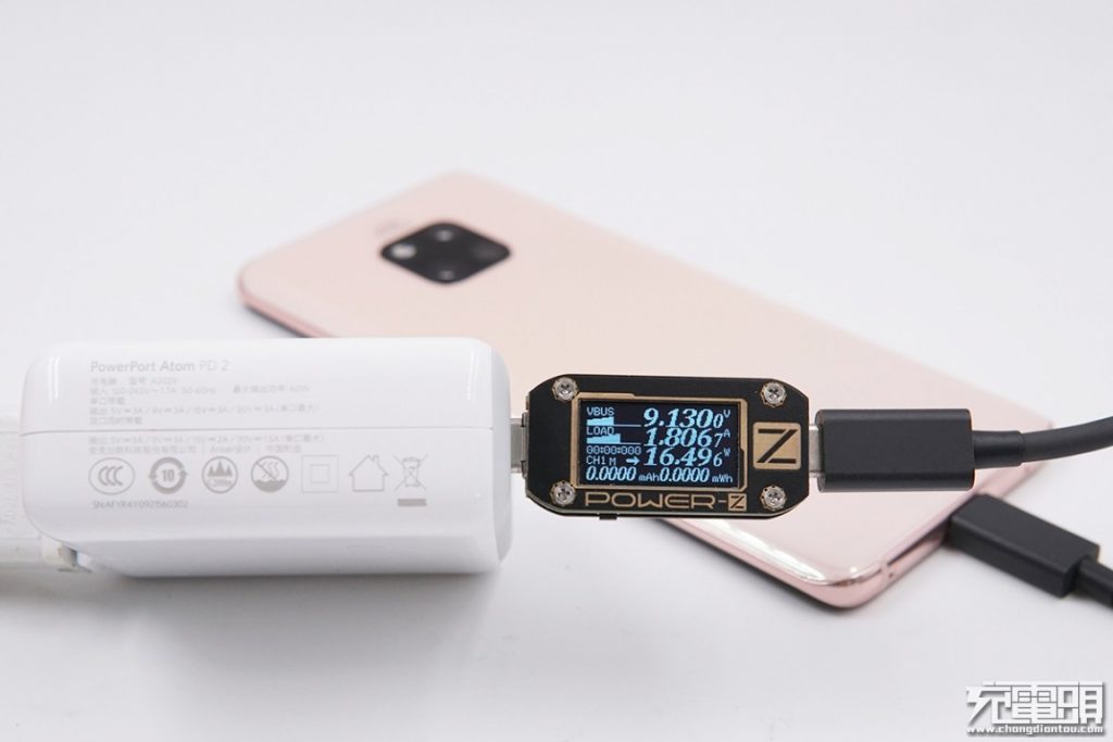

Charging the Huawei Mate 20 Pro, we are getting 9.13V 1.8A 16.49W, under PD protocol.

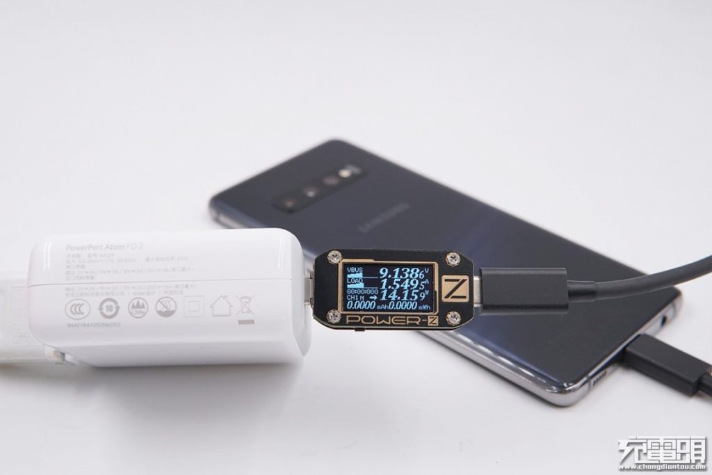

Charging the Samsung Galaxy S10+, we are getting 9.13V 1.54A 14.15W, under PD protocol.

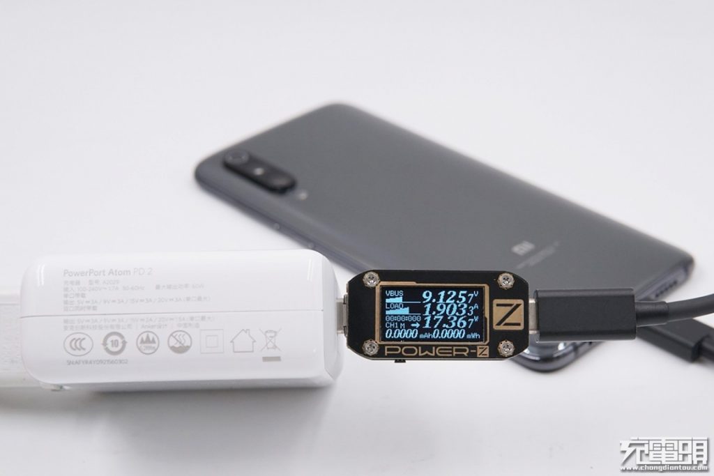

Charging the Mi9, we are getting 9.12V 1.9A 17.36W, under PD protocol.

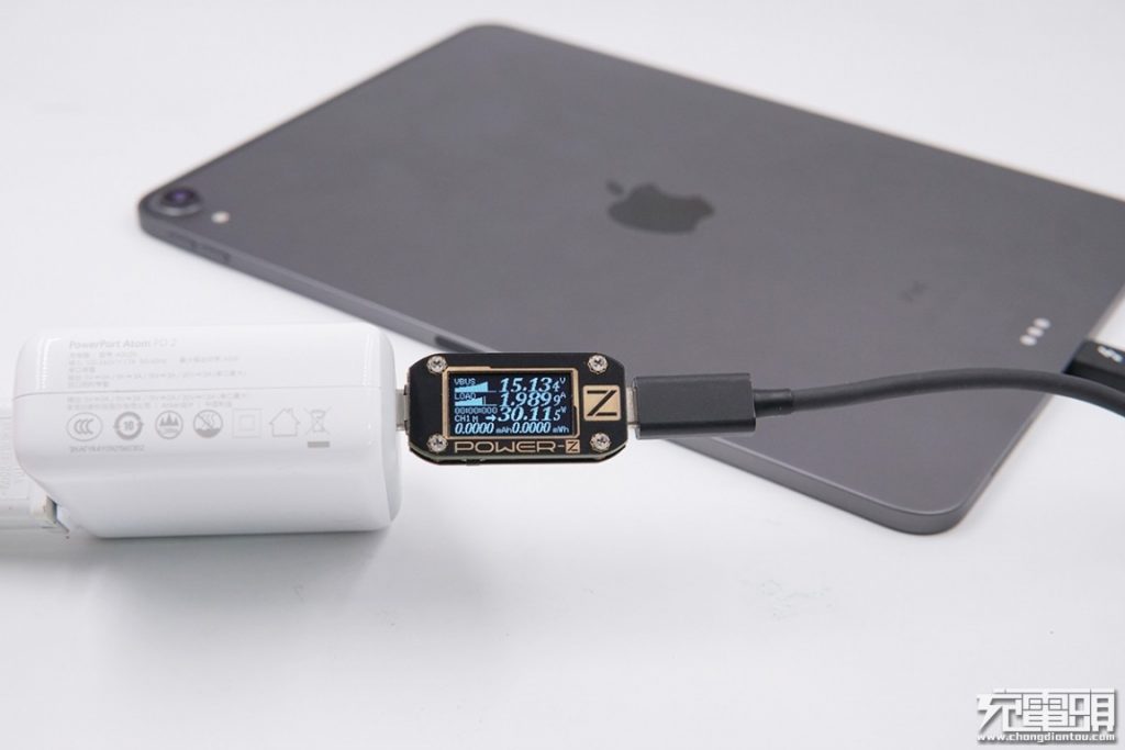

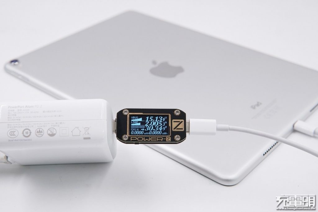

Charging the iPad Pro 11-inch, we are getting 15.13V 1.98A 30.11W, under PD protocol.

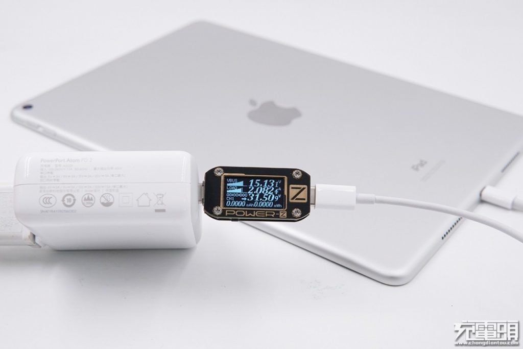

Charging the iPad Air3, we are getting 15.13V 2.08A 31.5W, under PD protocol.

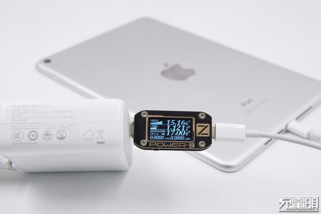

Charging the iPad mini5, we are getting 15.16V 1.12A 17W, under PD protocol.

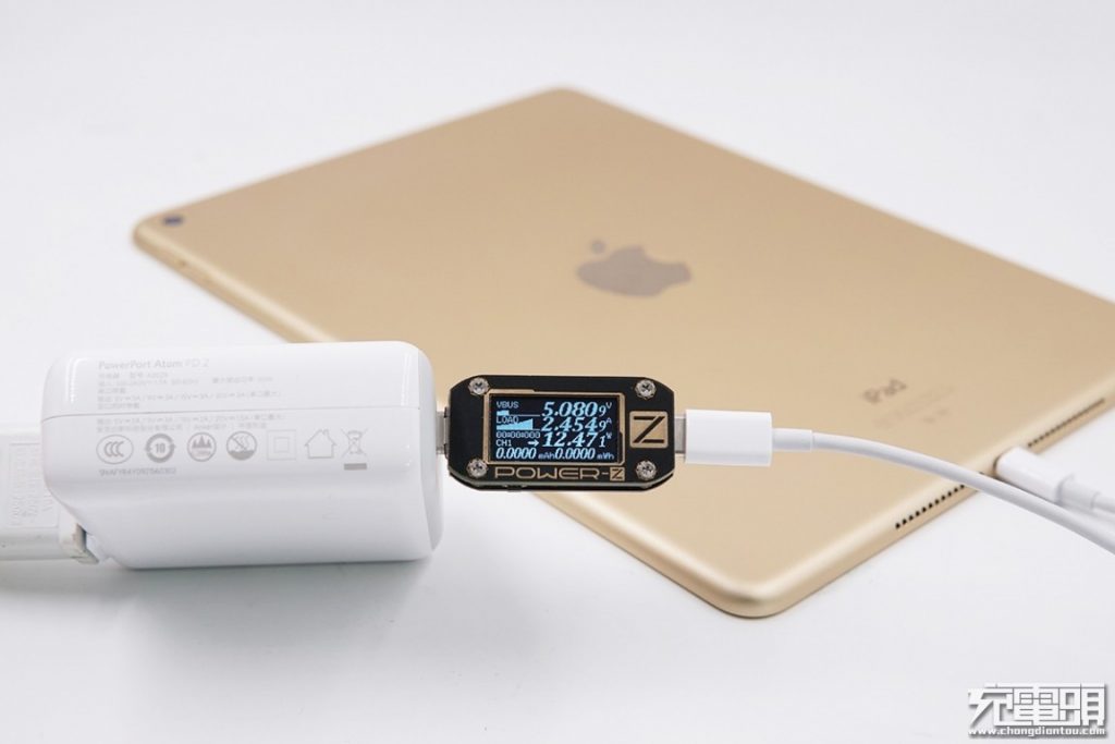

Charging the iPad Air2 which doesn't support PD, we are getting 5.08V 2.45A 12.47W, under Apple 2.4A protocol.

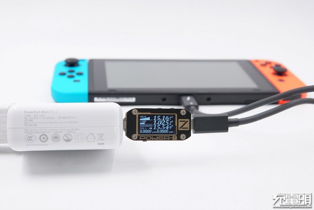

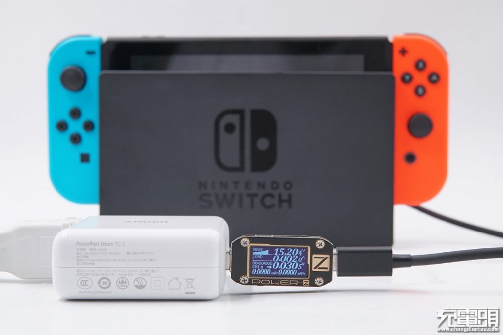

Charging the Nintendo Switch, we are getting 15.16V 1.02A 15.54W, under PD protocol.
However it can't charge the Nintendo Switch in TV mode. The Nintendo Switch in TV mode is quite picky on chargers in our experience.

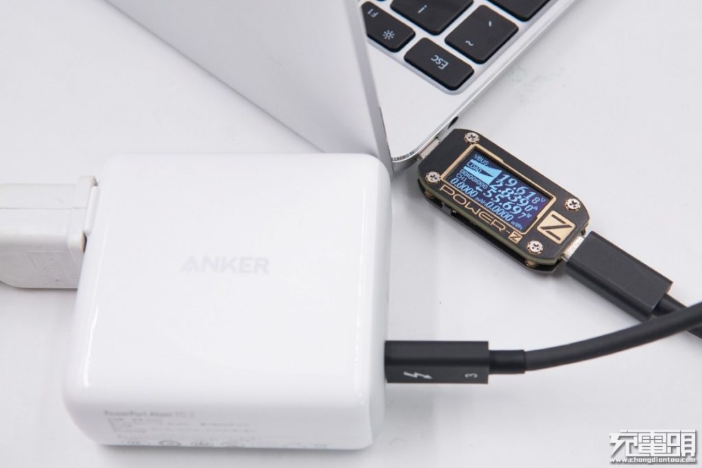

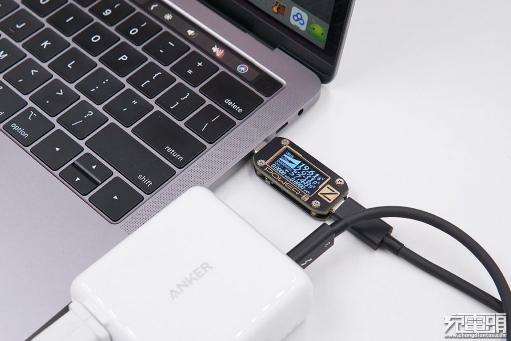

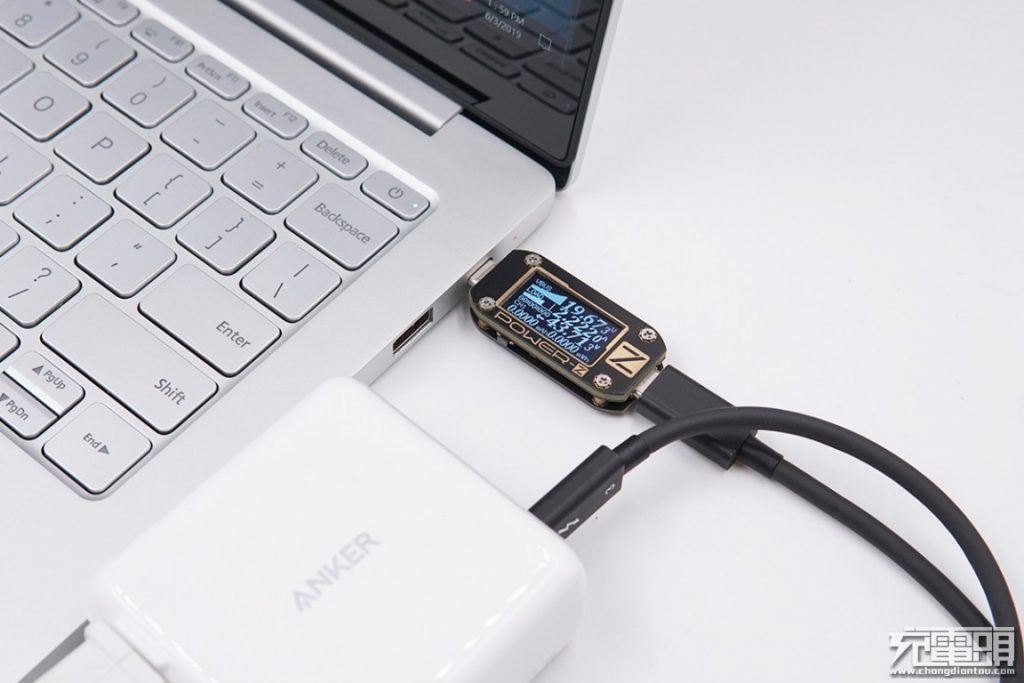

Charging the MacBook Pro 13.3-inch 2018, we are getting 19.61V 2.93A 57.48W, under PD protocol.

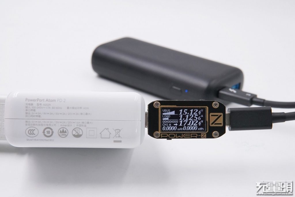

Charging the ANKER PowerCore 10000 PD Power Bank (A1235), we are getting 15.12V 1.12A 17.02W, under PD protocol.

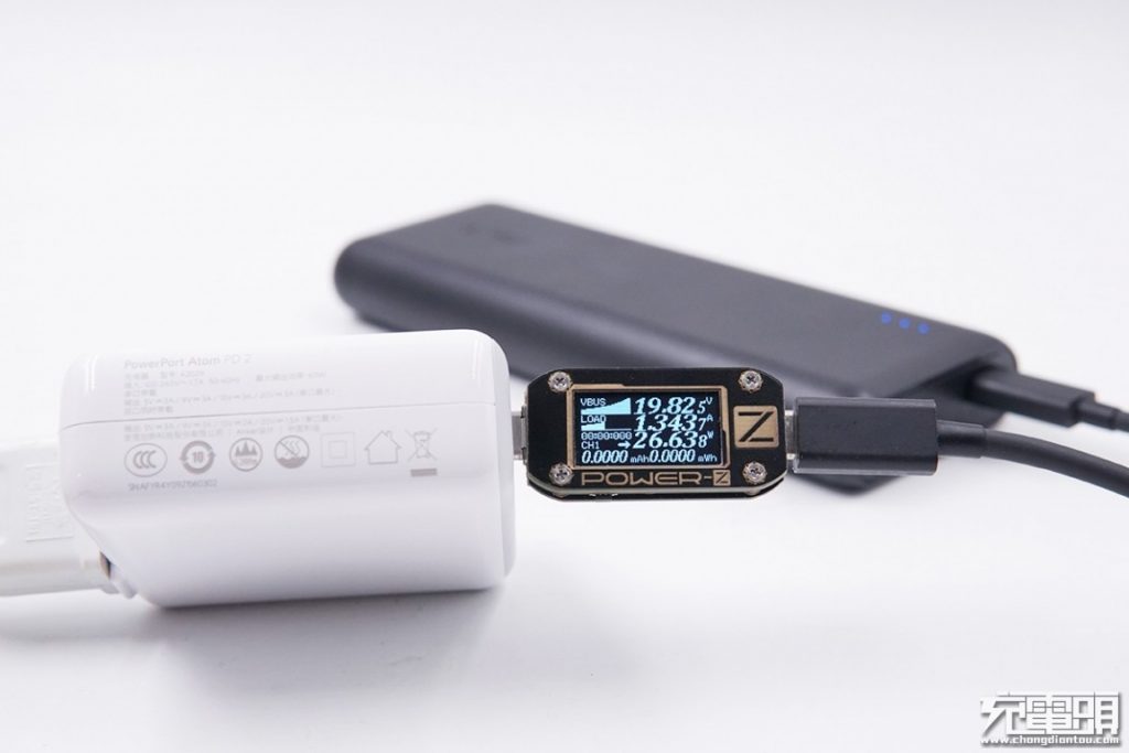

Charging the PowerCore Speed 20000 PD (A1275), we are getting 19.82V 1.34A 26.63W, under PD protocol.

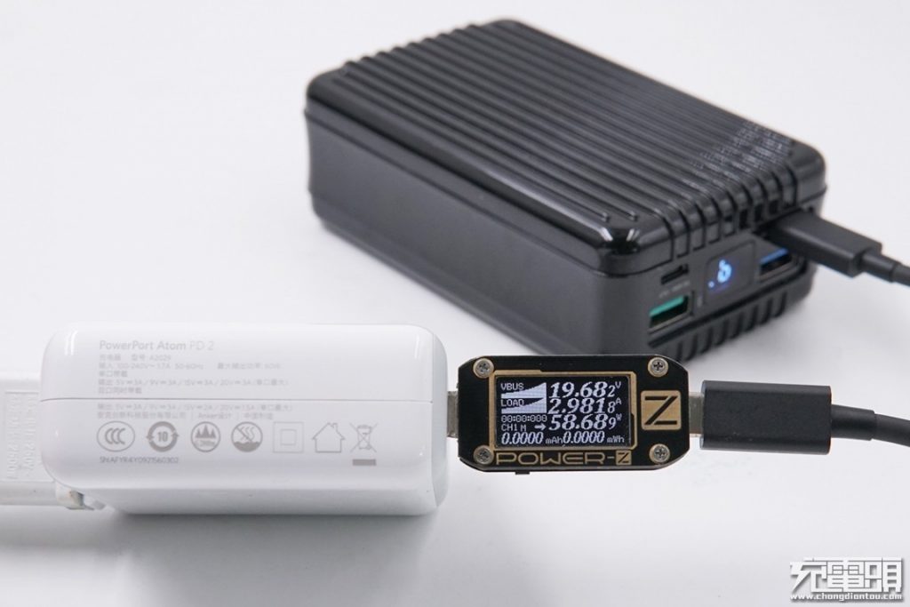

Charging the Zendure ZDA8PDP power bank, we are getting 19.68V 2.98A 58.68W, under PD protocol.

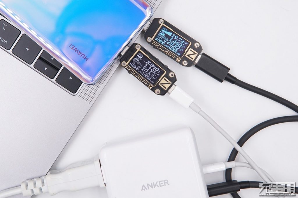

It can charge the Huawei P30 Pro and the MacBook Pro 13.3-inch 2018 at the same time, at the speed of 10.63W (8.89V/1.19A) and 28.82W (19.74V/1.46A) respectively, both under PD protocol.

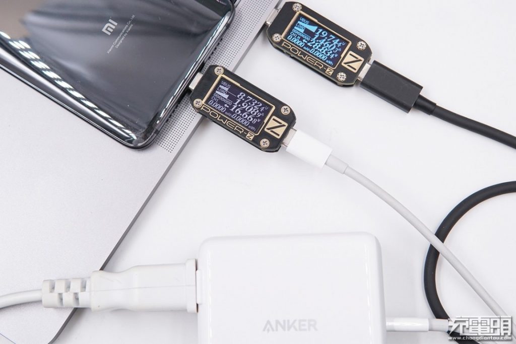

It can charge the Mi9 and the MacBook Pro 13.3-inch 2018 at the same time, at the speed of 16.66W (8.73V/1.9A) and 28.83W (19.74V/1.46A) respectively, both under PD protocol.

It can charge the MacBook Pro 13.3-inch 2018 and the Huawei MateBook 13 at the same time, at the speed of 28.37W (19.56V/1.45A) and 27.35W (19.63V/1.39A) respectively, both under PD protocol.

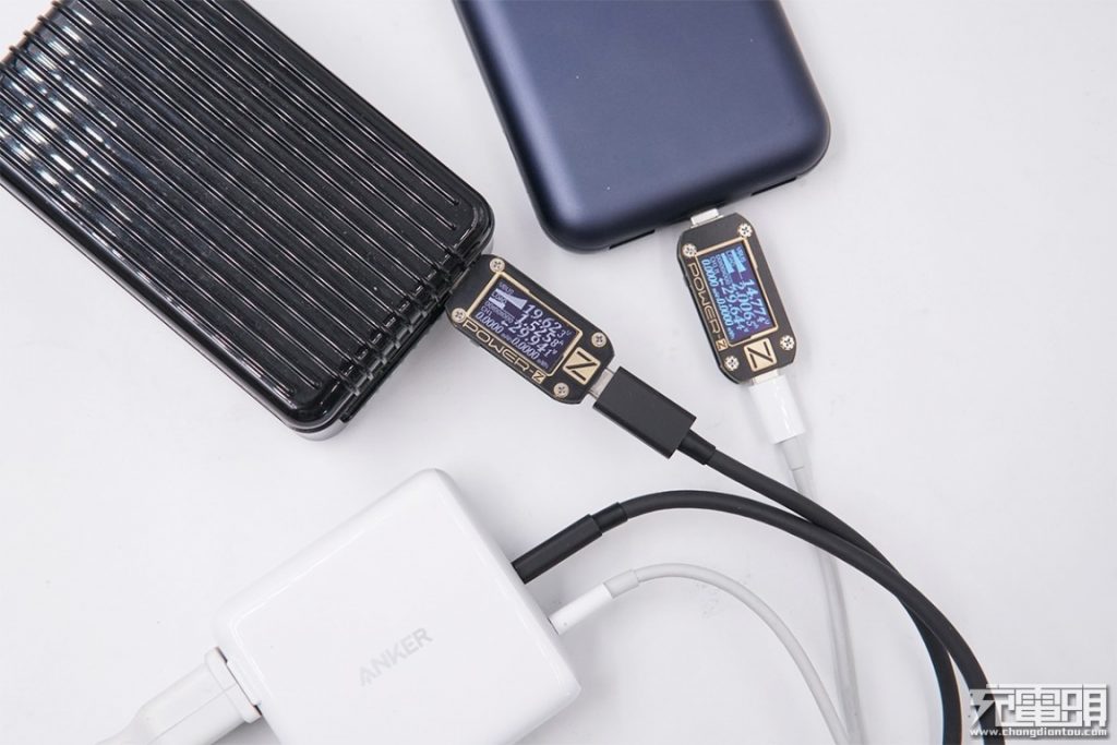

It can charge the Zendure ZDA8PDP power bank and the ZMI QB820 power bank at the same time, at the speed of 29.94W (19.62V/1.52A) and 29.64W (14.77V/2A) respectively, both under PD protocol.
