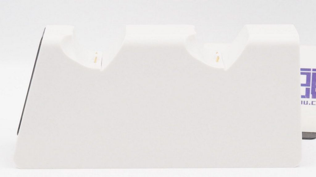

1. Controllers Can be Easily Lying Down
Fast Charging & Convenient | Review of Neentone PS5 Controller Charging Station-Chargerlab
Most traditional charging stations on the current market are difficult to stable sit and fit in on a single time.
Players usually need 30-40 seconds to align the pogo pins between the controller and the charging dock and ensure its charging status.
This charging dock improved the structure that can easily fix the controller into the charging dock, just like the official one.

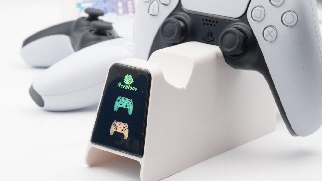

2. Clear and Clean Status Indication
As we all know, the official Sony PS5 controller charger station doesn't have an indicator light. So, you need to check it on your devices or TV screen.
The traditional third-party charging station depends on current detection to judge the charging status. They usually have a red and a green light to show the power info, which is doubtful. Because when the controller is completely out of power, the current will be very low, the traditional charging station can't detect it.
So, it still displays red after you put your controller down, which makes you believe it has fully charged but actually not.
The Neentone charging station improved the charging protocol program and makes it more natural and logical.
The green light means connected and charged, the red light means full charged, and the orange light means unconnected.

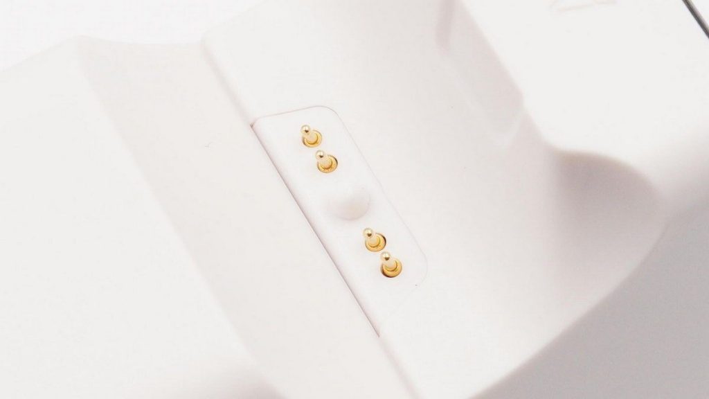

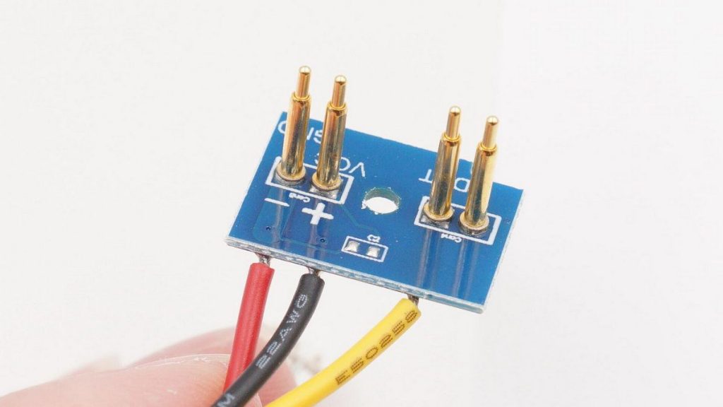

It adopts the pogo pins for fast charging.

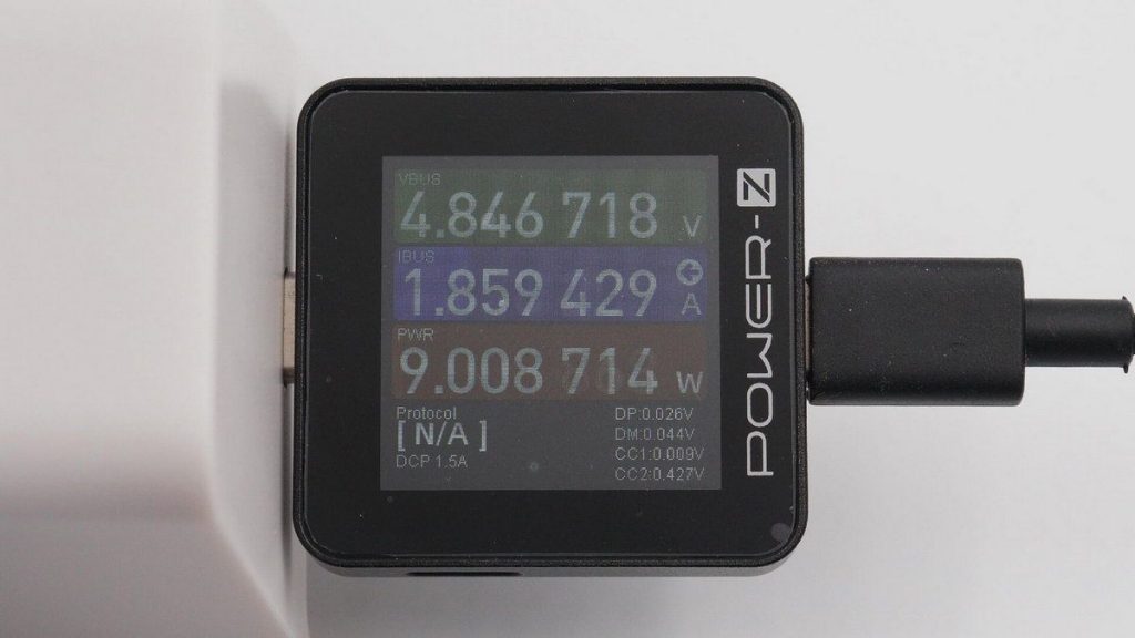

And the charging speed is basically the same as the official one, at 9W.
Here is the complete process of the charging curve. We tested it on the Japan version. It'll take about 2 hours and 55 minutes to be fully charged. The front and back USB-C port have the same result.

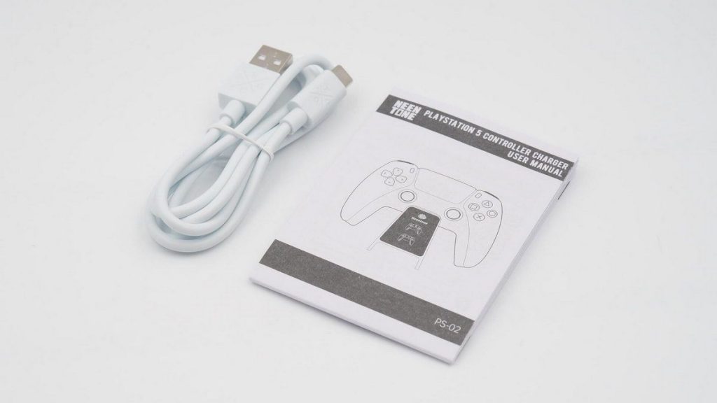

The product package contains a USB-C cable (1M).
Please make sure to find an adapter above 5V 2.4A to support fast charging.
