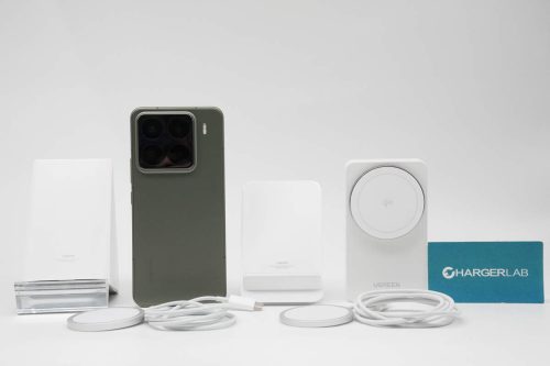

Wireless Charging Review of Xiaomi 15 Pro-Chargerlab
We will use multiple wireless chargers for testing to see how compatible it is.
