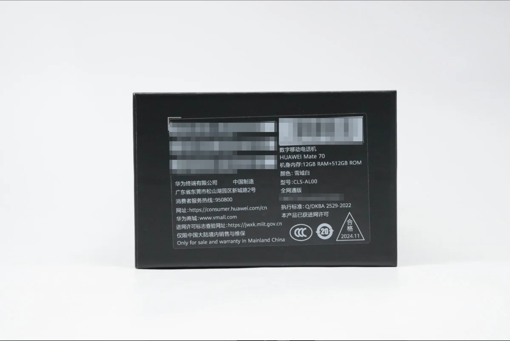

This side has a sticker with parameter information, model: CLS-AL00.

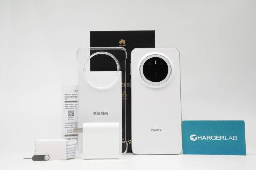

The box contains the Huawei Mate 70, a 66W charging set, and some documents.

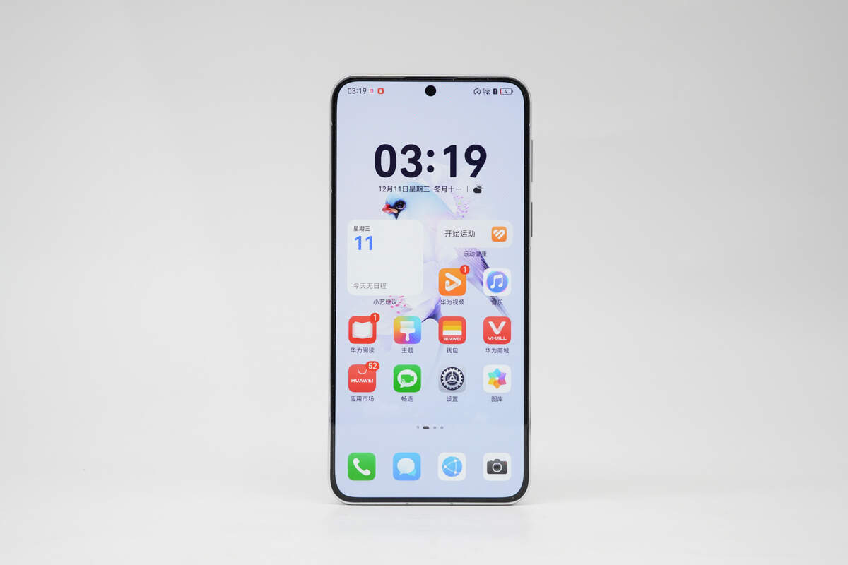

The Huawei Mate 70 is equipped with a 6.7-inch display, supports 1-120Hz adaptive refresh rate, 300Hz touch sampling rate, and also supports up to 1440Hz high-frequency PWM dimming.
