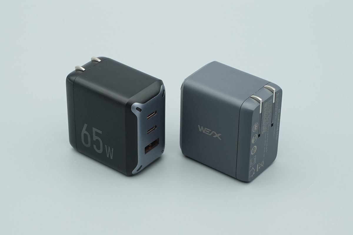

Available in classic black and gray, the WEX 65W charger maintains a minimalist, cubic design. Notably, the internal engineering and build quality remain consistent across both versions.
Teardown of the WEX 65W SiC Charger-Chargerlab

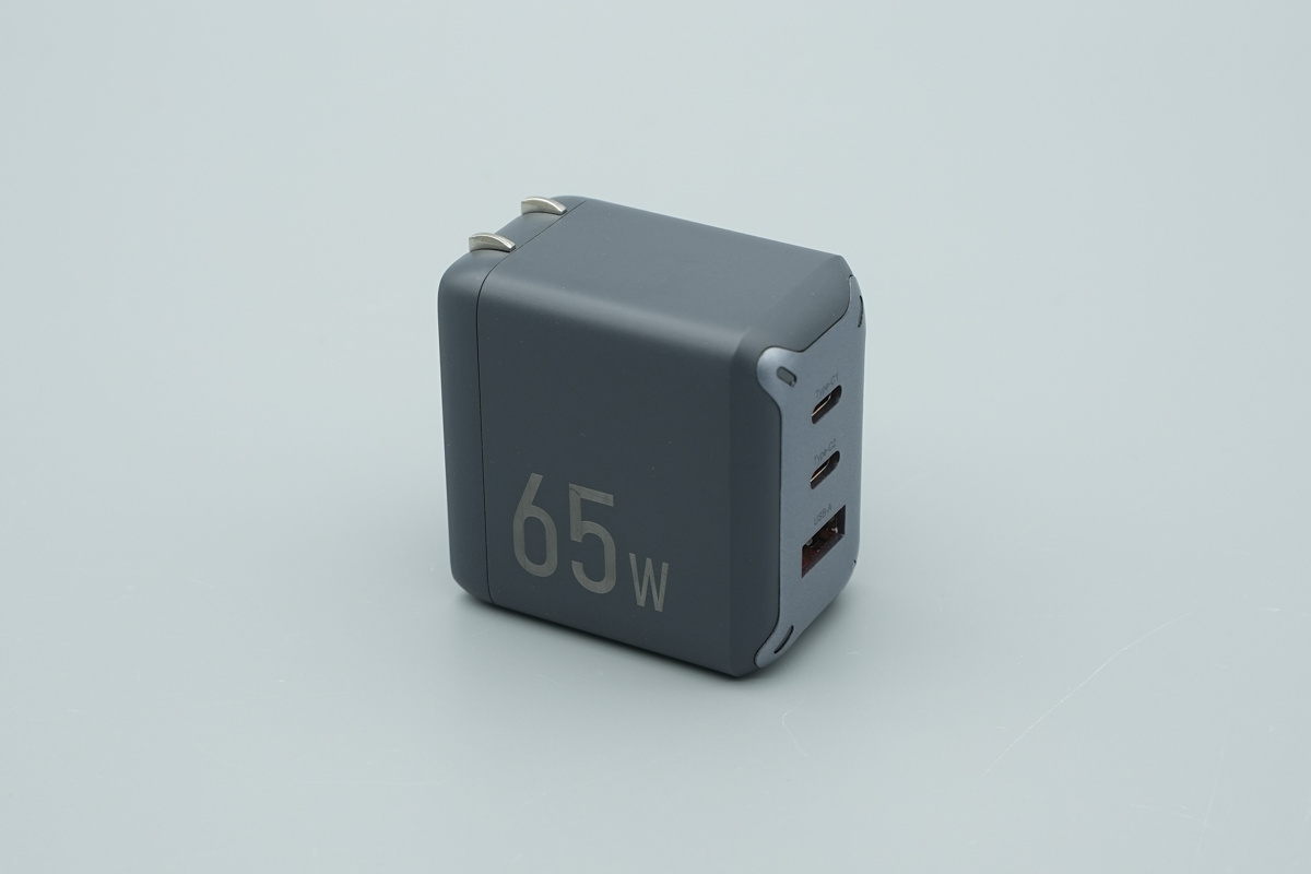

Focusing on the gray one, the fit and finish at the seam where the pin-side housing meets the main body is tight and remarkably well-built.

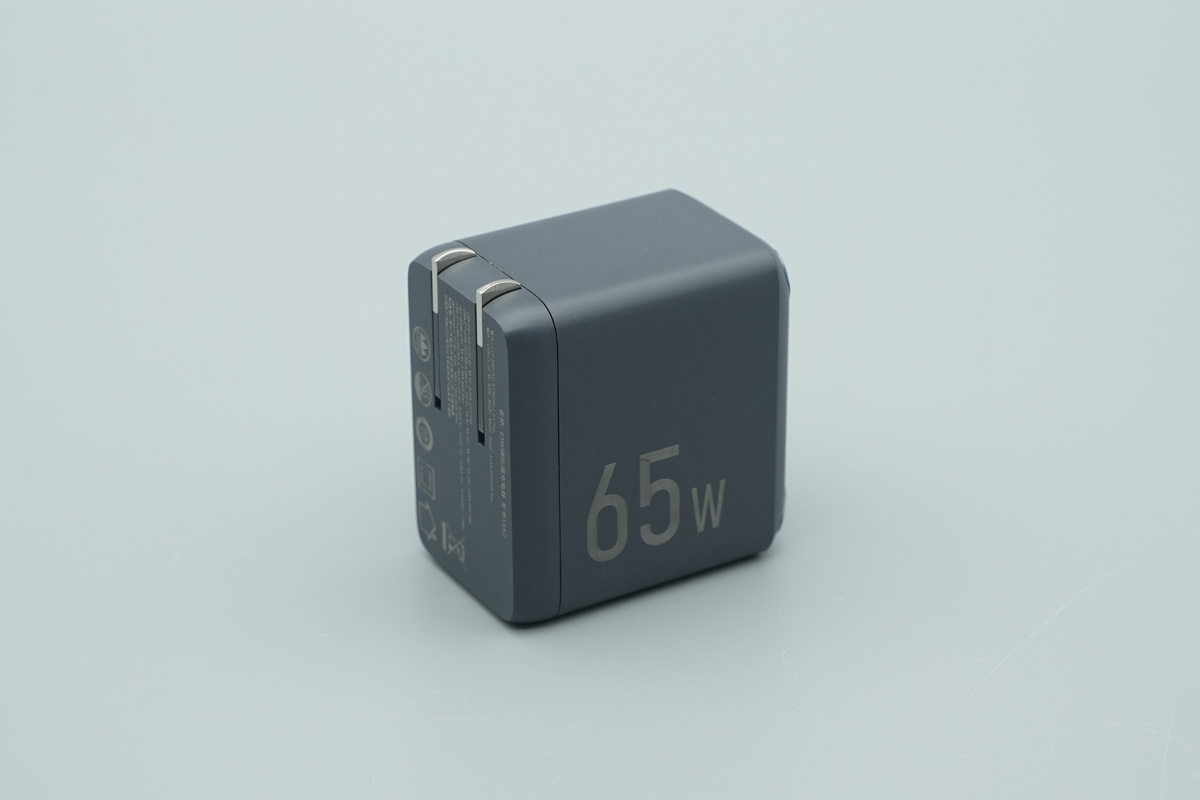

The side of the chassis features a prominent '65W' marking, clearly indicating the Max rated output power of the unit.

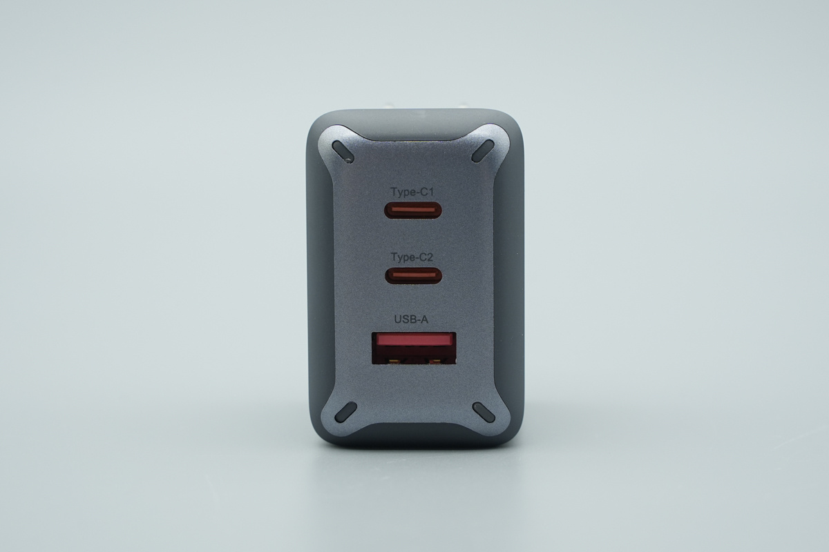

The output end features two USB-C ports (C1, C2) and one USB-A port. Each port is equipped with an orange plastic sheet, signaling support for high-speed fast-charging protocols.

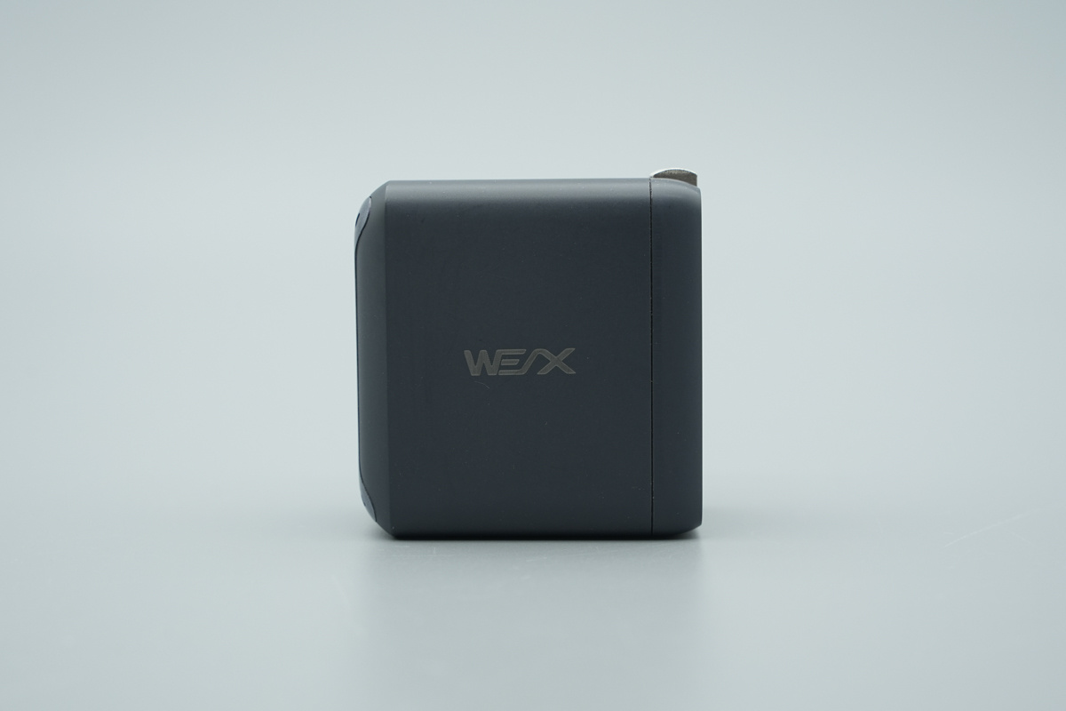

The WEX logo is prominently displayed on the side panel.

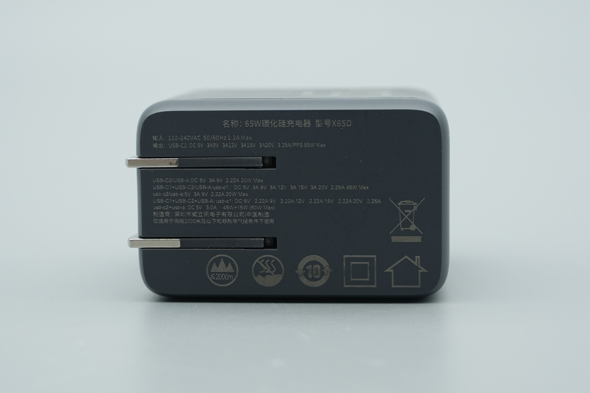

The base of it features a detailed technical specs label.
Product Specifications:
Name: the WEX 65W SiC Charger
Model: X65D
Input: 110-240V~ 50/60Hz 1.2A Max
Output:
USB-C1: 5V/3A, 9V/3A, 12V/3A, 15V/3A, 20V/3.25A (65W Max / PPS)
USB-C2 / USB-A: 5V/3A, 9V/2.22A (20W Max)
USB-C1+USB-C2/USB-A: USB-C1: 5V/3A, 9V/3A, 12V/3A, 15V/3A, 20V/2.25A (45W Max)
USB-C2/USB-A: 5V/3A, 9V/2.22A (20W Max)
USB-C1+USB-C2+USB-A: USB-C1: 5V/2.22A, 9V/2.22A, 12V/2.22A, 15V/2.22A, 20V/2.25A,
USB-C2+USB-A: 5V 3.0A, 45W+15W (60W Max)

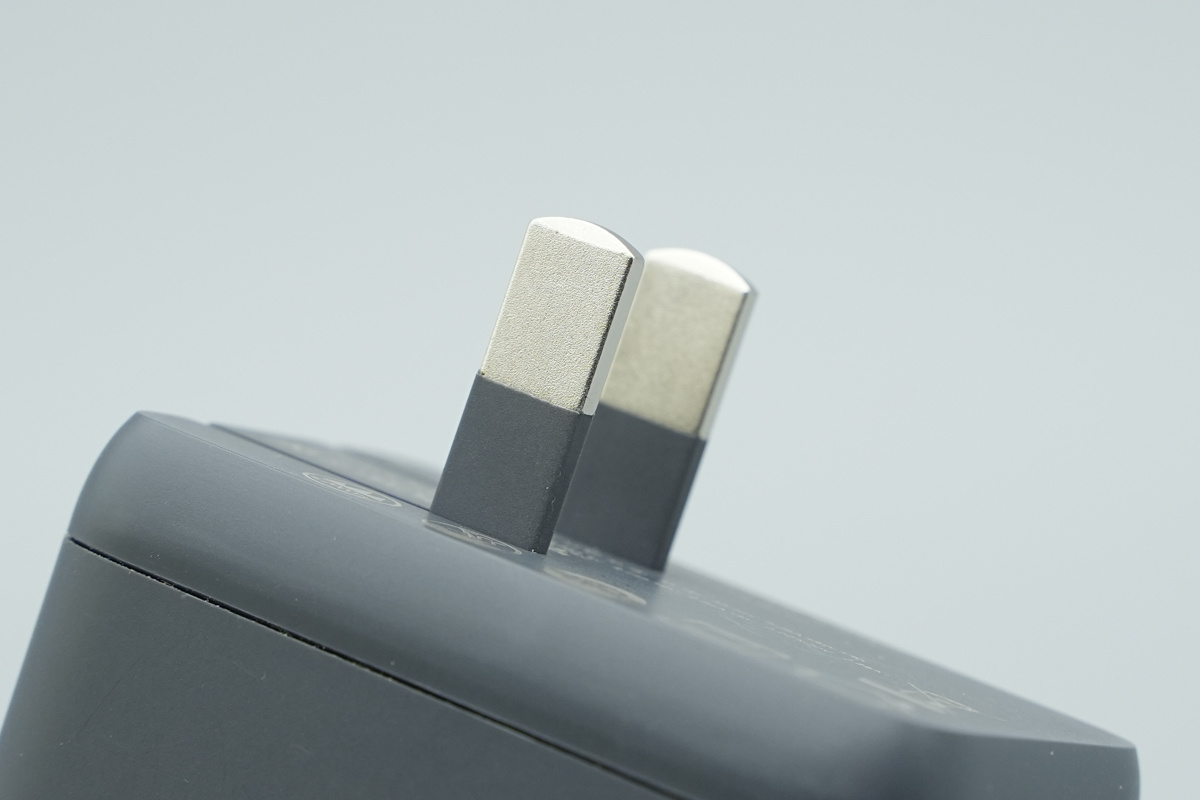

It is equipped with foldable AC pins compliant with Chinese standards, ensuring ease of storage and preventing accidental scratches to other items during transit

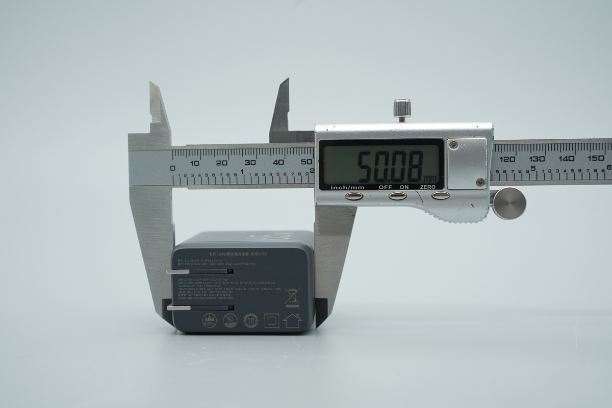

The length of the charger is about 50.08mm (1.972 inches).

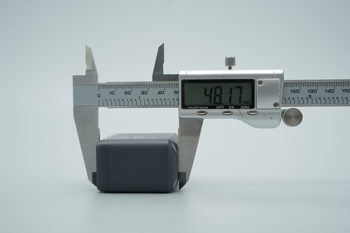

The width of the charger is about 48.17mm (1.897 inches).

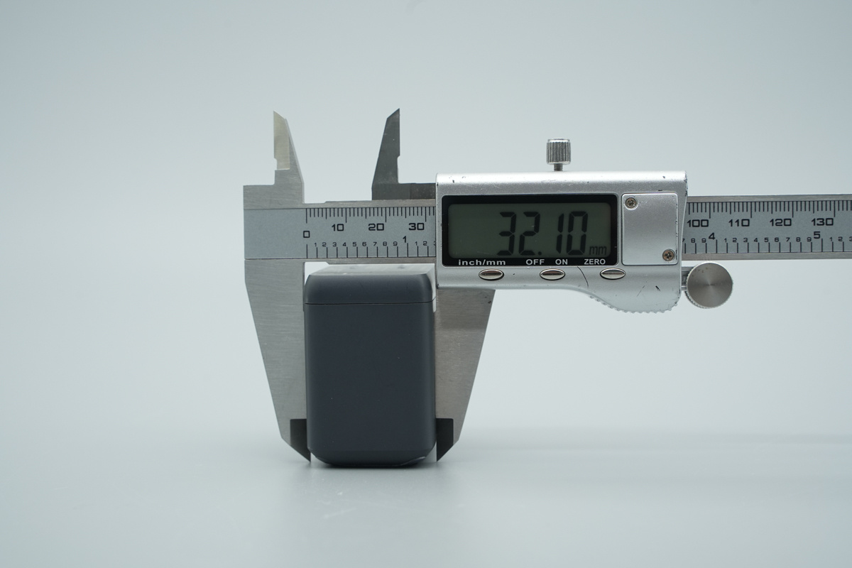

The thickness of the charger is about 32.10mm (1.264 inches).

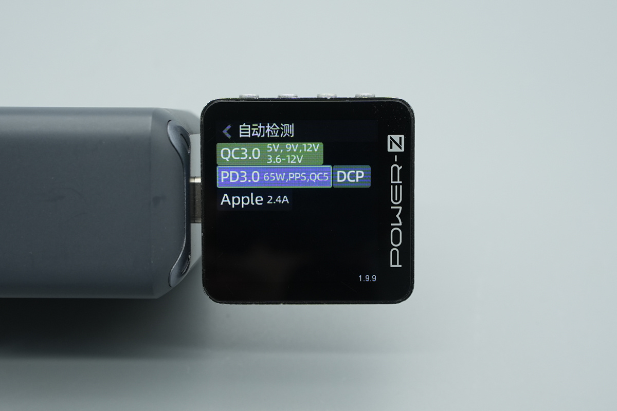

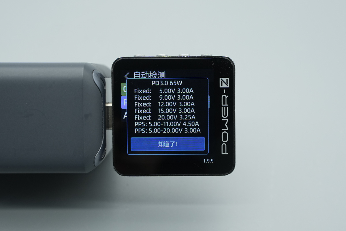

ChargerLAB POWER-Z KM003C shows that the USB-C1 port supports QC3.0, PD3.0/PPS, QC5, Apple 2.4A and DCP.
And it also supports four fixed PDOs of 5V3A, 9V3A, 12V3A, 15V3A and 20V3.25A, and features PPS subset: 5-11V4.5A and 5-20V3A.

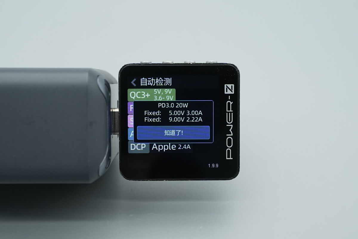

ChargerLAB POWER-Z KM003C shows that the USB-C2 port supports QC3+, FCP, SCP, AFC, PD3.0, Apple 2.4A and DCP.
And it also supports four fixed PDOs of 5V3A and 9V2.22A, Max 20W.

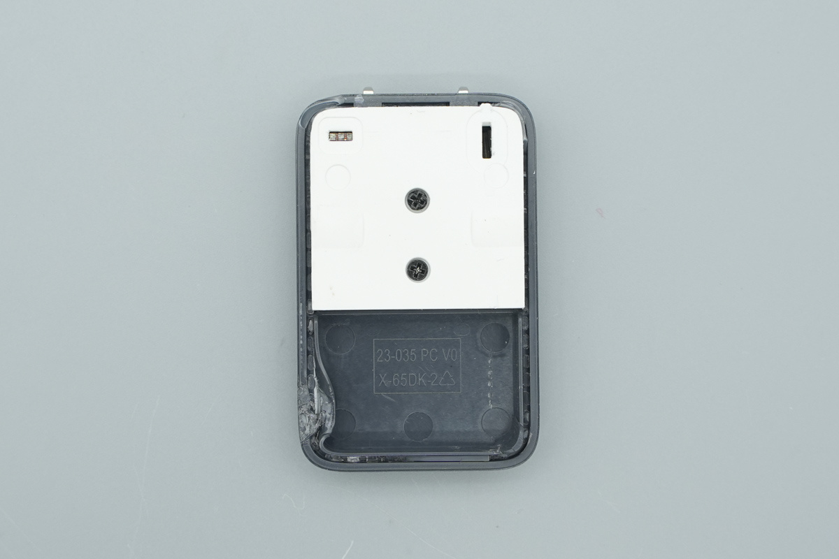

Moving to teardown, carefully pry open the housing to reveal the PCBA module inside.

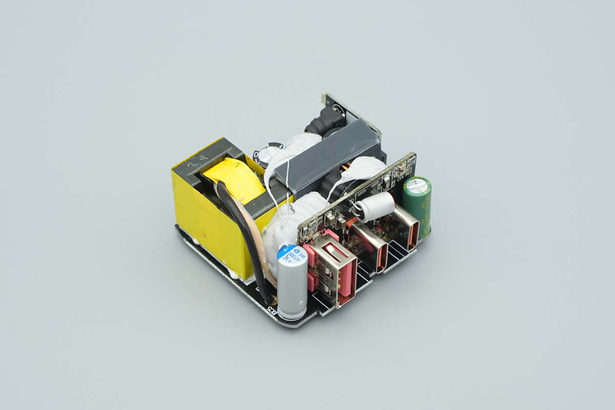

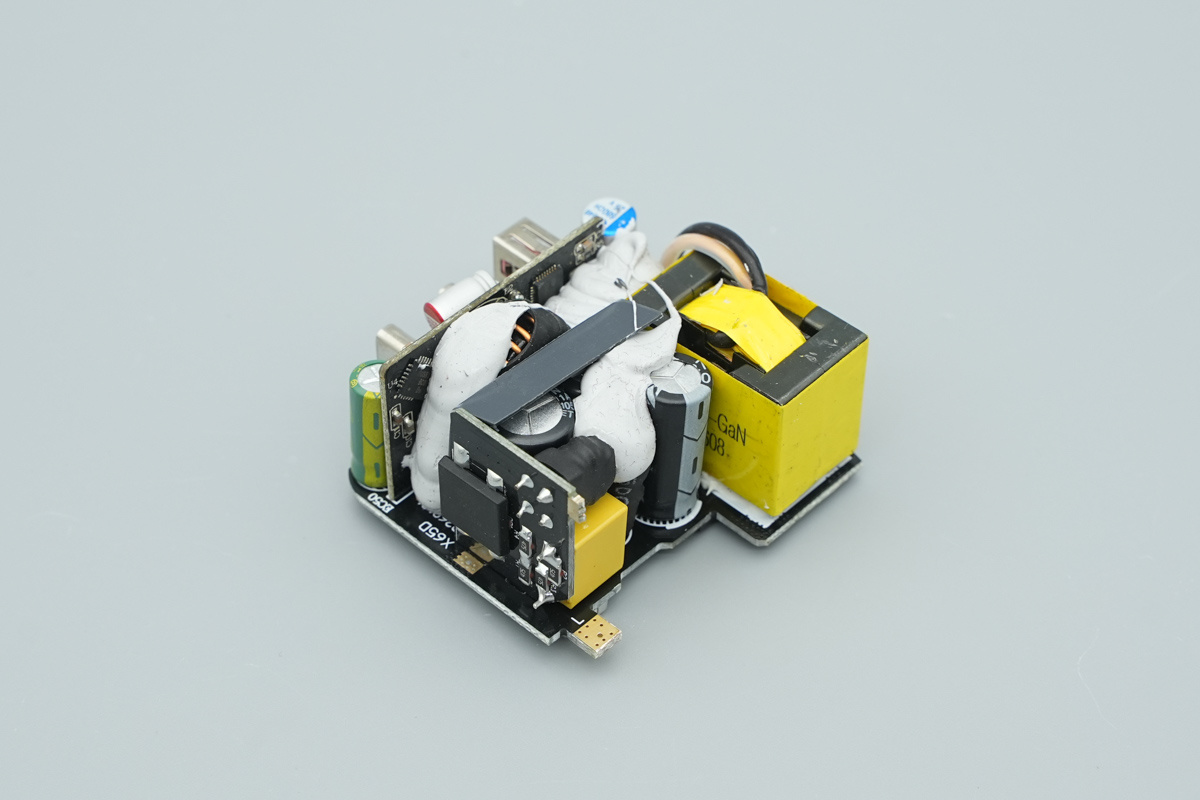

On the PCBA front, wihte thermal potting compound is applied across the transformer and caps to anchor the components and optimize thermal management.

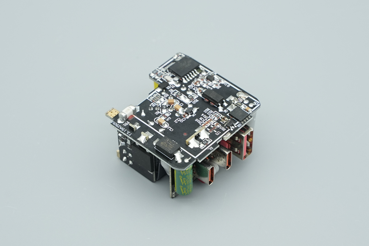

This is the side-profile view of the PCBA module.
This is the rear view of the PCBA module, featuring key components including the primary master control chip, an optocoupler, synchronous rectifier controllers, and synchronous rectifier MOSFETs.

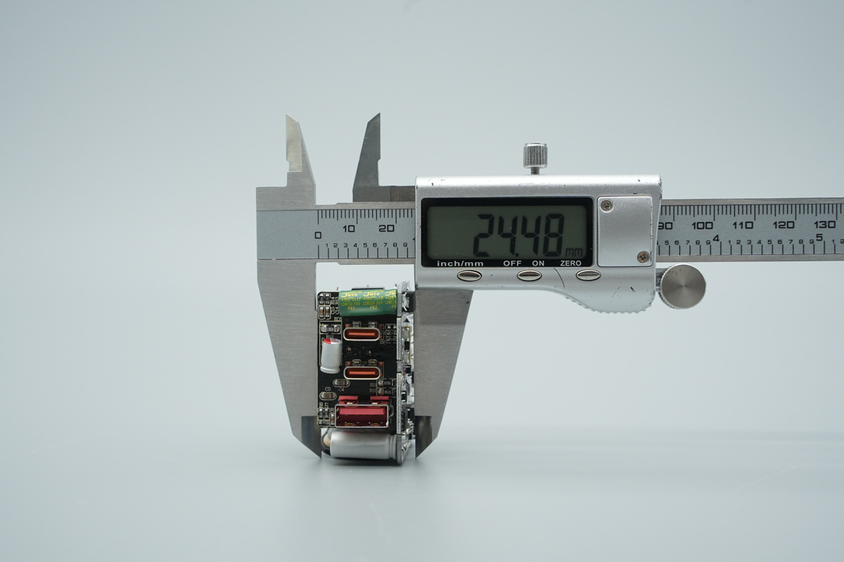

The thickness of PCBA is about 24.88mm (0.964 inches).

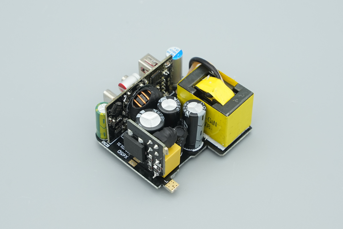

After removing the surface wihte thermal potting compound, the internal circuit architecture of the charger is clearly manifested.
This reveals key electrical components, like input filtering elements, high-voltage filter caps, the main transformer, input end PCB and the output end step-down PCB.

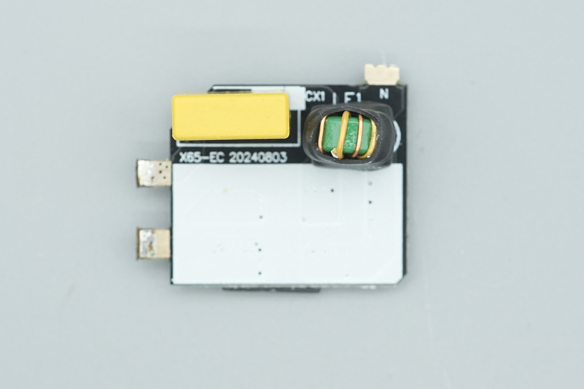

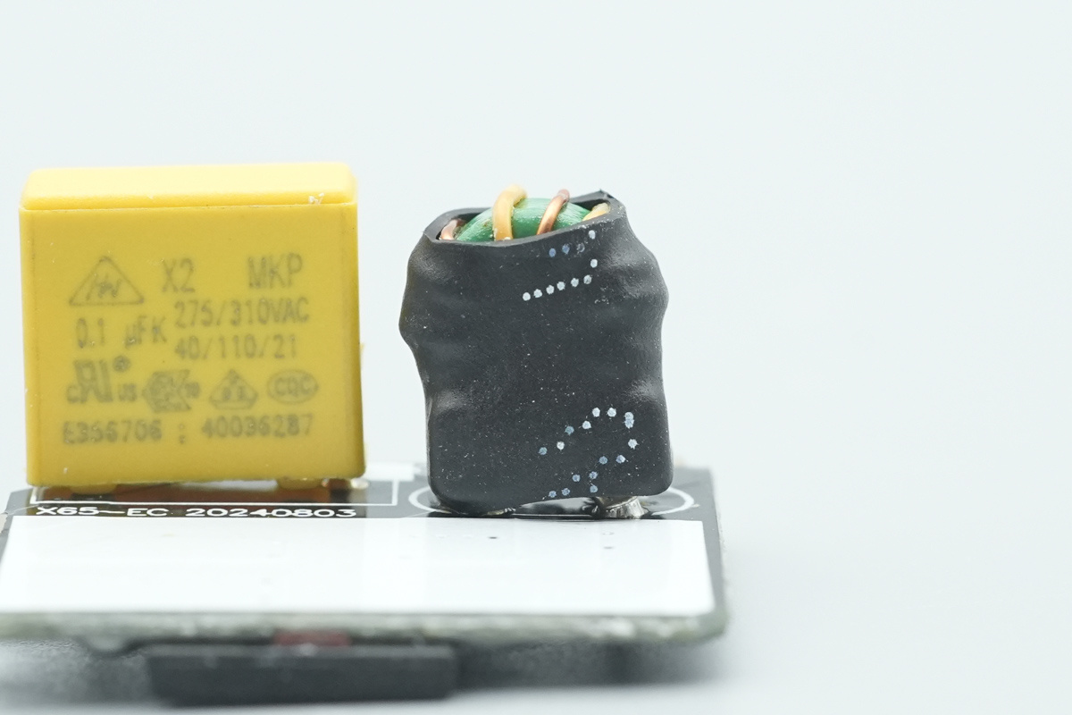

Front view of the input end PCB, it populated with a yellow X2 safety cap and a common-mode choke.

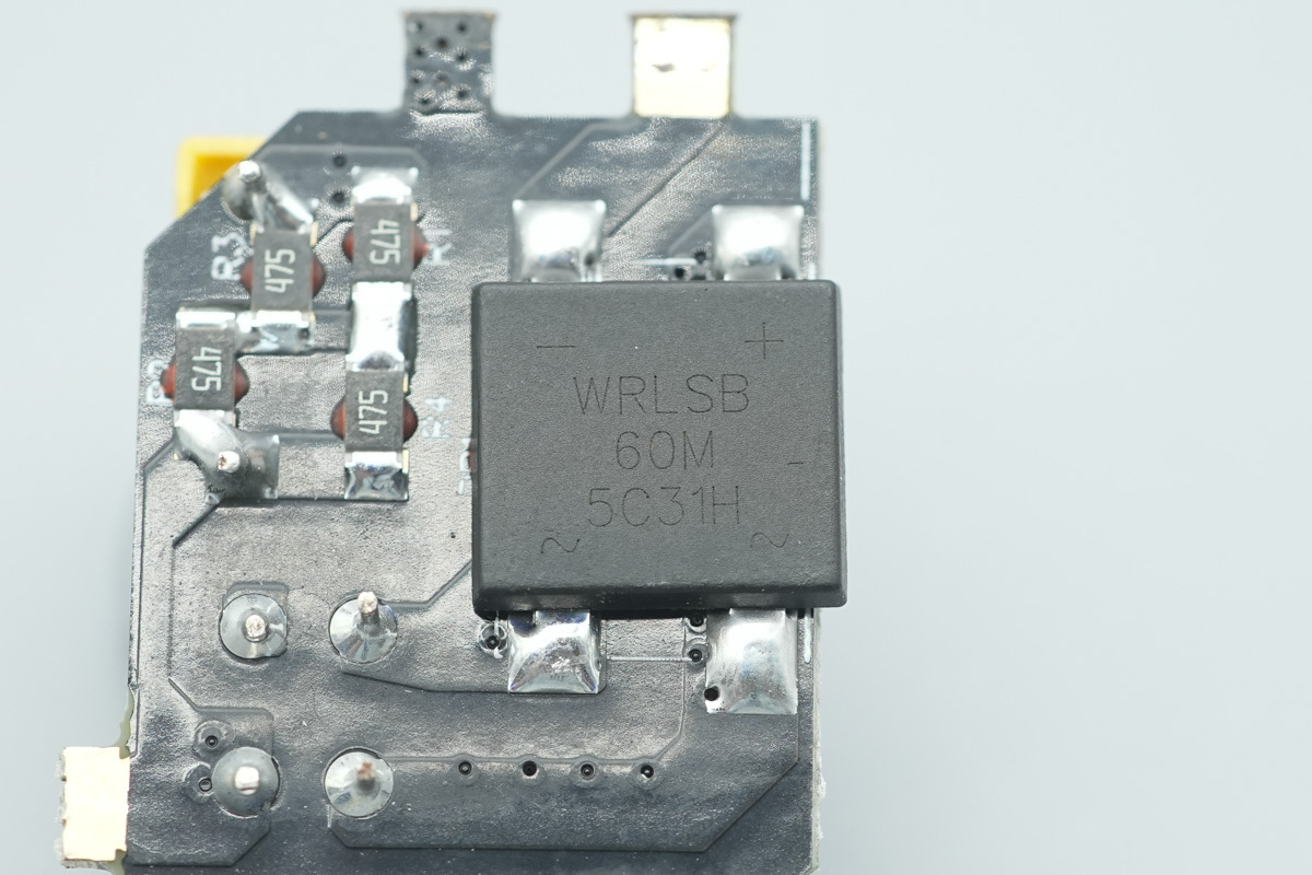

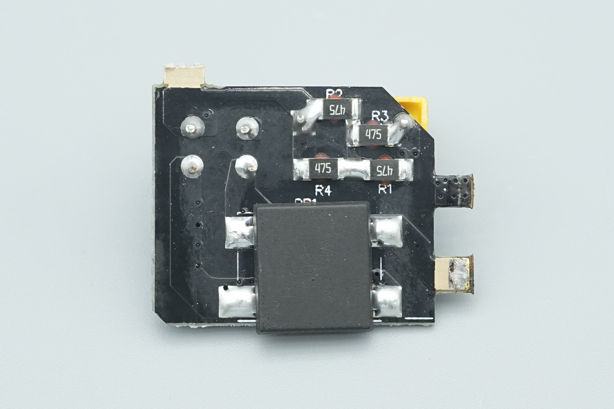

Rear view of the input end PCB, it features a rectifier bridge.
The rectifier bridge is from World, model WRLSB60M, 1000V and in an LSB package. This 'soft bridge' utilizes a soft recovery profile and smooth turn-off characteristics to minimize junction capacitance, effectively reducing harmonic oscillations and EMI noise.
Here is the info about World WRLSB60Mr.

The X2 safety cap, 0.1μF.
The common-mode choke is encapsulated in heat-shrink tubing for electrical insulation and is utilized to filter out EMI.

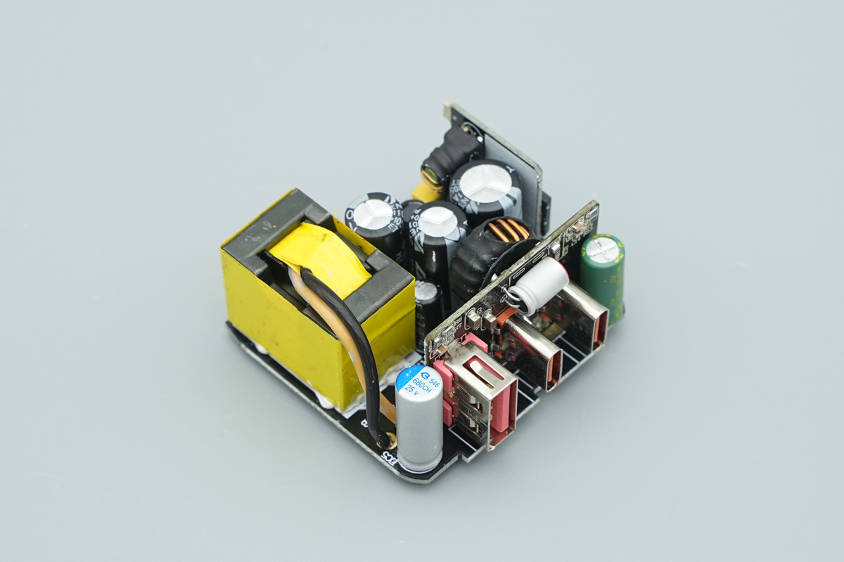

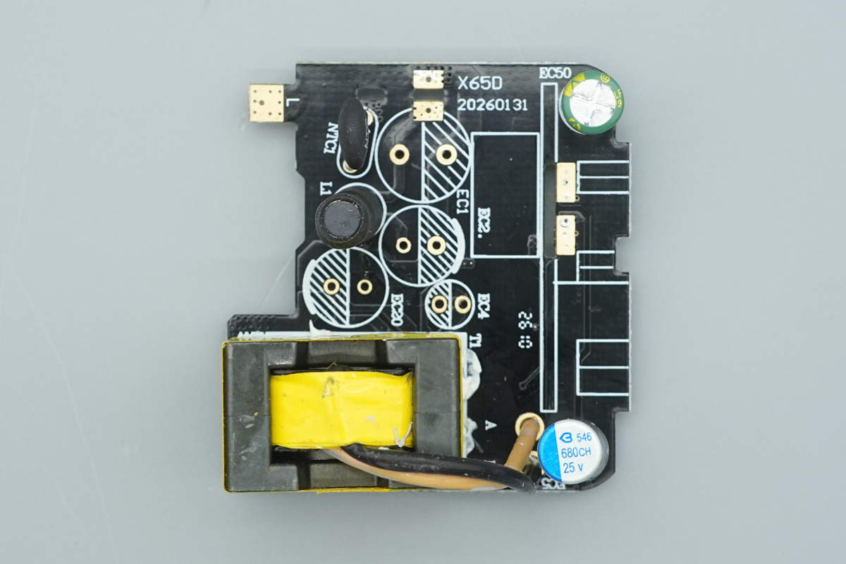

With the PCBs and select caps removed, the mainboard's core layout is revealed, featuring the transformer and two low-voltage output caps.
The high-frequency transformer, featuring yellow insulating tape, marked 'X-65D-GaN BLA 2608'.

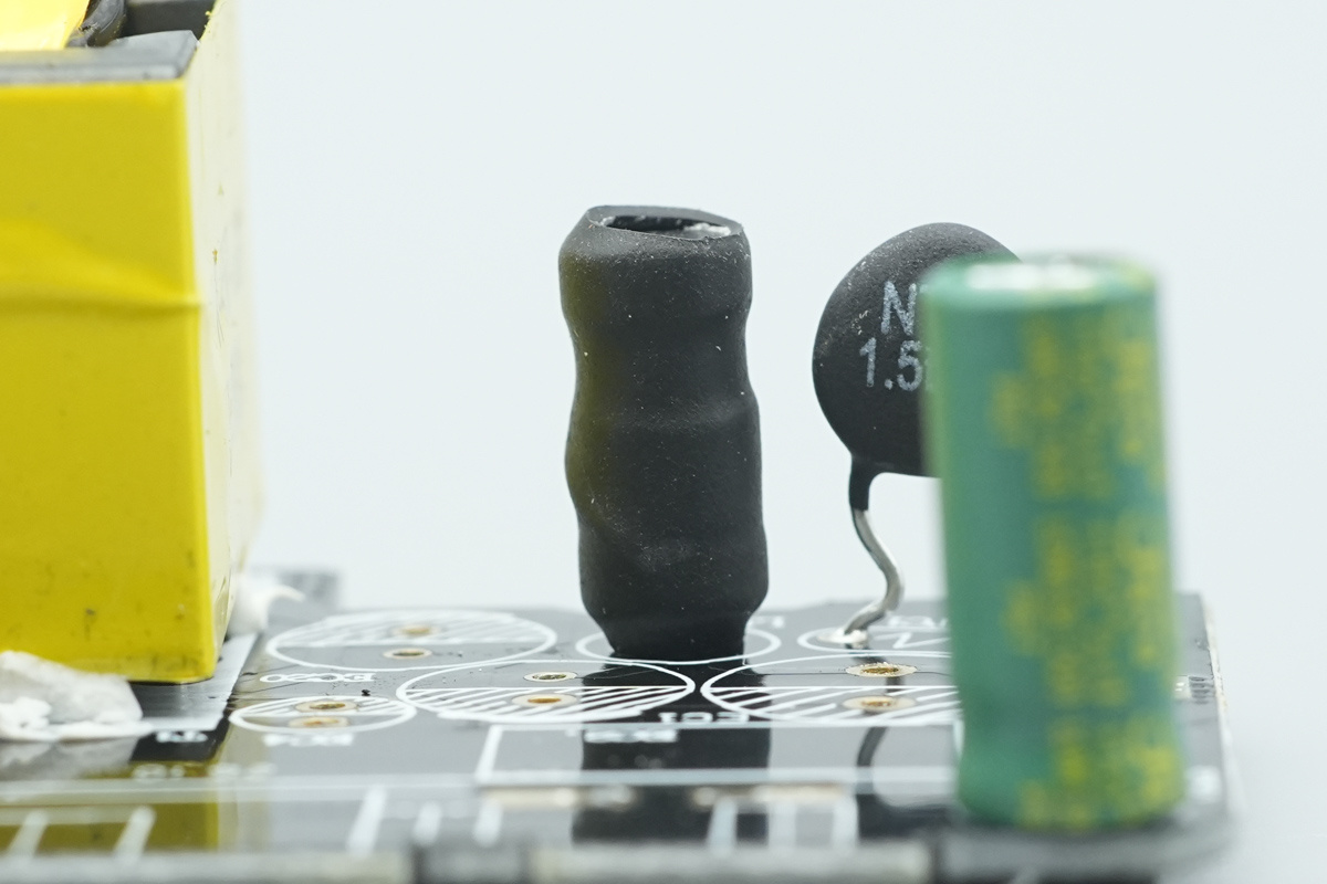

A I-shaped choke sits right next to the transformer.

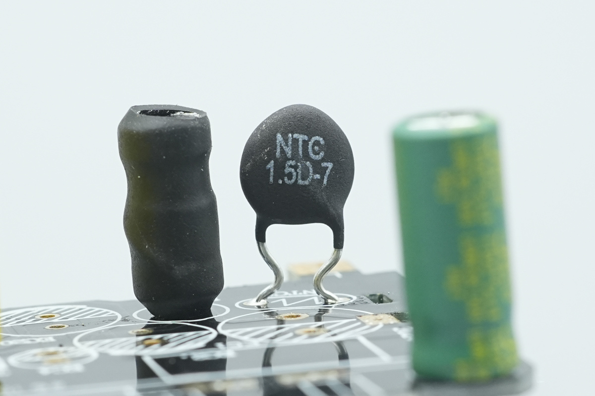

An NTC thermistor, marked 1.5D-7, is utilized to suppress inrush current during the charger's power-on sequence.

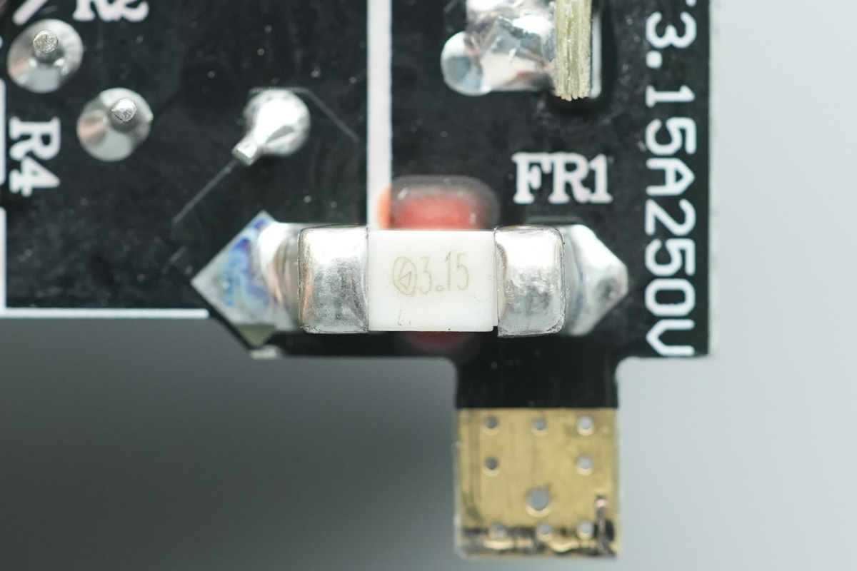

From rear side, it features a time-delay fuse at the input end, provided for OCP.

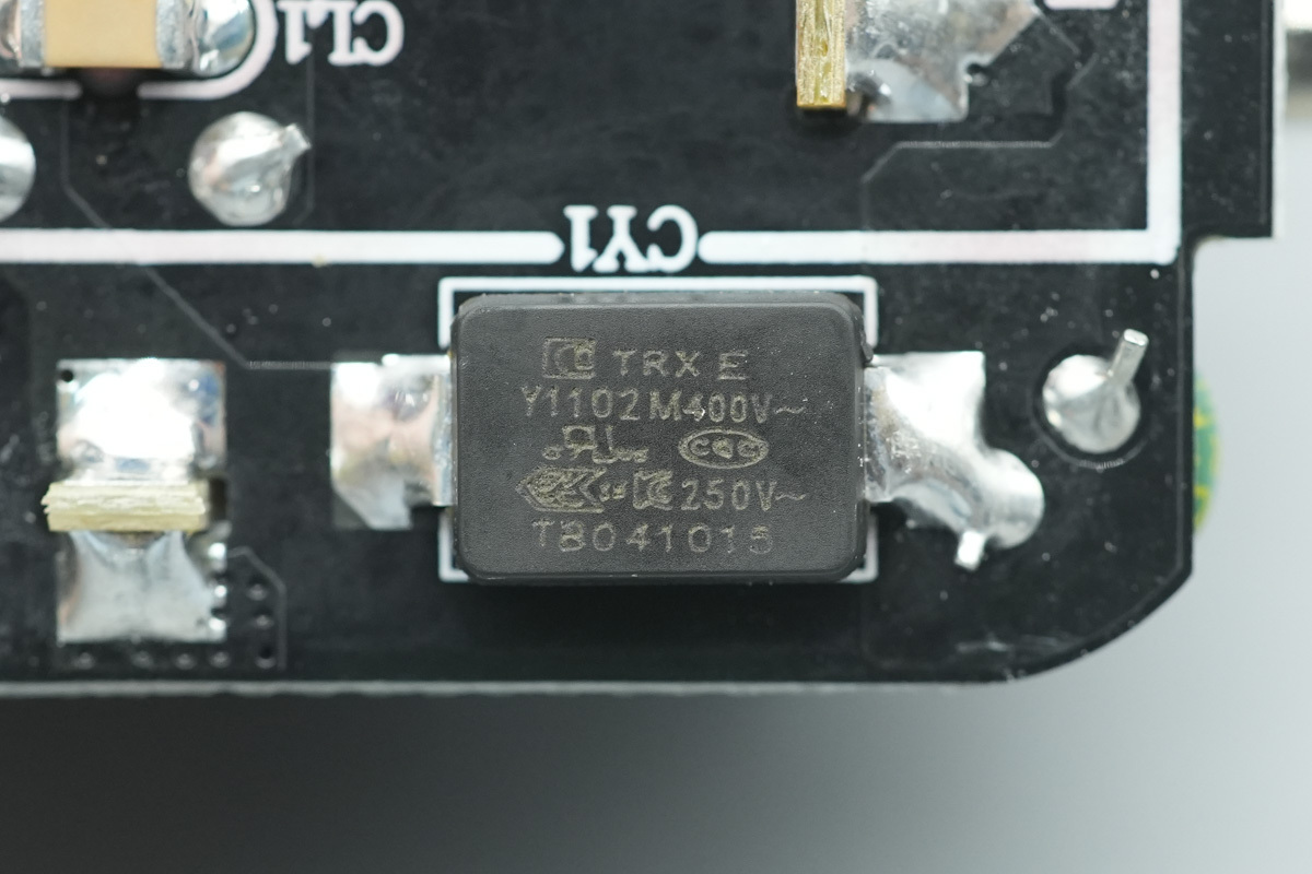

The SMD Y-cap is from TRX, model TMY1102M. Its small, lightweight design makes it an ideal component for maximizing space within the dense architecture of GaN fast chargers.
Here is the info about TRX SMD Y-cap.

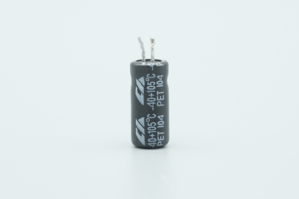

The supply cap for the main master control chip is from CH, 100V 4.7μF.

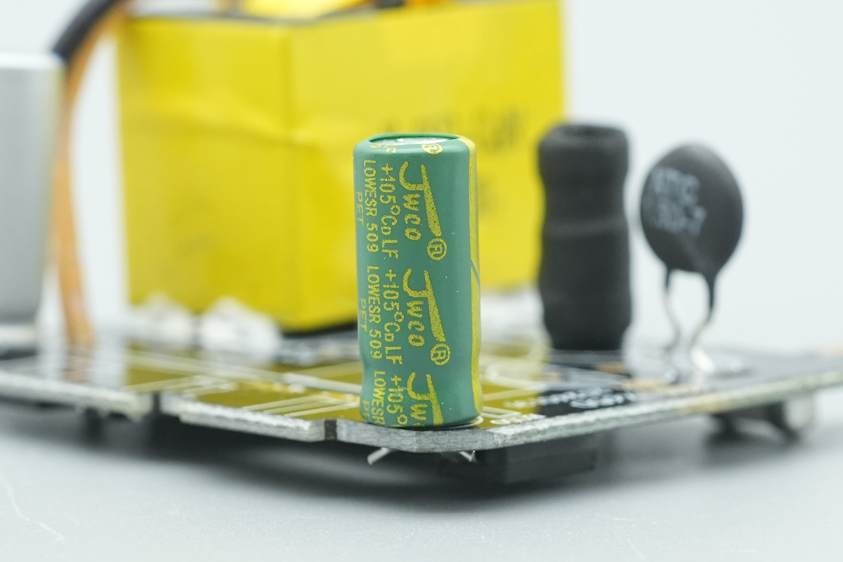

An additional aluminum electrolytic cap is from Jwco, 25V 330μF.

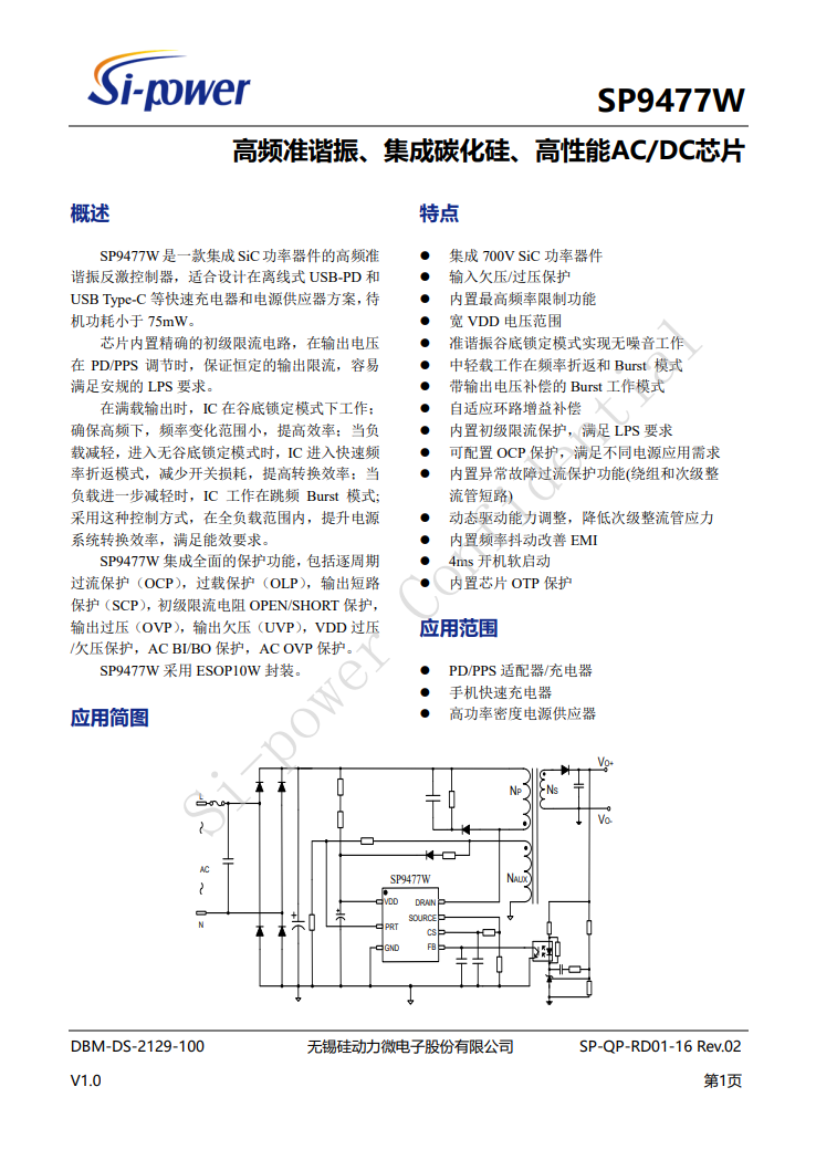

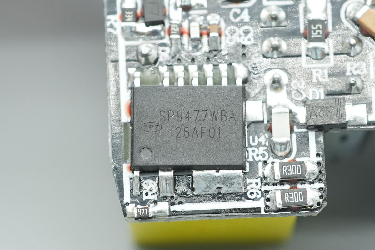

The SiC co-packaged chip is from SPT, model SP9477W, located on the rear of the mainboard,
It is specifically engineered for fast charging and adapter applications, integrating a 700V SiC power device and utilizing high-frequency QR technology to provide a high-performance solution for USB-PD and Type-C chargers.
The SP9477W simplifies design by integrating a 700V SiC power device. Its QR technology ensures silent operation, while intelligent switching to frequency-foldback and Burst modes boosts efficiency during light loads.
From input under/over-voltage protection to primary current limiting and thermal safety, the SP9477W offers all-around reliability. It also features dynamic drive adjustment to protect secondary rectifiers.
With integrated frequency jittering to tackle EMI and an ESOP10W heat-enhanced package, it is engineered for high performance and cooler operation.

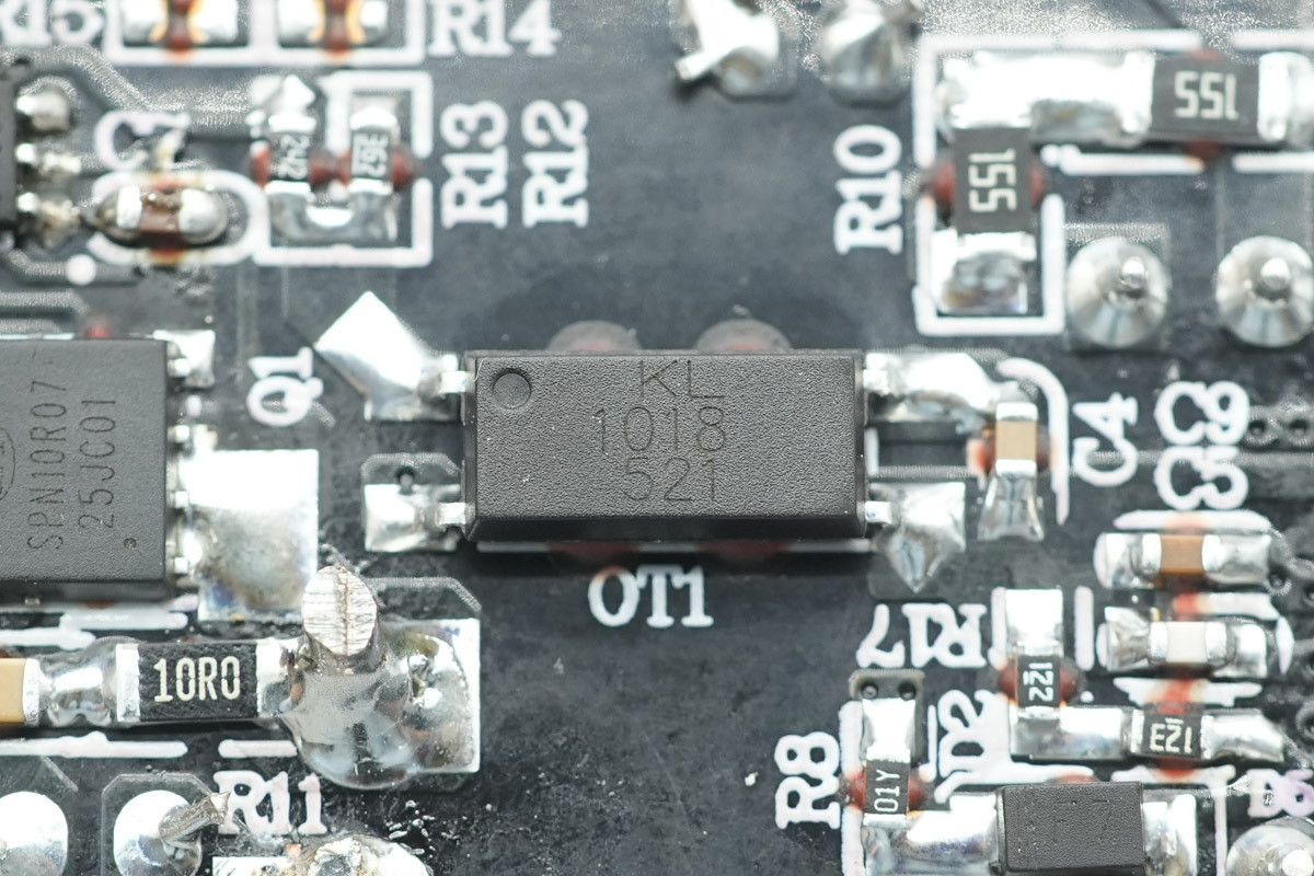

The optocoupler bridging the primary and secondary sides is from Kinglight, model KL1018.

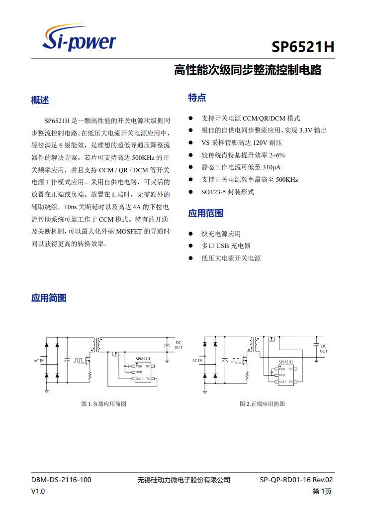

The synchronous rectifier controller is from SPT, model SP6521H, housed in an SOT23-5 package. Designed for high-current, low-voltage power conversion, it is a dedicated secondary-side synchronous rectifier controller to maximize efficiency.
With support for 500kHz switching and adaptive CCM/QR/DCM operation, it optimizes power conversion. Its smart self-supply design helps boost efficiency by 2–6% versus Schottky alternatives, keeping the design well within the requirements of Level VI efficiency.
It features an ultra-fast turn-off delay of 10ns and a robust 4A pull-down current, ensuring reliable performance in CCM operation. With a low quiescent current of 310μA, it is optimized for low-voltage, high-current applications, including fast-charging adapters and multi-port USB chargers.

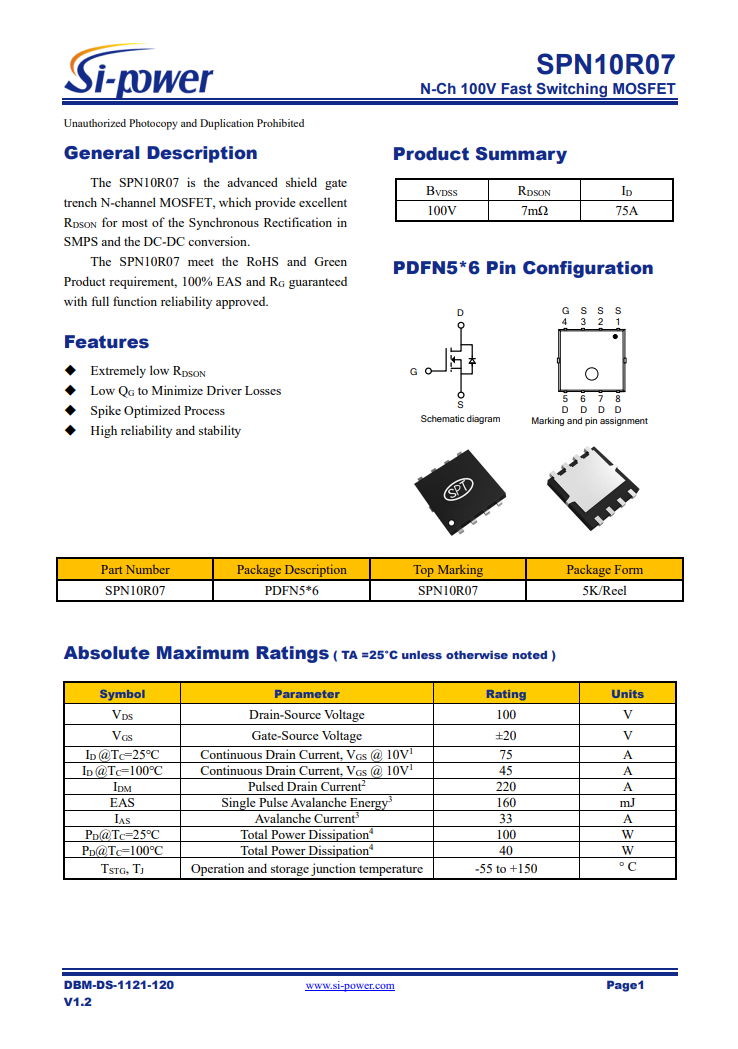

The synchronous rectifier MOSFET is from SPT, model SPN10R07, NMOS 100V and 7mΩ, in a PDFN5x6 package.
Here is the info about SPT SPN10R07.

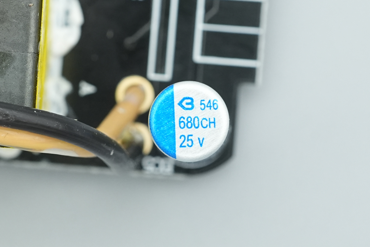

A blue solid filter cap is from BERYL , 25V 680μF.
The output end step-down PCB features two USB-C ports and one USB-A port on its top side, accompanied by a solid filter cap.
The rear of the output end PCB houses the protocol chip alongside a magnetic-core step-down choke, wrapped in heat-shrink tubing, for multi-port secondary voltage regulation.

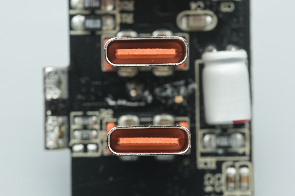

These are two USB-C ports, both featuring the orange plastic sheets within the internal architecture.

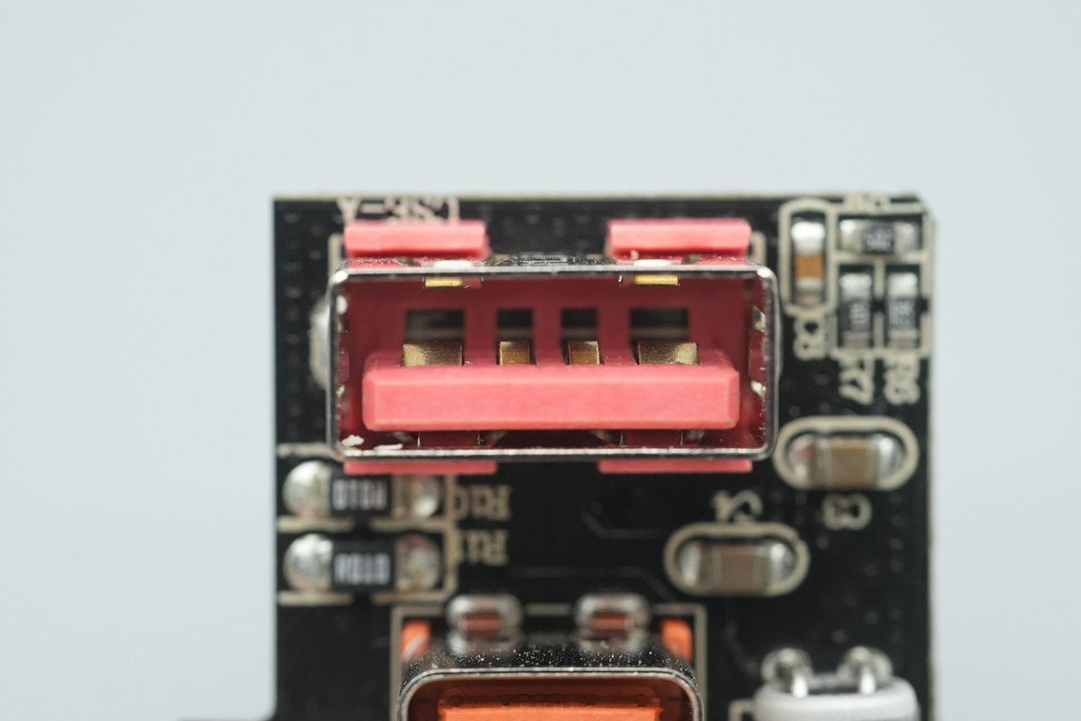

The USB-A receptacle features reinforced, widened power pins to ensure minimal contact resistance and facilitate high-current delivery for fast charging.

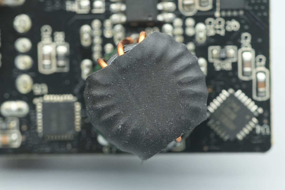

The step-down magnetic choke, with heat-shrink tubing for insulation and protection.

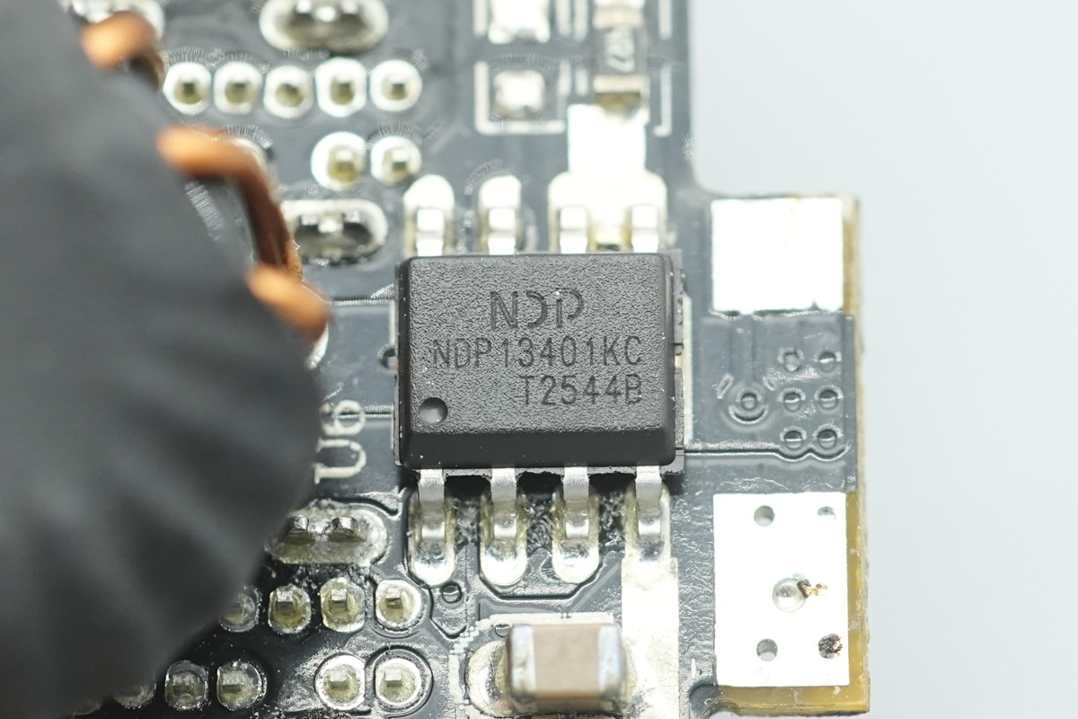

The synchronous step-down chip is from NDP, model NDP13401KC, featuring constant-frequency, average-current mode control. It is housed in an SOP8 package.

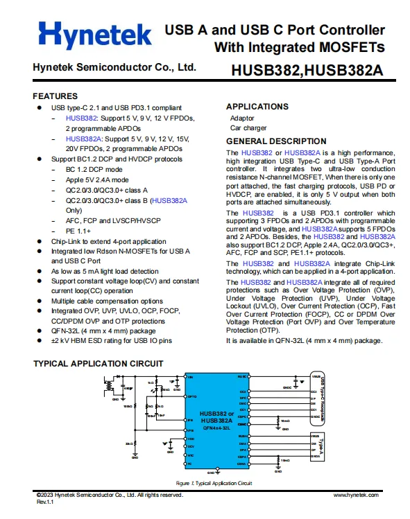

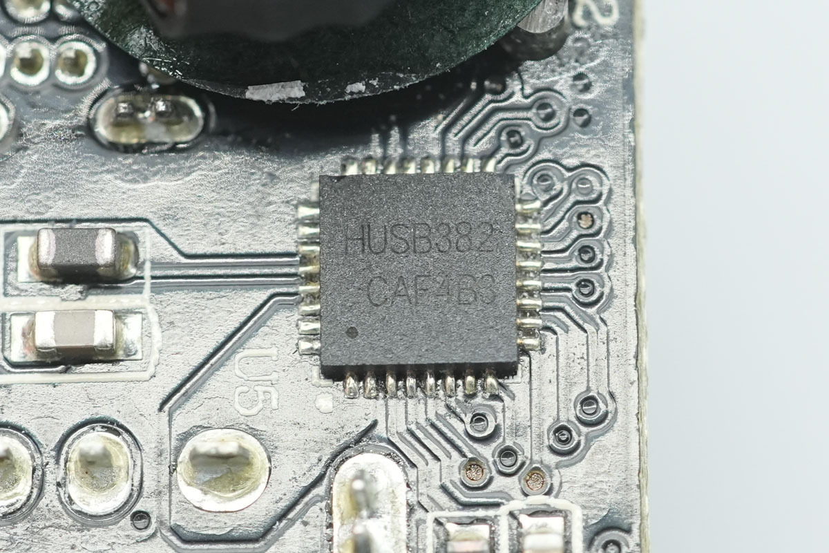

The protocol chip for USB-C2 and USB-A is from Hynetek, model HUSB382. This high-performance, highly integrated chip features built-in VBUS MOSFETs, which simplifies the peripheral circuit design by eliminating the need for external power path management.
The HUSB382 integrates a comprehensive protection suite, including OVP, UVP, UVLO, OCP, FOCP, CC/DPDM pin OVP and TSD. Housed in a QFN4x4-32L package, it is specifically optimized for compact multi-port fast chargers and automotive charging applications.

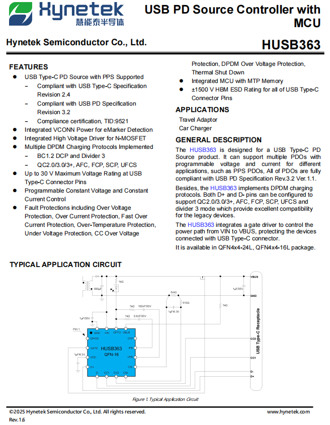

The protocol chip for the USB-C1 port is from Hynetek, model HUSB363. It supports multiple programmable PDOs, allowing for dynamic voltage and current configuration to meet diverse application requirements, including full support for PPS PDOs
All PDOs are fully compliant with the USB PD 3.2 spec. Furthermore, it integrates DPDM charging protocols, allowing the D+ and D- pins to be configured for support of QC2.0, QC3.0, AFC, FCP, and Divider 3 modes, ensuring robust backward compatibility for legacy devices.
It features an integrated gate driver for secure VIN-to-VBUS power delivery, plus high-voltage tolerance across all critical signal pins (CC1/CC2/D+/D-), creating a multi-layered shield that keeps connected devices protected against electrical surges.
