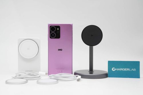

As the first Android phone to pass Qi2 wireless charging certification, the wireless charging performance of HMD Skyline is still unknown. We can also see that it supports Qi2 wireless charging on the HMD official website. ChargerLAB will conduct a wireless charging test on it below.

HMD Skyline supports Qi2 15W wireless charging. We will use multiple wireless chargers for testing to see how compatible it is.
