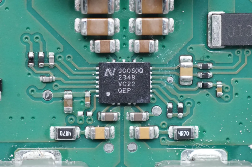

NuVolta SN90050Q
The SN90050Q is an advanced automotive-grade wireless power transmitter chip designed by NuVolta Semiconductor. It features a wide input voltage range of 3V to 27V and can withstand transient voltages up to 35V, delivering a maximum output power of 50W. This chip adopts a full-bridge architecture, integrating four 12mΩ low-Rdson power MOSFETs and an optimized low-EMI gate driver circuit to enhance system efficiency.
NuVolta Introduces the 50W Automotive-Grade Wireless Power Transmitter Chip SN90050Q, Enhancing the In-Car Charging Experience-Chargerlab
The SN90050Q also incorporates a high-precision input current sensing circuit with ±1% accuracy, supporting Foreign Object Detection (FOD). It features adaptive dead-time control, a 5V LDO voltage regulator, and an I2C interface, allowing for multi-channel charging address configuration. Moreover, it integrates multiple protection mechanisms, including input undervoltage/overvoltage protection, overcurrent protection, short-circuit protection, and over-temperature protection. The chip also provides real-time fault indication via an open-drain INT pin.
To meet the stringent FOD requirements of the Qi Extended Power Profile (EPP) standard, the SN90050Q includes a current-sensing amplifier with adjustable gain. By working with an external current-sensing resistor, it enables precise monitoring of input power loss.
Having successfully passed ESD tests, the SN90050Q also supports external VCC operation mode, reducing internal LDO power consumption. The chip achieves an efficiency of 90% at 15W output and maintains above 85% efficiency even at full 50W load. It is available in a compact QFN21 package and is suitable for WPC Qi EPP-compliant wireless charging transmitters, automotive 15-50W wireless charging systems, high-end industrial applications, and motor drivers.
NuVolta Semiconductor's SN90050Q chip provides a solid hardware foundation for wireless charging systems, thanks to its wide input voltage range, high 50W power output capability, and exceptional power conversion efficiency. Featuring an integrated full-bridge architecture, low-Rdson MOSFETs, low-EMI drivers, and high-precision current sensing, this chip ensures stable operation even under high loads. Additionally, its compliance with stringent automotive-grade standards and safety protection features highlights its advanced design and reliability.
From a professional perspective, the SN90050Q is a comprehensive solution tailored for high-end NEVs and industrial applications. With its multiple built-in protection mechanisms and flexible system configuration, it significantly reduces external design complexity and system costs. By offering high efficiency and intelligent monitoring capabilities, this chip is set to drive the adoption and advancement of wireless charging technology in automotive, industrial, and motor drive applications.
