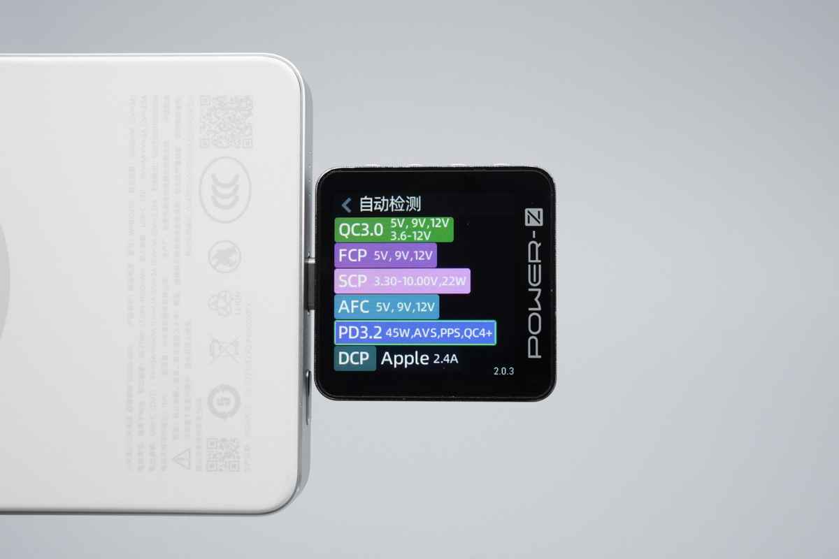

The protocol detection feature of the POWER-Z KM003C tester has been successfully adapted for the Xiaomi UltraThin 10000mAh Power Bank. It can accurately identify the power bank’s supported fast-charging protocols, delivering stable compatibility and complete, reliable protocol data.
Also Read: Xiaomi UltraThin Series Upgrades Its Slim Profile with ATL Battery Tech
ChargerLAB POWER-Z Reveals the Fast-Charging Protocols of the Xiaomi UltraThin 10000mAh Power Bank-Chargerlab
Testing shows that the USB-C port supports QC3.0/4+, FCP, SCP, AFC, PD3.2, AVS, PPS, DCP, and Apple 2.4A charging protocols. It also supports Xiaomi’s proprietary 45W HyperCharge technology.

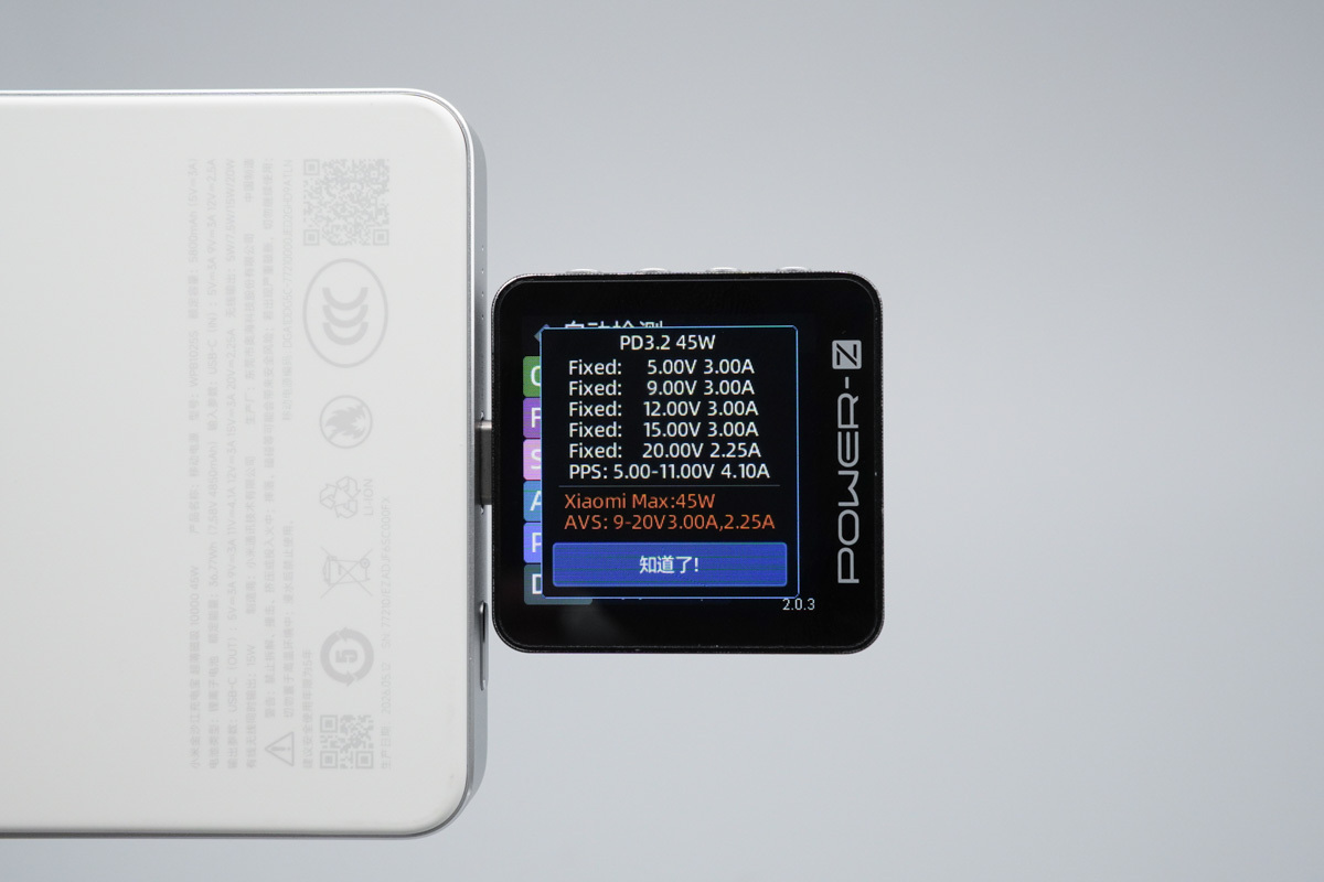

In terms of PDOs, testing confirms support for five fixed profiles: 5V/3A, 9V/3A, 12V/3A, 15V/3A, and 20V/2.25A. The power bank also supports 45W Xiaomi HyperCharge, along with the PPS fast-charging range of 5–11V/4.1A and AVS ranges of 9–20V at up to 3A and 2.25A.
