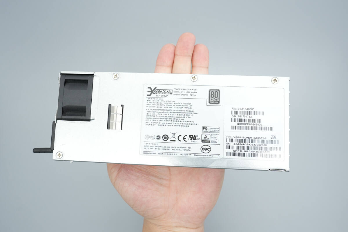

It uses a metal casing with an information label attached.
Teardown of 3Y POWER 1600W SiC Server Power Supply (YSEF1600EM)-Chargerlab
Model: YSEF1600EM
Input: 100–120V AC, 50–60Hz, 13A
DC Output: 1000W MAX: +12.2V / 81A, +12Vsb / 2A
Input: 200–240V AC, 50–60Hz, 10A or 190–310V DC, 10A
DC Output: 1600W MAX: +12.2V / 130A, +12Vsb / 2A

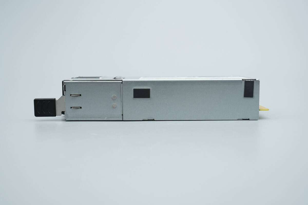

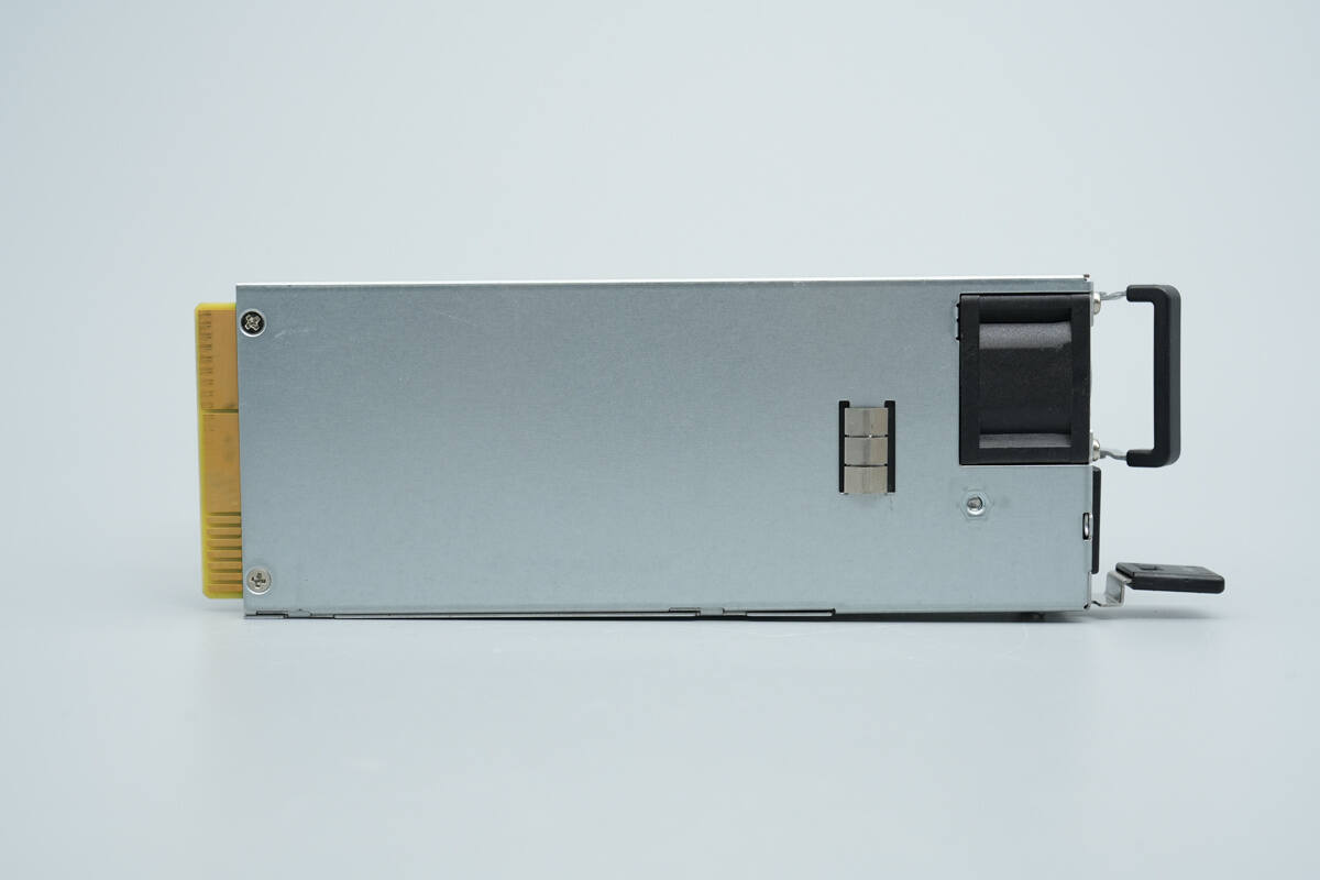

There is a locking latch on the side.

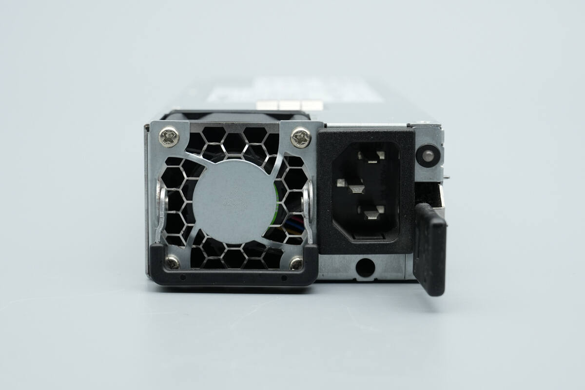

The input side is equipped with a cooling fan, input socket, locking handle, and power indicator light.

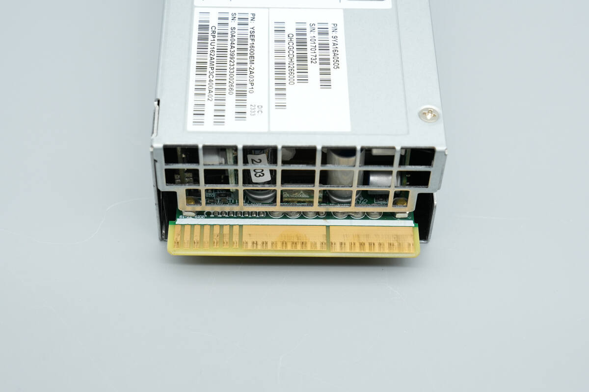

The output side is equipped with a protective grille and gold-finger connector.

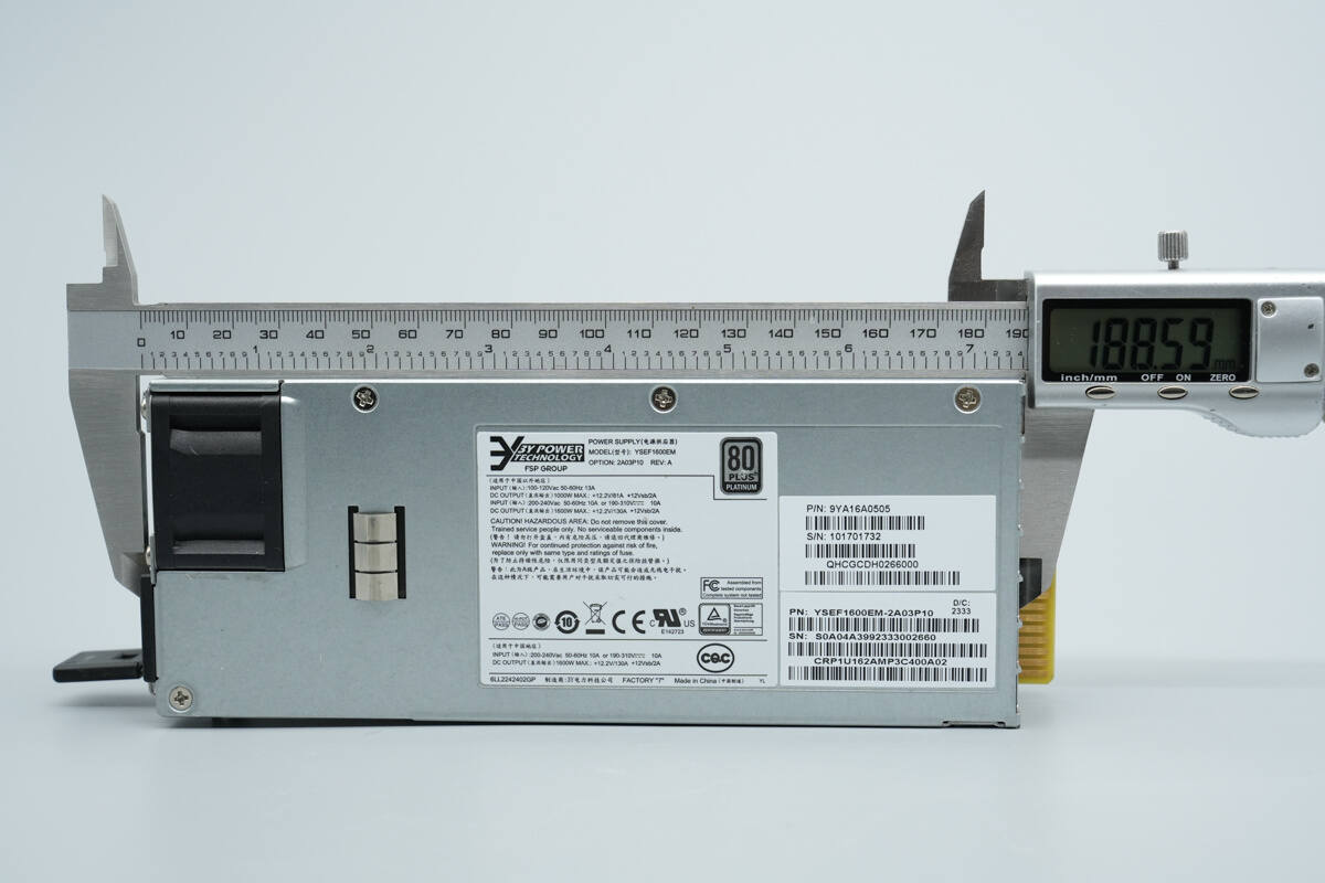

The length of the module is about 188.6 mm (7.43 inches).

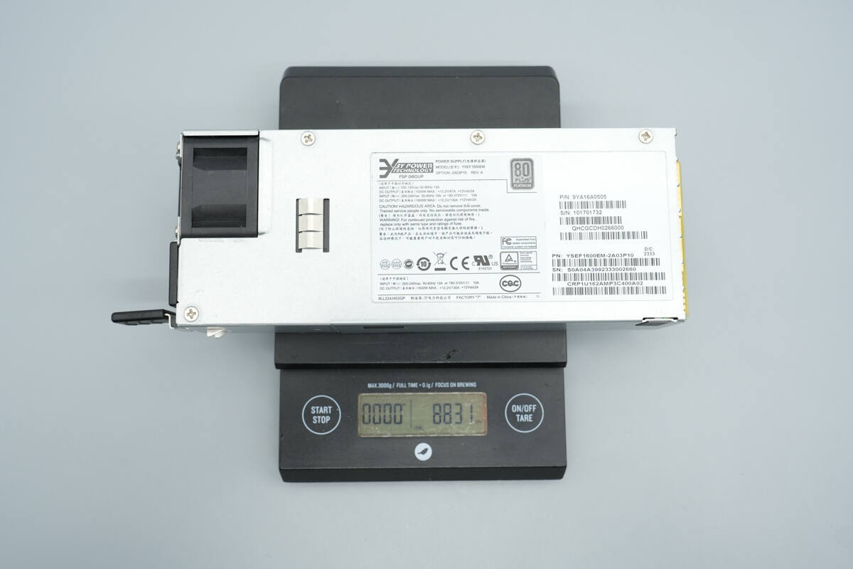

The weight is about 883 g (31.15 oz).

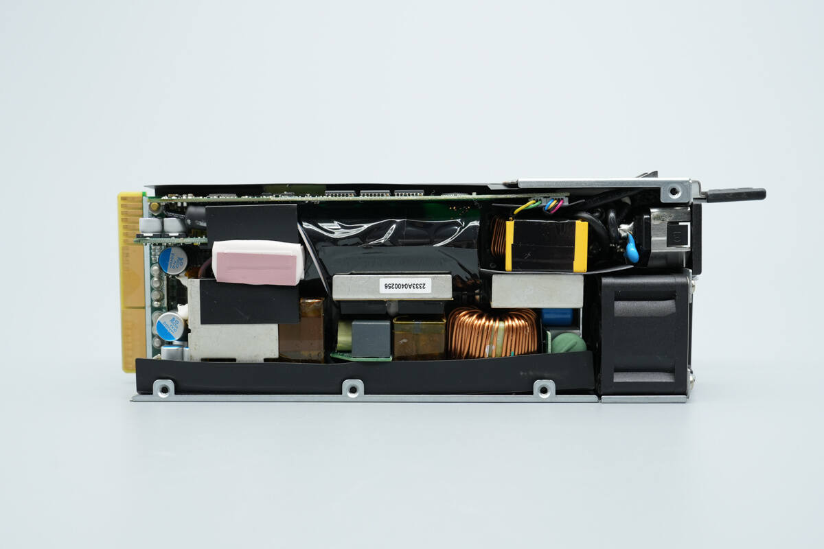

The front side of the PCBA module features components such as a fuse, Y-capacitors, a varistor, a common mode choke, a safety X2 capacitor, a bridge rectifier, a relay, a PTC resistor, a PFC boost inductor, a resonant inductor, and resonant capacitors.

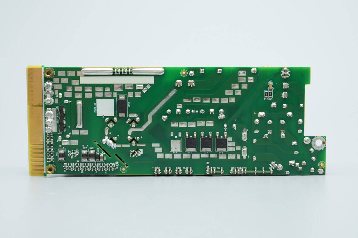

The back side features PFC rectifiers, an SMD Y-capacitor, and output control MOSFETs.

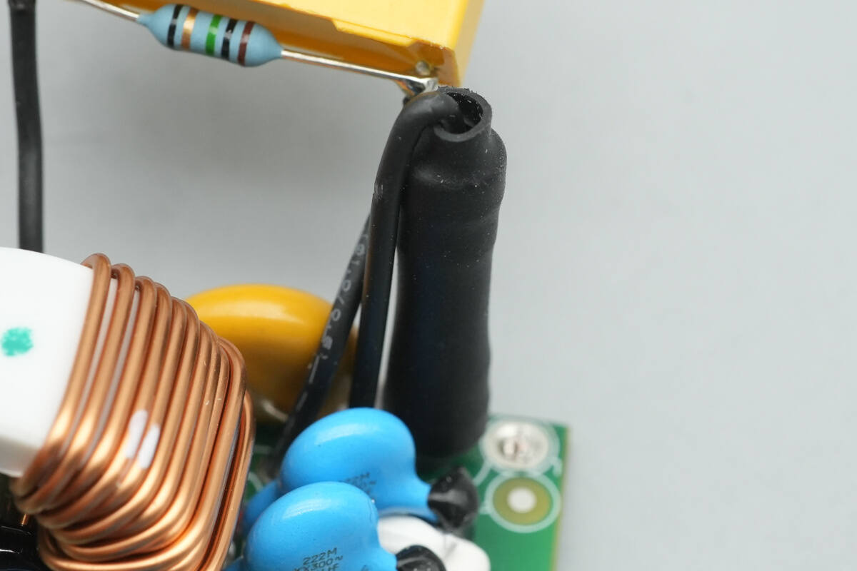

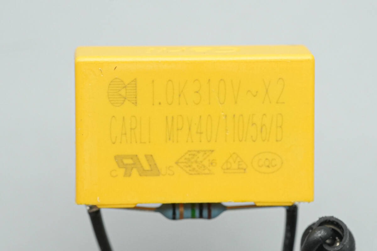

The safety X2 capacitor is from Carli, with a specification of 1 μF.
The blue Y-capacitors are from MURATA, part number 222M.

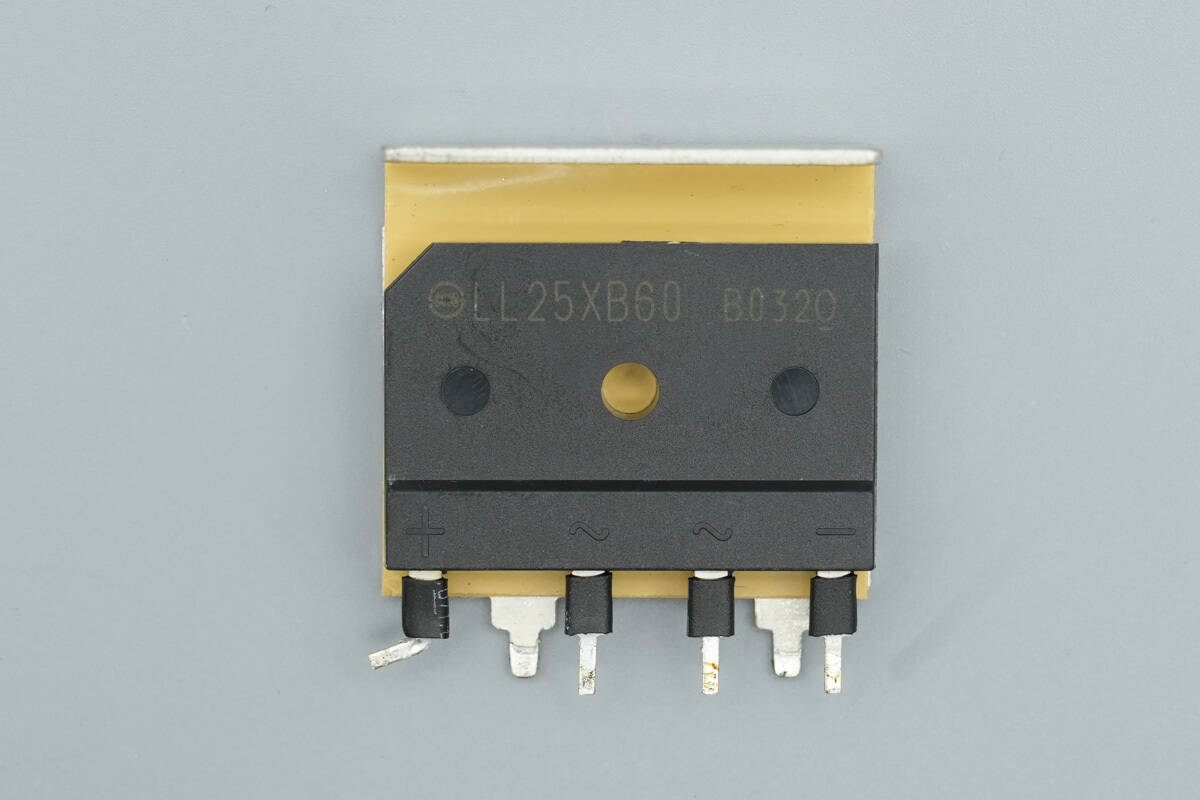

The bridge rectifier is from Shindengen, model LL25XB60, rated 25A 600V, and uses a 5S package.

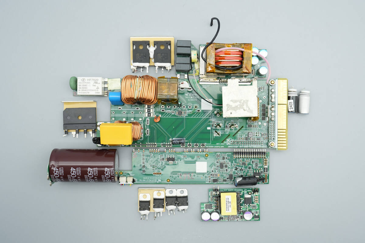

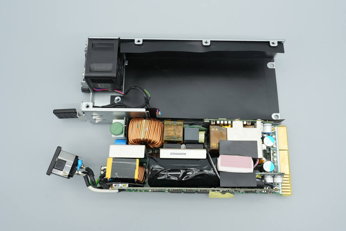

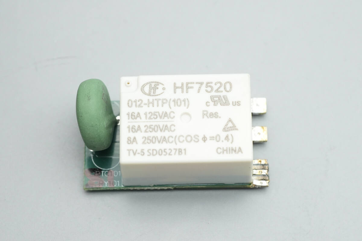

The other side is equipped with a relay, PFC boost inductor, LLC resonant capacitors, and a synchronous rectification PCB.

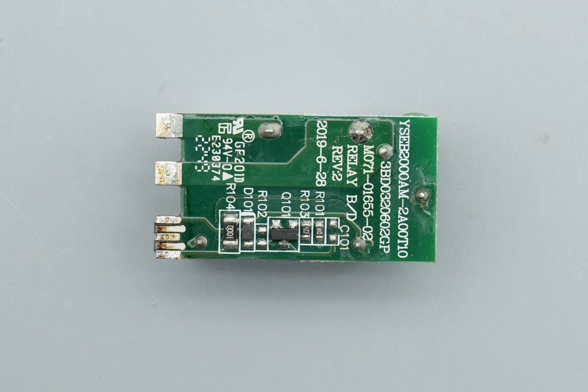

The PTC resistor and relay are soldered onto a separate PCB.
On the back side of the small PCB, there is a driver transistor.

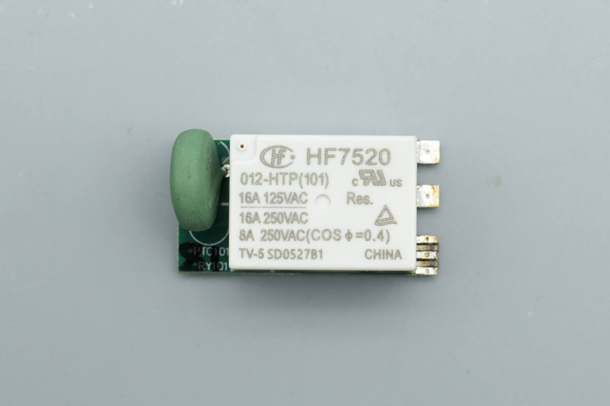

The relay is from HONGFA, model HF7520/012-HTP. It is an ultra-compact high-power relay with a single normally open contact. The contact is a high-load type, rated at 16A 250 VAC, and the coil voltage is 12 V.

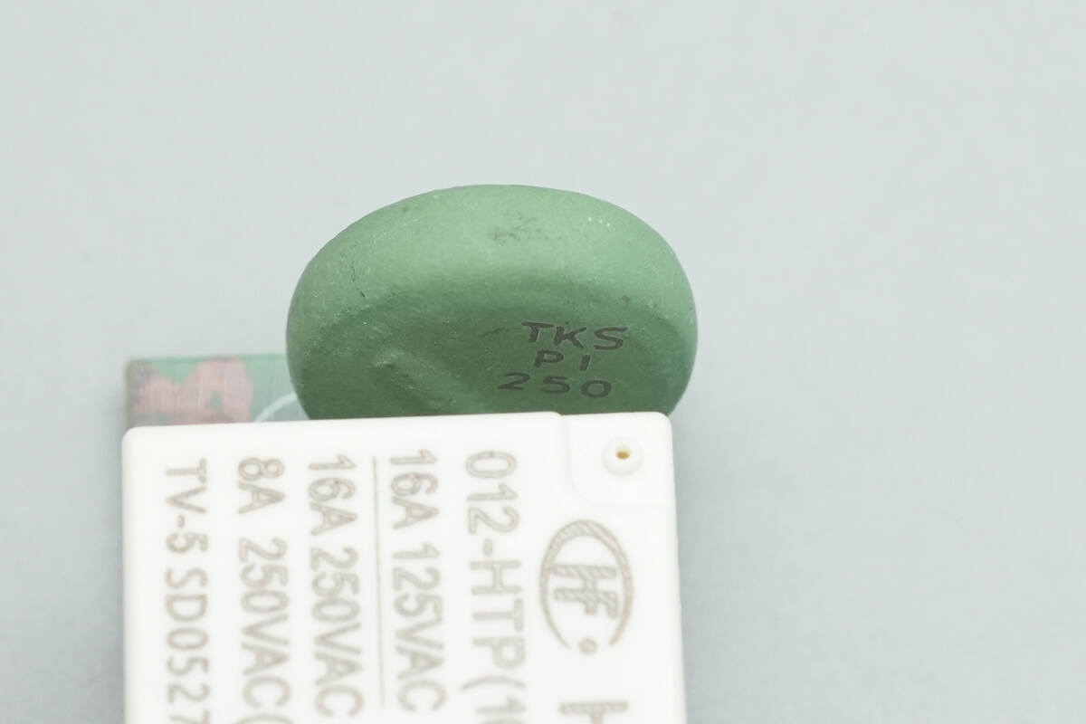

The PTC resistor is from Thinking, marked TKSPI250.

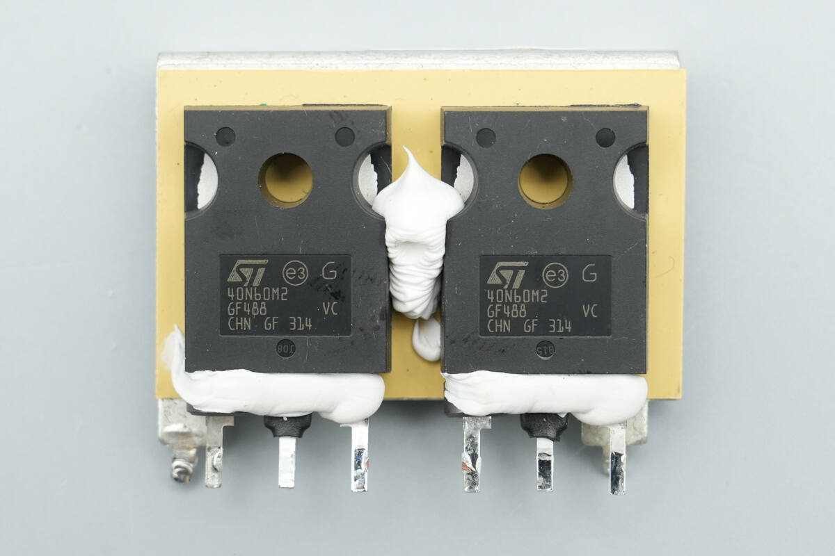

The PFC MOSFETs are from STMicro, model STW40N60M2. They are NMOS devices with a voltage rating of 650 V and an on-resistance of 78 mΩ, housed in a TO-247 package.

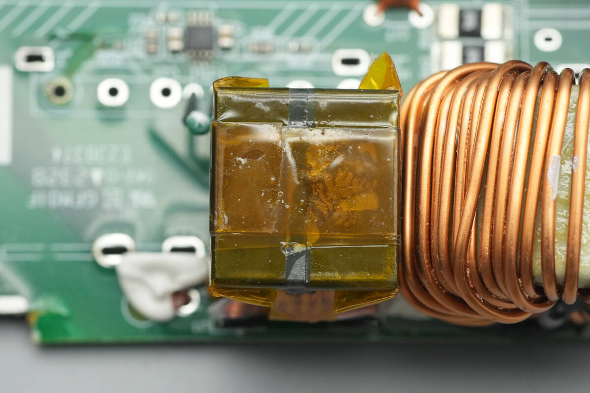

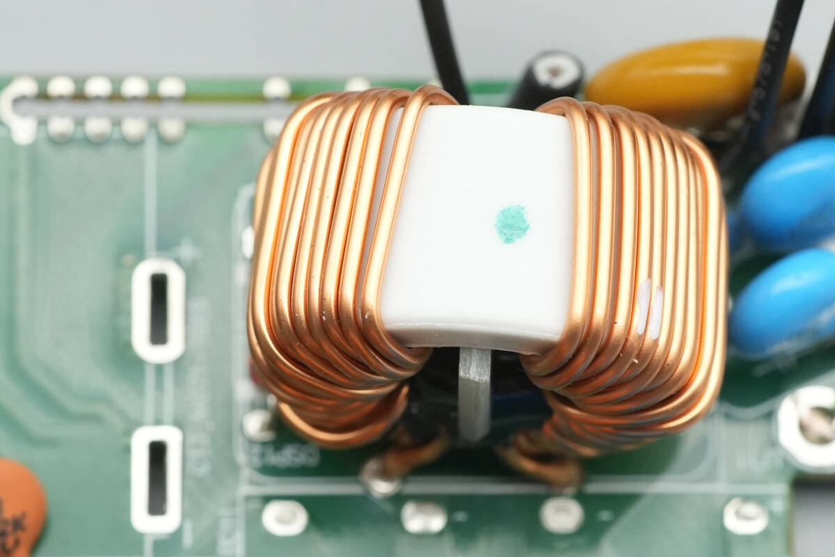

The PFC boost inductor is wound with enameled wire.

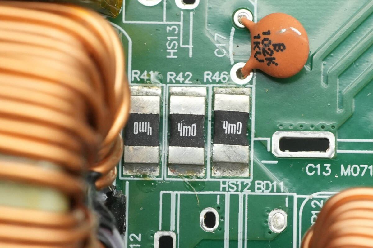

Three 4 mΩ sense resistors are used to monitor the current of the PFC MOSFETs.

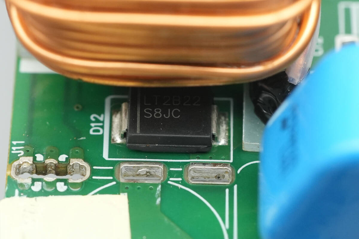

The bypass diode is from LITEON, model S8JC, rated at 600V and 8A, and comes in an SMC package.

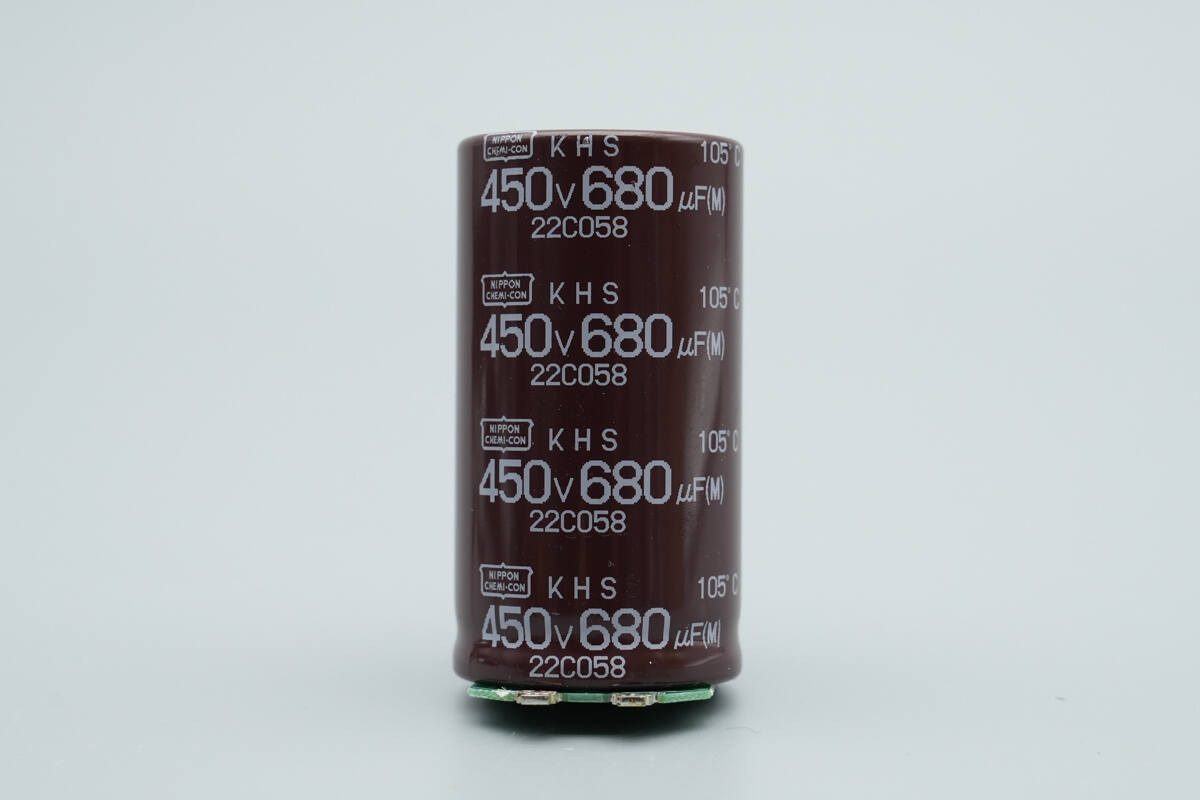

The high-voltage filter capacitor is from NCC, a KHS series self-supporting electrolytic capacitor, rated for 105 °C, with specifications of 450 V and 680 μF.

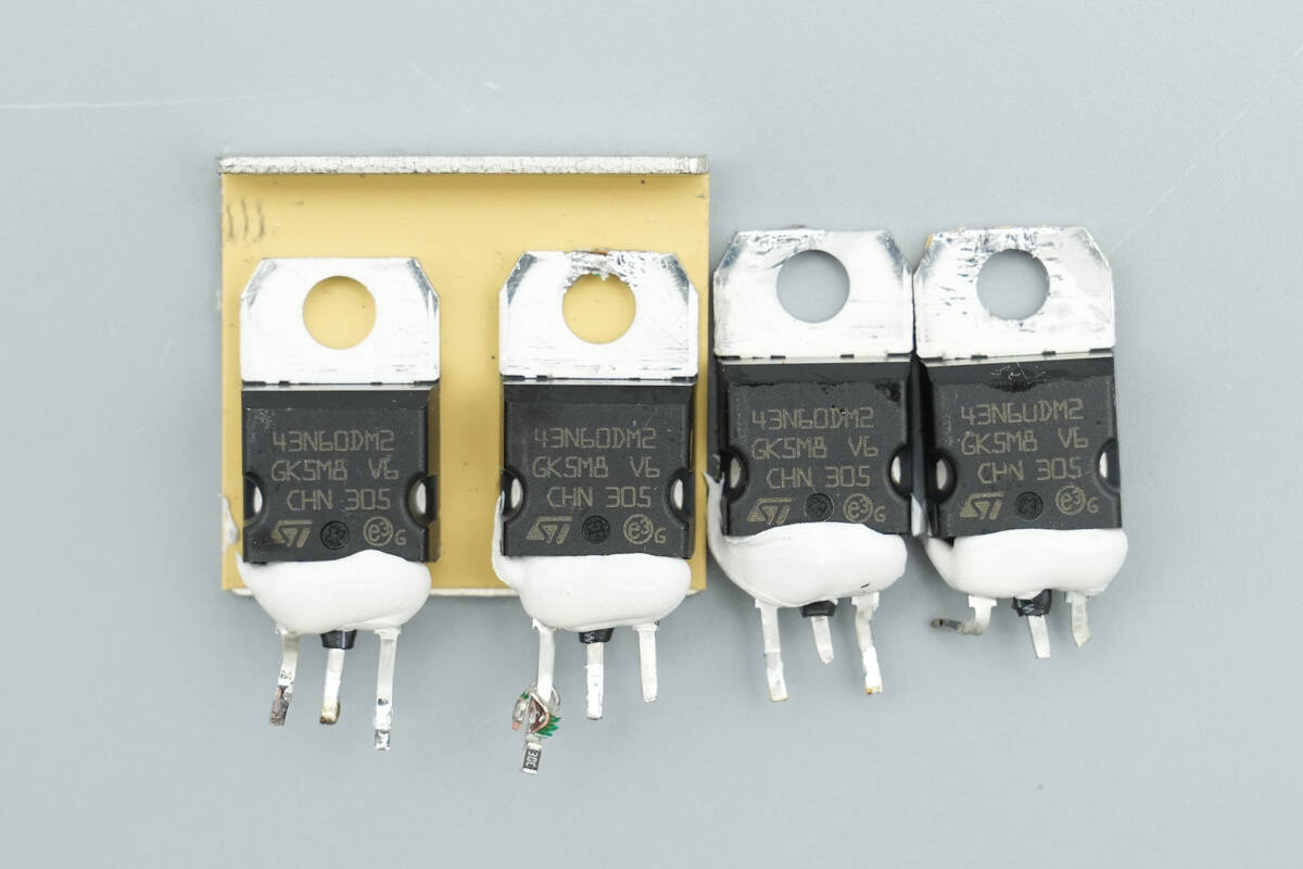

The LLC MOSFETs are from STMicro, model STP43N60DM2, NMOS type, rated at 650 V with an on-resistance of 85 mΩ, and packaged in TO-220.

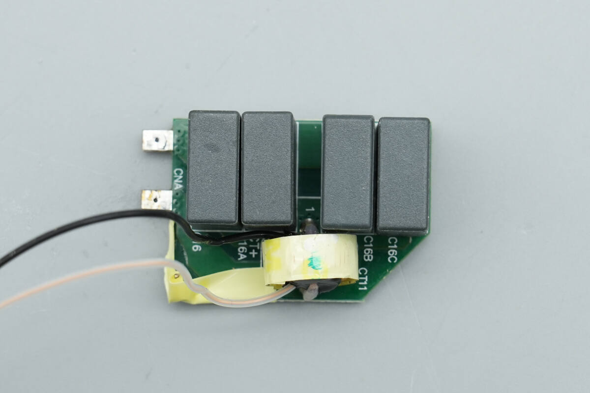

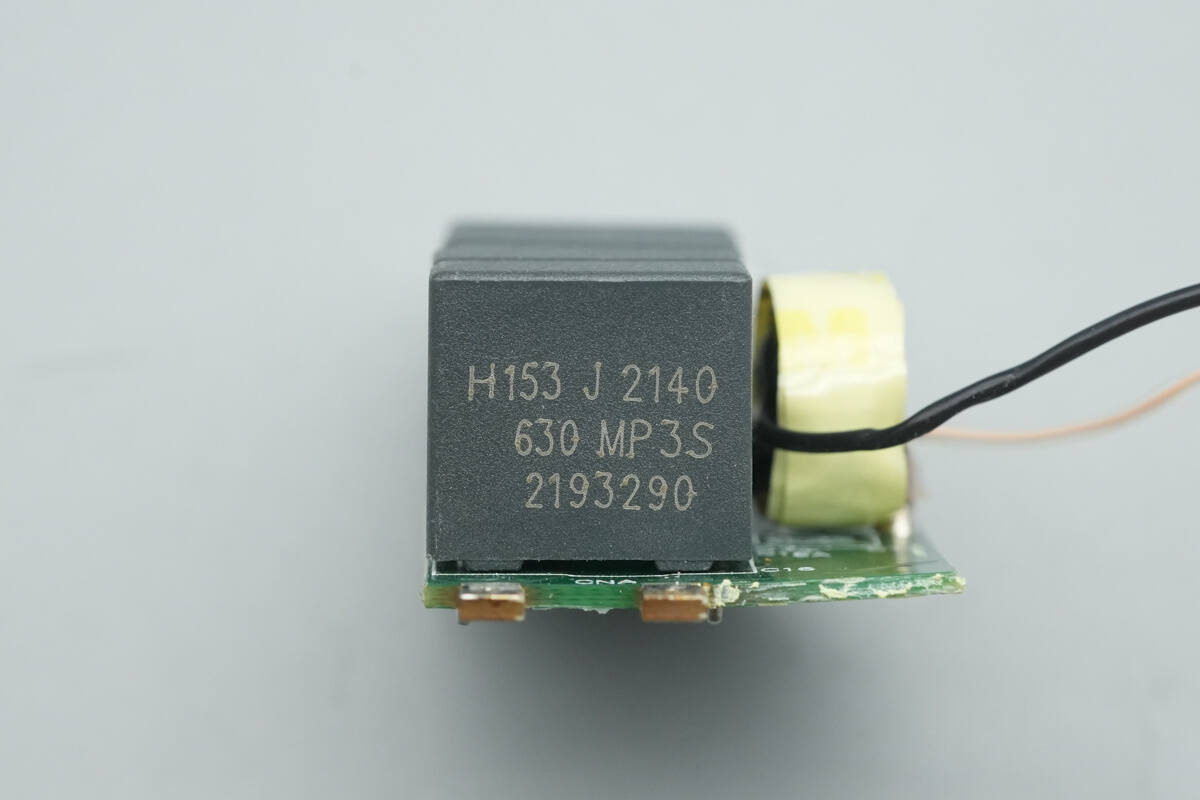

The resonant capacitors and current transformer are soldered onto a dedicated PCB.
There are no components on the backside.
The resonant capacitors are rated at 0.015 μF, 630 V, with four units connected in parallel.
The current transformer is constructed using a toroidal winding.

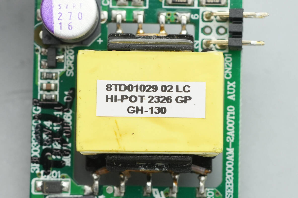

The transformer is soldered onto a vertically mounted PCB, with filter capacitors positioned to the right of the transformer.

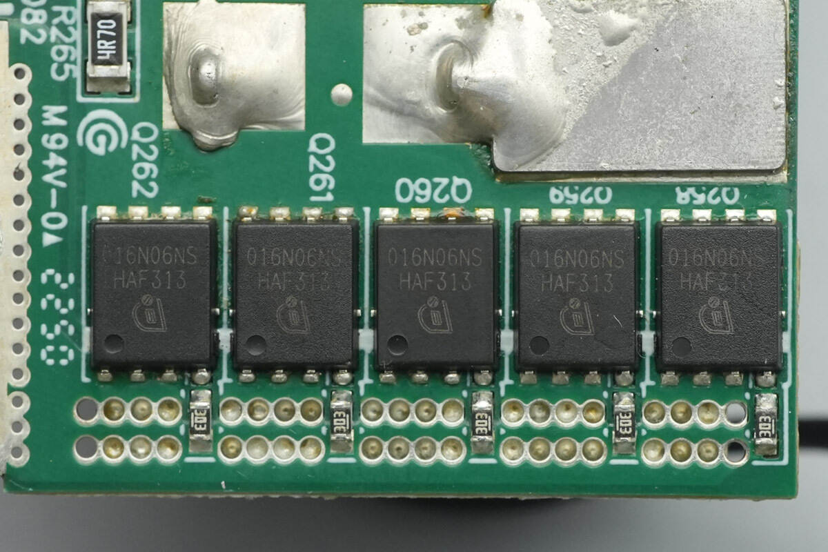

There are two sets of synchronous rectifiers on the backside.
The transformer primary is wound with Litz wire, while the secondary is constructed using soldered copper strips. The magnetic core is tightly wrapped with tape for insulation.

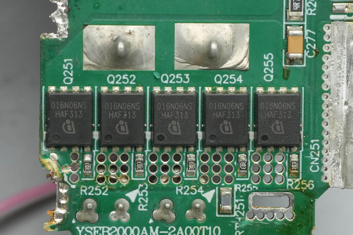

The synchronous rectifiers are from Infineon, model BSC016N06NS, NMOS type, rated at 60 V with an on-resistance of 1.1 mΩ, and packaged in TDSON-8. A thermistor is placed underneath for temperature monitoring.
The other set of synchronous rectifiers is of the same model.

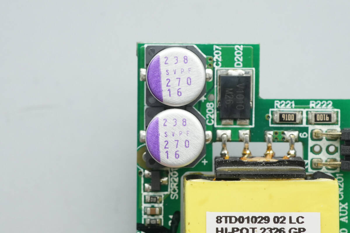

The filter capacitors are from NCC, part of the PSG series of compact, long-life solid-state capacitors, rated at 470 μF and 16 V.
The driver is an Onsemi NCP81071B.
The output filter capacitors are rated at 2200 μF and 16 V.

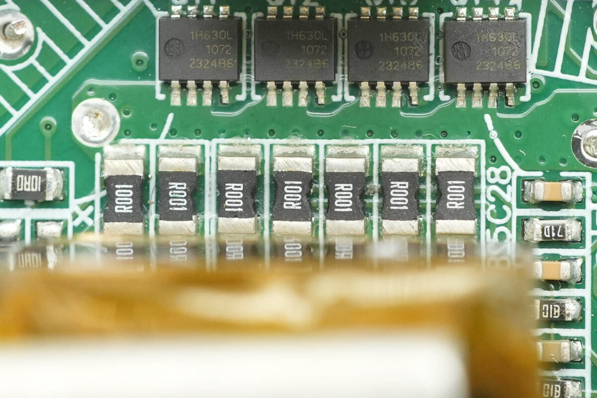

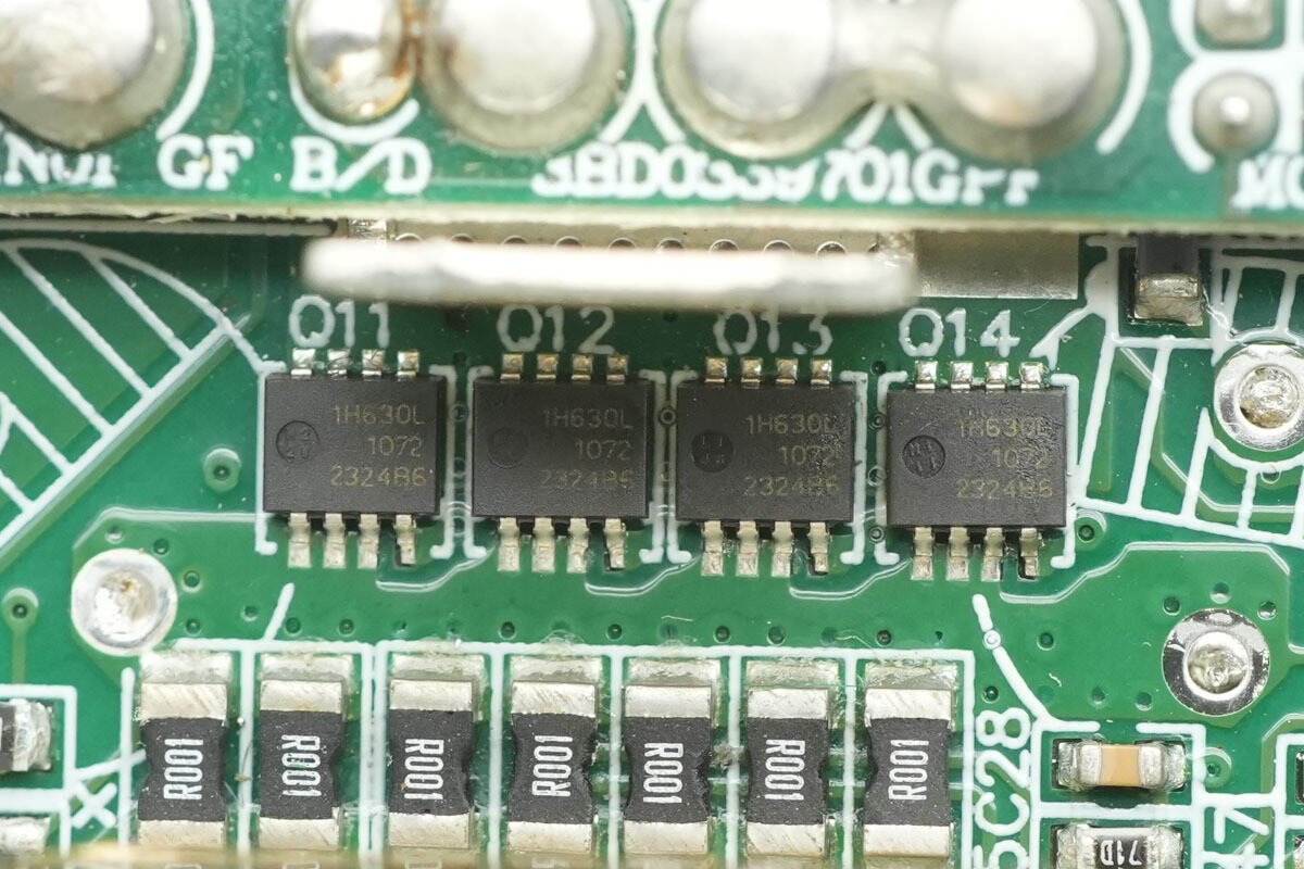

Seven 1 mΩ resistors are connected in parallel for output current sensing.
The Op-Amp is from TI, marked OSUI, model OPA171. It is a 36 V single-supply general-purpose Op-Amp, packaged in SOT-23.
The output control MOSFETs are from Nexperia, marked 1H630L, model PSMN1R6-30MLH, NMOS type, rated at 30 V with an on-resistance of 1.6 mΩ, and packaged in LFPAK33.
On the backside, there are four output control MOSFETs of the same model.

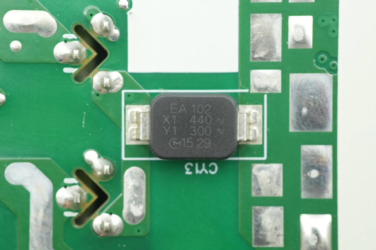

The SMD Y capacitor is from MURATA, part of the DK1 series, with the part number EA102.

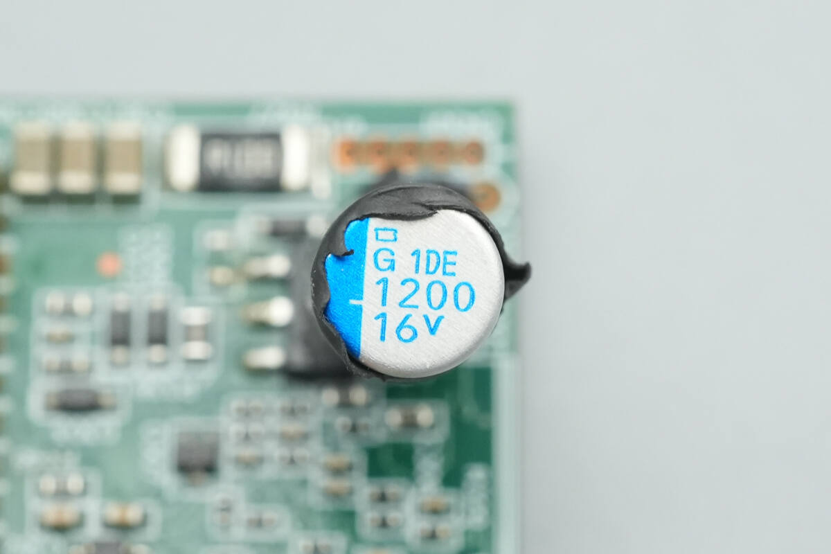

The filter capacitor is from Rubycon, rated at 25 V and 68 μF.

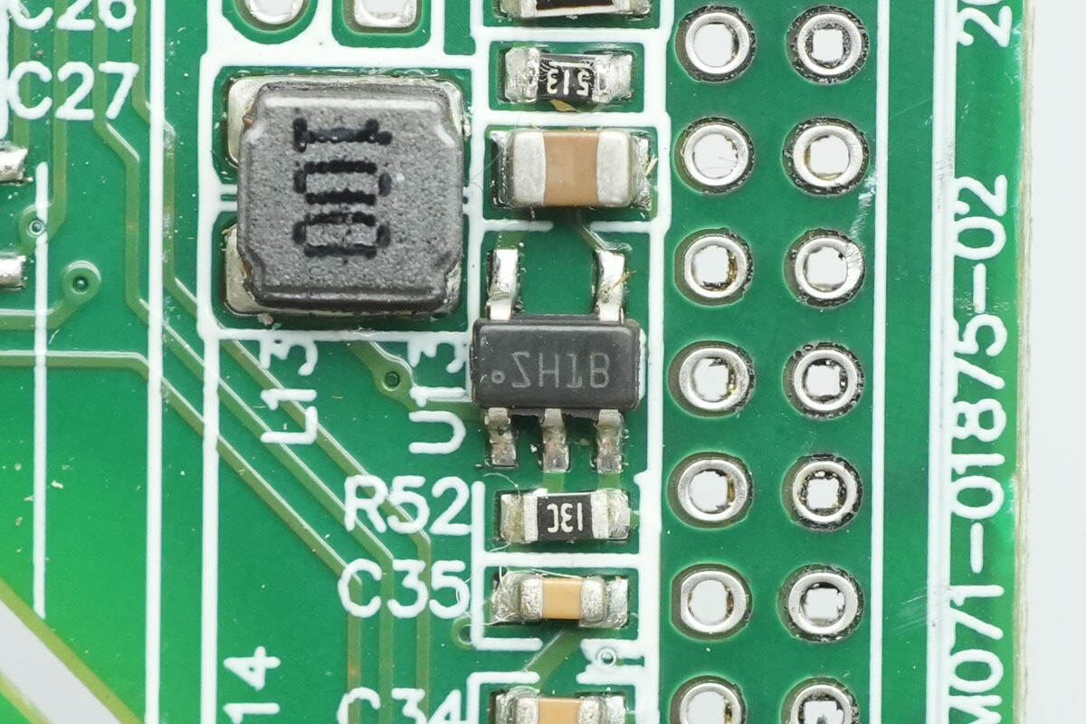

The boost chip is from TI, marked SH1B, model LMR62014. It supports an input voltage of 2.7–14 V and can output up to 20 V. It features an internal MOSFET, supports a switching current of 1.4 A, operates at a switching frequency of 1.6 MHz, and is packaged in SOT-23.
Close-up of the 10 μH boost inductor.

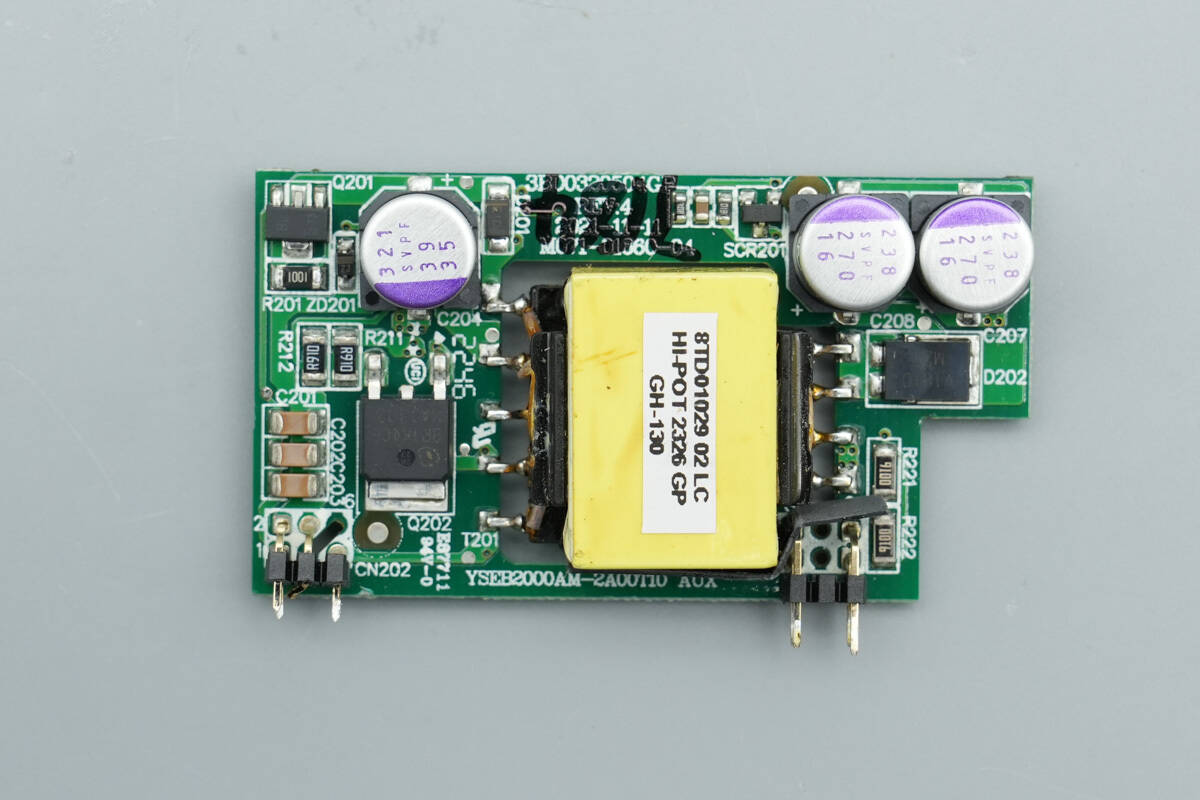

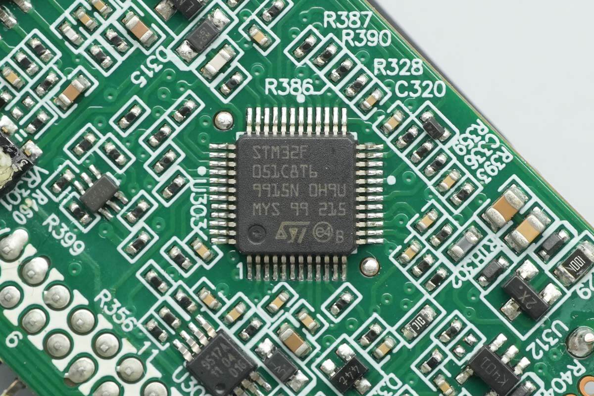

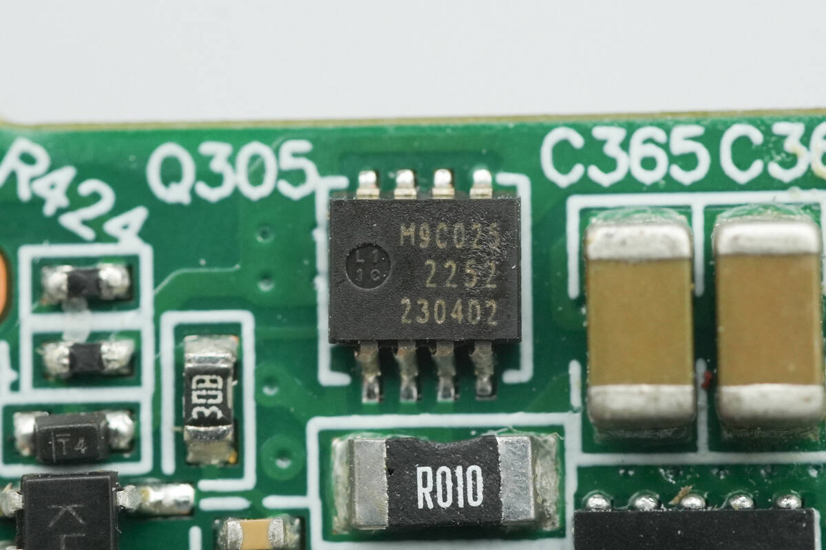

The outer side of the control PCB features a PFC controller, digital isolator, additional digital isolators, an LLC controller, an MCU, a digital isolator, and an electronic fuse.

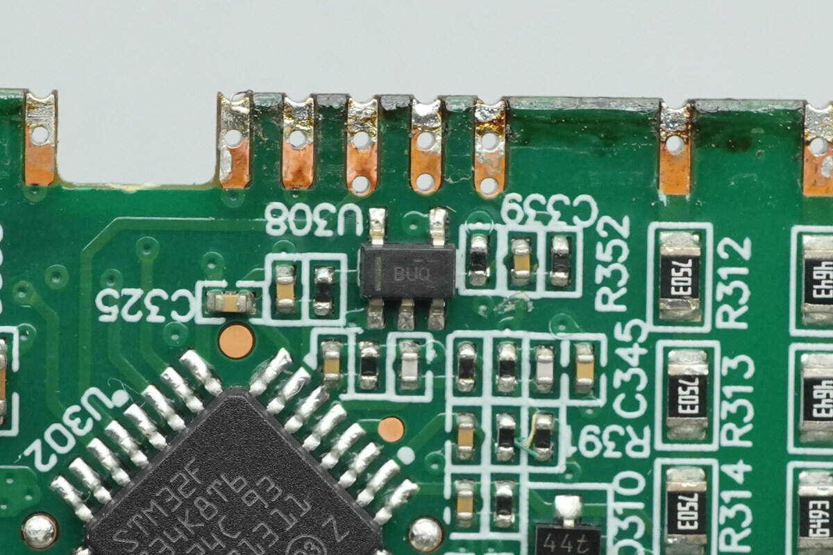

The other side contains regulators, memory, a voltage comparator, and Op-Amps, among other components.

The Op-Amp is from TI, marked BUQ, model OPA376. It is a precision, low-quiescent-current Op-Amp with rail-to-rail input and output, packaged in SOT-23.

The MCU is from STMicro, model STM32F051C8T6. It features an ARM Cortex-M0 CPU running at 48 MHz, with 64 KB of Flash memory and 8 KB of SRAM. It supports motion control and CEC functions, and is packaged in LQFP48.

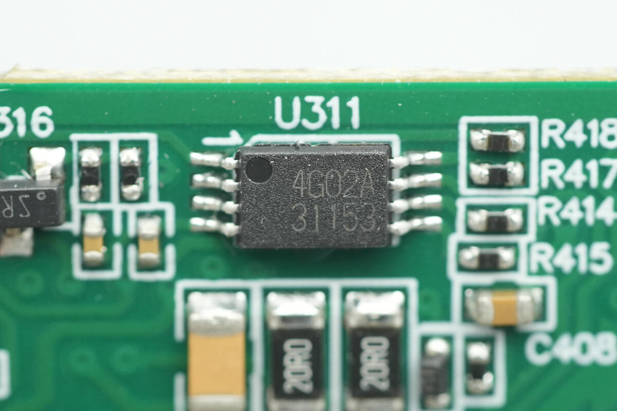

The memory is from ROHM, marked 4G02A, model BR24G02-3A. It has a capacity of 256 B, supports an operating voltage of 1.6–5.5 V, and is packaged in TSSOP-B8.

The MOSFET is from Nexperia, marked M9C025, model PSMN9R0-25MLC. It is an NMOS device rated at 25 V, with an on-resistance of 7.55 mΩ, and is packaged in LFPAK33.

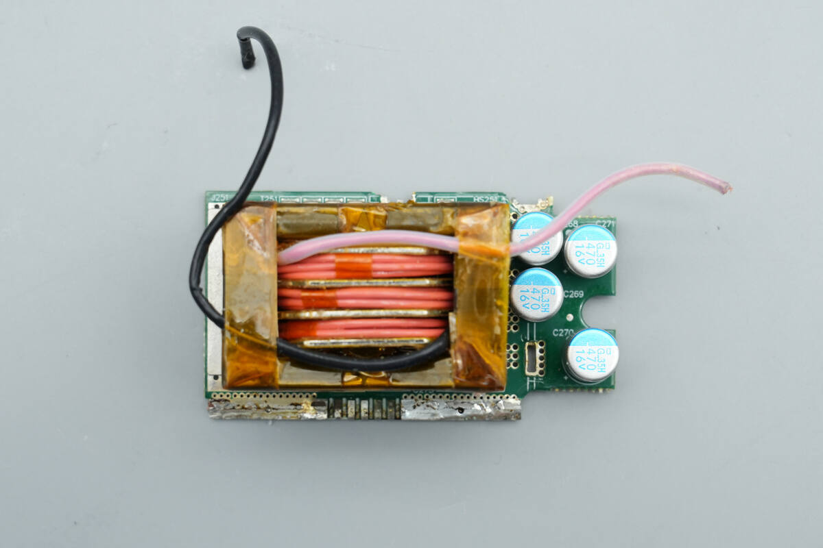

The transformer magnetic core is insulated with tightly wound tape.
The PCBA module is hollowed out to reduce its thickness.

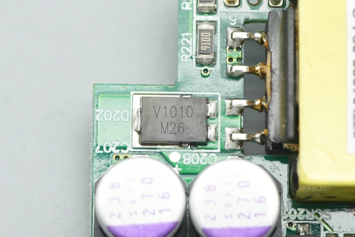

The rectifier is from VISHAY, marked V1010, model V10P10, rated at 10 A and 100 V, and packaged in TO-277A.
