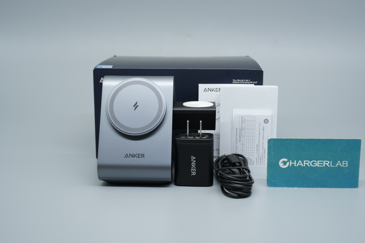

The box contents include the product, power adapter, data cable, user manual, and warranty certificate.

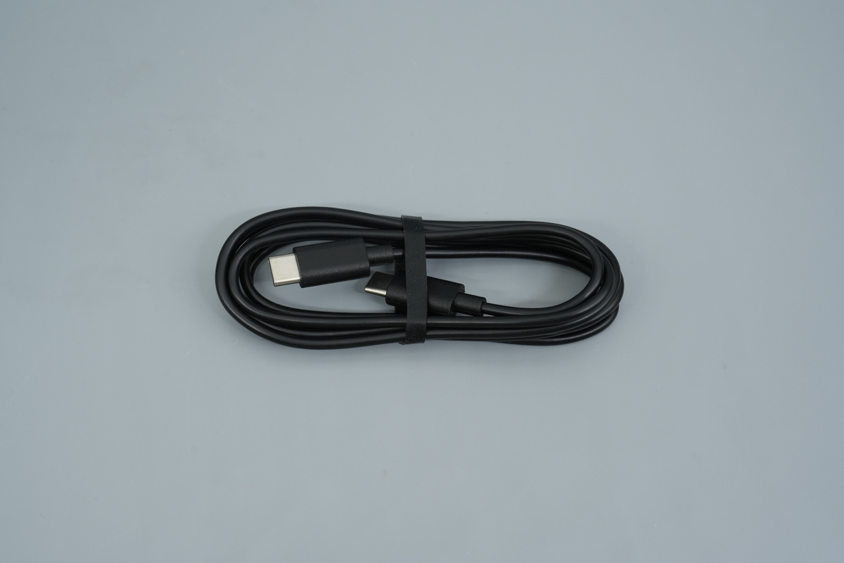

Teardown of the Anker737 MagGo 3-in-1 Wireless Charger-Chargerlab

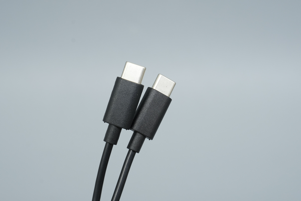

The package comes with a standard black USB Type-C to USB Type-C fast charging cable.
The cable is equipped with USB-C connectors on both ends.

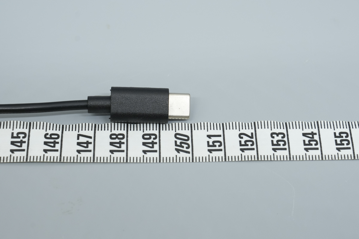

The length of the integrated cable is approximately 1.5m.
ChargerLAB POWER-Z KM003C shows that the cable supports that it doesn't contain an E-Marker chip.

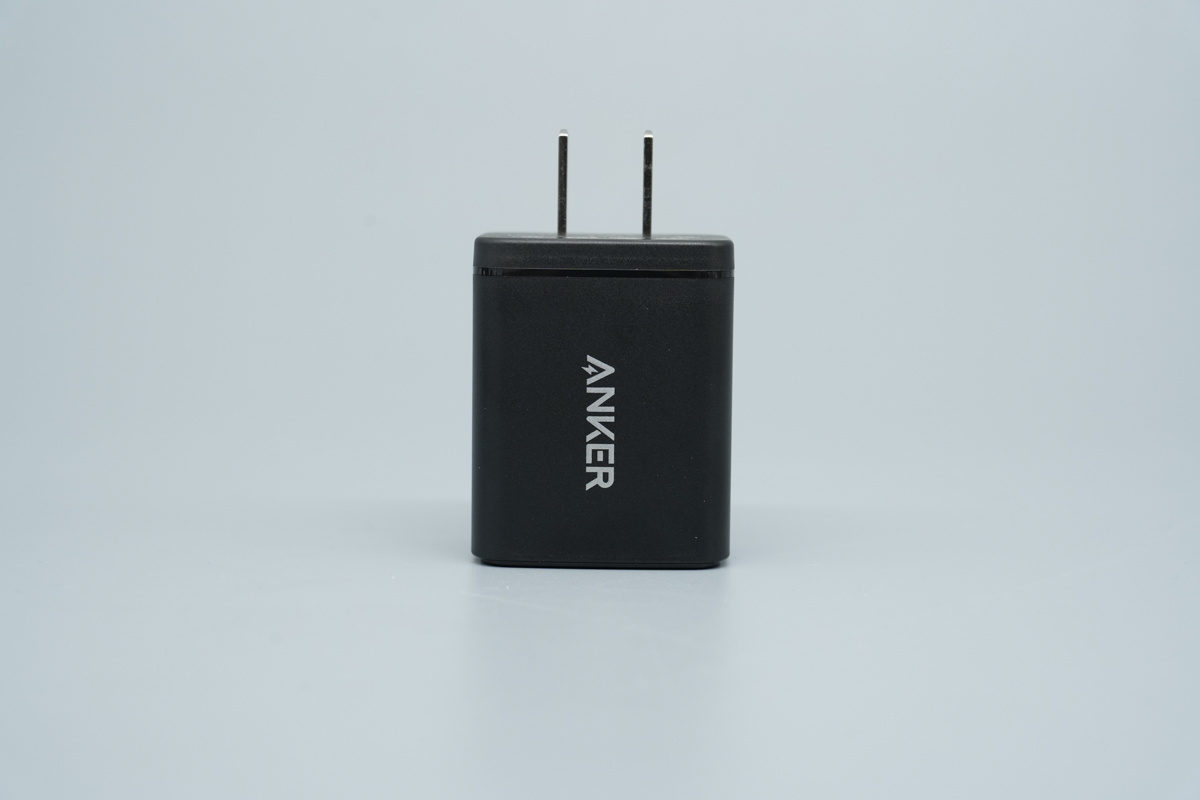

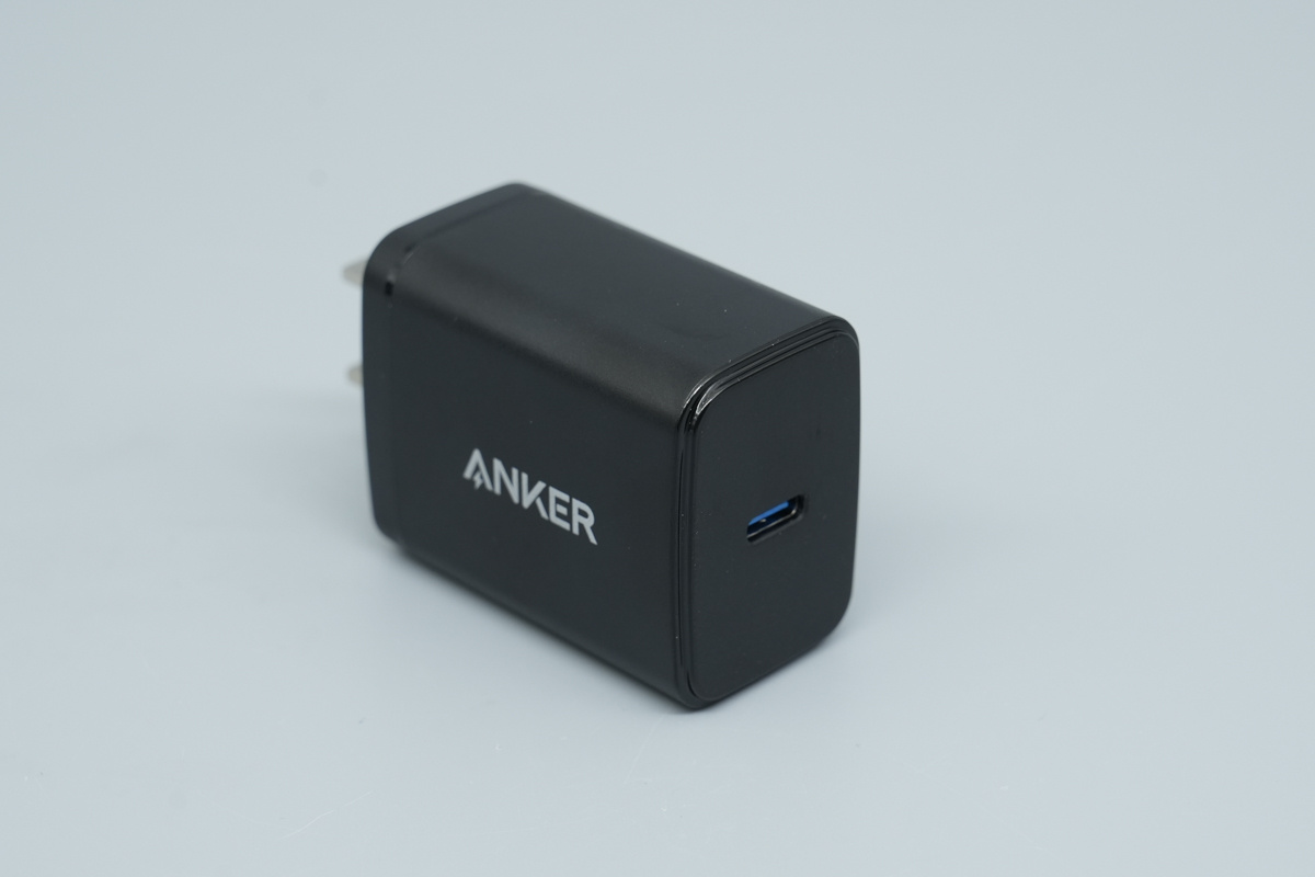

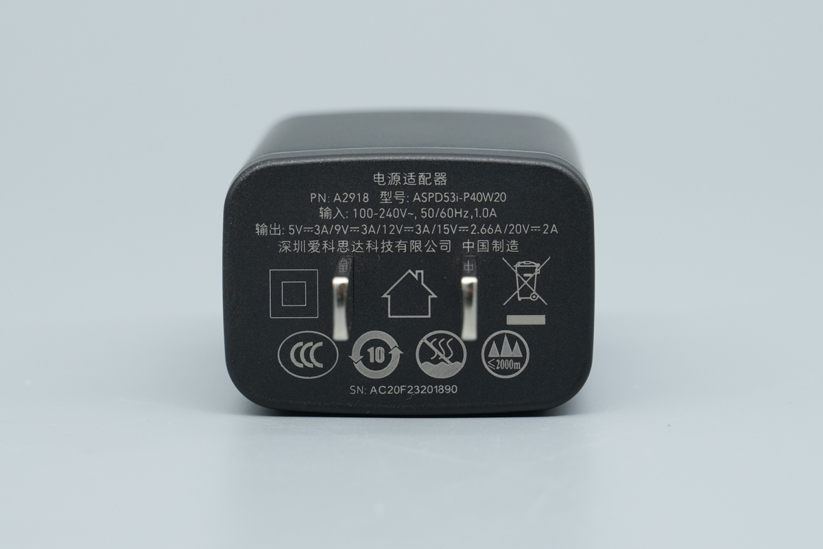

The included single-port USB-C charger sports a dual-texture design, combining glossy and matte surfaces, and is branded with the Anker logo.
With its compact and rounded form factor, this small charger comes with a single USB-C port, featuring Anker’s iconic blue plastic sheet inside.
The detailed specs for the charger are as follows:
Model: ASPD53i-P40W20
Input: 100-240V~, 50/60Hz, 1.0A
Output: 5V3A / 9V3A / 12V3A / 15V2.66A / 20V2A
Manufacturer: SHENZHEN AQUILSTAR TECHNOLOGY CO.,LTD
Certification: It has passed Chinese 3C certification.

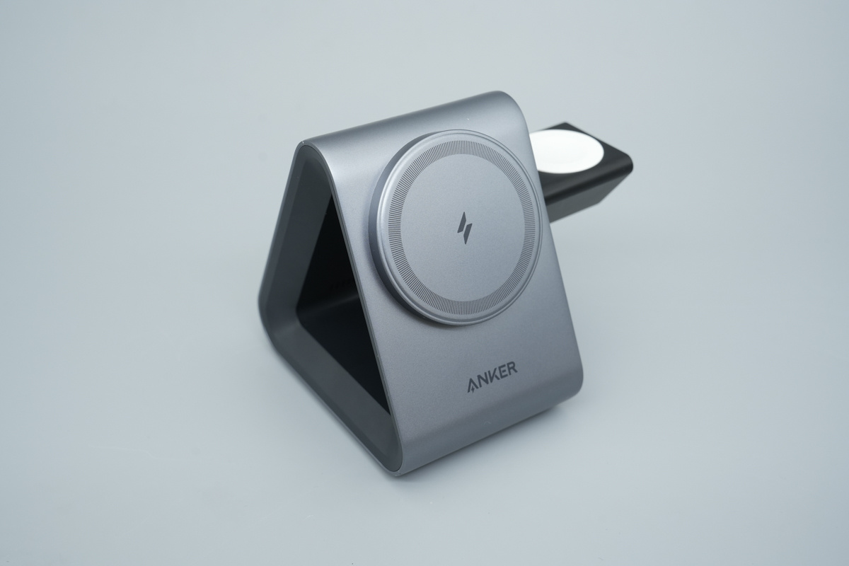

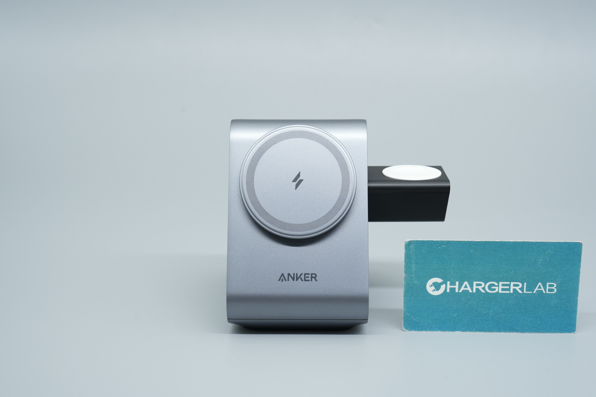

The charger showcases a distinct triangular form, finished in a sleek space gray.

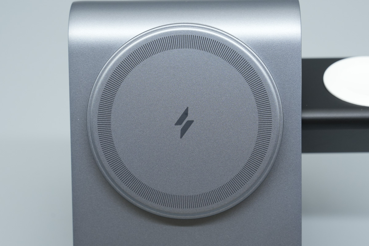

The front houses a prominent MagSafe magnetic charging module, set at an ergonomic angle that makes it easy to snap on your phone and trigger the iPhone's Standby display.
The MagSafe module surface features a lightning icon fast-charging mark.

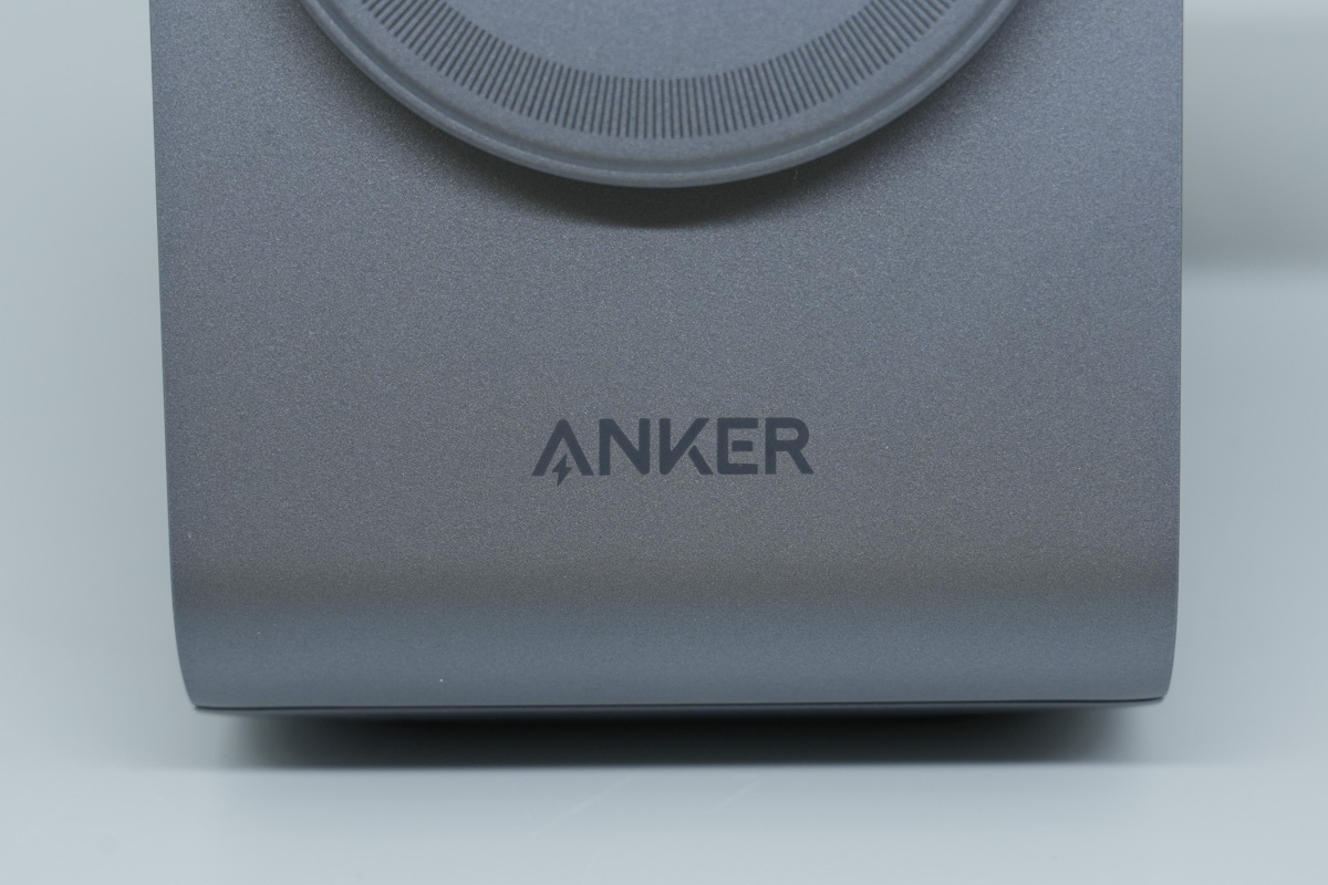

The ANKER logo is printed below the front base.

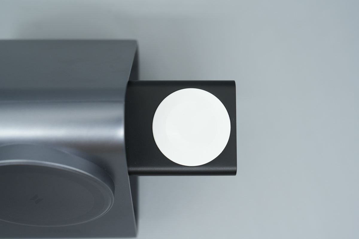

The protruding arm on the right side of the unit is the dedicated MFW wireless charging module for the Apple Watch.

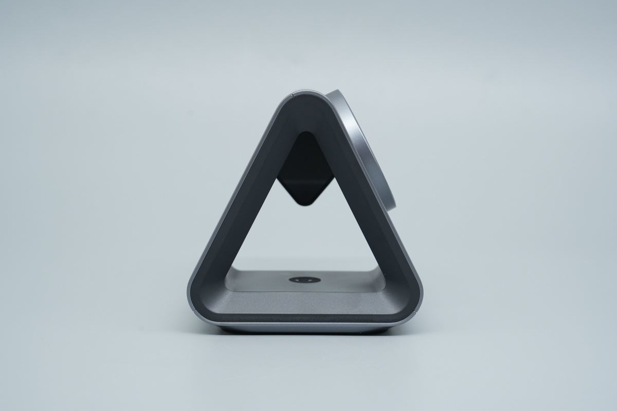

The unique triangular cutout design on the side offers a perfect balance of tech aesthetics and practicality.

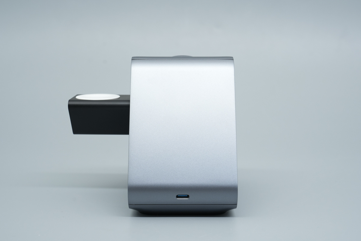

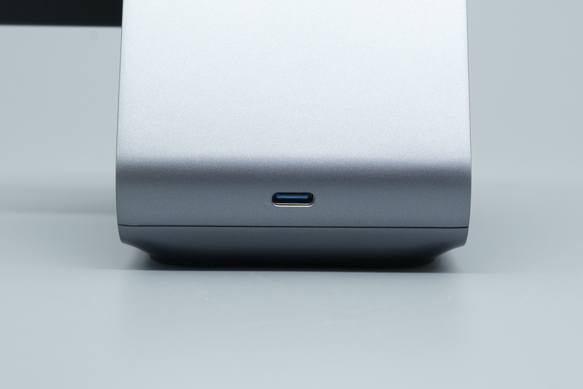

A USB-C input port is provided at the bottom of the rear.

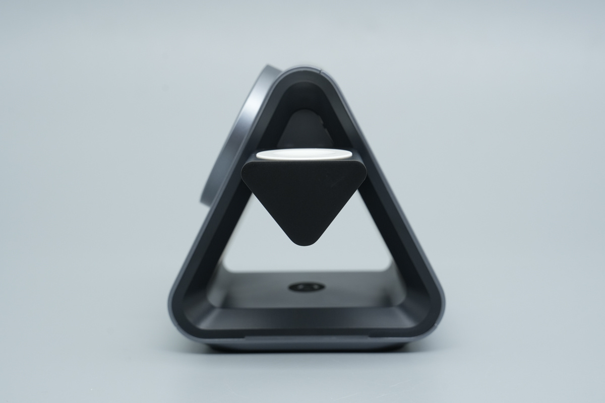

The other side reveals a full equilateral triangle design.

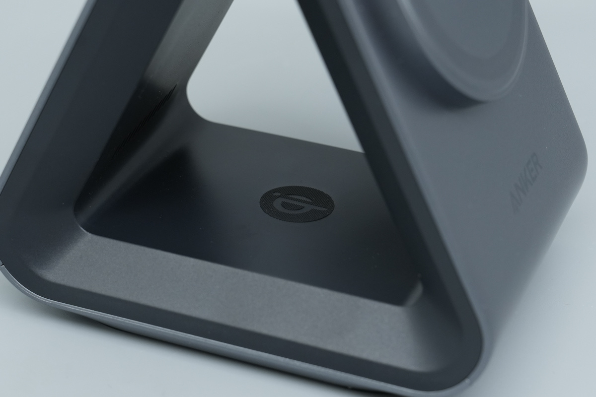

The base is marked with a qi wireless charging symbol, supporting wireless charging for AirPods.

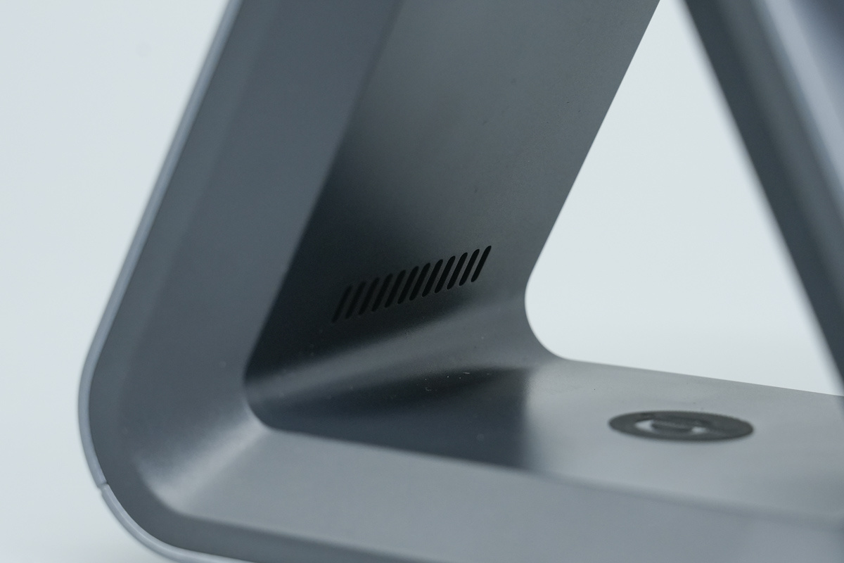

A discreet, grille-style ventilation slot is cleverly tucked away at the top inside the triangle to help dissipate internal heat.

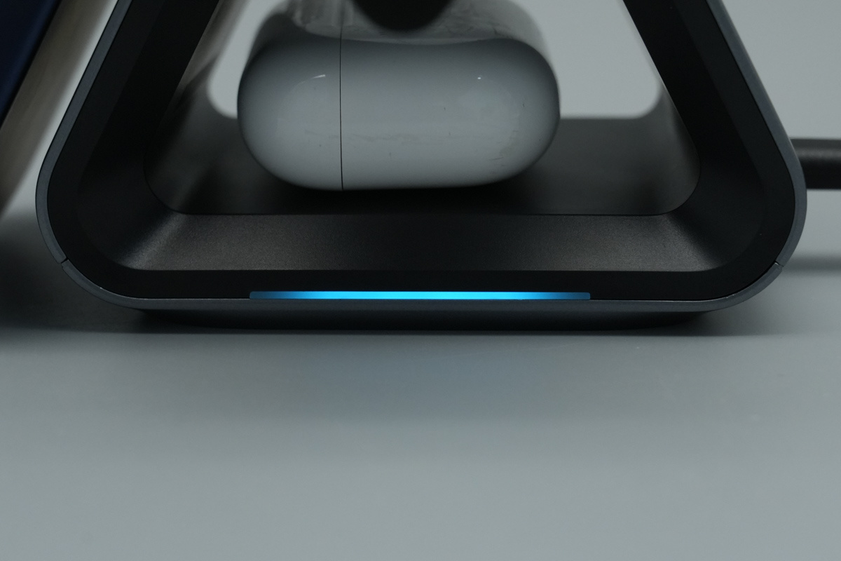

The blue indicator on the right lights up during device charging.

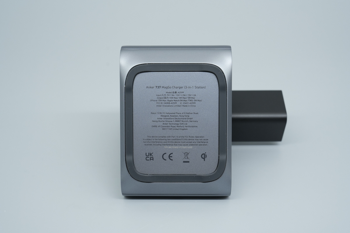

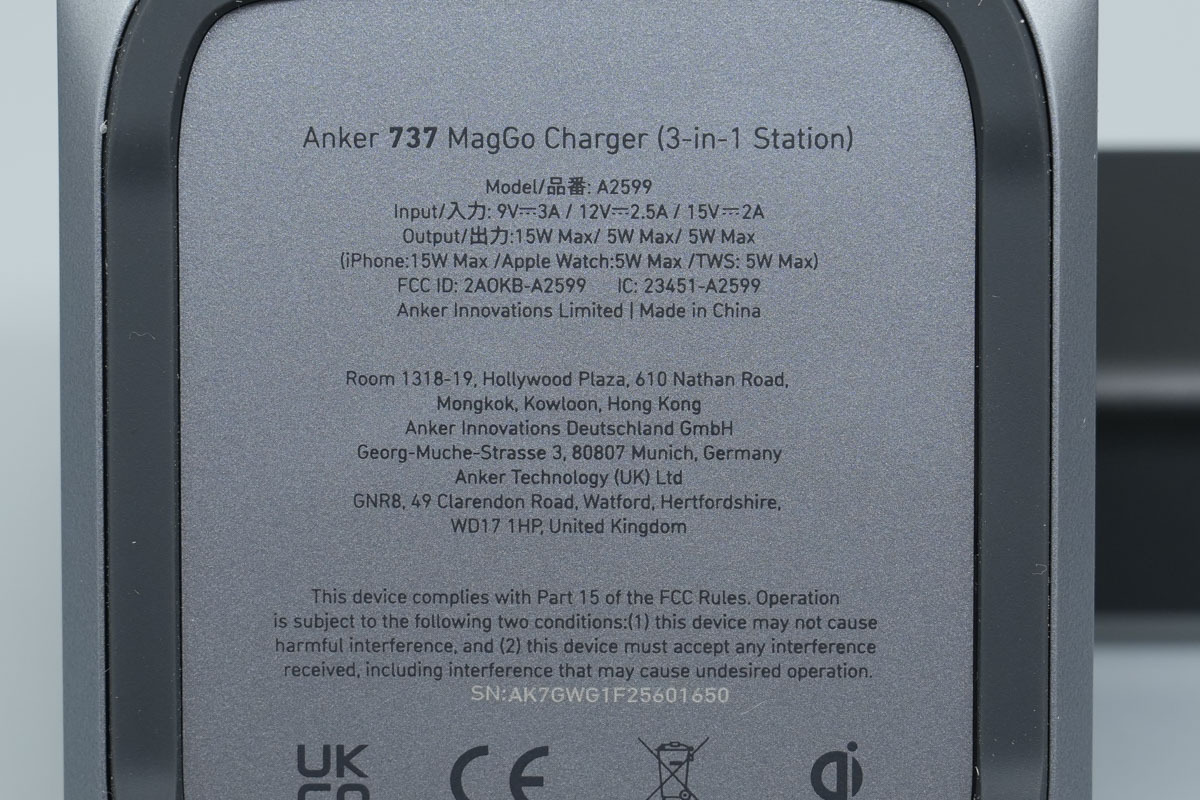

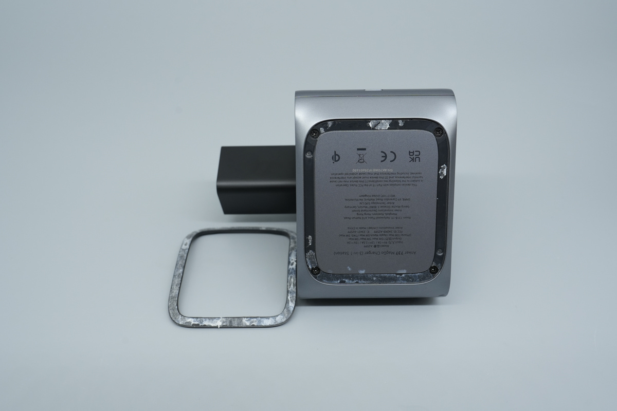

The base panel displays the product spec nameplate.
The technical specs as follows:
Product Name: Anker 737 MagGo Charger (3-in-1 Station)
Model: A2599
Input: 9V3A / 12V2.5A / 15V2A
Output: 15W Max / 5W Max / 5W Max
iPhone: 15W Max / Apple Watch: 5W Max / TWS: 5W Max
FCC ID: 2AOKB-A2599
IC: 23451-A2599

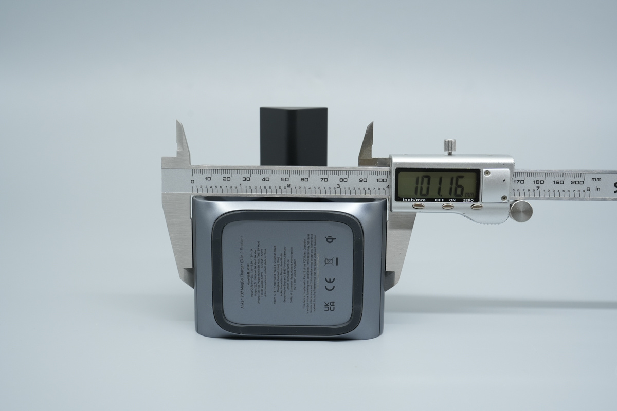

The length of the charger is about 101.16mm (3.983 inches).
The width of the charger is about 114.37mm (4.503 inches).

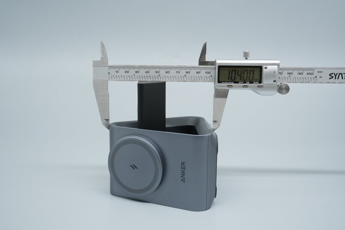

The height of the charger is about 104.00mm (4.095 inches).

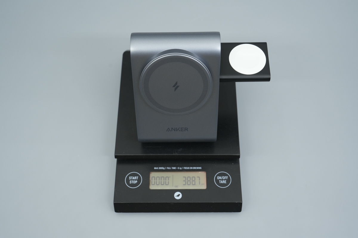

The weight is about 388.7g (13.71 oz).

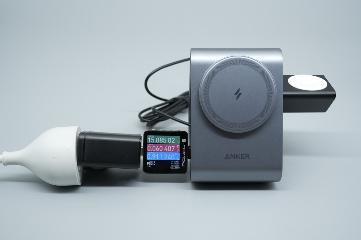

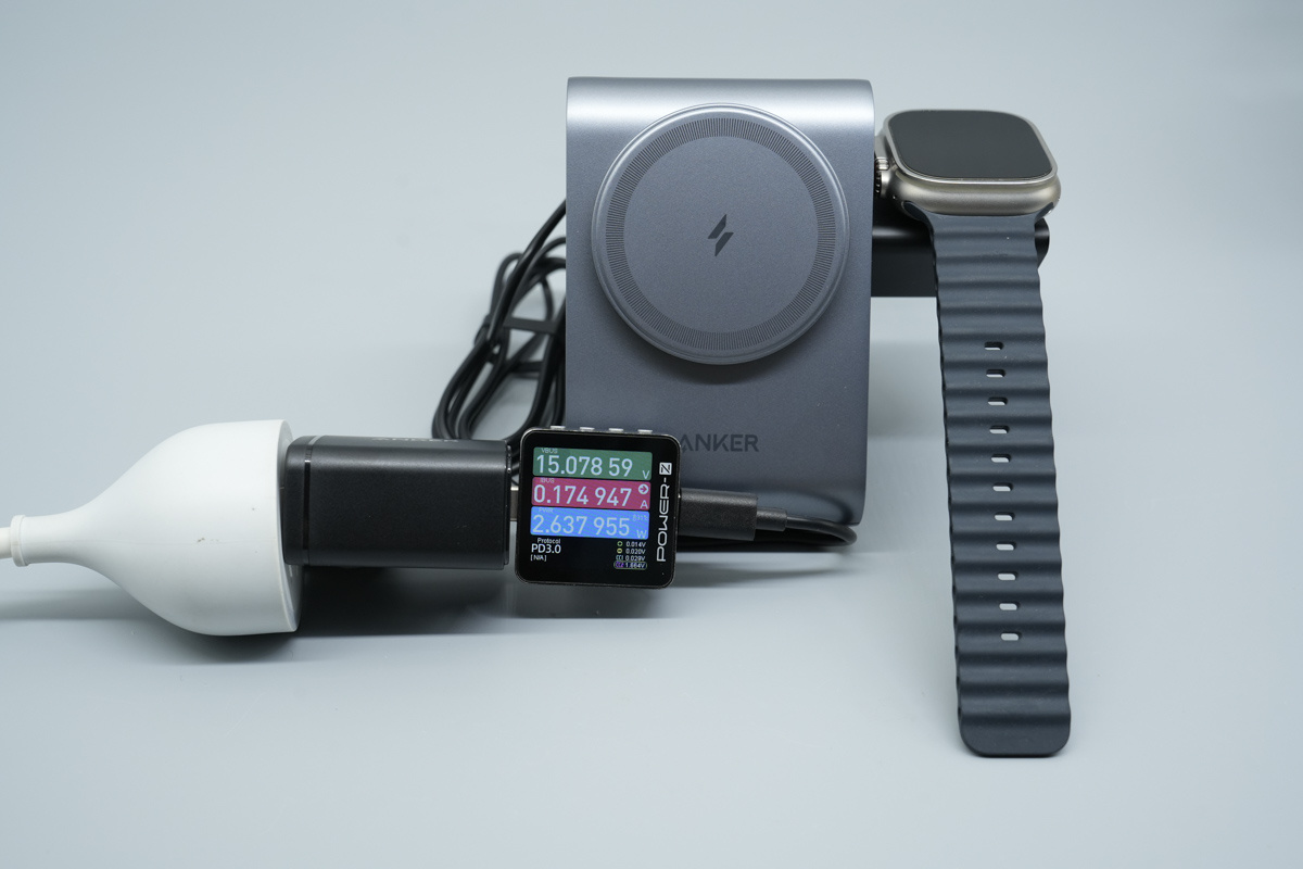

ChargerLAB POWER-Z KM003C shows that the charger negotiates 15V in standby, drawing about 0.9W of power while idle.
With an Apple Watch placed on the charger, the input power reads about 2.6W, successfully initiating charging for the watch.

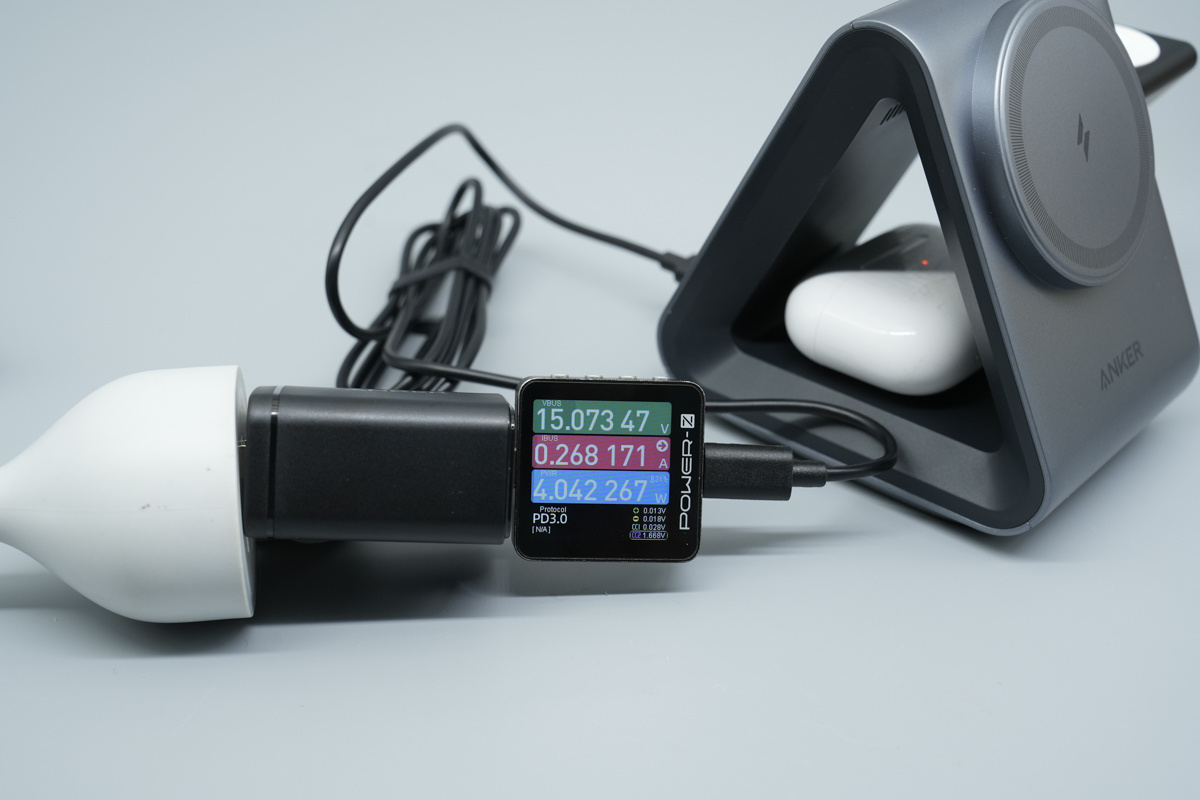

With AirPods on the base, the input power reads about 4.0W.

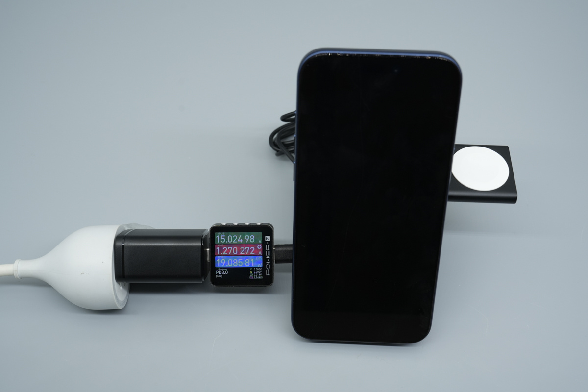

With an iPhone attached to the front, the input power stabilizes at over 19W.

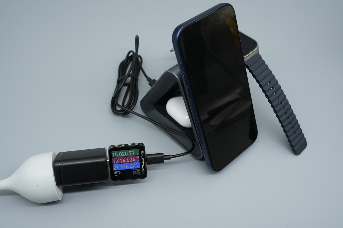

With all three devices charging at once, the input power reaches a stable 21.2W or more.

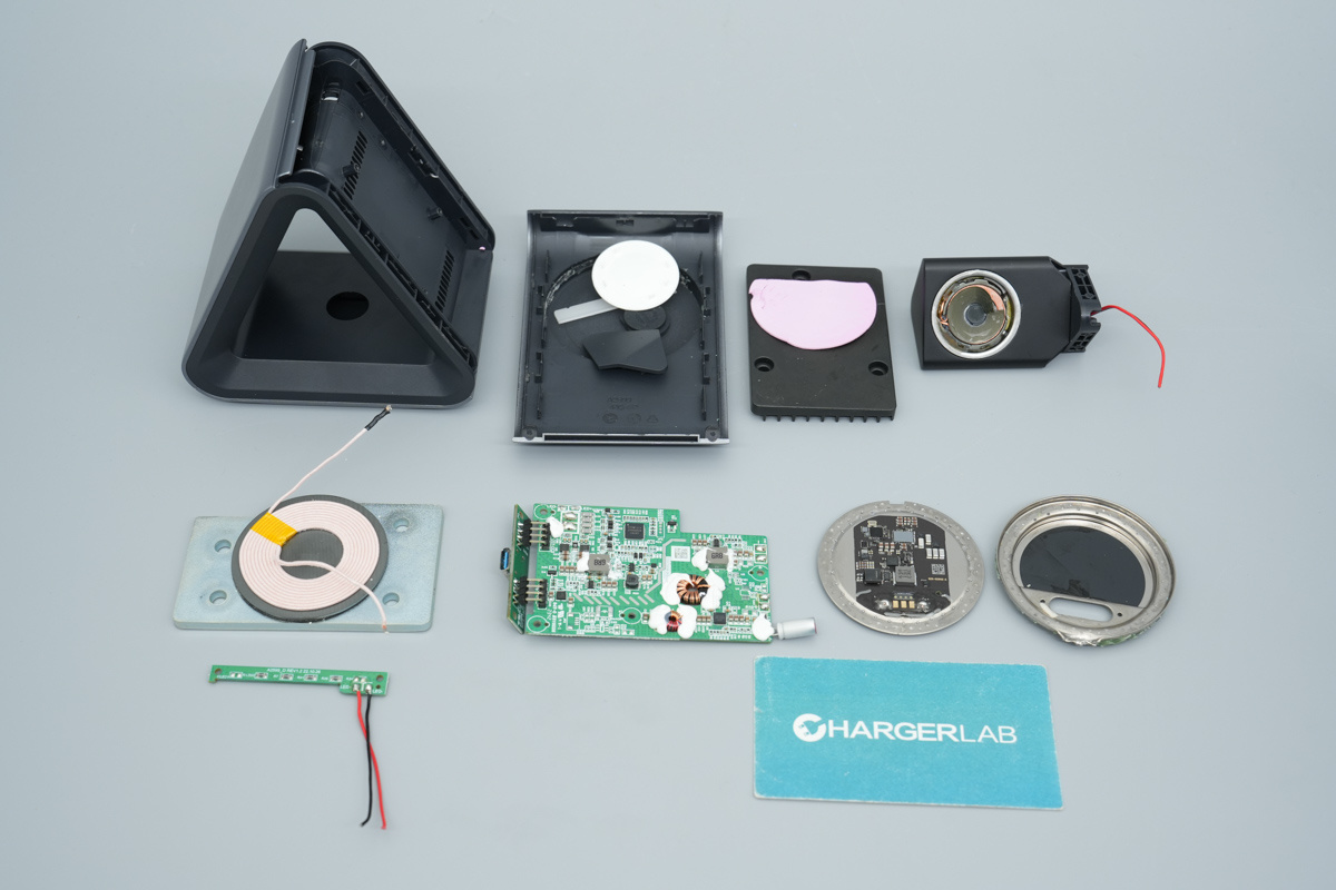

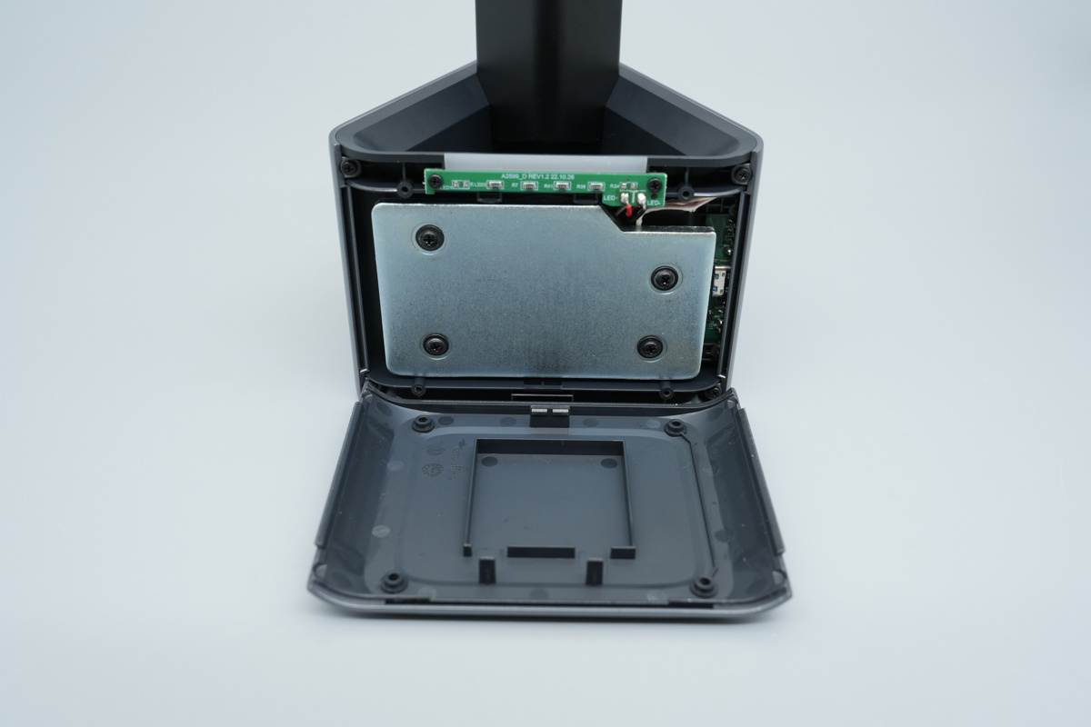

Peel off the base's anti-slip silicone pad to expose the four hidden Phillips screws.

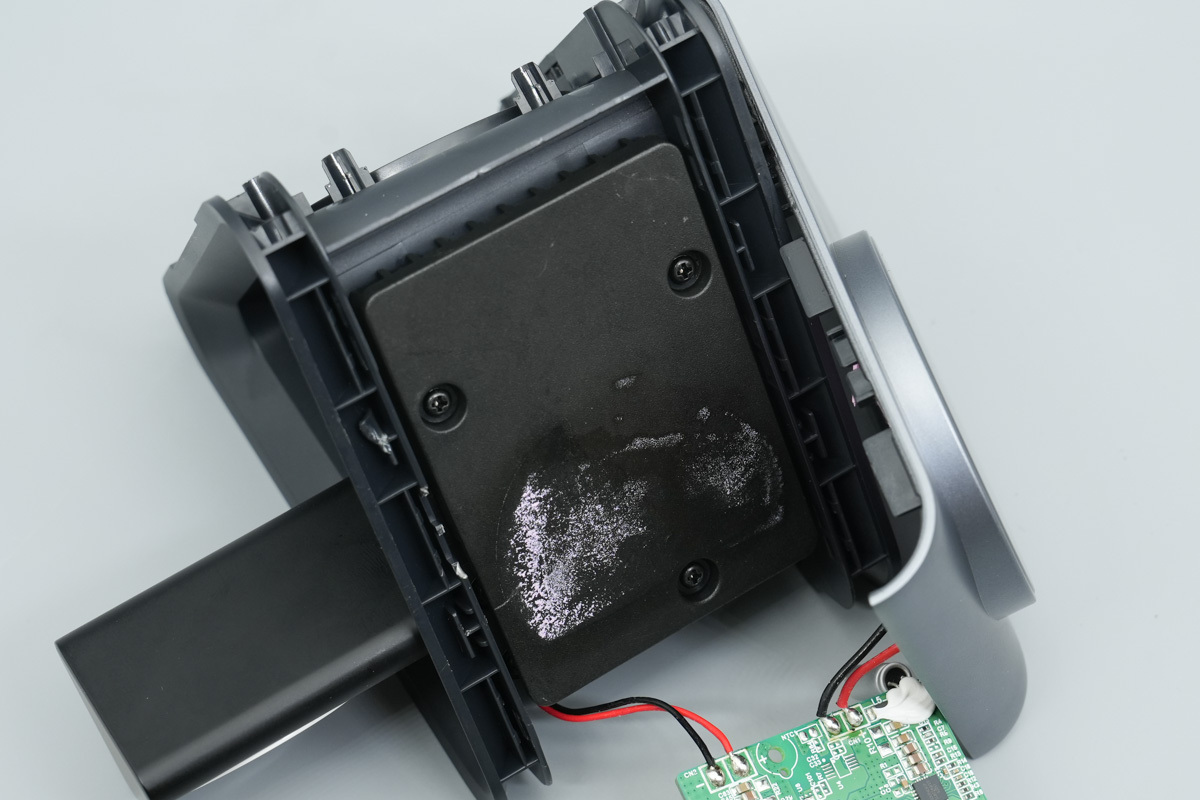

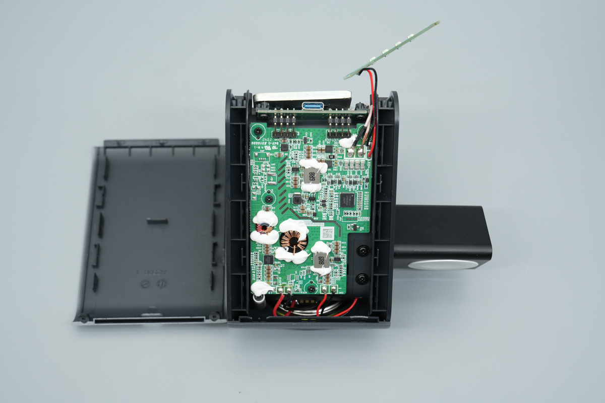

After unscrewing the base and opening the cover, the interior is dominated by a large metal plate, with an LED PCB connected to one side.

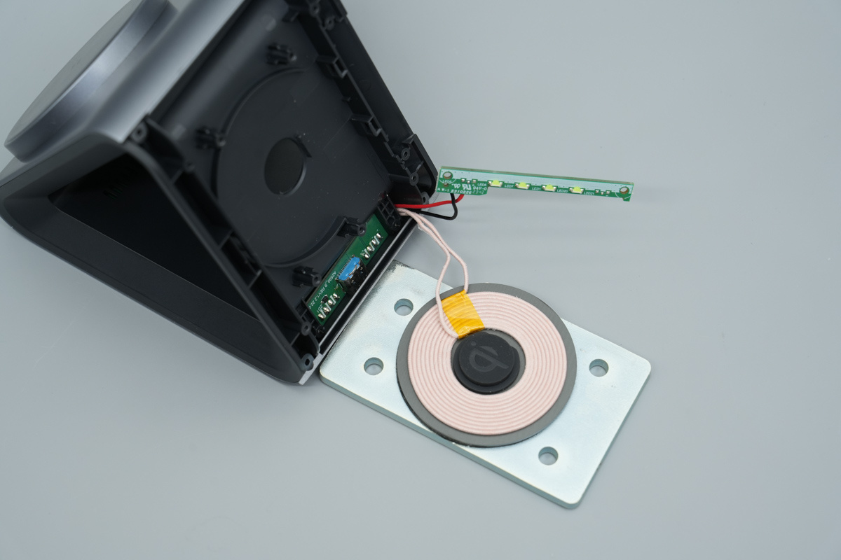

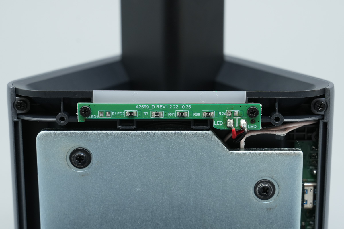

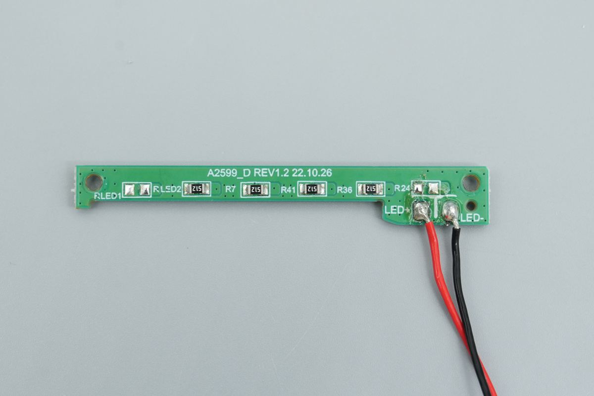

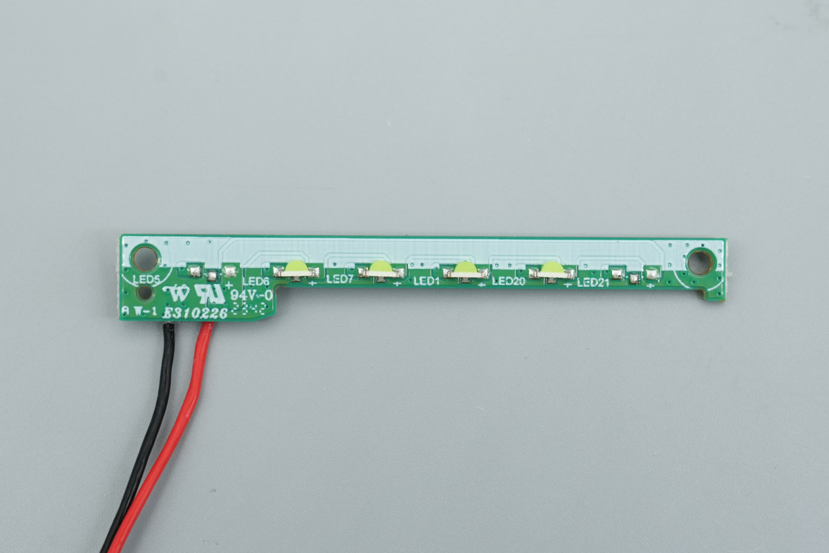

Here is the LED PCB, featuring a light guide cover for even light distribution.

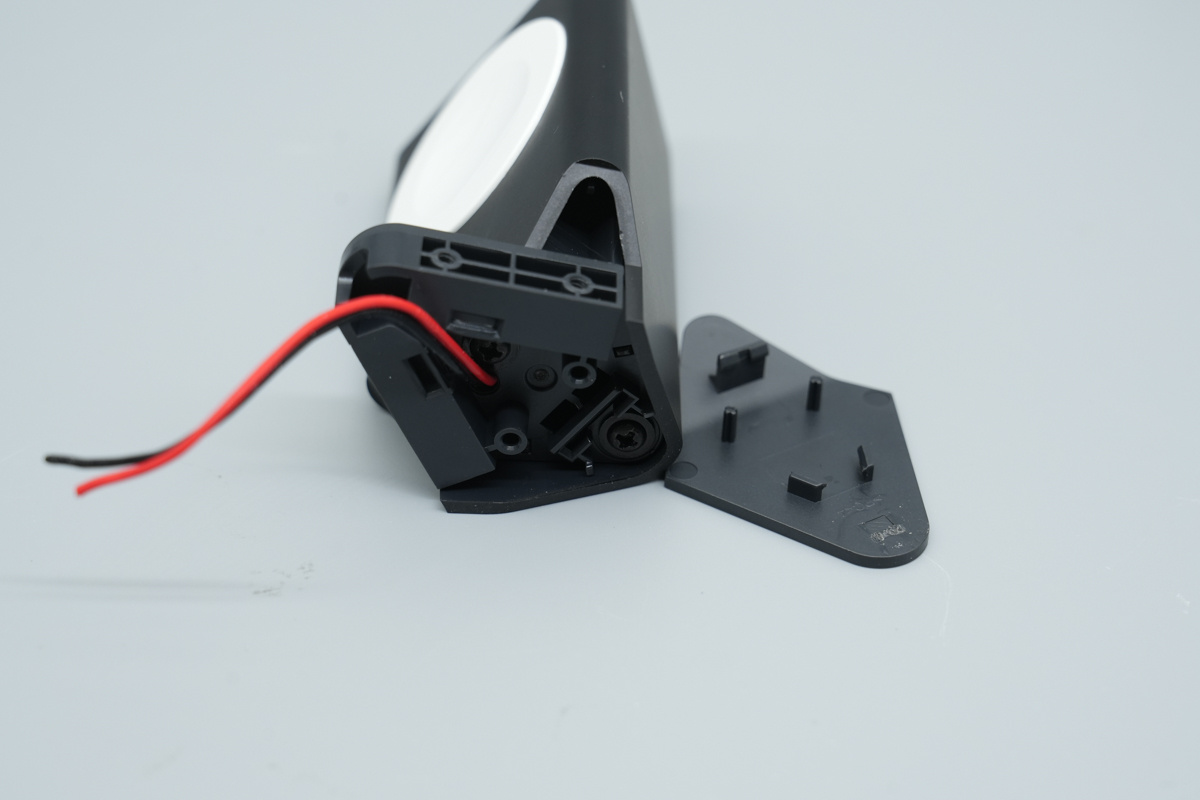

Removing the metal bottom plate reveals the wireless charging coil used for the AirPods.

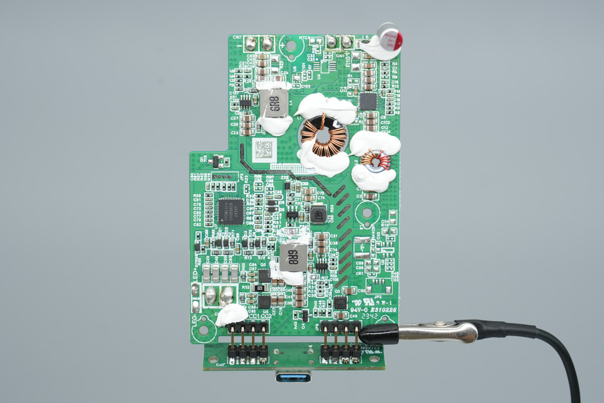

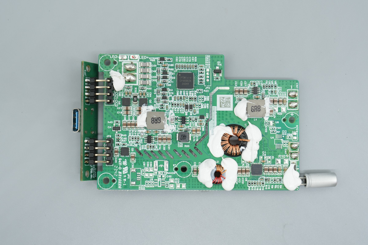

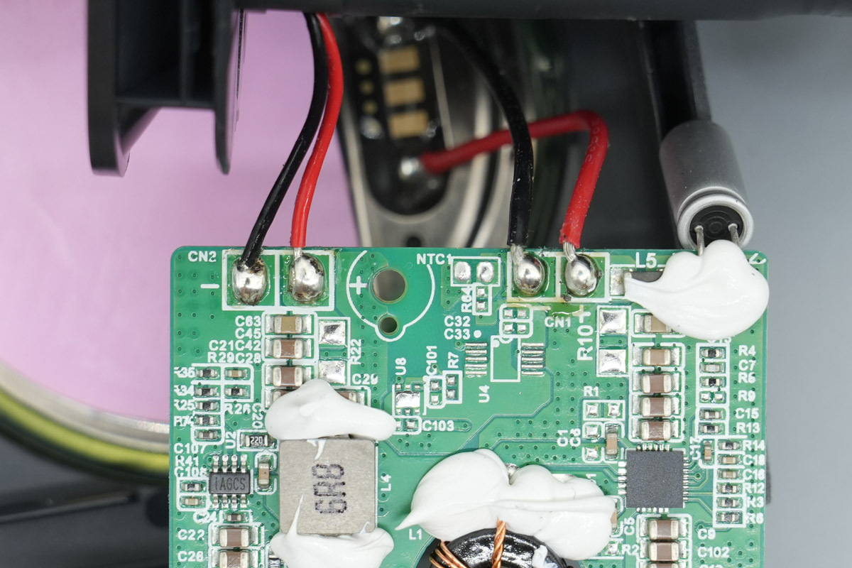

This is the mainboard, we can see that components like the chokes on the PCBA are reinforced with white potting compound.

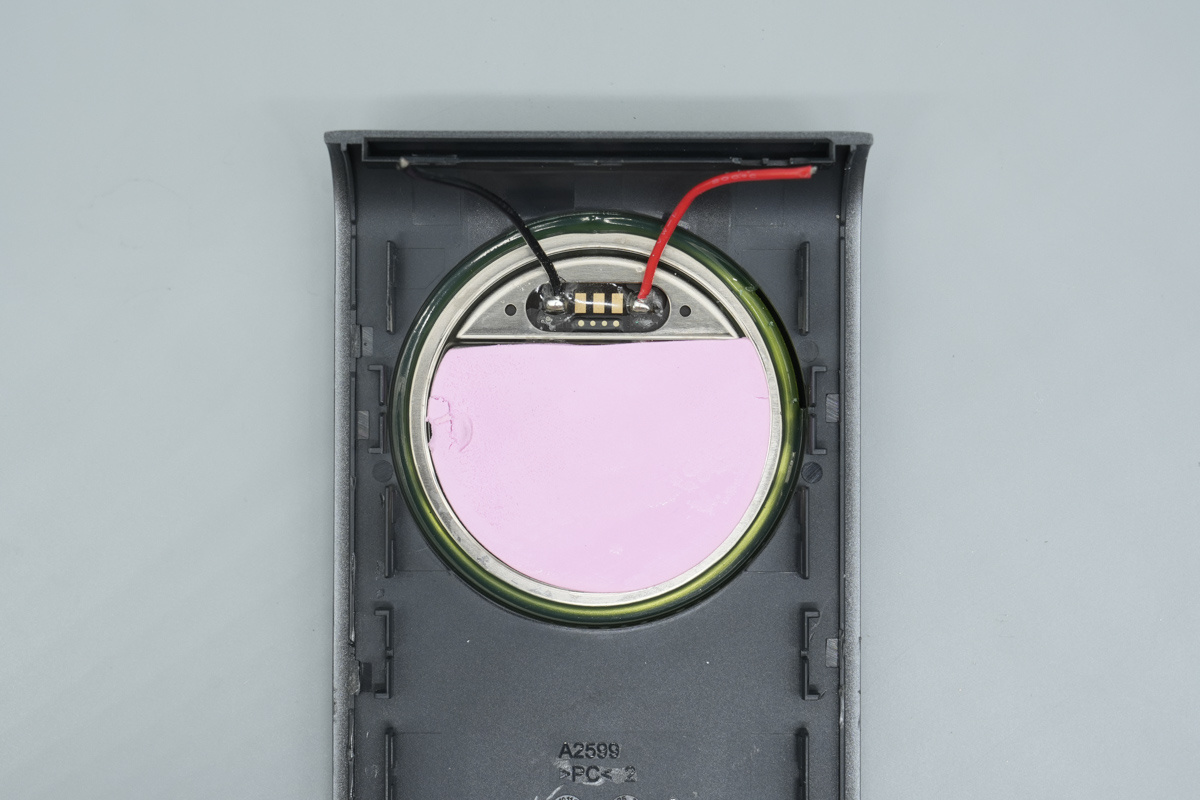

Moving on to the MFM front panel, the module is tightly coupled with the heatsink to boost thermal performance and keep excess heat away from the phone.
With the MFM and PCBA taken out, we can see the solder joints for the MFM and MFW wireless charging modules are clean and well-soldered.

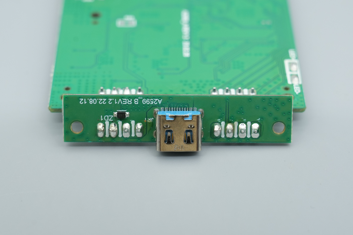

Removing the PCBA reveals a small power input PCB positioned on the side.
The USB-C female port is soldered onto the edge of a separate extension PCB.
There are no other components on the back of the mainboard but the step-down chokes.
A pink thermal pad is applied to the back of the MFM, contacting the internal heatsink for better thermal management.

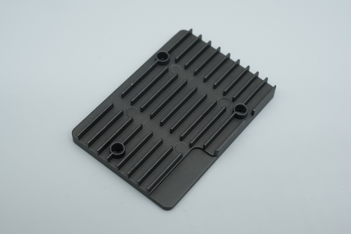

The large metal heatsink base extracted from the housing is specifically designed to pull heat away from the MFM and dissipate it.

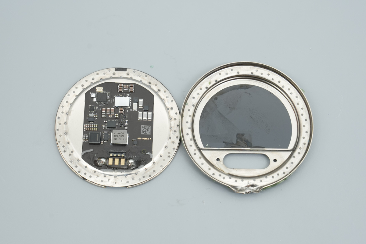

We have extracted the original Apple MFM-certified MagSafe charging module, which is connected using soldered wires.
The wireless charging module for the phone is an Apple-certified MFM MagSafe component.

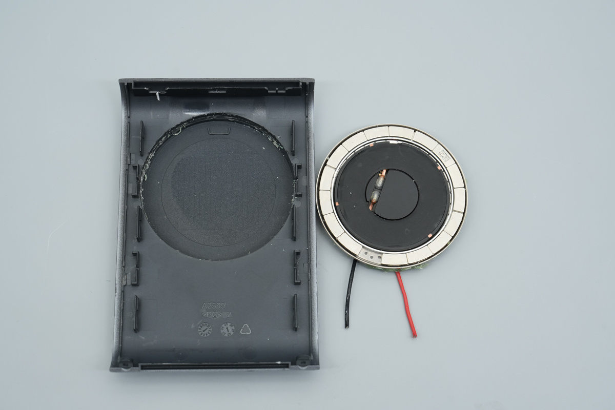

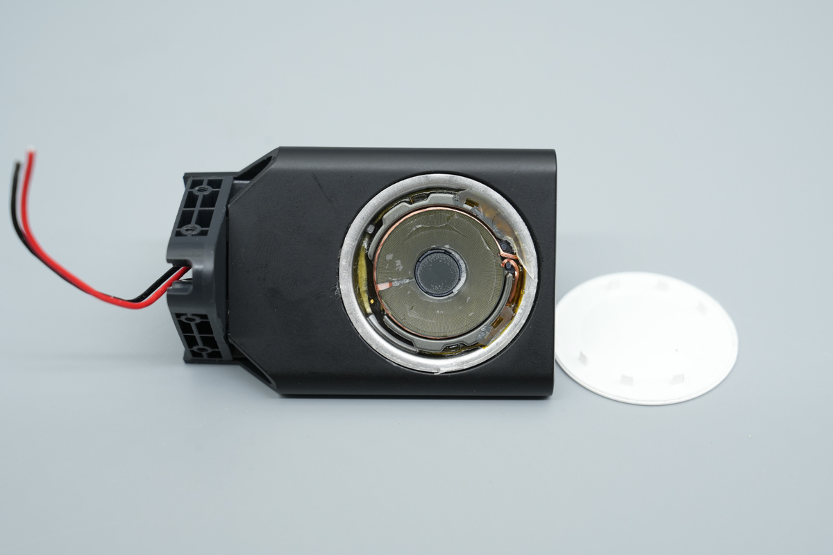

Removing the MFW wireless charging arm, which extends from the main unit.
With the white cover removed, we can see the official MFW-certified Apple Watch wireless charging module located beneath.

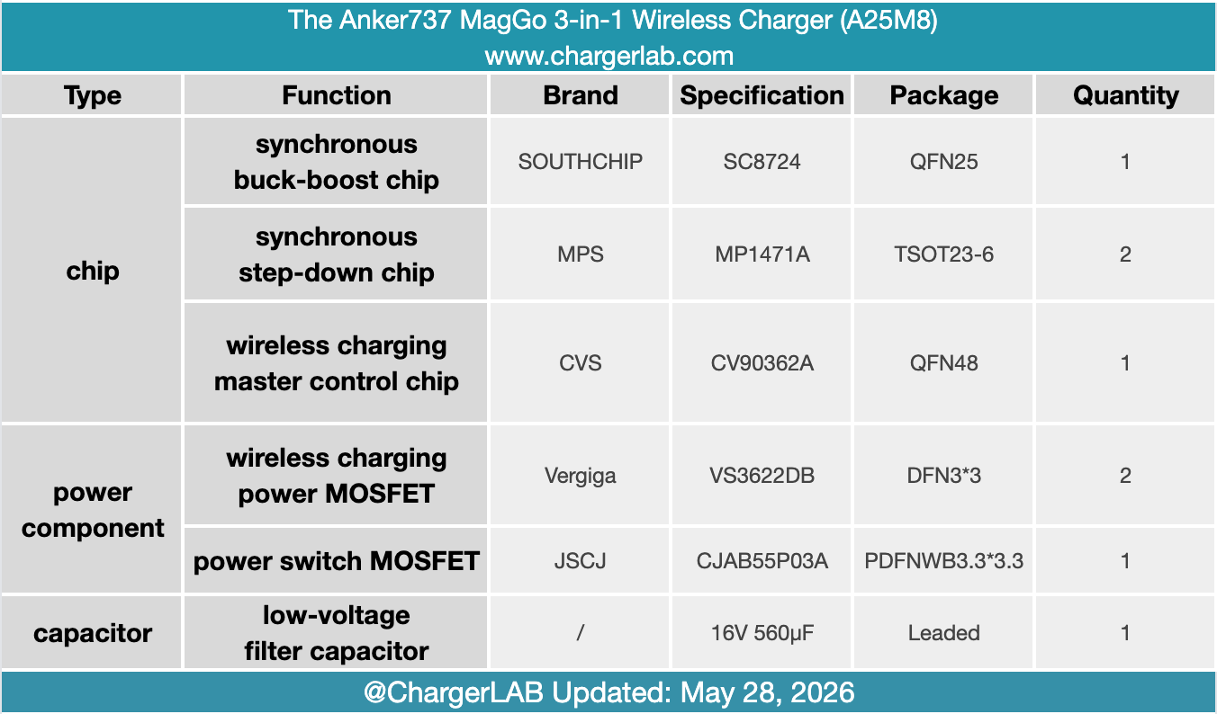

On the front of the PCBA, the top three chokes manage the MFM and MFW wireless charging, while the bottom choke powers the earphone wireless charging alongside the main controller.

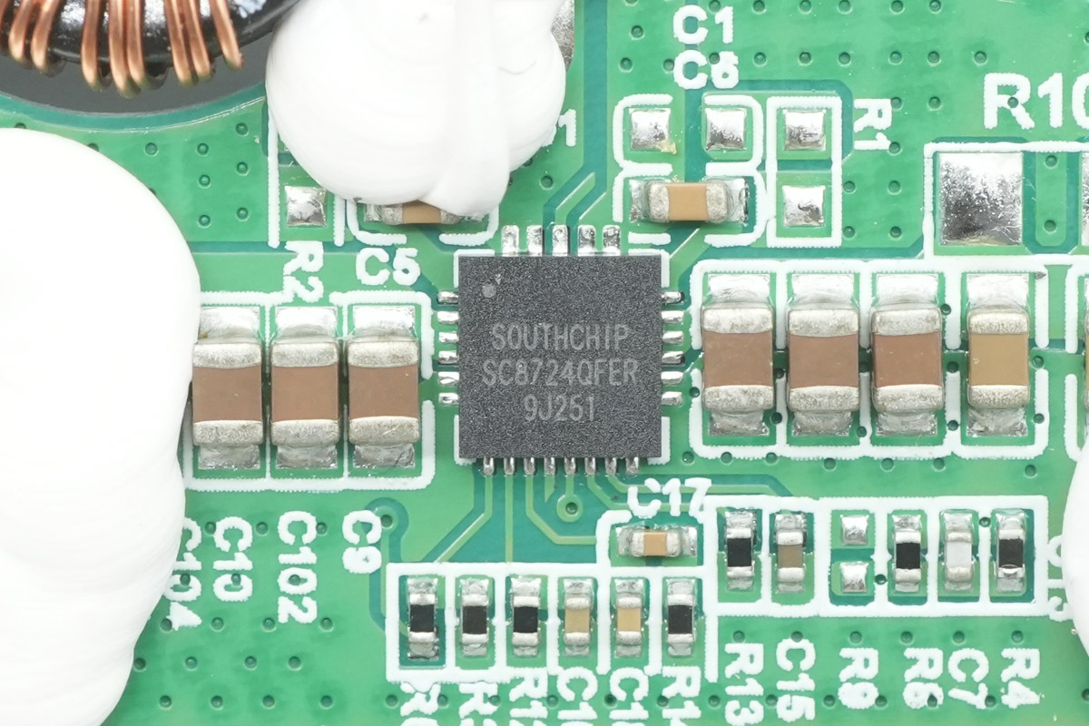

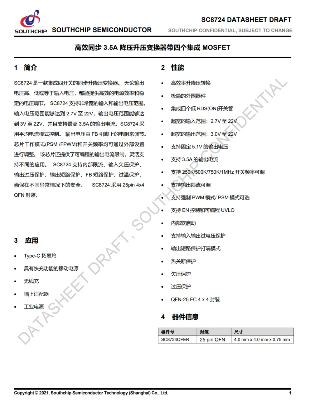

The synchronous buck-boost chip is from Southchip, model SC8724, housed in a QFN25 package. It is a four-switch synchronous buck-boost converter that ensures high power efficiency and stable voltage regulation, regardless of whether the output voltage is higher, lower, or equal to the input voltage.
It supports an input voltage range of 2.7V to 22V, an output voltage range of 3V to 22V, and provides a maximum output current of 3.5A.
The SC8724 uses average current mode control, with output voltage set by resistors on the FB pin. External settings allow for adjustments to both the switching frequency and the operating mode (PSM/FPWM).
It also supports programmable output current limiting to suit different needs. Safety is ensured by a suite of protections, including internal current limiting, input UVP, output OVP, output/FB short-circuit protection, and OTP.

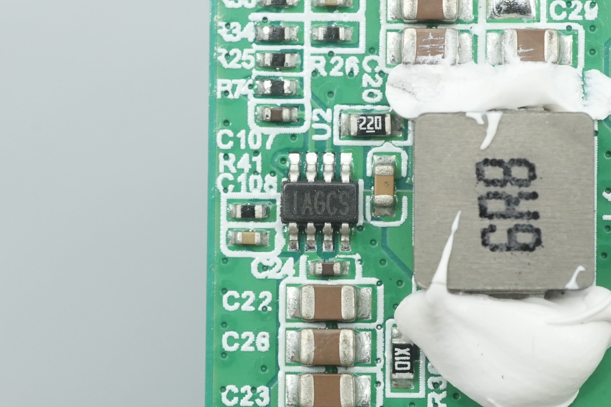

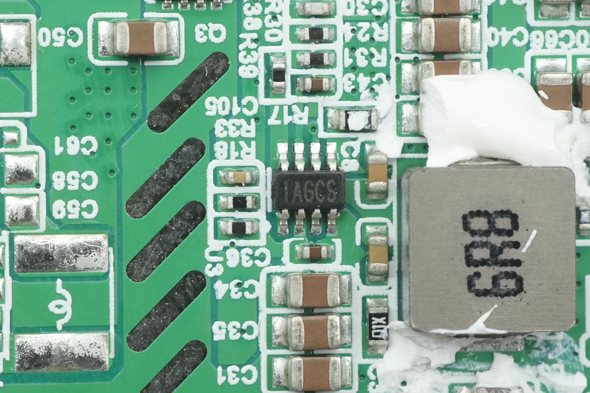

The chip is from MPS, model MP1471A, marked IAGCS, and in a TSOT23-6 package. It is a high-frequency, synchronous, rectified, step-down, switch-mode converter with integrated power MOSFETs.
It delivers 3A of continuous output current over a wide input supply range, providing a highly compact solution with excellent load and line regulation.

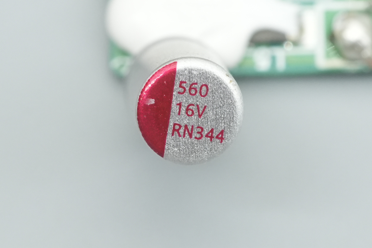

A solid filter cap, 16V 560μF.
Another synchronous step-down chip is from MPS, model MP1471A.

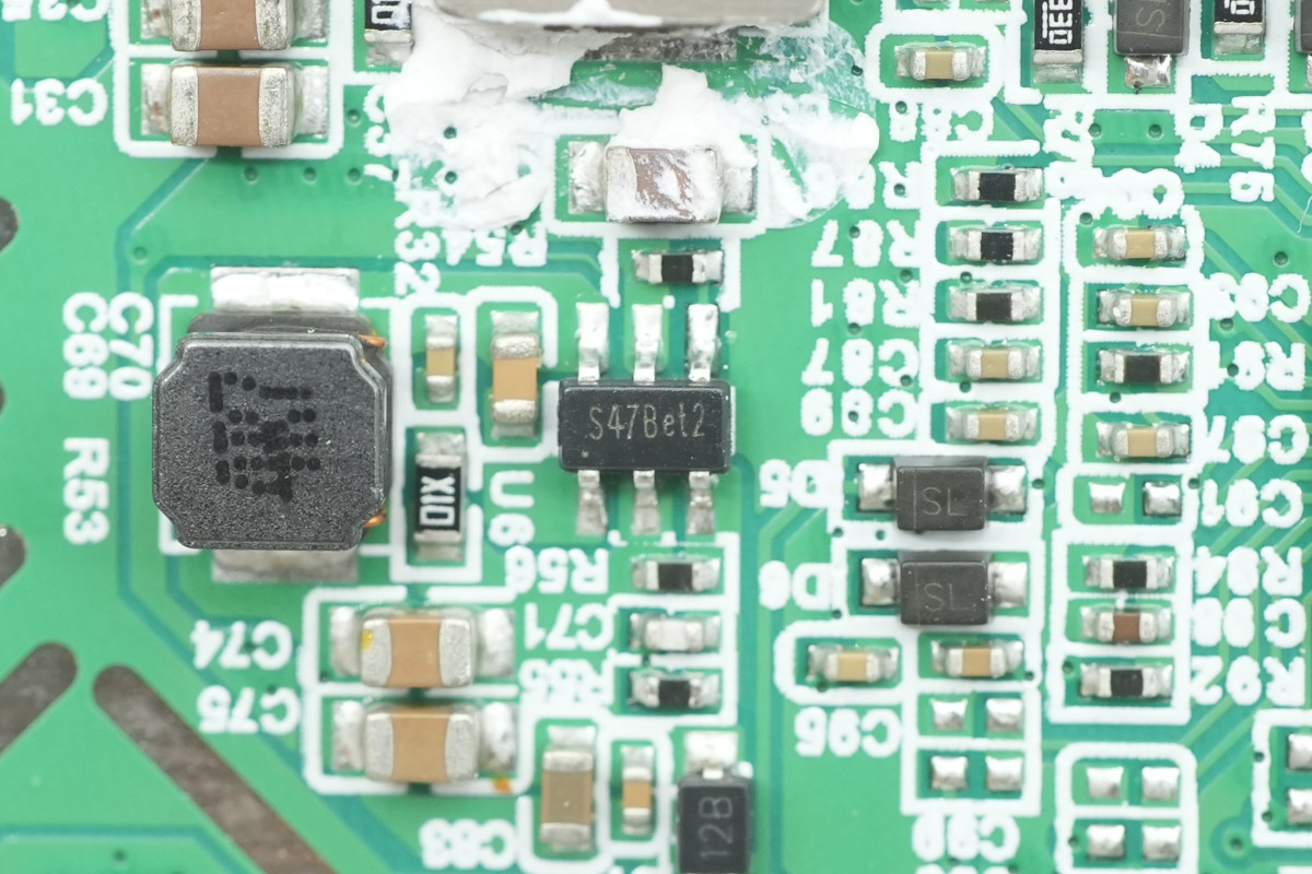

A chip, marked S3Bet2.

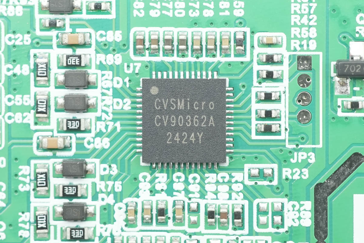

The wireless charging master control chip is from CVS, model CV90362A, housed in a QFN48 package. It supports various adapter power inputs, including PD 2.0/3.0, QC 2.0/3.0, and AFC. It is compliant with Qi V1.2 and Qi V1.3 standards, supporting both single-coil and multi-coil wireless charging applications. It supports BPP 5W, Apple 7.5W, Samsung 10W, and EPP 15W wireless charging, as well as proprietary protocols with power outputs of up to 100W.

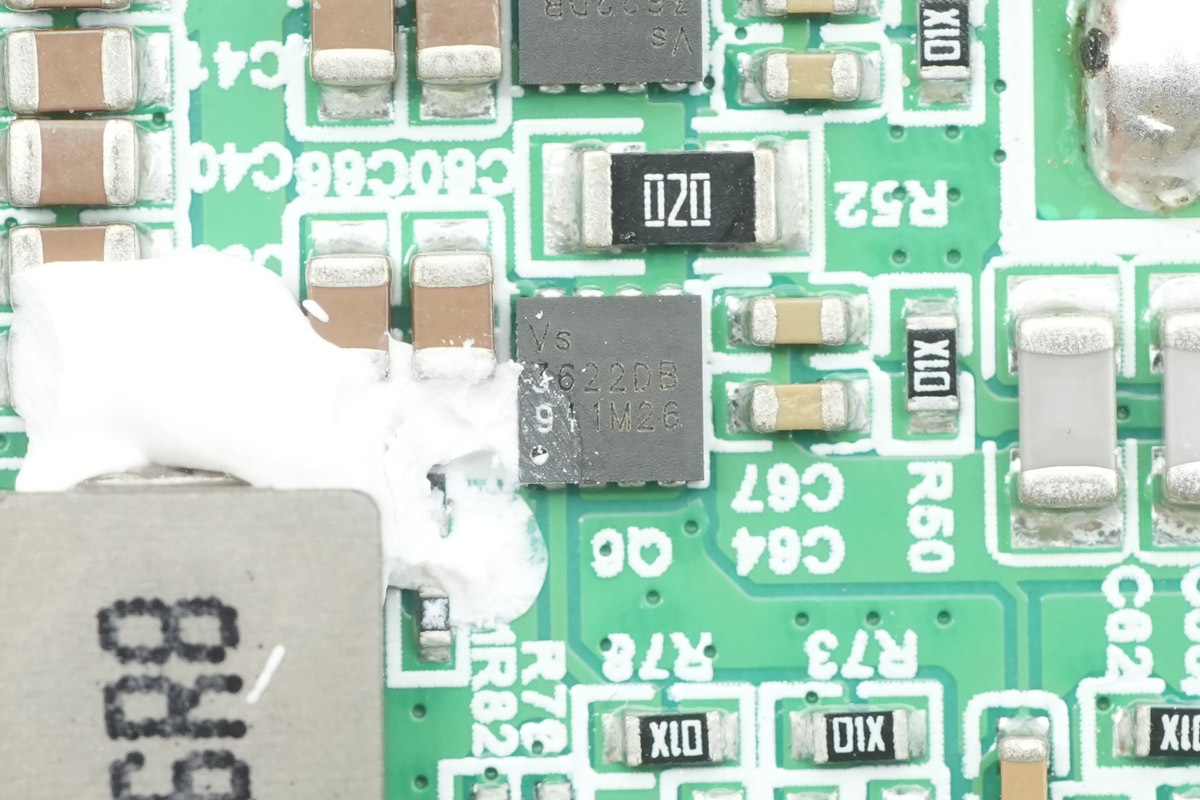

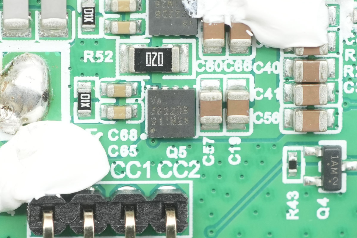

The wireless charging power MOSFET is from Vergiga, model VS3622DB, 30V and a 6 mΩ, housed in a DFN3x3 package.
Here is the info about Vergiga VS3622DB.
Another one is also from Vergiga, model VS3622DB.

The power switch MOSFET is from JSCJ, model CJAB55P03A, PMOS, -30V and 6.5mΩ, in a PDFNWB3.3x3.3 package.
