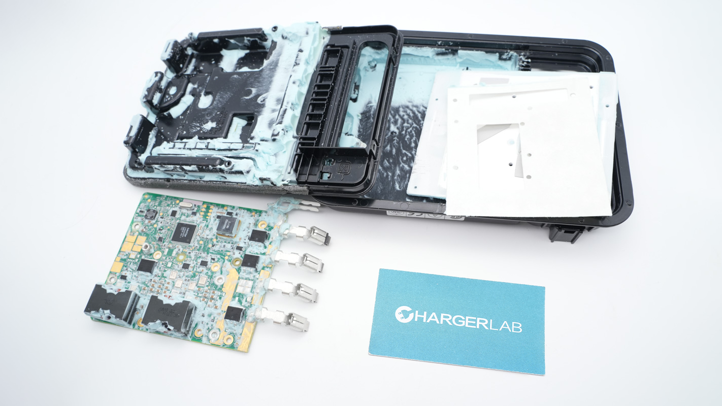

And then, use the spudger to pry along the gap and remove the back cover.
Teardown of SolarEdge 330W Power Optimizer Module (OPJ300)-Chargerlab
What impressed us the most is that the internal module is filled with light green potting compound.
An aluminum plate is fixed inside the potting compound to enhance heat dissipation.
And there’s a circle of foam around the edge of the bottom case for sealing.
Take out the entire PCBA module, the other side is also covered with light green potting compound.
Here is the input cable.
Hidden under the potting compound are the fixing screws for the aluminum plate we just mentioned.
Remove all the fixing screws and take out this thick aluminum plate, which can greatly improve the heat dissipation performance.
There are thermal pads on the aluminum plate that make contact with the PCB.
There is exposed copper in the heat-generating area of the PCB for enhanced heat dissipation.
An insulating layer is between the aluminum plate and PCB.
It took us really long to get it cleaned up. Then, we’ll introduce every single component.
First, let's take a look at the front side of the PCBA module. At the bottom, there are two inductors wound with copper strips. On the right side, there is a synchronous buck-boost MOSFET. Above the PCBA, the master control chip and the buck module are soldered. On the right side, you can find the output ends.
