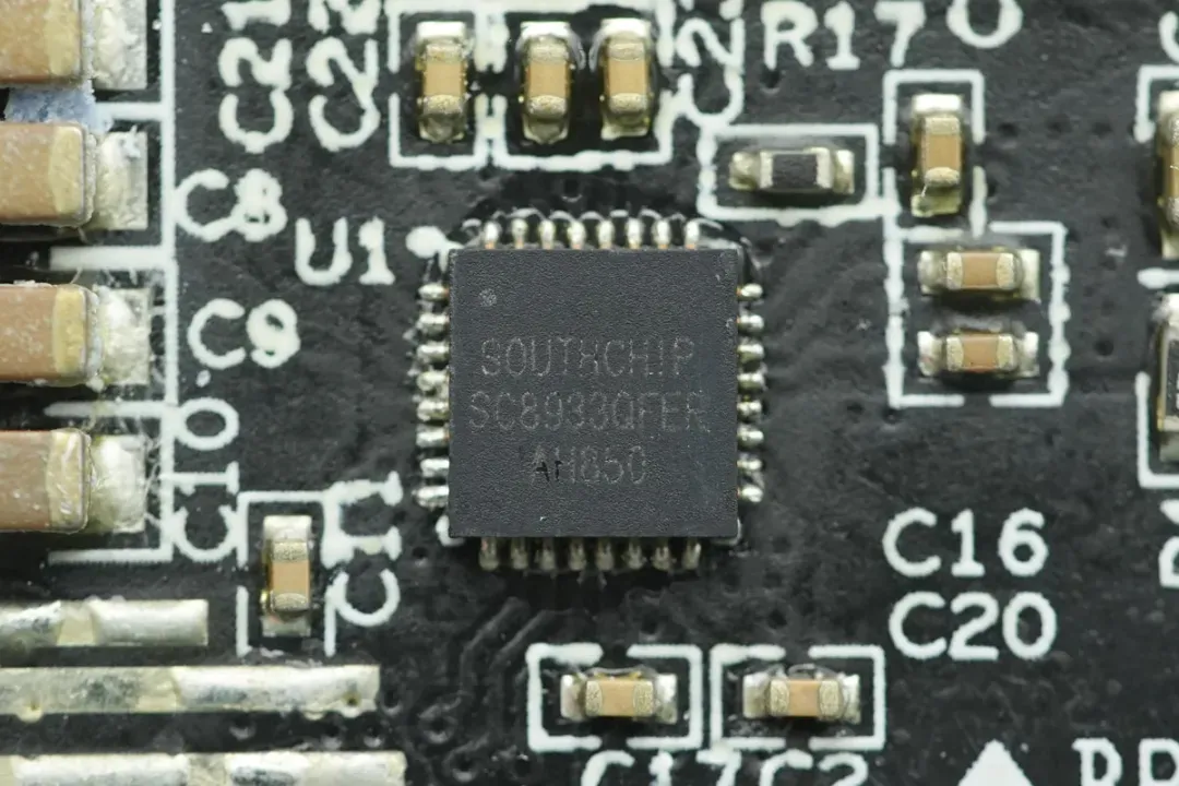

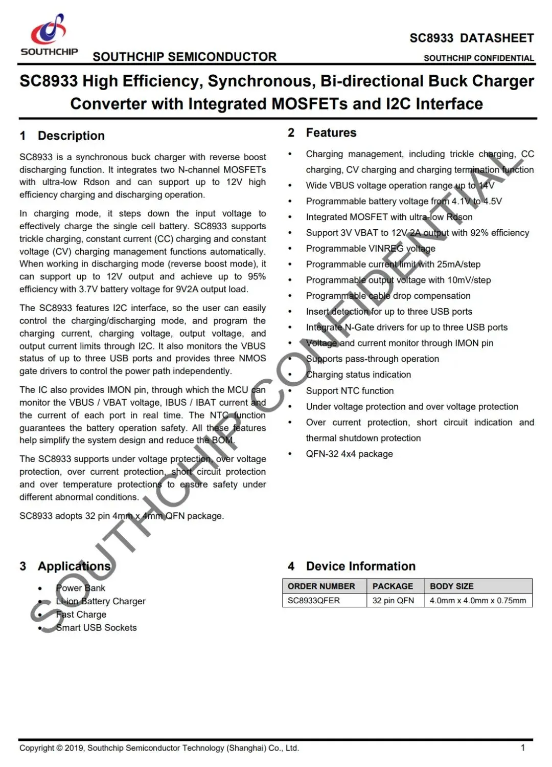

Power banks are getting smaller, faster, and more versatile, putting immense pressure on internal charging and discharging circuitry. Southchip’s SC8933 rises to the challenge as a high-efficiency synchronous bidirectional buck-boost charger. Delivering elite performance in single-cell lithium battery management, it has become the go-to silicon for global giants like Anker, Belkin, Huawei, iQOO, Tesla, UGREEN, and vivo. Packing dual internal NMOSFETs and I²C configuration, it efficiently handles trickle, CC/CV charging, and reverse boost discharging in a fraction of the board space, serving as the ultimate two-way power engine for portable energy.
Southchip SC8933 | The Power Engine Inside Today’s Leading Power Banks-Chargerlab
The SC8933 shines with ultimate flexibility and design footprint. In charge mode, it handles up to 14V VBUS input for precise charge termination. In discharge mode, it truly impresses, hitting up to 95% efficiency (at 9V/2A from a 3.7V battery), easily dominating the 20W to 33W fast-charge sweet spot. It’s also incredibly smart and safe: it supports plug-in detection and independent power path control (N-Gate drivers) for up to three USB ports, alongside an IMON pin for real-time telemetry. Combined with bulletproof hardware protections covering UVLO, OVP, OCP, SCP, and thermal shutdown, the SC8933 slashes external component counts. It is the ultimate highly integrated choice for 5,000mAh–20,000mAh power banks, magnetic wireless chargers, and hybrid wall adapters.
Tear-downs over the years prove the SC8933 isn't just for standard power banks anymore; it’s inside cable-tethered packs, magnetic wireless docks, shared chargers, and smart devices. As fast-charge standards fragment but Type-C connectors unify, highly integrated, two-way power ICs with robust telemetry are defining market winners. Moving forward, as portable storage and smart ecosystems evolve, the SC8933 family will keep driving innovation, helping brands shrink their devices while pushing energy conversion and safety to the absolute limit.
