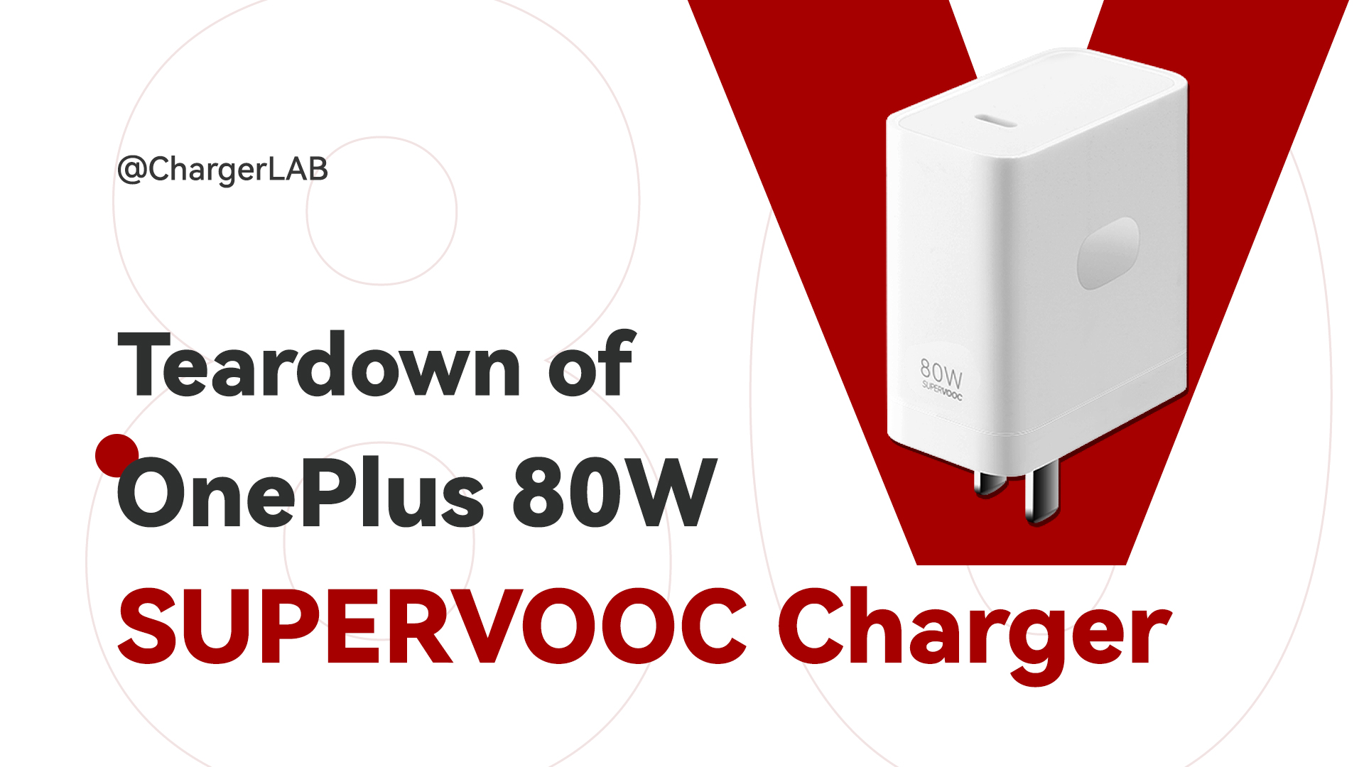

Several days ago, we posted the teardown and review videos of the 100W dual port SuperVOOC charger. Today, we got another SuperVOOC charger, but the output power is a little slower, at 80W. Since it supports the 45W PD protocol, it can charge third-party PD devices. Let's take it apart to see what's inside.
Model: VCB8HBCH
Input Time-delay Fuse: Better Electronics
NTC Thermistor: JOYIN 8S050M
Safety X2 Capacitor: STE
Bridge Rectifier: Yangjie YBSM6010
Electrolytic Capacitor: Koshin
Master Control Chip: ON Semiconductor NCP1342
GaN IC: Navitas NV6134A
Power Capacitor: AiShi
Planar Transformer: Huntkey
Y Capacitor: South HongMing
Optocoupler: EL1019
Synchronous Rectification Controller: MPS MP6908A
Synchronous Rectifier: Pingwei D115N10ESL
Solid Capacitor: PolyCap
Protocol Chip: Injonic IP2736
