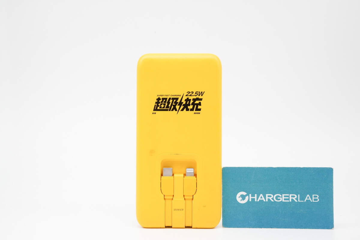

It features a bright yellow casing with a matte finish and rounded corners.

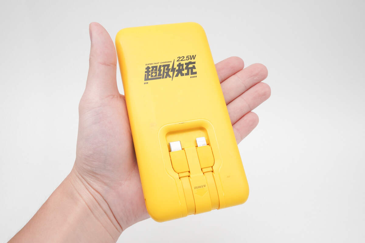

The front is printed with the Meituan logo, safety instructions, and other notices.

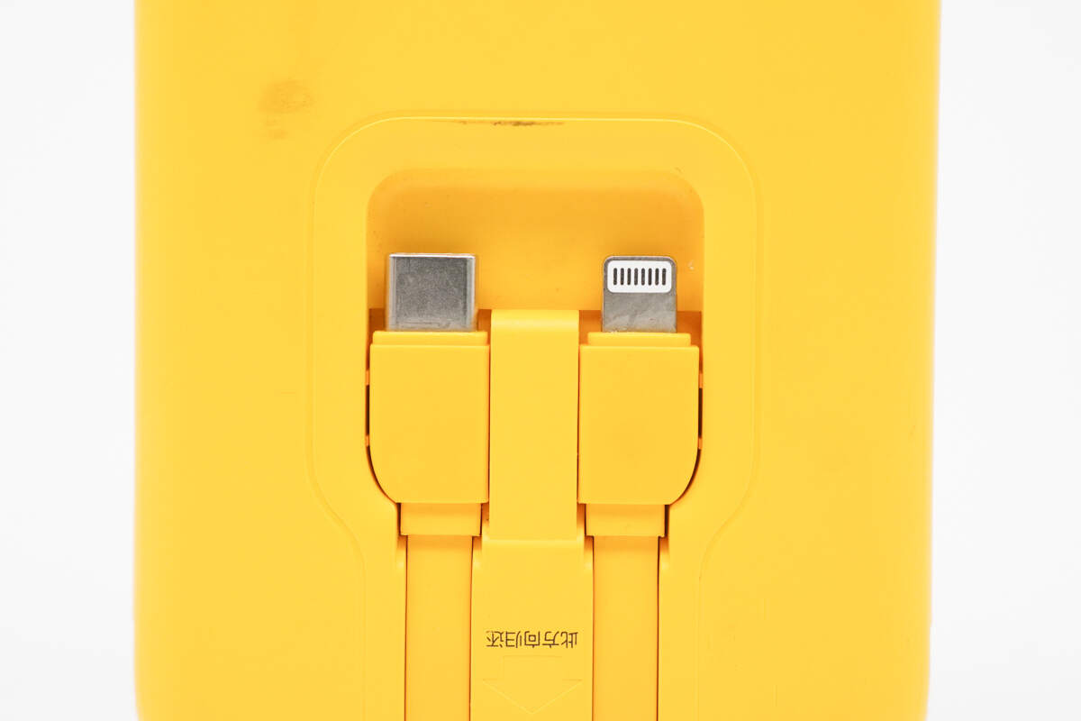

Teardown of Meituan 7000mAh 22.5W Shared Power Bank (MT-D-7BDY0)-Chargerlab

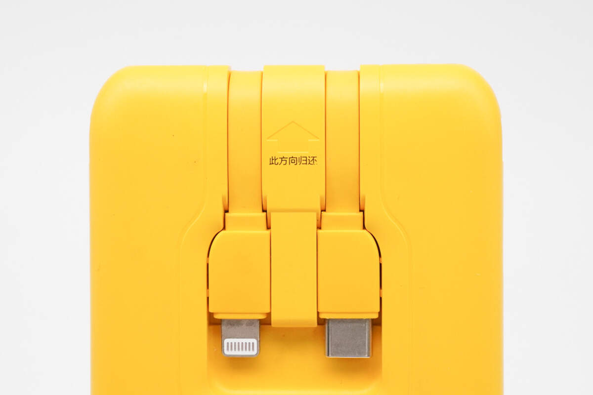

At the bottom, there are two built-in short cables with corresponding storage slots and return guide arrows.
The built-in cables are USB-C and Lightning.

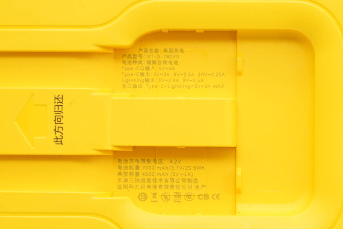

Model: MT-D-7BDY0
Battery Type: Lithium Polymer Battery
Battery Charging Limit Voltage: 4.2V
Battery Energy: 7000mAh / 3.7V / 25.9Wh
Typical Capacity: 4600mAh (5V 1A)
Type-C Input: 5V 3A
Type-C Output: 5V 3A, 9V 2.5A, 10V 2.25A
Lightning Output: 5V 2.4A, 9V 2.5A
Multi-Port Output:
Type-C + Lightning: 5V 3A MAX
Certified: CCC, CB, CE

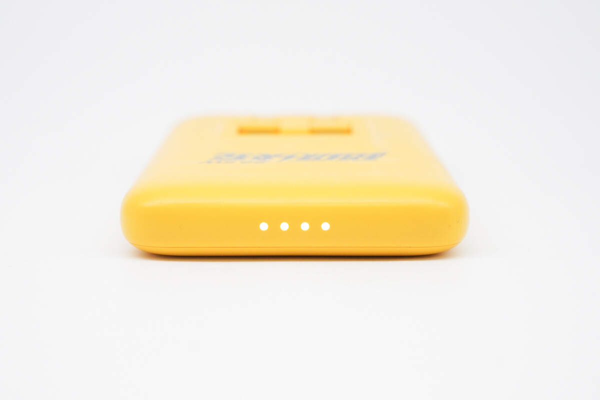

There are four LED battery indicator lights on the top.

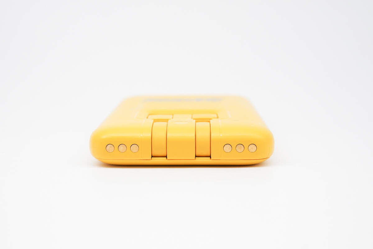

There are charging contact points on both sides of the opposite end.

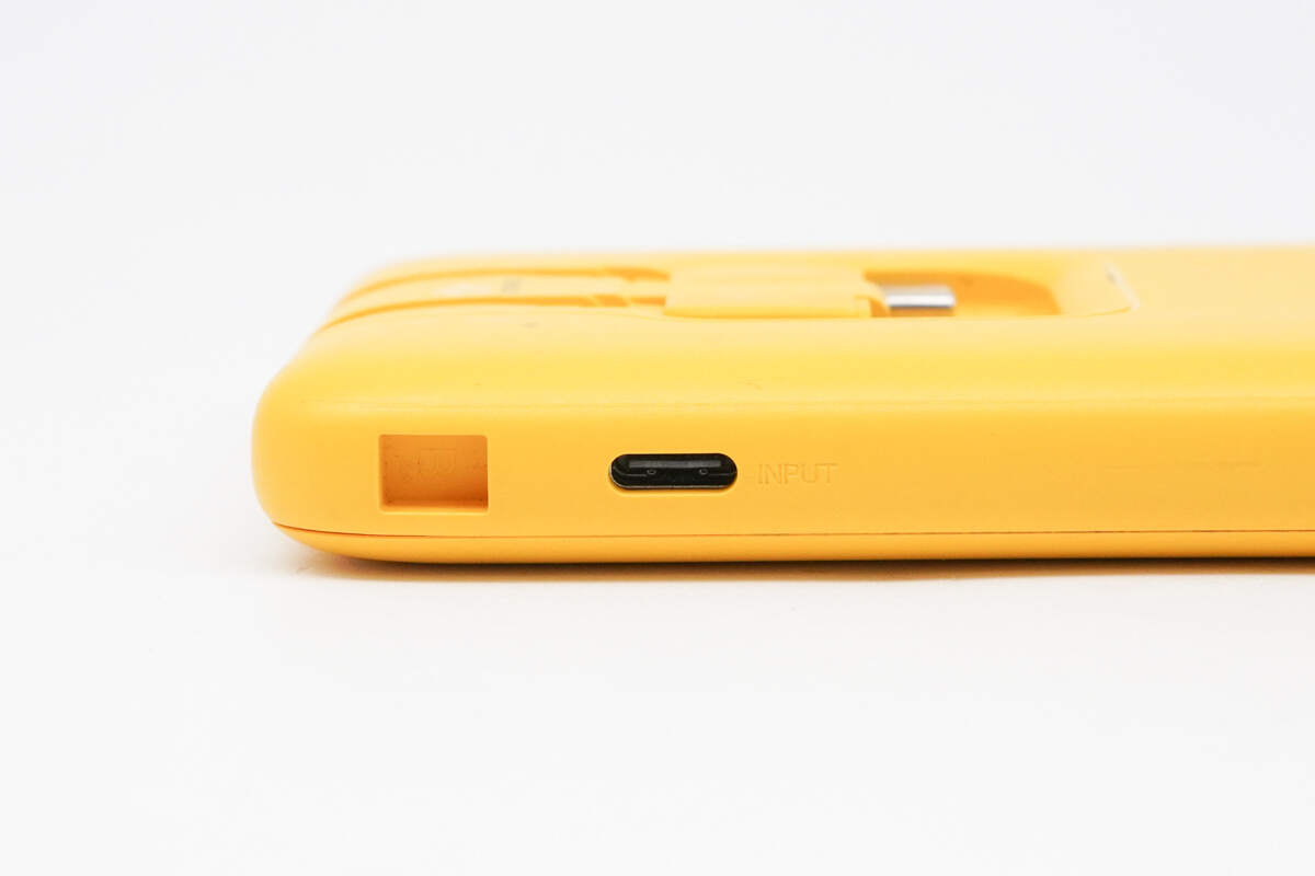

There are locking slots on both sides of the body. This side also features a USB-C input port.

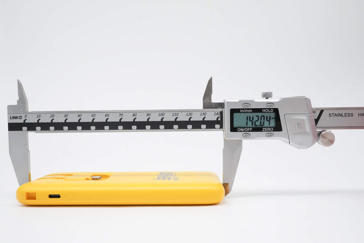

The length of the power bank is about 142.04 mm (5.59 inches).

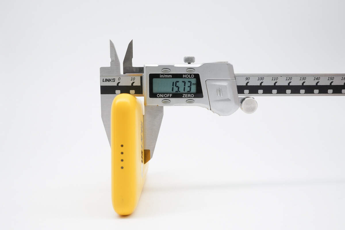

The thickness is about 15.73 mm (0.62 inches).

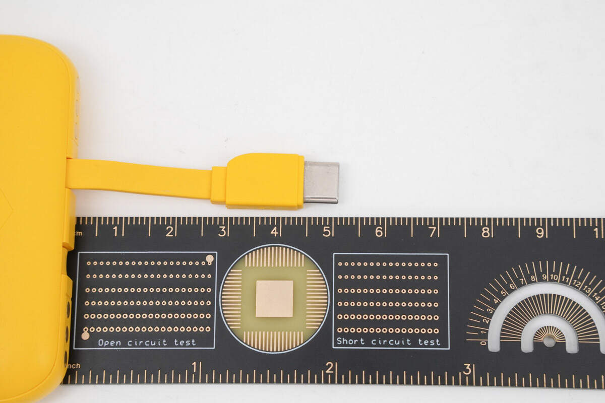

The length of the USB-C cable is about 5 cm (1.97 inches).

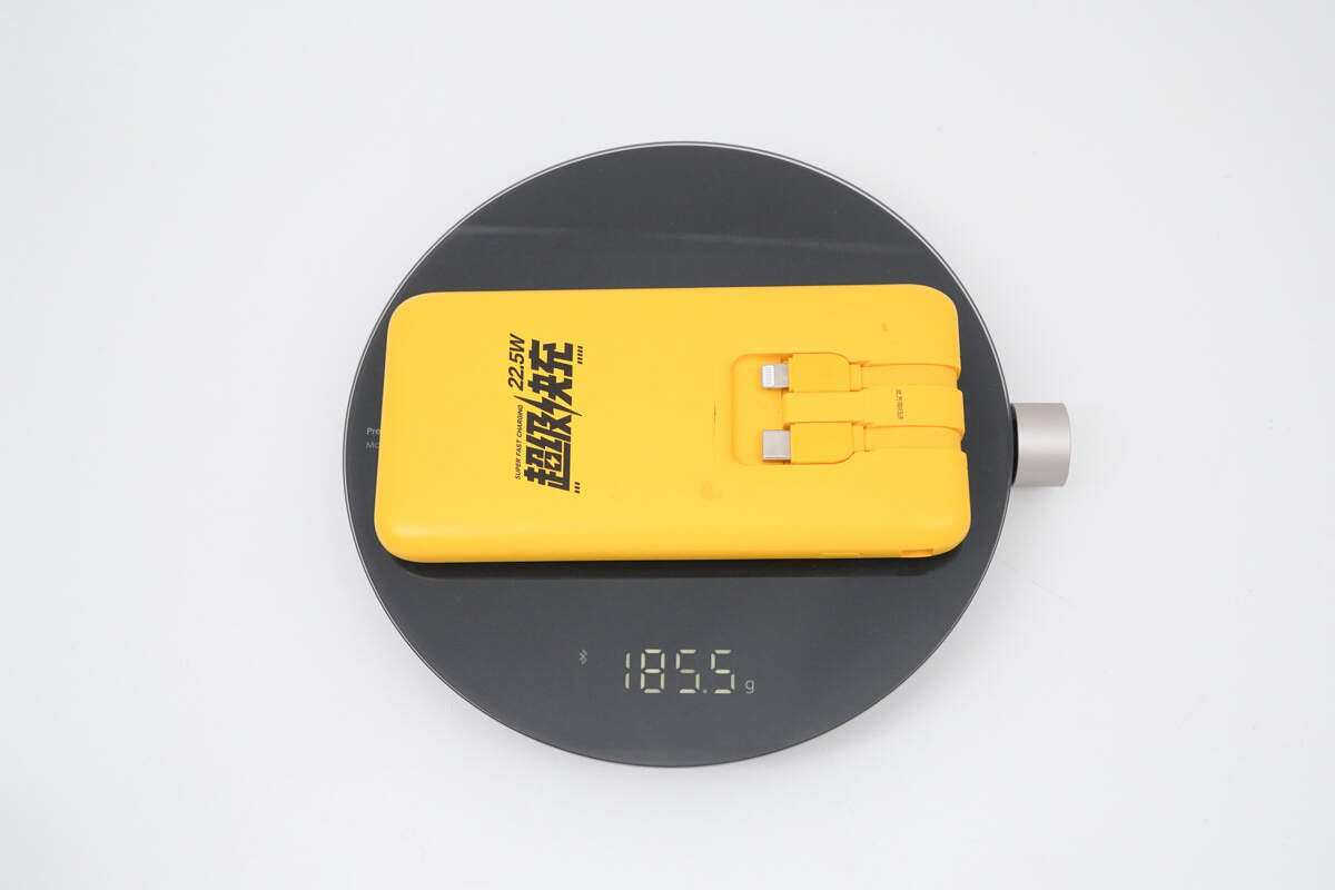

The weight is about 186 g (6.56 oz).

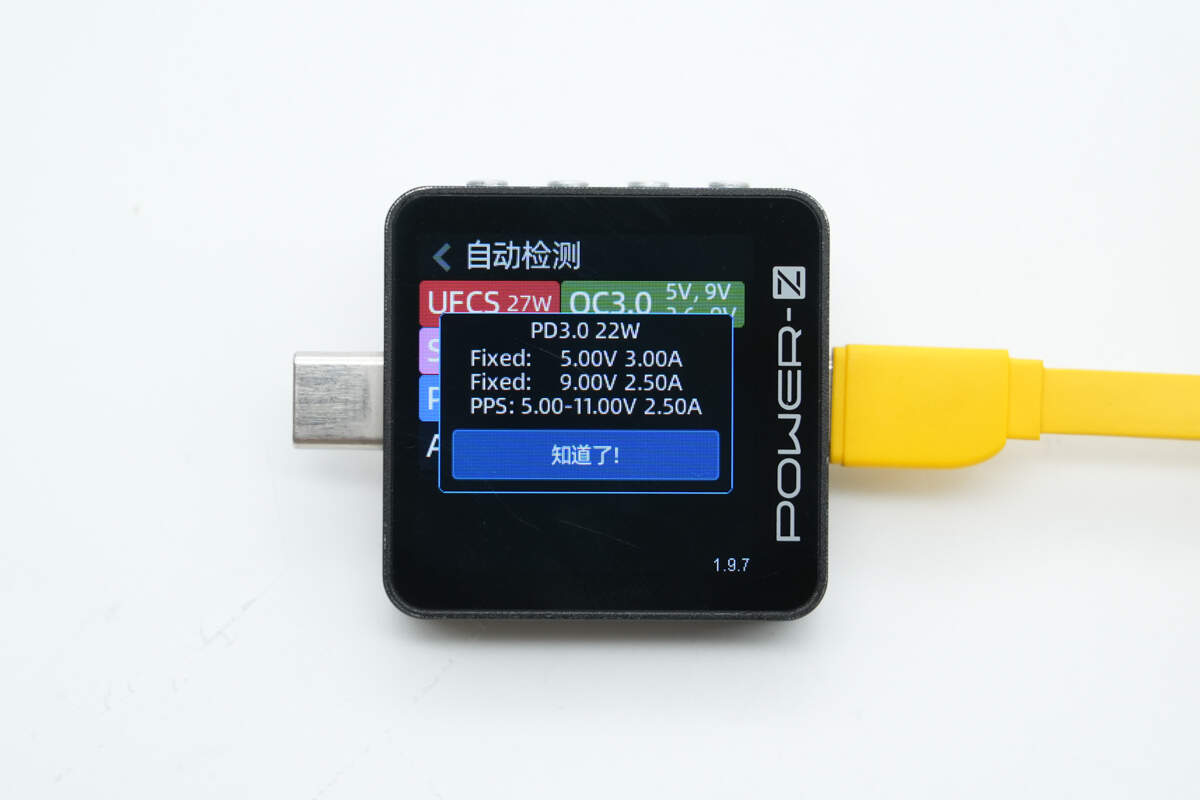

ChargerLAB POWER-Z KM003C shows that the USB-C cable supports UFCS, QC3.0, SCP, PD3.0, DCP, and Apple 2.4 charging protocols.
And it has two fixed PDOs of 5V3A and 9V2.5A. It has one set of PPS, which is 5-11V2.5A.

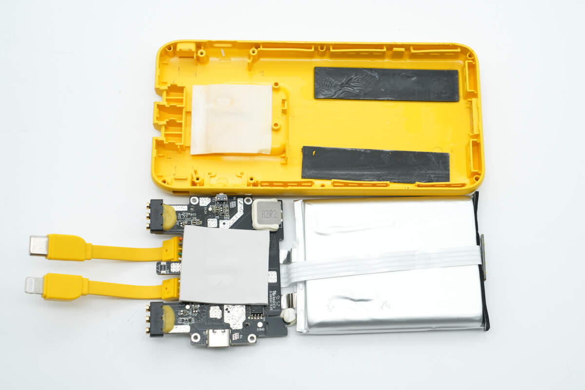

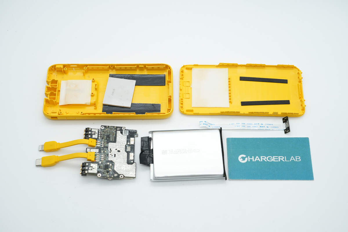

After unclipping the snap-on casing, protective foam padding is found on the inside.
The PCB is secured with screws.
The solder joints on the cores of the two built-in cables are solid and well-made.
The battery cell is connected to the PCB via nickel strip spot welding. The LED indicator lights are connected to the PCB via a ribbon cable.
After removing the PCB and battery cell, protective foam and padding can be seen inside. A thermal pad is attached to the other side of the PCB.

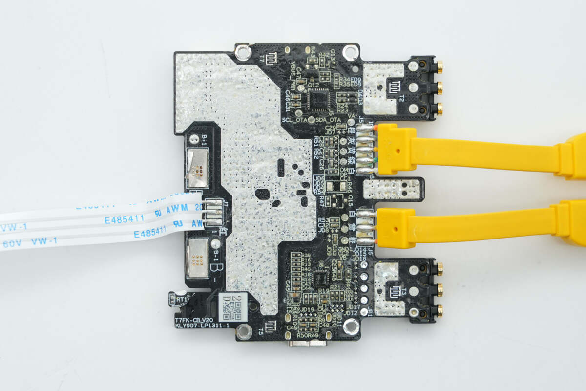

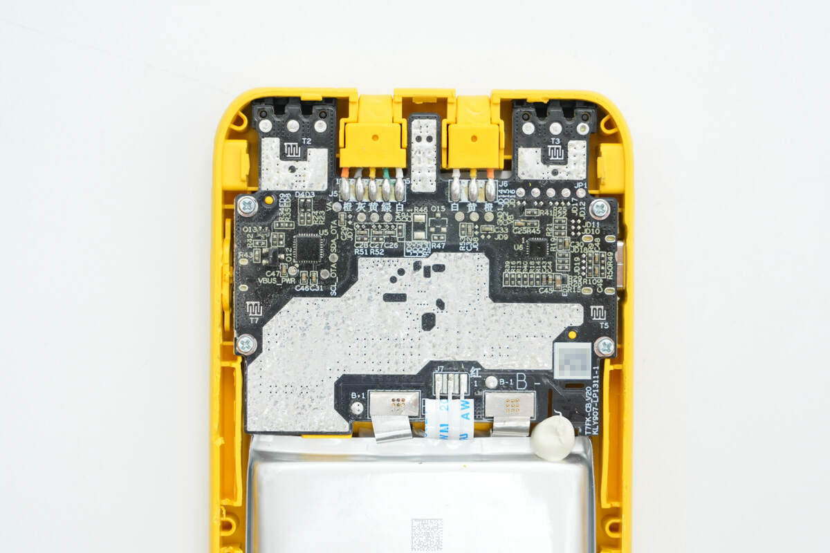

The front side of the PCB features a large area of exposed copper with added solder to enhance heat dissipation. It also includes a protocol chip and an MCU.
The other side houses a lithium battery protection chip, a synchronous buck converter, an inductor, and three VBUS MOSFETs.

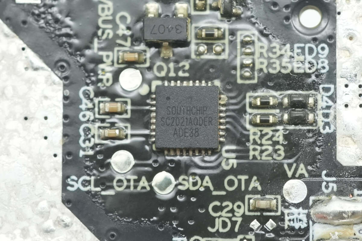

The protocol chip is the SouthChip SC2021A, a highly integrated Type-C/PD and DPDM fast charging controller. It complies with the latest Type-C and PD 3.0 standards and has passed USB PD 3.1 compliance testing.
The chip supports proprietary high-voltage fast charging protocols and includes one USB-C interface along with two DPDM interfaces, making it suitable for dual-port fast charging applications (1A + 1C).

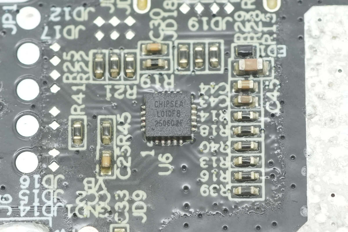

The MCU is the Chipsea CS32L010F8, a 32-bit low-power microcontroller based on the ARM Cortex-M0 core. It operates at a maximum frequency of 24 MHz and features 64 KB of embedded Flash memory and 4 KB of SRAM. The chip comes in a QFN-20 package.

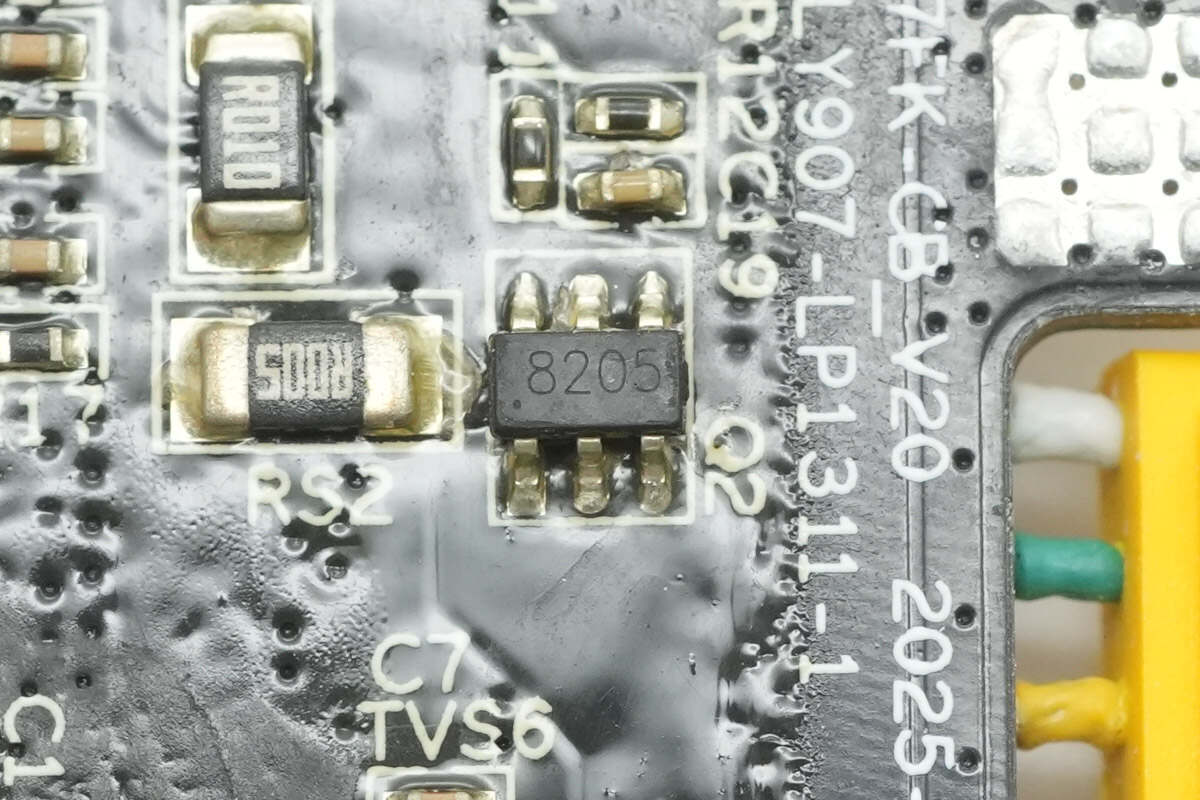

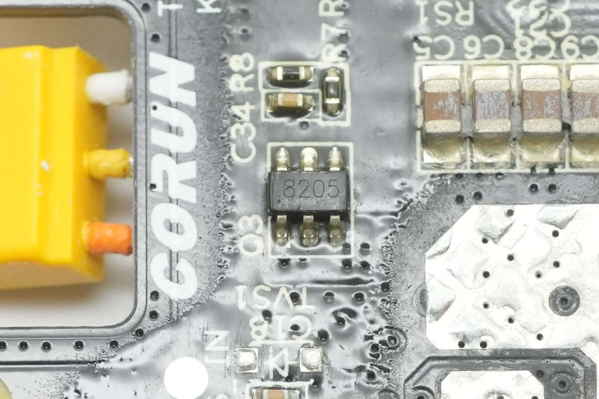

The VBUS MOSFET for the Lightning cable output is marked with 8205.
The VBUS MOSFET for the USB-C cable output has the same part number.

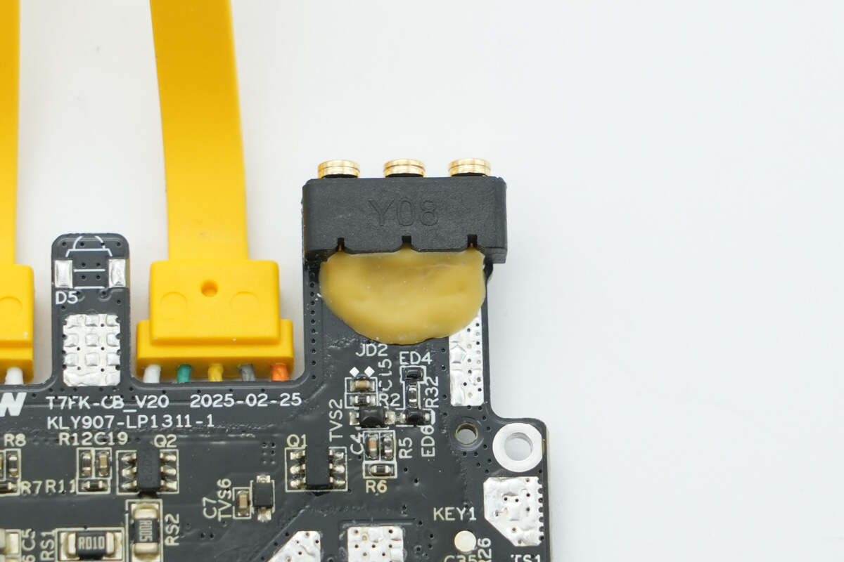

The VBUS MOSFET at the charging contact points also has the same part number.
The charging contact points are gold-plated, and the base is reinforced with adhesive.

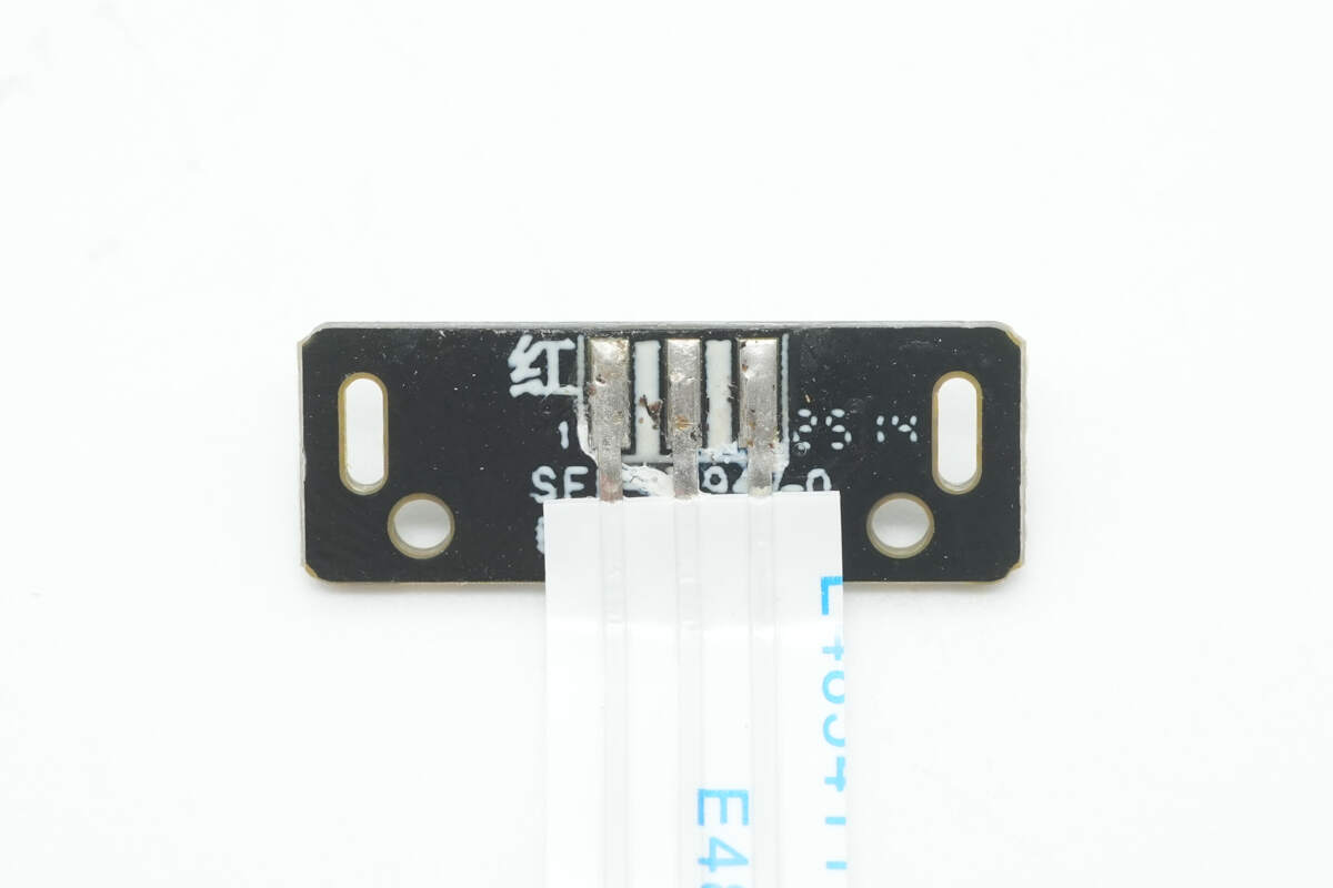

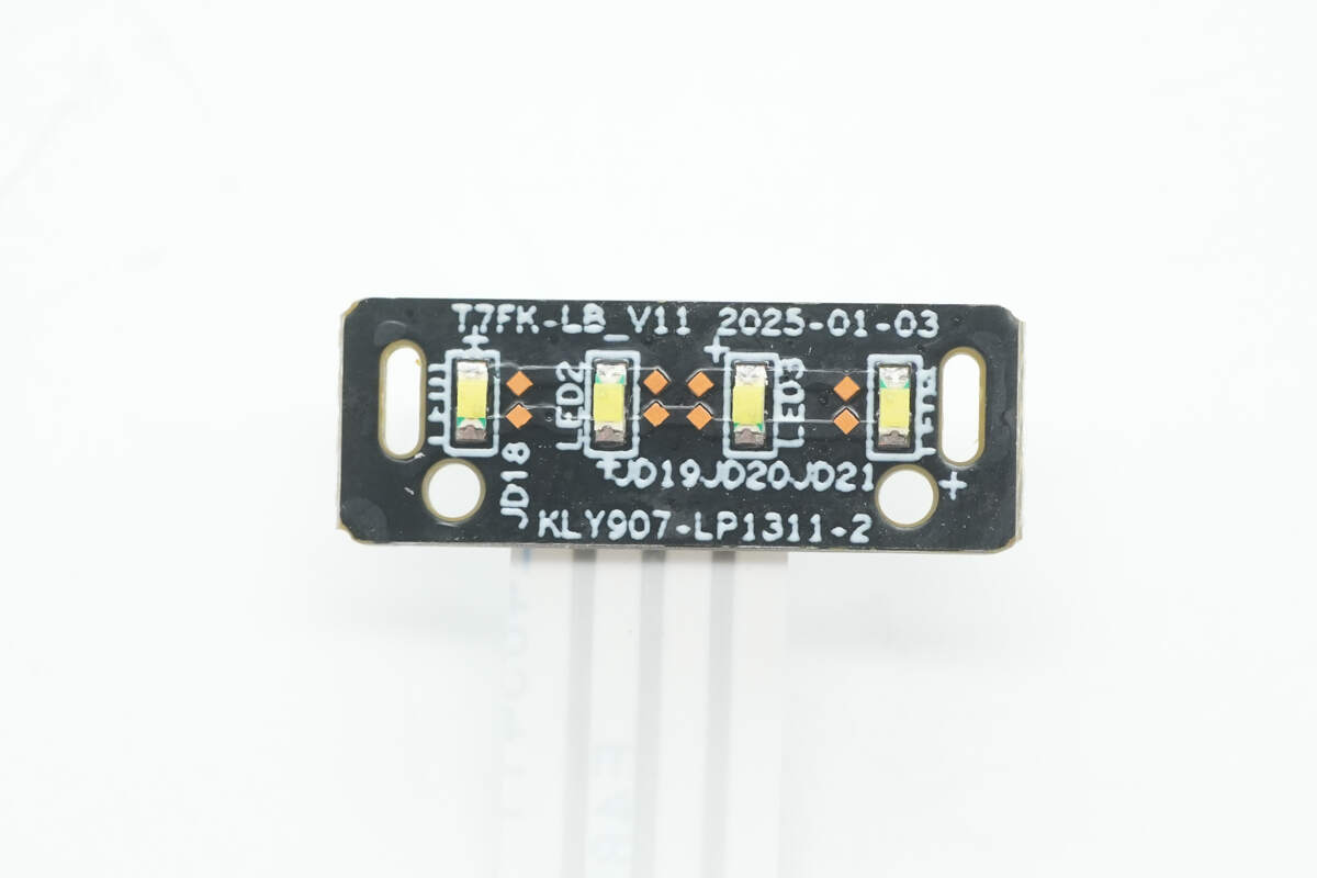

The PCB for the LED battery indicators features cutouts on both sides.
There are no components on the back side.
