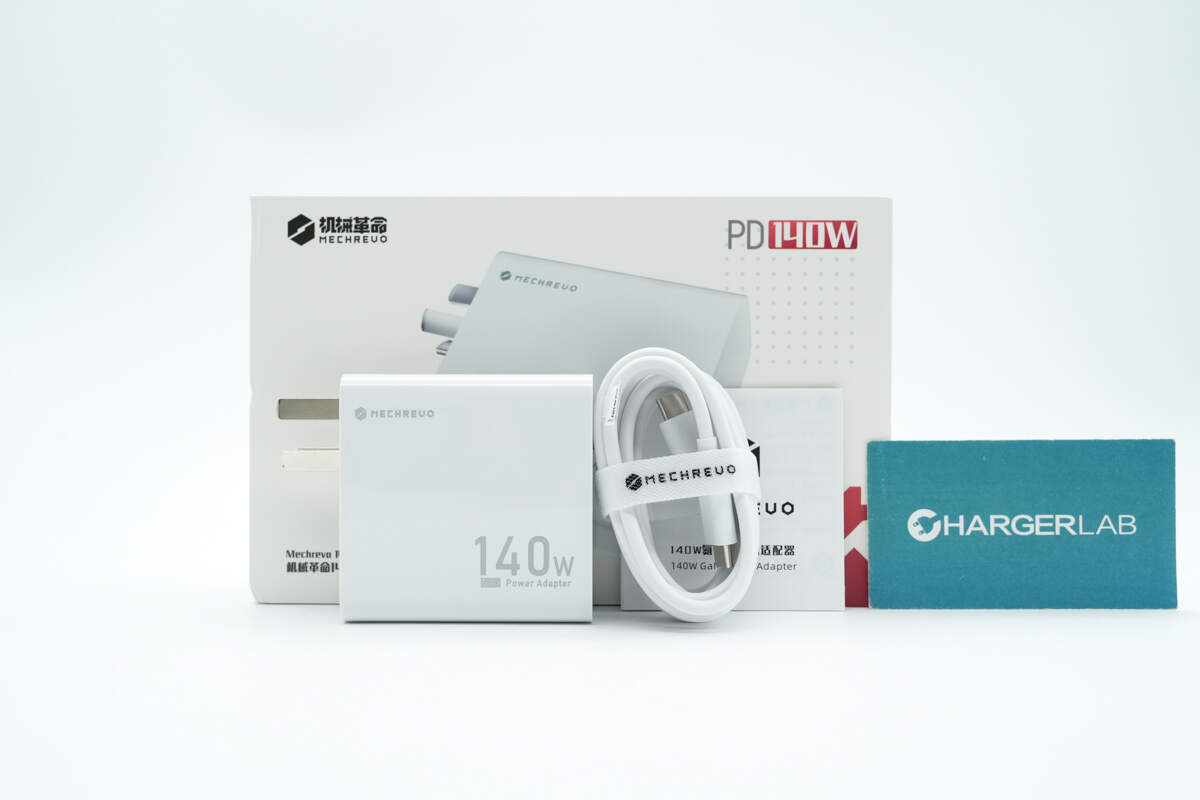

The package includes the charger, a cable, and a user manual.
Teardown of MECHREVO 140W USB-C GaN Power Adapter (AY140AA-1C-CH)-Chargerlab

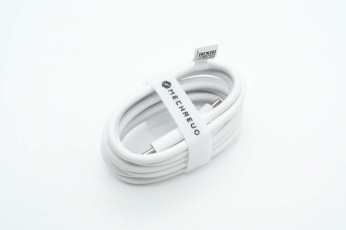

The included cable is secured with a MECHREVO-branded Velcro strap.

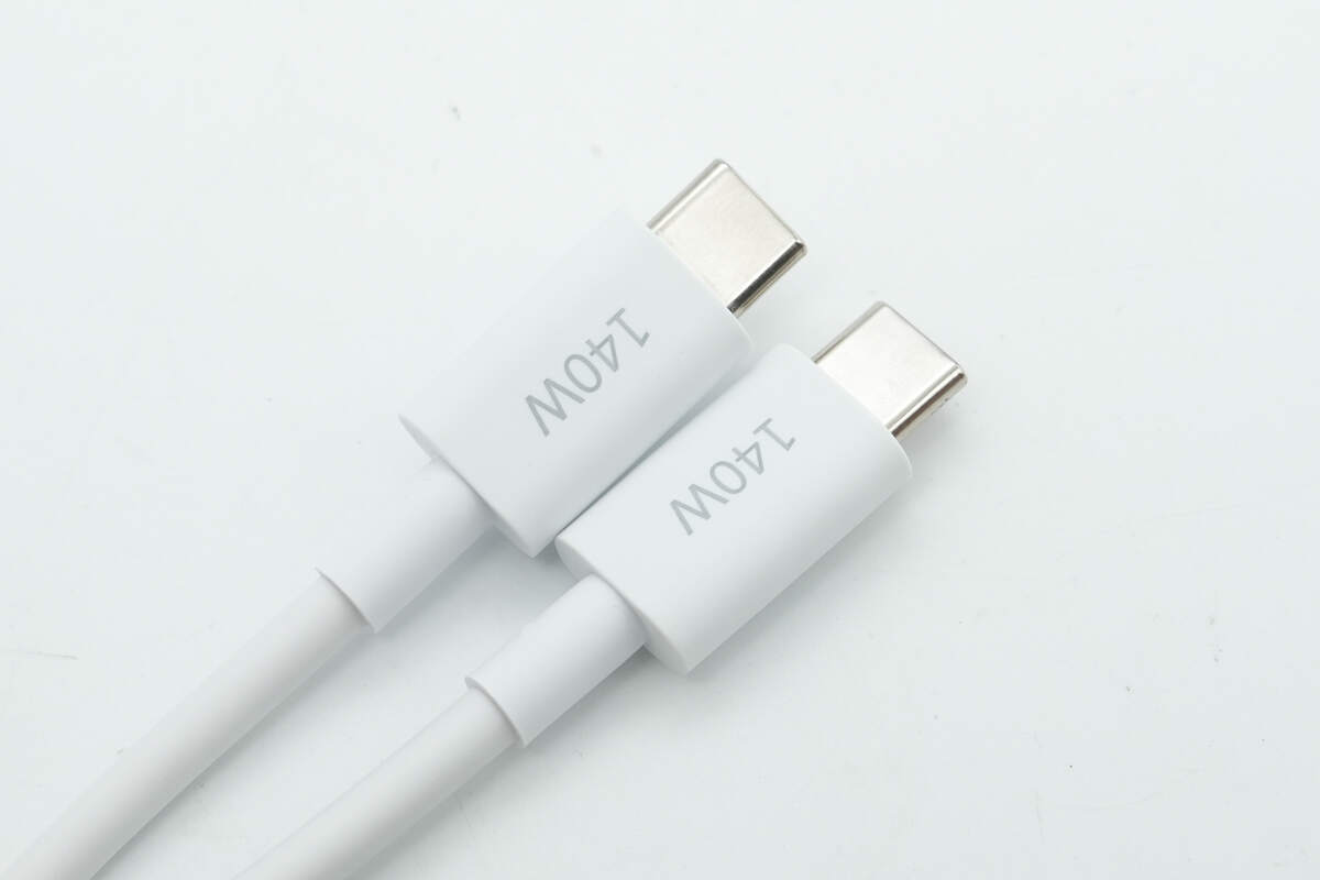

The cable is a dual USB-C type, with “140W” printed on the connectors.

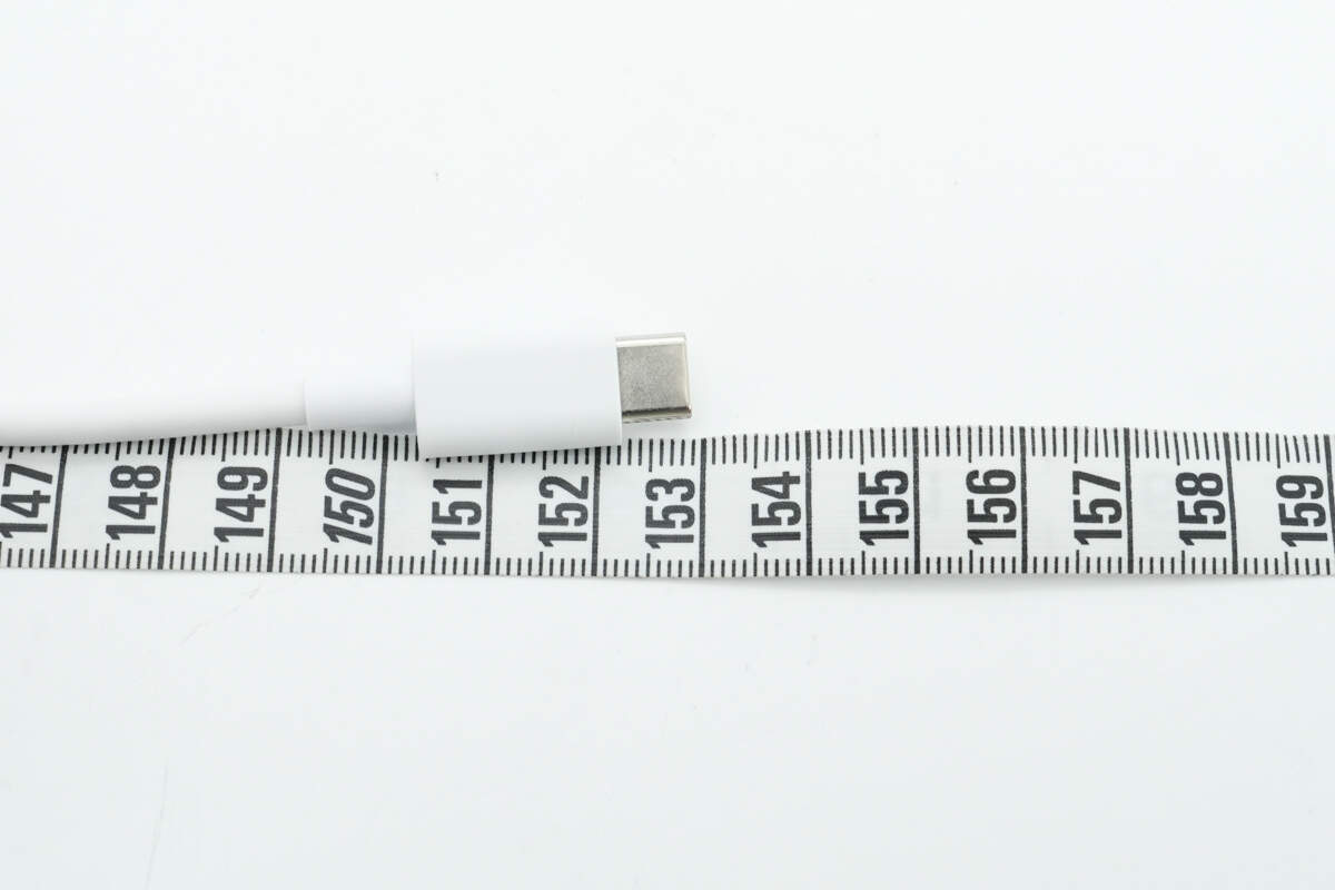

The length of the cable is about 153 cm (60.24 inches).

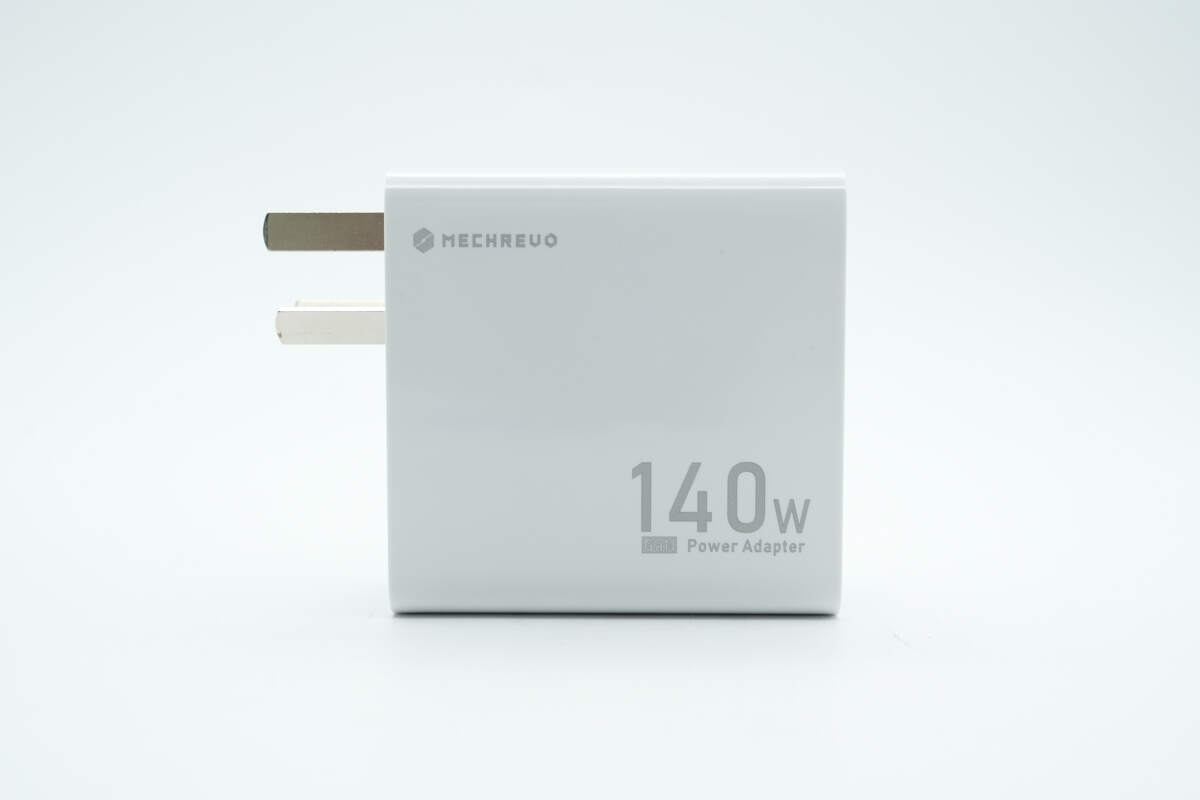

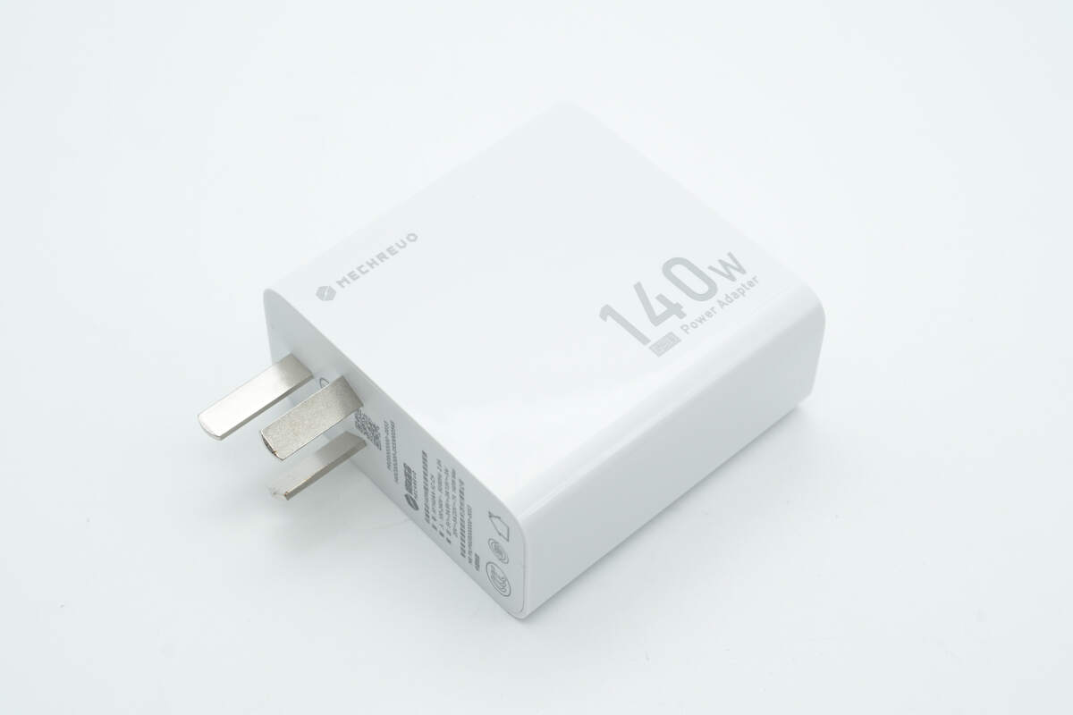

The charger housing is made of flame-retardant PC material with a smooth surface.
The front is printed with “MECHREVO” and “140W GaN Power Adapter.”

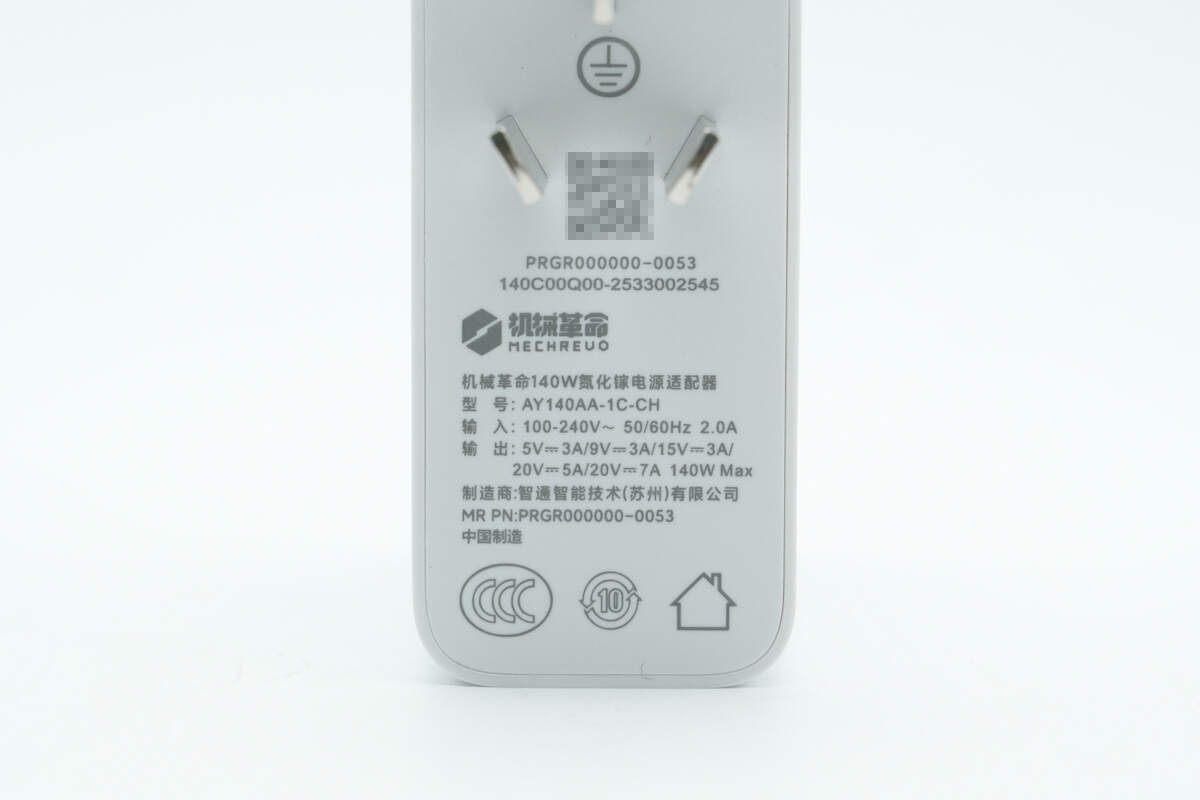

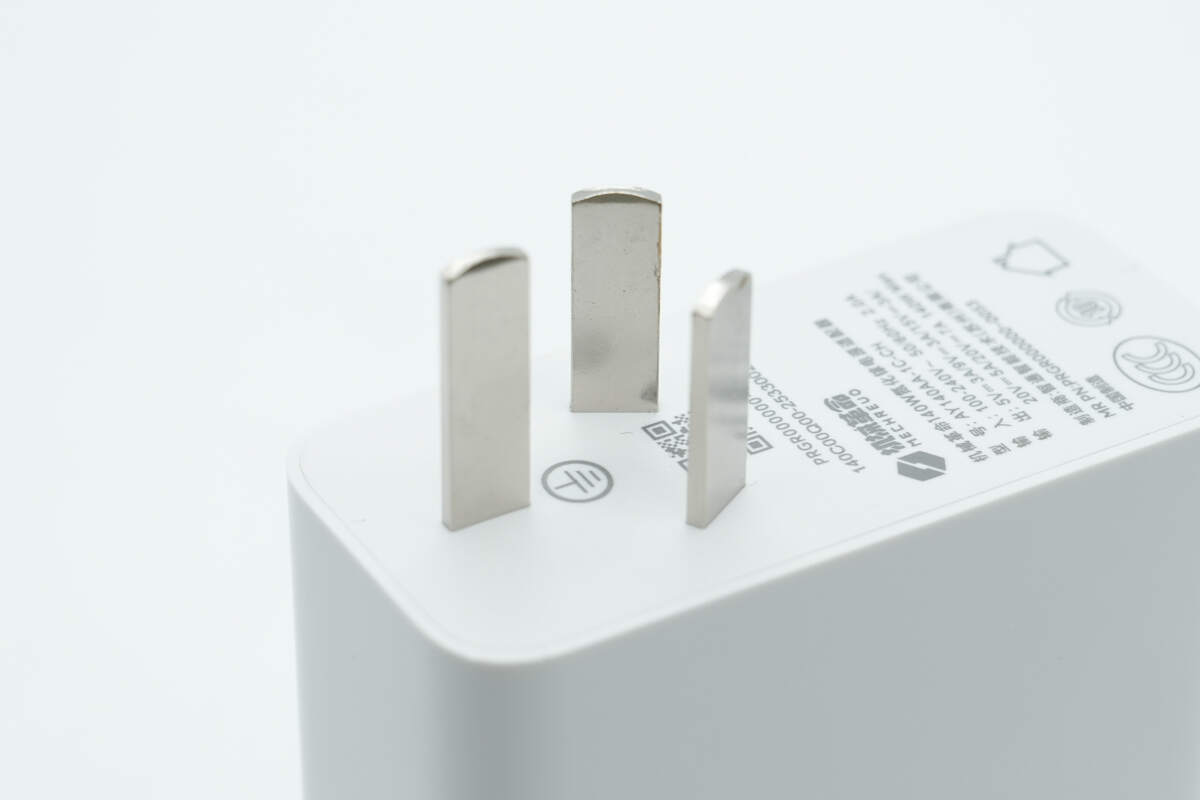

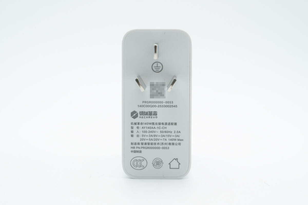

The input housing is printed with the specification information.
Model: AY140AA-1C-CH
Input: 100-240V\~50/60Hz 2.0A
Output: 5V 3A, 9V 3A, 15V 3A, 20V 5A, 20V 7A 140W Max
PPS: 3.3-21V 5A 100W Max
The charger is CCC certified.
It is equipped with a fixed plug.

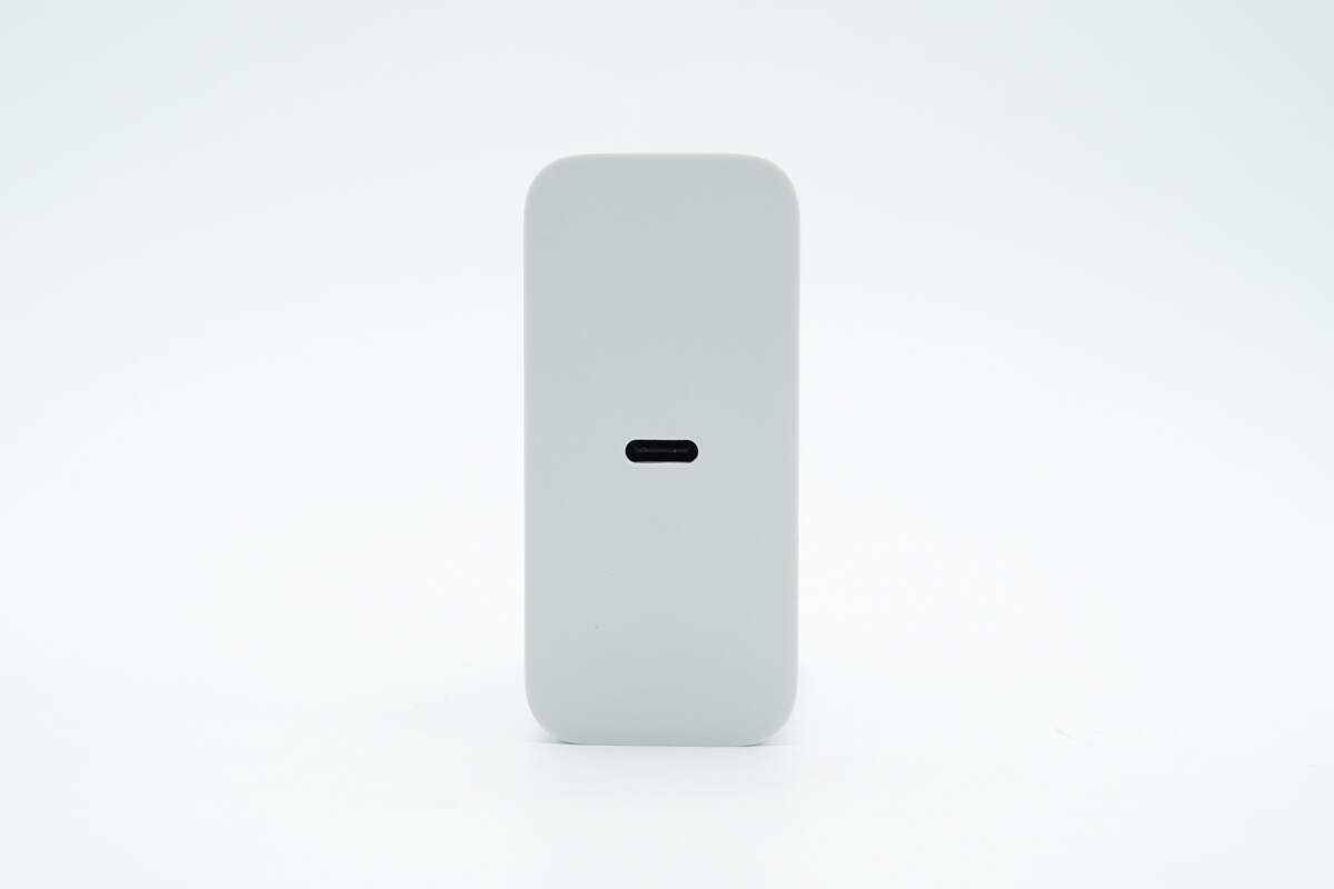

The output USB-C port is centered.

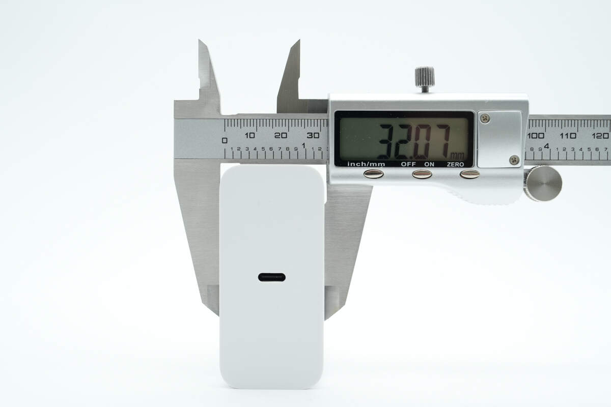

The length of the charger is about 69.25 mm (2.73 inches).

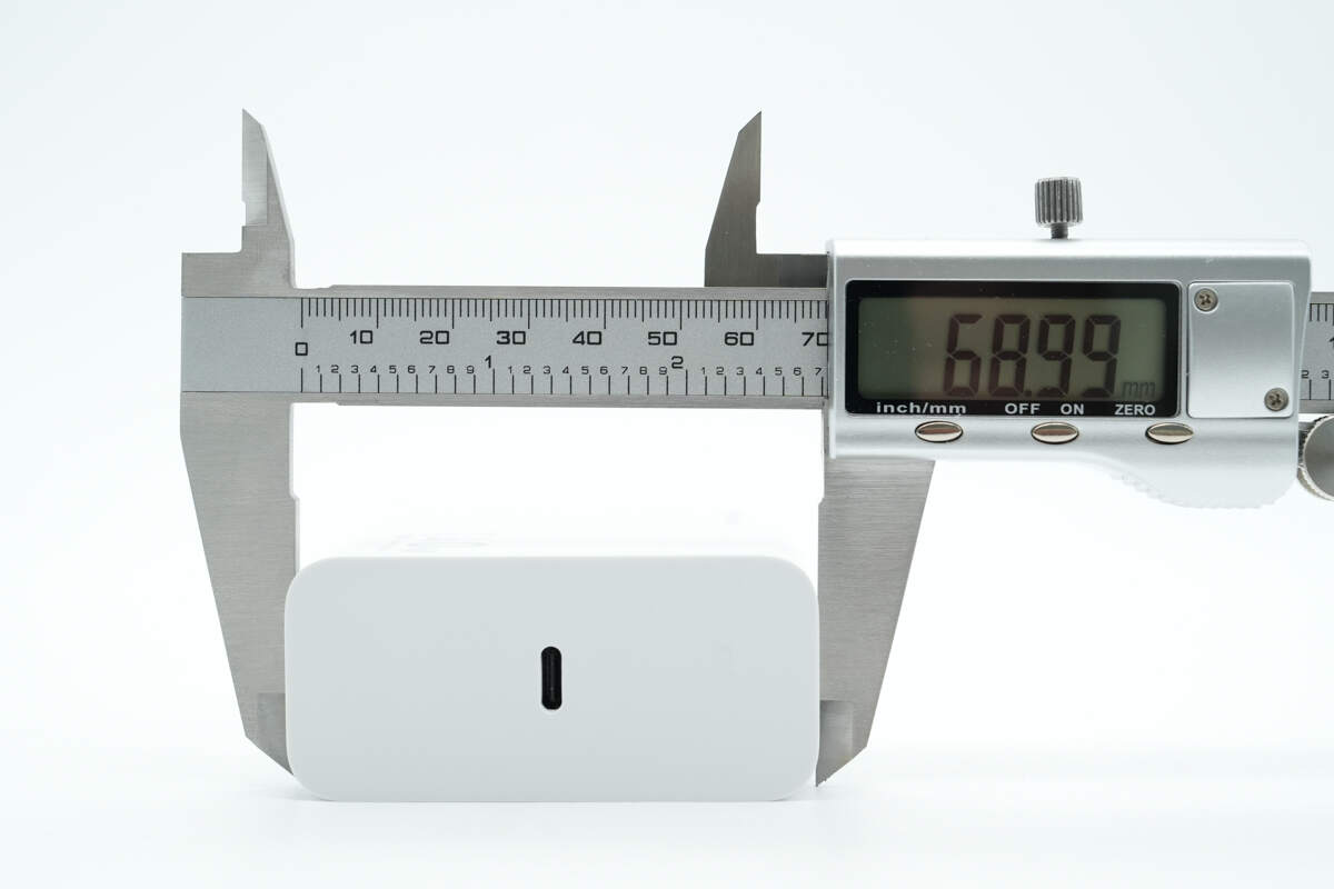

The width is about 68.99 mm (2.72 inches).
The thickness is about 32.07 mm (1.26 inches).

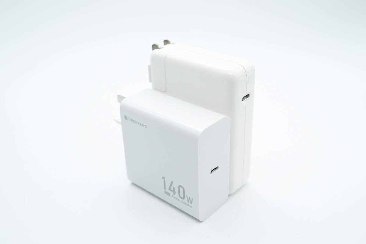

It is slightly smaller in size than the Apple 140W charger.

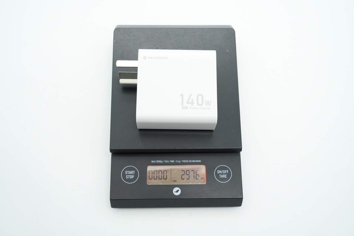

The weight is about 298 g (10.51 oz).

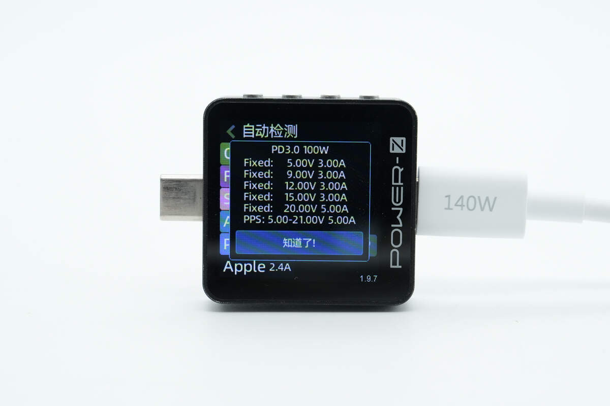

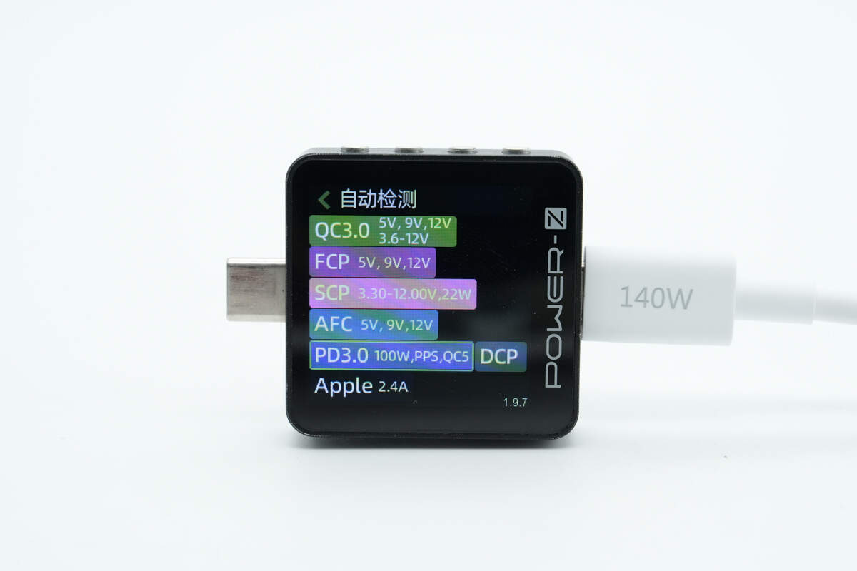

ChargerLAB POWER-Z KM003C shows that it supports QC3.0/5, FCP, SCP, AFC, PD3.0, PPS, DCP, and Apple 2.4A charging protocols.
And it has five fixed PDOs of 5V3A, 9V3A, 12V3A, 15V3A, and 20V5A. It has one set of PPS, which is 5-21V5A.

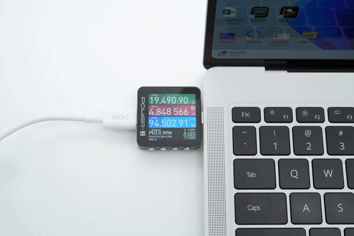

When used to charge the Huawei MateBook X Pro, the charging power is about 94.5W, successfully activating the 20V/5A 100W charging protocol.

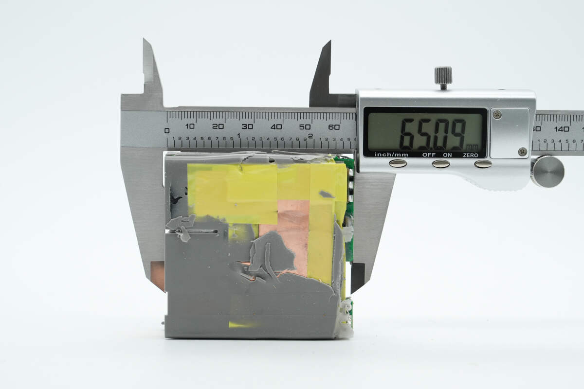

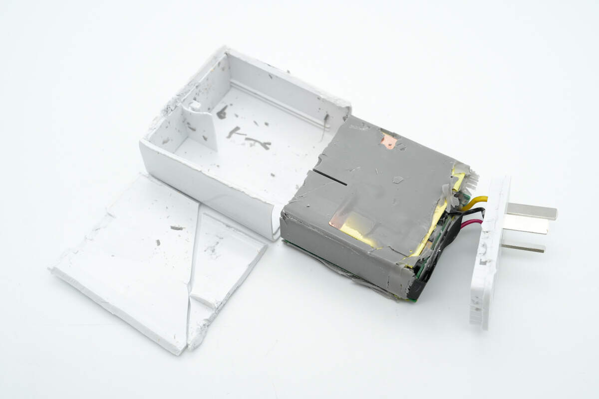

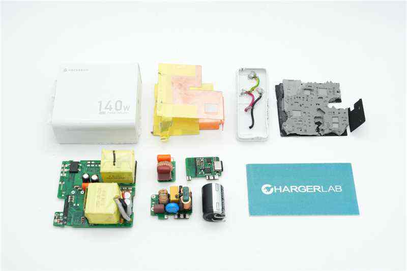

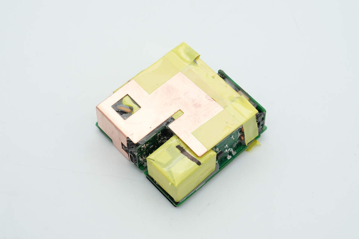

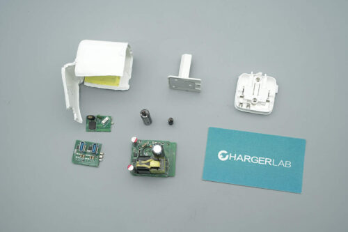

Cut open the housing and remove the PCBA module. The module is encapsulated with potting compound to improve weather resistance and heat dissipation. The input pins are soldered to the PCBA using wires.

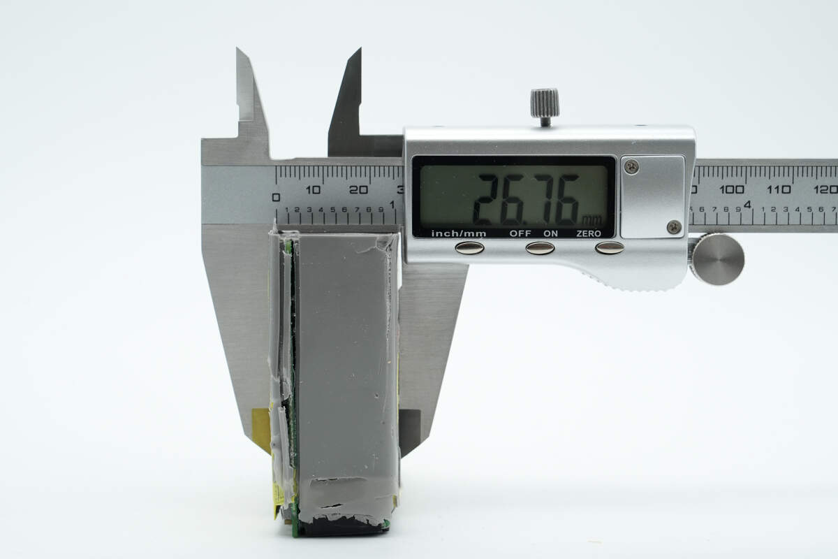

The PCBA module measures approximately 65.09 mm (2.56 inches) in both length and width.
The thickness is about 26.76 mm (1.054 inches).

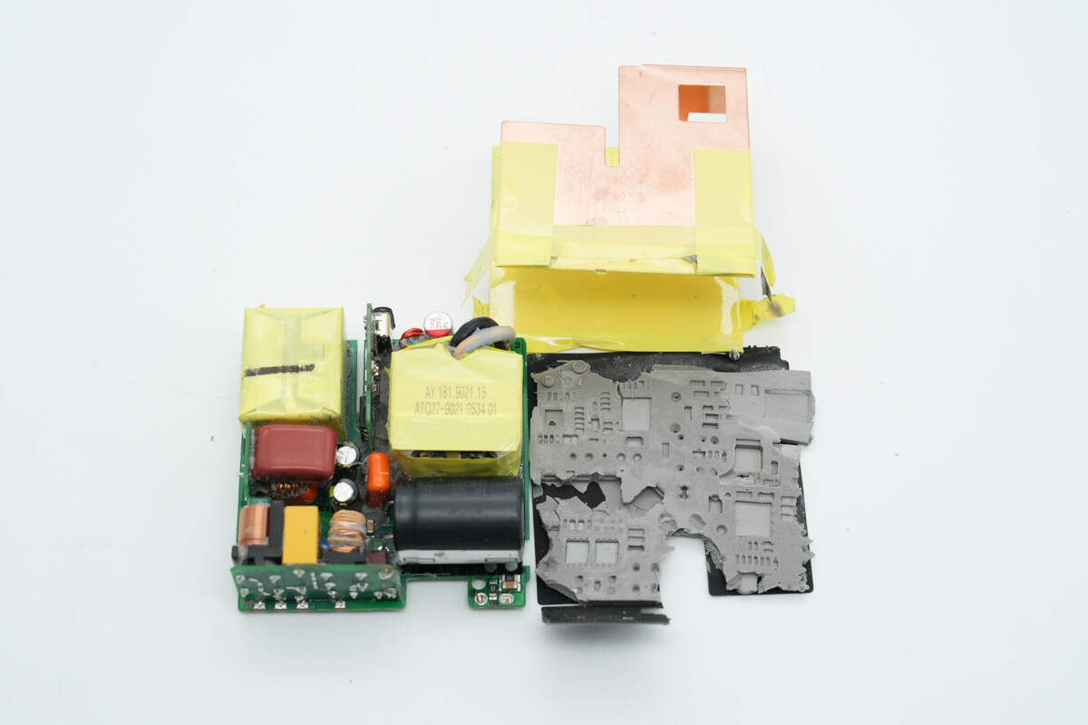

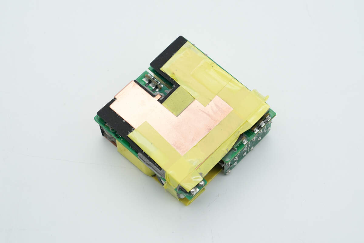

Remove the thermal compound from the PCBA module. The top side of the PCBA is covered with a copper heatsink.
The bottom side is also covered with a copper heatsink, insulated with a Mylar sheet.
After removing the copper heatsinks and Mylar sheet, it’s revealed that the heatsinks on both sides are part of an integrated one-piece design.
The front side of the PCBA module features three separate small PCBs, which are used for mounting the time-delay fuse, common mode chokes, film capacitors, and the USB-C socket.

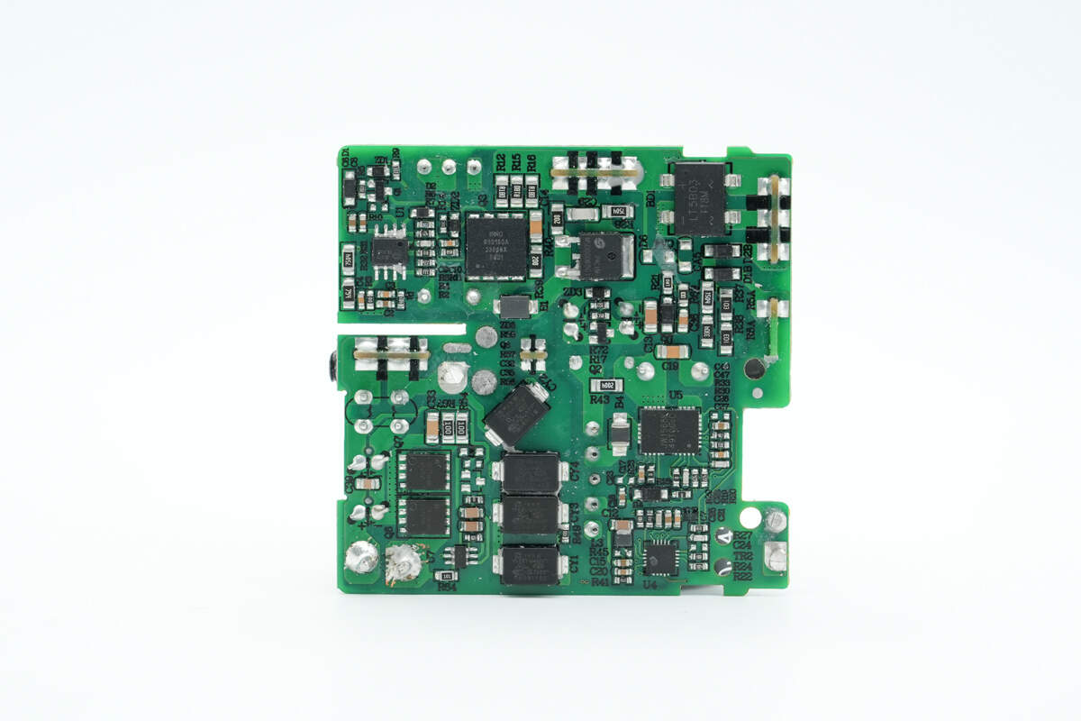

The upper area on the back side houses the bridge rectifiers, PFC controller, PFC boost MOSFET, and PFC rectifier. The lower area contains the master control chip along with the corresponding power MOSFETs, as well as four SMD Y-capacitors.

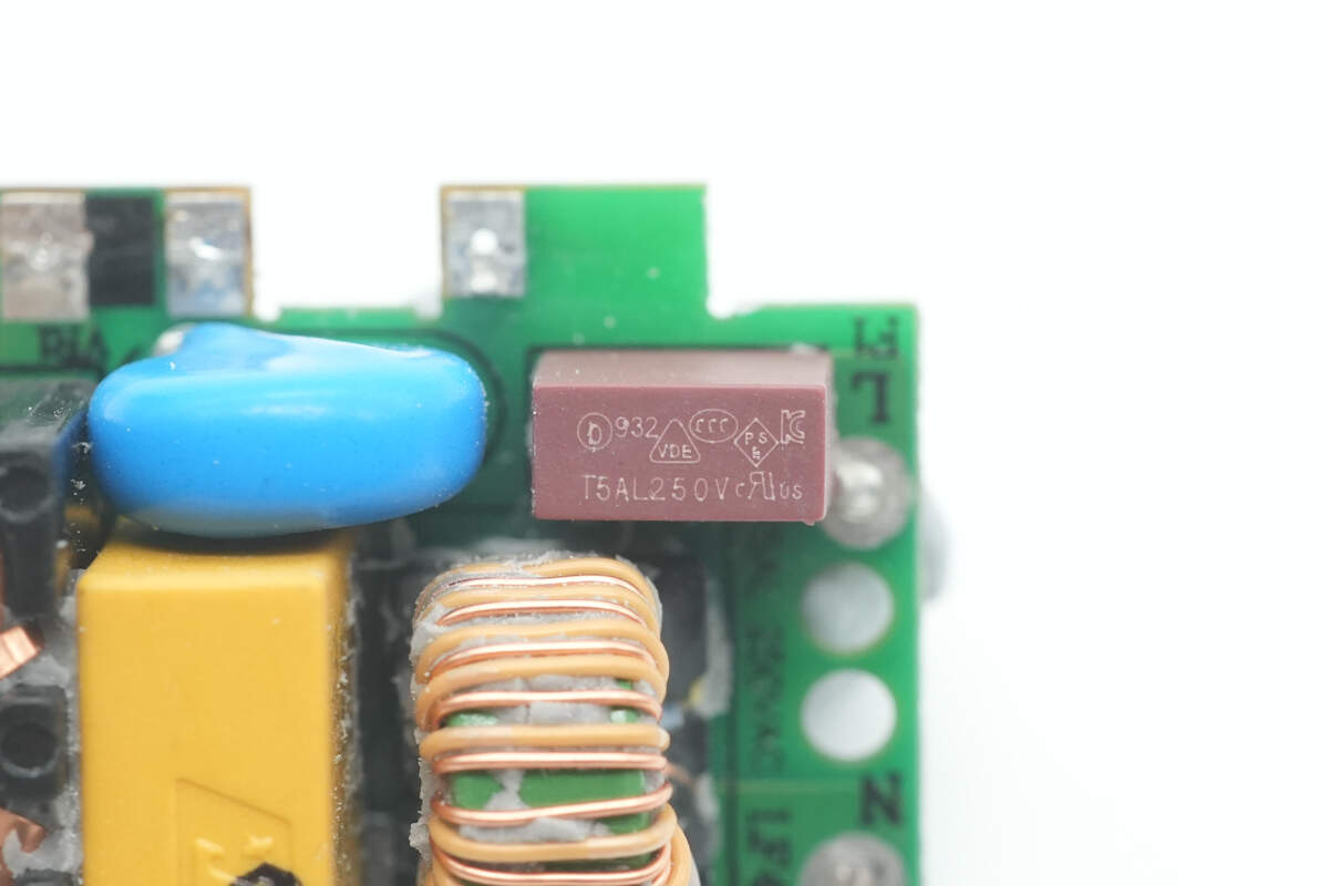

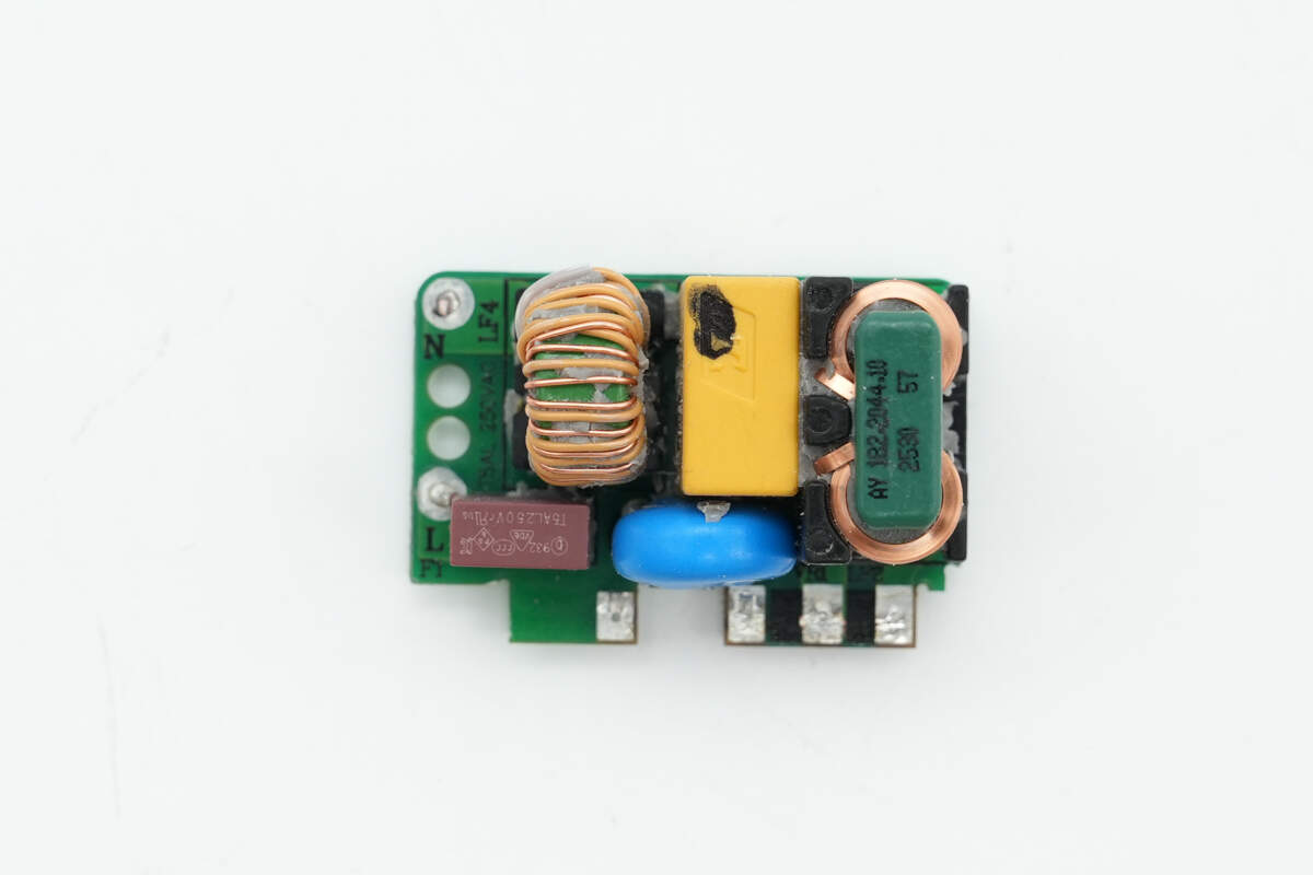

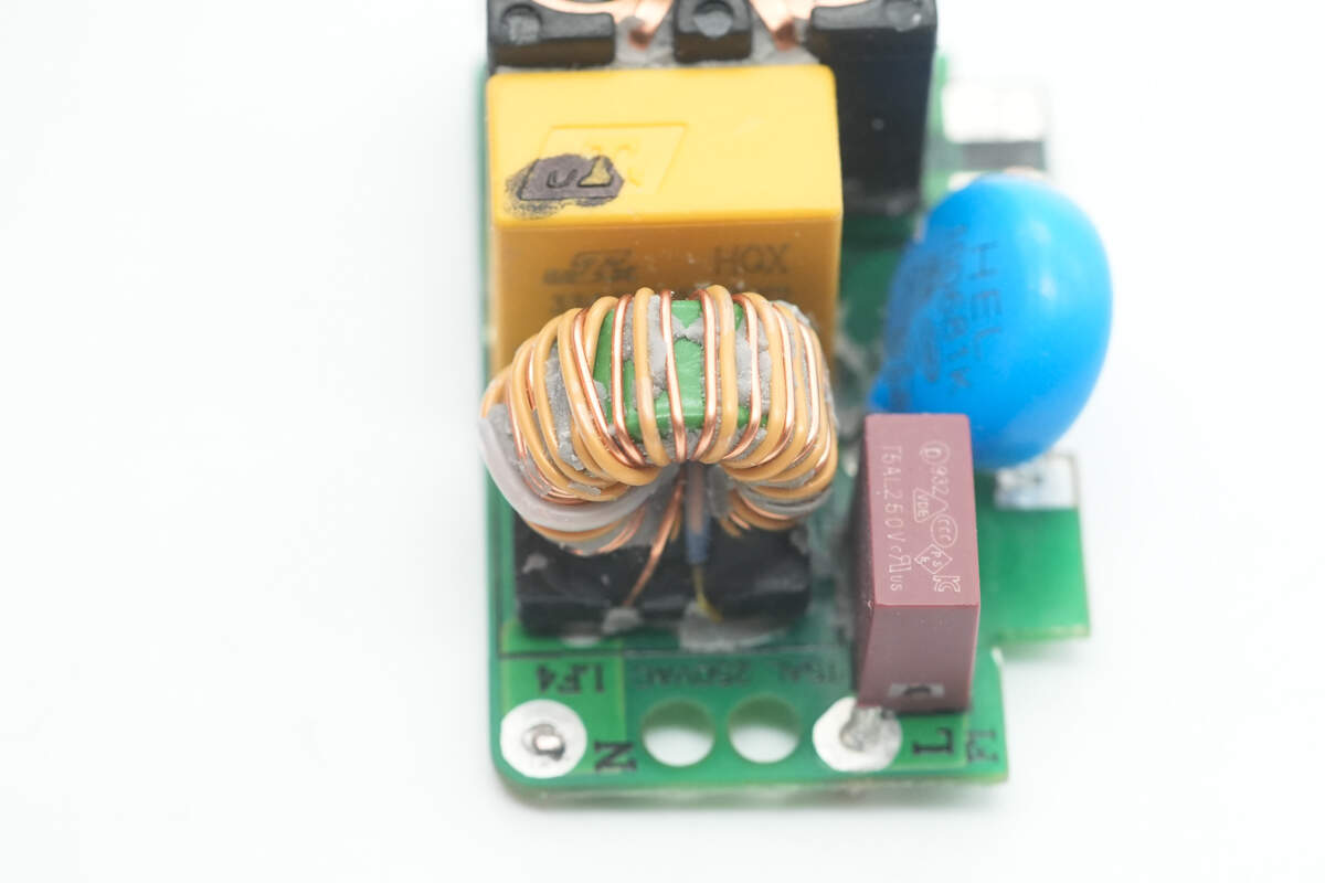

Remove the small PCB. The front has a time-delay fuse, a varistor, common mode chokes, and a safety X2 capacitor.
The time-delay fuse is manufactured by Betterfuse, model 932, rated at 5A 250V.
The varistor is from HEL, model 10D681K, used for surge overvoltage protection.

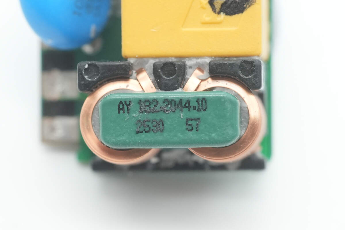

The common mode choke features a two-stage design to filter out EMI interference, with the first coil wound using dual wires.
The second choke uses a green magnetic core and is wound with flat copper tape.

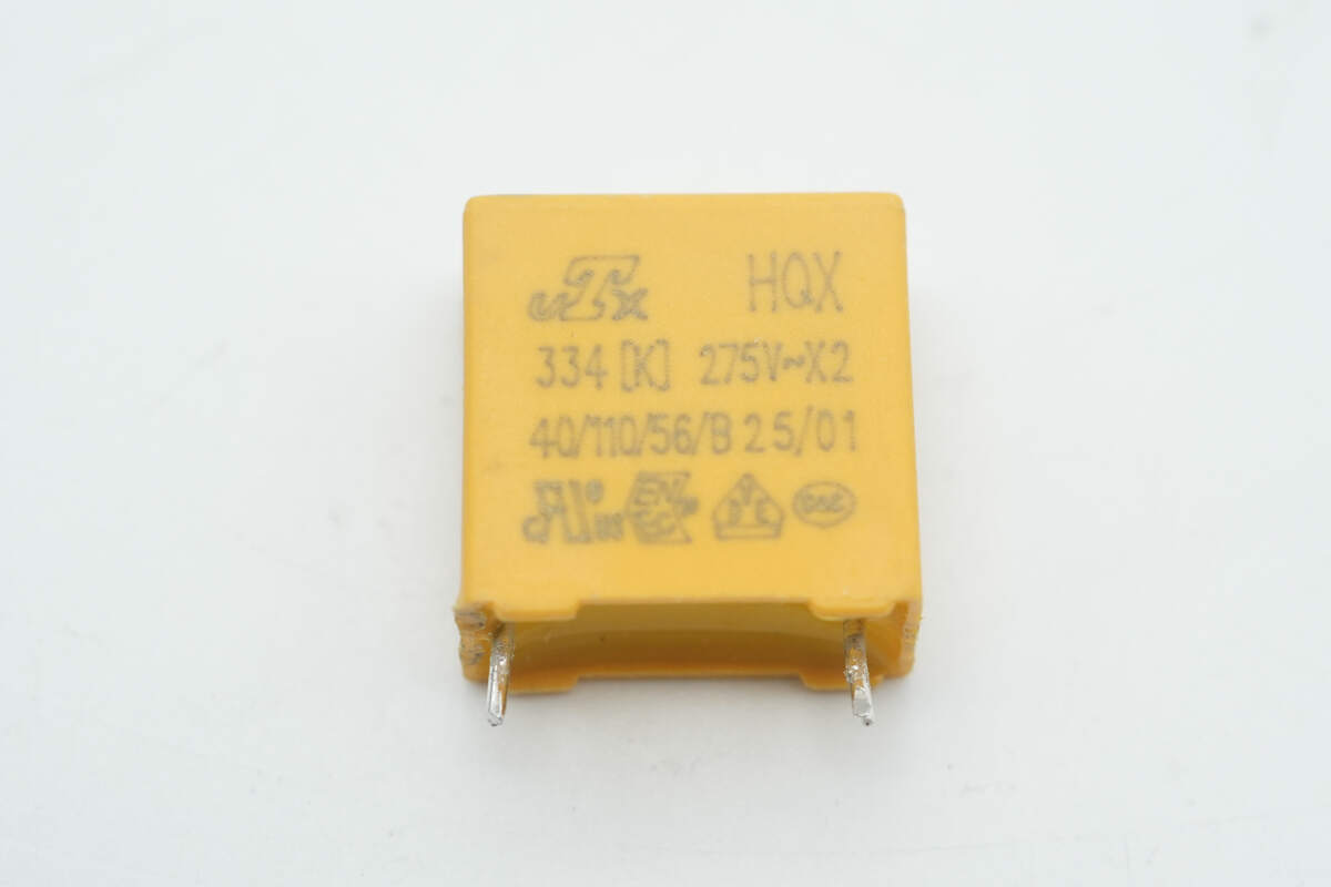

The safety X2 capacitor has a capacitance of 0.33μF.

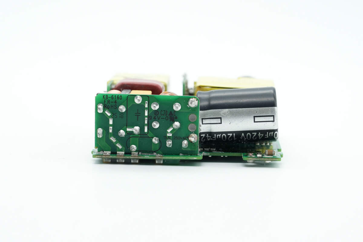

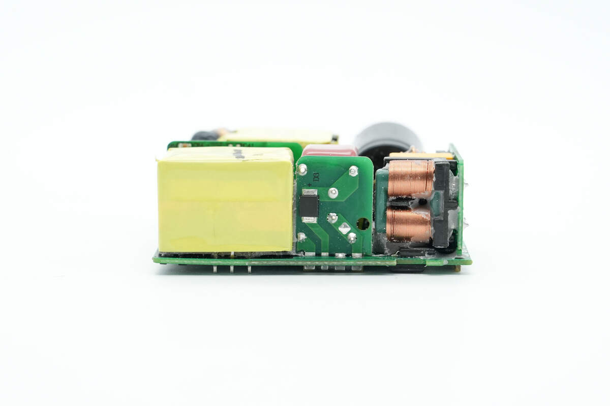

The side is soldered with a filter PCB and the PFC boost inductor. There is a diode on the back side of the small PCB.

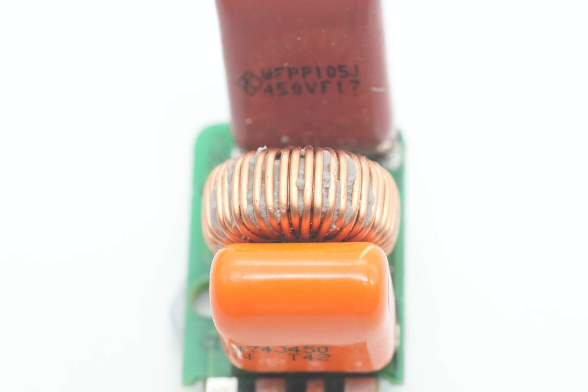

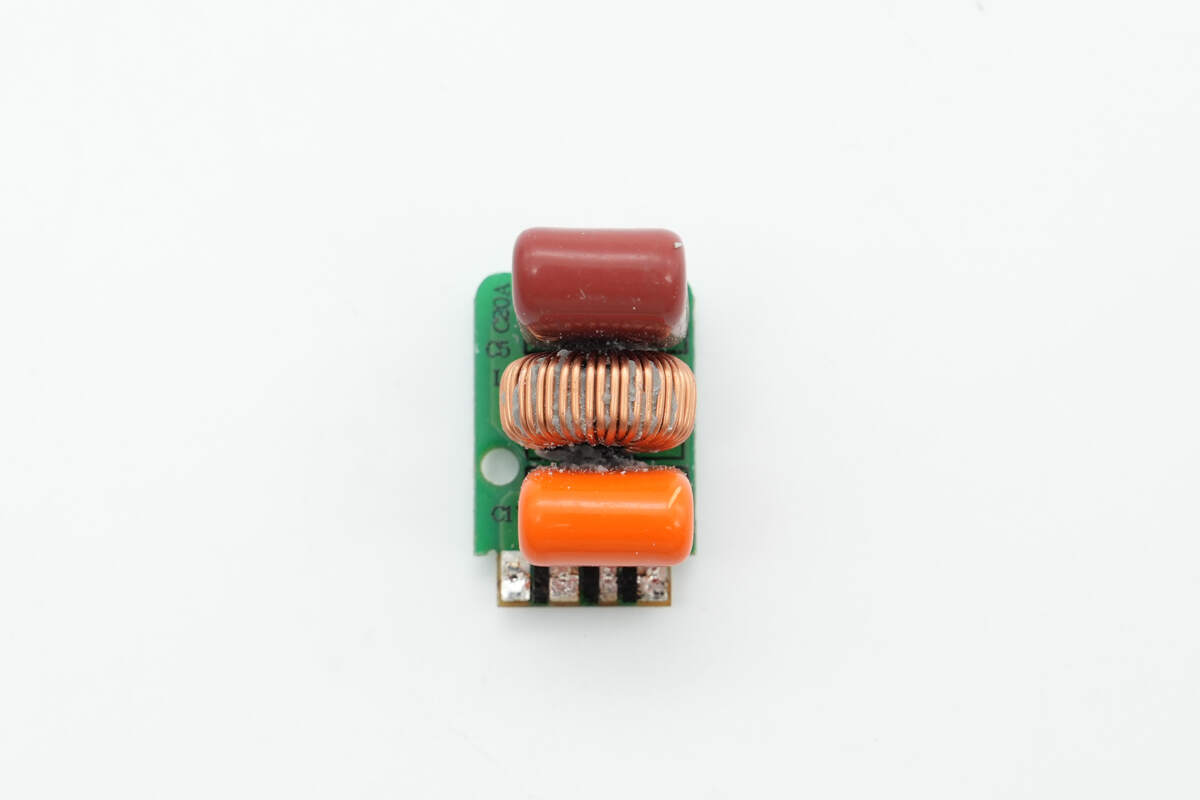

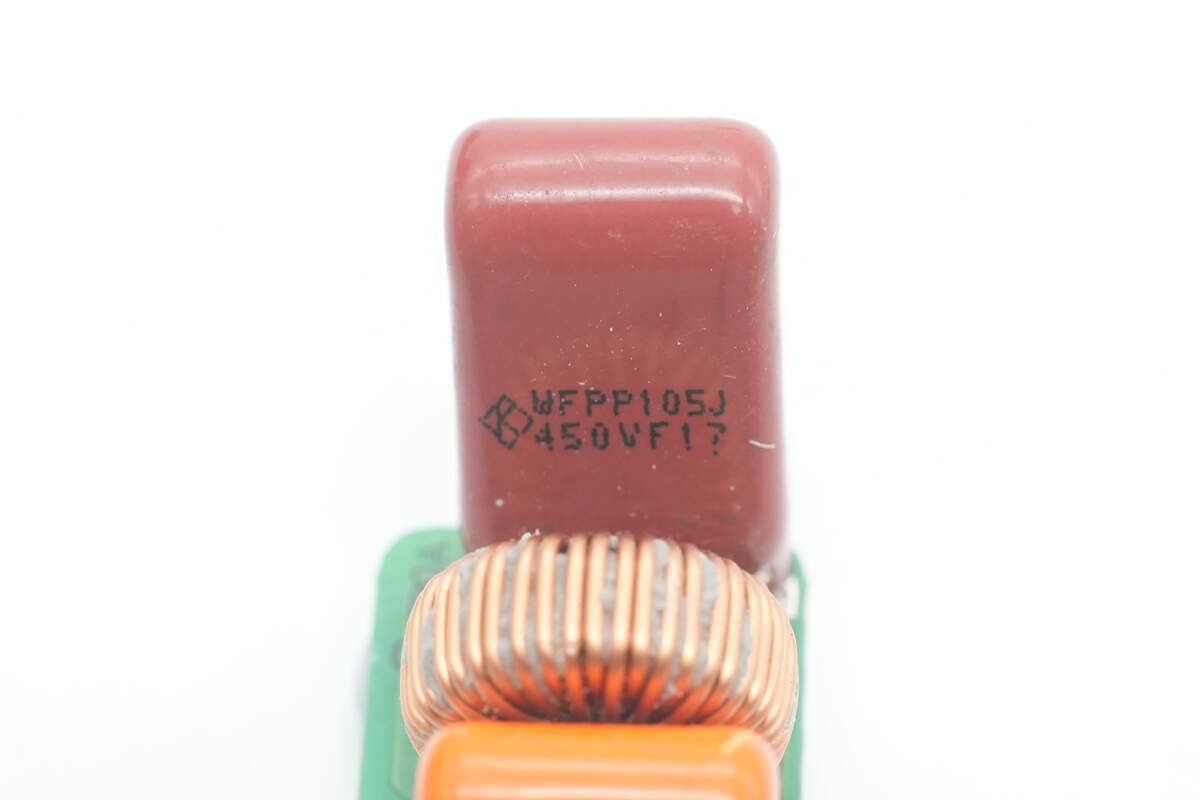

Remove the small PCB. The front side has two film capacitors and one filter inductor.
The red film capacitor is rated at 1μF, 450V.

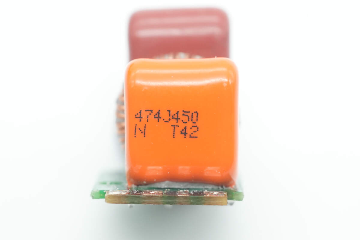

The orange film capacitor is rated at 0.47μF, 450V.

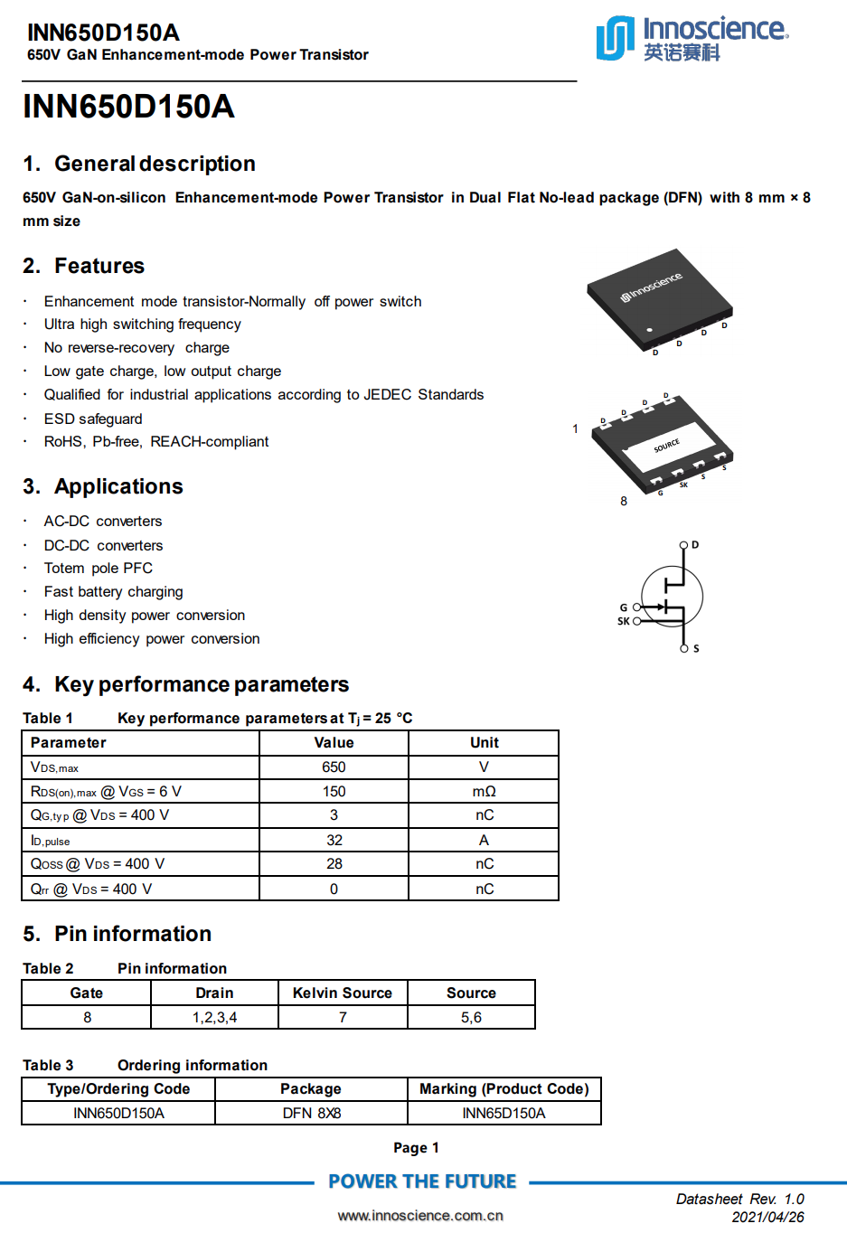

The PFC boost MOSFET is from Innoscience, model INN650D150A. It is a high-voltage GaN transistor with a voltage rating of 650V and a transient withstand voltage of 750V, featuring an on-resistance of 150mΩ. It comes in a DFN 8×8 package.
The INN650D150A supports ultra-high switching frequencies, has no reverse recovery charge, and boasts very low gate charge and output charge. It meets JEDEC standards for industrial applications, includes built-in ESD protection, and complies with RoHS, lead-free, and EU REACH regulations.
The INN650D150A supports AC-DC and DC-DC converter applications, including totem-pole PFC configurations, battery fast charging, as well as high power density and high-efficiency conversion applications.

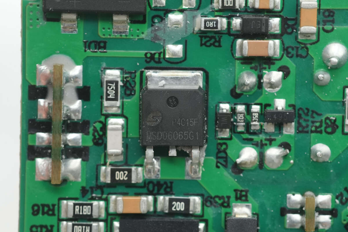

The PFC rectifier is from Msemitek, model MSD06065G1. It is a SiC diode rated for 650V and continuous forward current of 6A at 150°C, housed in a TO-252 package.

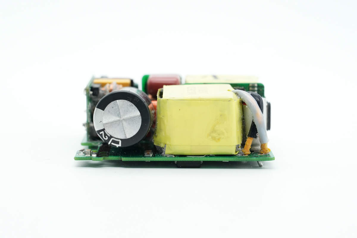

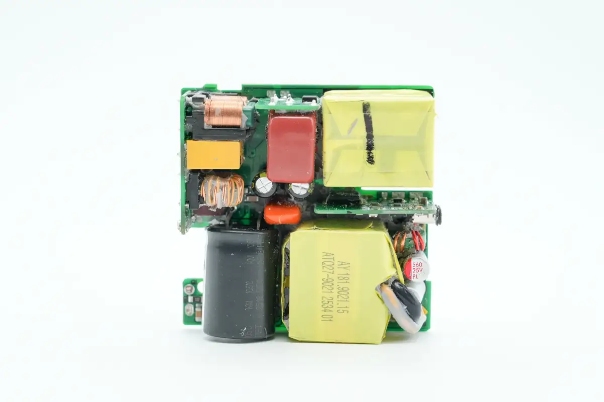

On the other side of the module, there is a high-voltage filtering electrolytic capacitor and a transformer.
The electrolytic capacitor is from ChengX, rated at 120μF, 420V.

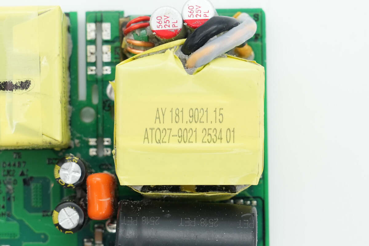

The two capacitors supplying power to the master control chip are also from ChengX, rated at 47μF 50V and 22μF 100V, respectively.

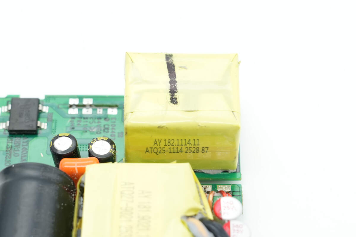

Close-up of the transformer.

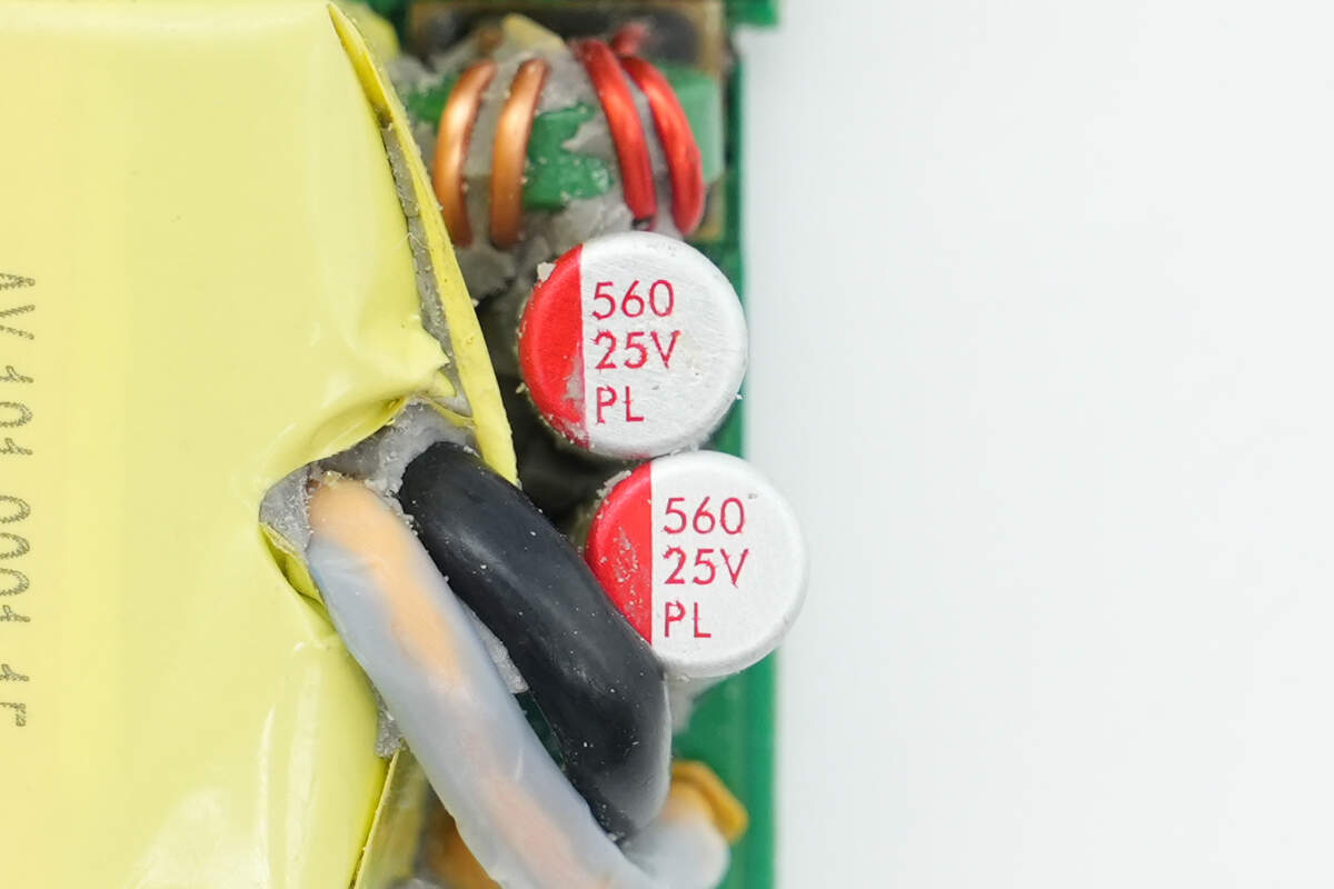

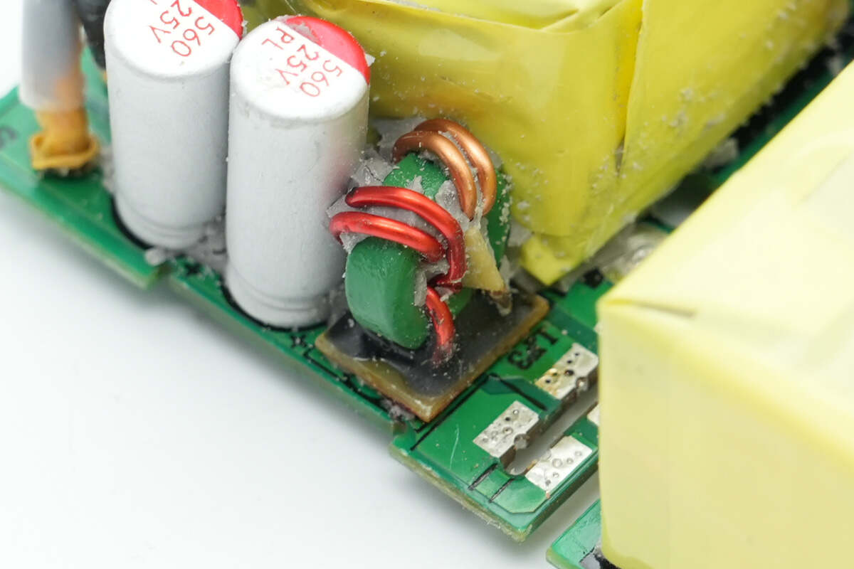

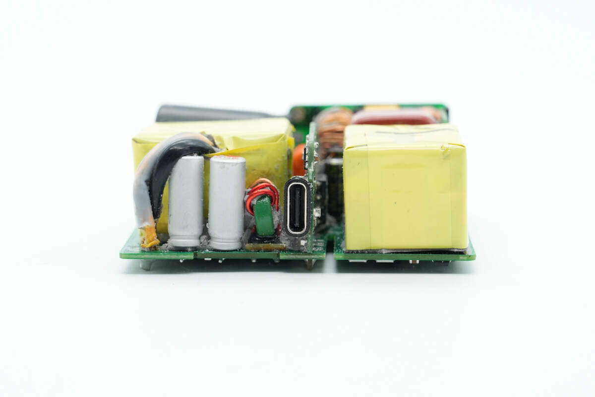

On the output side, the left contains a filter inductor and two solid capacitors for output filtering. The center houses the protocol PCB.

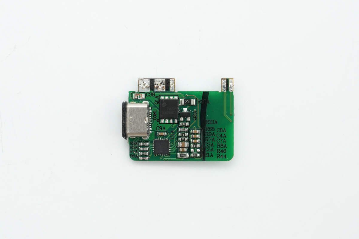

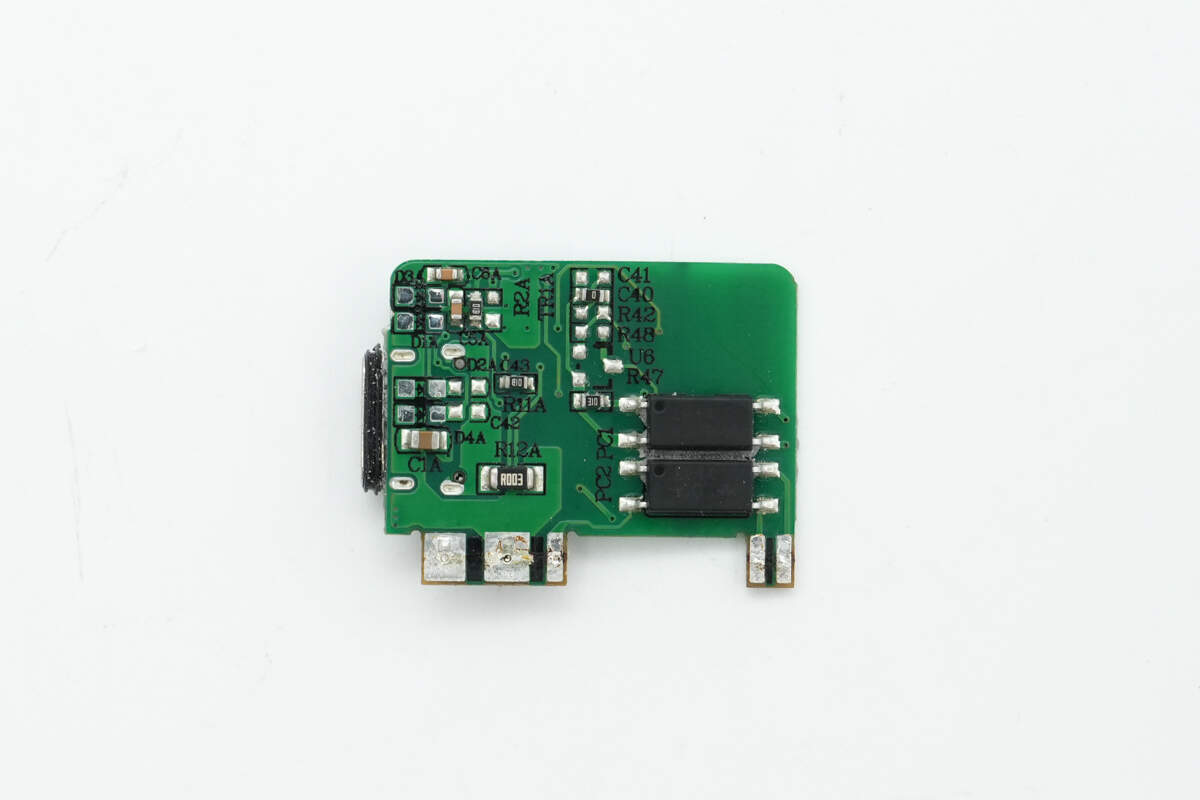

Remove the PCB with the USB-C socket. The front features the protocol chip and the output VBUS MOSFET.
The other side is equipped with two optocouplers.
The two 1009 optocouplers are used for output voltage feedback and protection.
The SMD Y capacitors are from TRX. Their compact size and lightweight design make them well-suited for high-density power products such as GaN fast chargers. The model numbers are TMY1221K, TMY1102M, and TMY1681M.

Both solid capacitors for output filtering are rated at 25V, 560μF.
Close-up of filter inductor.
The protocol chip is from Injoinic, model IP2723T. It has passed USB-IF PD3.0 PPS certification, TID: 3135. It is a fast-charging protocol IC integrating multiple protocols for USB output ports. It supports various fast-charging protocols, including USB Type-C DFP, PD2.0/3.0, PPS, HVDCP, QC4, QC4+, QC3.0/2.0, FCP, SCP, AFC, MTK PE+ 2.0/1.1, Apple 2.4A, BC1.2, and Samsung 2.0A.
It provides a complete Type-C solution for unidirectional output applications such as adapters and car chargers. In addition, the IP2723T features high integration and rich functionality, requiring only a few peripheral components in practical applications, effectively reducing the overall solution size and BOM cost.
The output VBUS MOSFET is from Msemite, model SLM120N03T. It is an N-channel MOSFET rated for 30V with an on-resistance of 2.6mΩ, housed in a DFN5×6 package.

Well, those are all components of the MECHREVO 140W USB-C GaN Power Adapter.
Here is the component list of the MECHREVO 140W USB-C GaN Power Adapter for your convenience.
It supports a wide input voltage range of 100-240V and has passed CCC certification. It is equipped with a grounded plug for enhanced safety. It supports MECHREVO’s proprietary 140W PD fast charging protocol and comes with a 7A USB-C cable. It also supports 100W PD/PPS high-power fast charging, offering good performance and compatibility.
After taking it apart, we found that it is based on a PFC + AHB power architecture design, utilizing the complete JOULWATT power solution with JW1572, JW1556C, and JW7726HB, along with the JOULWATT JW1568K GaN half-bridge chip.
It uses a GaN component from Innoscience and SiC components from Msemite, with output controlled by the Injoinic IP2723T protocol chip. This integrated solution provides the product with high reliability and efficiency. The PCBA module is fully potted and covered with an integrated copper heatsink for thermal management, with well-executed insulation measures.
