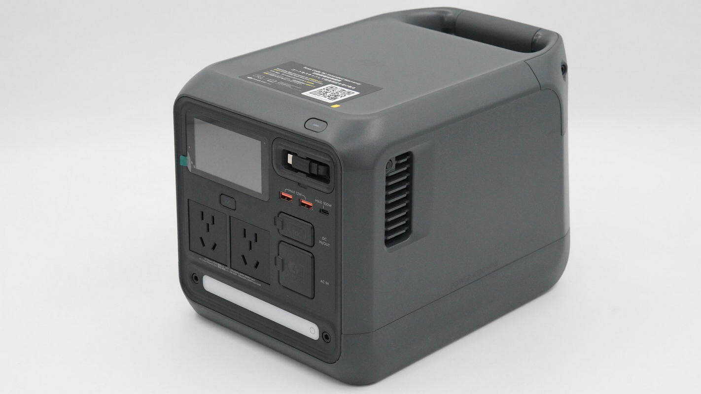

DJI has launched a brand-new portable power station, the DJI Power 1000 Mini. It features a built-in 1 kWh lithium iron phosphate battery. The inverter delivers a rated output power of 1000 W, with a boosted output of up to 1200 W, enabling it to support high-power appliances. The inverter is also optimized for higher conversion efficiency at low loads, extending the operating time of low-power devices.
The power station supports AC charging, reaching 80% capacity from zero in just 58 minutes. It also supports 400 W fast charging via a vehicle, as well as charging through solar panels and USB-C. The unit is equipped with two universal AC output sockets and an integrated retractable USB-C cable, approximately 80 cm in length, enhancing convenience for everyday use. The retractable cable module is also detachable and replaceable.
The front panel includes additional USB-C and USB-A ports. The USB-C port supports 100 W bidirectional fast charging, while the USB-A port provides up to 12 W output. The SDC port supports a charging input of up to 400 W and a discharging output of up to 300 W. The inverter uses a fully potted protection design, ensuring reliable operation in environments such as seaside camping or high-altitude road trips. Next, we will present a teardown to take a closer look at its internal design and components.

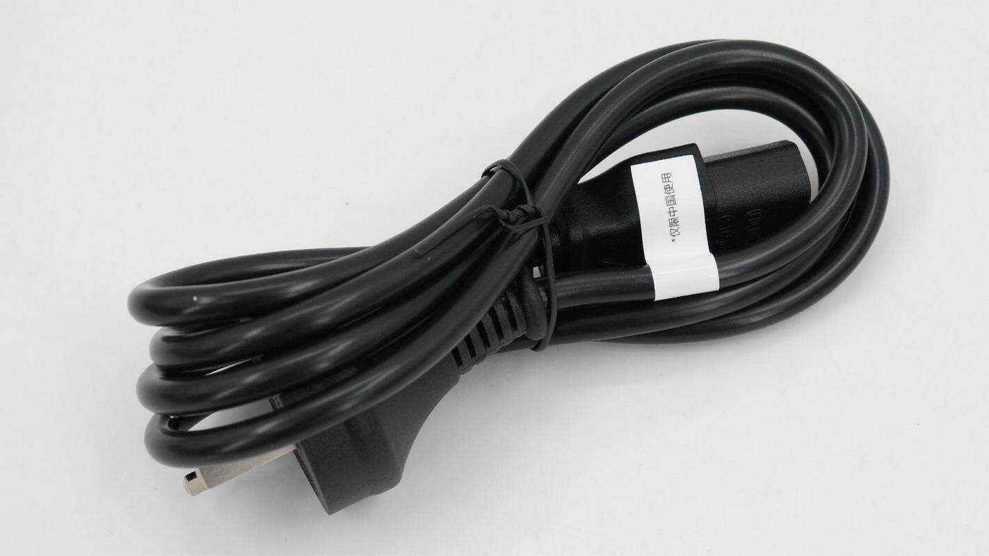

The included power cable is a three-prong type with a length of 1.5 meters, rated at 10A 250V~.

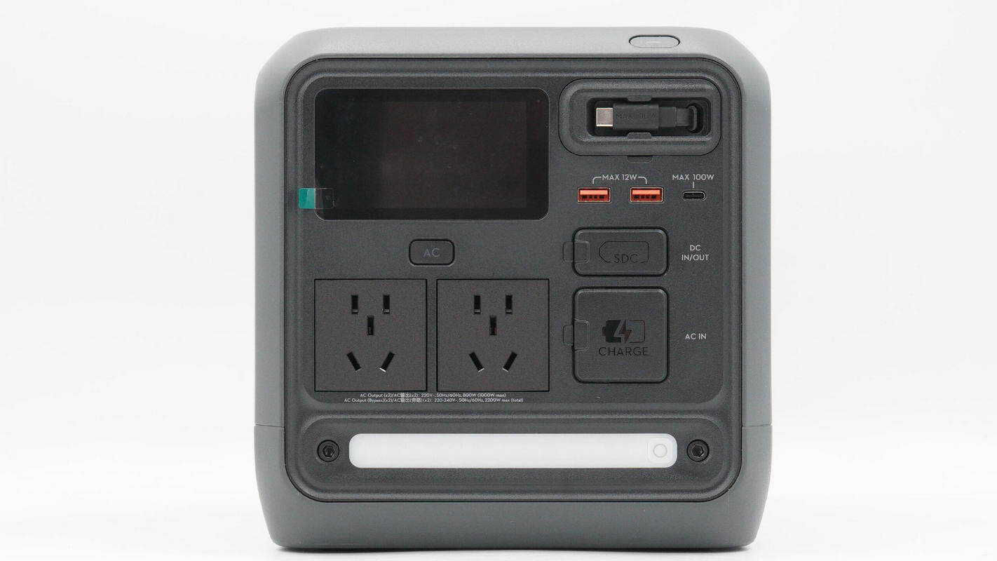

The design is minimalist, with a comprehensive set of functional interfaces. Combined with a 1 kWh battery capacity and 1000 W output power, it is well-suited to meet power needs in outdoor scenarios.
Teardown of DJI Power 1000 Mini Power Station (DYM1000M)-Chargerlab

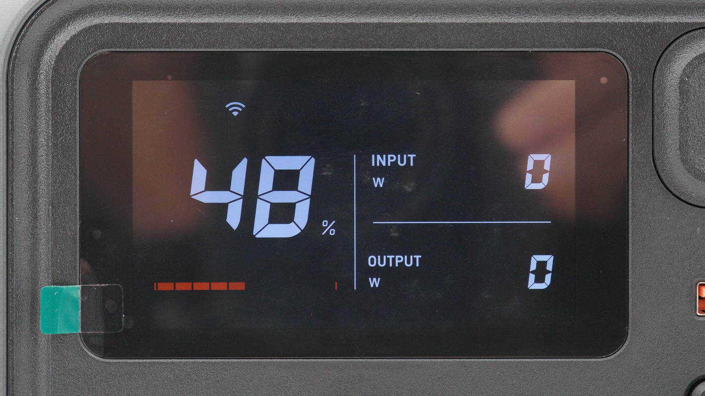

The front panel features an LCD in the upper left corner, with AC output sockets located below it. On the upper right is a retractable USB-C cable, while USB-A and USB-C ports are positioned beneath it. The SDC port and the AC input port are protected by sealing covers. At the bottom is an integrated LED light.
The display shows the remaining battery level, input and output power, and Wi-Fi connection status.

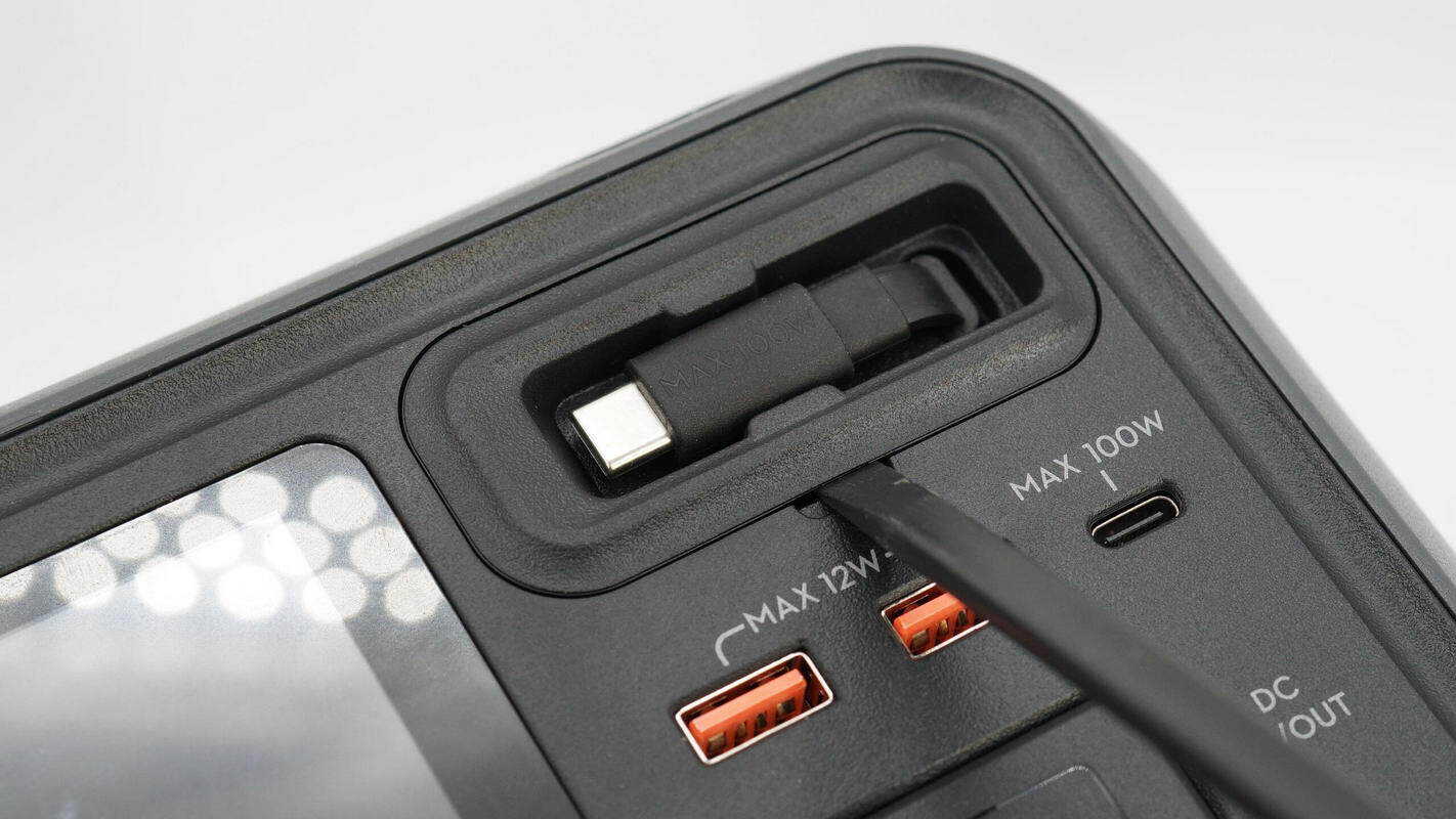

The retractable USB-C cable is magnetically secured and adopts a modular design, allowing it to be detached and replaced.

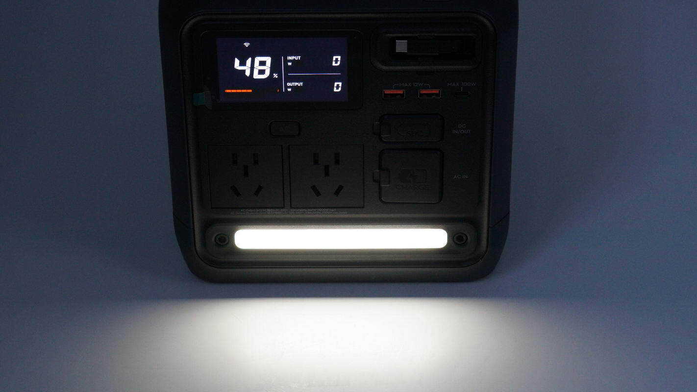

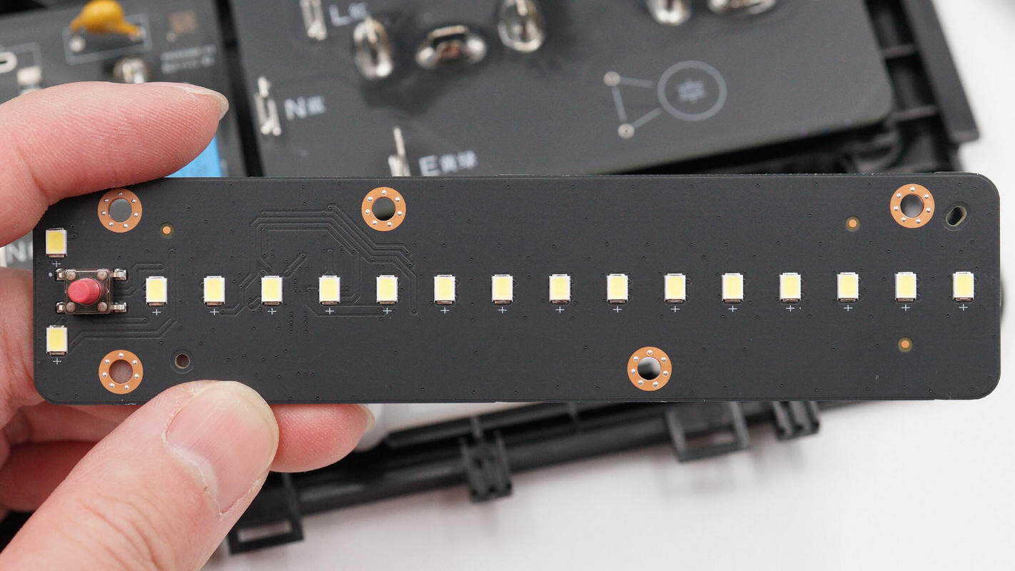

The LED light provides sufficient illumination for nighttime activities and emergency lighting.

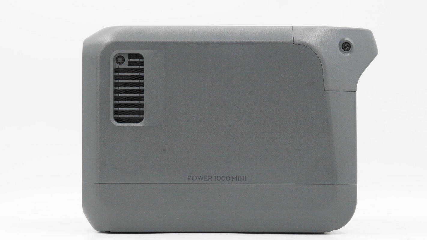

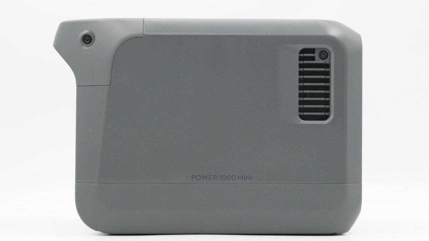

This side of the unit features ventilation holes, with "POWER 1000 MINI" printed on the chassis.
The opposite side has an identical design.

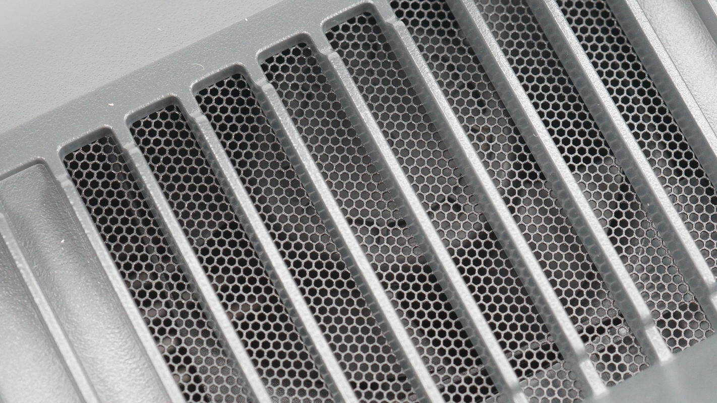

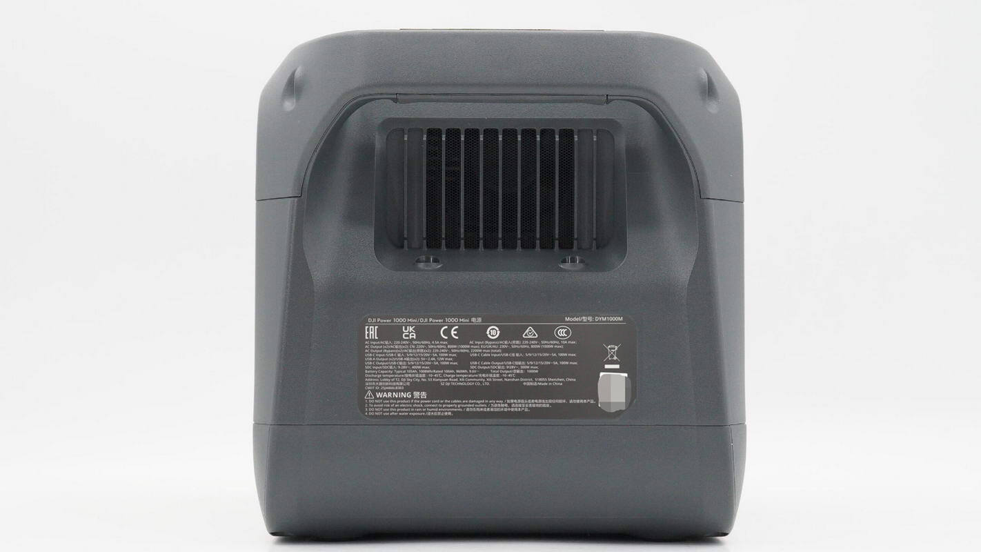

The rear of the unit houses a cooling fan and features a nameplate sticker.
The cooling fan is equipped with a dust filter.

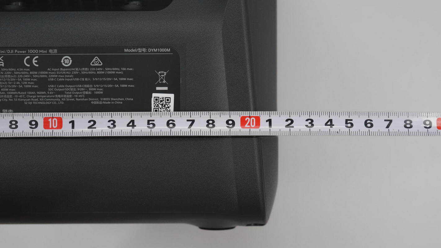

Model: DYM1000M

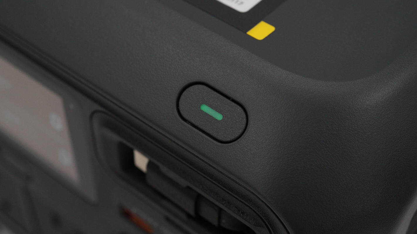

The top of the unit is marked with "DJI," and at the rear, there is an integrated handle with a power switch.

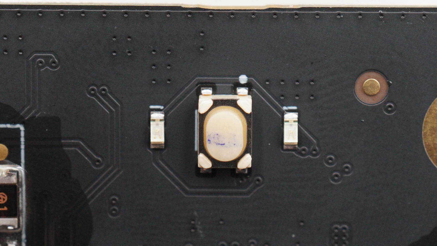

The power switch has an indicator light inside.

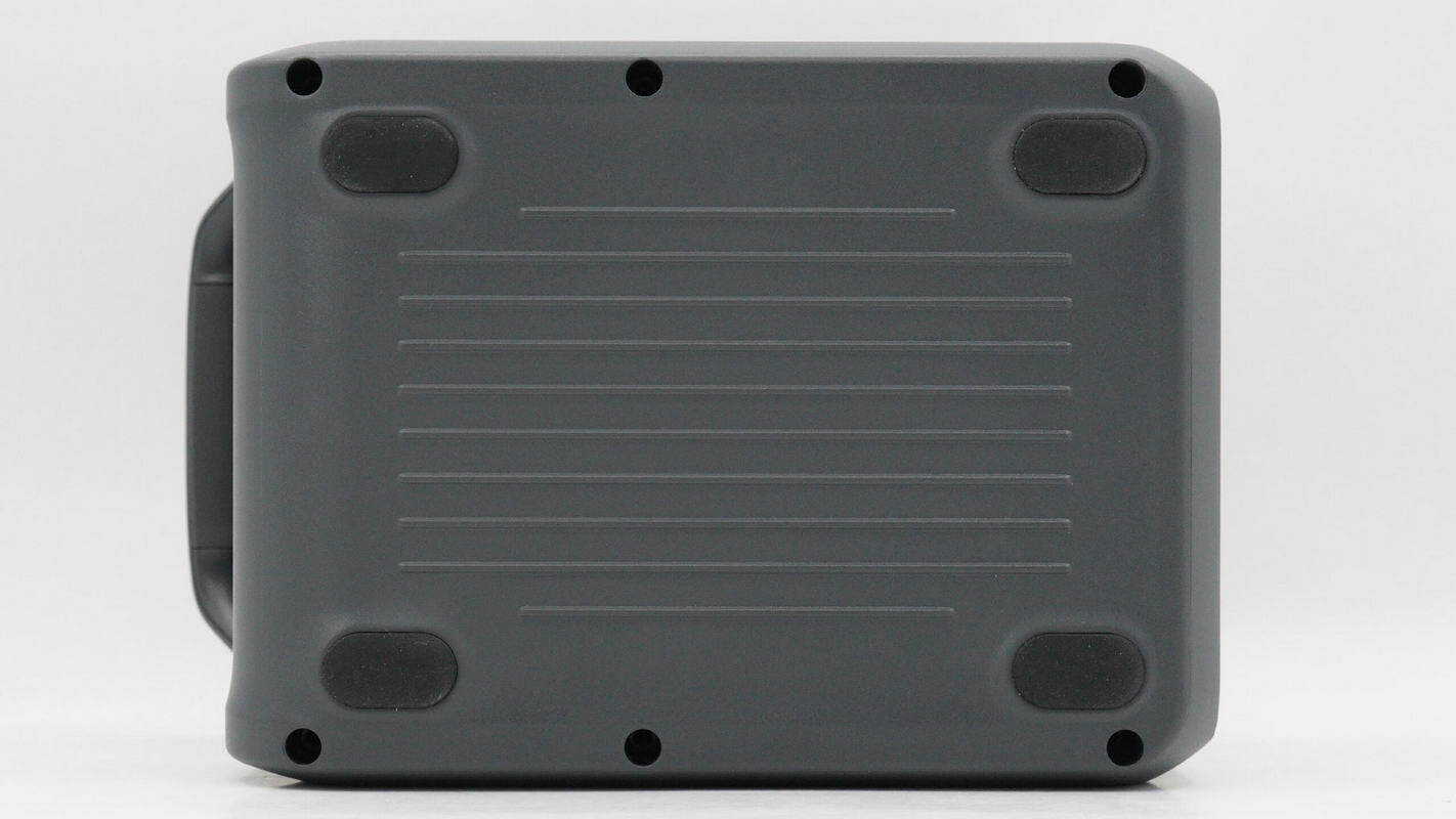

The bottom is equipped with non-slip feet.

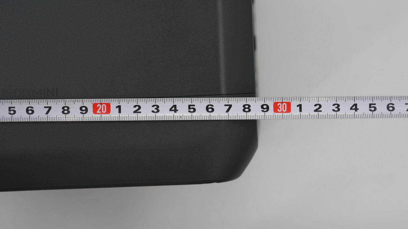

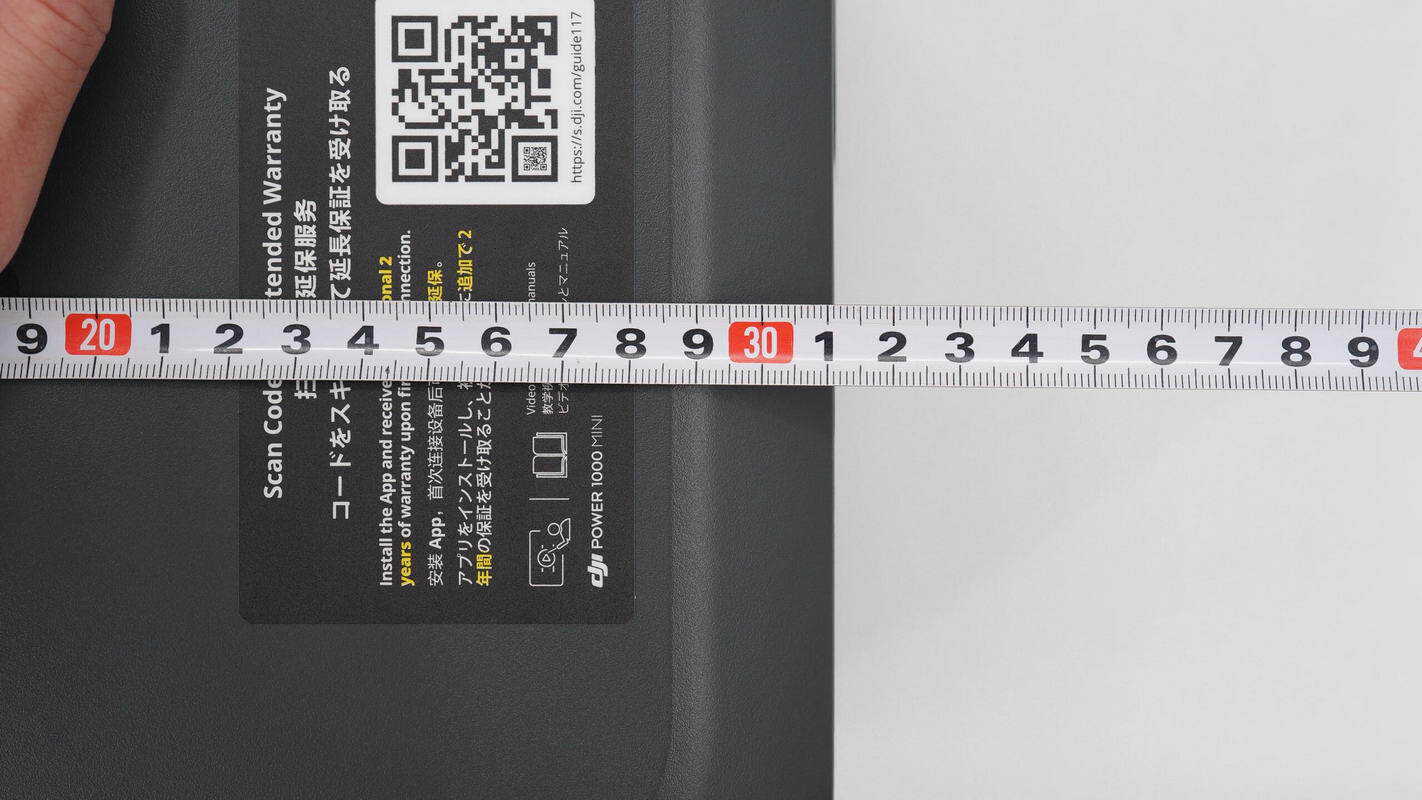

The length of the unit is about 310 mm (12.2 inches).
The length of the unit’s bottom is about 285 mm (11.22 inches).
The width of the unit is about 214 mm (8.43 inches).

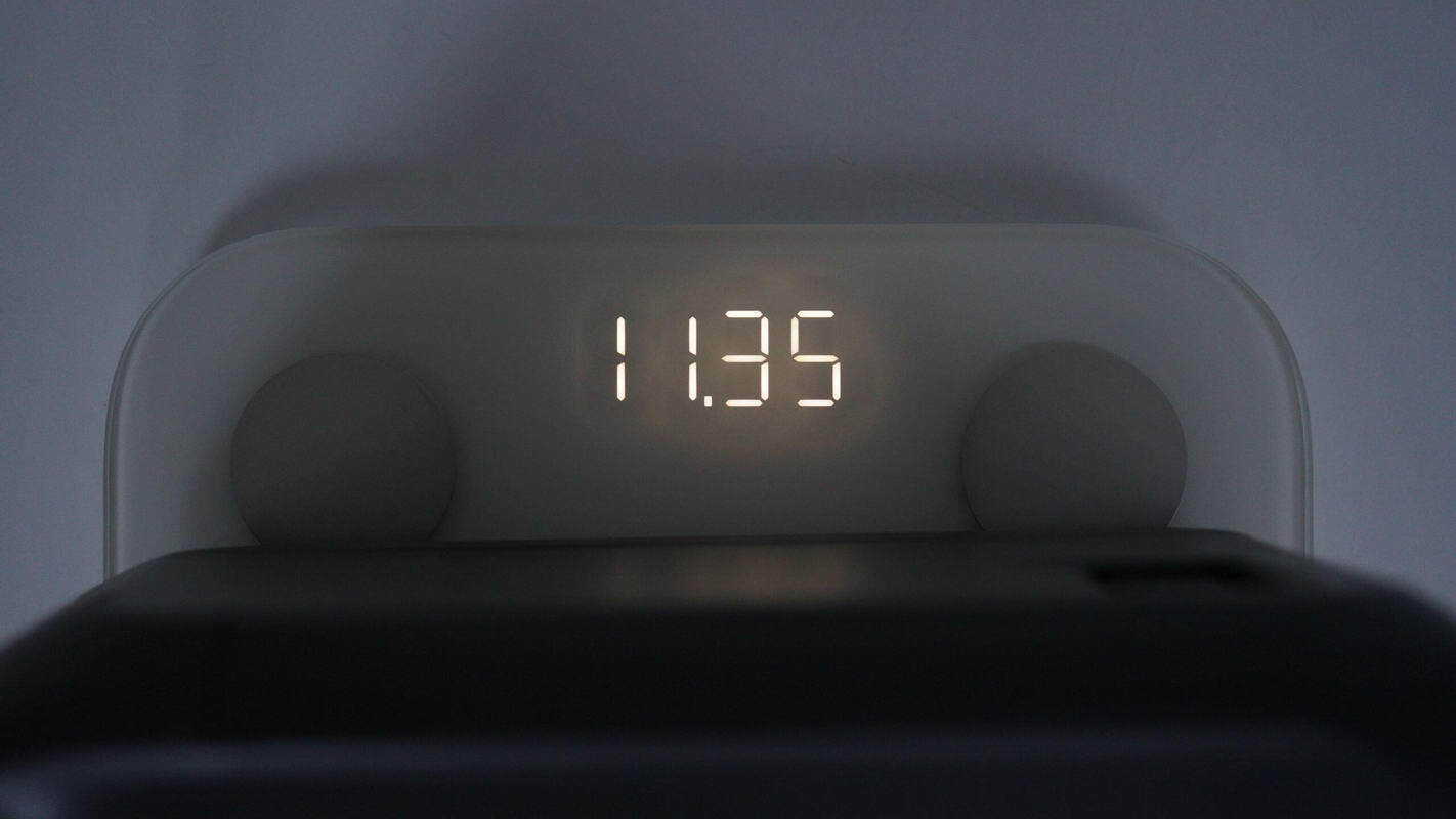

The weight is about 11.35 kg (25.022 pounds).

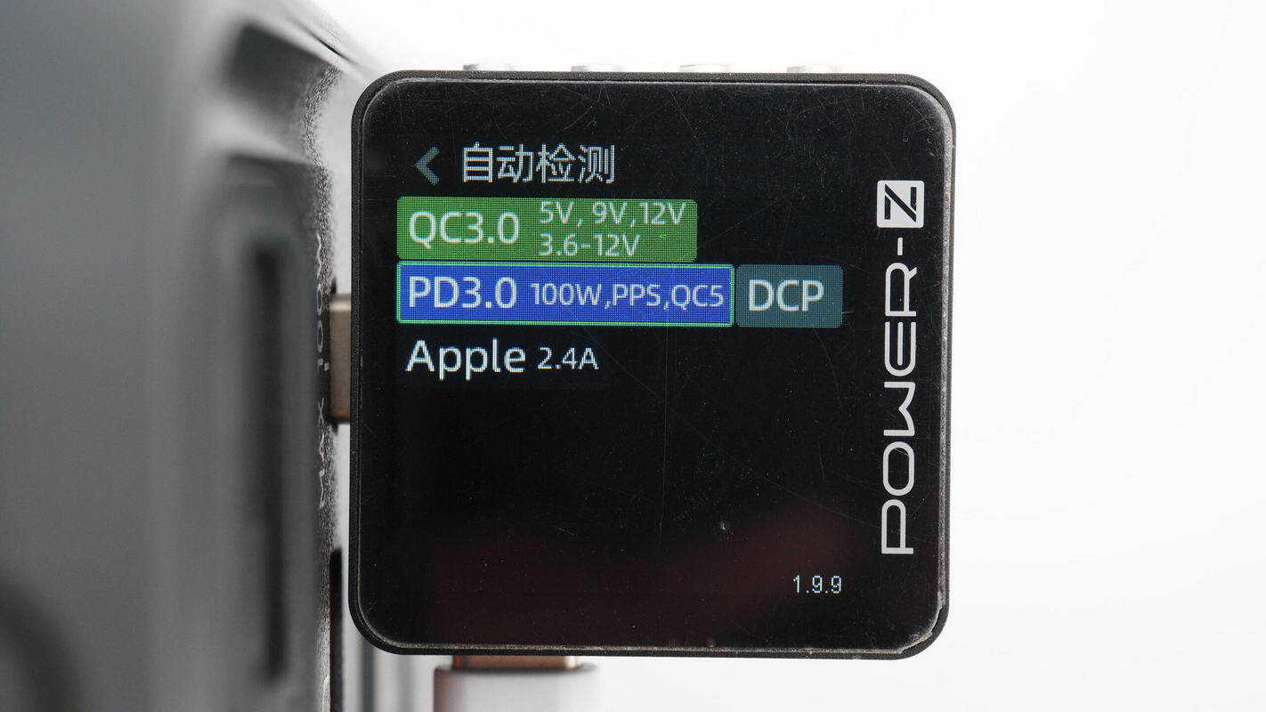

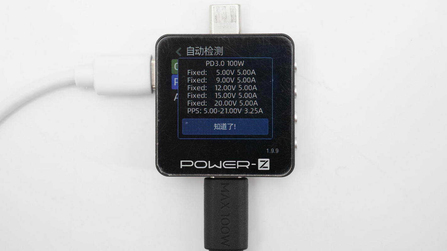

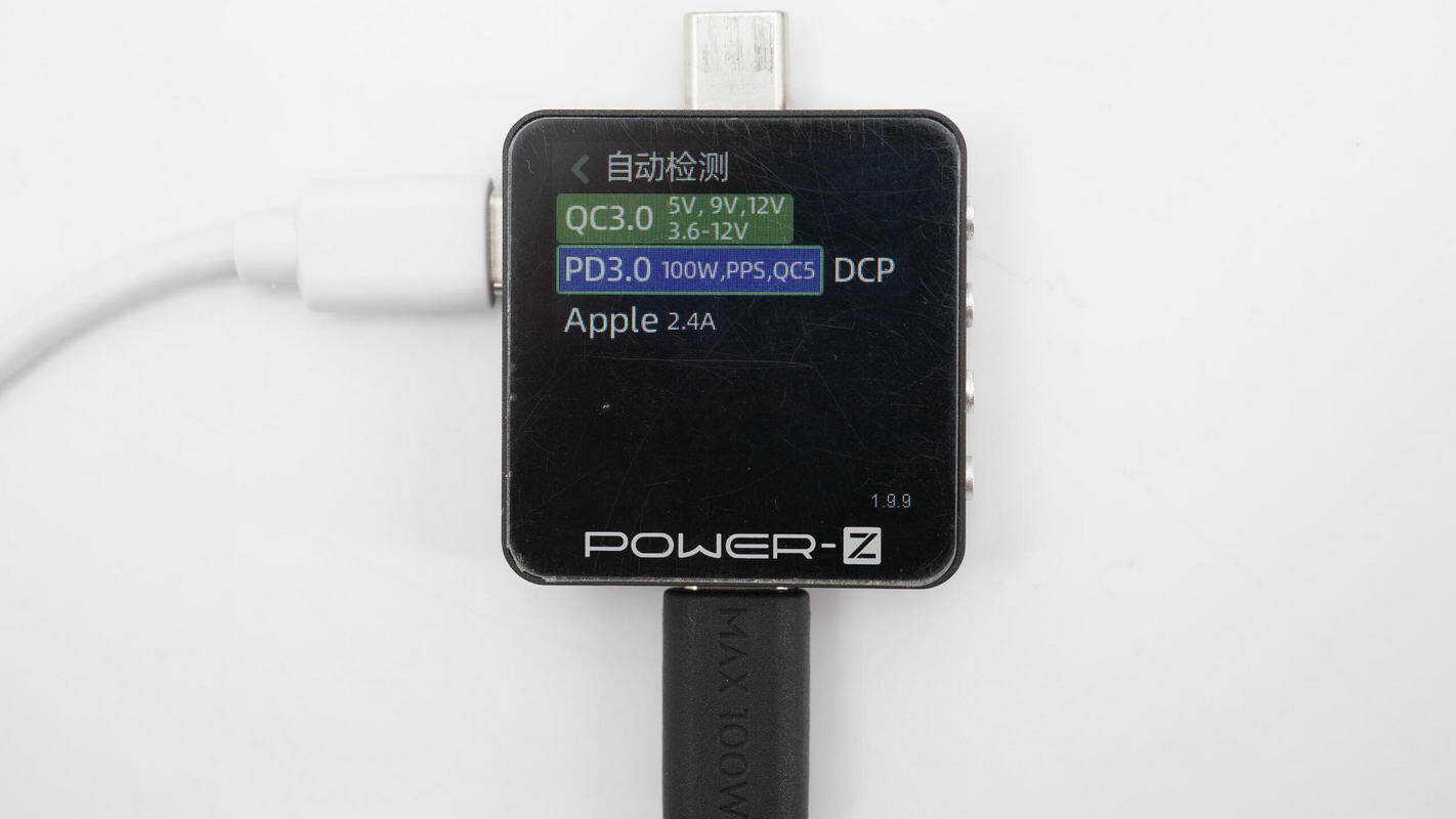

ChargerLAB POWER-Z KM003C shows that the USB-C supports QC3.0/5, PD3.0, PPS, DCP, and Apple 2.4A protocols.
It supports five fixed PDOs of 5V5A, 9V5A, 12V5A, 15V5A, and 20V5A. It also supports a set of PPS, which is 5-21V 3.25A.

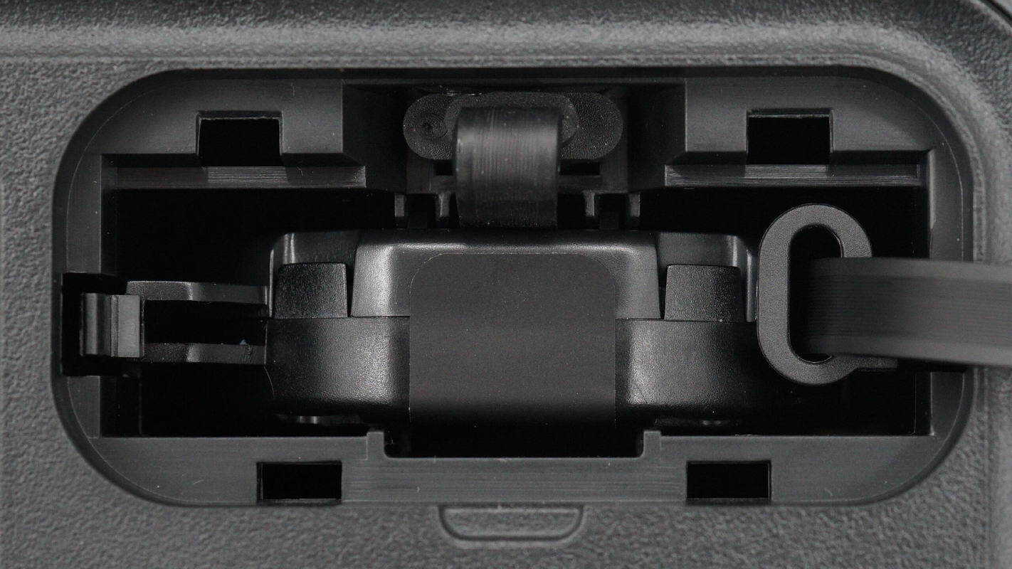

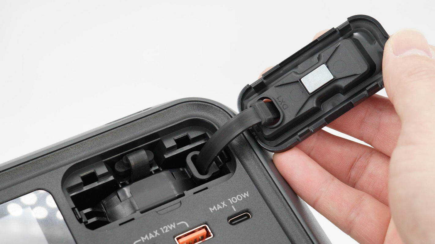

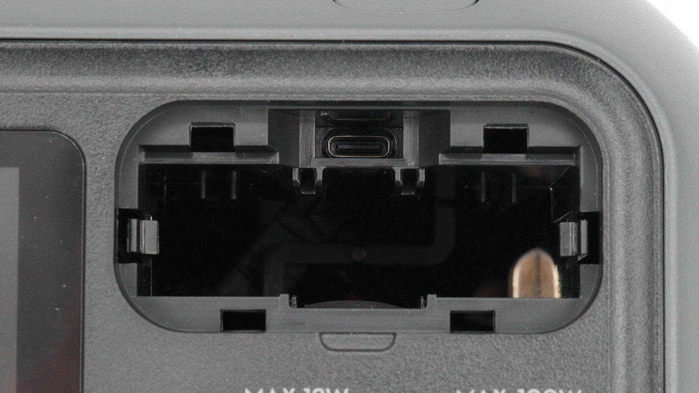

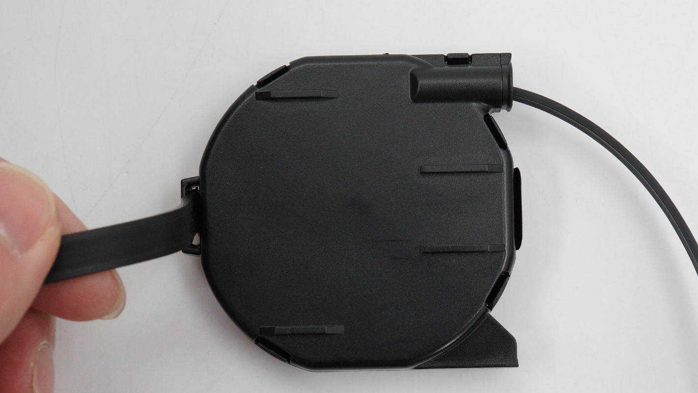

Remove the cover of the retractable USB-C cable module.
Beneath the cover is the retractable cable module, and the back of the cover is equipped with a magnet.
The retractable cable module is secured on both sides with clips, and a USB-C port is located on the top.

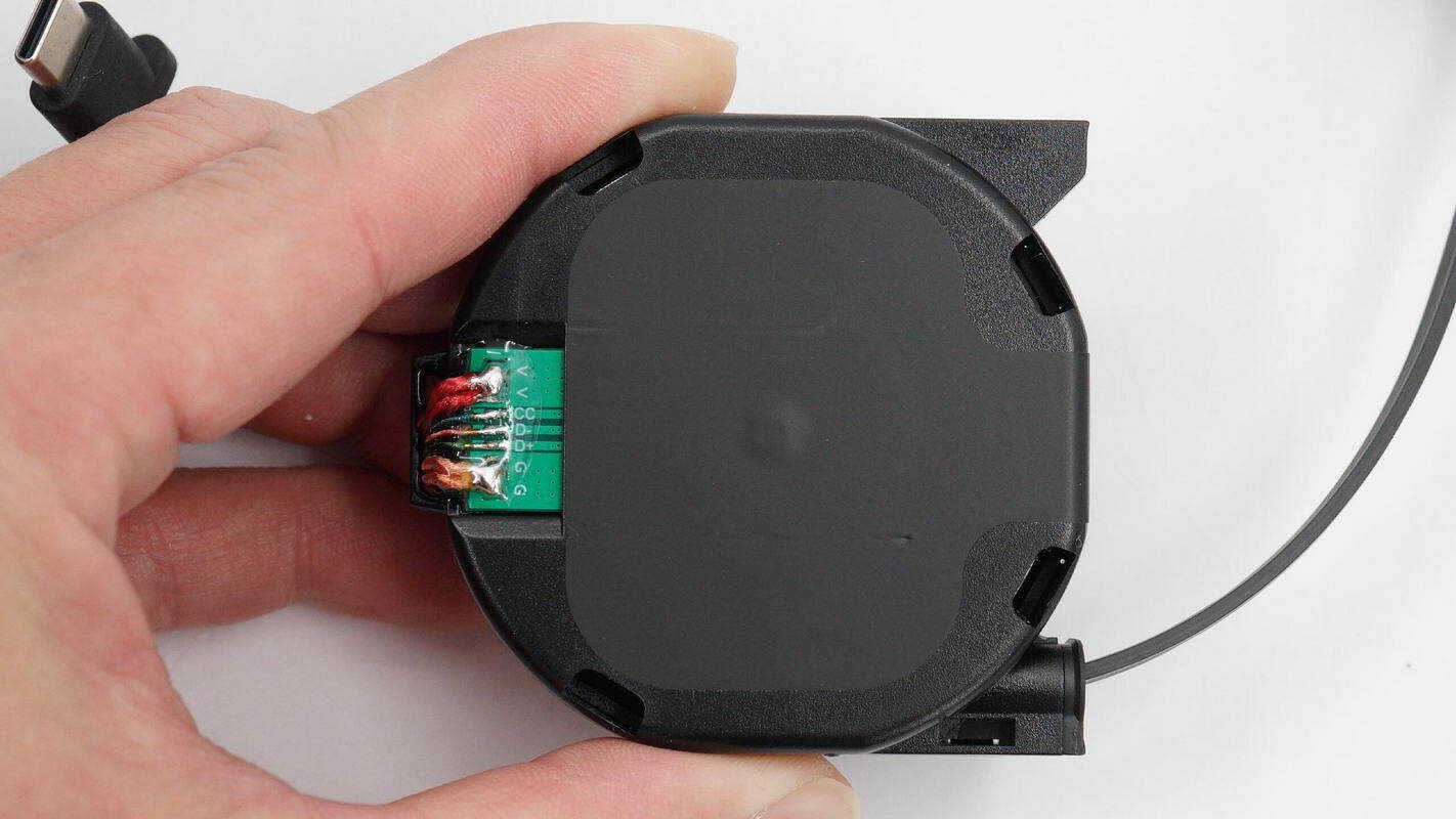

Remove the retractable cable module.
One side of the module features positioning protrusions.
The opposite side has a carbon brush.

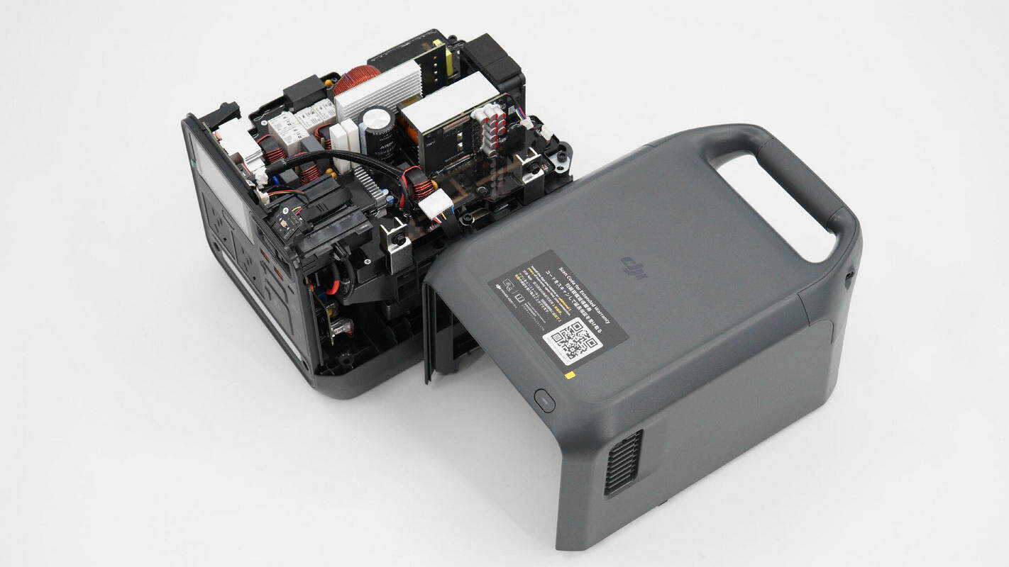

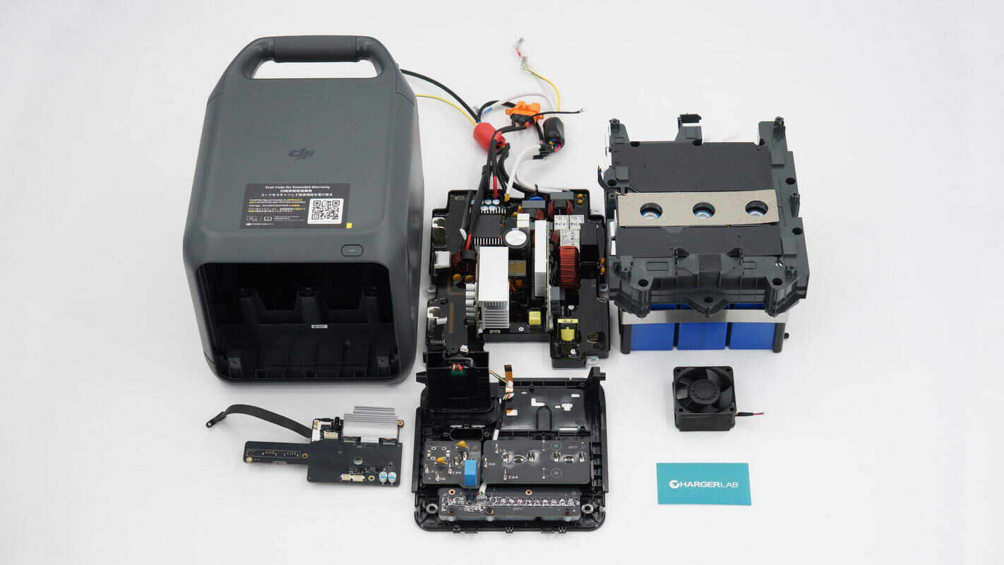

Unscrew the screws at the bottom to remove the outer casing of the power station.
Inside the casing, there are reinforcing ribs.
The power button is covered with foam for light shielding.

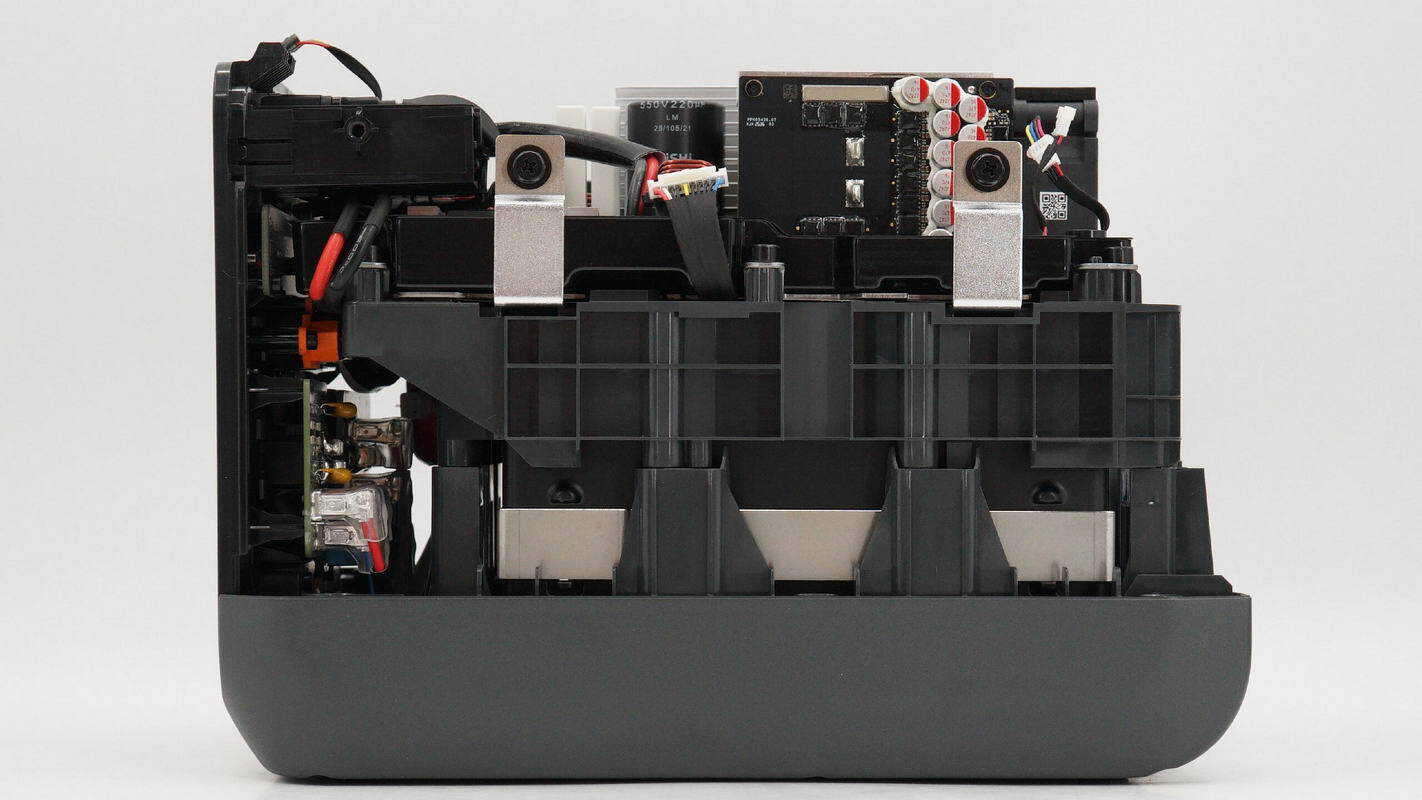

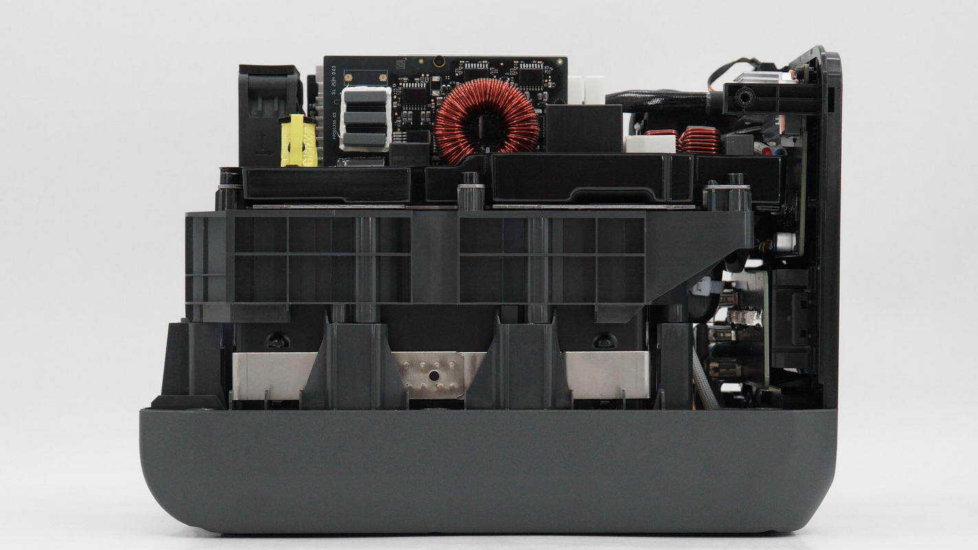

Inside, there is a bidirectional inverter module secured with screws.
Beneath the bidirectional inverter module is the battery pack, covered by a plastic panel. The battery terminals are connected to the bidirectional inverter module.
A cooling fan is installed on the opposite side.
The battery pack cover on the opposite side is also secured with screws.

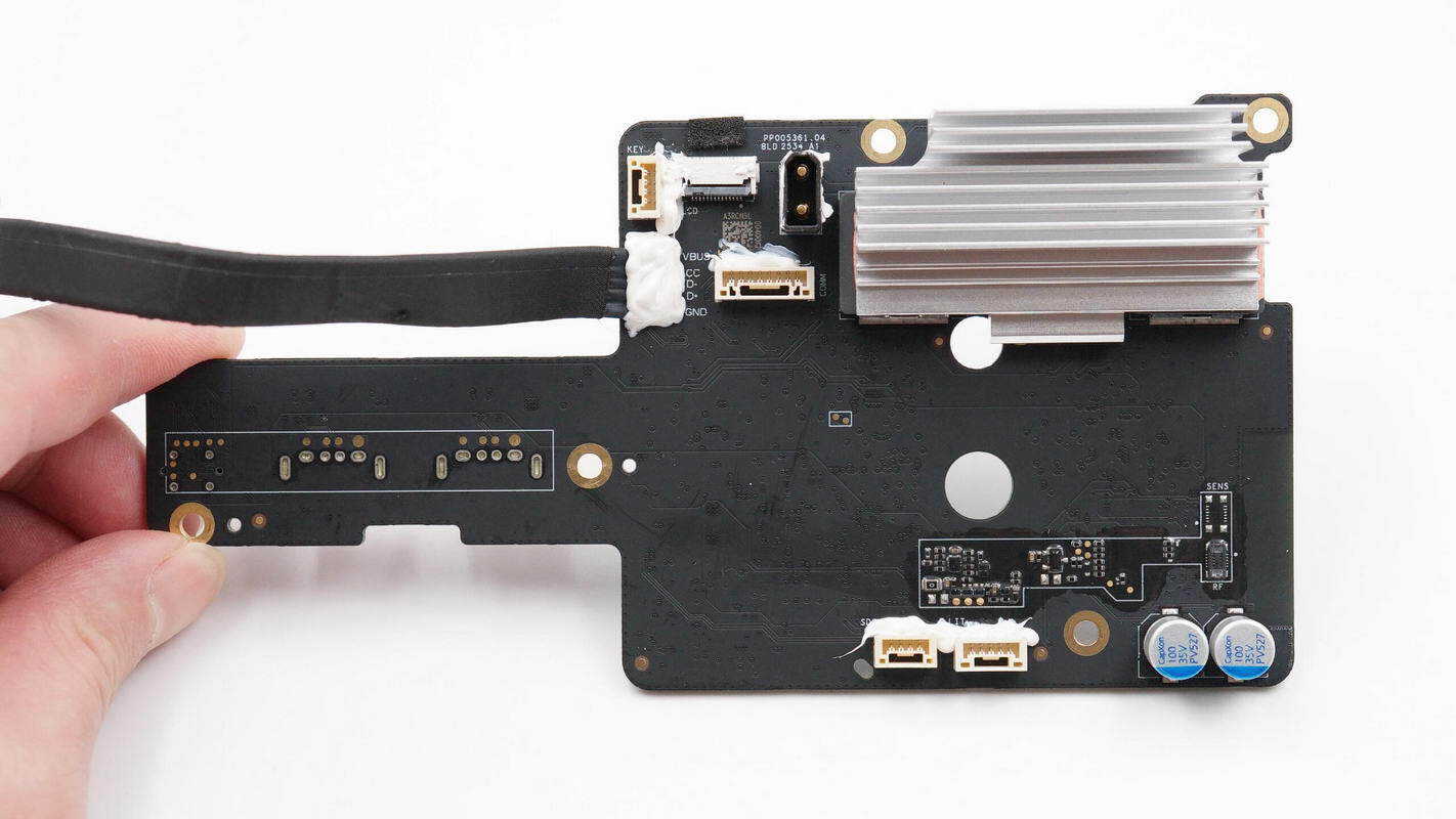

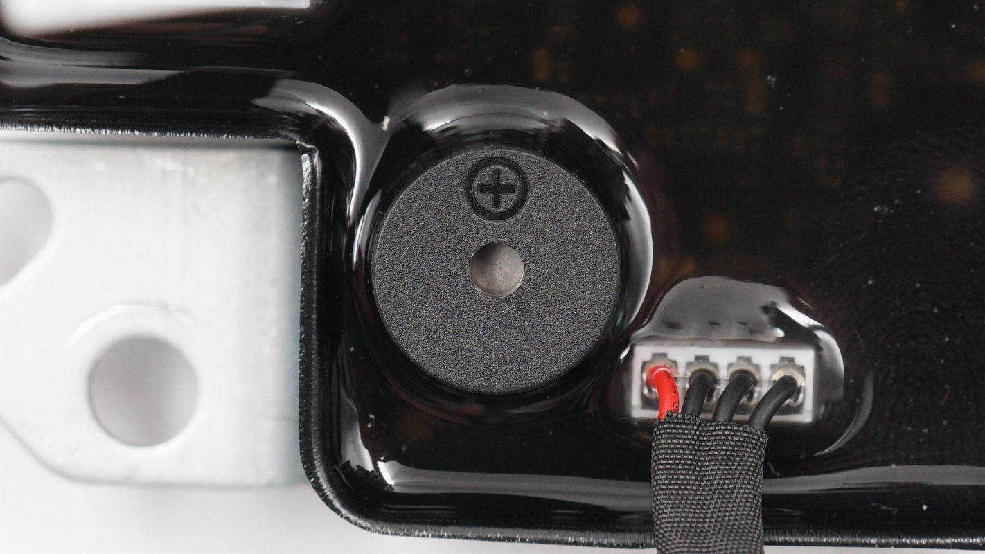

The side panel is equipped with wiring for the power switch, the display ribbon cable, and a power connector.

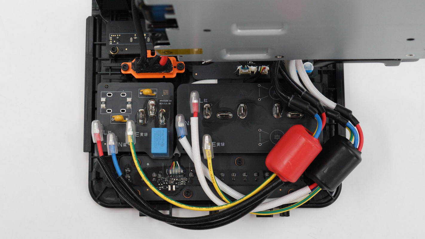

Remove the bidirectional inverter module.

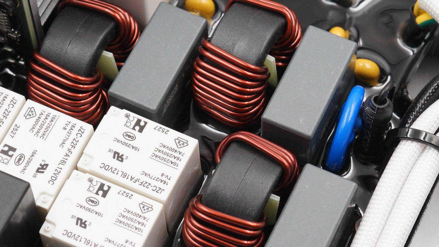

Both the AC input and AC output cables are equipped with ferrite cores to suppress high-frequency interference.
Remove the side panel along with the bidirectional inverter module.

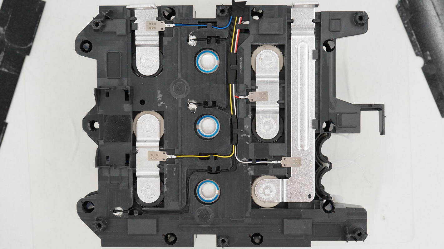

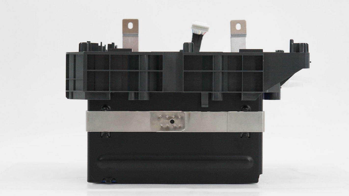

Remove the battery pack, which is insulated with Mylar and mica sheets.
Inside the insulation frame, three thermistors correspond to three battery series, each with its respective voltage detection wire.

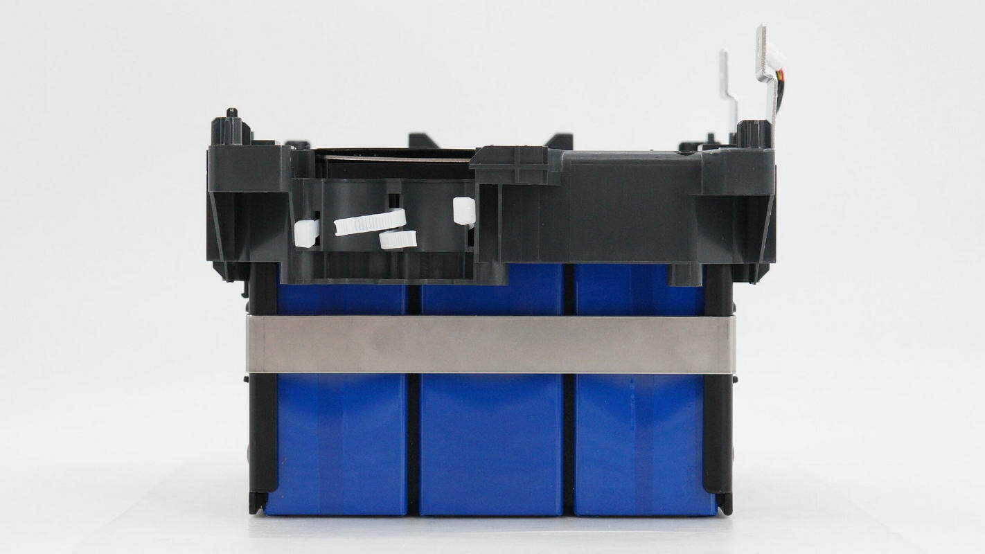

The battery pack is strapped with a steel band, with iron plates on both sides for protection.
The steel strap is secured by spot welding.

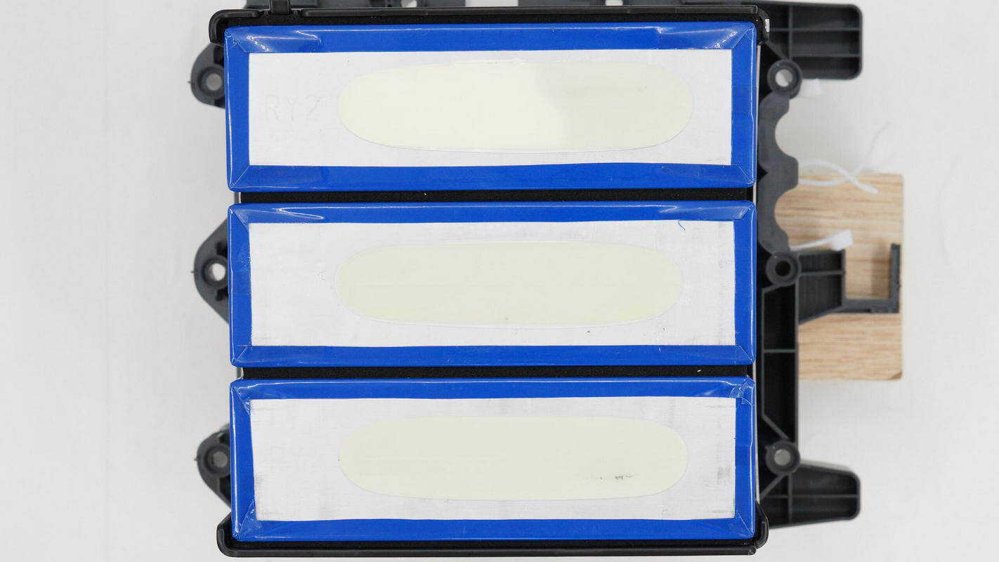

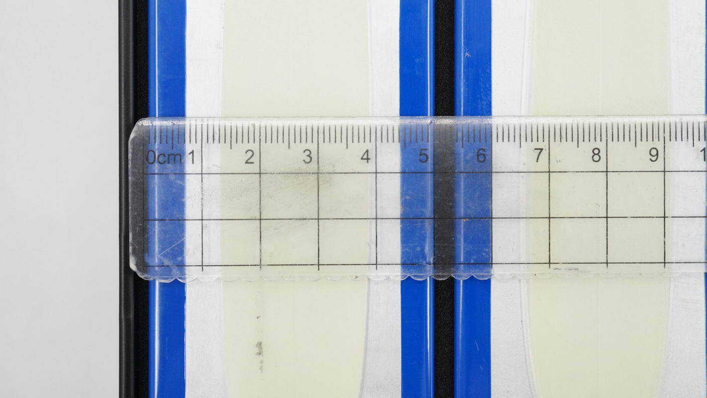

The batteries are prismatic lithium iron phosphate cells, encased in blue heat-shrink sleeves.
The bottom of the battery cells is secured with adhesive.

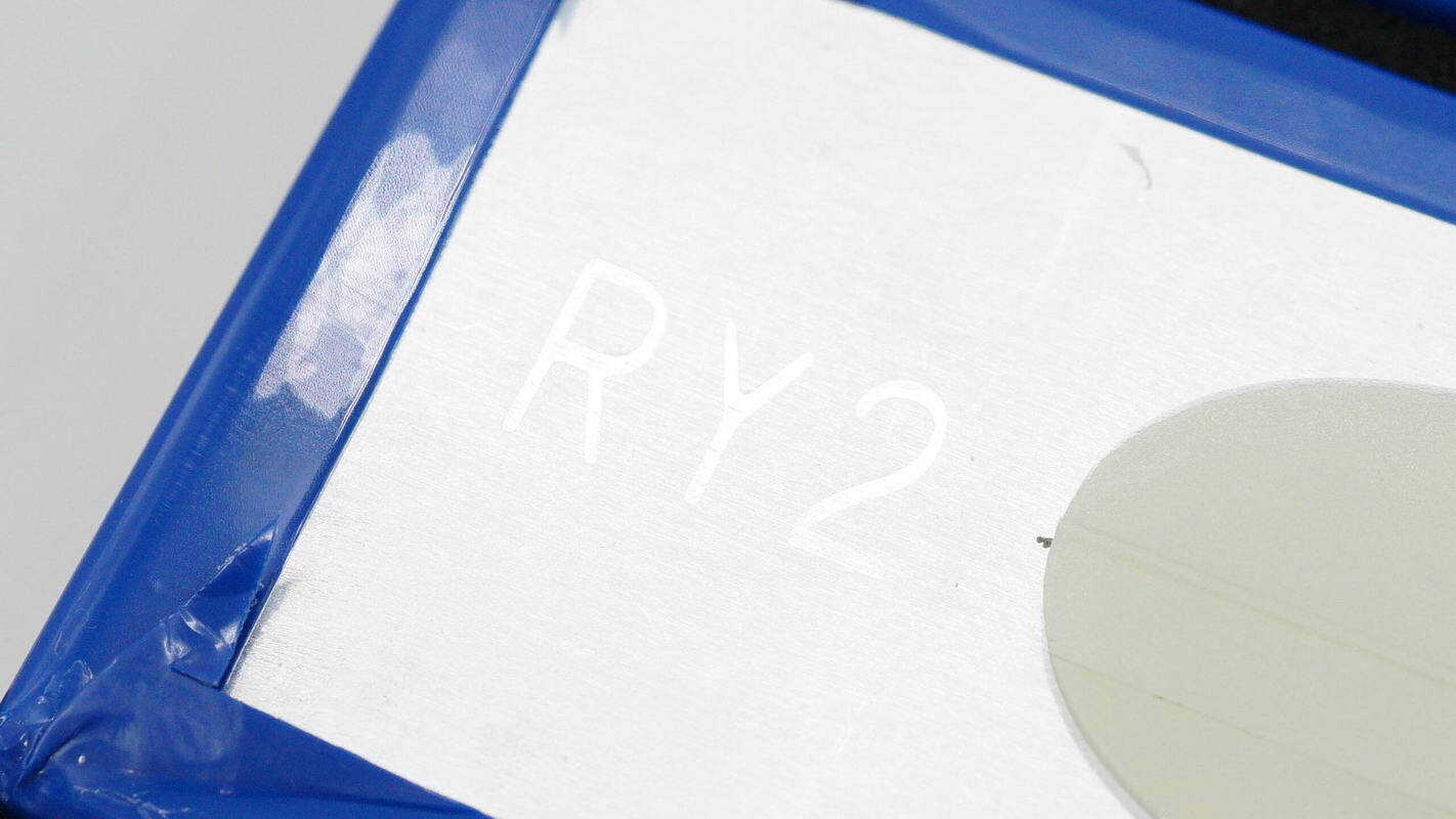

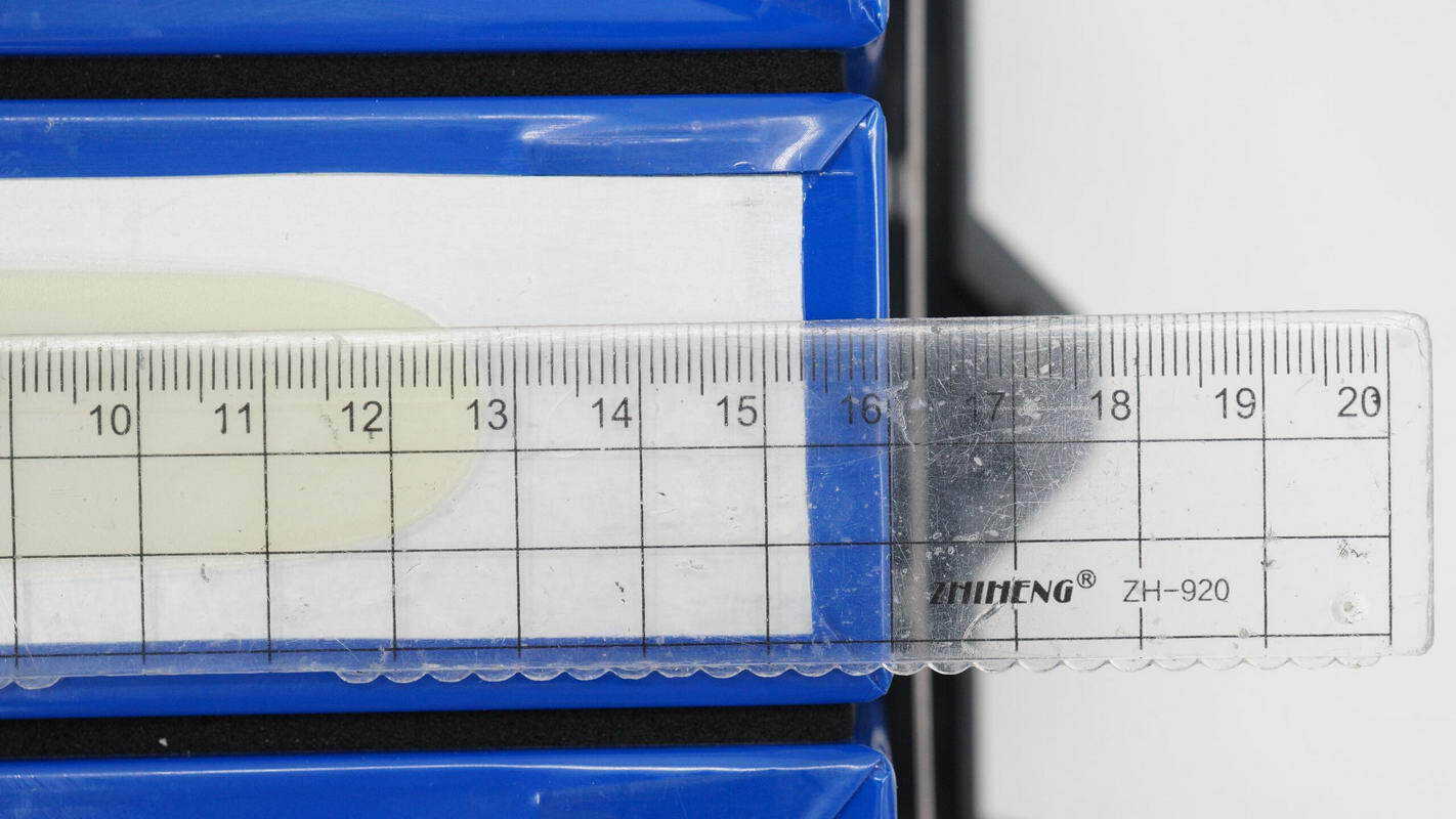

The bottom is marked with the characters "RY2."
The height is about 115 mm (4.53 inches).
The width is about 160 mm (6.3 inches).
The thickness is about 50 mm (1.97 inches).

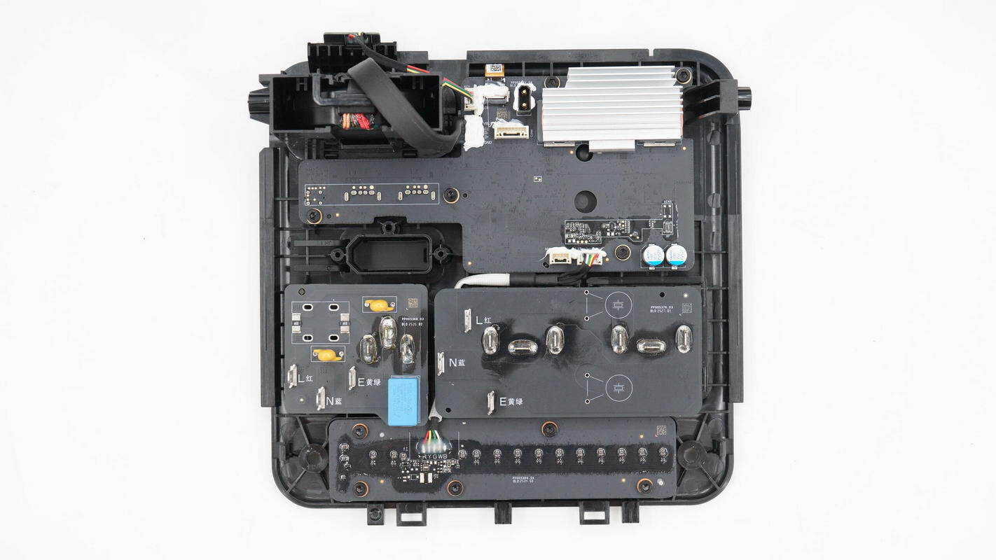

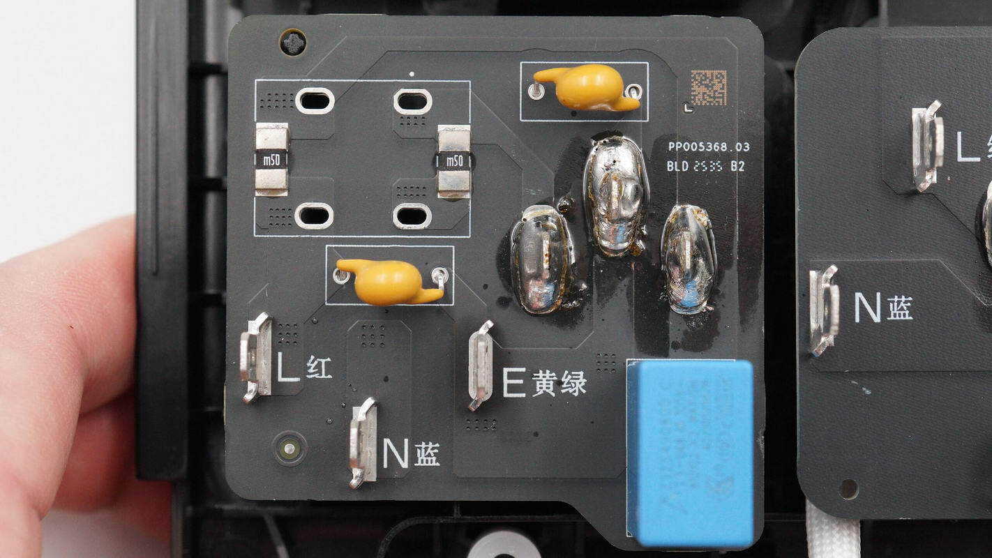

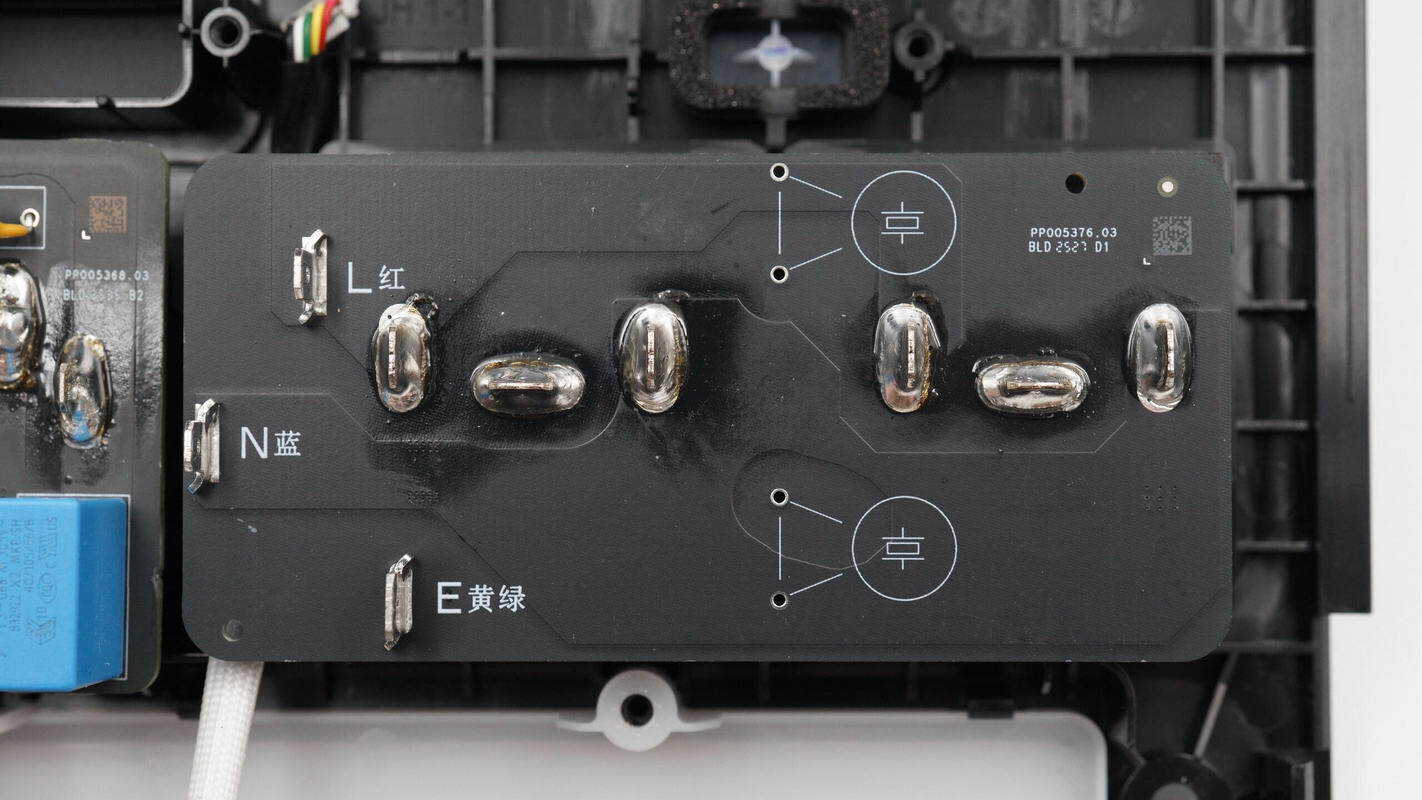

The wires of the bidirectional inverter module are connected via plug connectors.

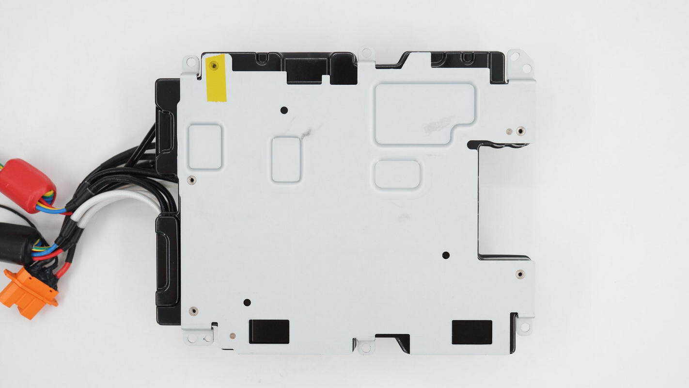

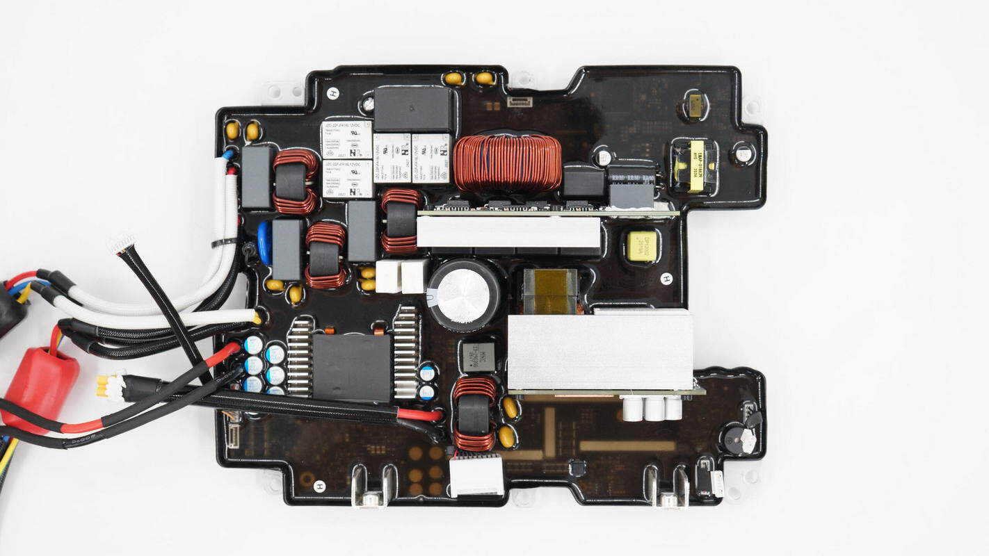

The bidirectional inverter module is equipped with inverter output wires, AC input wires, SDC interface wiring, safety X2 capacitors, common mode chokes, switching relays, a PFC inductor, and filter capacitors, among other components.
The metal plate on the back is used for mounting and securing the module.

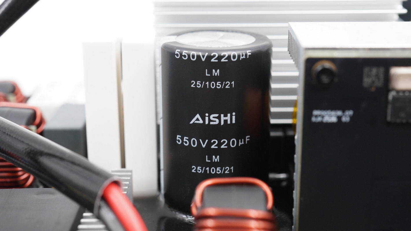

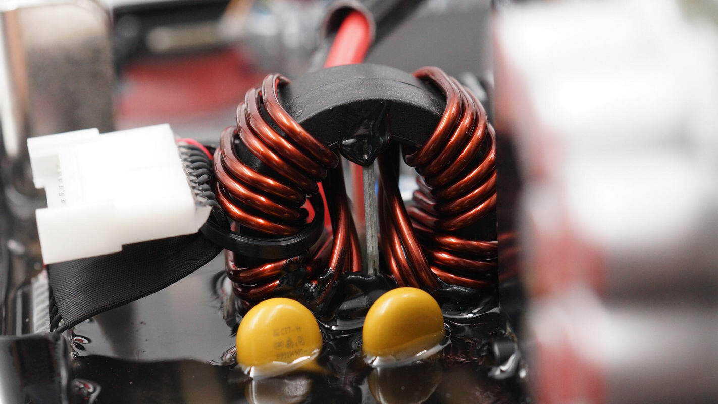

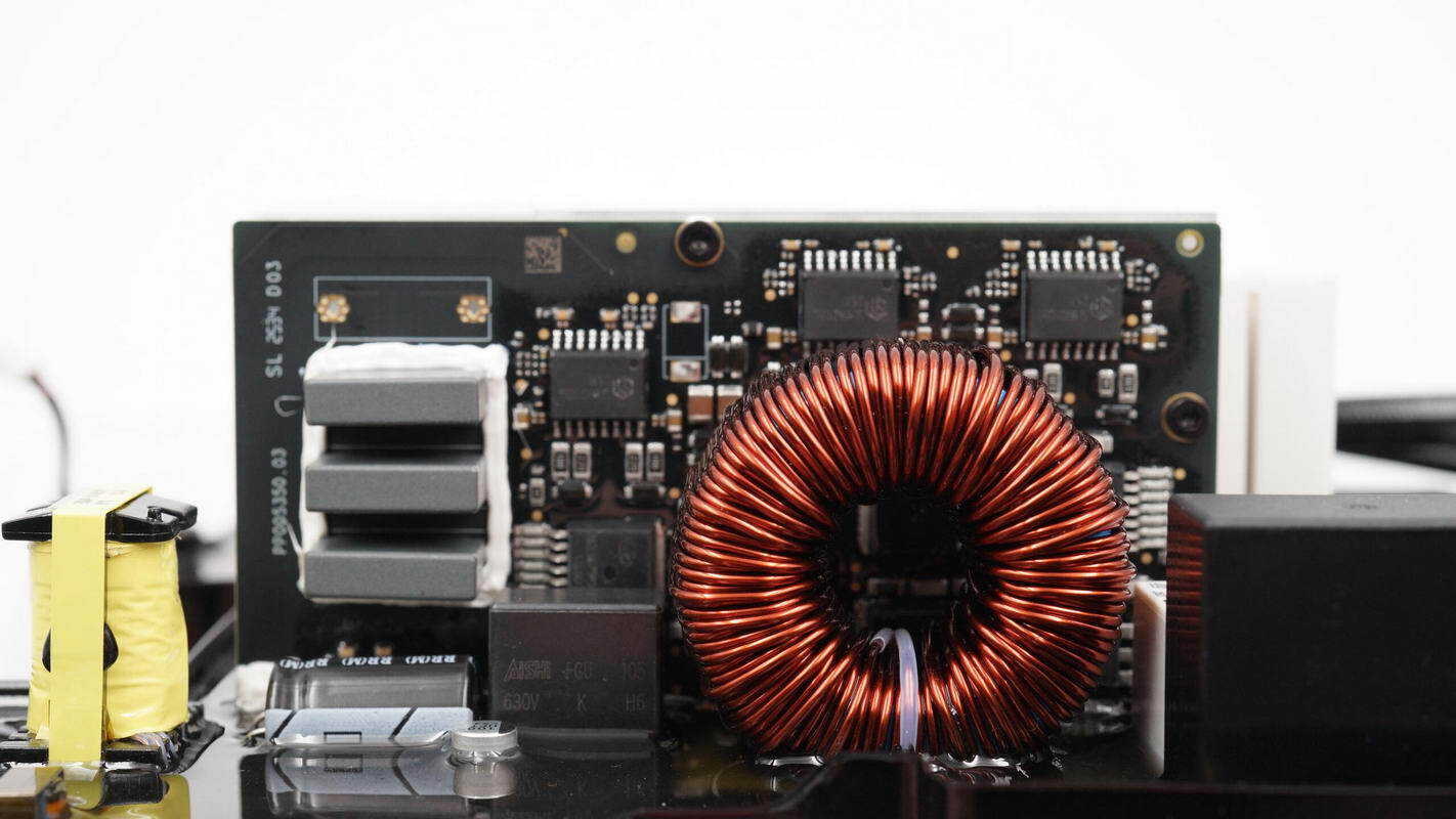

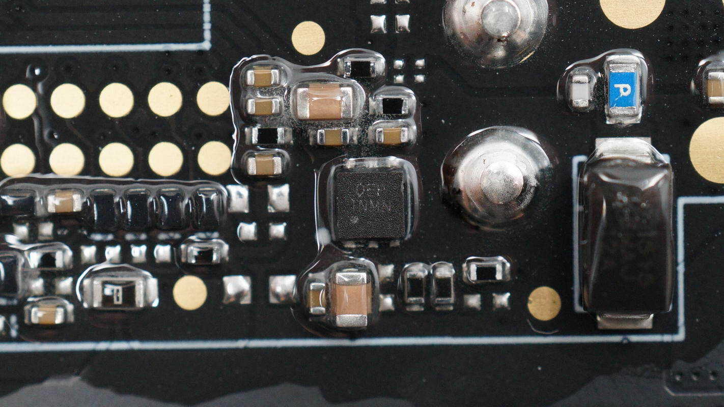

The DC input terminals are equipped with a common mode choke.

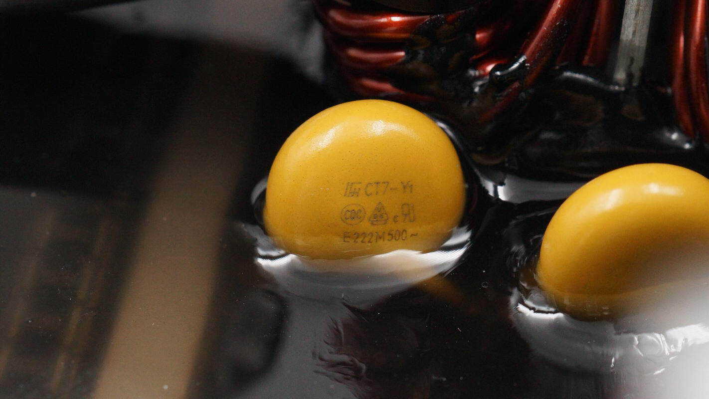

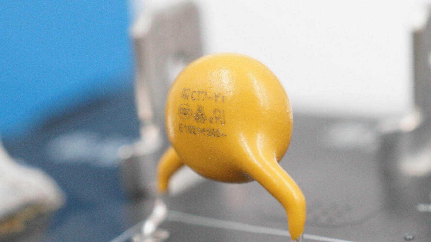

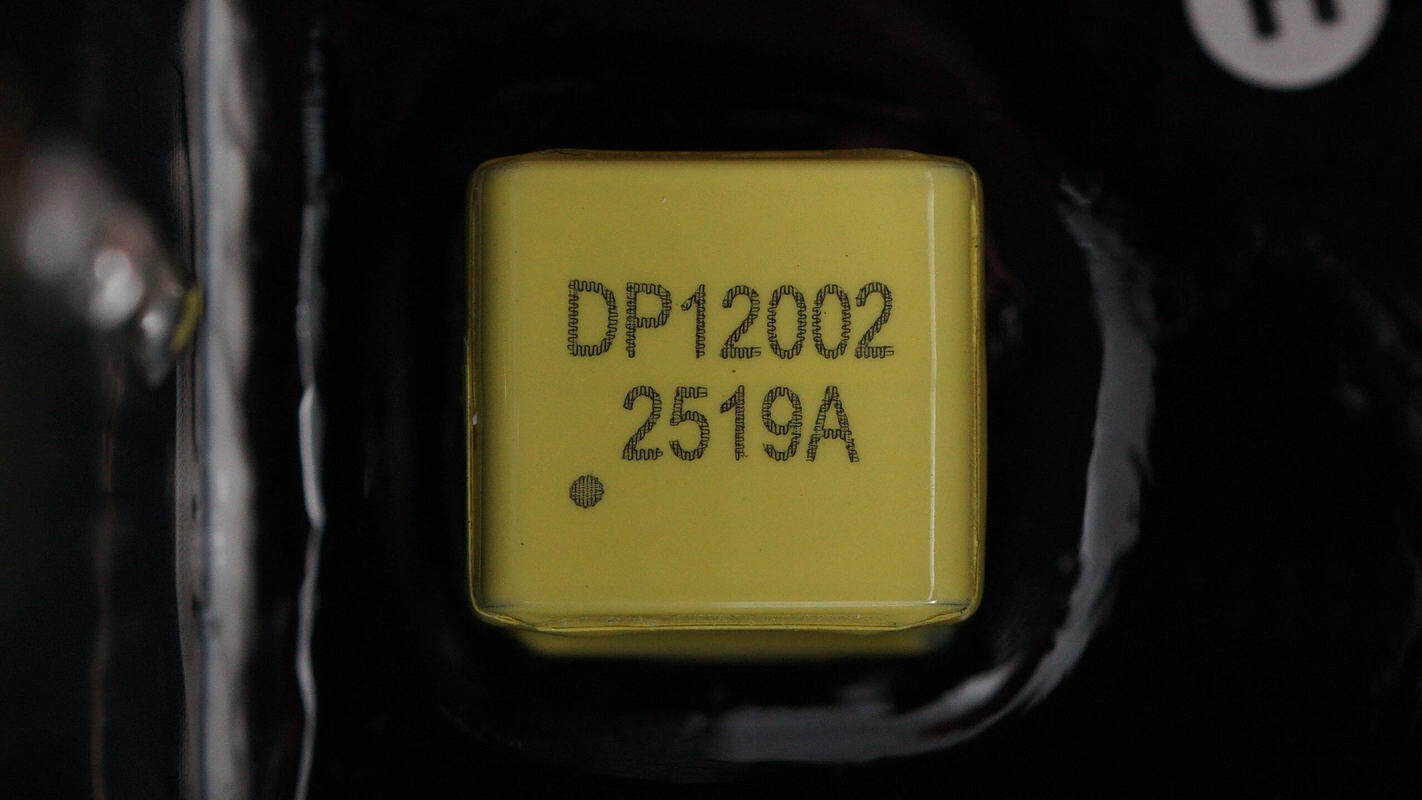

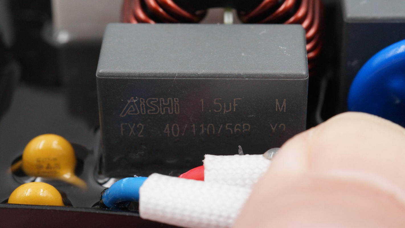

The yellow Y-capacitor is from FNR, with the part number E222M.

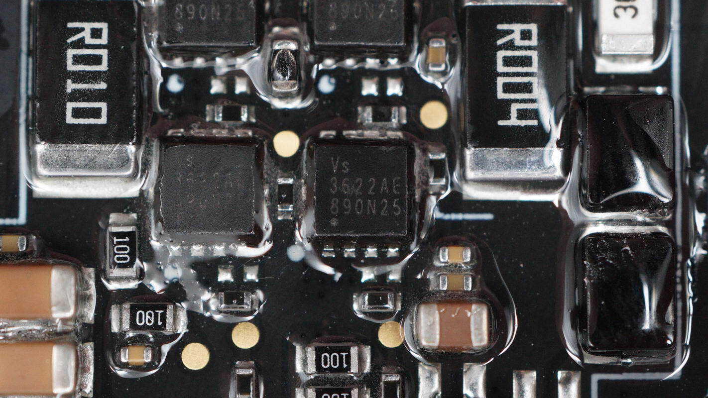

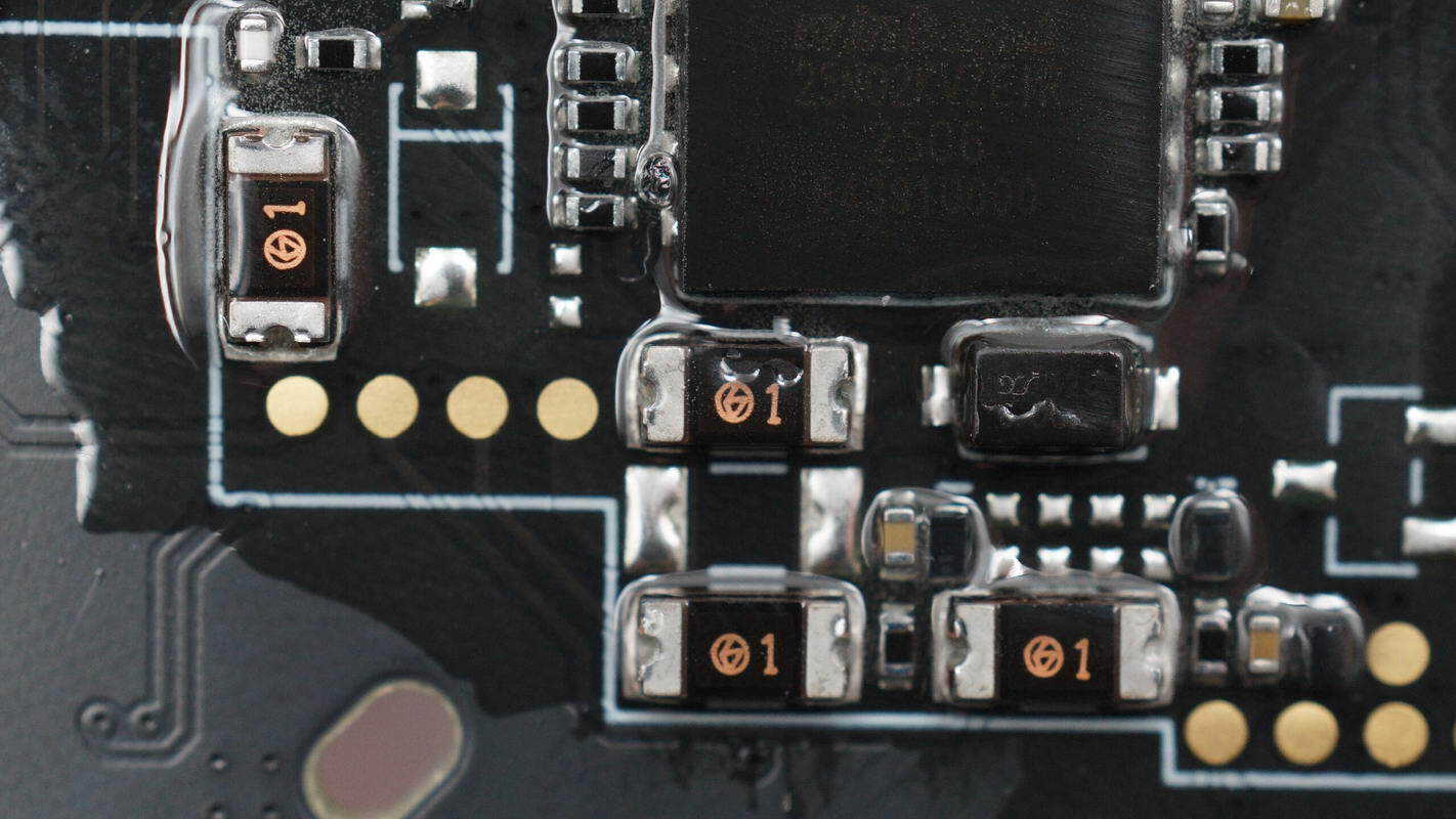

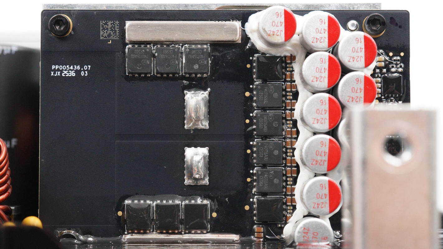

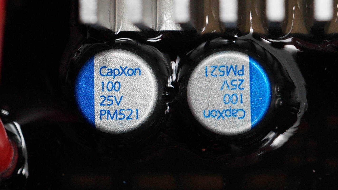

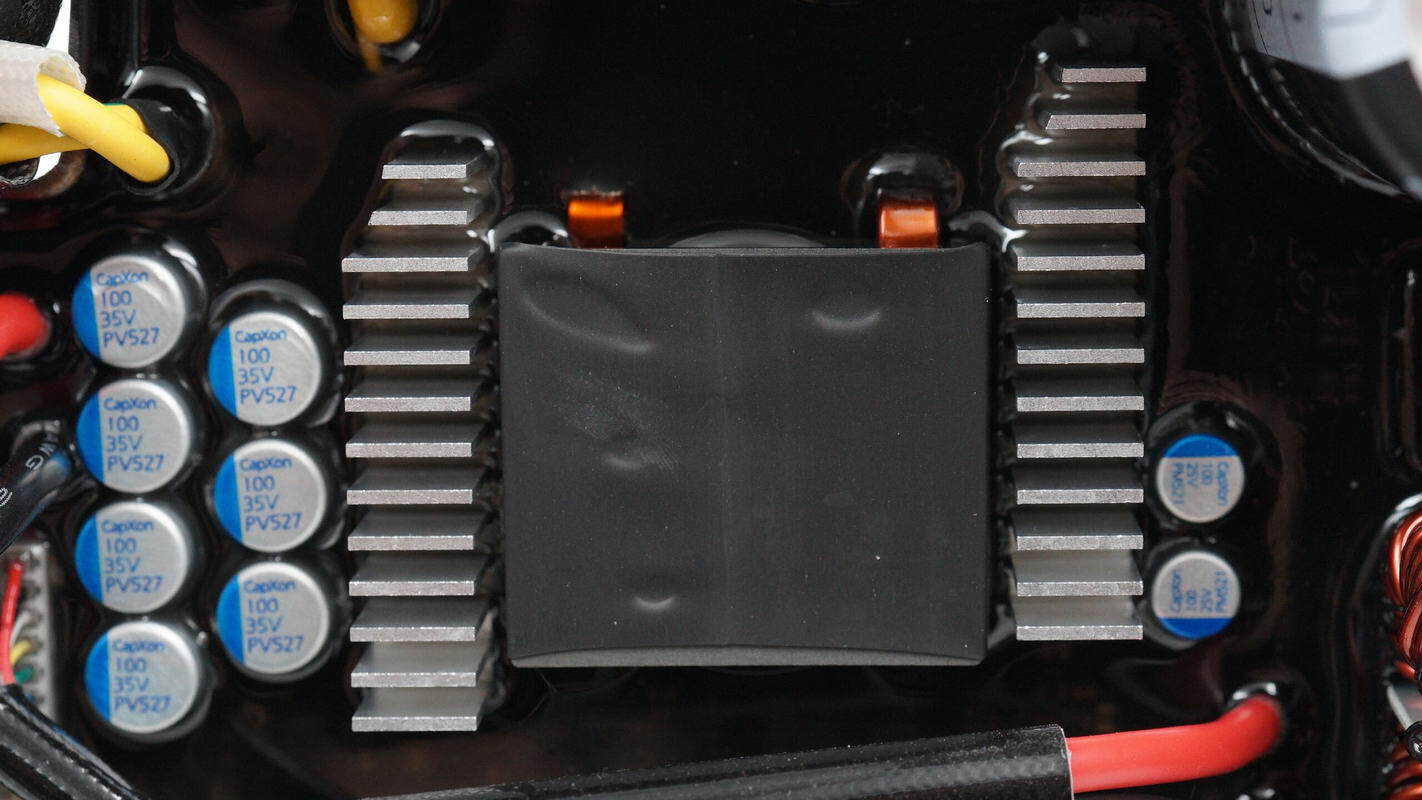

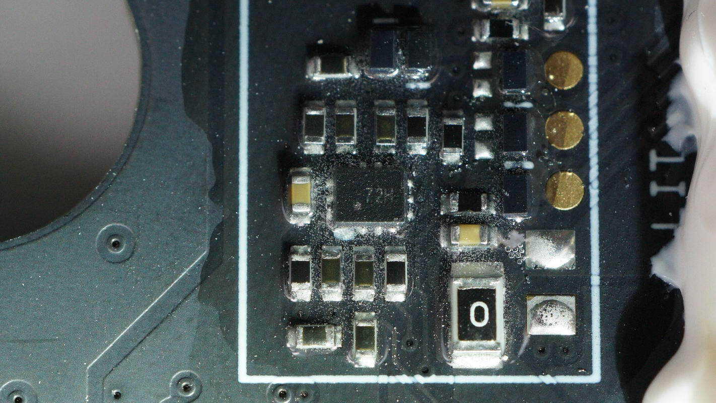

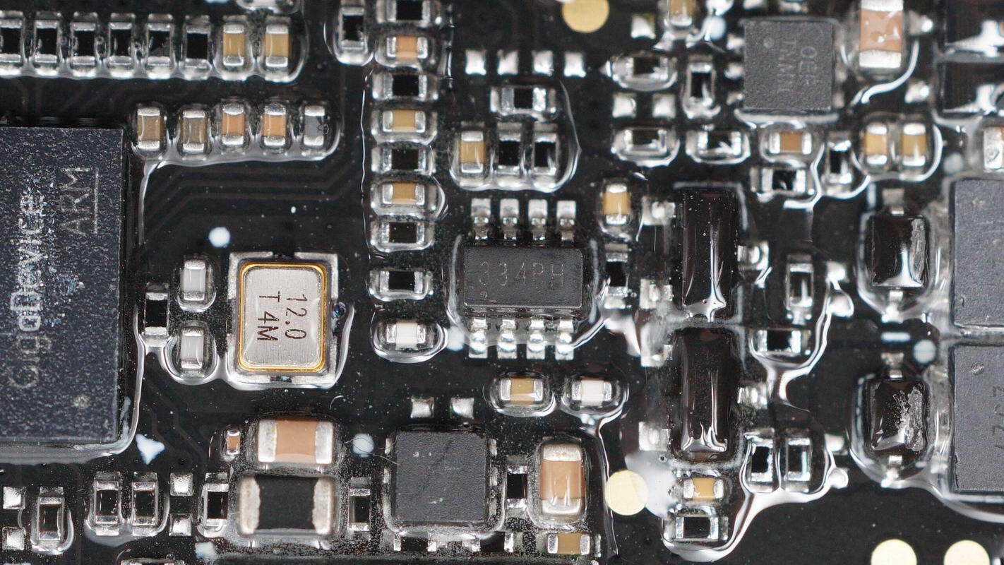

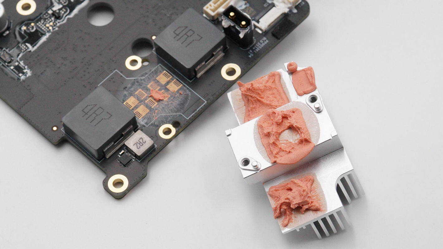

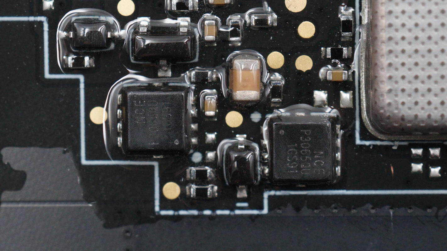

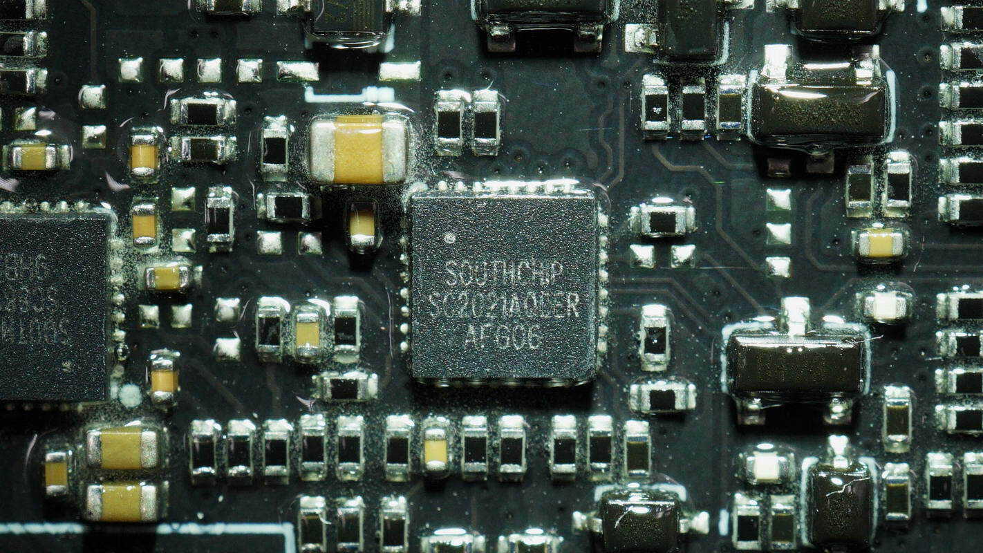

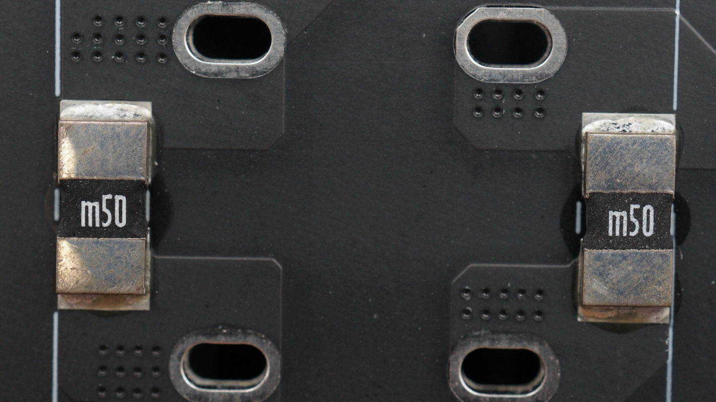

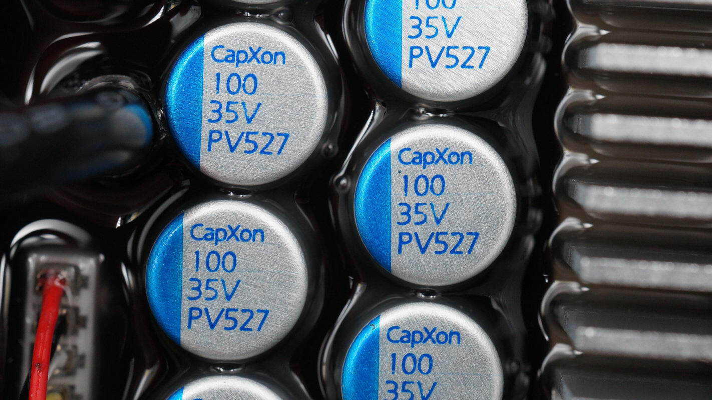

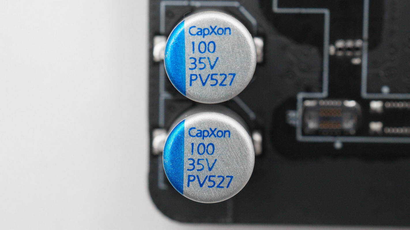

The small PCB on the low-voltage side features boost MOSFETs, solid capacitors, and drivers.

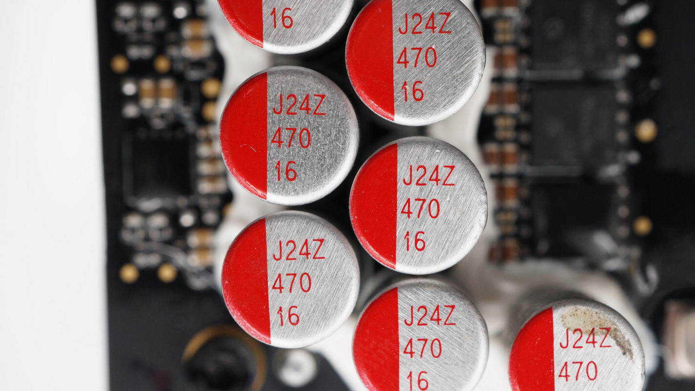

The solid capacitors are rated at 470 μF, 16 V.

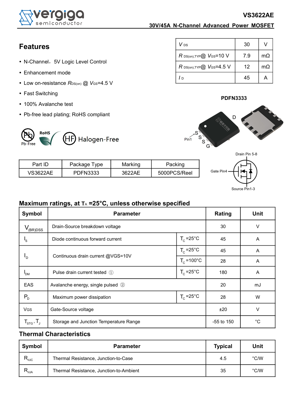

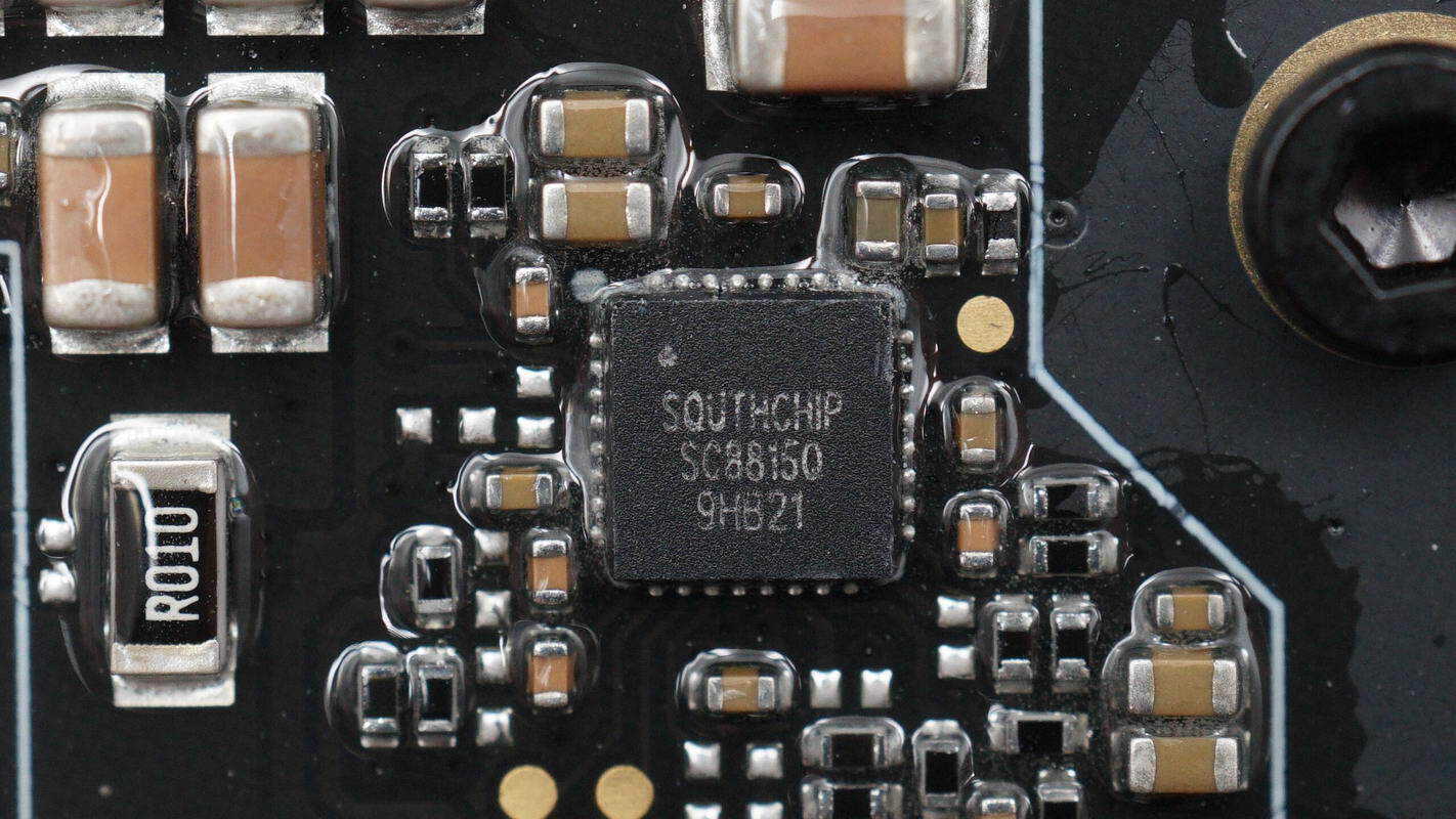

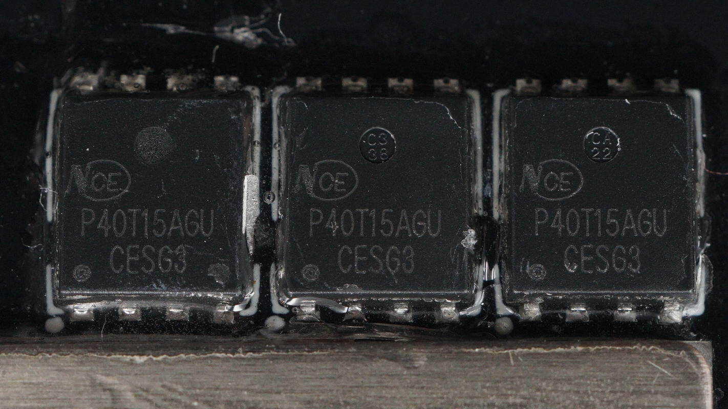

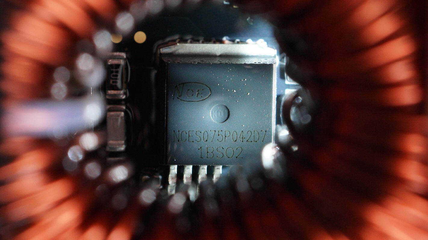

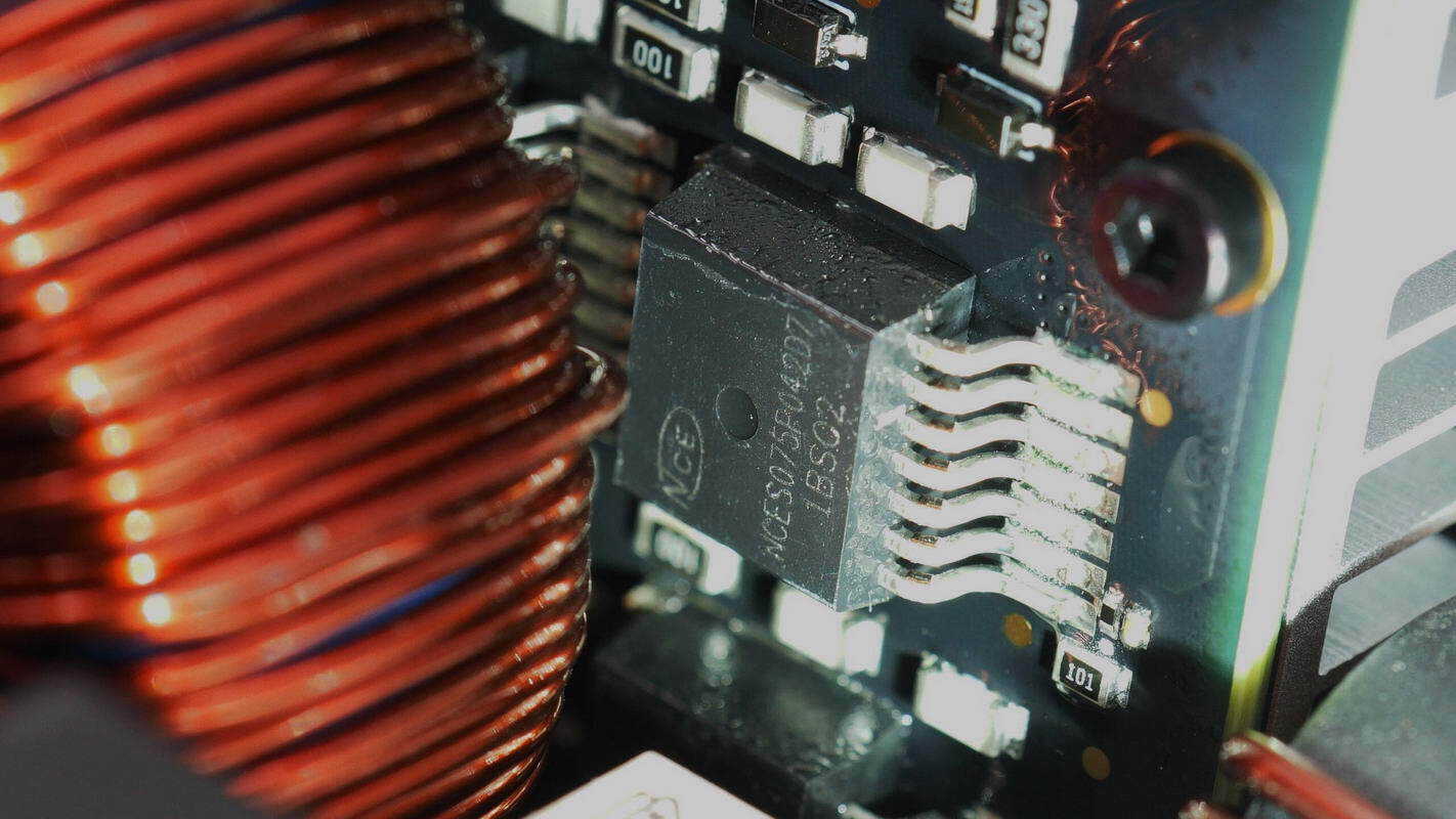

The boost MOSFETs are from NCE, model NCEP40T15AGU, NMOS type, rated at 40 V with an on-resistance of 1.2 mΩ, in a DFN 5×6 package, with a total of 12 units.

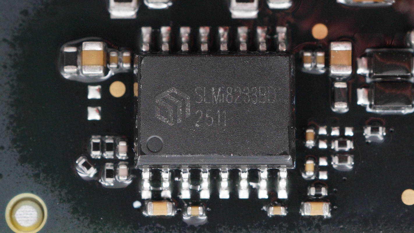

Two drivers are from SGMICRO, model SGM48211. Each is a 120 V half-bridge driver with fully independent high-side and low-side channels. The chip supports a peak current of 4 A, integrates bootstrap diodes, and comes in a TDFN 4×4 package.

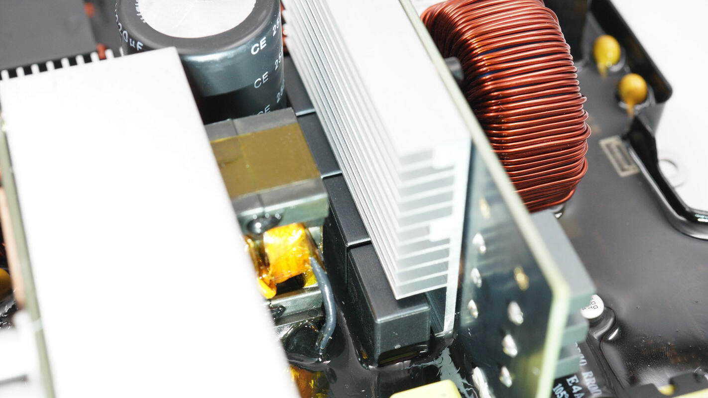

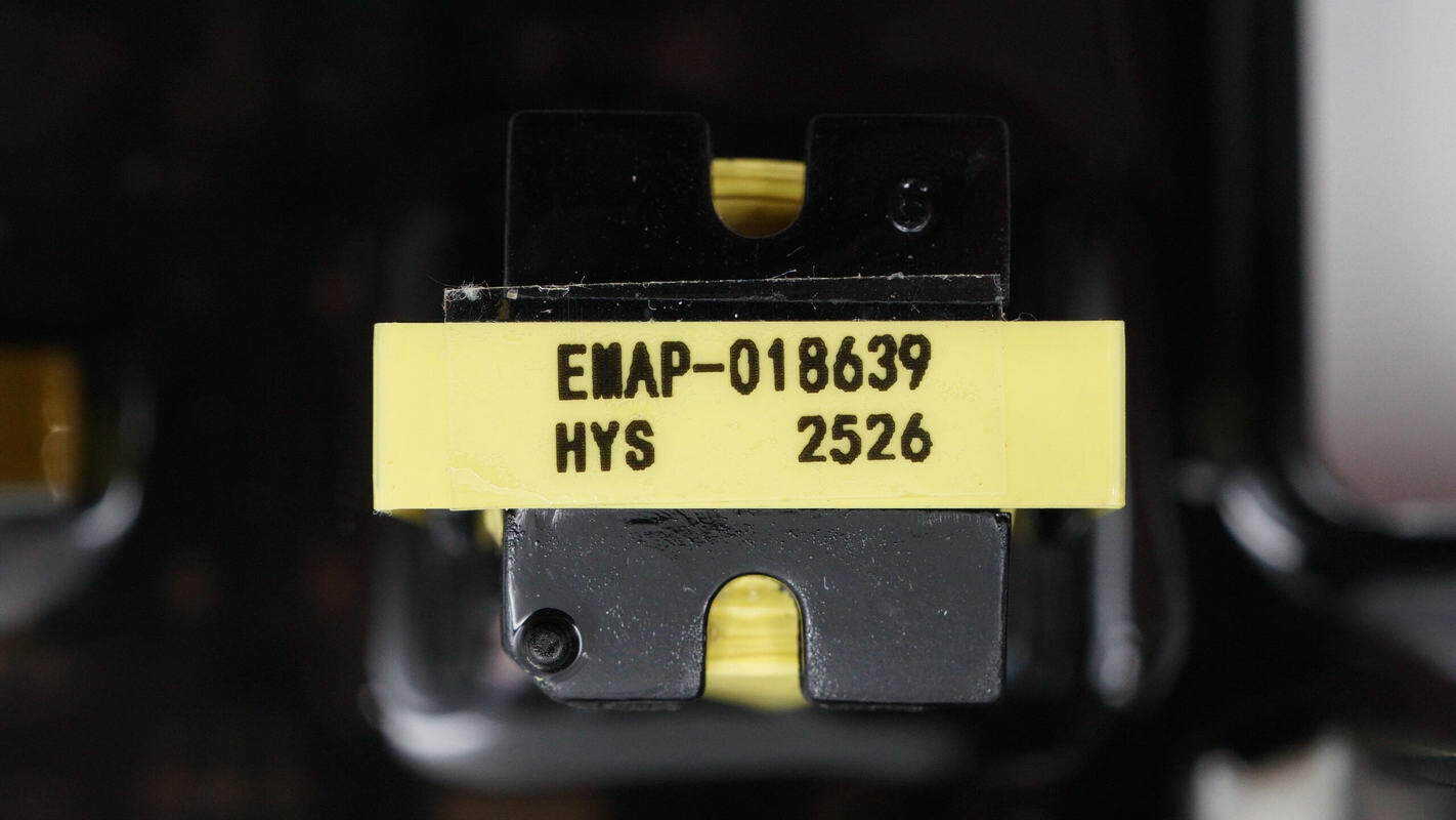

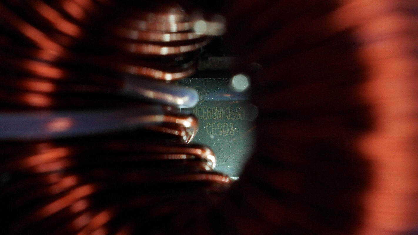

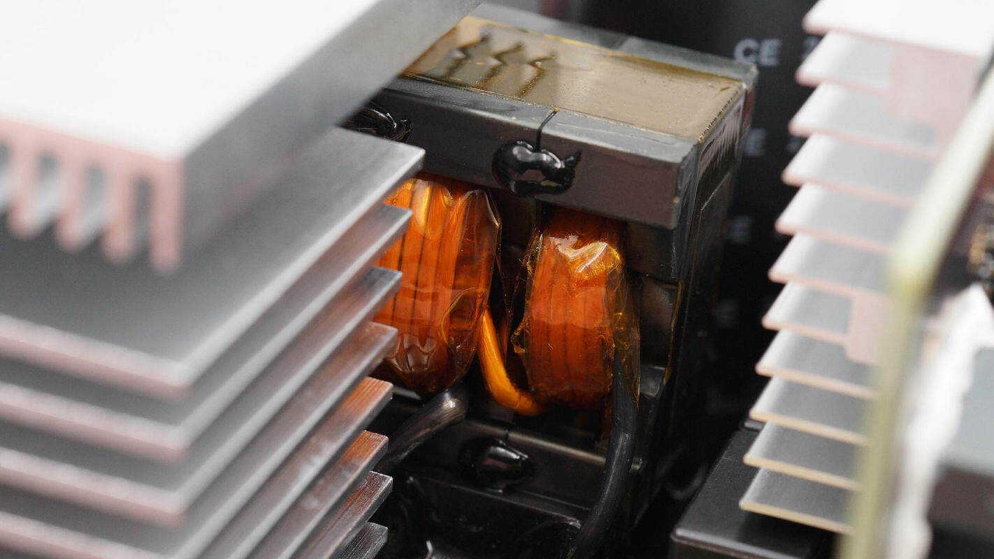

The boost transformer is wound with Litz wire.
There are four film capacitors mounted on the side of the transformer.

The high-voltage filter capacitor is from AiSHi, part of the LM series of long-life electrolytic capacitors, rated at 550 V, 220 μF.

The high-voltage MOSFET is from NCE, model NCES75P042D7. It is a silicon carbide MOSFET, rated at 750 V with an on-resistance of 42 mΩ, in a TO263-7L package.
The other MOSFET has the same model.
The solid capacitors are from CapXon, with a rating of 100 μF, 25 V.

The yellow Y capacitors are from FNR, with the part number E102M.

The left side of the side panel features USB-C and USB-A ports. On the other side, there are an MCU, synchronous buck-boost controllers, protocol chips, and MOSFETs. Inside the shielded enclosure, there is a wireless communication chip.
The back side features connection sockets, a heatsink, and filter solid capacitors.
Below the heatsink, there are inductors, which are coated with thermal gel to enhance heat dissipation.

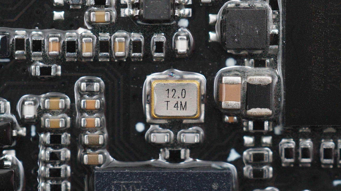

Close-up of the 12.0 MHz crystal oscillator.
Here is the information about Vergiga VS3622AE.

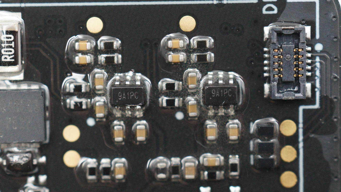

The current sensing chips are from 3PEAK, marked with 9A1, model TP181A1. They are zero-drift, bidirectional current sensing amplifiers, and come in SC70 packages.
The two filter capacitors are from CapXon, with a specification of 100 μF, 35 V.

It features a gray exterior with an integrated handle on the back. The front includes a display screen, USB-C port, USB-A ports, AC input and output sockets, an SDC interface, and a retractable cable. Inside, it is equipped with a 1000Wh lithium iron phosphate battery, supporting a rated output power of 1000W to meet the demands of high-power devices. The USB-C port supports 100W bidirectional fast charging, making it suitable for powering laptops.
After taking it apart, we found that it adopts a modular design, consisting of a display panel, a bidirectional inverter module, and a battery pack. The battery pack uses square lithium iron phosphate cells, which are insulated with a plastic frame. Metal plates are installed on both sides of the battery for protection, and they are secured with a steel band. Each cell is equipped with a thermistor to monitor temperature. The bidirectional inverter module is encapsulated with a hard resin to provide dust and moisture protection.
