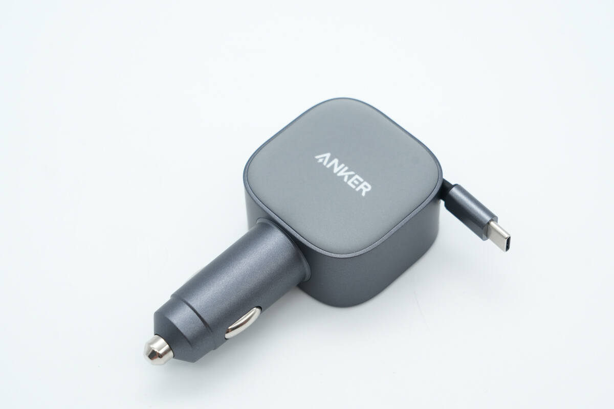

Teardown of Anker Nano 75W Car Charger (A2738)-Chargerlab
The exterior is made of flame-retardant PC material, coated with a silver-gray metallic paint. The front panel features a matte finish.
The center of the front panel is embossed with the ANKER logo.

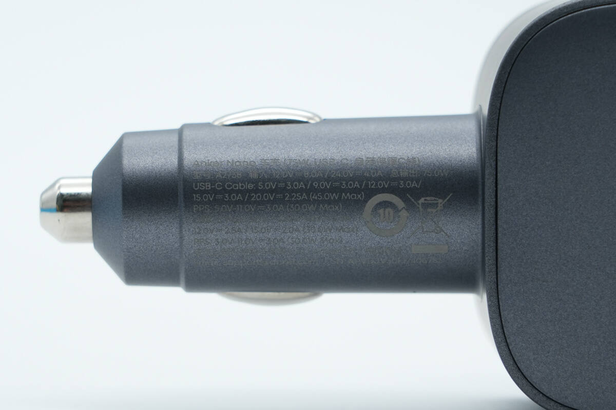

The back of the charger displays the specification information.
Model: A2738
Input: 12V8A, 24V4A
Total Output: 75W
USB-C Cable: 5V3A, 9V3A, 12V3A, 15V3A, 20V2.25A (45W Max)
PPS: 5-11V3A (30W Max)
USB-C: 5V3A, 9V3A, 12V2.5A, 15V2A (30W Max)
PPS: 5V-11V3A (30W Max)

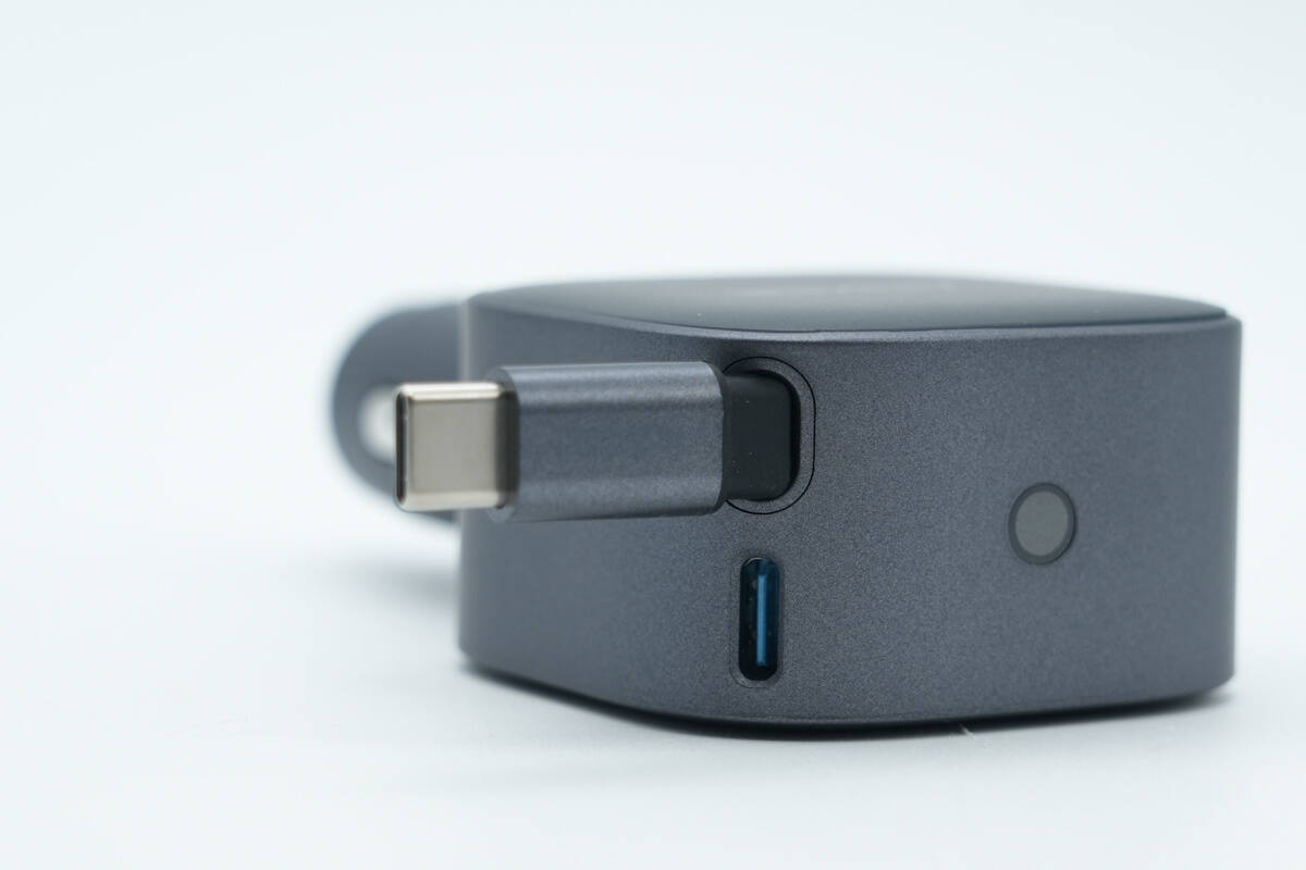

It is equipped with a USB-C port and a USB-C retractable cable.
The USB-C connector housing is also treated with a spraying process, and the cable itself is flat.

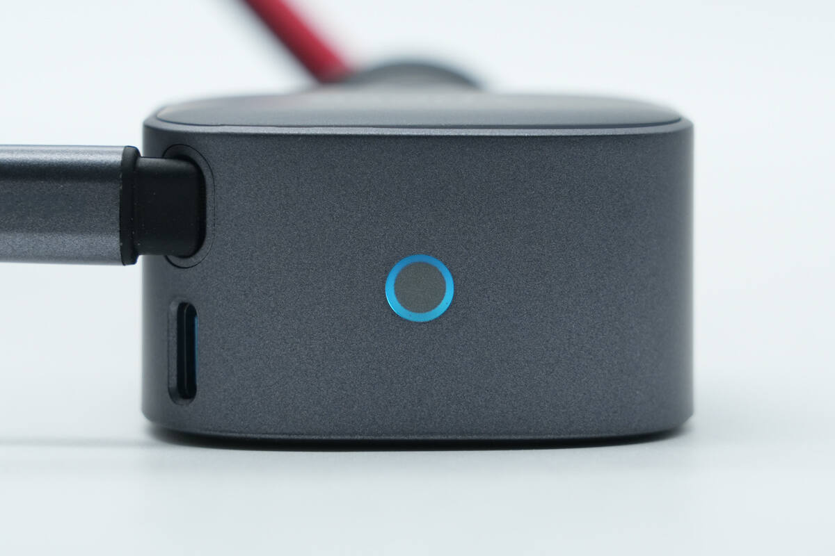

A ring-shaped indicator light is positioned at the center of the top, which automatically lights up when powered on.

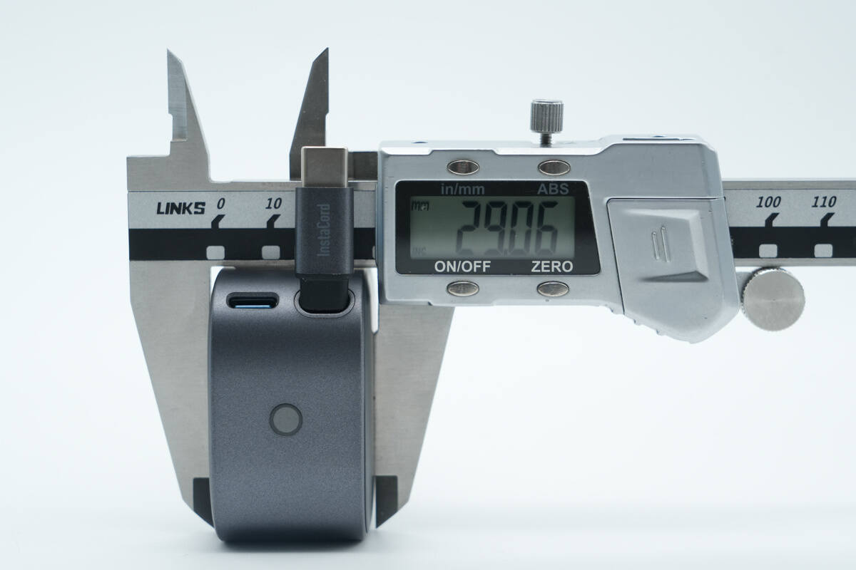

The thickness is about 29.06 mm (1.14 inches).

When powered on, the indicator light ring glows blue.

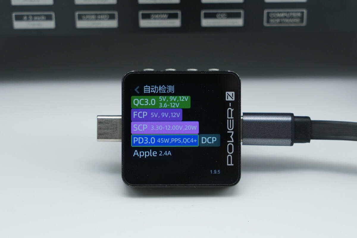

Simulating a 24V DC input scenario, the ChargerLAB POWER-Z KM003C shows that the USB-C retractable cable supports QC3.0/4+, FCP, SCP, PD3.0, PPS, DCP, and Apple 2.4A charging protocols.

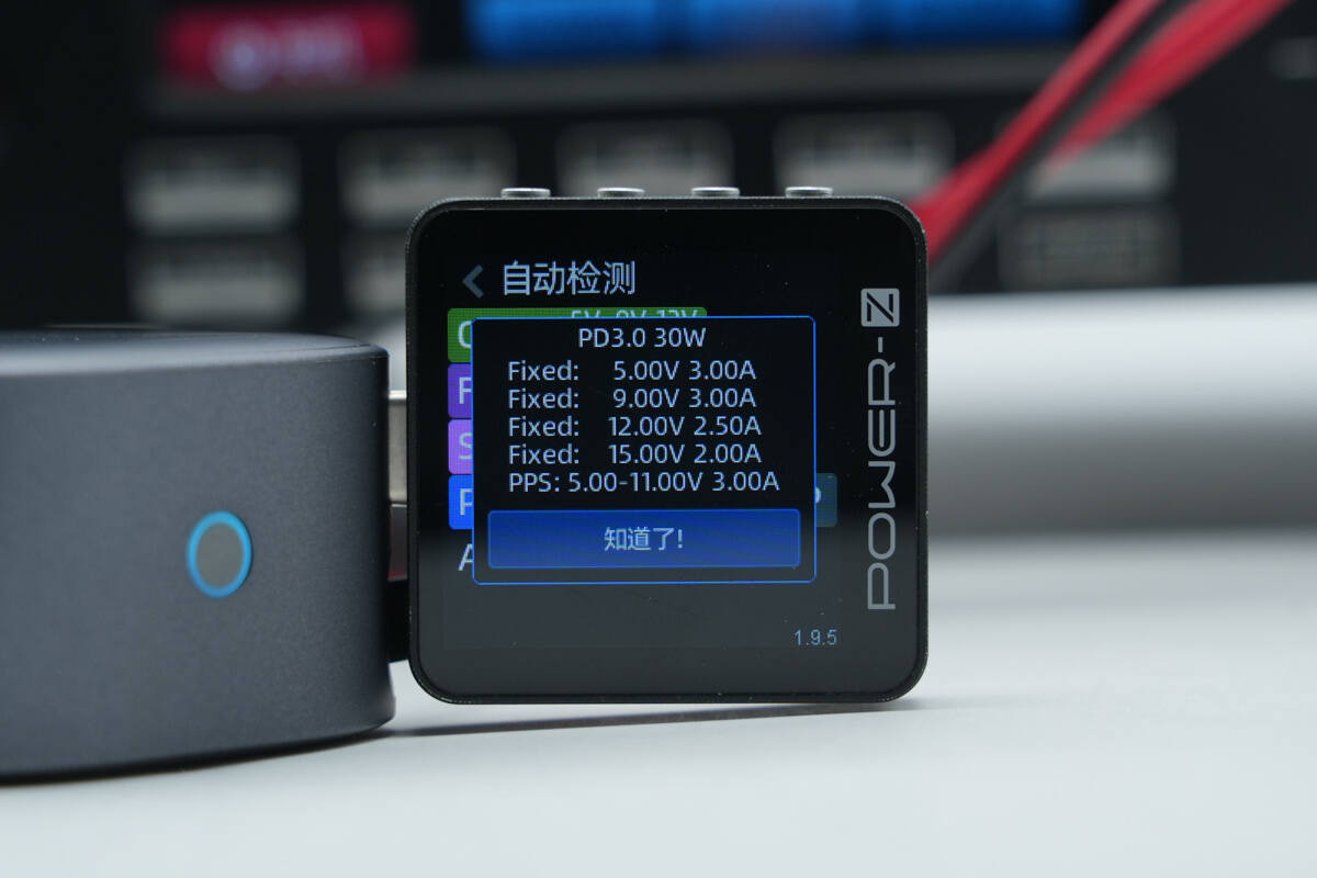

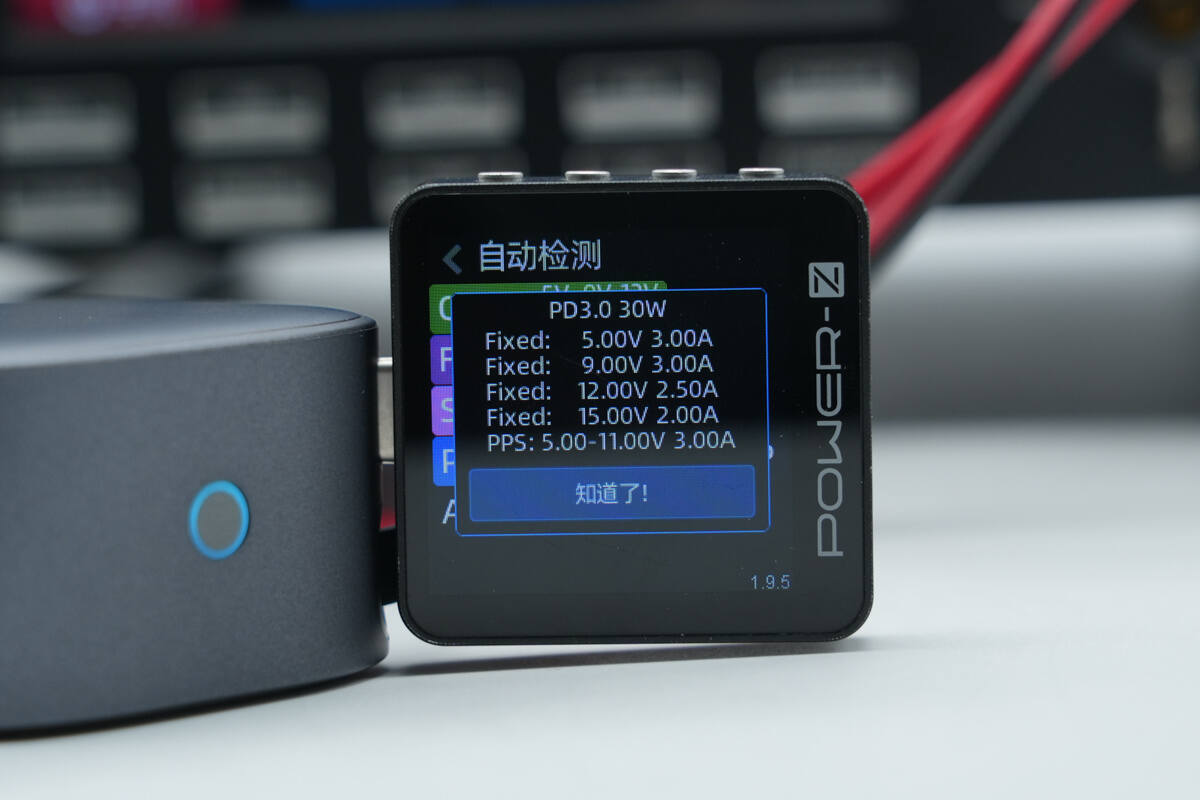

The USB-C port supports QC3.0/4+, FCP, SCP, PD3.0, PPS, DCP, and Apple 2.4A protocols.
It has four fixed PDOs of 5V3A, 9V3A, 12V2.5A, and 15V2A, as well as a set of PPS, which is 5-11V 3A.

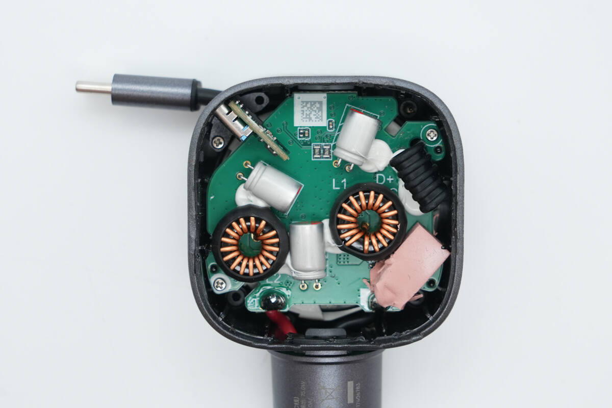

Upon removing the front panel, there are screws inside.
After removing the screws and continuing the disassembly, the PCBA is also secured with screws.
Inside, there is also a small input PCB and a retractable cable module. The small input PCB is connected to the PCBA module via red and black wires.
Remove the small input PCB; the front features an SMD fuse, a negative metal contact, and connecting wires.
The PCBA module and the retractable cable module are connected by a ribbon cable, with both ends of the solder joints sealed with glue.
A front view of the PCBA module shows the USB-C port soldered onto a small PCB. The solid capacitors and inductors are reinforced with glue.
The back side features synchronous buck-boost controllers, synchronous buck-boost MOSFETs, a protocol chip, and an output VBUS MOSFET.

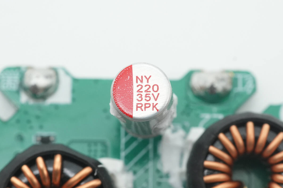

The solid capacitor used for input filtering has a specification of 35V 220μF.

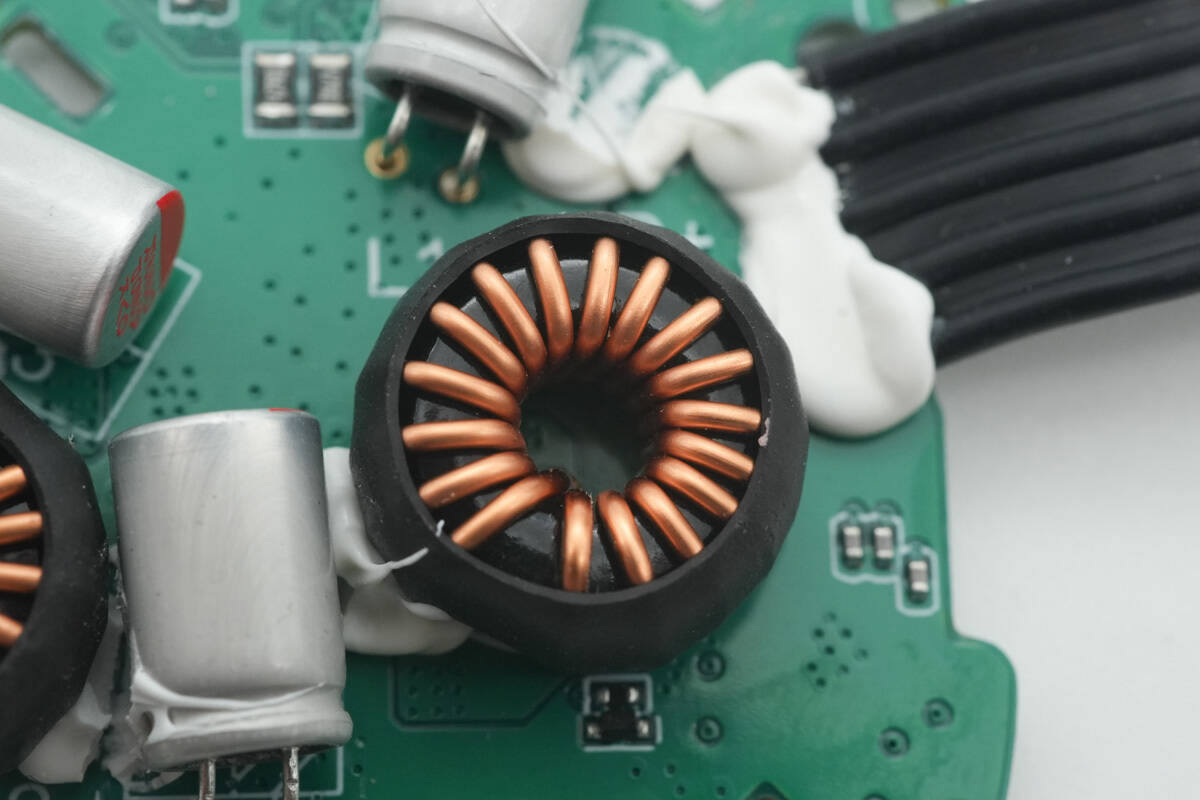

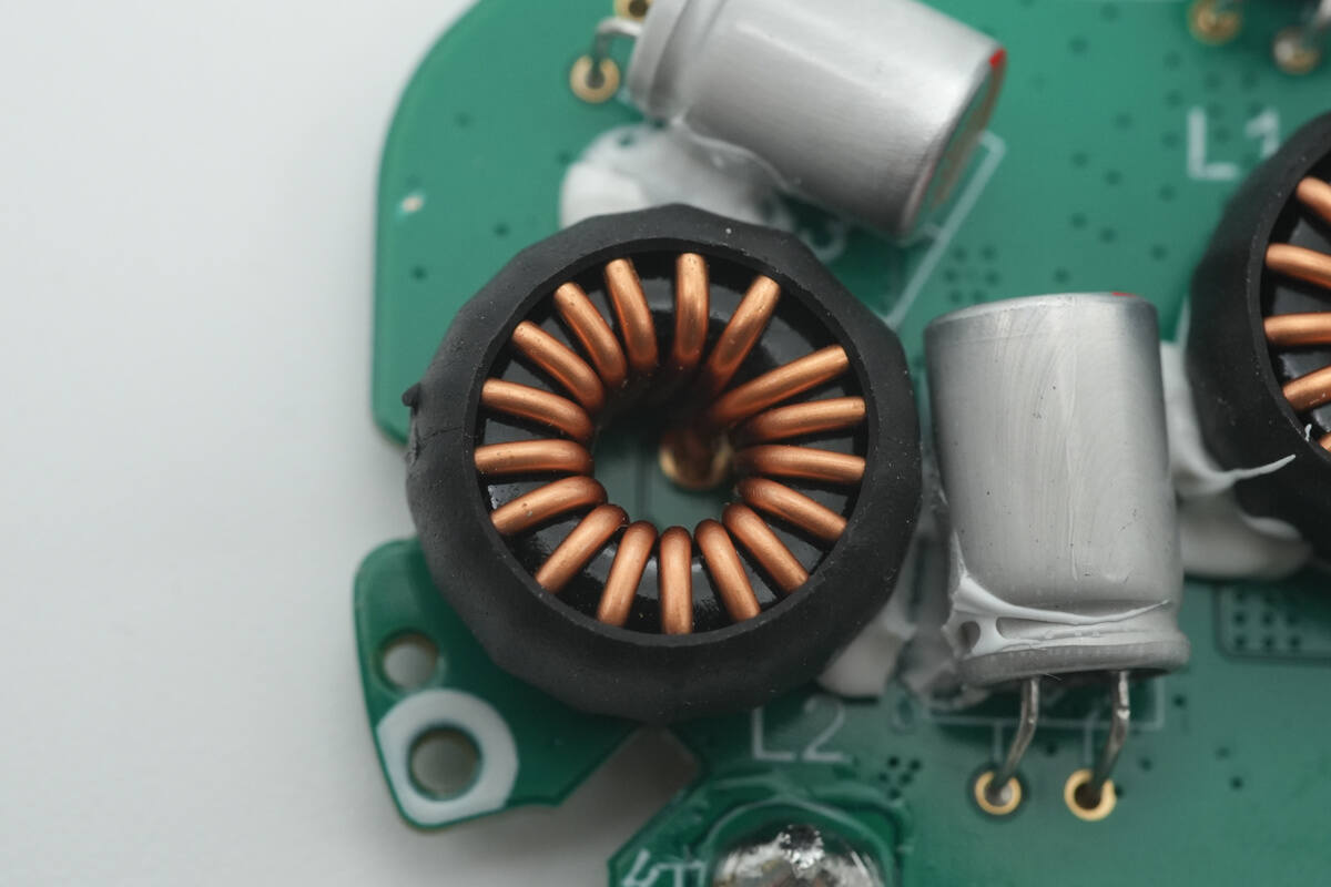

The paired buck-boost inductors are insulated with heat shrink tubing.
Close-up of the other inductor.

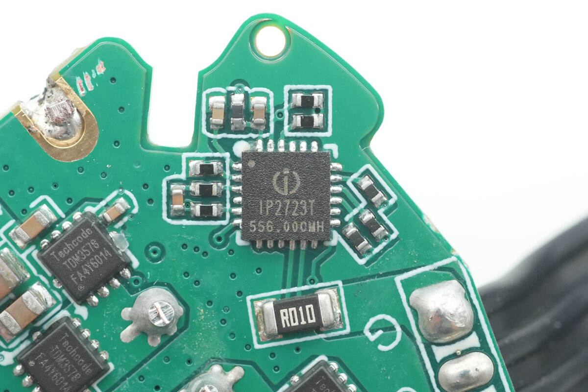

The protocol chip for the USB-C retractable cable is from Injoinic, with the model IP2723T. This chip has been certified by the USB-IF Association for PD3.0 PPS, with TID: 3135. It is an integrated protocol IC for fast charging protocols used in USB output ports. The chip supports multiple fast-charging protocols, including USB Type-C DF, PD2.0/3.0, PPS, HVDCPQC4, QC4+, QC3.0/2.0, FCP, SCP, AFC, MTKPE+2.0/1.1, Apple 2.4A, BC1.2, and Samsung 2.0A.
On the right side is the TVS protection diode for the USB-C female connector, which provides electrostatic protection.
The IP2723T provides a complete TYPE-C solution for adapters, car chargers, and other single-output applications. Additionally, it features high integration and rich functionality, requiring minimal external components during implementation, which effectively reduces the overall solution size and lowers BOM costs.

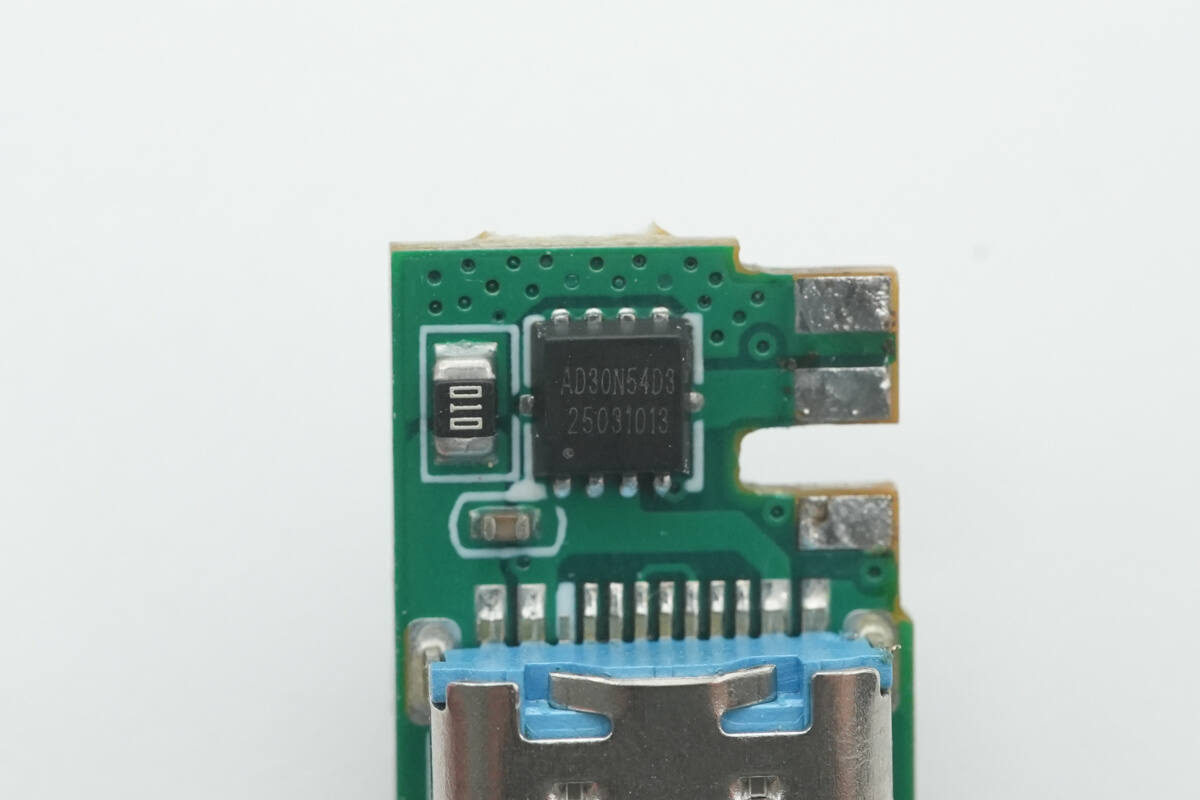

The VBUS MOSFET is from ADAMANT, with the model number AD30N54D3. It is an NMOS transistor, rated for 30V voltage tolerance, with a conduction resistance of 5.7mΩ. The MOSFET is packaged in a PPAK 3*3 form factor.

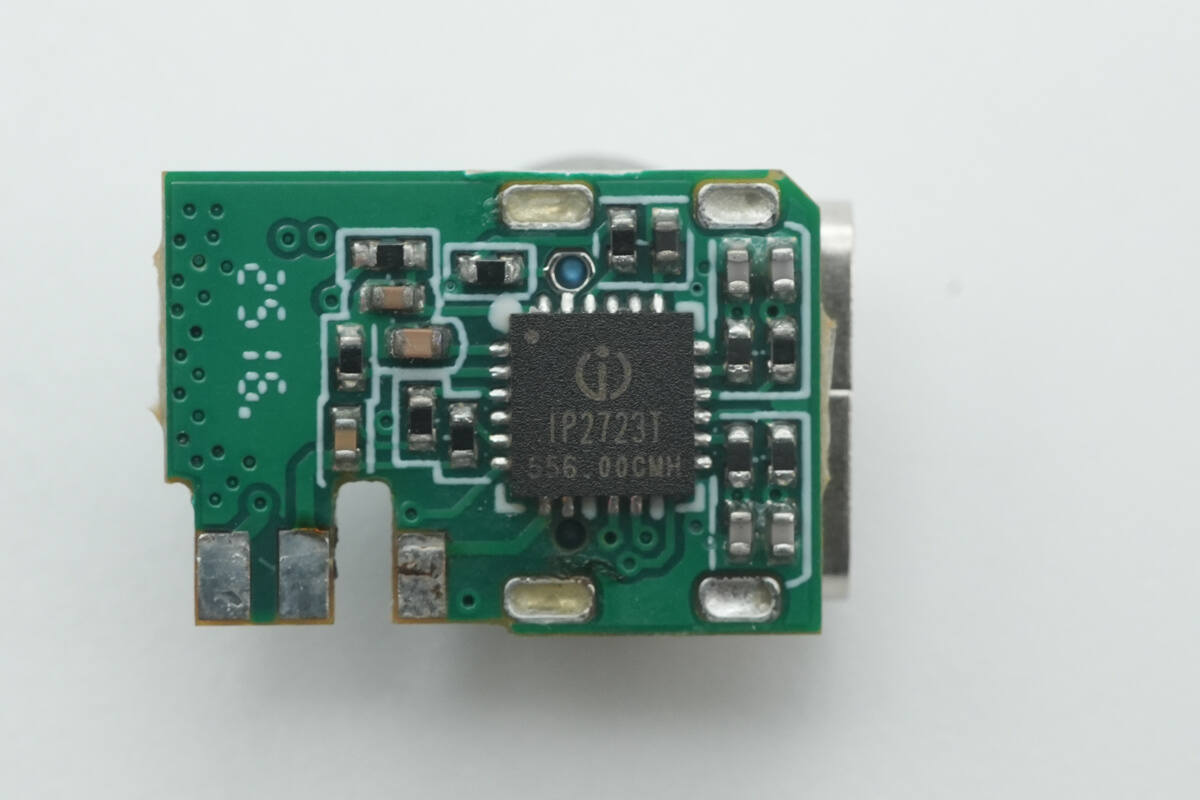

The protocol chip for the USB-C port also uses the Injoinic IP2723T model.

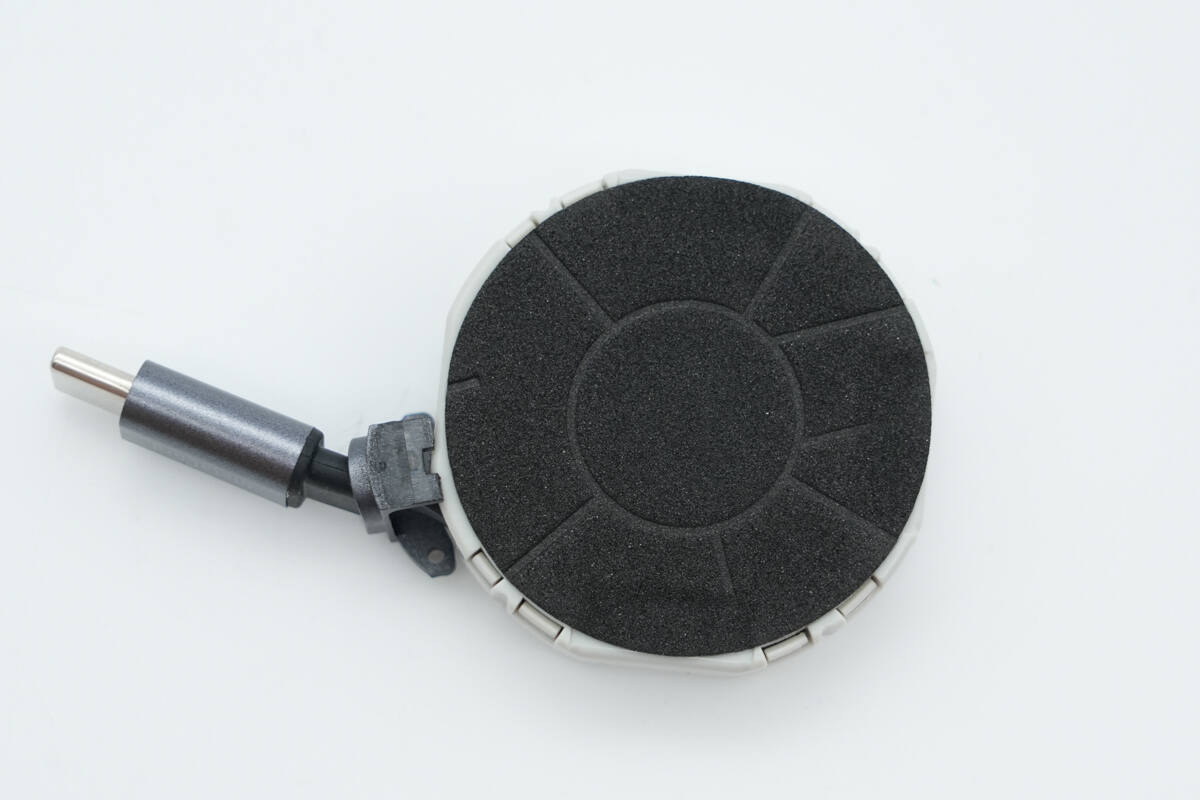

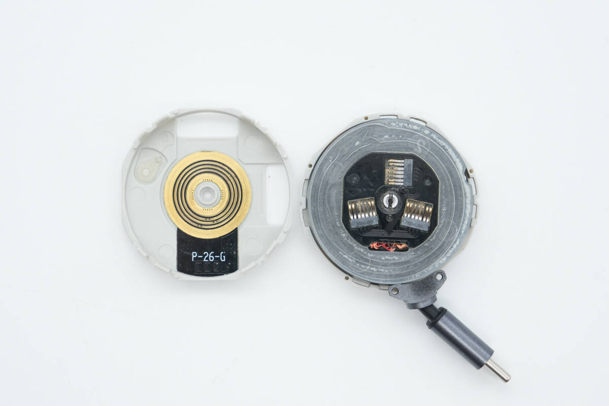

The other side of the retractable cable module has a cushioning protective pad attached.
A view of the disassembled retractable cable module.
The spool is equipped with three brushes to increase current-carrying capacity.

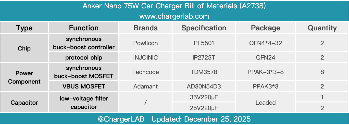

Here is the component list of the Anker Nano 75W Car Charger for your convenience.
It is equipped with a USB-C port and a USB-C retractable cable, supporting independent dual outputs of 45W and 30W, meeting the charging needs of both the driver and passenger simultaneously. The retractable cable module features manganese steel bearings, which support over 10,000 pull-retract cycles without stuttering. The cable is durable, capable of withstanding more than 12,000 bends without cracking, ensuring a long lifespan and smooth retracting experience. With a cable length of 75cm, it is more than sufficient for use within the car.
After taking it apart, we found that it uses two independent buck-boost circuits, both utilizing the Powlicon PL5501 synchronous buck-boost controller paired with Techcode MOSFETs. Both protocol chips are the Injoinic IP2723T. The PCBA module is secured with screws, with capacitors and inductors reinforced with glue. The retractable cable module is equipped with a cushioning protective pad.
