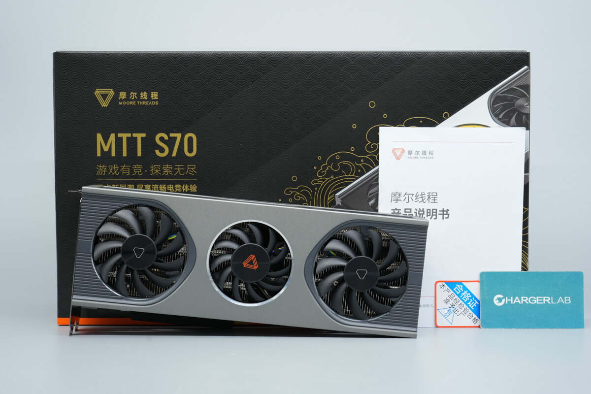

The package includes the MTT S70 graphics card, a product manual, and a quality inspection certificate.

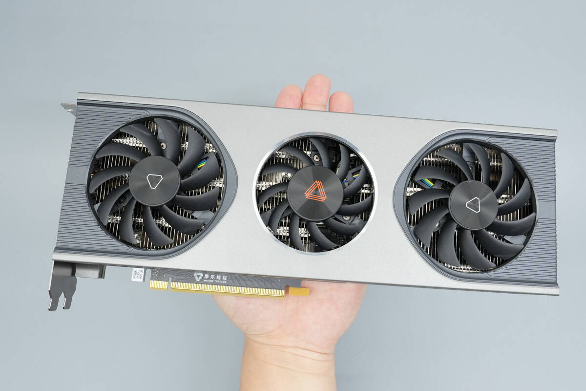

Teardown of Moore Threads MTT S70 Graphics Card-Chargerlab

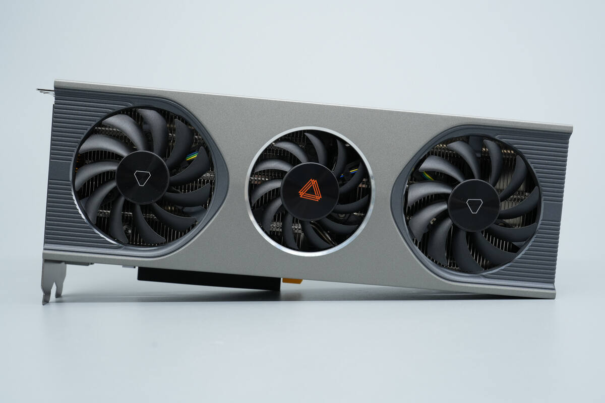

The graphics card features a metal shroud and a triple-fan cooling design.

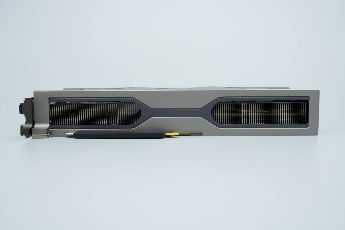

The side features an open design to facilitate hot air exhaust.
The opposite side also features an open design.
Close-up of the cooling grille.

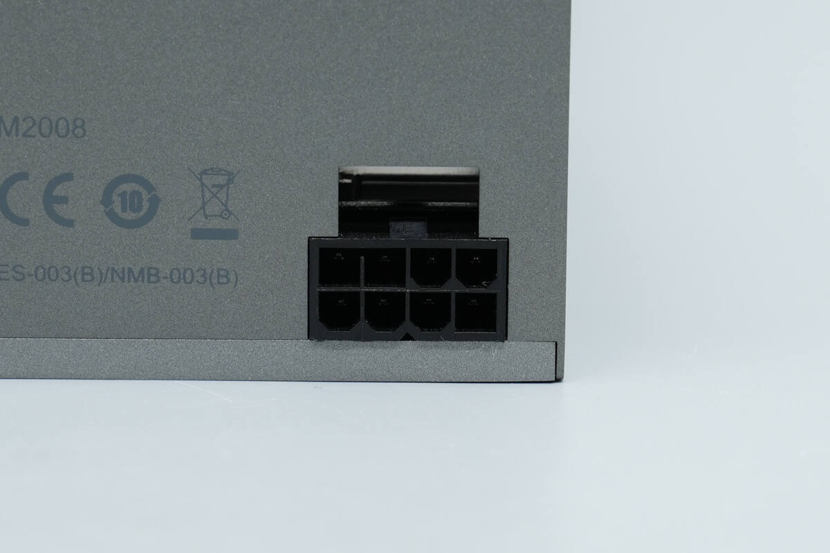

After removing the warning label sticker, the PCIe 8-pin power connector is exposed.

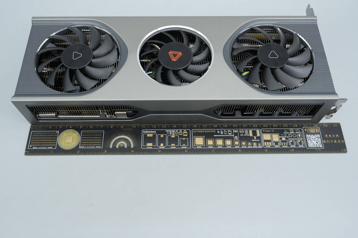

The length of the graphics card is about 285 mm (11.22 inches).

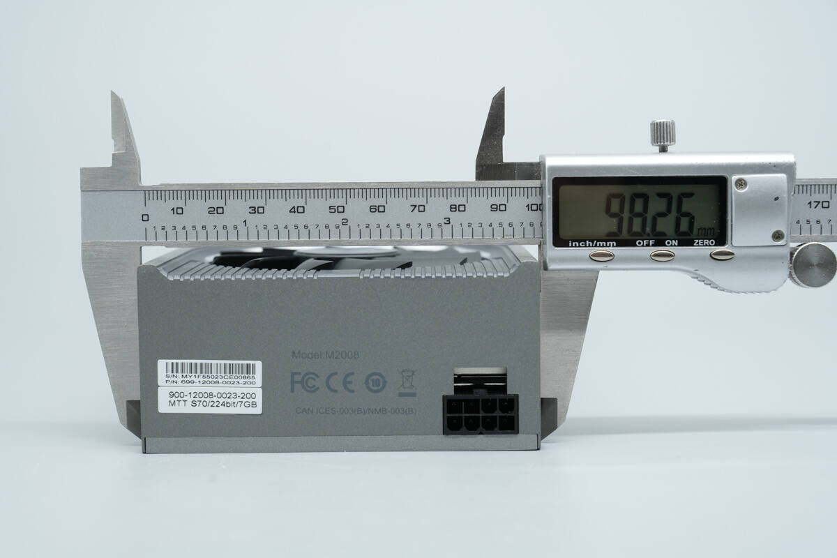

The width is about 98.3 mm (3.87 inches).

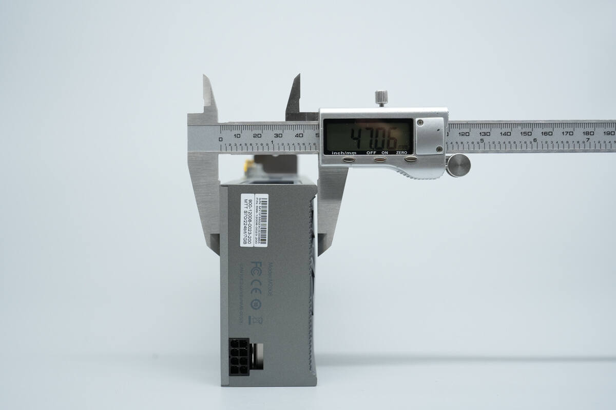

The thickness is about 47.1 mm (1.85 inches).

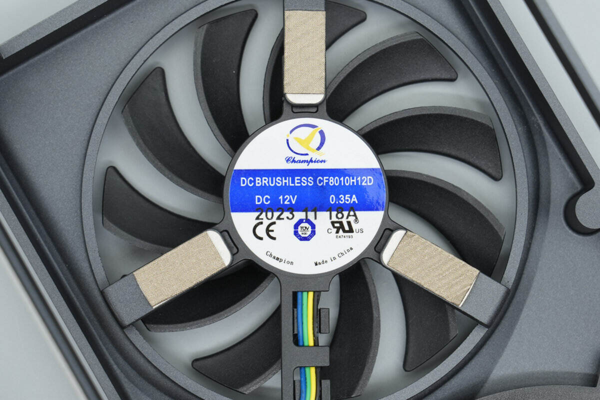

The cooling fans are from Dongguan Champion Electronic Technology Co., Ltd., model CF8010H12D, rated at 12V 0.35A.

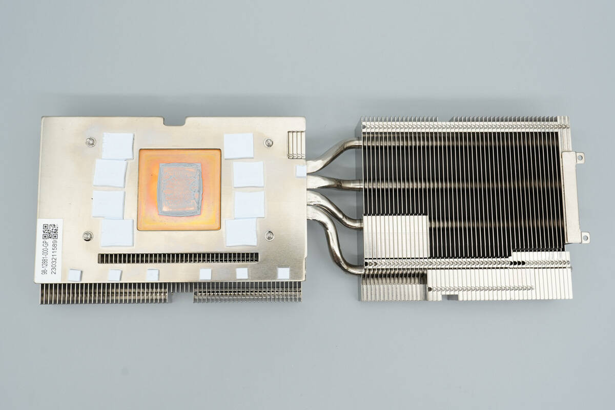

The cooling assembly is secured to the aluminum alloy backplate with screws.
The cooling assembly features a four-heat-pipe design.
Remove the screws and remove the bracket and cooling assembly to continue the teardown.
Overview of the back of the cooling assembly, with heat pipes connecting to the right-side fins for heat dissipation.
The heatsink has a copper base aligned with the GPU core, and thermal pads are placed over the memory chips and DrMOS components.

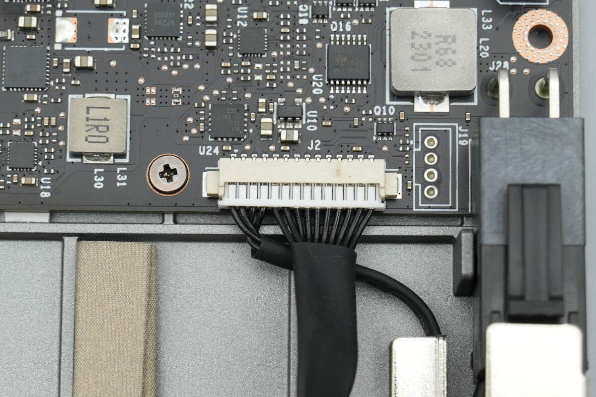

Close-up of the connector for the cooling fans and ambient lighting.

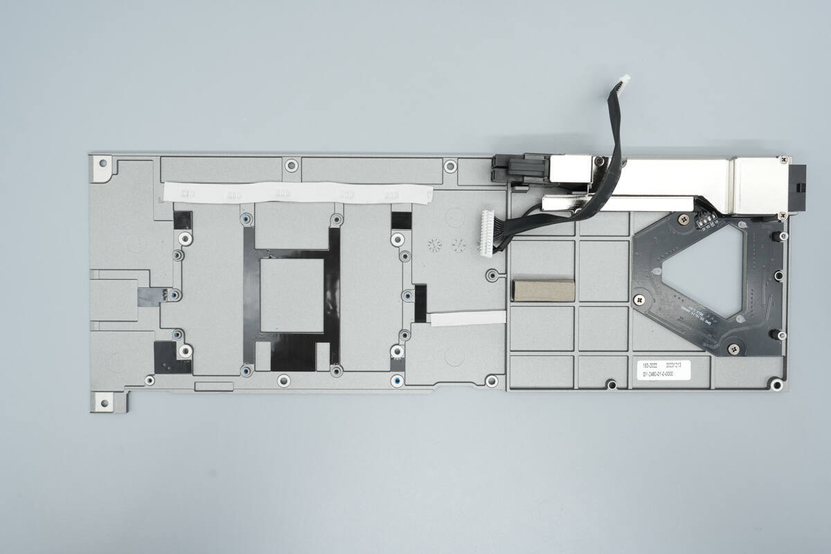

Remove the PCB module. An insulating sheet is attached to the backplate where the PCB module was mounted, thermal pads are placed over the DrMOS components, and a power adapter cable is located at the upper-right corner.

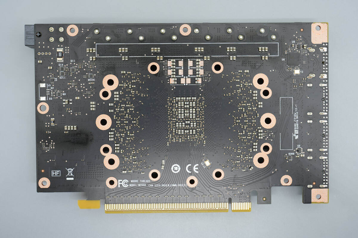

Front view of the PCB module: the GPU core is located in the center, with four memory chips on the left and three memory chips on the right. Above the GPU are filter capacitors, buck inductors, and DrMOS components. On the left side are the HDMI and DisplayPort connectors. The lower-right corner houses additional buck inductors, DrMOS components, and filter capacitors.
On the back side, there is a current-sensing resistor, a filter MLCC capacitor, and a video conversion chip.

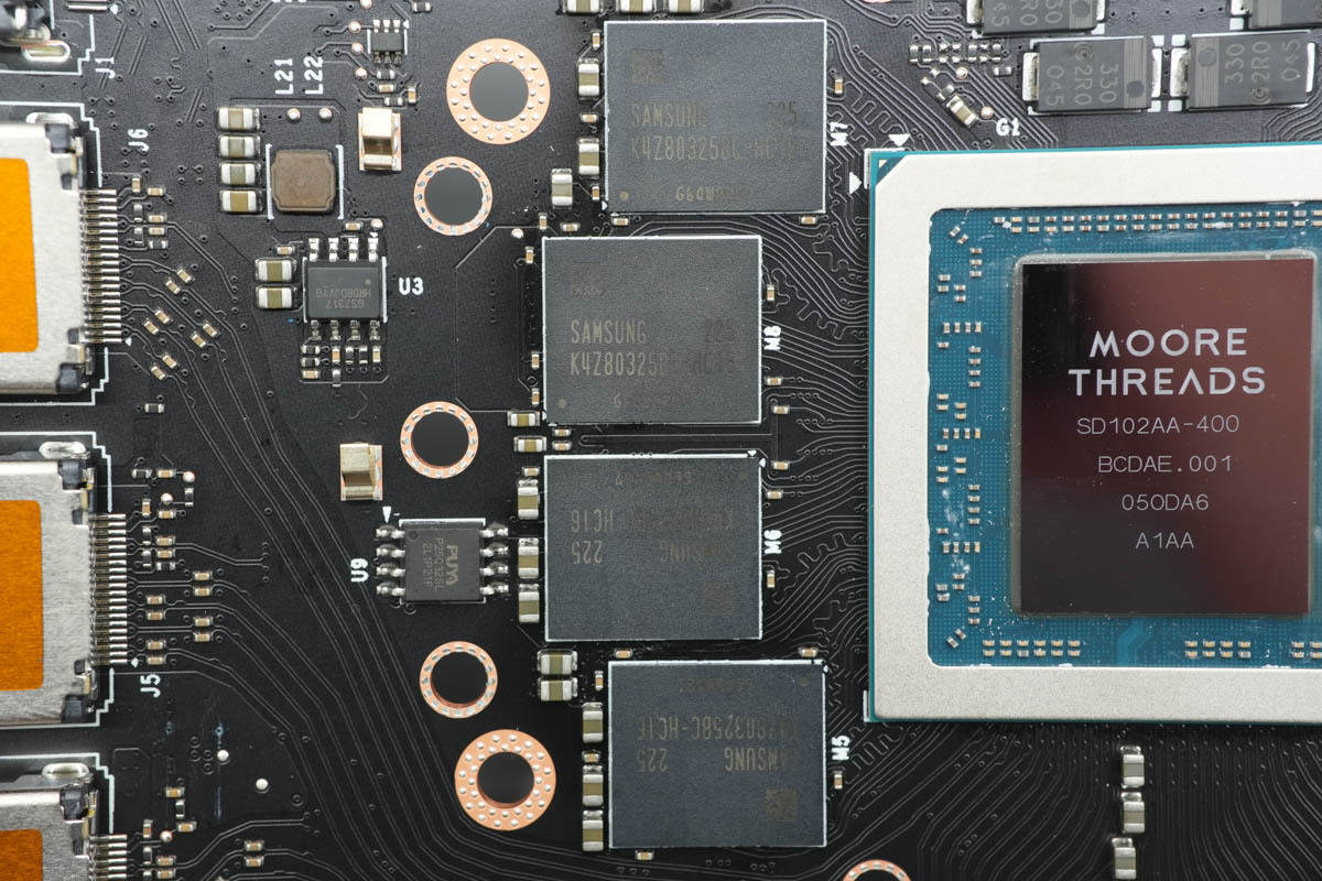

The MTT S70 GPU is marked with SD102AA-400 BCDAE.001 05ODA6 A1AA. It features 3,584 MUSA cores with a clock speed of 1.6 GHz and delivers a peak single-precision floating-point performance of 11.2 TFLOPS. The GPU is paired with 7 GB of GDDR6 high-speed memory, featuring a 224-bit memory bus and a bandwidth of 392 GB/s.

Close-up of the four memory chips on the left side of the GPU.
Close-up of the three memory chips on the right side of the GPU.
The memory chips are from Samsung, model K4Z80325BC-HC16, each with a capacity of 1 GB, a speed of 16 Gbps, and packaged in 180 FBGA.

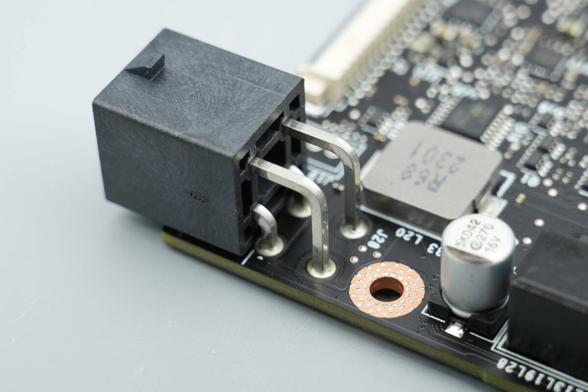

The power connector is a 4-pin design.
The connector is soldered to the PCB module.

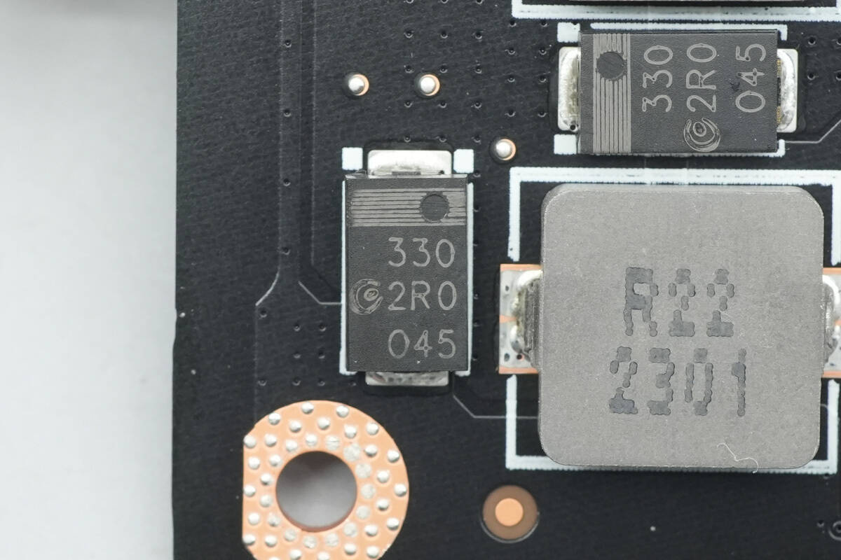

The output filter capacitors are from APAQ, surface-mount conductive polymer solid capacitors, rated at 330 μF 2 V.
Close-up of the two 0.22 μH buck inductors in the lower-right corner.
The filter capacitors are rated at 330 μF 2 V.

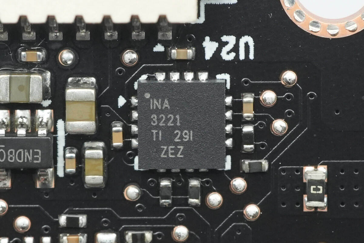

The power monitoring chip is from Texas Instruments, model INA3221. It is a three-channel voltage and current monitor supporting I²C and SMBus interfaces, capable of measuring up to 26 V. It has two current channels, a built-in 13-bit ADC, supports an operating voltage range of 2.7–5.5 V, features programmable alert and warning outputs, and comes in a VQFN16 package.

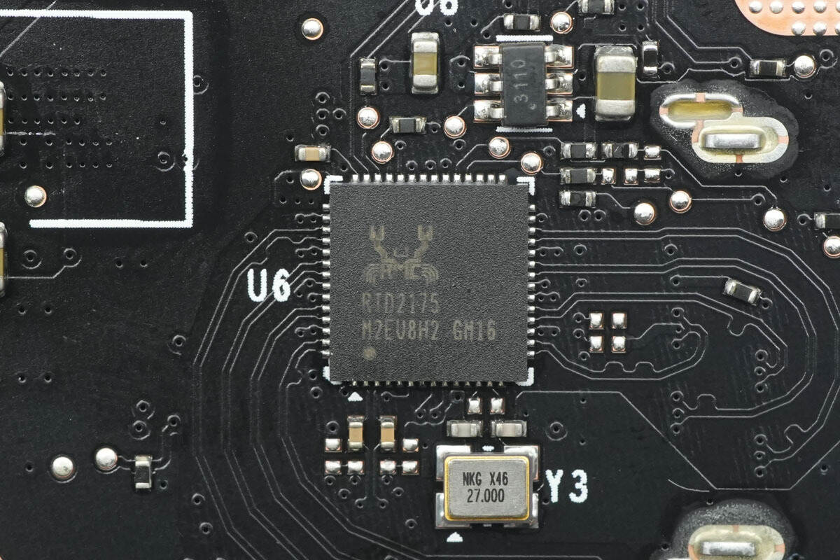

The video conversion chip is from Realtek, model RTD2175, used for converting DisplayPort to HDMI output, and comes in a QFN56 package.
Close-up of the 27.000 MHz clock crystal.

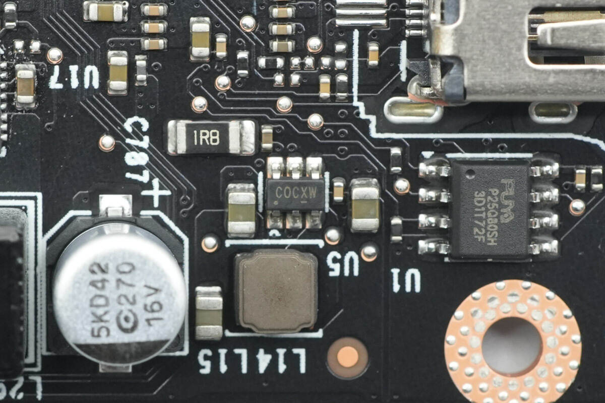

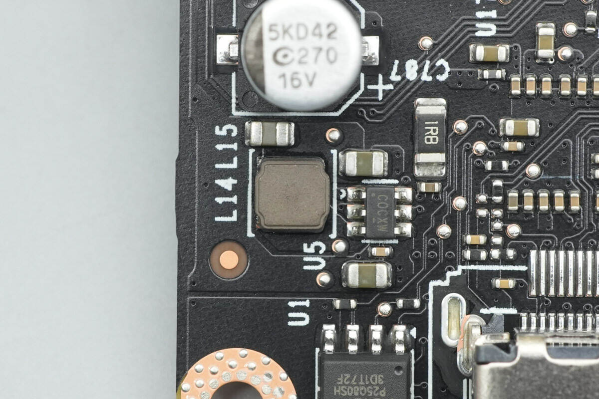

The memory is from Puya, model P25Q80SH, with a capacity of 8 Mb, supporting a 2.3–3.6 V operating voltage, and comes in an SOP8 package.

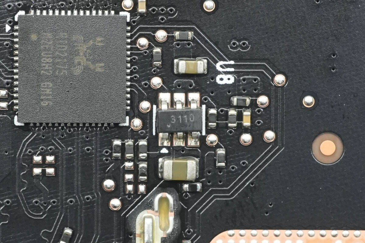

The charge pump is from SGMicro, marked 3110, model SGM3110-5.0. It is a low-power charge-pump boost converter with a 5 V output, supporting a 2.7–5 V input voltage, 100 mA output current, and a switching frequency of 750 kHz. It features short-circuit and over-temperature protection and comes in a SOT-23-6 package.

A 1 μH inductor is used for power filtering.

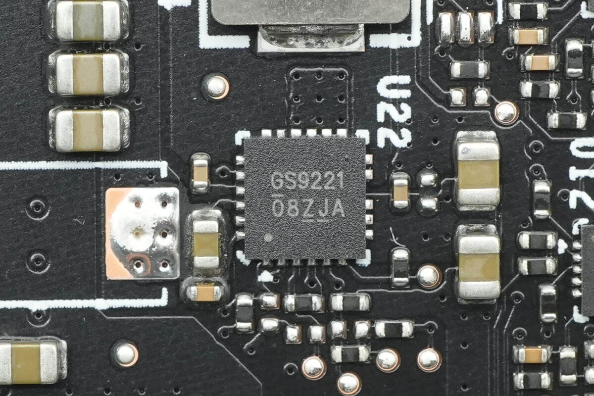

The synchronous buck chip is from GStek, model GS9221. It is a high-performance synchronous buck converter supporting a 2.7–26 V input voltage and 0.6–12 V output voltage, with a 6 A output current. The chip integrates internal MOSFETs, supports a 100–600 kHz switching frequency, and features over/under-voltage protection, over-temperature protection, and over-current protection. It comes in a TQFN23 package.
Close-up of the 1 μH buck inductor used with the chip.
