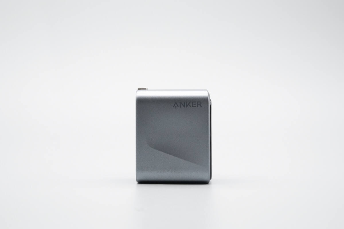

The front is printed with the ANKER and PRIME branding.
Teardown of Anker Prime 160W Charger with Smart Display (A2687)-Chargerlab

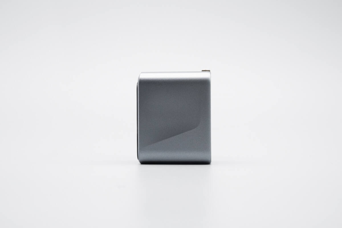

Both sides feature contoured side grooves, serving as decorative elements and enhancing the plug-in and unplugging experience.

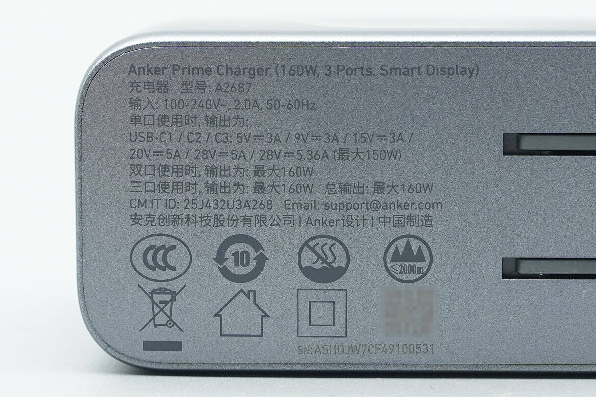

The input-side casing is printed with the technical specifications.
Model: A2687
Input: 100-240V~50/60Hz 2A
Output:
USB-C1/C2/C3: 5V 3A, 9V 3A, 15V 3A, 20V 5A, 28V 5A, 28V 5.36A (150W Max)
Dual-port output: 160W Max
Three-port output: 160W Max
Total output: 160W Max
The charger has passed PSE certification and Level VI energy efficiency certification.

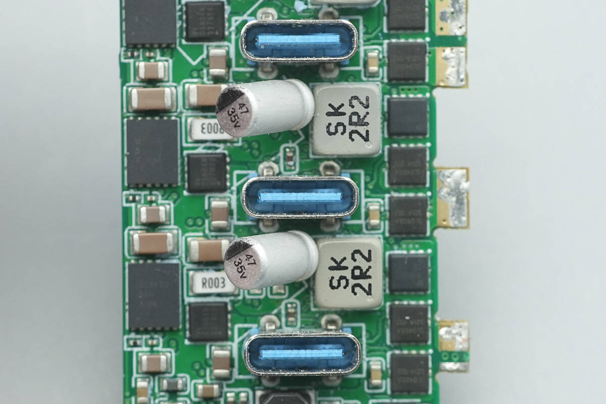

It is equipped with three USB-C ports, each labeled with its corresponding designation.

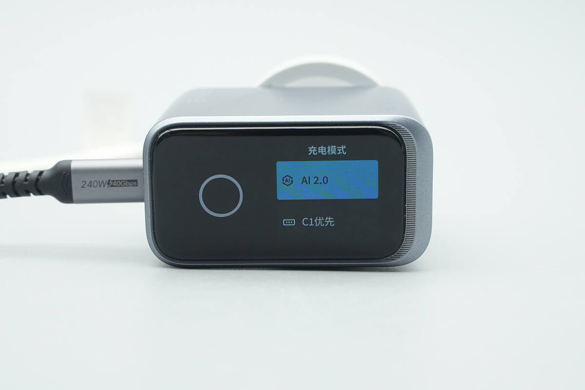

Overview of the charging mode selection interface, supporting seamless switching between AI Mode 2.0 and Standard Mode (with priority given to the C1 port).

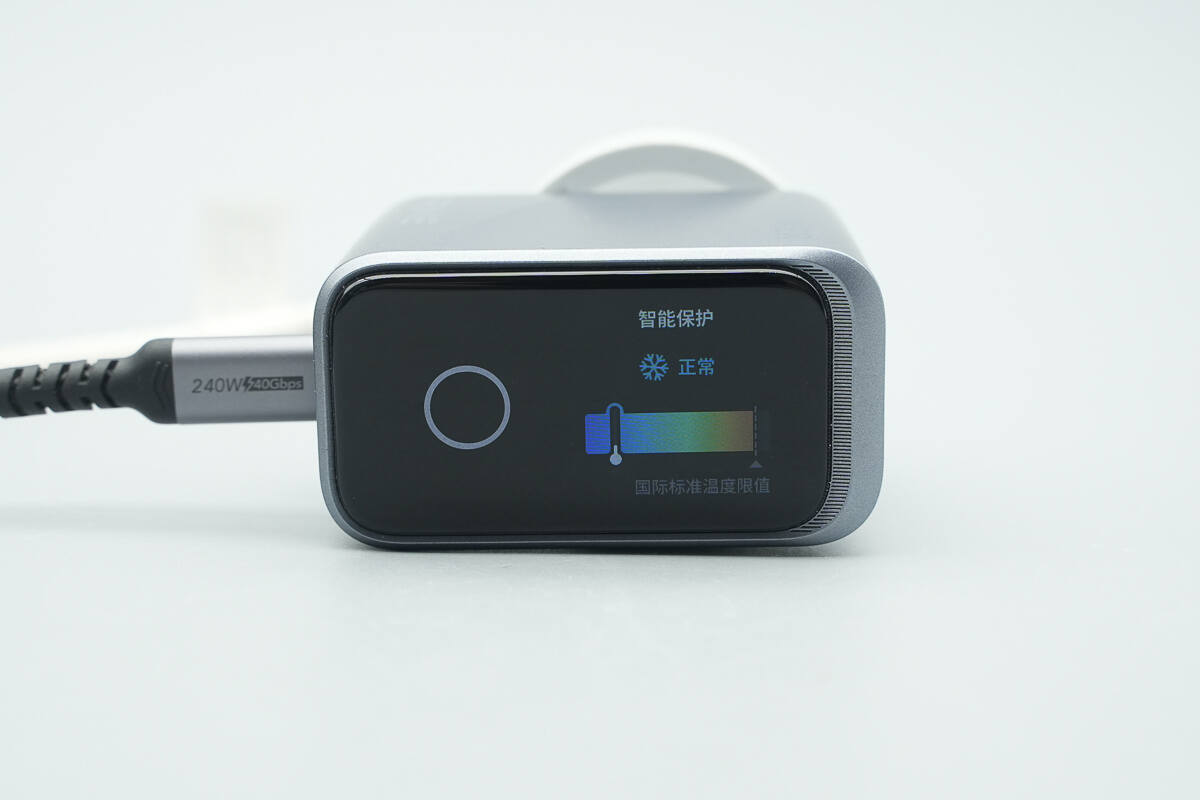

Overview of the temperature protection interface, which allows real-time temperature monitoring.

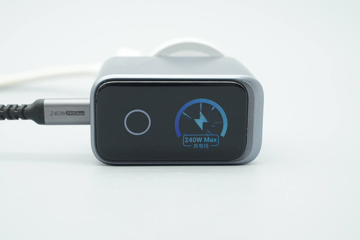

It can also read the specifications of the connected data cable.

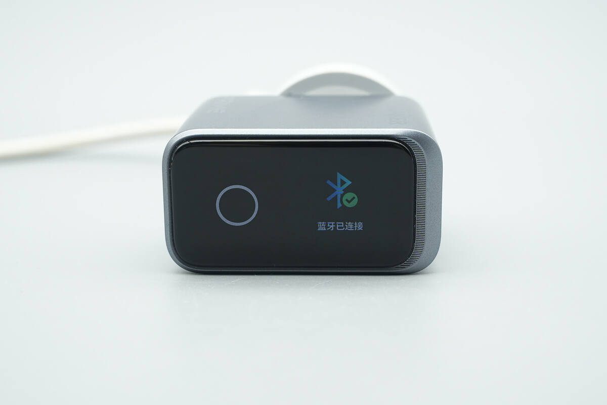

Overview of the Bluetooth interface. By connecting via Bluetooth to the app, users can view more detailed charging information and customize charging modes directly from their smartphone.

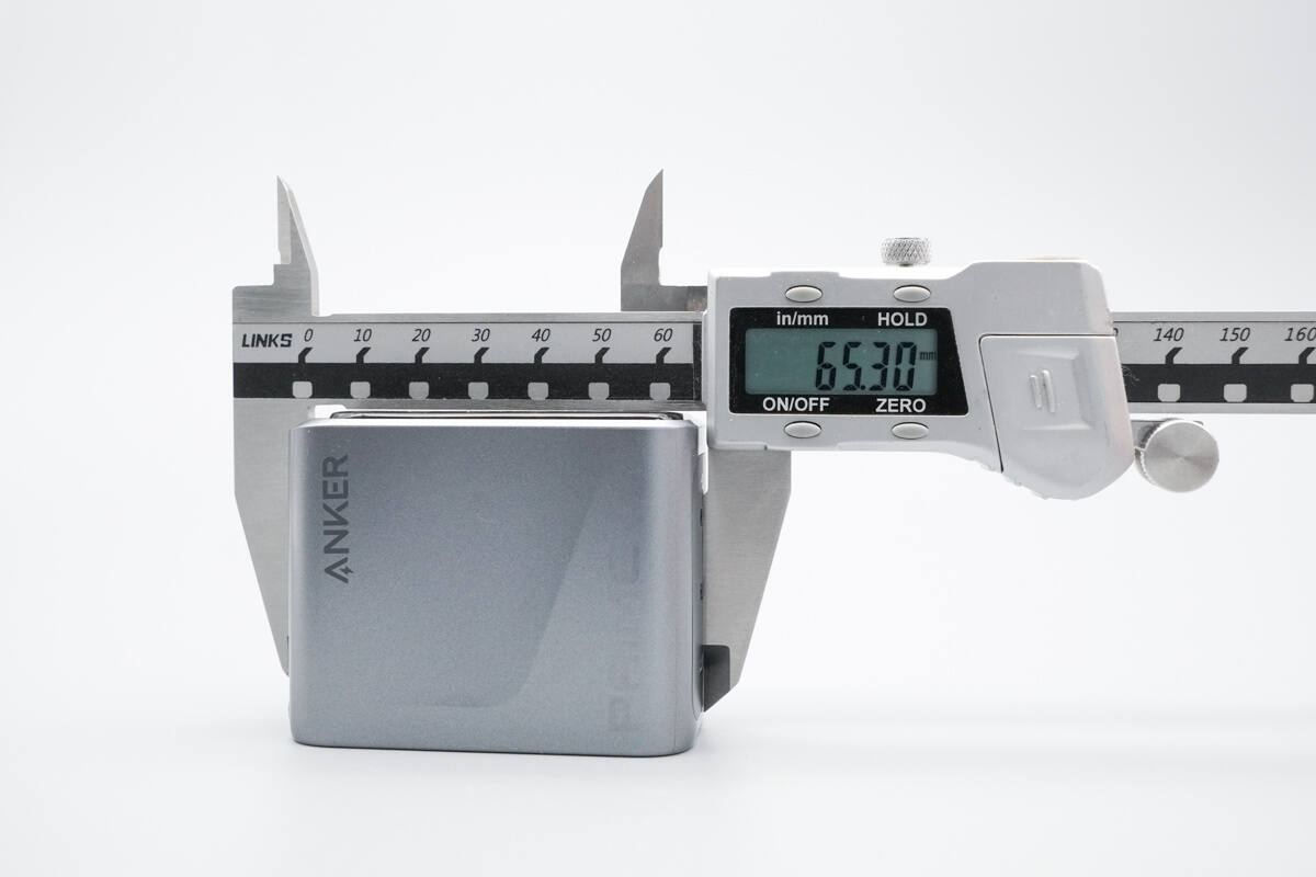

The length of the charger is about 65.3 mm (2.57 inches).

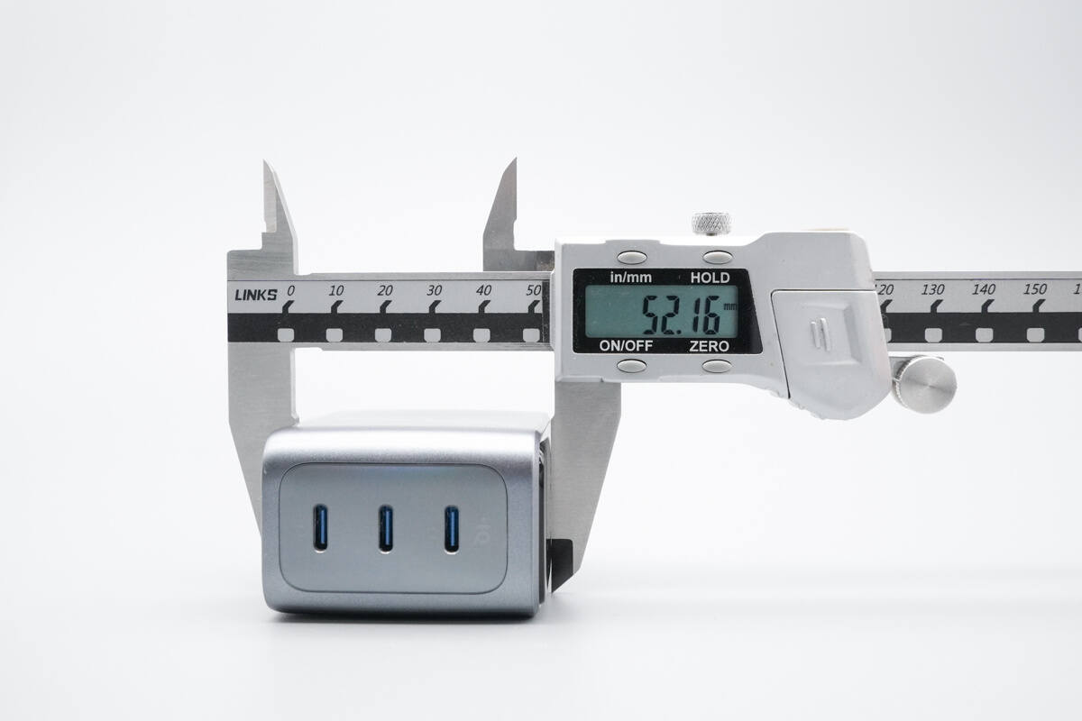

The width is about 52.16 mm (2.054 inches).

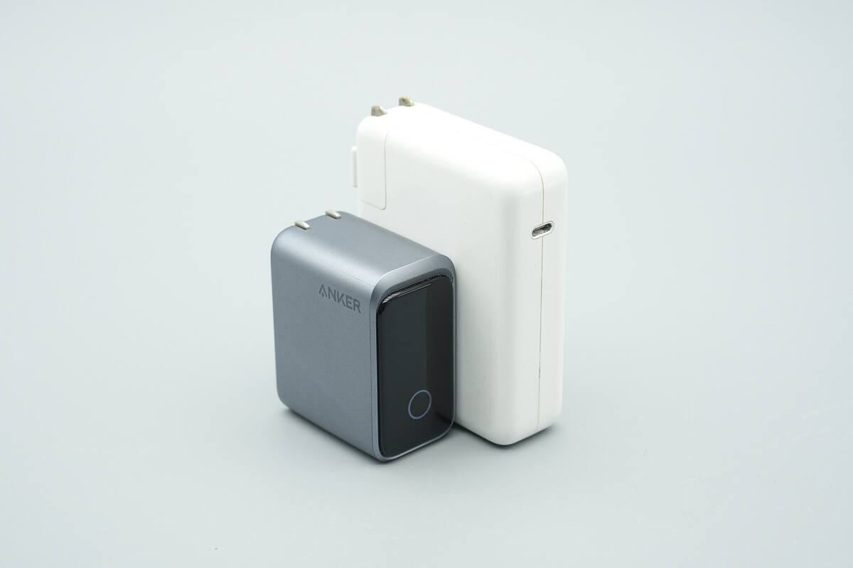

Compared with the Apple 140W charger, its size advantage is obvious.

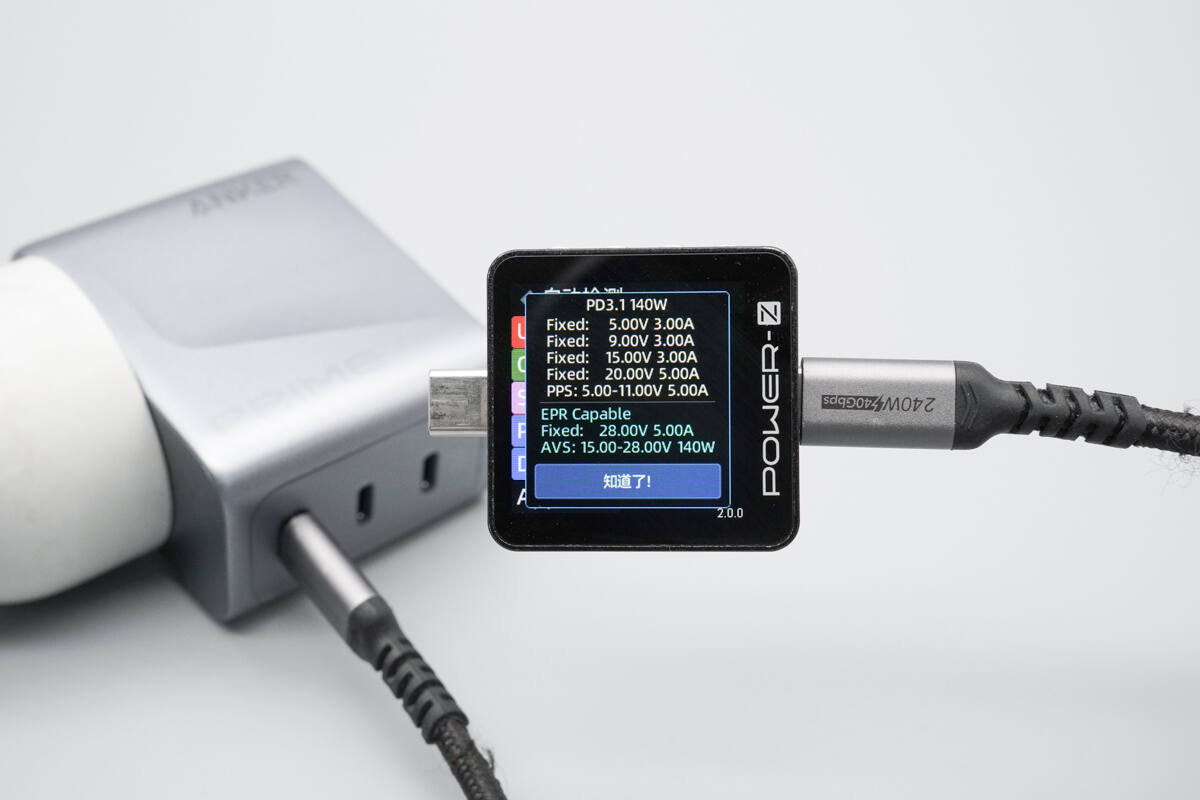

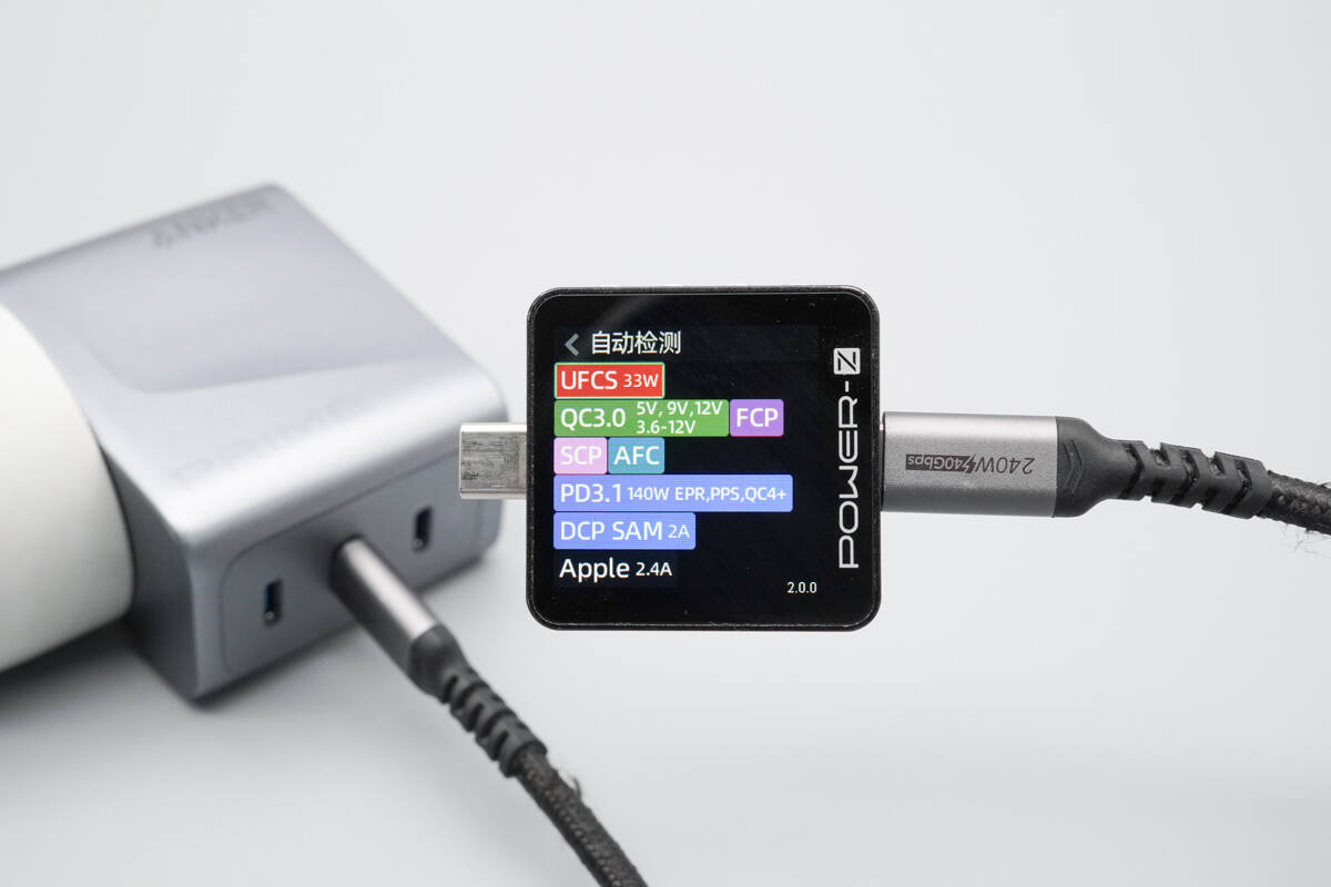

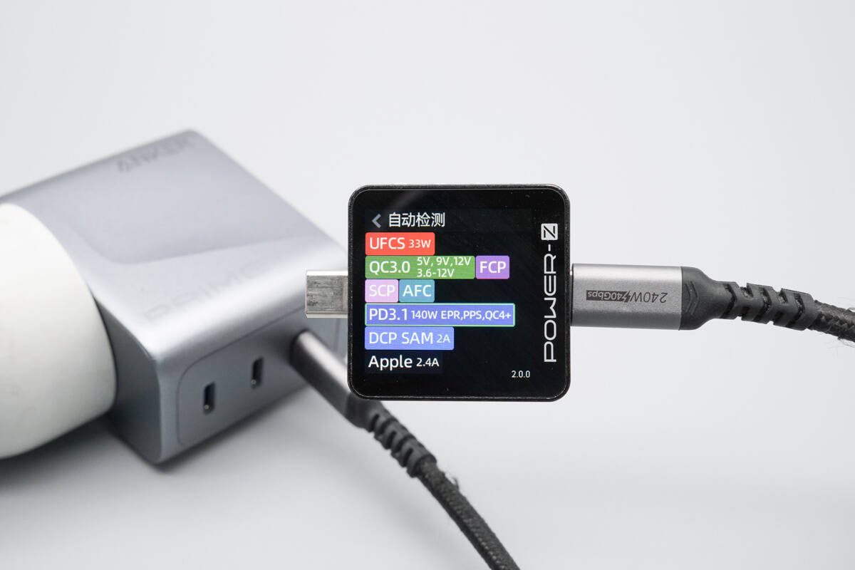

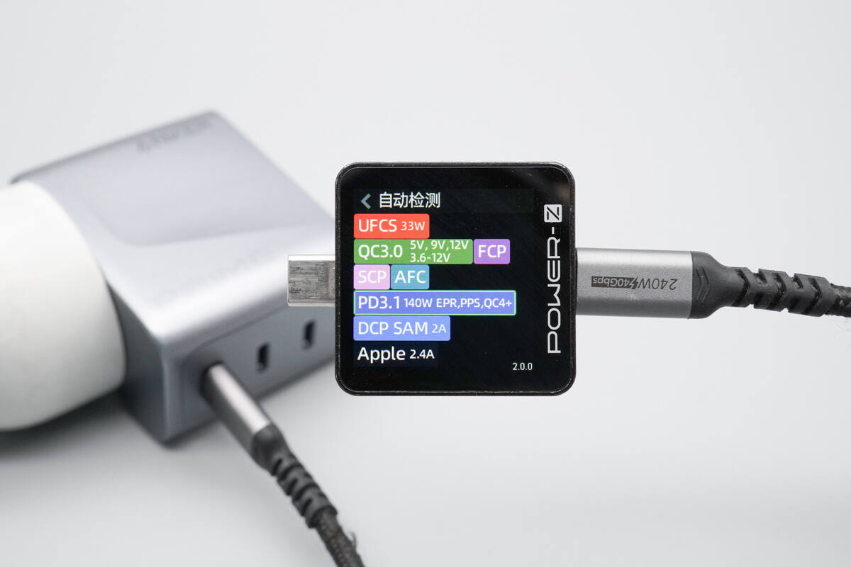

ChargerLAB POWER-Z KM003C shows that the USB-C1 supports QC3+/4+, FCP, SCP, AFC, PD3.1, PPS, DCP, SAM 2A, and Apple 2.4A charging protocols.

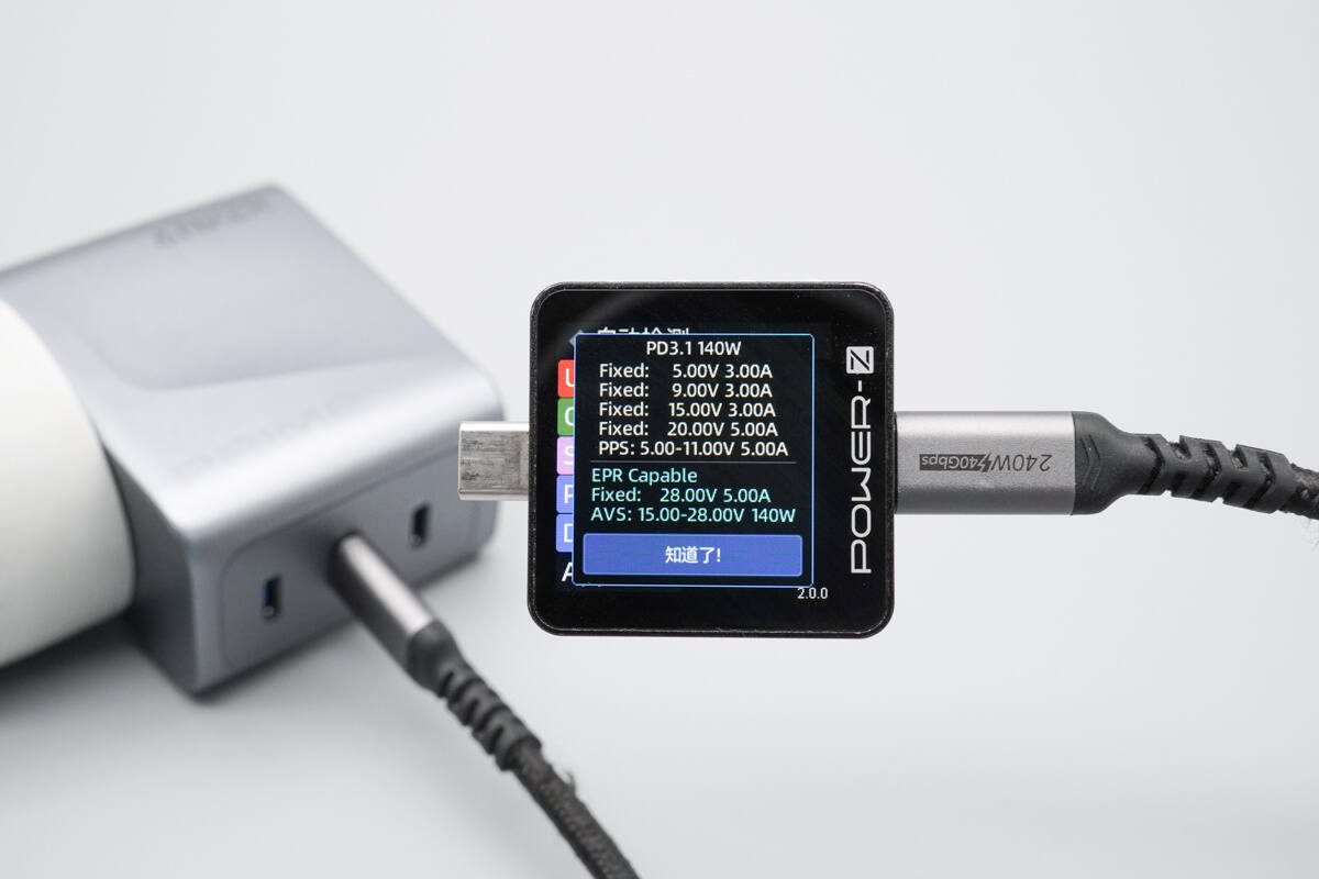

It has five fixed PDOs of 5V 3A, 9V 3A, 15V 3A, 20V 5A, and 28V 5A, as well as a PPS voltage range of 5–11V 5A and an AVS voltage range of 15–28V 140W.

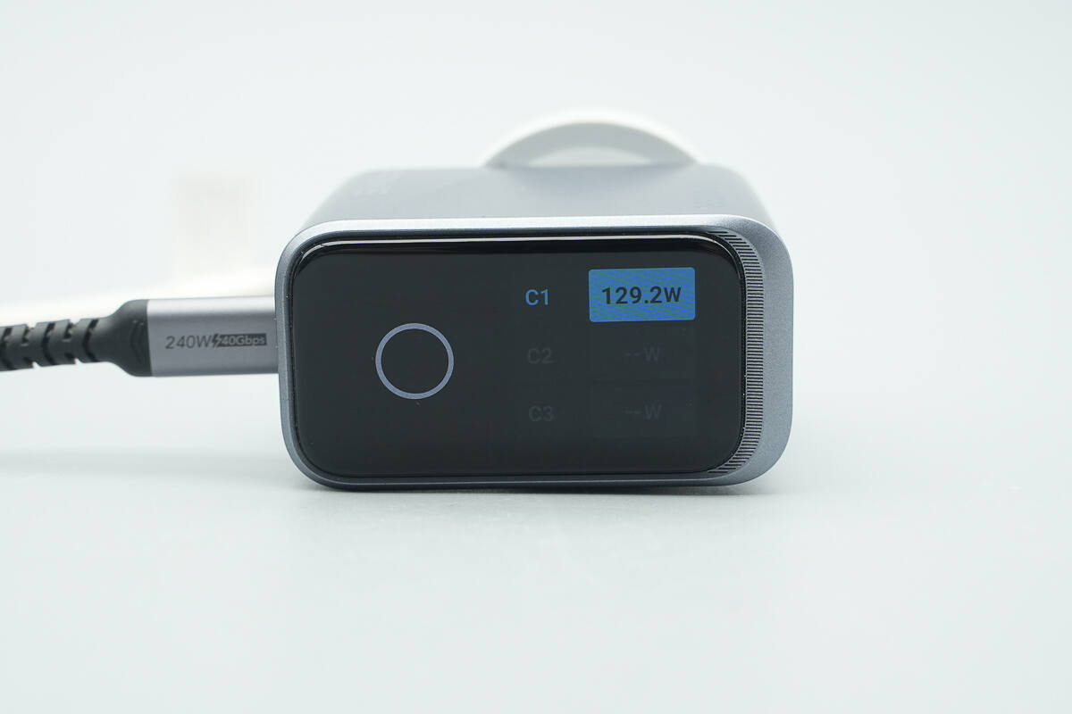

When used to charge a MacBook Pro, it delivers a charging power of about 134.02W.

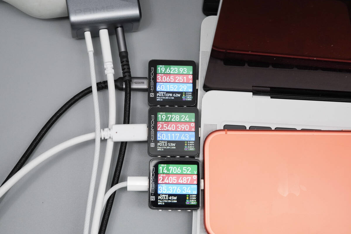

When charging two laptops and a smartphone simultaneously, the output power is about 60.15W, 50.12W, and 35.37W, with a total of around 145.64W.

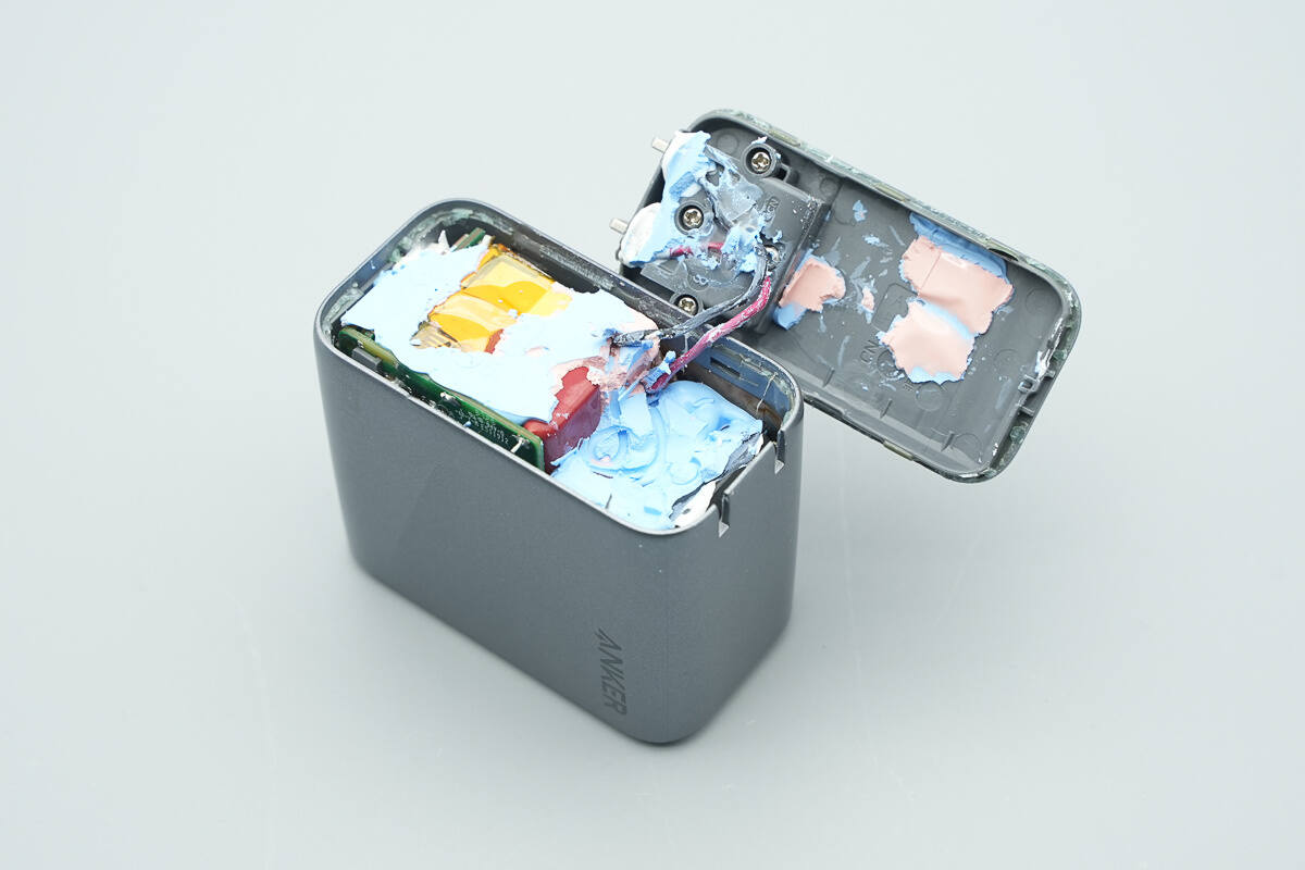

Open the input-side casing. The prongs are secured with a plastic plate and screws, and the internal module is filled with blue and pink thermal gel.

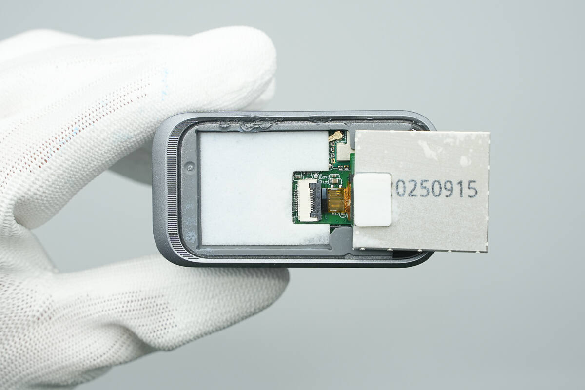

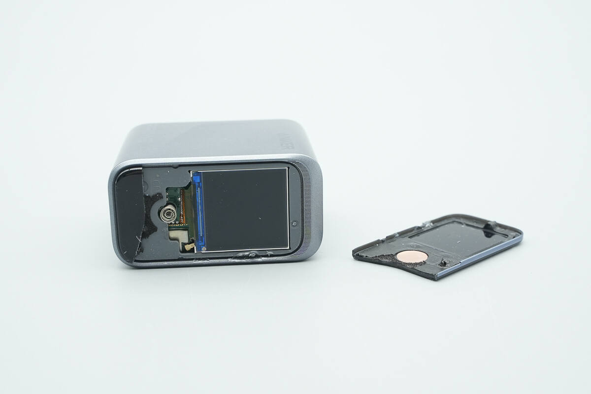

Removing the top cover reveals that it is secured with double-sided adhesive.
The cover has a window for the display, and copper foil is applied at the positions corresponding to the touch-sensitive button.

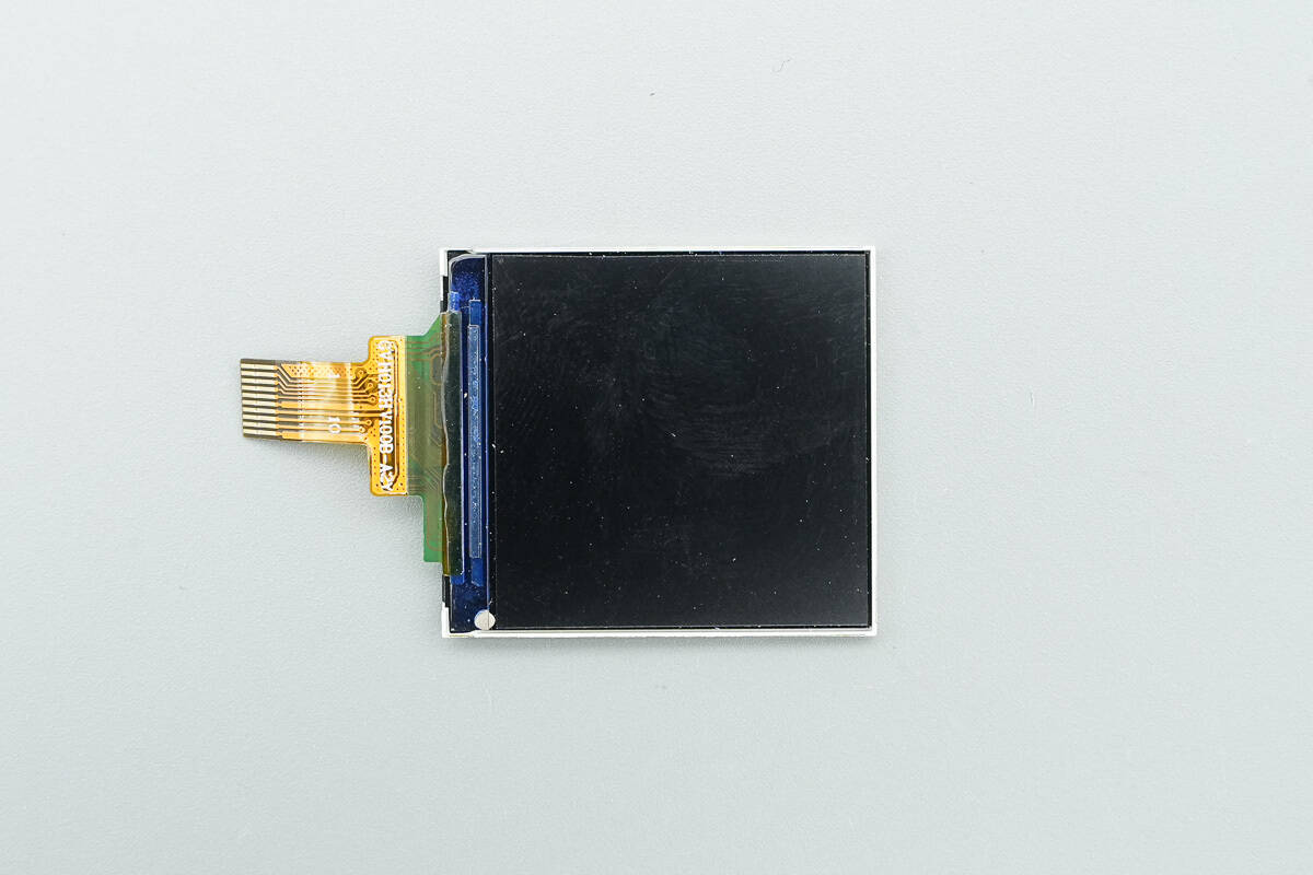

The display is connected to the PCBA module via a ribbon cable, and the bottom is protected with a layer of foam.

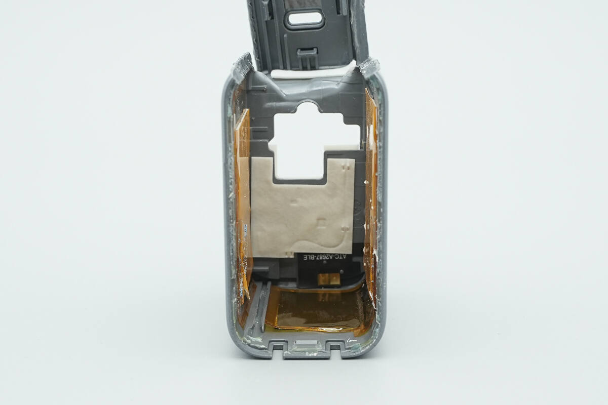

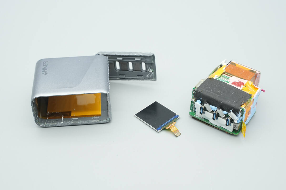

Cut open the casing to remove the PCBA module and the display.
The inner side of the casing is lined with foam and graphite thermal pads and insulated with high-temperature-resistant tape.

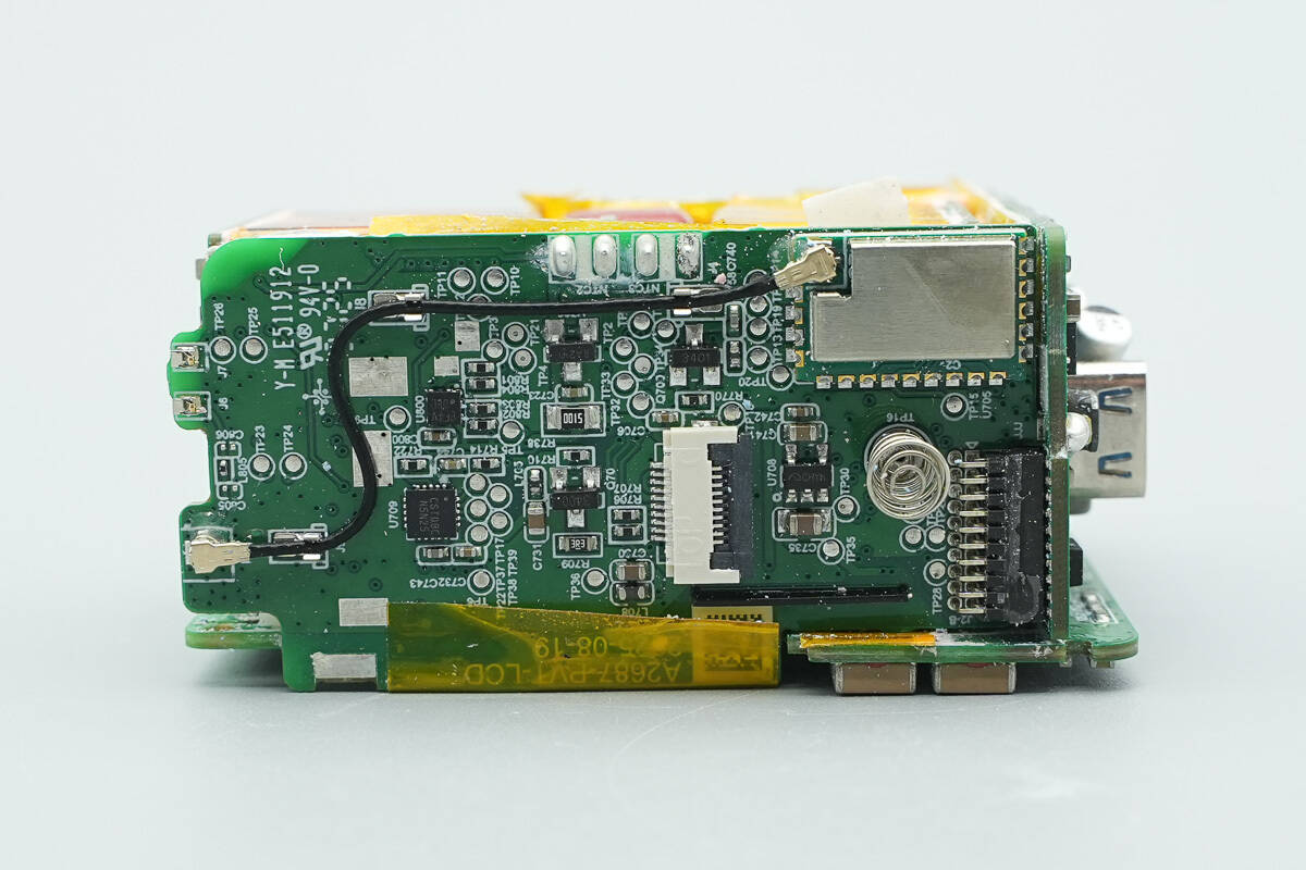

Close-up of the SMD Bluetooth antenna.

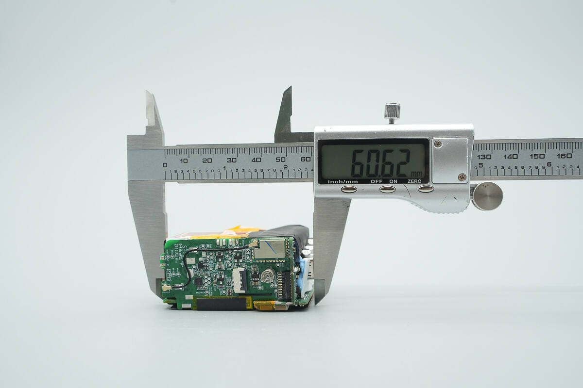

The length of the PCBA module is about 60.62 mm (2.39 inches).

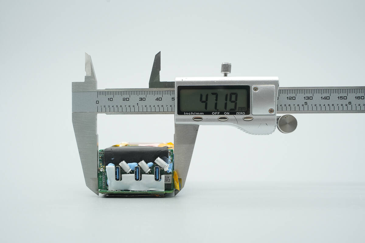

The width is about 47.19 mm (1.86 inches).

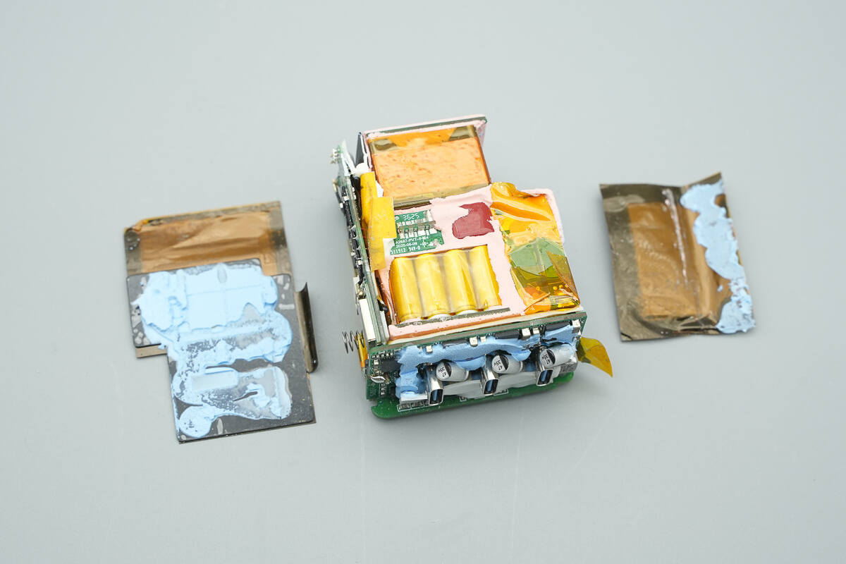

The gaps between components are filled with thermal adhesive, and one side of the module is covered with an insulated thermal pad.
The bottom of the module is also covered with an insulated thermal pad.

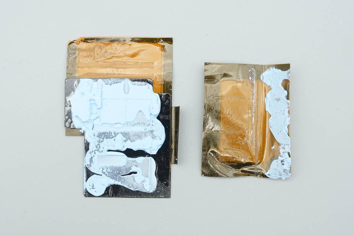

Remove the thermal pad; a Mylar sheet is found between it and the motherboard for insulation.
The thermal pads are composed of copper foil and graphite, with both sides insulated.

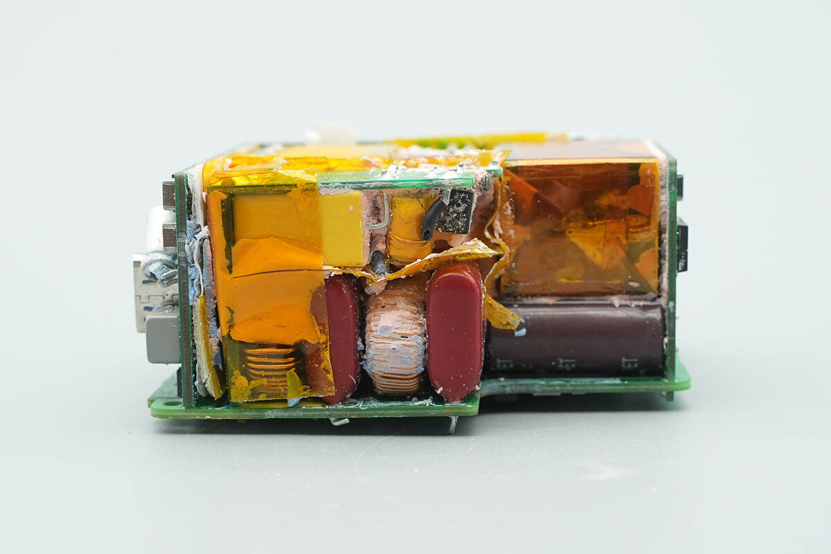

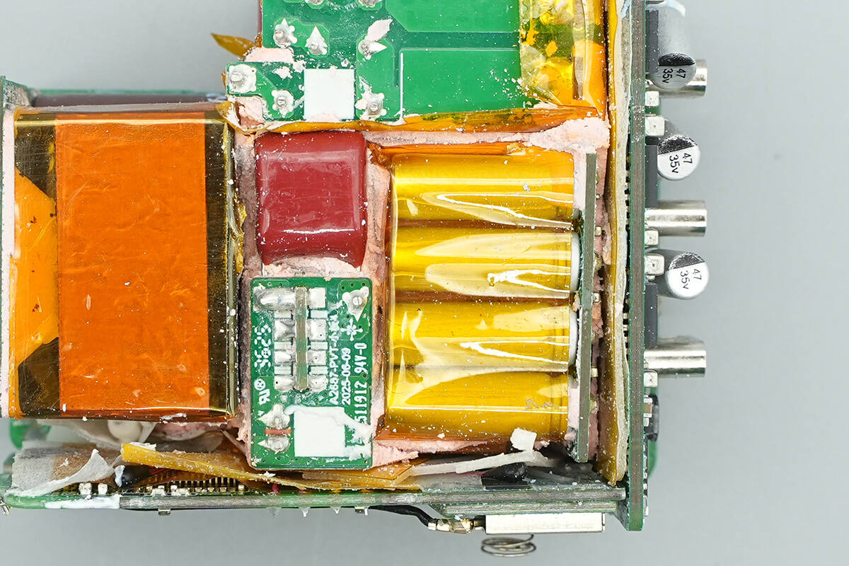

On the front of the PCBA module, the input small PCB, the PFC boost inductor, and solid capacitors for output filtering are all wrapped with insulating tape.
The back side is filled with thermal adhesive, while the side openings are fitted with plastic isolation plates and Mylar sheets for insulation protection.

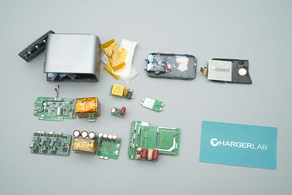

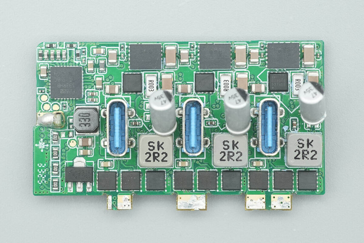

Remove the thermal adhesive. The PCBA module consists of as many as nine PCBs, arranged compactly yet with thorough insulation measures in place.

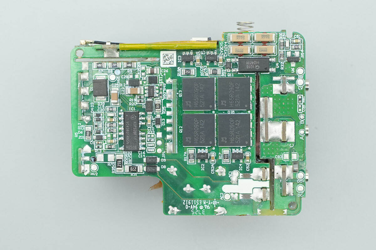

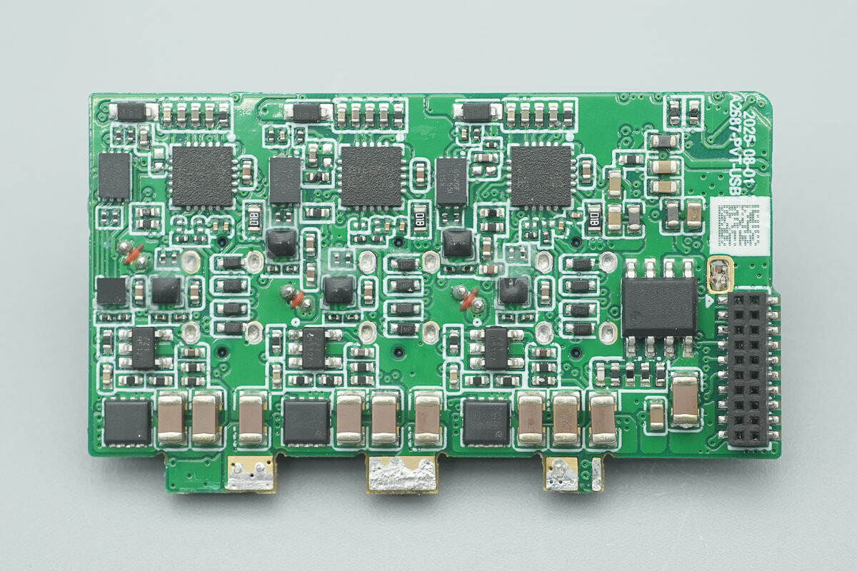

The back side houses active bridge drivers, rectifiers, and the master control chip, among other components.

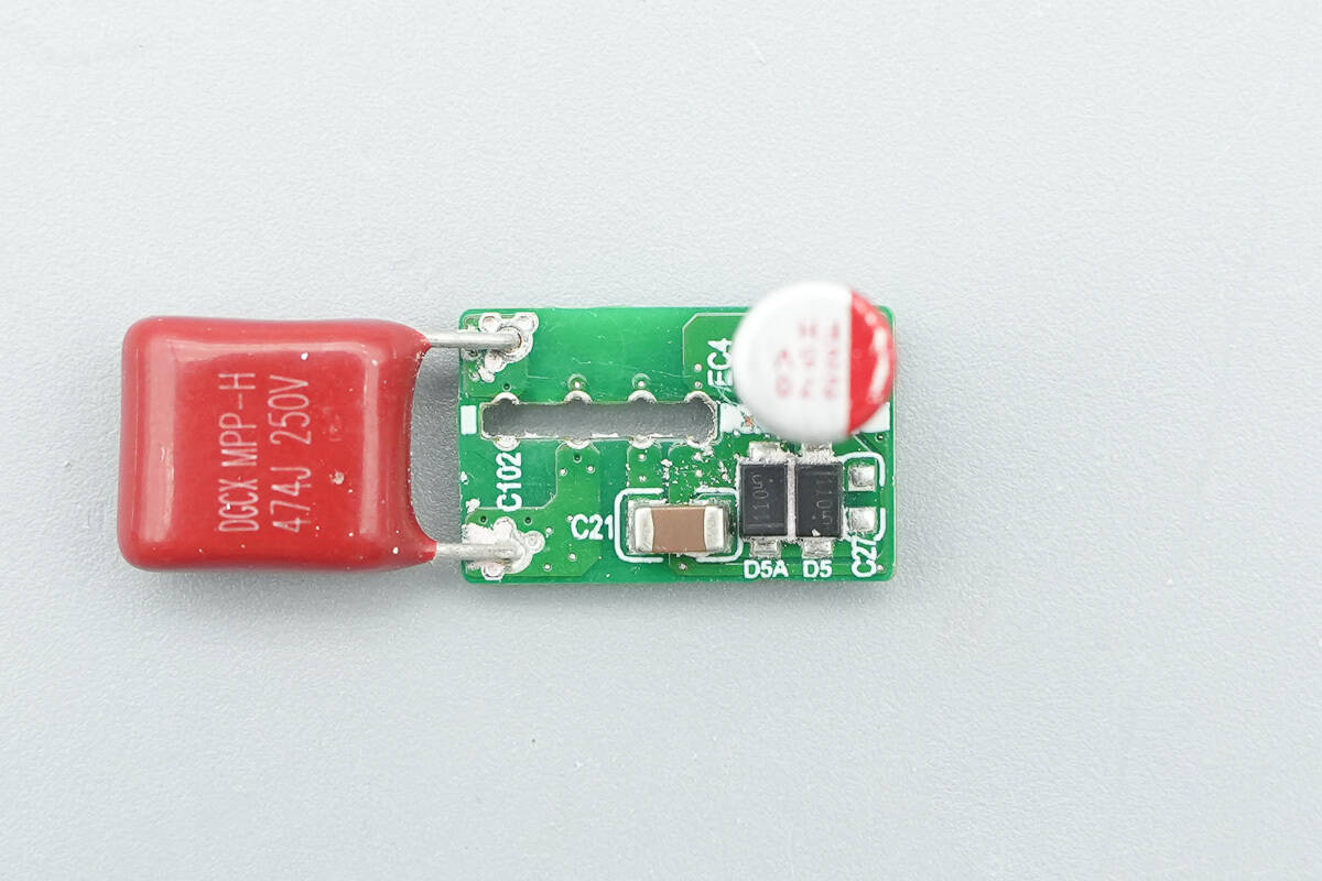

At the input end, there is a small PCB. On the main PCB, there are film capacitors, filter inductors, and a small PCB used for structural support.

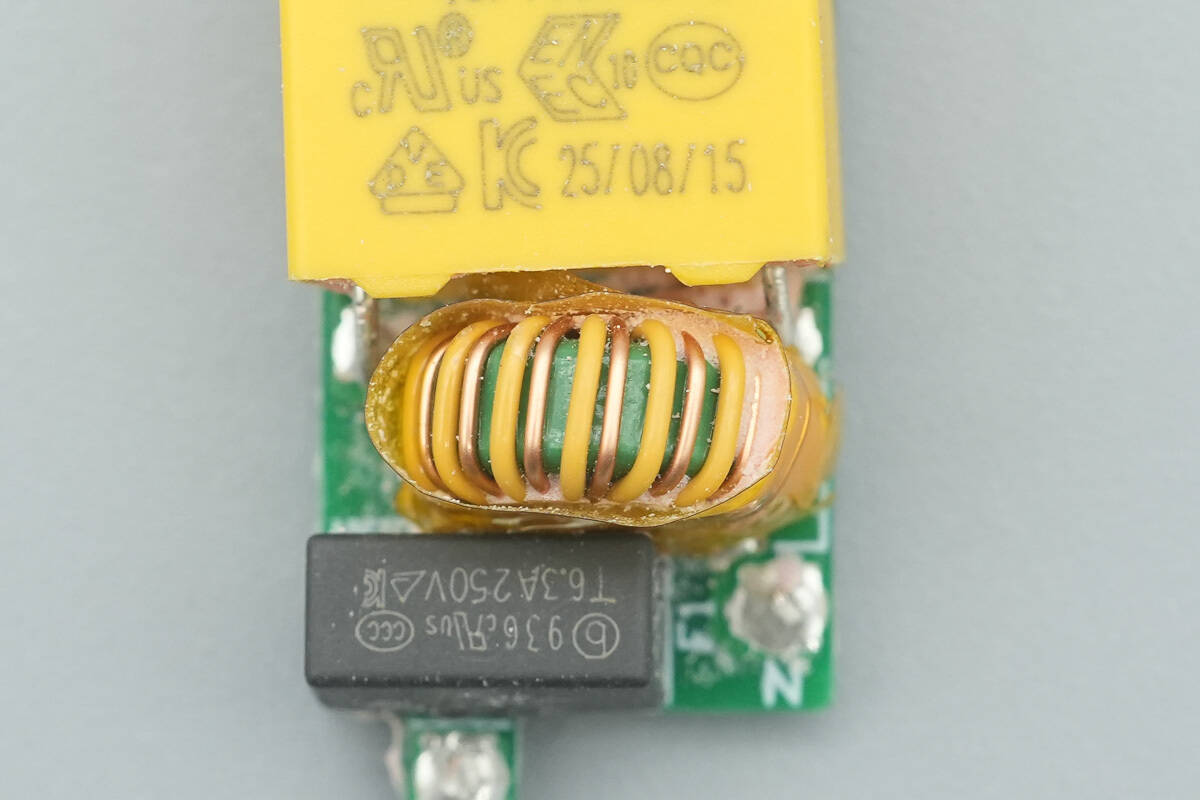

After removing the two small PCBs, the input PCB reveals a time-delay fuse, a common-mode choke, and a safety X2 capacitor.

The common-mode choke, used to filter EMI interference, is wrapped in insulating tape.

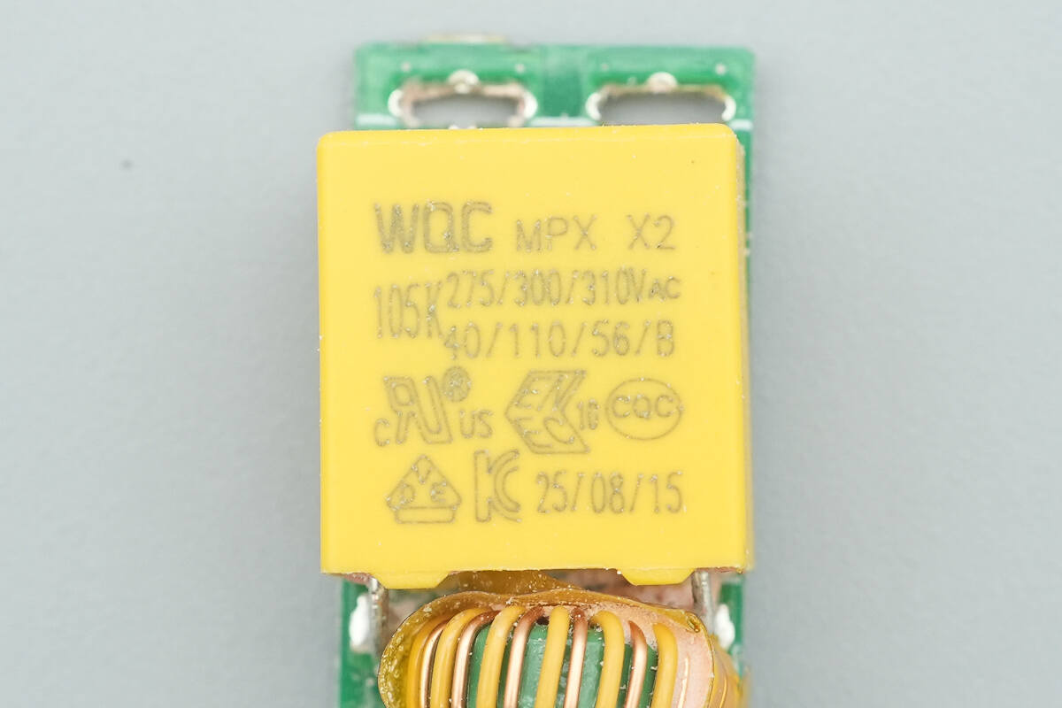

The safety X2 capacitor is from WQC, with a capacitance of 1 µF.

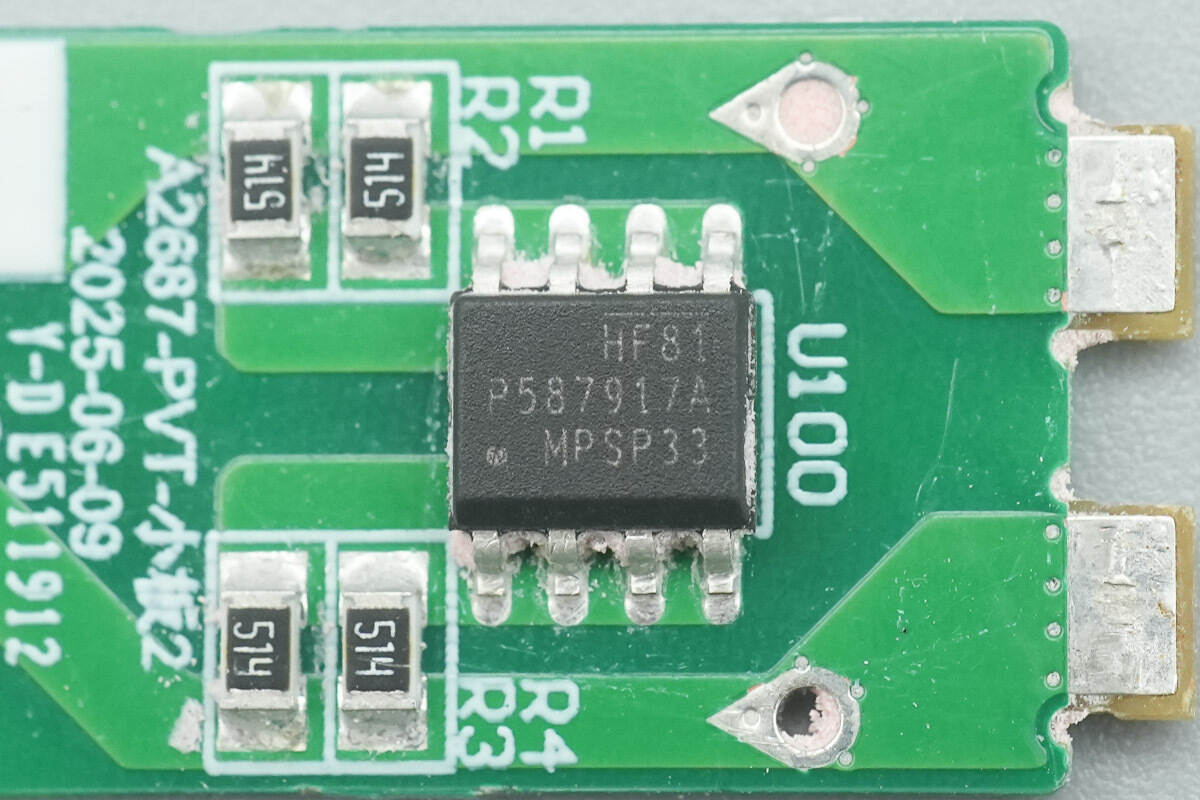

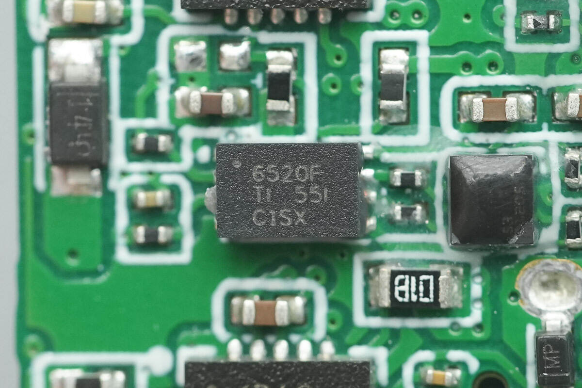

The X-capacitor discharge chip is from MPS, model HF81. This is an innovative two-terminal IC that can automatically discharge X capacitors while avoiding power loss and ensuring the power supply meets safety standards. It comes in an SOIC-8 package.

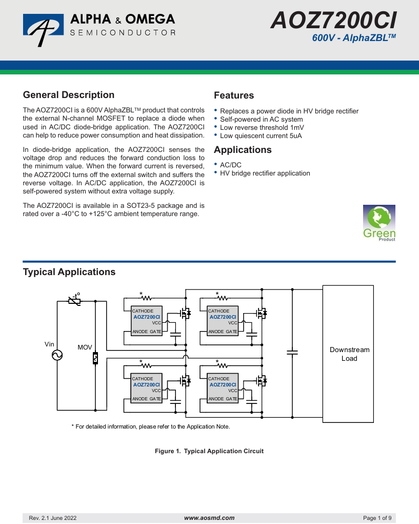

The active bridge drivers are from AOS, model AOZ7200CI. This is a 600V AlphaZBL™ series device designed to control external N-channel MOSFETs in AC/DC rectifier bridge applications, replacing traditional diodes to effectively reduce system power loss and thermal load.
In rectifier bridge applications, the AOZ7200CI minimizes the forward conduction loss of the external MOSFET by detecting the voltage difference across its terminals. During reverse current, it quickly turns off the MOSFET to withstand reverse voltage, thereby emulating the unidirectional conduction characteristic of an “ideal diode.”
In AC/DC applications, the chip uses a self-powered design, requiring no additional auxiliary power supply. The AOZ7200CI comes in a SOT23-5 package, with a rated operating temperature range of –40°C to +125°C.

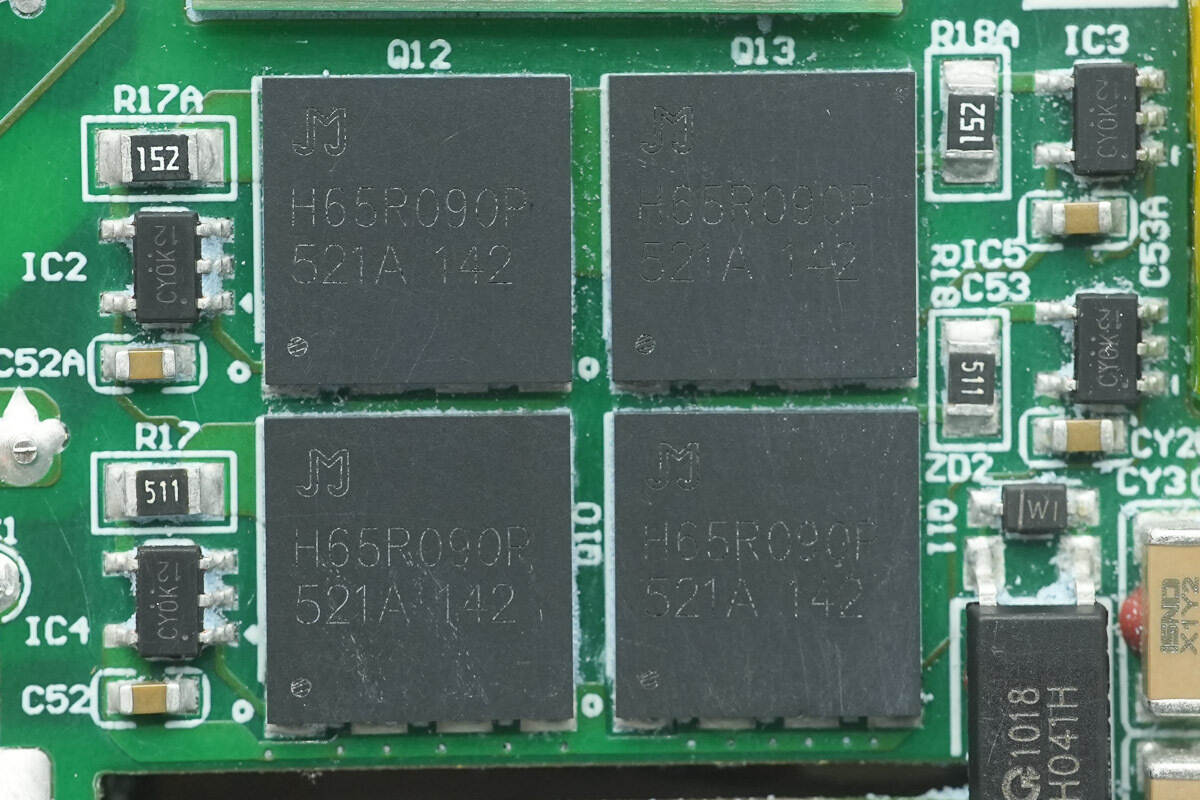

The four accompanying N‑MOSFETs are from JJWD, model JMH65R090PPLNFD, in a DFN8080‑4L package.

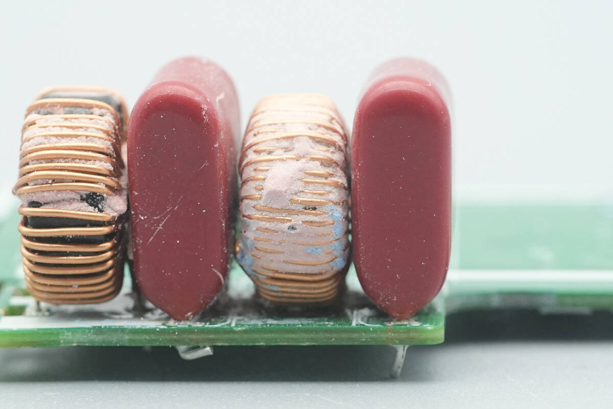

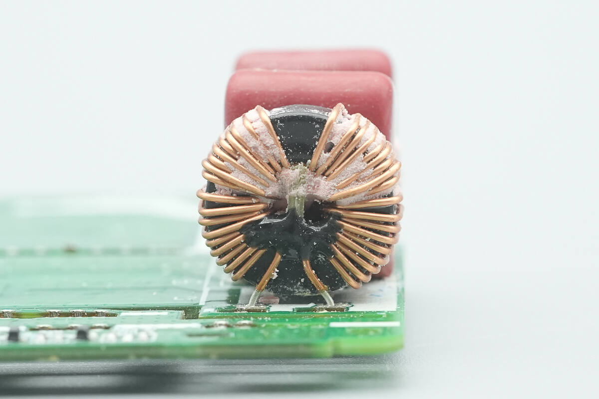

Close-up of the other filter inductor.

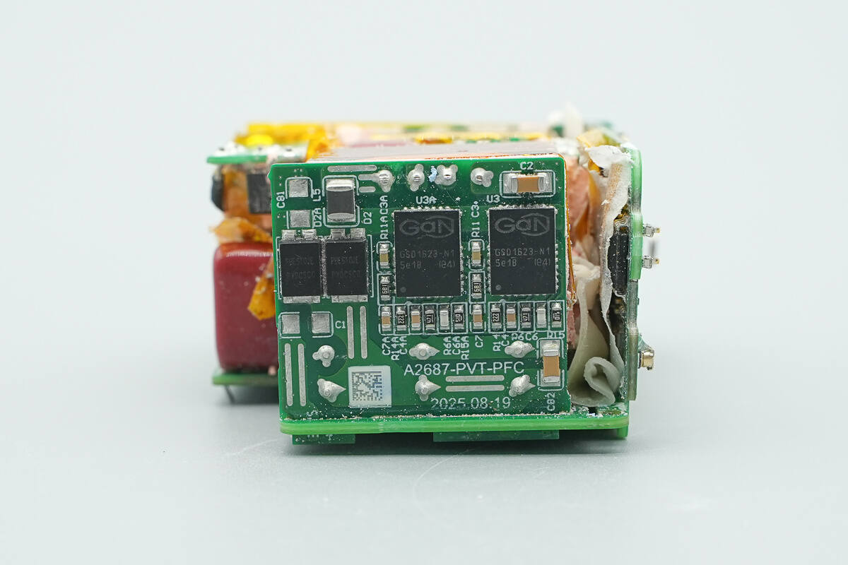

On this side is the PFC boost small PCB. The back of the PFC boost PCB houses the PFC MOSFETs and PFC boost rectifiers.

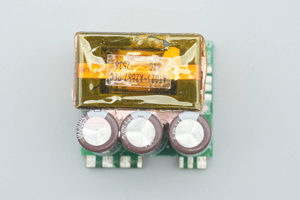

After removing the PCB, the other side features the PFC boost inductor and three high-voltage filter electrolytic capacitors.

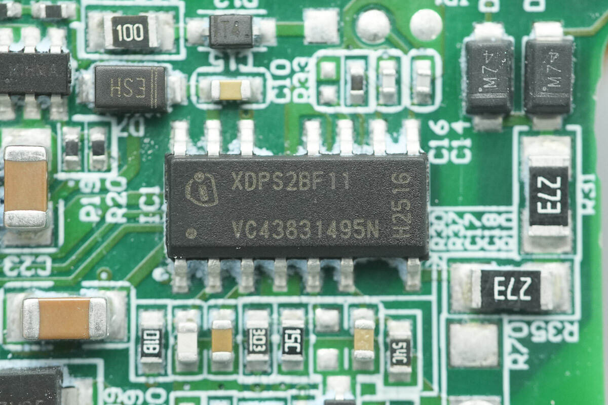

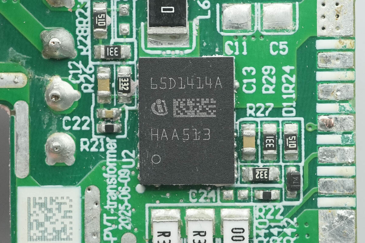

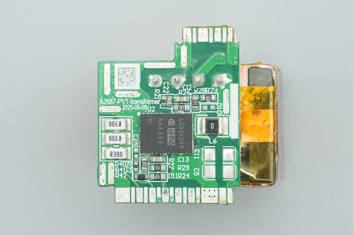

The master control chip is from Infineon, marked XDPS2BF11. It is a custom model that integrates both the PFC controller and the HFB controller, and comes in a DSO-14 package.

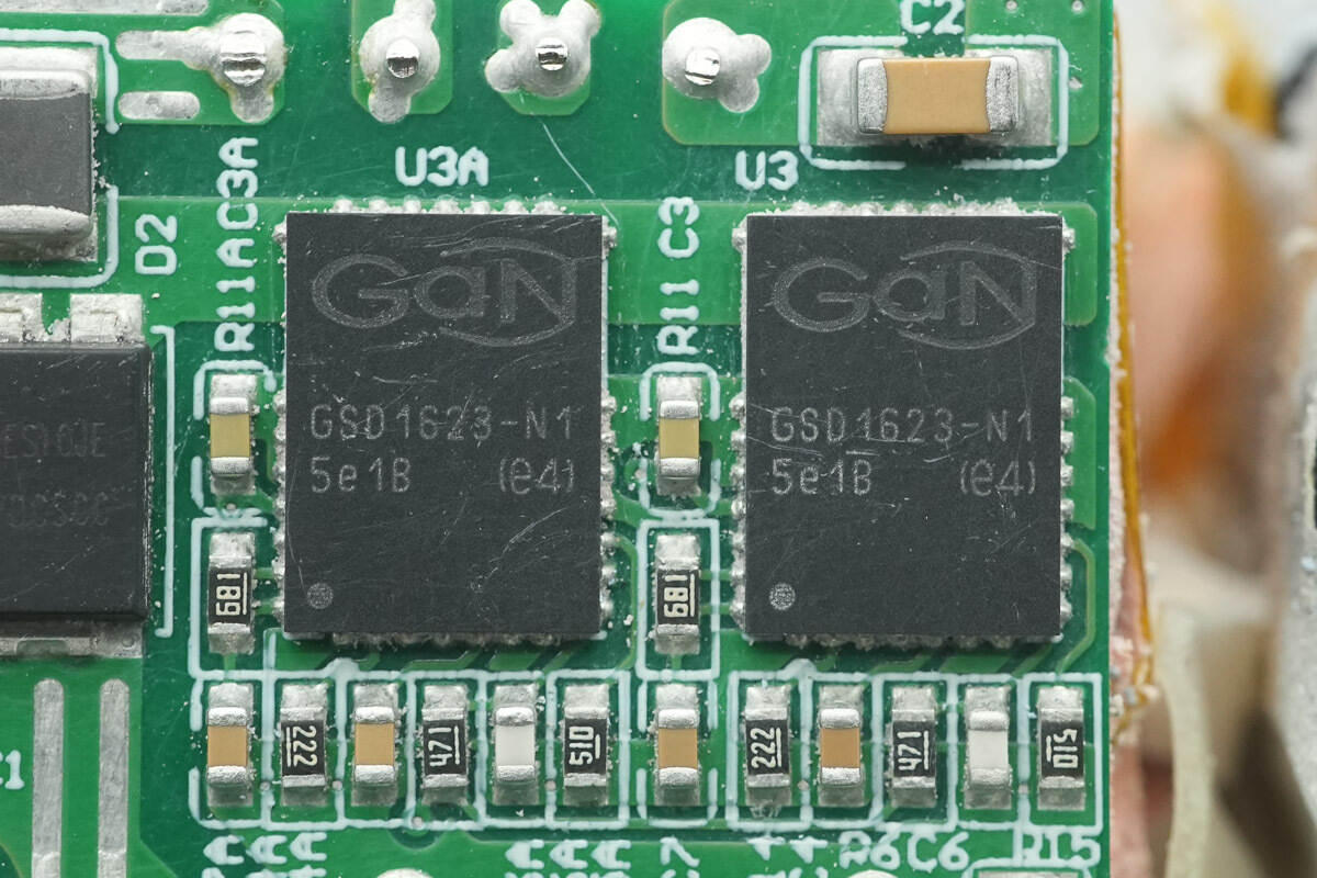

The PFC MOSFETs are from Infineon, model GSD1623‑N1. This is a 150 mΩ enhancement-mode GaN transistor with integrated smart gate drive and lossless current-sensing features, housed in a VIQFN‑30 package.

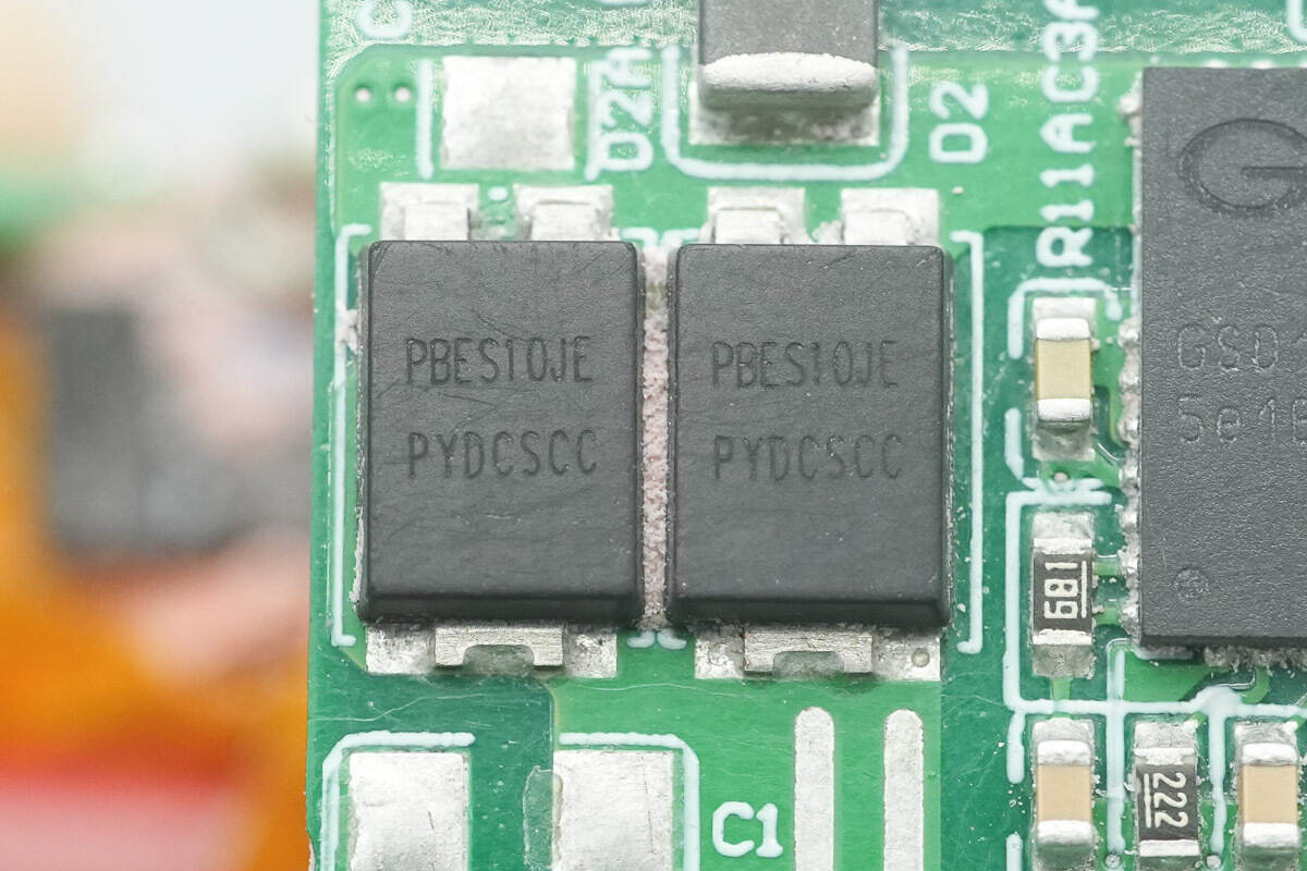

The PFC rectifiers are from PY, marked PBES10JE. They are 10 A, 600 V ultra-fast recovery diodes.

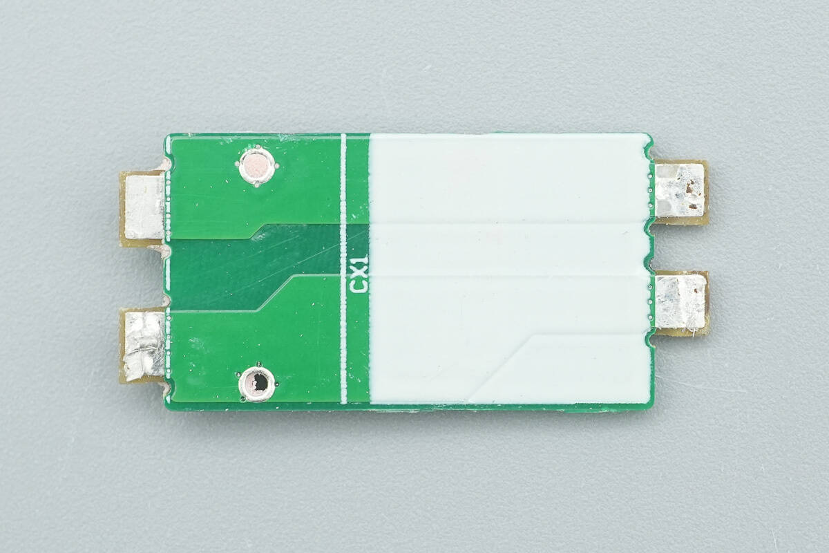

On the front of the PCBA module, there is a small PCB at the top center, a small support PCB below it, and a small synchronous rectification PCB on the right side.
After removing the three small PCBs in the central area, the front of the support small PCB is found to house a transformer.

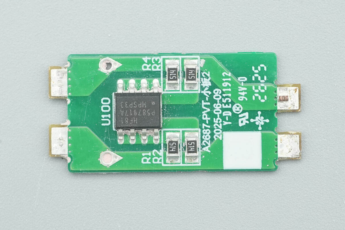

On the back side, there is a primary MOSFET.
The top small PCB houses a film capacitor and a solid capacitor.

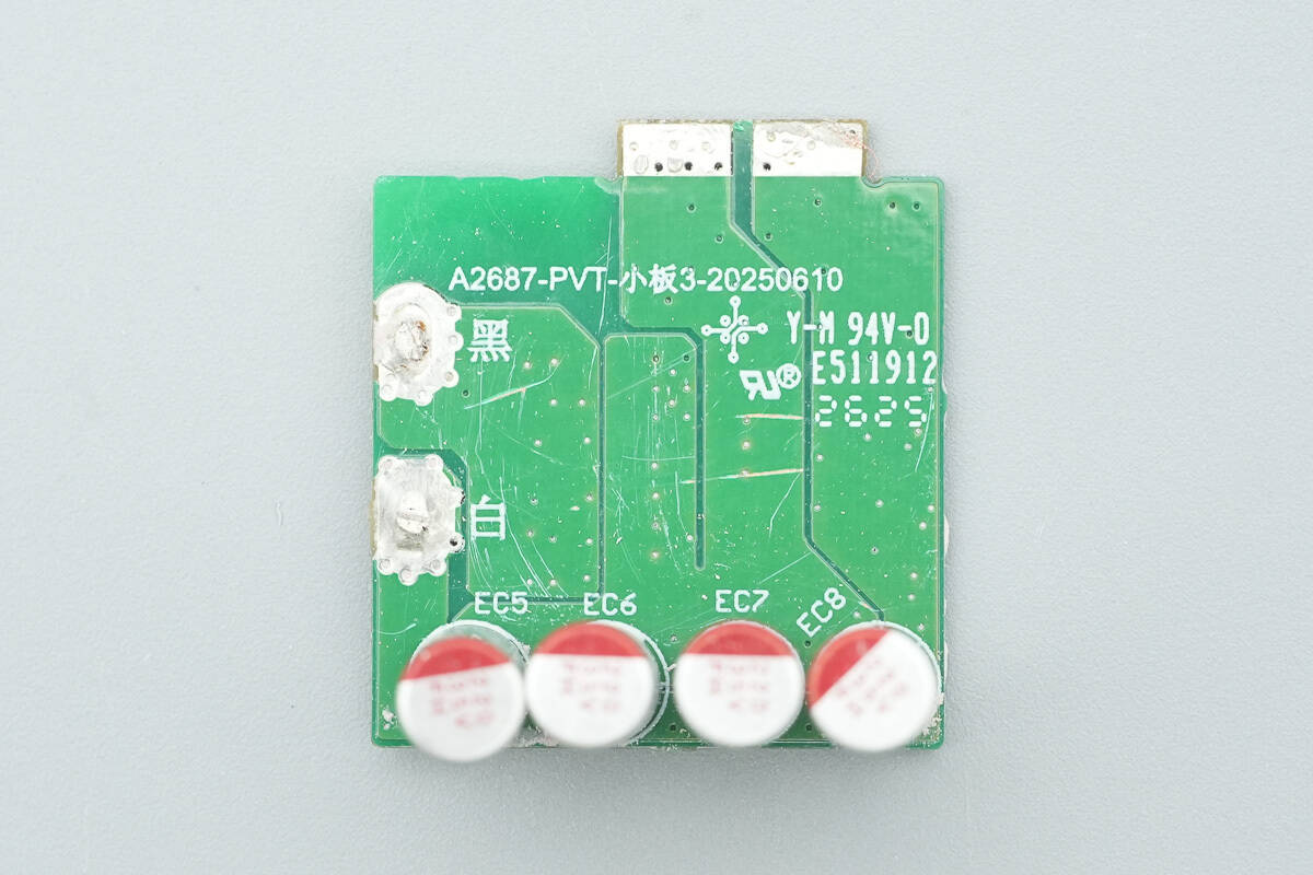

The front of the synchronous rectification small PCB is equipped with four solid capacitors.

The GaN half-bridge chip is from Infineon, model IGI65D1414A3MS. The chip integrates a half-bridge power stage consisting of two enhancement-mode GaN transistors, each with a typical on-resistance of 140 mΩ and a voltage rating of 650 V, packaged in a compact 6×8 mm QFN‑32.

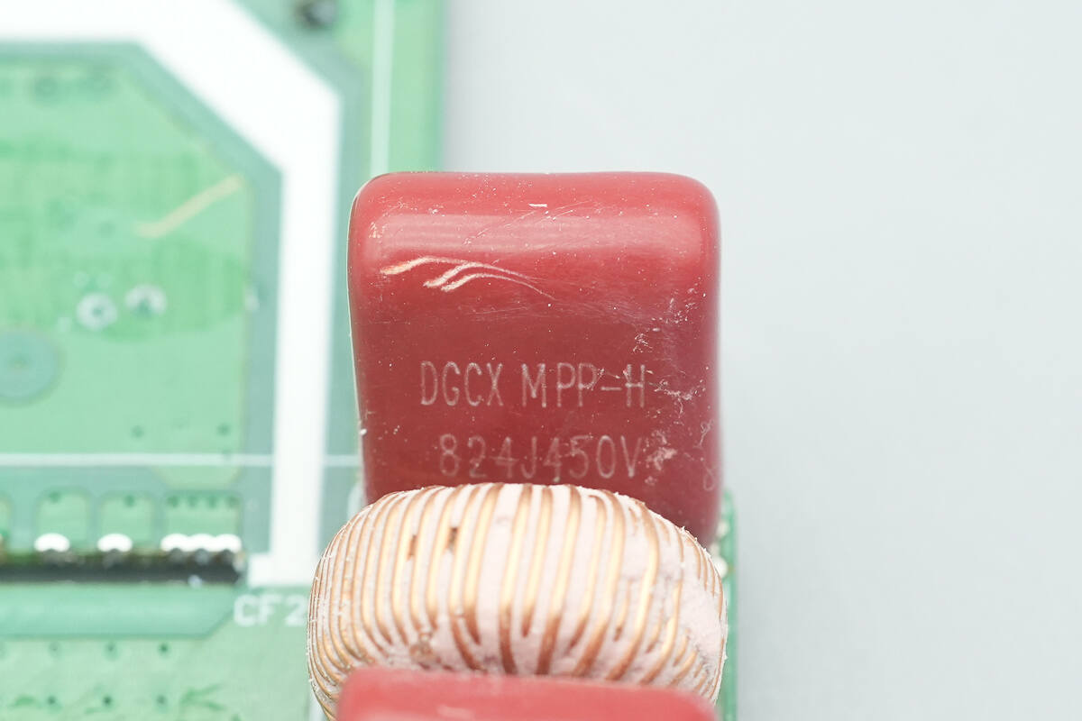

The resonant capacitor is from DGCX, rated at 0.47 µF, 250 V.

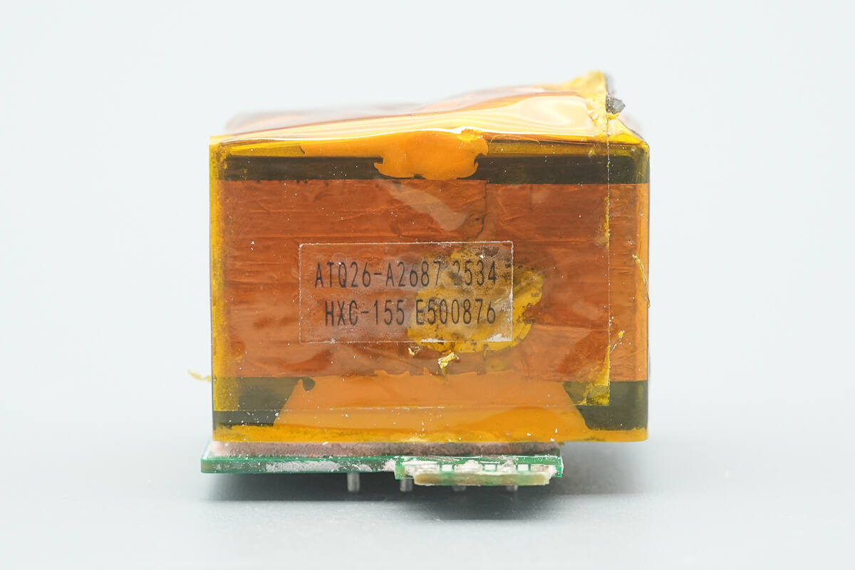

The transformer uses an ATQ26 magnetic core.

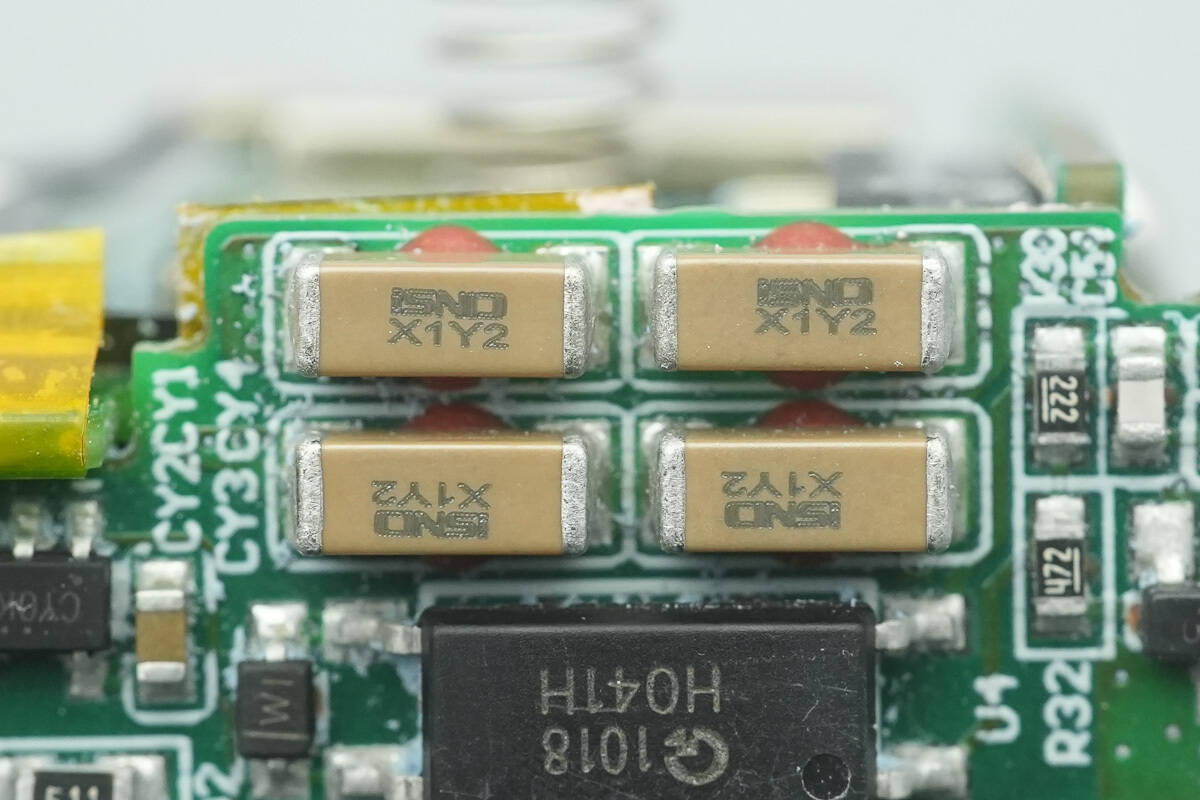

The four SMD Y capacitors are from ISND, connected in pairs in series to enhance the safety rating.
The synchronous rectifier controller is from MPS, marked ICDGT, and comes in a SOT23‑6 package.

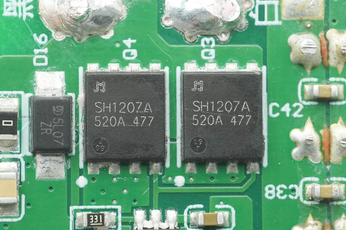

The synchronous rectifiers are from JJWD, model JMSH1207AG, rated 120 V with an on-resistance of 5.6 mΩ, housed in a DFN 5×6 mm package.

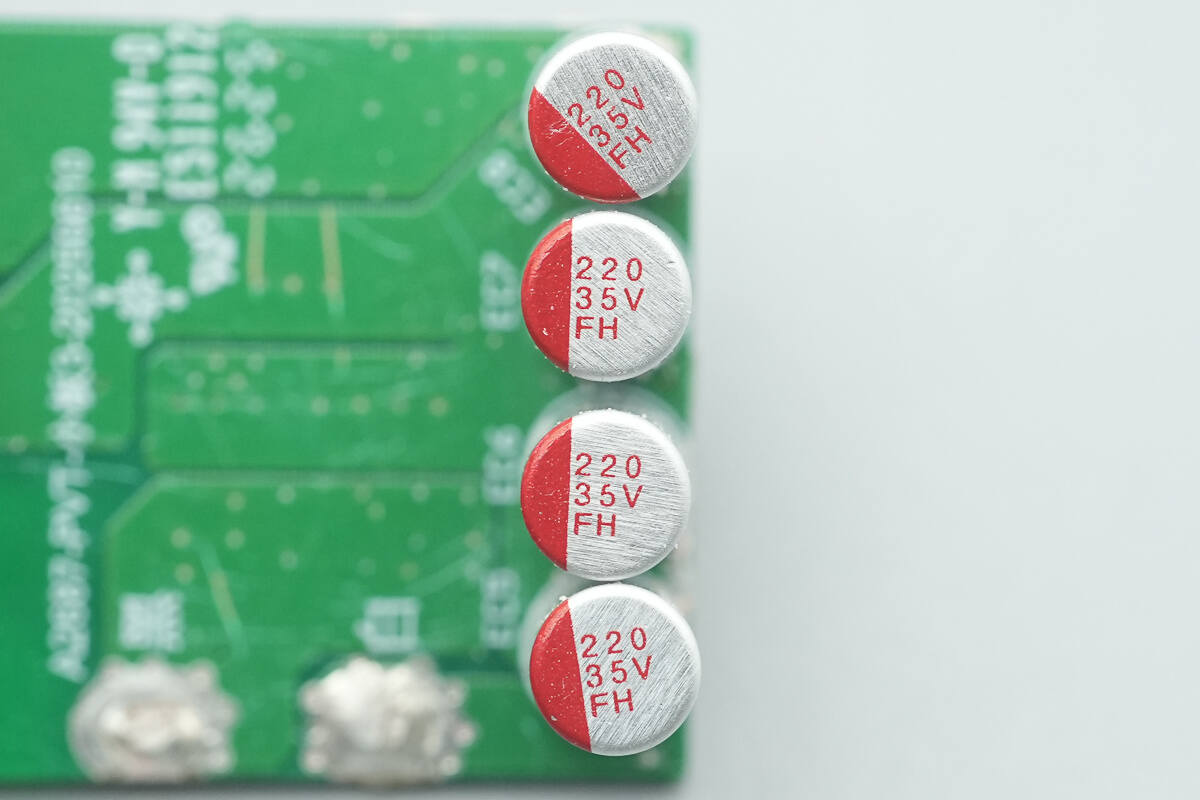

The four solid capacitors for output filtering are all rated at 35 V, 220 µF.

All three USB-C ports use the same output control scheme, so only one set will be described.
The front of the small PCB houses the MCUs, synchronous buck MOSFETs, buck inductors, solid capacitors, VBUS MOSFETs, and isolated power modules, among other components.

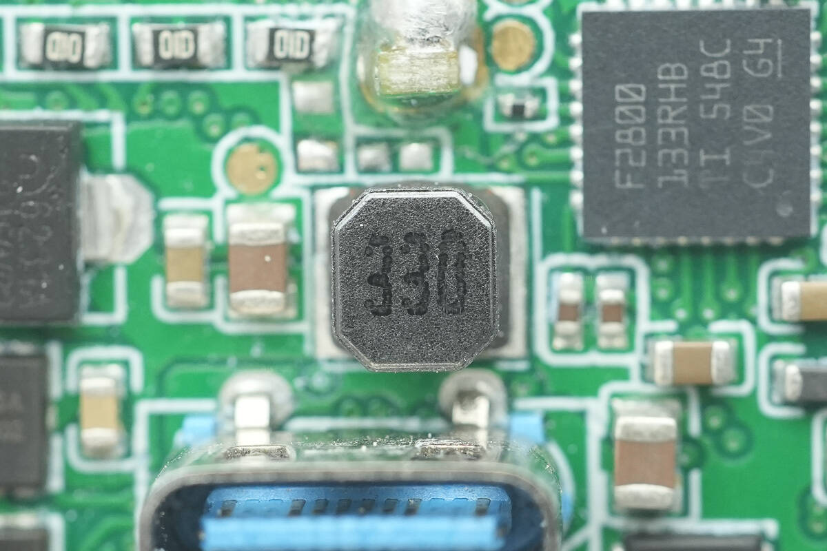

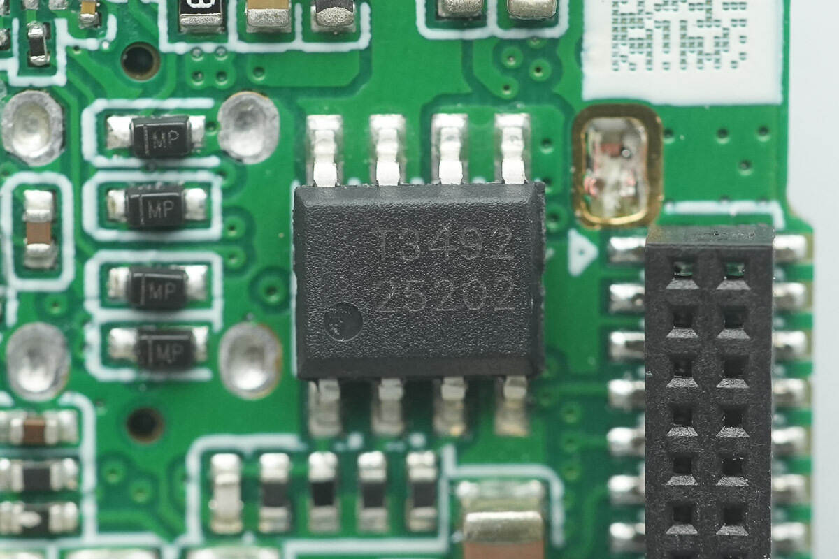

The synchronous buck converter is from Tollsemi, model TMI3492. It is a wide-input, high-efficiency 2 A synchronous rectified buck converter that integrates a 120 mΩ high-side power MOSFET and a 50 mΩ low-side power MOSFET, capable of delivering up to 2 A total output current at 5 V output.
The TMI3492 features advanced production-grade protection functions, including undervoltage lockout, thermal shutdown, soft start, and input overvoltage protection, and comes in an SOP8 package.
Close-up of the accompanying buck inductor.

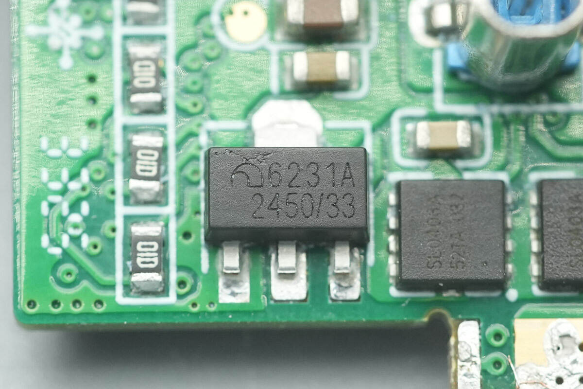

A voltage regulator chip marked 6231A is from Microne.

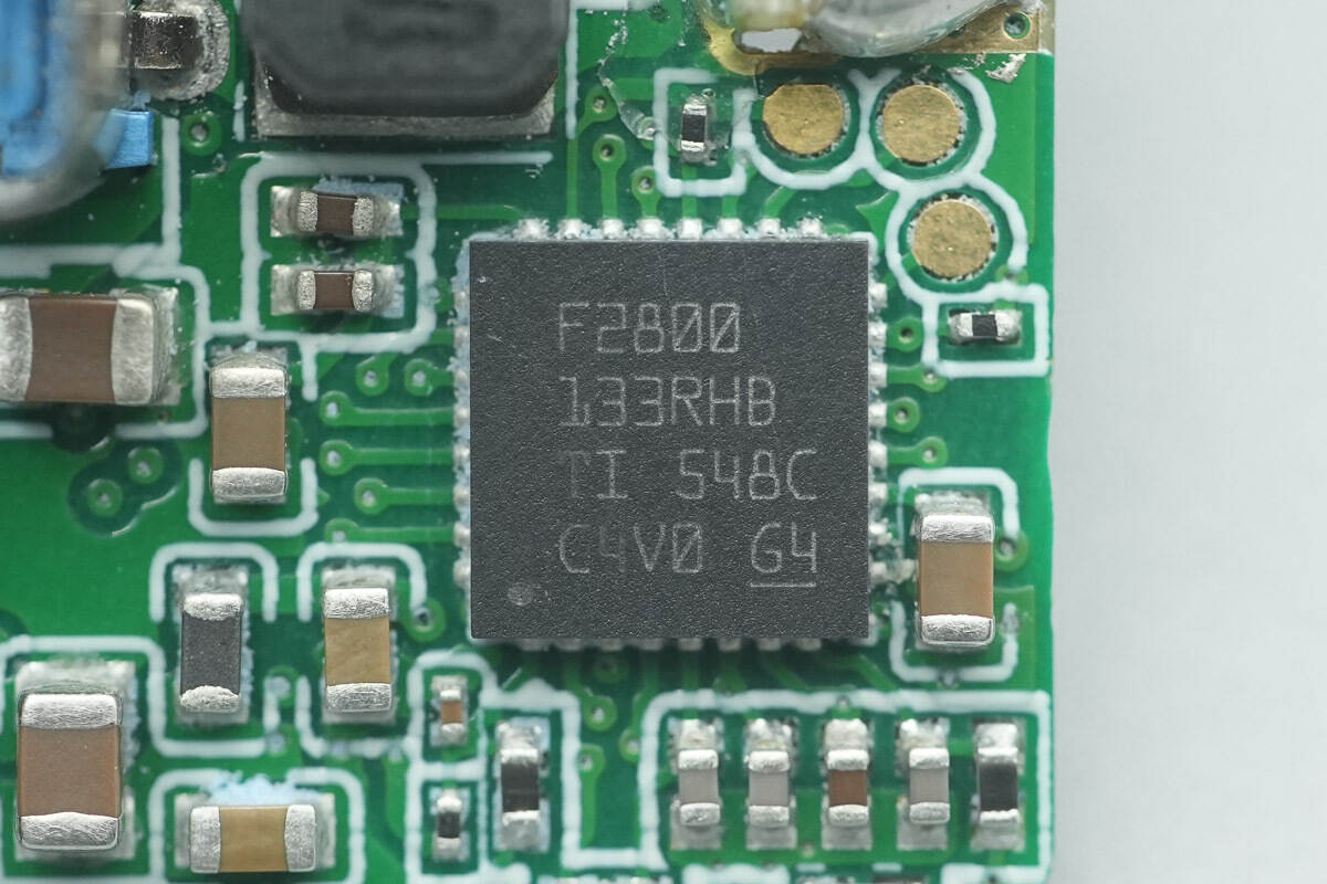

The TMS320F2800133RHB is a real-time microcontroller from TI’s C2000™ series. It features a 32-bit C28x DSP core with a maximum clock frequency of 120 MHz, 14 ePWM channels (including 2 channels with 150 ps high-resolution capability), high-speed ADCs, hardware protection comparators, and a rich set of communication interfaces. It is designed for high-precision, high-dynamic-response digital control applications and comes in a VQFN32 package.

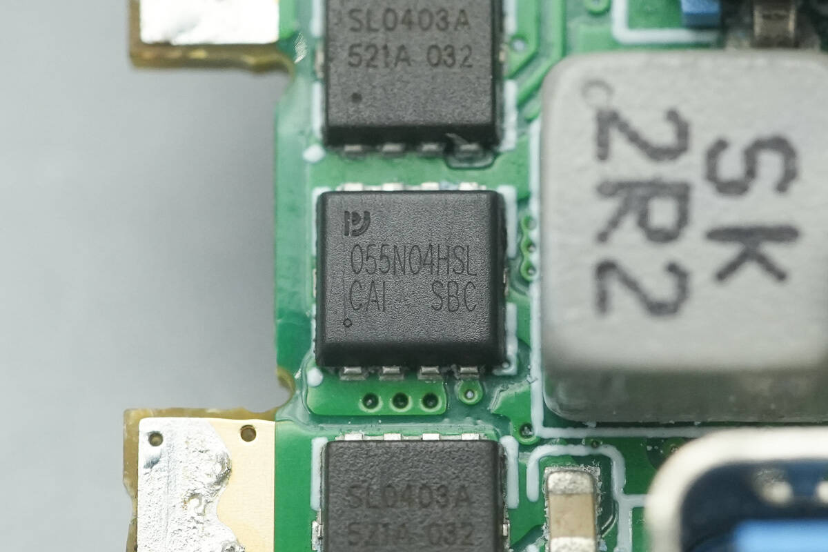

The JJWD JMSL0403AU is an N‑MOSFET with a voltage rating of 40 V and an on-resistance of 2.5 mΩ, housed in a PDFN 3×3‑8L package.
The PY MOSFET is marked 055N04HSL.
Close-up of the PY MOSFETs on the back side.

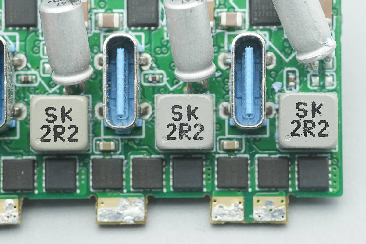

Close-up of the three 2.2 µH buck inductors. They measure just 5.5×5.5 mm, much smaller than conventional inductors. This, combined with Anker's proprietary architecture, significantly reduces the PCB area occupied by the DC-DC circuit.
The three solid capacitors for output filtering are all rated at 35 V, 47 µF.

The three digital isolators are TI ISO6520. This is a high-performance, dual-channel functional isolator designed for cost-sensitive, space-constrained applications that require isolation from non-safety applications. While isolating CMOS or LVCMOS digital I/O, the device offers high electromagnetic immunity, low emissions, and low power consumption.

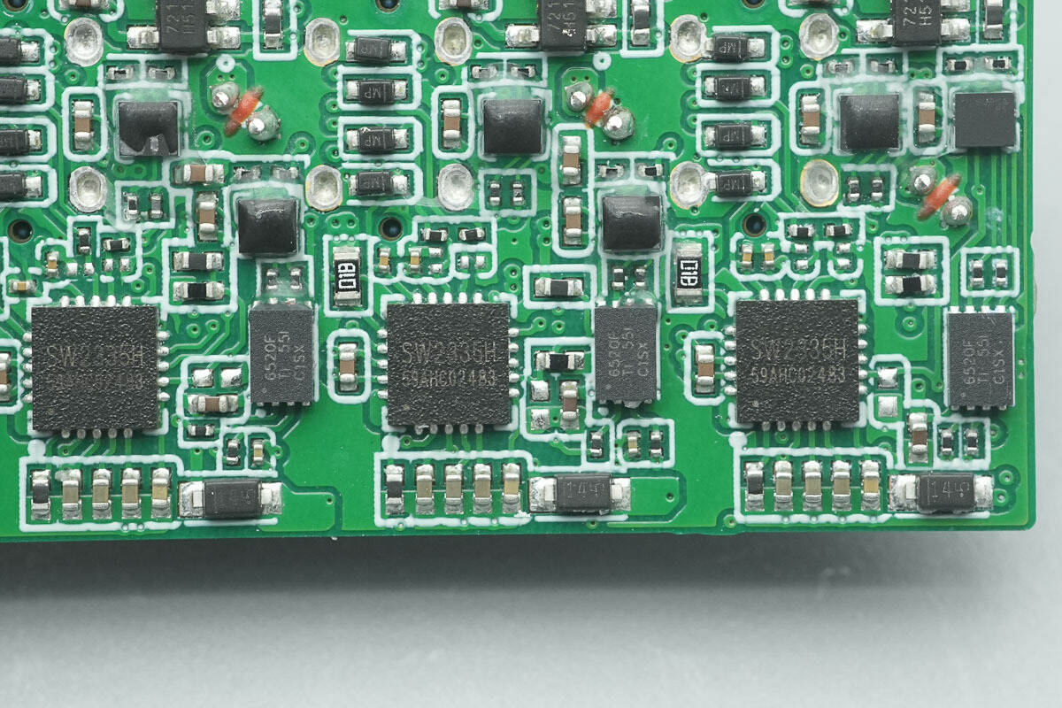

The protocol chips for all three ports are iSmartWare SW2335H. This is a highly integrated fast-charging protocol controller, featuring an ARM Cortex-M0 core with a maximum operating frequency of 40 MHz, and supporting common peripheral interfaces such as I2C, UART, and GPIO.
The SW2335H integrates Type-C interface logic and PD3.1 PHY, supporting PD3.1, BC1.2, UFCS, and various mainstream DPDM fast charging protocols, with a maximum output voltage of 32V. It is primarily used in applications such as adapters, power strips, and car chargers.

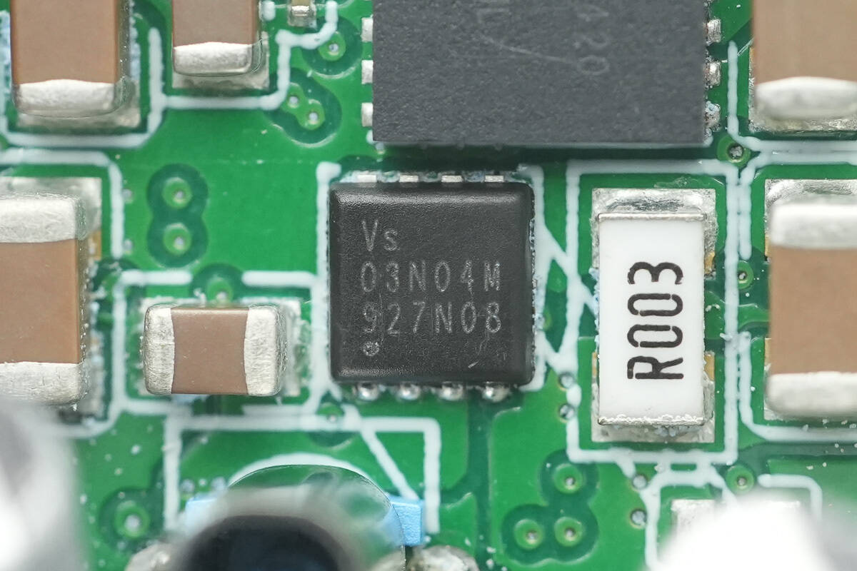

The three VBUS output MOSFETs are Vergiga VSE003N04MSC-G, N‑MOSFETs with a voltage rating of 40 V and an on-resistance of 2.3 mΩ, packaged in a PDFN 3333 package.

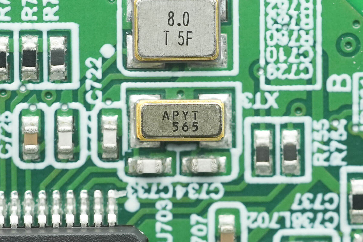

Close-up of the external 8.0 MHz surface-mount crystal oscillator.
Close-up of the 32.768 kHz surface-mount crystal oscillator.

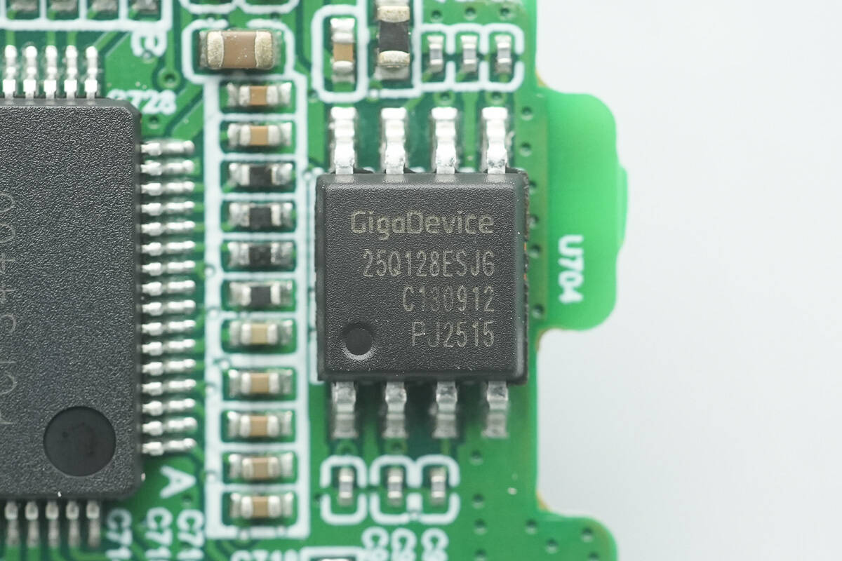

The memory is from GigaDevice, model GD25Q128E, with a capacity of 16MB. It supports a single-supply voltage range of 2.7–3.6V and comes in an SOP8 package.

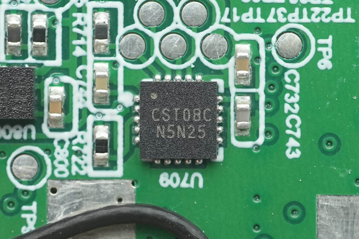

The HYNITRON CST08C is a high-performance self-capacitance touch chip. It uses a high-speed MCU core with an embedded DSP circuit, combined with fast self-capacitance sensing technology. The chip supports a variety of self-capacitance patterns, including triangles, and supports single-point gestures and real two-point operations, offering extremely high sensitivity and low standby power consumption. It comes in a QFN 3×3-20L package.

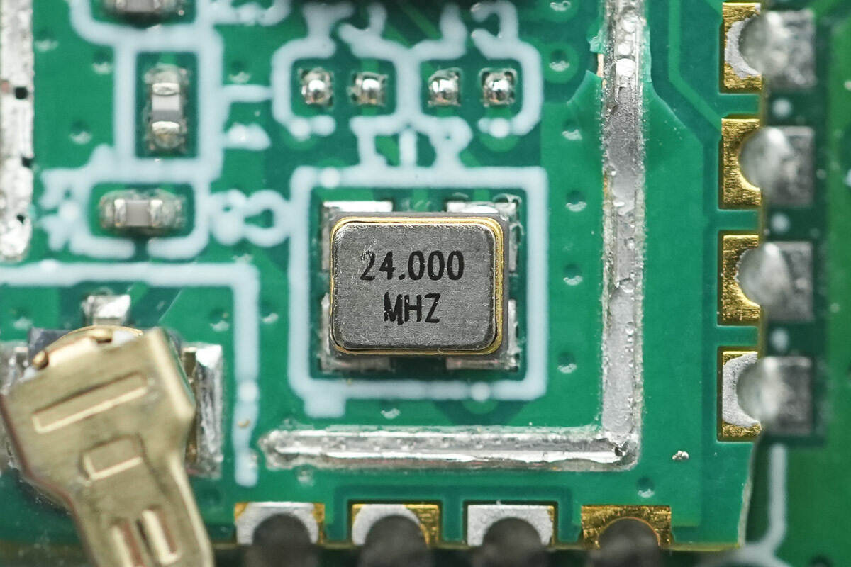

Close-up of the 24.000 MHz crystal oscillator.

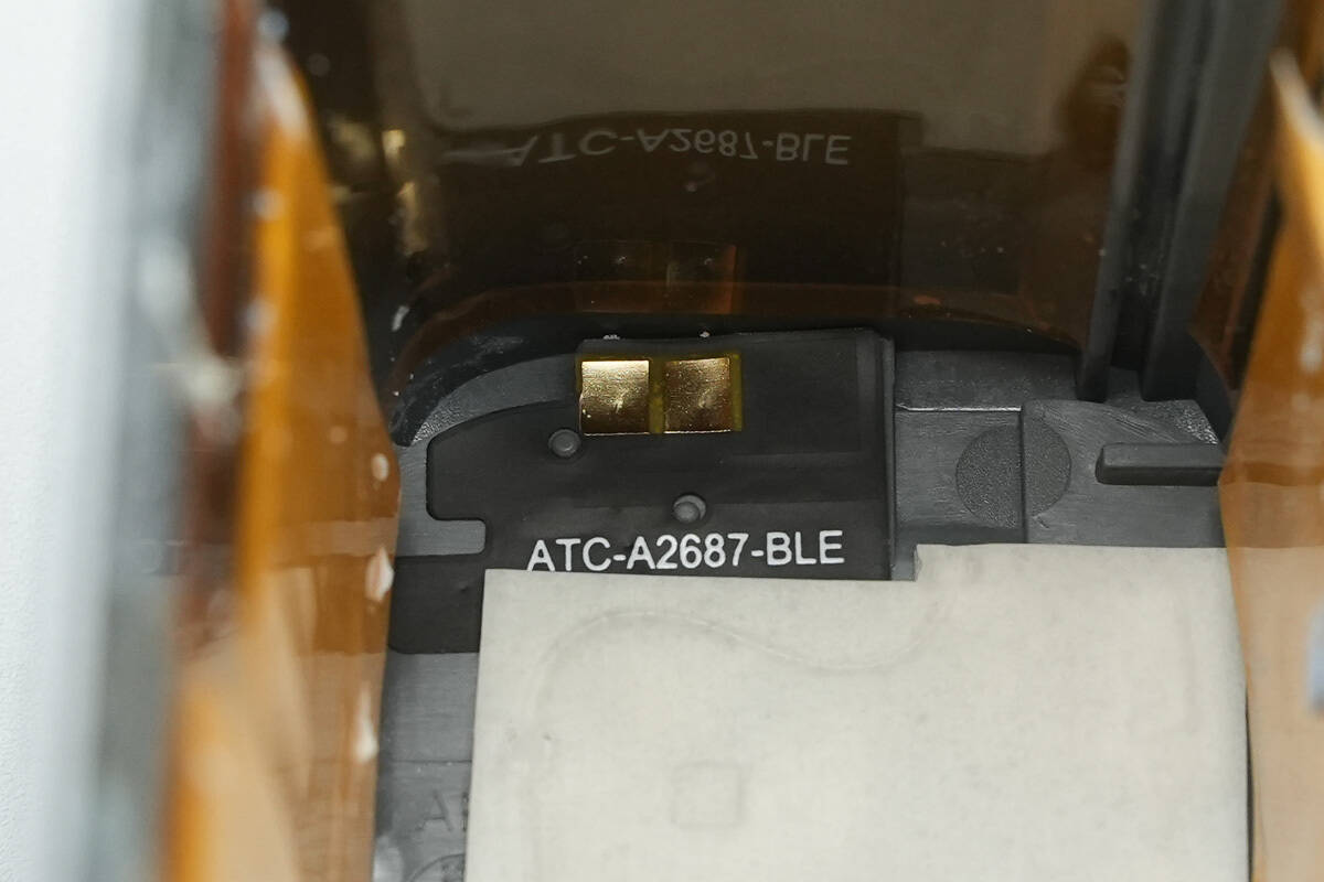

Close-up of the contact points used to connect the Bluetooth antenna.

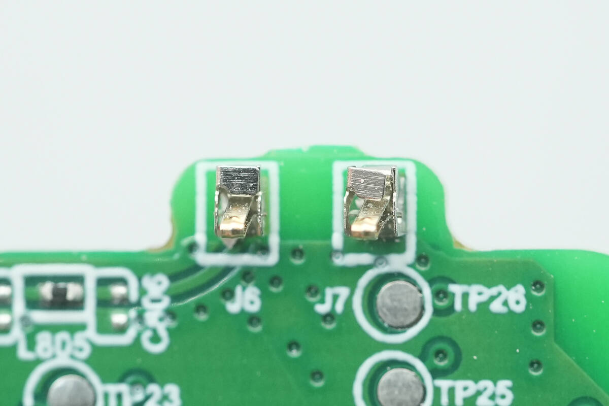

Close-up of the two thermistors.
Close-up of the screen.

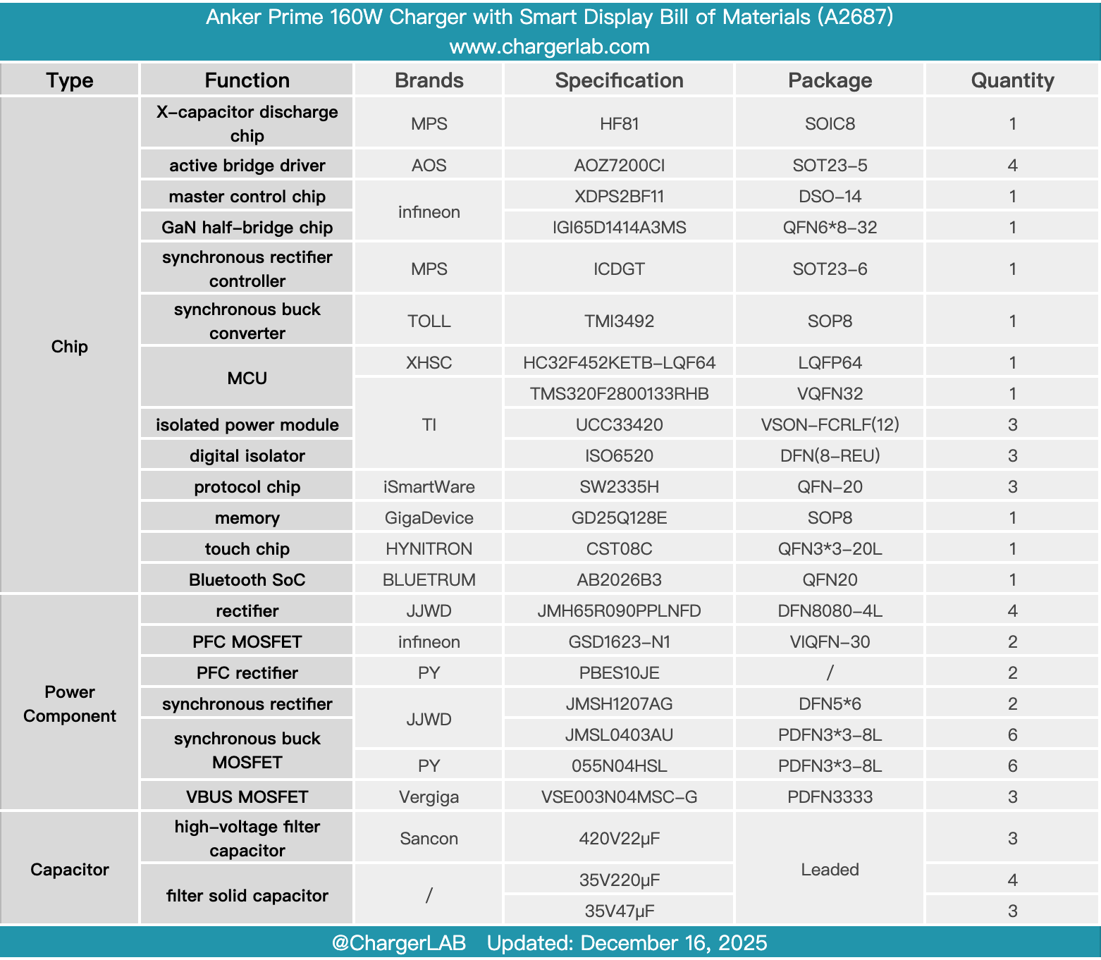

Here is the component list of the Anker Prime 160W Charger with Smart Display for your convenience.

It is equipped with three USB-C ports that support multiple protocols, including PD3.1, QC3.0, PPS, and SCP. It provides up to 140W for a single port and a total power of 160W. Additionally, it supports smart and customizable power distribution, ensuring broad compatibility with various brand devices for efficient fast charging.

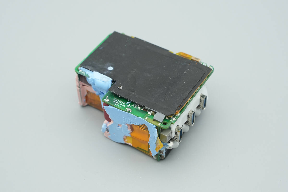

After taking it apart, we found that it uses a PFC+HFB efficient topology design. The controllers and GaN devices are from manufacturers like Infineon and MPS. The core components of the output isolation circuit are from TI. The protocol chips for all three ports are iSmartWare SW2335H.
The module features an extremely compact stacked design, with a very tight component layout. It is heavily filled with thermal adhesive and covered with thermal pads to assist with heat dissipation. Additionally, adequate insulation and isolation have been applied between components to ensure safety during long-term use.
