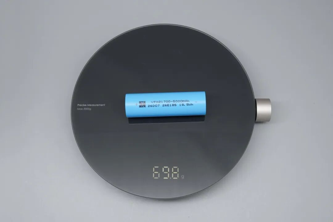

Built to the standard 21700 form factor, it packs a 5000mAh nominal capacity (4900mAh minimum), 18.5Wh of energy, and a 3.7V nominal rating. Featuring an innovative tabless, low-impedance layout paired with impressive energy density, this cell delivers top-tier sustained discharge rates and thermal management, expanding YFH's robust high-power cylindrical lineup.
YFH Introduces the 21700 Tabless Battery Cell—YFH-50Q-Chargerlab
The YFH-50Q shines in impedance and output, boasting an AC internal resistance of ≤4mΩ, a gravimetric density of 272Wh/kg, and a volumetric density of 744Wh/L. It supports 5A standard charging, up to 15A fast charging, and a continuous discharge of 50A—stretching to a blistering 90A continuous output with an 80℃ thermal cutoff, plus a 2-second 140A pulse capability.
Cycle longevity is equally solid, retaining over 80% capacity after 500 cycles at 5A charge and 50A discharge. Dressed in a sleek blue heat-shrink sleeve, it features a flat three-vent alloy positive terminal and an anodized negative base.

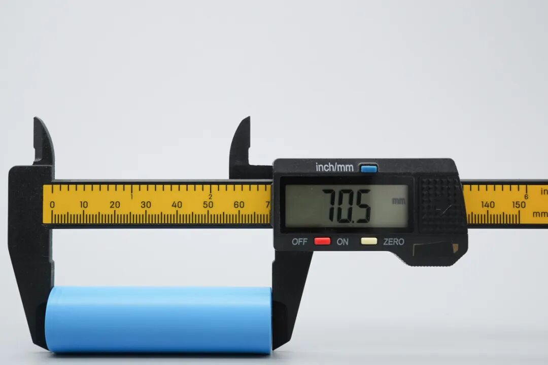

Dimensions measure roughly 70.5mm × 20.9mm at a weight of 69.8g.
