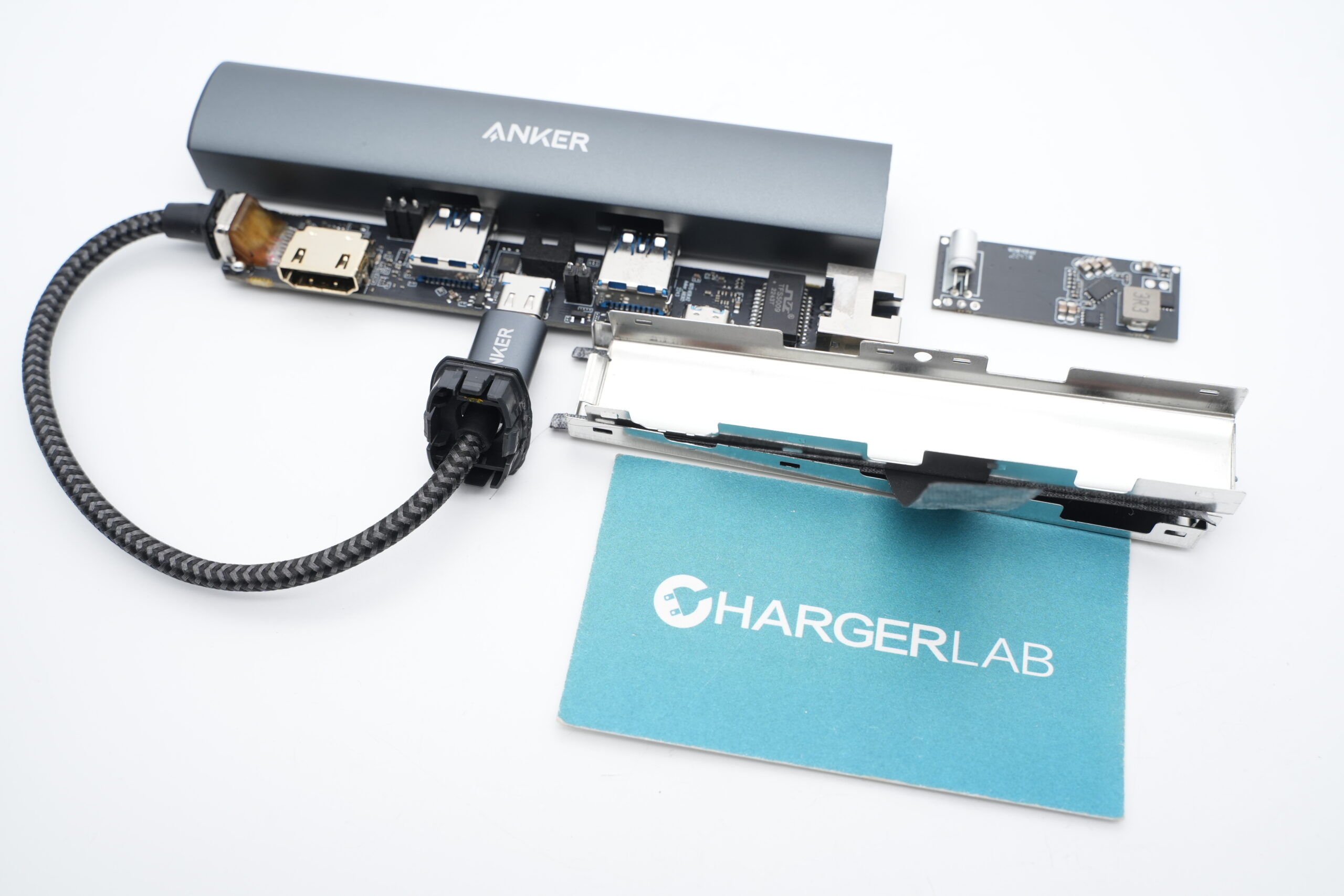

Now, let's start to take it apart.
Teardown of Anker 6-in-1 USB-C Hub (A8365)-Chargerlab
Remove the case and take out the PCBA module.
The PCBA module has an aluminum alloy case and is pasted with conductive cloth for grounding.
The case is fixed with snaps.
Remove the aluminum alloy case, the PCBA module is insulated by mylar sheets.
So as the back of the PCBA module.
Remove the mylar sheets.
There is a small PCB soldered on the front of the PCBA module.
Remove the small PCB and continue to take it apart.
There are lots of sockets on the front.
The HDMI converter, USB-C controller, USB hub chip, and Ethernet controller are on the back.
The built-in cable and its metal case are soldered on the PCBA module.

Here is the small PCB soldered on the PCBA module. There is a synchronous buck-boost circuit on it.
The synchronous buck-boost converter marked with 9247 is from MPS. It integrates two PMOSFETs, and two NMOSFETs to form an H-bridge.
