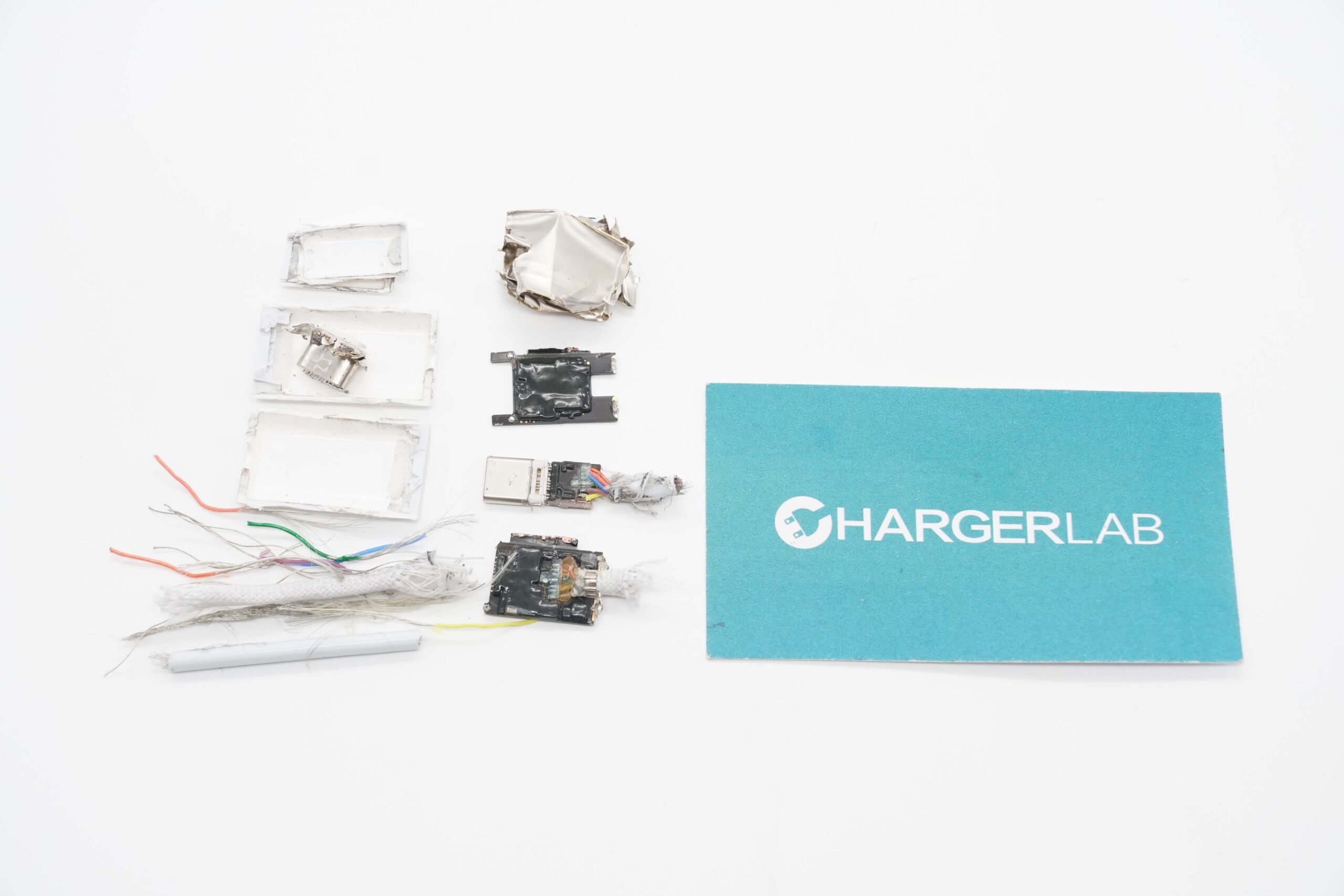

Teardown of Apple USB-C to Lightning Adapter (A2868)-Chargerlab
Firstly, use the cutting machine to cut off the USB-C connector. Just the Apple 240W USB-C Charge Cable we just took apart before, it has a steel sleeve to protect internal components, which is fixed by plenty of solder joints.
Continuing to remove the steel sleeve, you can see a lot of potting compound on top of the black PCB.
All the wires are connected to this side, all of which are reinforced with glue.
And there are no components on the back.
Moving on to the Lightning part, it also has a steel sleeve to protect internal components.
There is soft rubber on the shell for fixing.
Continuing to remove the steel sleeve, there are two PCBs inside.
They were originally connected through the extension parts within the red frame.
The first PCB is covered with a lot of potting compound.
The solder joints of the wires are reinforced with glue.
The back only has potting compound.
The other PCB also has potting compound applied in the same way.
And there is nothing on the back.
Next is the cable, you can see red, yellow, blue and green wires.
There's a layer of white TPE, followed by the shielding net.
No aluminum foil.
Here is a close-up of the cable's internal structure, including the outer woven layer, white TPE, shielding net, and data wires.
These two positive power supply wires are made of tinned copper.
Here is the green wire.
Purple wire.
Yellow wire.
Blue wire.
These five bare tinned copper wires are used for negative power supply.
Well, that would be all the components of the two connectors and the cable.
In terms of build quality, the extensive use of potting compound inside and the special way of connecting the two PCBs are top-tier. And these advantages somehow justify the $29 price tag.
If you already have plenty of Lightning cables on hand, it is recommended to purchase this adapter to help protect the environment. If not, you may consider buying a brand new USB-C to USB-C cable instead.
