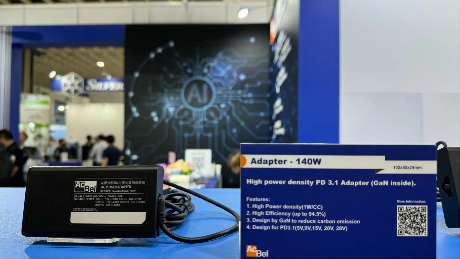

AcBel
AcBel 140W PD3.1 Adapter
The AcBel 140W PD3.1 Adapter comes in a deep black color. The surface is engraved with the "AcBel".
Summary of Five Brands' 140W PD 3.1 Laptop Chargers-Chargerlab
The adapter uses GaN technology and measures 102 x 55 x 24 mm (4.02 x 2.17 x 0.94 inches). It has a power density of 1.12W/cm³ (18.35W/in³) and a charging efficiency of 94.5%.
It can support input of 100-240V 50/60Hz 2.0A. It can support output of 5V/3A, 9V/3A, 15V/3A, 20V/6.5A, and 28V/5A, with a maximum power output of 140W. It complies with EMI/RFI standards EN55032, CLASS B, and provides OVP, OCP, OTP, and SCP protections. It also meets the IEC 62368-1 safety standard. The adapter comes with a USB-C charging extension cable, making it suitable for charging laptops, tablets, and smartphones.
