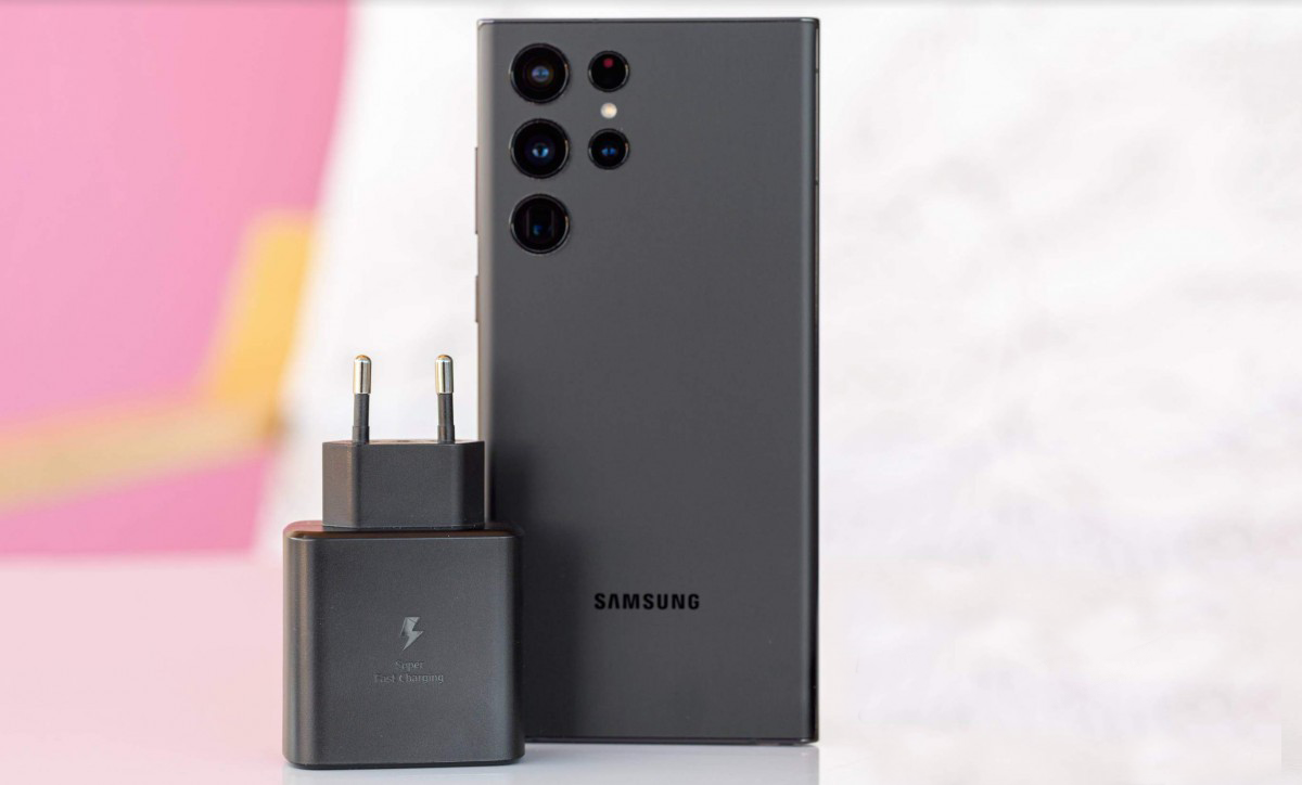

On February 17, 2023, Samsung announced the release of the Galaxy S23 series, which features the snapdragon 8 gen 2 mobile platform across the board. The S23 Ultra and S23+ models support 45W fast charging, while the S23 model supports 25W fast charging. Since Samsung introduced 45W fast charging in 2019, the highest charging specification for Samsung smartphones has remained at 45W, but the S23 series this year is actually the generation with the greatest improvement in fast charging performance.

In 2019, Samsung first introduced 45W fast charging on the Galaxy Note10+, and subsequent models such as the S20 Ultra, S22+, and S22 Ultra also support 45W fast charging. In addition, all Samsung phones that want to experience 45W fast charging need to purchase a 45W original charger at their own expense or support 5A PPS third-party chargers. The standard chargers are all 25W (if any).
