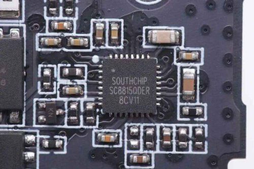

The SouthChip SC8815 is used for buck-boost voltage conversion, charging the battery, and the output of the USB-C port.  It is a bidirectional synchronous buck-boost controller with an integrated I2C port, supporting 2.5 to 36V input and output voltage range and supporting 1 to 6 battery strings. It has under-voltage protection, overvoltage protection, overcurrent protection, short-circuit protection, and thermal shutdown protection. It integrates the I2C interface and adopts QFN32 package.

  • Supports reverse discharging operation.
  • Battery voltage range: up to 36V.
  • Supports 1 to 6-cell Li-ion batteries.
  • Flexible I2C interface for programming:
    • Charging/discharging modes.
    • Charging voltage/current limits.
    • Switching frequency and other parameters.
  • Integrated 10-bit ADC for real-time voltage and current monitoring.
  • Built-in protections:
    • Overvoltage, undervoltage, overcurrent, short-circuit, and overtemperature protections.
  • Buck-boost battery charging for 1–6 cell batteries.
  • Charging management:
    • Trickle charge.
    • Constant current (CC) charge.
    • Constant voltage (CV) charge.
    • Charge termination.
  • Buck-boost reverse discharging mode.
  • Voltage ranges:
    • VBAT: 2.7V–36V (40V sustainable).
    • VBUS: 2.7V–36V (40V sustainable).
  • I2C-programmable parameters:
    • Charging/discharging current and voltage.
    • Input/output current limits.
  • High-efficiency buck-boost conversion.
  • Event detection:
    • Automatic adapter insert/load insert detection.
  • Power path control.
  • Package: QFN-32 (4mm × 4mm × 0.75mm).
