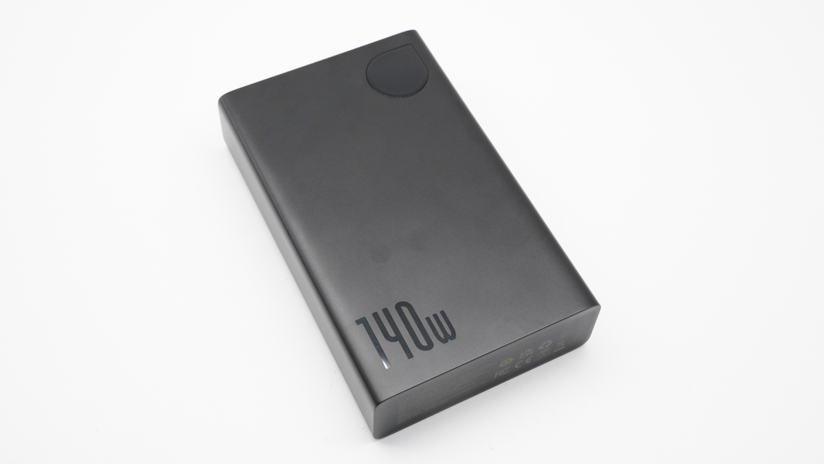

Nowadays, there is an increasing demand from users for high-power smart device charging, leading to a growing market for dual-direction fast-charging power banks. In this review, ChargerLAB has obtained an unreleased Baseus 140W Power Bank. This power bank features two USB-C ports and one USB-A port, with support for a maximum output of 28V5A 140W. Let's take a closer look at the performance of this power bank.
Review of Baseus 140W PD3.1 Power Bank (2C1A)-Chargerlab
The exterior of the power bank is made of black PC material with a matte finish, making it resistant to fingerprints. The front design closely resembles their Adaman series.
In the upper right corner of the case is a drop-shaped LED display, which can show the remaining battery, voltage, and current, which is very convenient.
Three USB ports are all designed in red.
And the specs info are on the other side. Model is PPADM140. The capacity is 24000mAh/86.4Wh. The maximum input power is USB-C1's 100W. Regardless of which port it is used with, the USB-C1 always has a maximum output power of 100W. And it has passed FCC, CE and other certifications.
