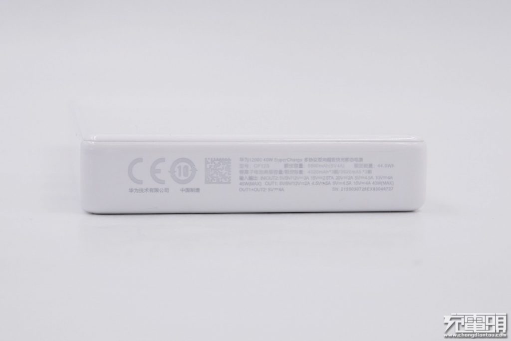

Model: CP12S
Battery Typical Capacity: 4020mAh×3 Battery
Rated Capacity: 3920mAh×3
Rated Capacity: 6800mAh (5V/4A)
Rated Power: 44.9Wh
Input (USB-C): 5V/9V/12V=3A, 15V=2.67A, 20V=2A, 5V=4.5A, 10V=4A, 40Wh (Max)
Output:OUT1 (USB-A): 5V/9V/12V=2A, 4.5V=5A, 5V=4.5A, 10V=4A, 40W (Max)
OUT2 (USB-C): 5V/9V/12V=3A, 15V=2.67A, 20V=2A, 5V=4.5A, 10V=4A, 40W (Max)
OUT1+OUT2: 5V=4A

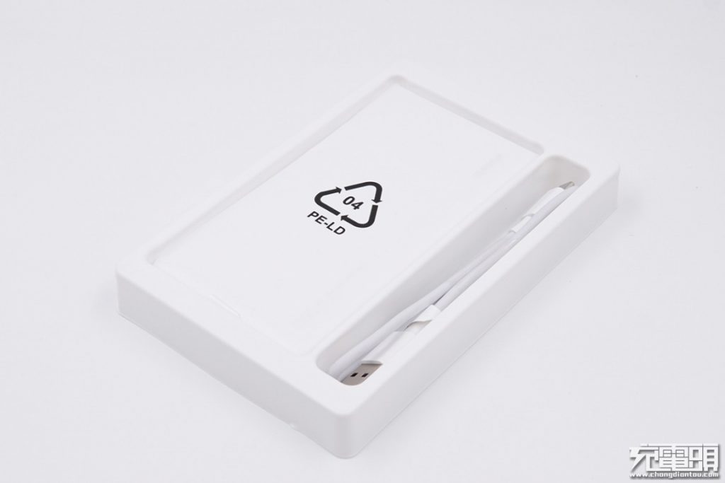

HUAWEI 12000 40W SuperCharge Power Bank Review: the Porsche of Power Banks-Chargerlab
The power bank is wrapped in an anti-static bag and lays inside the plastic tray with a cable.

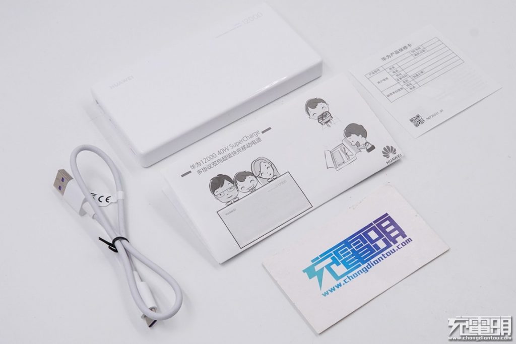

Package contents: power bank, USB cable user manual, and warranty card.

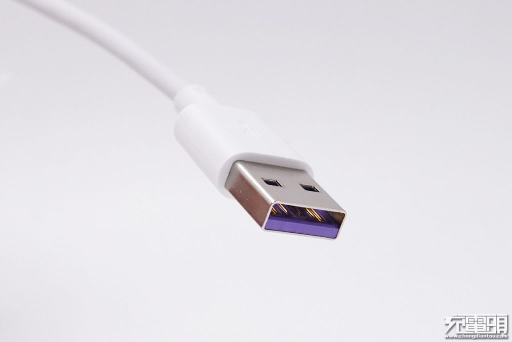

The included USB-A to USB-C 5A cable which is capable of 5A charging.

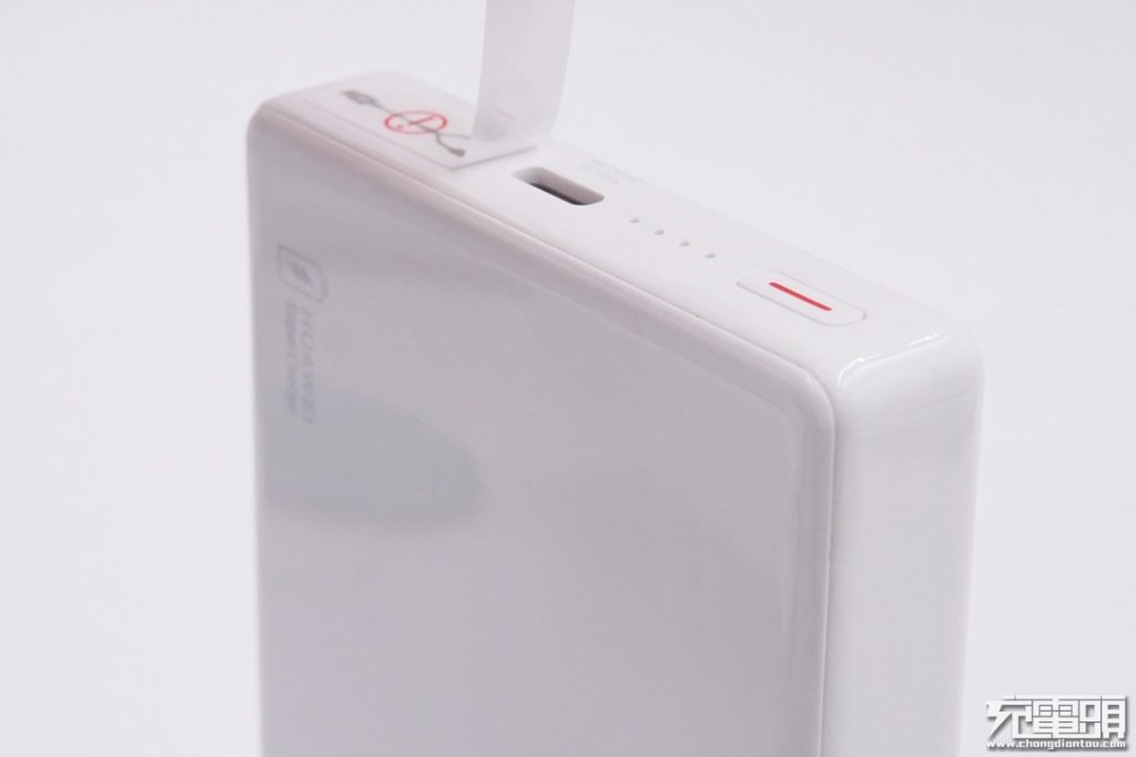

Our review unit comes in white with a rectangular shape. The surface adopts a complex coating process and feels very much like ceramic.
Huawei SuperCharge logo on the back.
A sticker covers the ports.

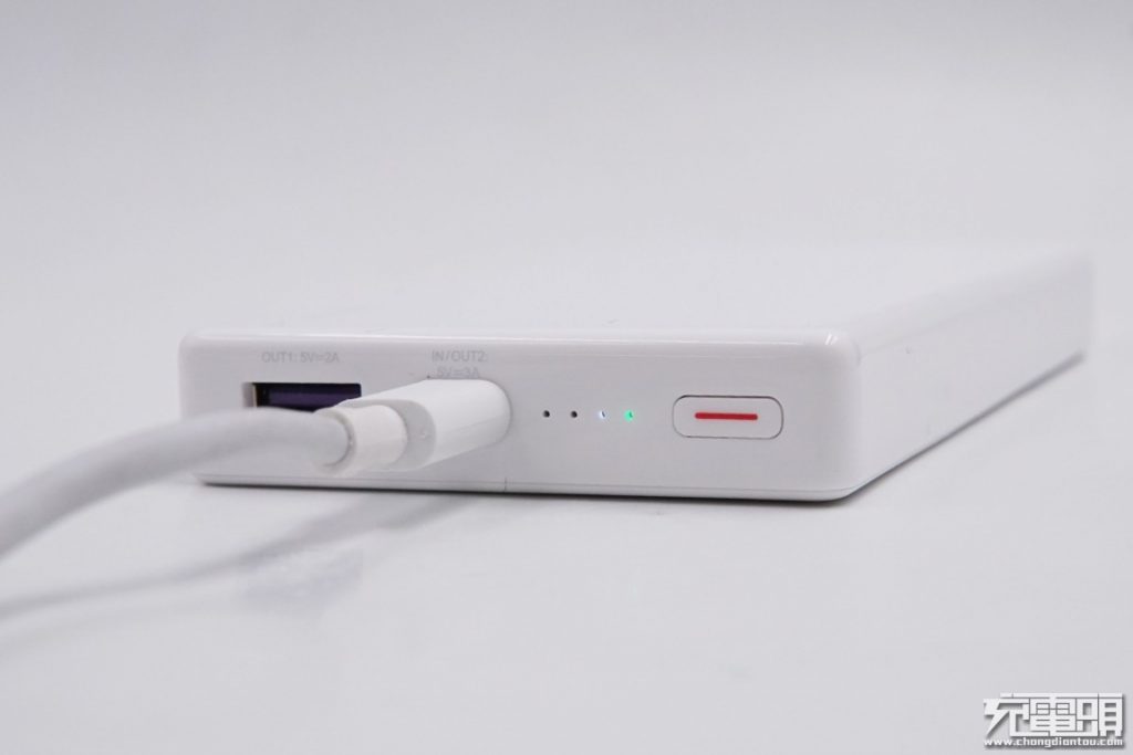

From left to right: the USB-A output port, USB-C input/output port, four LED indicators and a power activation button with Huawei's signature red stripe.
The LED indicator closest to the power activation button lights up in green when the power bank is in fast input or output mode.

Specifications on the side.
Diemensions: 135.4*69*15.5mm (4.06 x 2.07 x 0.47 in).

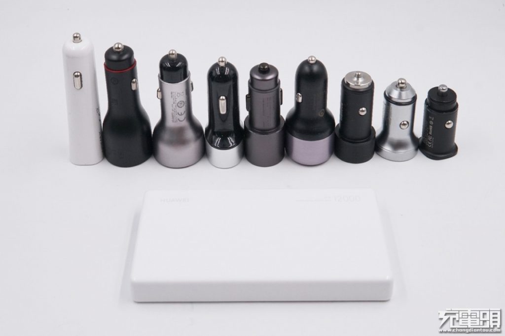

Compared to the 10000mAh CP11QM power bank and the Huawei P20 Pro, the Huawei 12000mAh 40W SuperCharge Power Bank is the smallest. The use of three Lithium Cobalt Oxide batteries enables the power bank to be thinner and lighter, as our teardown shows.

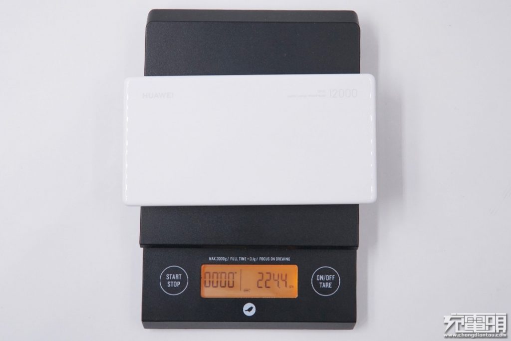

It weighs 224.4g (7.9 oz)

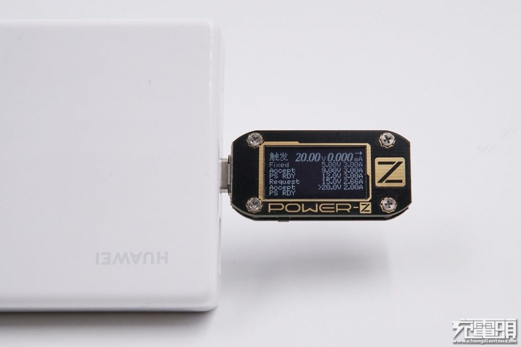

PDO information reveals the USB-C port supports quick charging output in 5V/3A, 9V/3A, 15V/2.66A, and 20V/2A.

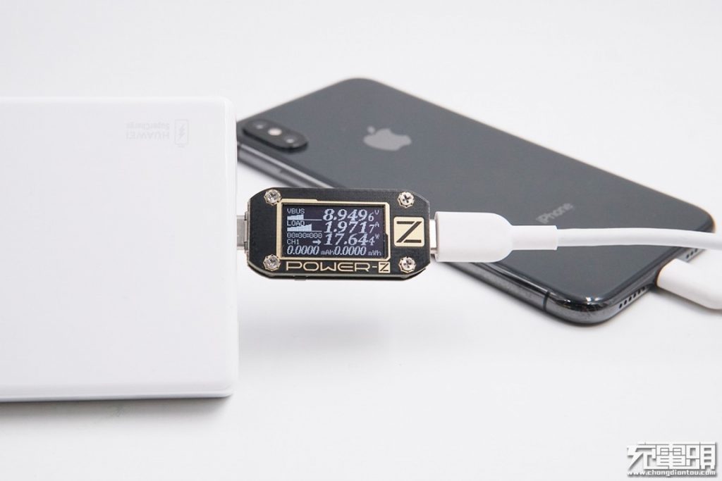

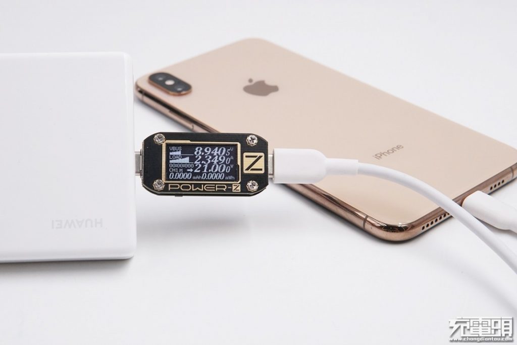

Charging the iPhone XS Max, we are getting 8.94V 2.34A 21W, under PD protocol.
Charging the iPhone XS, we are getting 8.94V 1.97A 17.64W, under PD protocol.

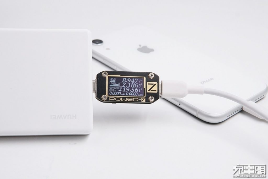

Charging the iPhone XR, we are getting 8.94V 2.18A 19.56W, under PD protocol.

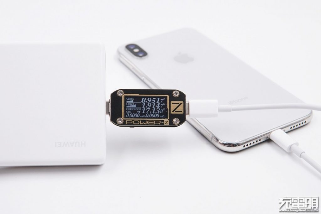

Charging the iPhone X, we are getting 8.95V 1.91A 17.13W, under PD protocol.

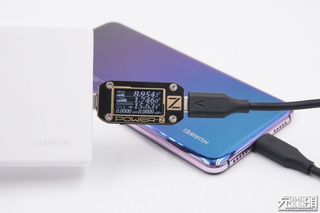

Charging the Huawei P20 Pro, we are getting 8.95V 1.74A 15.63W, under PD protocol.

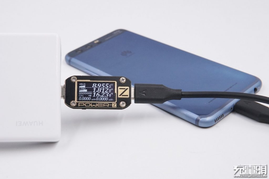

Charging the Huawei P10, we are getting 8.95V 1.81A 16.23W, under PD protocol.

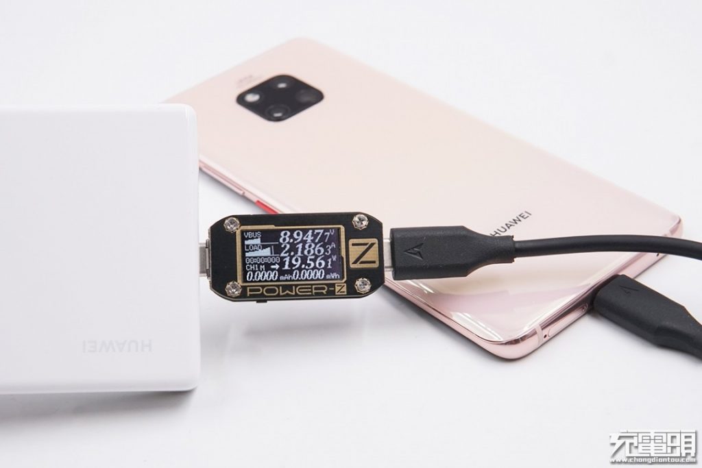

Charging the Huawei Mate 20 Pro, we are getting 8.94V 2.18A 19.56W, under PD protocol.

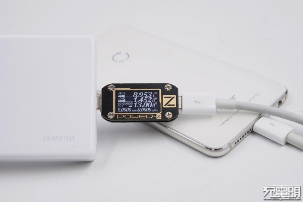

Charging the Honor 8, we are getting 8.95V 1.45A 13W, under FCP protocol.

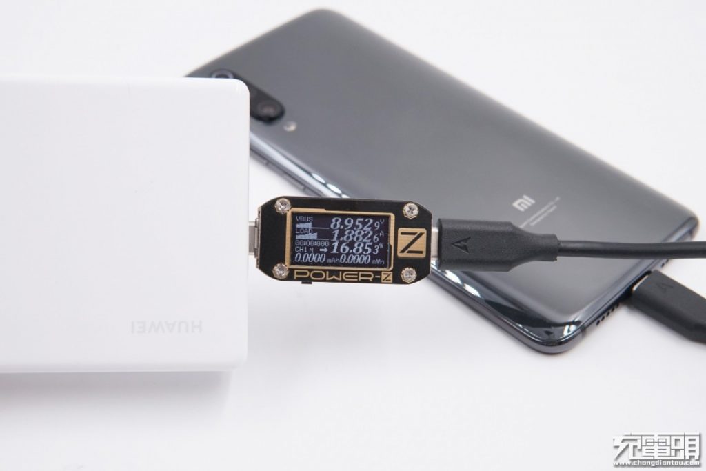

Charging the Mi9, we are getting 8.95V 1.88A 16.85W, under PD protocol.

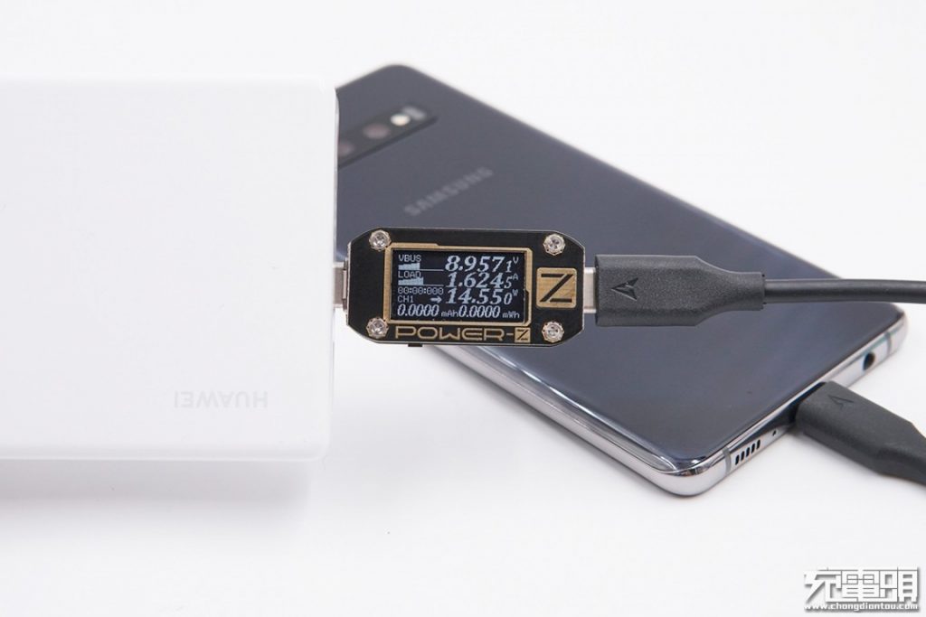

Charging the Samsung Galaxy S10+, we are getting 8.95V 1.62A 14.55W, under PD protocol.

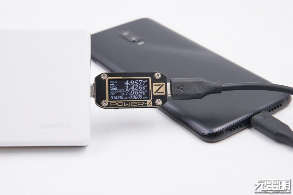

Charging the OnePlus 6T, we are getting 4.95V 1.42A 7.06W, under normal charging speed.

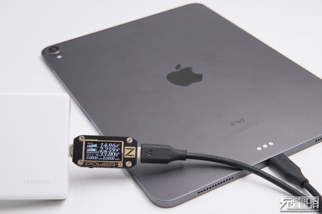

Charging the iPad Pro 11-inch, we are getting 14.96V 2.25A 33.8W, under PD protocol.

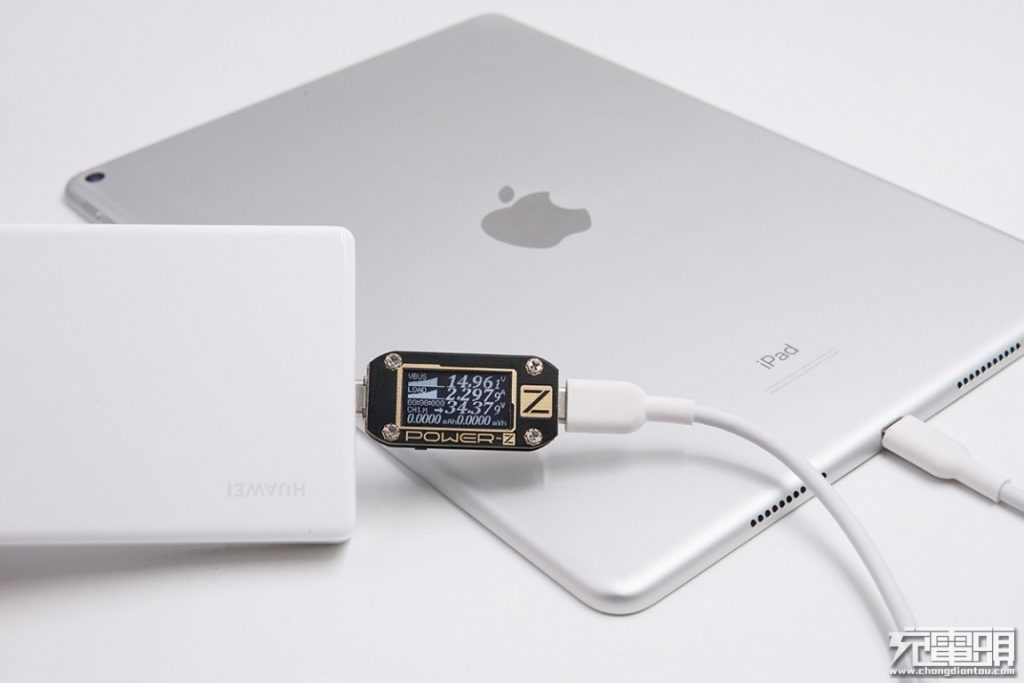

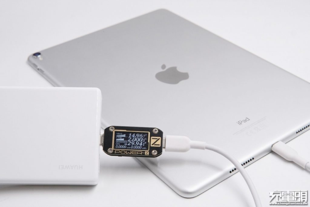

Charging the iPad Pro 10.5-inch, we are getting 14.96V 2A 29.94W, under PD protocol.
Charging the iPad Air3, we are getting 14.96V 2.29A 34.37W, under PD protocol.

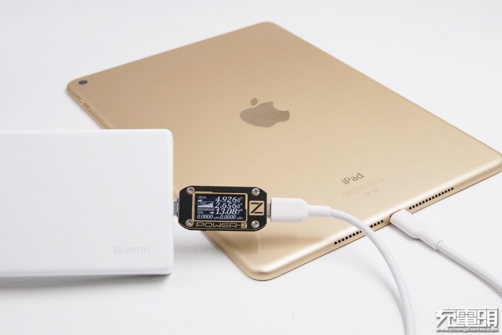

Charging the iPad Air2, we are getting 4.92V 2.65A 13.08W, under Apple 2.4A protocol.

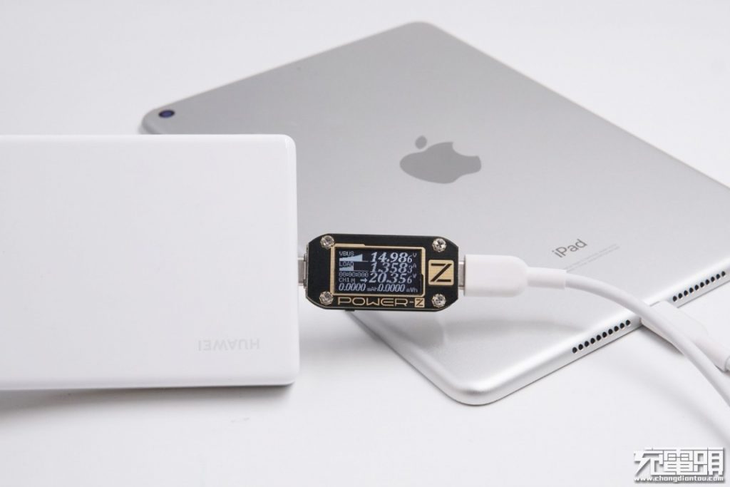

Charging the iPad mini5, we are getting 14.98V 1.35A 20.35W, under PD protocol.

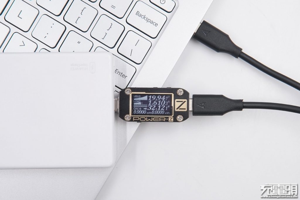

Charging the Xiaomi Notebook Air, we are getting 19.94V 1.61A 32.12W, under PD protocol.

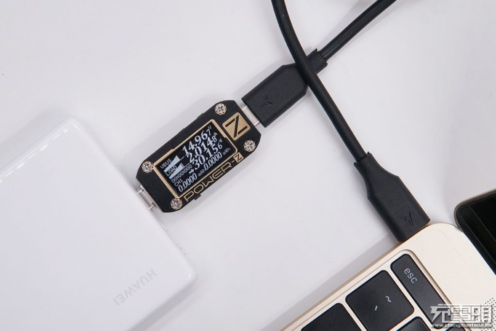

Charging the Apple MacBook, we are getting 14.96V 2.01A 30.15W, under PD protocol.

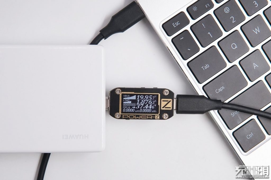

Charging the MacBook Pro 13.3-inch, we are getting 19.95V 1.94A 38.81W, under PD protocol.

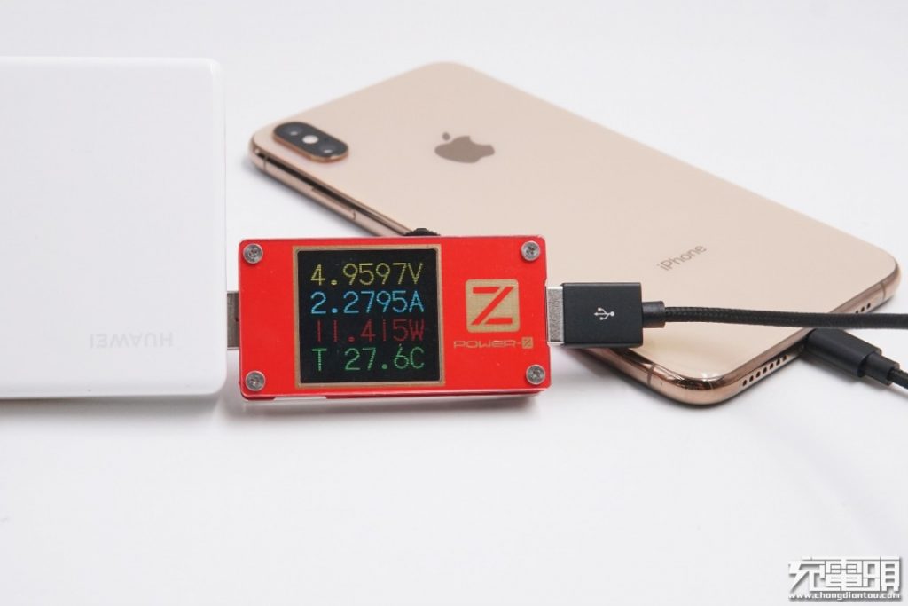

2) USB-A output
Phones

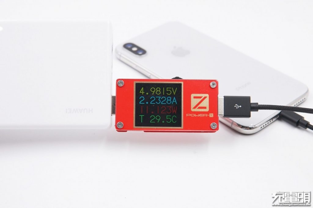

Use the USB-A port to charge the iPhone XS Max, we are getting 4.95V 2.27A 11.41W, under Apple 2.4A protocol.

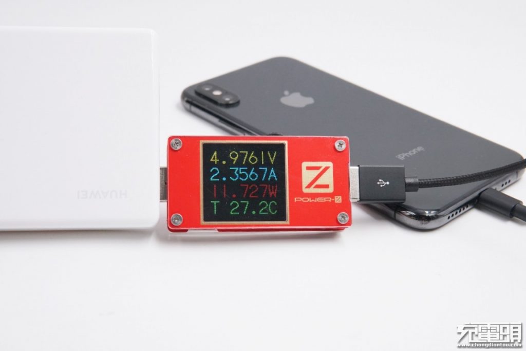

Use the USB-A port to charge the iPhone XS, we are getting 4.97V 2.35A 11.72W, under Apple 2.4A protocol.

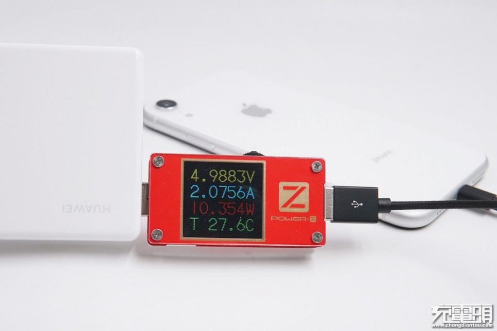

Use the USB-A port to charge the iPhone XR, we are getting 4.98V 2.07A 10.35W, under Apple 2.4A protocol.

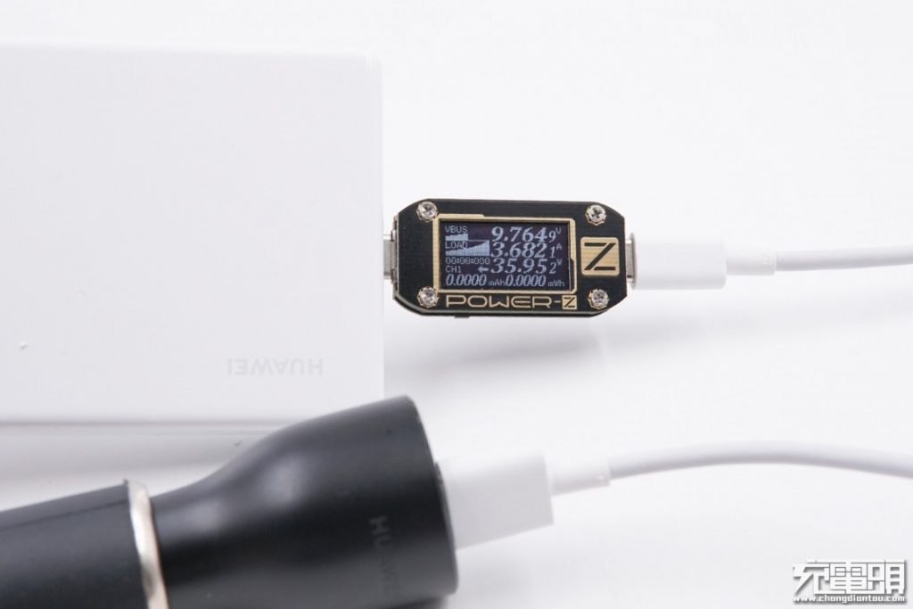

Use the USB-A port to charge the Huawei Mate 20 Pro, we are getting 9.66V 3.95A 38.18W, under 40W SCP protocol.

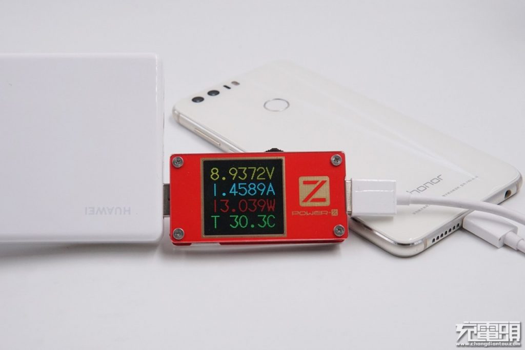

Use the USB-A port to charge the Honor 8, we are getting 8.93V 1.45A 13.03W, under FCP protocol.

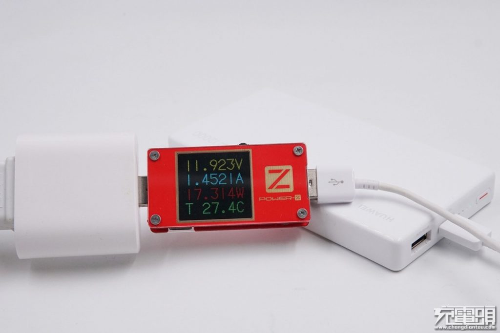

Use the USB-A port to charge the Mi9, we are getting 9.39V 1.83A 17.27W, under QC protocol.

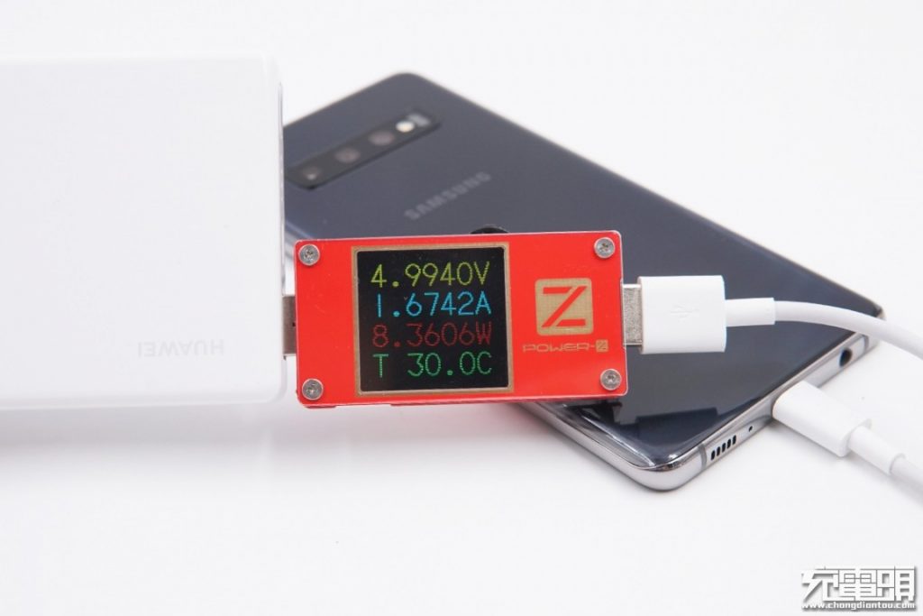

Charging the Samsung Galaxy S10+, we are getting 4.99V 1.67A 8.36W, under normal charging speed.

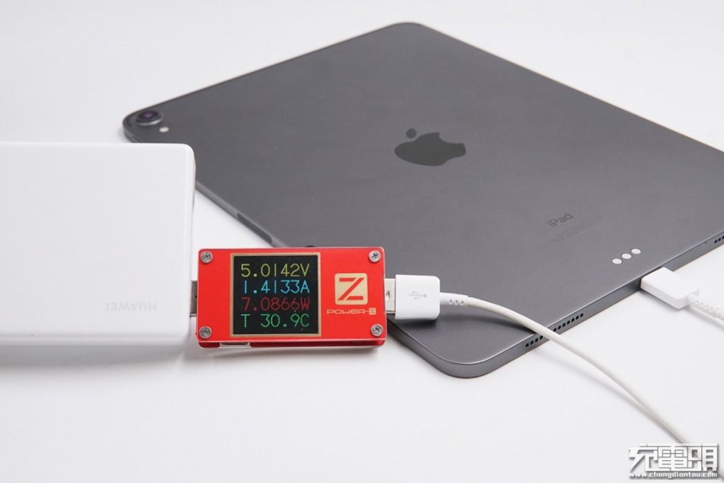

Use the USB-A port to charge the iPad Pro 11-inch, we are getting 5.01V 1.41A 7.08W, under normal charging speed.

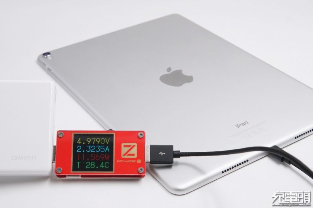

Use the USB-A port to charge the iPad Pro 10.5-inch, we are getting 4.97V 2.32A 11.56W, under Apple 2.4A protocol.

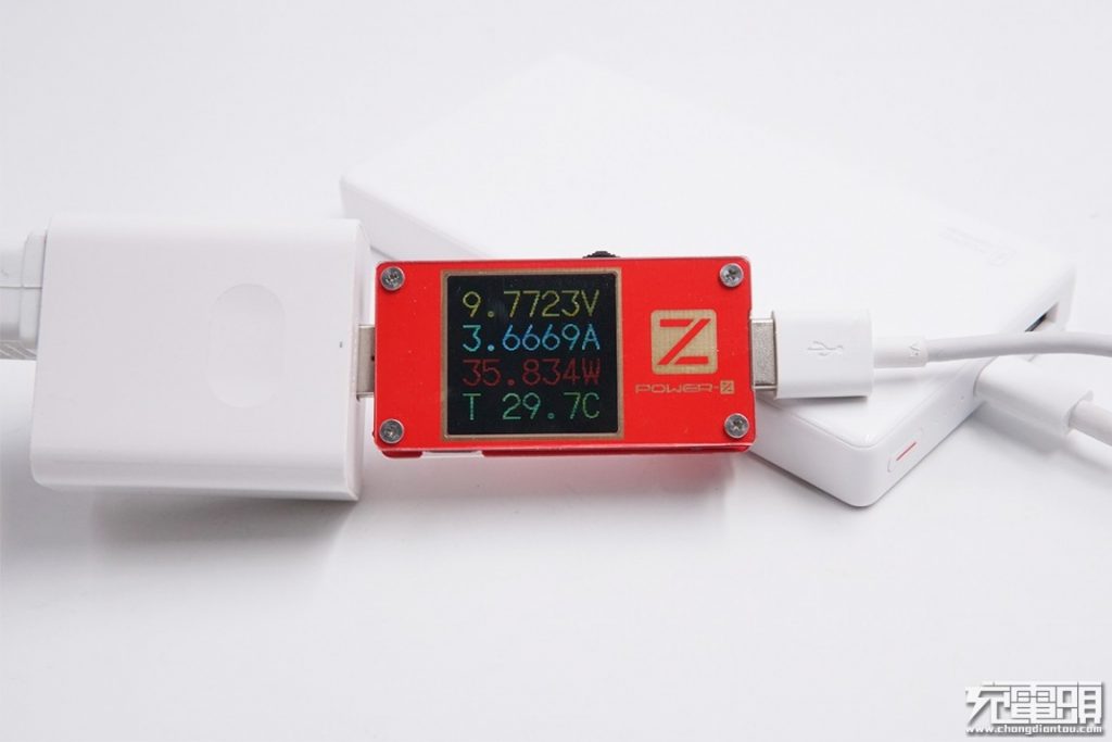

3) USB-C input
USB-C chargers

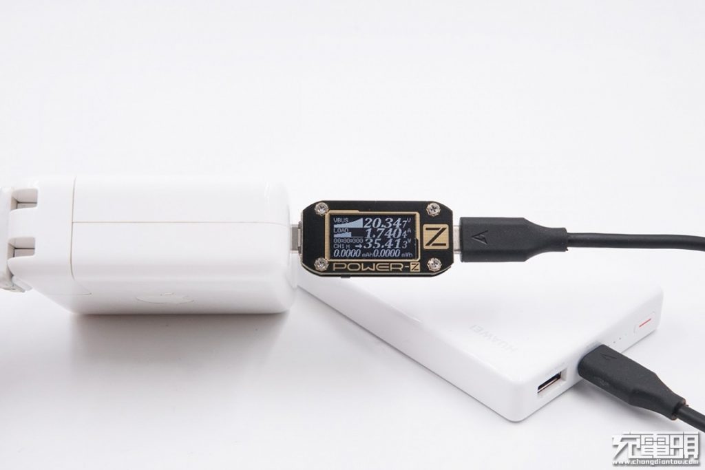

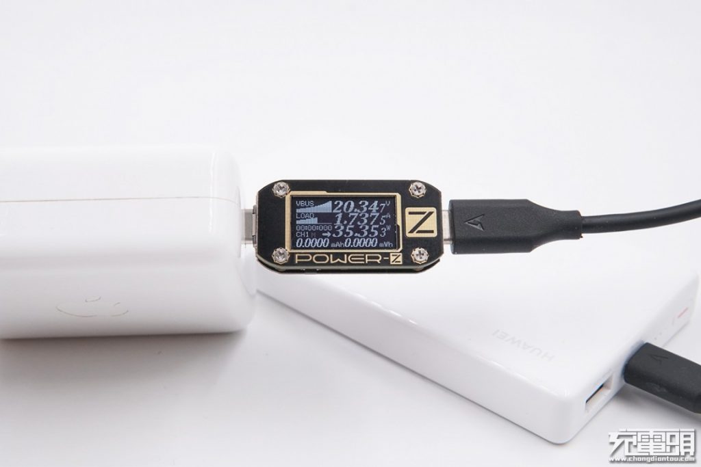

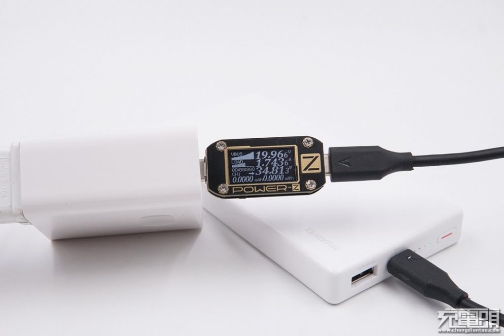

Using the Apple 18W PD charger (A1695) to charge the Huawei 40W SCP power bank, we are getting 9.01V 1.78A 16.1W, under PD protocol.

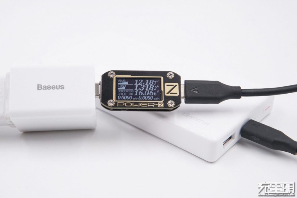

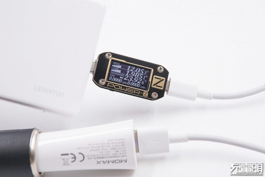

Using the Baseus TC-075PQ charger to charge the Huawei 40W SCP power bank, we are getting 12.18V 1.31A 16.06W, under PD protocol.

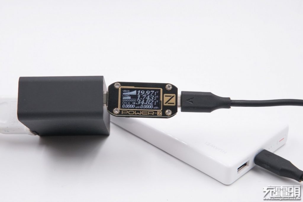

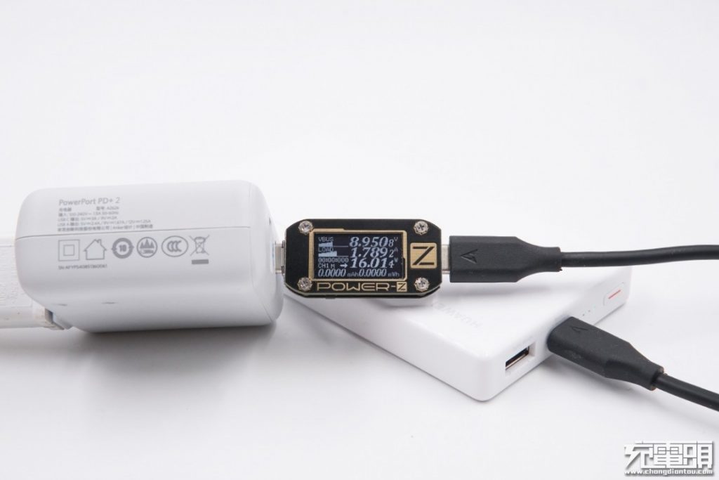

Using the USB-C port of the Anker 33W PowerPort PD+2 charger (A2626) to charge the Huawei 40W SCP power bank, we are getting 8.95V 1.78A 16.01W, under PD protocol.

Using the Anker PowerPort Atom PD 1 charger (A2017) to charge the Huawei 40W SCP power bank, we are getting 19.88V 1.28A 25.49W, under PD protocol.

Using the ZMI HA832 charger to charge the Huawei 40W SCP power bank, we are getting 19.99V 1.74A 34.83W, under PD protocol.

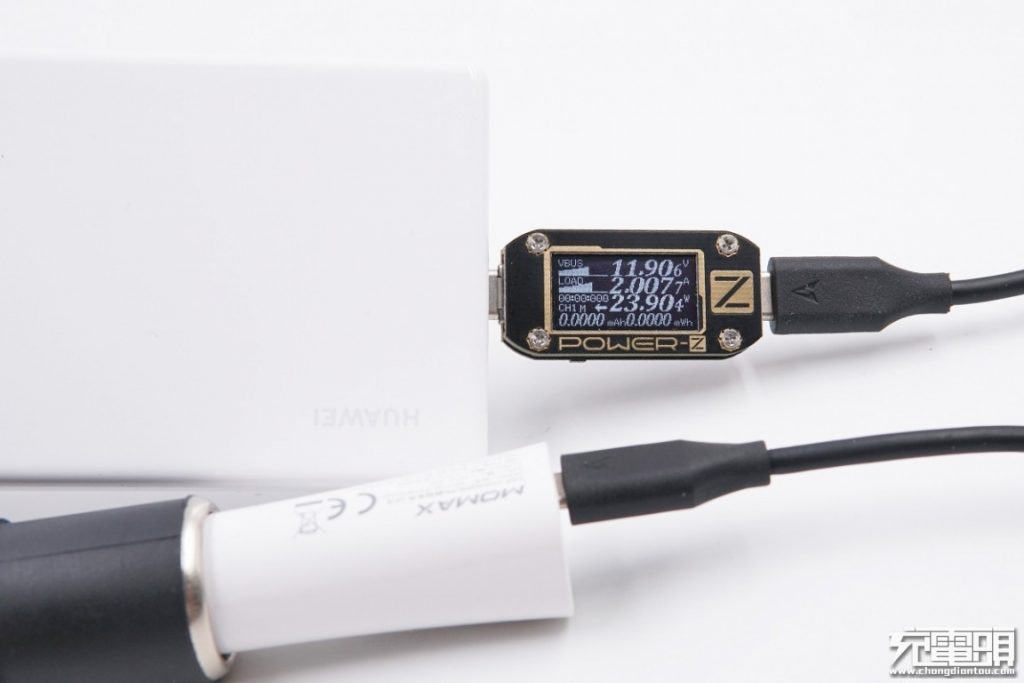

Using the USB-C port of the MOMAX ASCC54-P27W12+Q3 car charger to charge the Huawei 40W SCP power bank, we are getting 11.9V 2A 23.9W, under PD protocol.

The Huawei 40W SCP power bank supports dual-port simultaneous output, but the output voltage will be locked at 5V.
