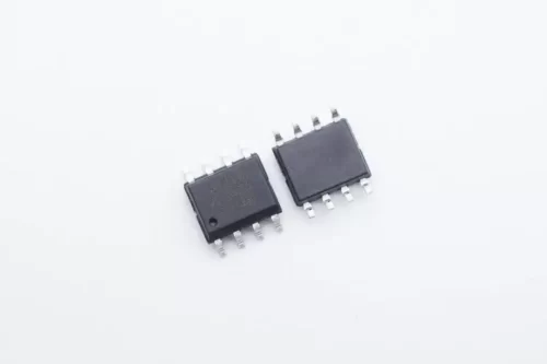

JD6610B Overview
The JD6610B is a simplified yet highly efficient fast-charging protocol controller supporting a 3A output current. It is compatible with USB PD 3.1 SPR and PPS, along with Huawei’s FCP and SCP fast-charging protocols. Additionally, it supports AFC and Qualcomm QC 2.0/3.0/3+ standards, making it suitable for next-generation USB-C charging applications.
JD6610B: A Simplified USB-PD PPS Fast-Charging Protocol Controller-Chargerlab
This chip includes intelligent plug-in detection, monitoring the USB-C port’s insertion and removal status. It supports a VBUS voltage range of 5V to 12V and provides a programmable 9V Prog voltage for flexible power output. The JD6610B also integrates USB D+/D- data line detection, enabling dynamic voltage adjustment based on connected devices, with an adjustable output range from 3.6V to 12V.
For precision power applications, the JD6610B supports CV (Constant Voltage) mode with a reference voltage of 1.24V, ensuring stable output for high-accuracy power management. The chip adopts a compact SOP-8L package, making it ideal for space-constrained applications.
Additionally, the JD6610B is fully compatible with Apple 2.4A charging and BC1.2 identification. Its multi-protocol configuration makes it a versatile solution for multi-port and multi-device charging applications, providing an efficient and flexible power solution.
