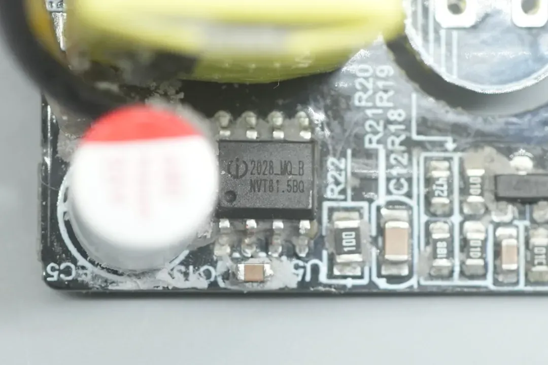

Injoinic is driving the next wave of high-density power design with the launch of the IP2028_MQ—a compact, high-performance synchronous rectification (SR) controller that integrates a 100V/10mΩ MOSFET directly into the chip. Designed for the multi-protocol era, it is the ideal choice for developers looking to build smaller, faster, and more efficient chargers for smartphones and laptops.
Injoinic’s New IP2028_MQ, The All-in-One Powerhouse for Synchronous Rectification-Chargerlab
By merging control logic with a low-resistance power MOSFET, Injoinic eliminates the clutter of discrete secondary-side components. Whether operating in CCM, DCM, QR, or ZVS modes, the chip intelligently adapts to optimize timing, thanks to its high-precision VDS slope detection. With a -30mV fast turn-off threshold and a 30ns delay, the chip minimizes switching waste, ensuring peak efficiency even in high-load scenarios. Featuring a 3.3V–28V input range and 0V startup, it’s built to simplify your power path, reduce BOM costs, and free up precious PCB space.
The industry is moving toward "small and powerful," and the IP2028_MQ is designed to lead that shift. By streamlining secondary-side implementation, Injoinic is helping manufacturers deliver more reliable, energy-efficient products that pack more power into smaller, more travel-friendly designs.
