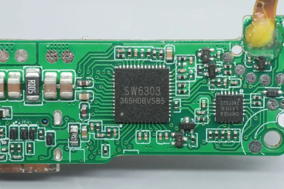

As high-power laptop charging becomes the norm, power banks are getting bigger and more complex. Usually, that means cramming a board full of separate controllers, protocol chips, and drivers. iSmartWare is changing the game with the SW6303, a new three-port SoC that handles everything from bidirectional buck-boost control to power management and display driving in a single QFN52 chip. Whether you are building a 100W flagship power bank or a portable storage station, this chip gives you the density and compatibility you need without the design headache.

iSmartWare has essentially killed off the need for bulky, discrete power bank designs. By rolling five critical functions into one chip, the SW6303 helps engineers slash BOM costs, reduce thermal buildup, and save precious space. It’s the ultimate high-density core for anyone looking to build the next generation of 100W-class mobile energy products.
