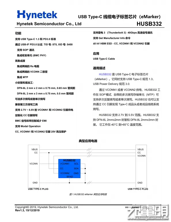

Hynetek HUSB332
The Hynetek HUSB332 is a high-voltage E-Marker chip developed by Hynetek Semiconductor Co., Ltd. It has received USB-IF certification (TID: 875) and incorporates a series of performance enhancements and reliability improvements based on extensive market feedback. Notably, the CC, VCONN1, and VCONN2 pins support up to 25V overvoltage protection. Additionally, it supports Thunderbolt 3 40Gbps high-speed data communication, the Modal Operation command, and the Get Manufacturer Info command. The chip also features options for multiple reprogramming and one-time programmable (OTP) lock functions.

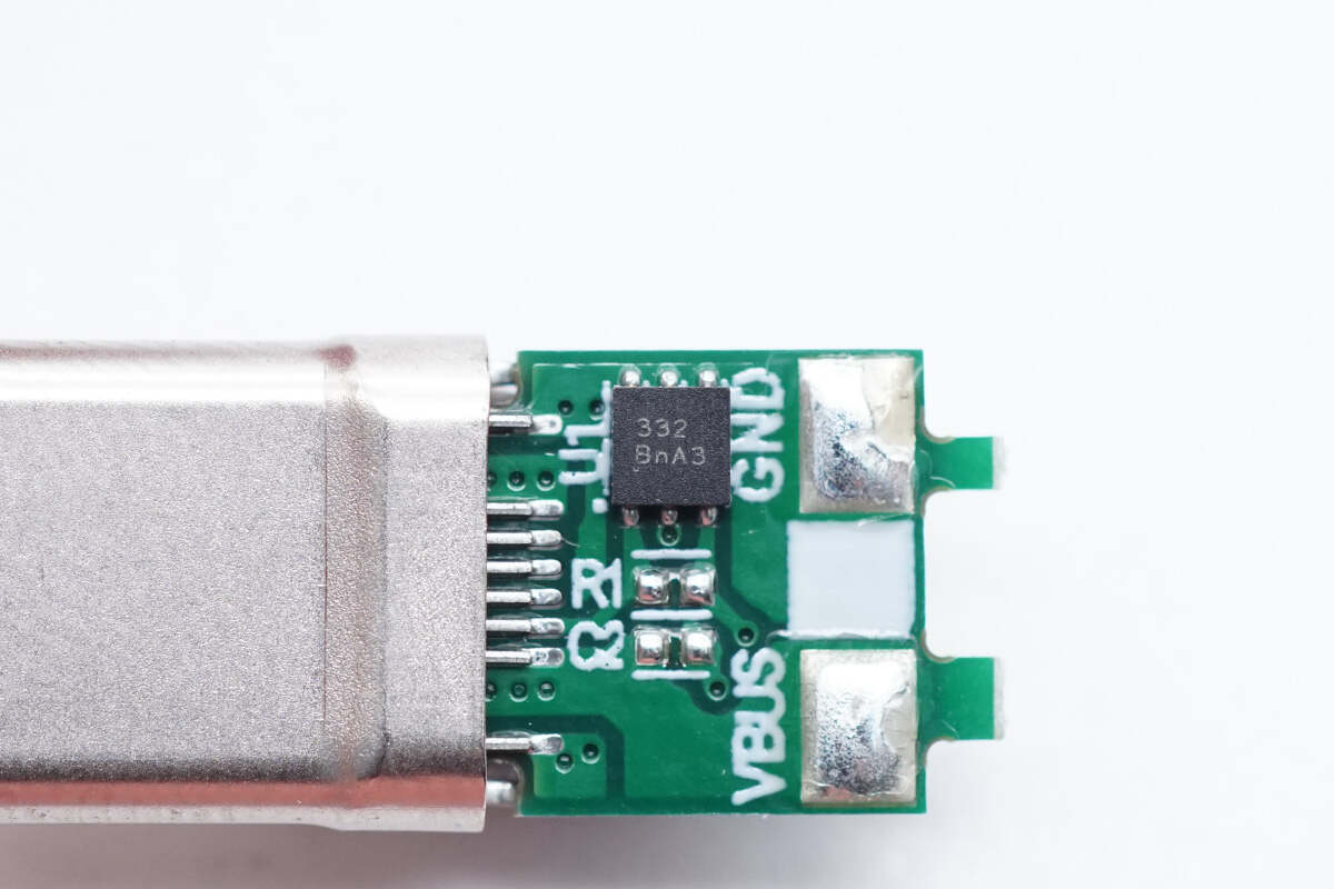

Hynetek HUSB332: A High-Voltage E-Marker Chip for USB-C Cables-Chargerlab
Designed to accommodate various USB application environments, the HUSB332 can be integrated into USB 2.0 (5A), USB 3.0, USB 3.1, USB 3.2, and 40Gbps high-speed cables. By eliminating decoupling capacitors on the VCONN1 and VCONN2 pins, it enables a zero-external-component design, simplifying system implementation and reducing overall costs.

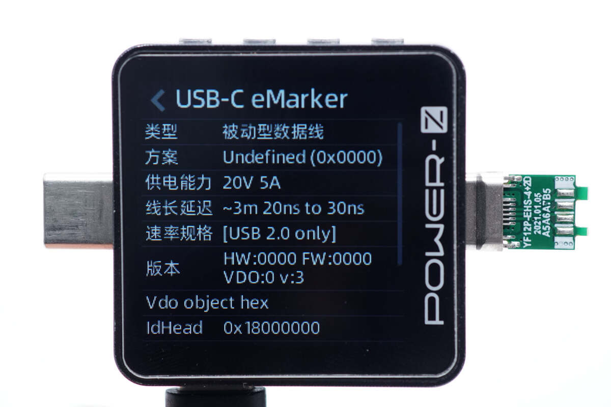

ChargerLAB POWER-Z KM003C shows it supports USB2.0, has a power transmission capacity of 20V5A, and supports 100W PD fast charging.

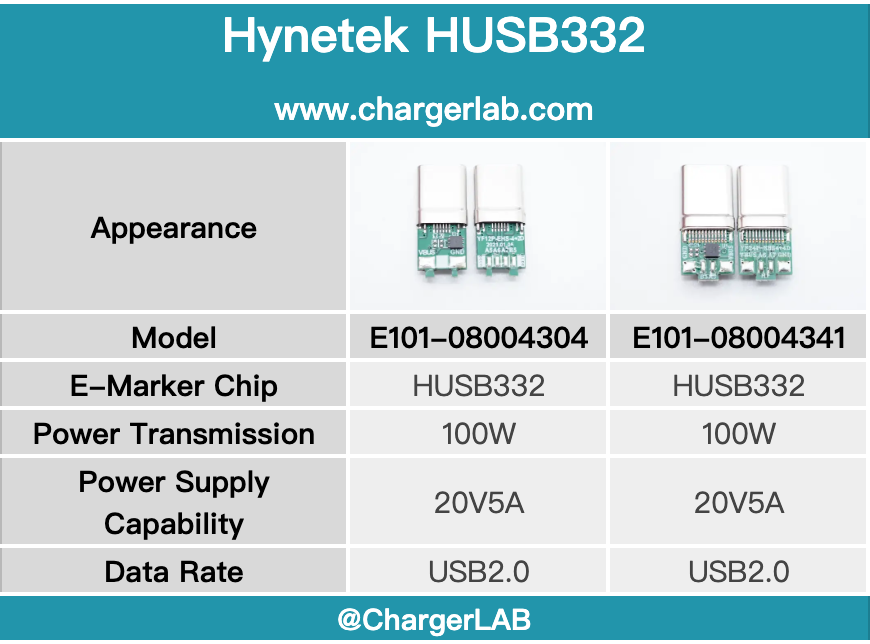

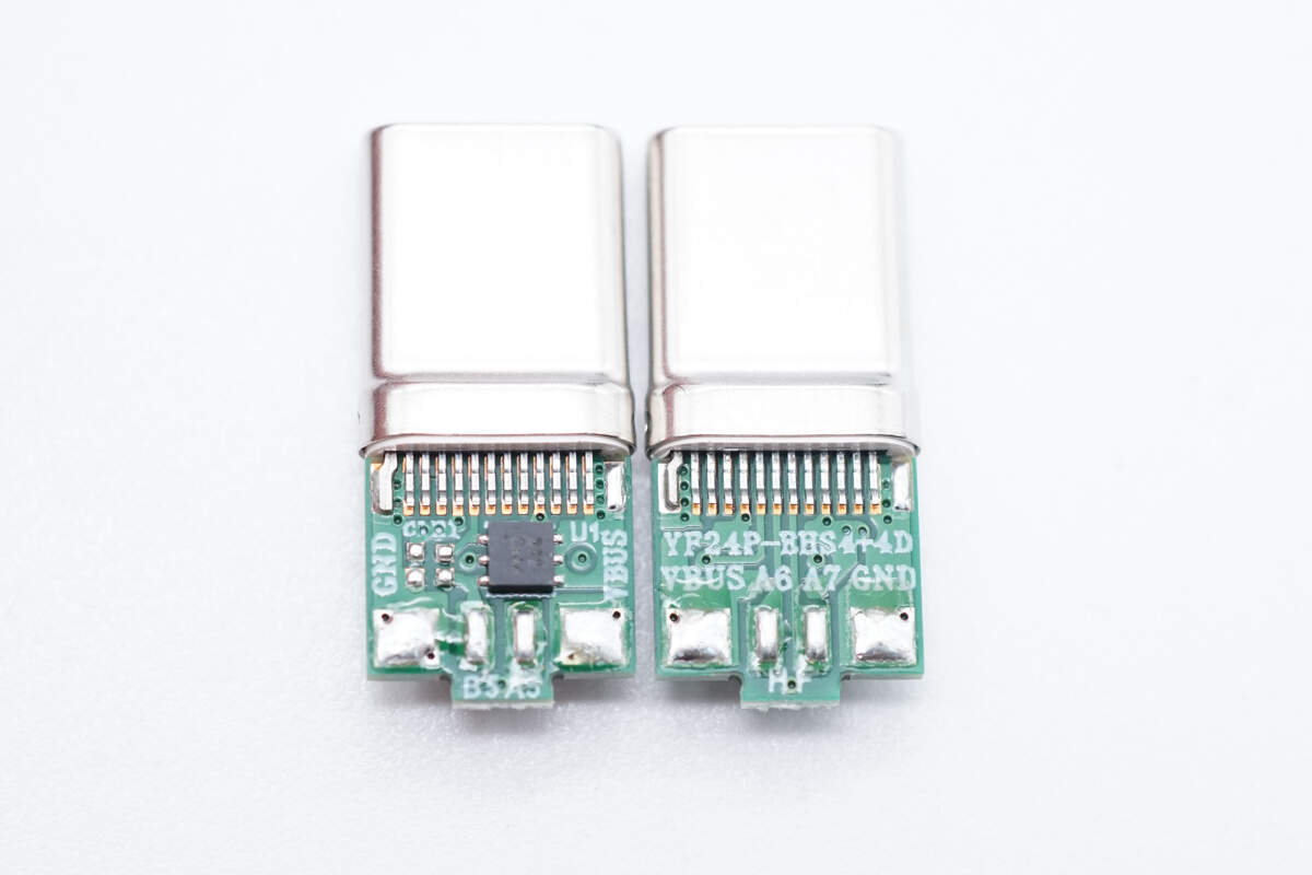

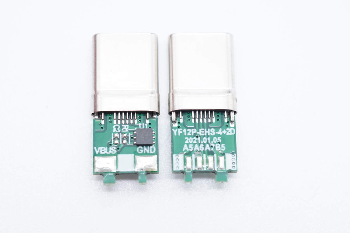

Available Solutions Featuring HUSB332
E101-08004304
  • E-Marker Chip: HUSB332
  • Power Transmission: 100W
  • Power Supply Capability: 20V/5A
  • Data Rate: USB 2.0
E101-08004341
