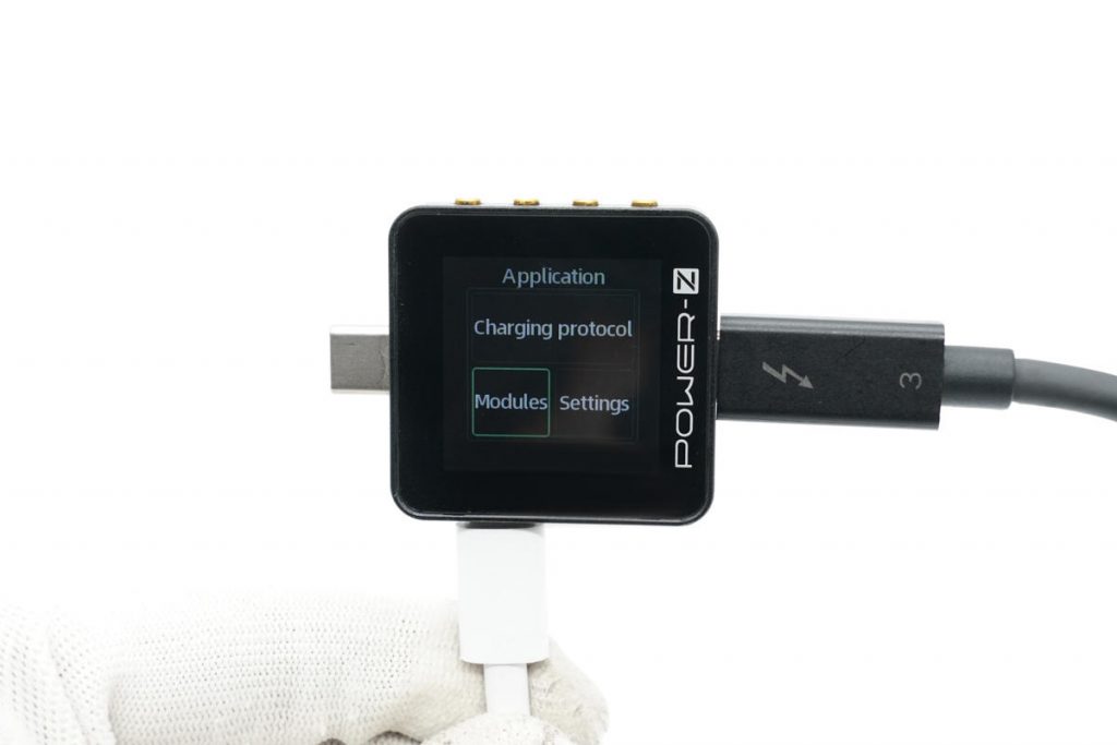

On the Application Menu, press the "Confirm" button on the right to select the "Modules", and then press the "Confirm" button again.

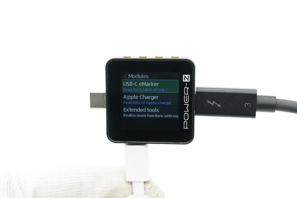

After entering the "Modules", the first item, "USB-C eMarker, Read the E-label of USB-C", will be selected automatically, and then press the "Confirm" button.

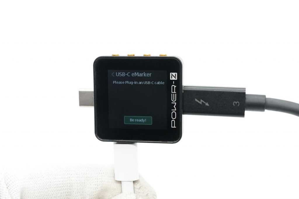

Then the display shows that you should plug in the USB-C cable. And after the KT002C is connected to the cable, you should press the "Confirm" button again.

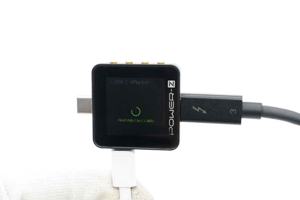

The tester is reading the information and parameters of the cable.

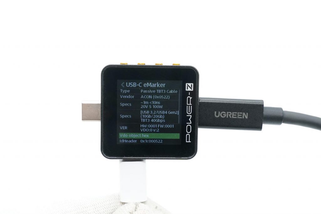

The KM002C shows that this is a passive Thunderbolt (TBT) 3 cable that supports 20V100W and the speed of 40Gbps of data transmission.

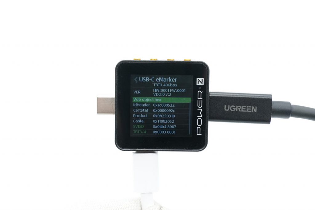

At this moment, press the rightmost "Right" button to see more information about the cable.
