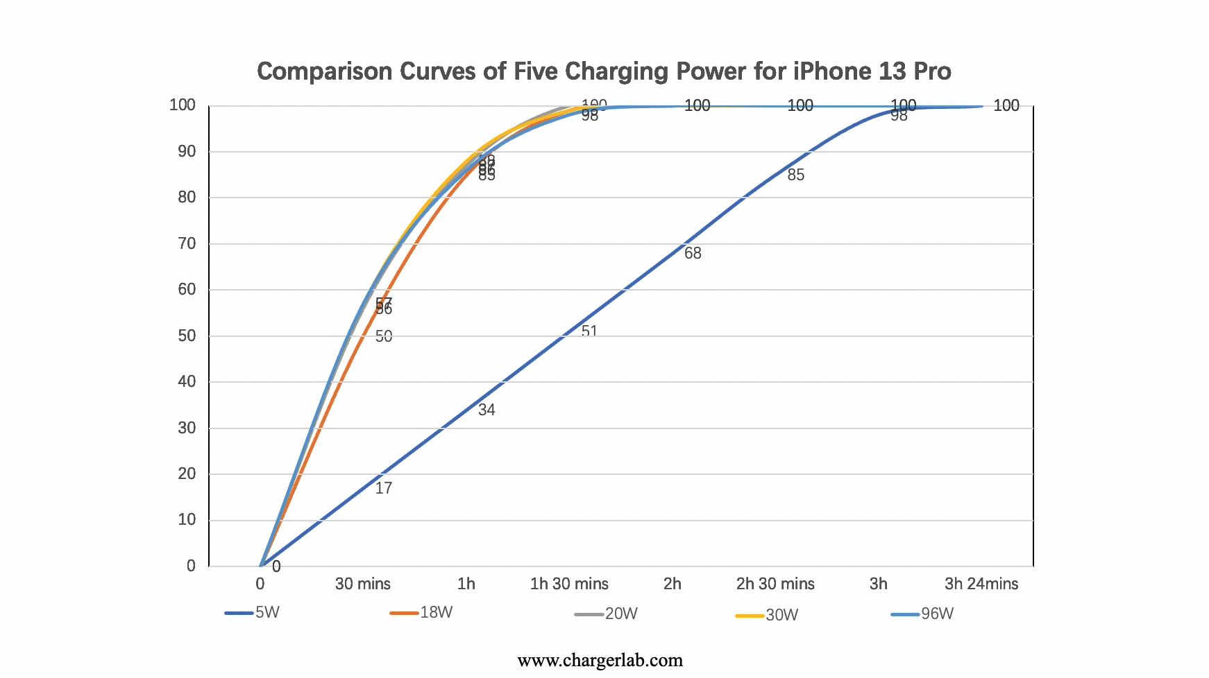

Today, we will show you the charging performance of the iPhone 13 Pro under different charging powers.
We picked up five different Apple chargers, which are 5W, 18W, 20W, 30W, 96W, respectively.
And we will test them one by one.

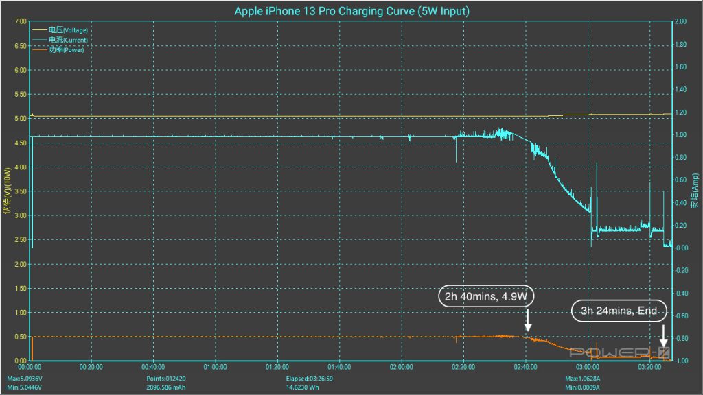

5W
Charging Curve Test of Apple iPhone 13 Pro (5W - 96W Input)-Chargerlab

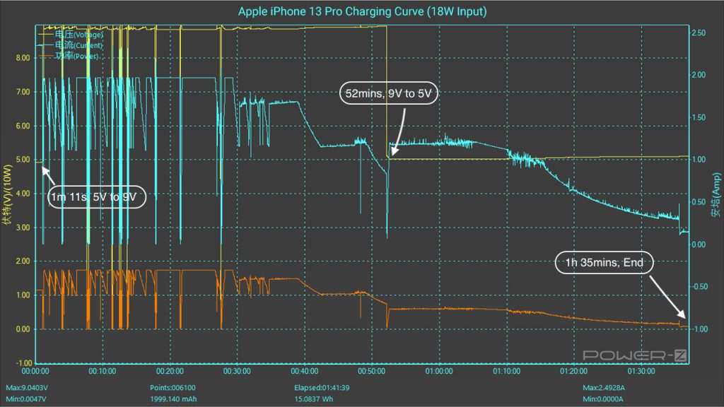

18W

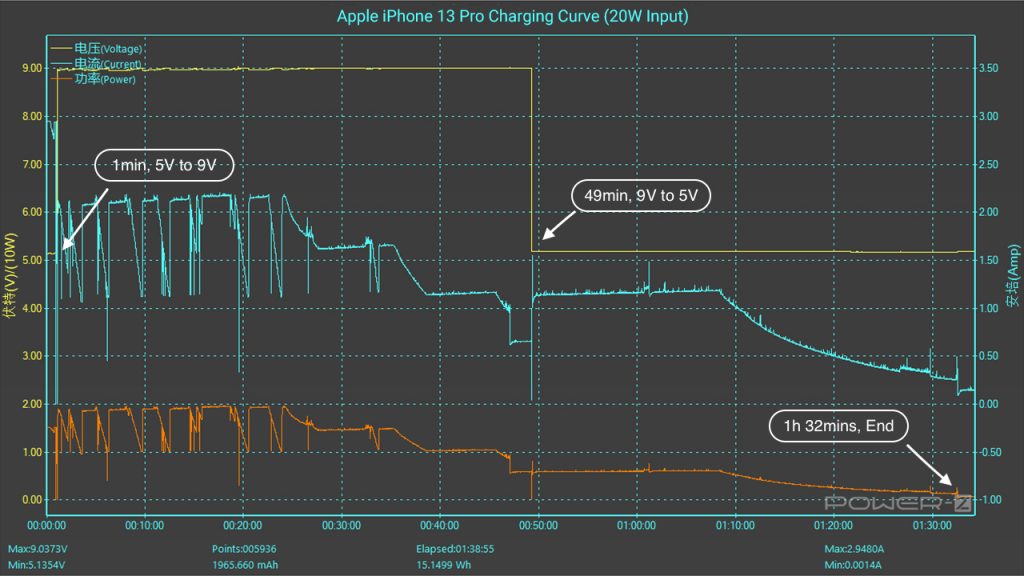

20W

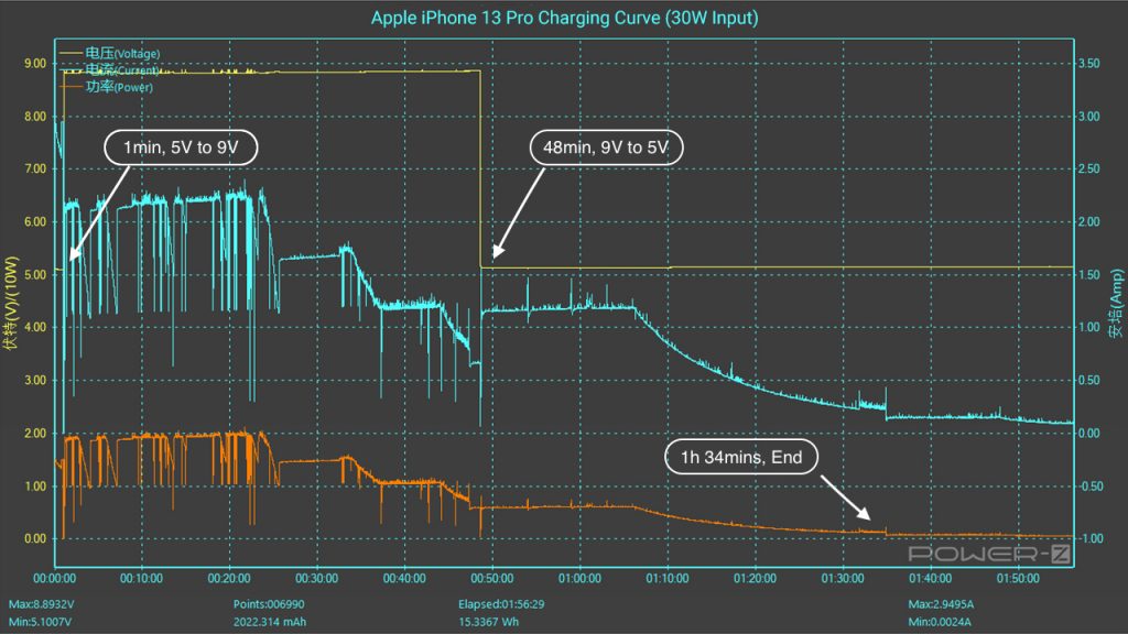

30W

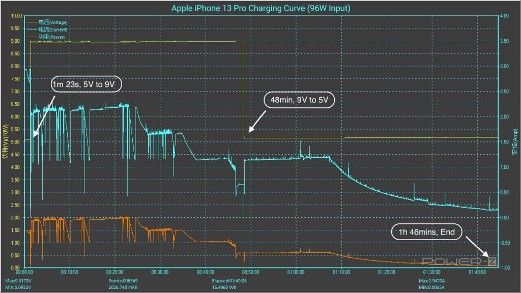

96W
