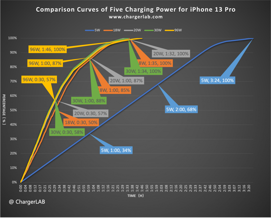

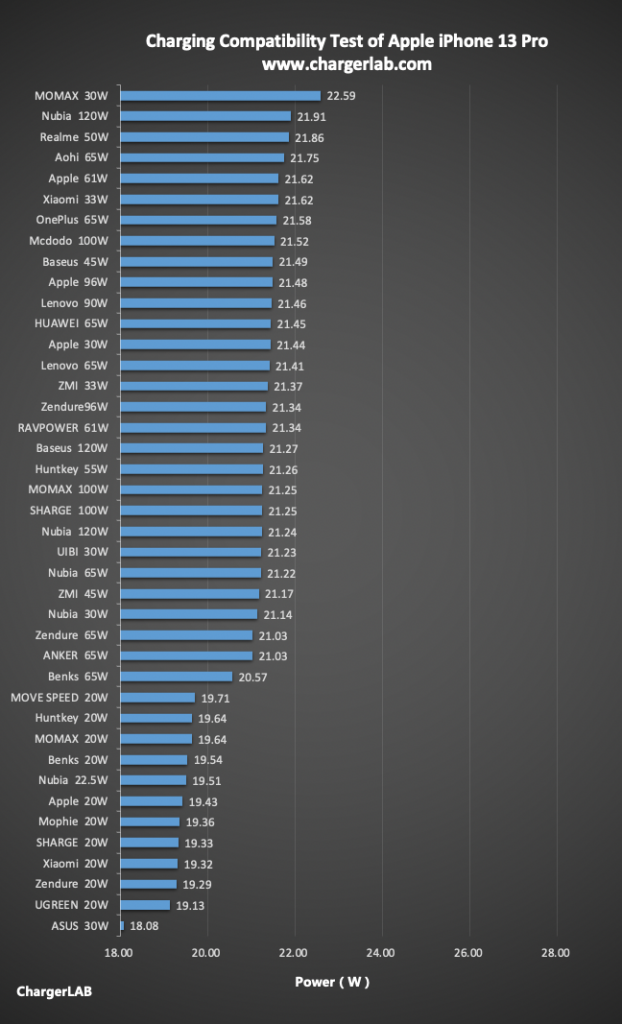

Since we published the charging compatibility test of Apple iPhone 13 Pro Max, many people are asking to see the same tests of other models, as well as the charts.
So, we will release the compatibility test and its detailed data of all the models, including iPhone 13 mini, iPhone 13, iPhone 13 Pro and iPhone 13 Pro Max.
Let's go.
Detailed data and charts | Charging Compatibility Test of Apple iPhone 13 Pro (20W-100W)-Chargerlab
Here is the comparison chart of different charging power for iPhone 13 Pro. We can see most of the 20W+ charger can perfectly support the fast charging. And this time, 20W charger only needs 1 hour and 32 mins to fully charged the iPhone 13 Pro. And the Apple 96W charger is a little bit slower.
