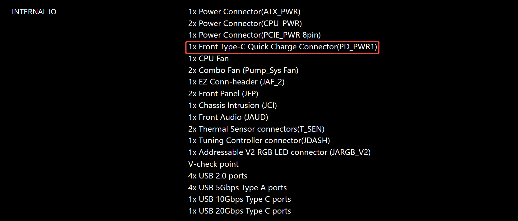

Today, we received a hands-on report from tech blogger "Fei Wei" confirming that the MSI MEG X870E GODLIKE motherboard features a dedicated front-panel Type-C fast charging header (PD_PWR1). This allows the front USB 3.2 port to deliver up to 60W Fast Charging.
