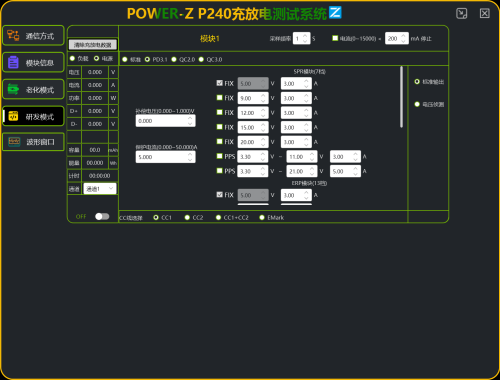

5.3 R&D Mode
ChargerLAB POWER-Z P240 Power Supply Manual Update - Automated Test Program-Chargerlab
The operation interface is consistent with the machine display.
Sampling Frequency: Set the data sampling rate.
Load/Power: Function toggle button.
OFF: Power switch.
CC Line Selection: Choose cable wiring configuration.
