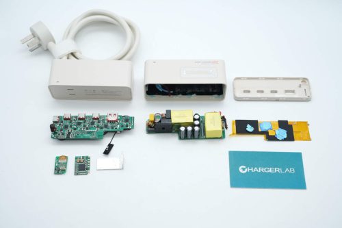

The casing can be opened along the seam, revealing the power module wrapped in high-temperature tape, with blue thermal gel filling the gap between the module and the housing.
Teardown of CANDYSIGN 160W CoCan Ultra-Chargerlab
The OLED infinite light column PCB is connected via wiring.
The FPC antenna is used for wireless communication.
The PCBA module is secured in place with clips.
The PCBA module is connected to the prongs via wiring.
Graphite thermal pads are applied inside the housing to enhance heat dissipation.
The entire PCBA module is wrapped with high-temperature tape.
The other side is coated with blue thermal gel.

The power PCB and the buck converter PCB are separated, connected by wiring.
The wires are soldered to the buck converter PCB to supply power.
The power PCB is fully wrapped in high-temperature tape for insulation.
After removing the tape, the gaps around components such as capacitors and the transformer are also filled with thermal gel.

Well, those are all components of the CANDYSIGN 160W CoCan Ultra.
Here is the component list of the CANDYSIGN 160W CoCan Ultra for your convenience.
It features a modular design that combines a power strip and a portable charger. It comes with a 1.5-meter power cord and built-in surge protection. The charger module includes four USB-A ports and one USB-C port, with a total output power of 160W, and supports automatic power distribution.
After taking it apart, we found that it consists of two PCBA modules: the power PCB and the buck PCB. The power PCB uses the DONGKE DK3601A PFC controller paired with the Innoscience INN700D140C GaN FET and SGKS KS06065D silicon carbide diode to form a PFC boost circuit. The AHB uses the DK8718AD GaN integrated chip, and synchronous rectification is achieved with two DK5V100R10VL in parallel.
The buck PCB uses five iSmartWare Technology SW3566H buck protocol chips combined with Eternal ET6440T MOSFETs, which are used for the four USB-C ports and the USB-A port. It also contains the Anlogic EF2M45LG48B FPGA chip and the ESPRESSIF WSP32-C3 wireless chip. The PCBA modules are enhanced with copper sheets and thermal pads to improve heat dissipation, insulated with high-temperature tape, and the solid capacitors are covered with heat-shrink tubing for insulation. Inside the enclosure, graphite thermal pads are applied, and gel is used to strengthen heat dissipation, ensuring stability during long-term operation.pplied, and gel is used to strengthen heat dissipation, ensuring stability during long-term operation.
