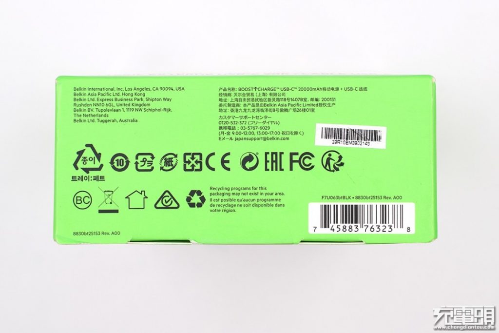

Belkin 30W BoostCharge Power Bank USB-C 20K Review-Chargerlab
Manufacturer's info and certifications.

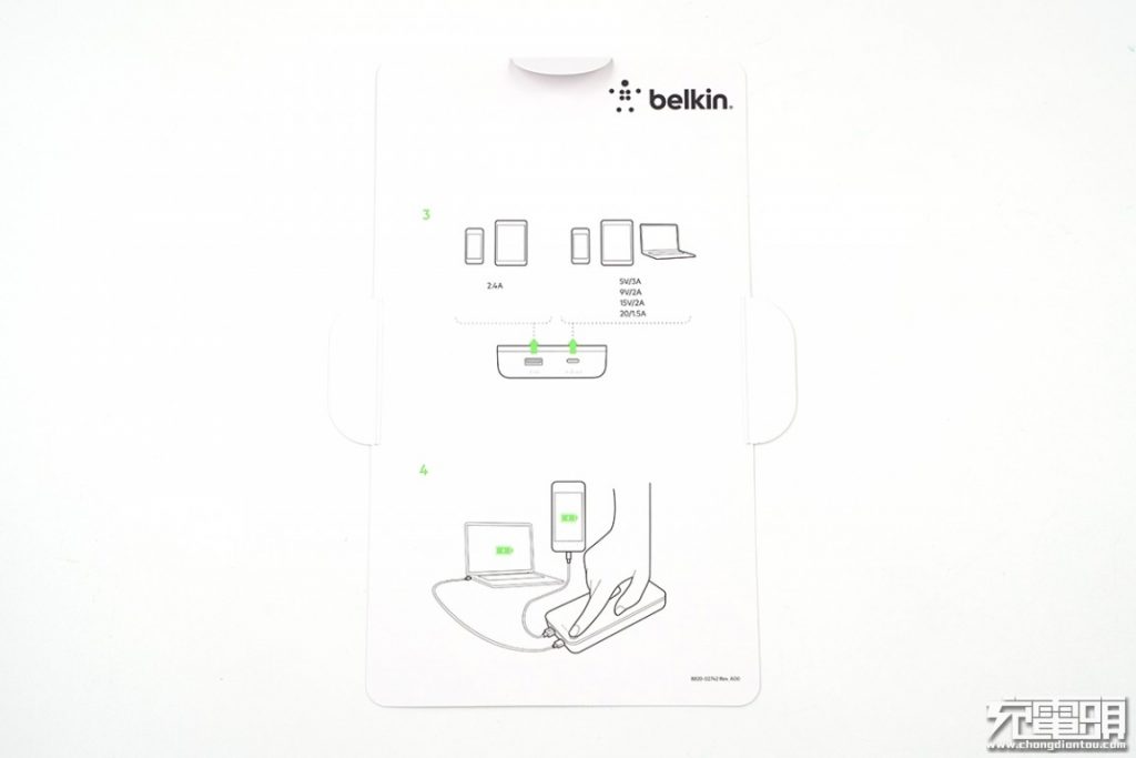

Slides open and we are greeted by a paper cover.
It is printed with a quick guide.

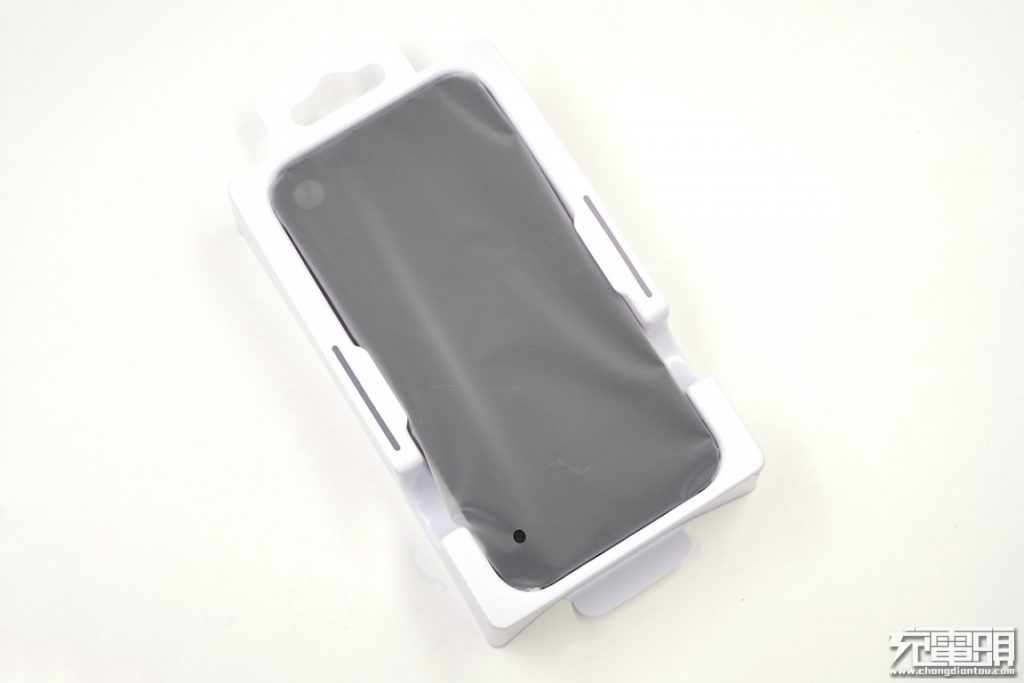

The power bank is wrapped in an anti-static bag and lays inside the tray.

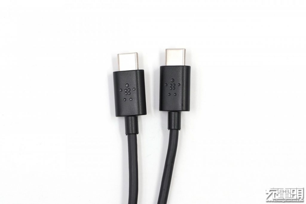

The included USB-C to USB-C cable.

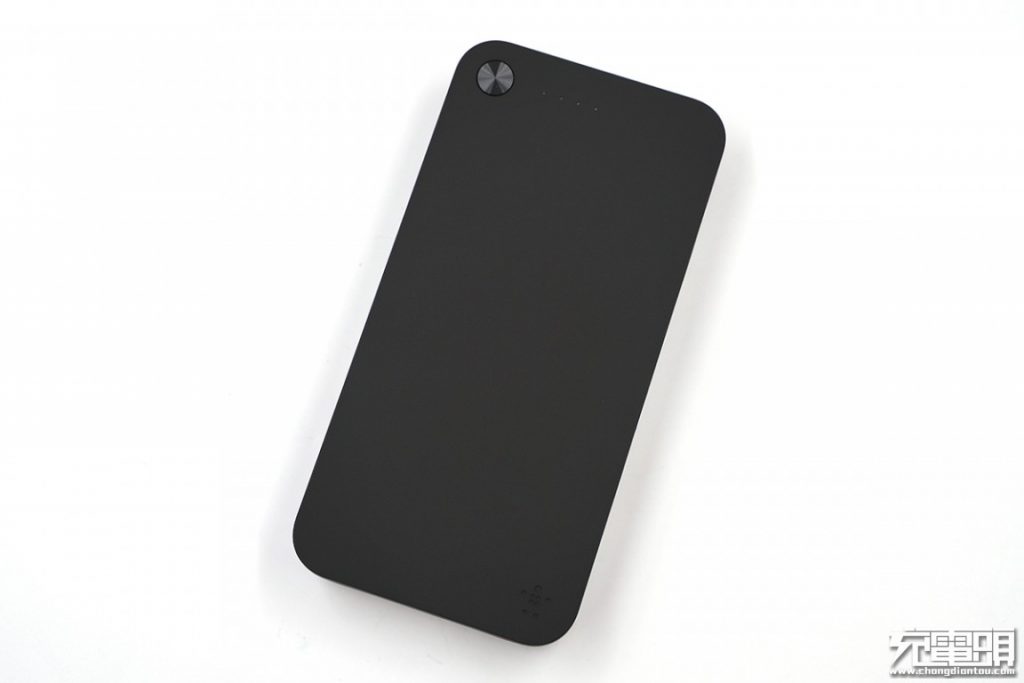

The power bank is made of plastic with a two-tone black-and-grey finish.
There is a power button, four LED indicators on the front, with a Belkin logo in the lower right corner.

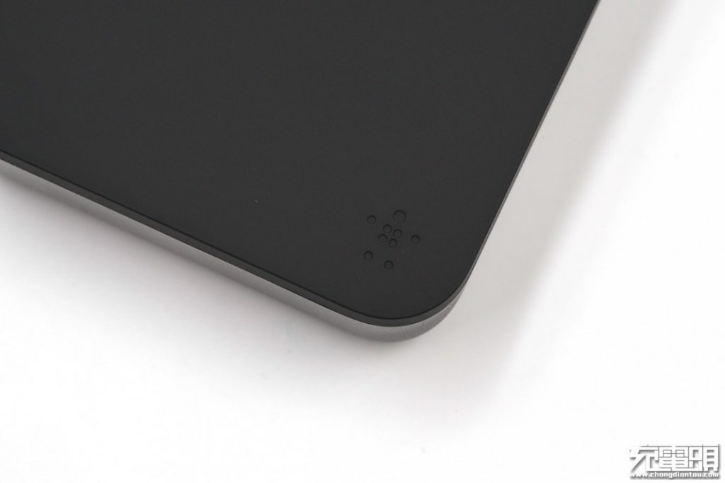

Close-up of the Belkin logo.

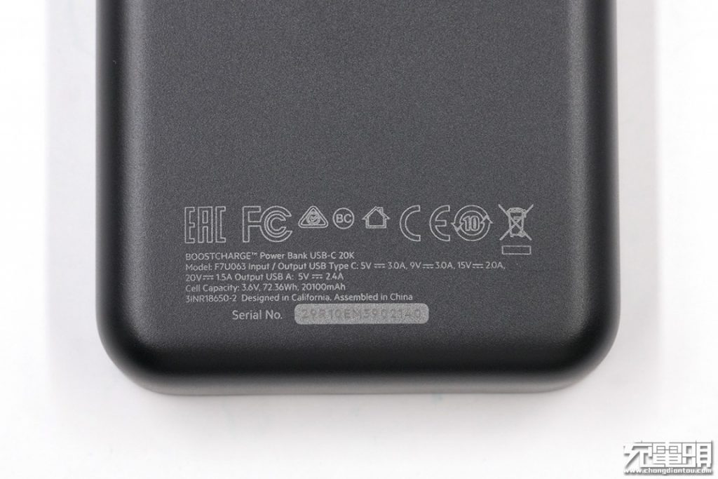

Specifications on the back.
Model: F7U063. USB-C input/output: 5V/3A, 9V/3A, 15V/2A, 20V/1.5A. USB-A output: 5V/2.4A. Cell capacity: 20100mAh, 72.36Wh (3.6V).

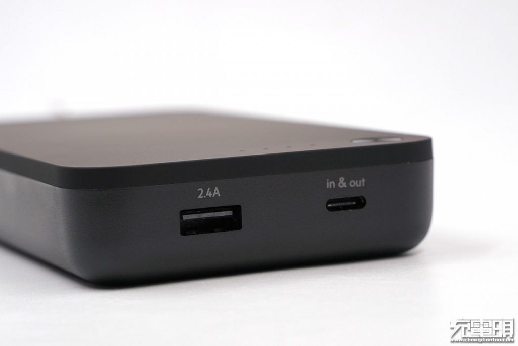

Close-up of the ports.

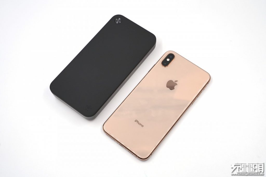

Compared to the iPhone XS Max.

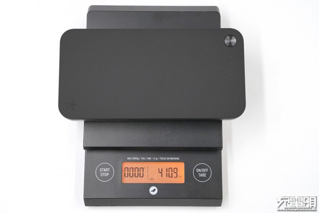

It weights 410.9g/14.5oz.

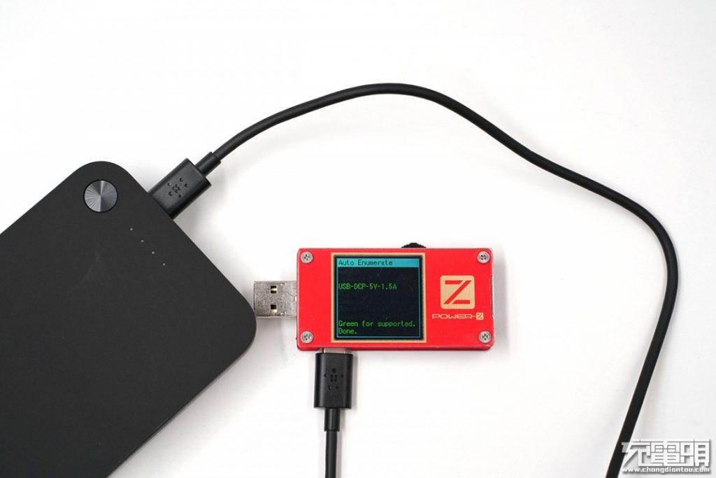

Using ChargerLAB Power-Z KT001 USB power tester, we know that its USB-A port supports Apple 2.4A protocol.

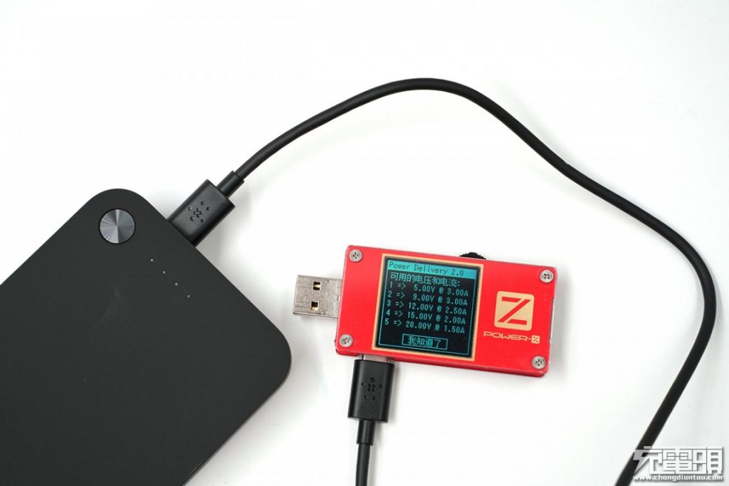

2. PDO information
PDO information reveals the USB-C port supports quick charging output in 5V/3A, 9V/3A, 12V/2.5A, 15V/2A, and 20V/1.5A.

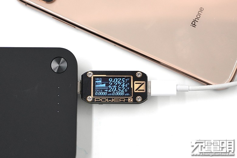

Using its USB-C port to charge the iPhone XS Max, we are getting 9.02V 2.27A 20.52W, under PD protocol.

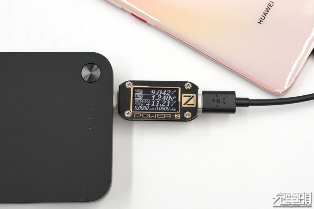

Charging the Huawei P30 Pro, we are getting 9.04V 1.32A 11.96W, under PD protocol.

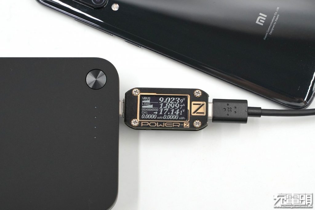

Charging the Xiaomi 9, we are getting 9.02V 1.89A 17.14W, under PD protocol.

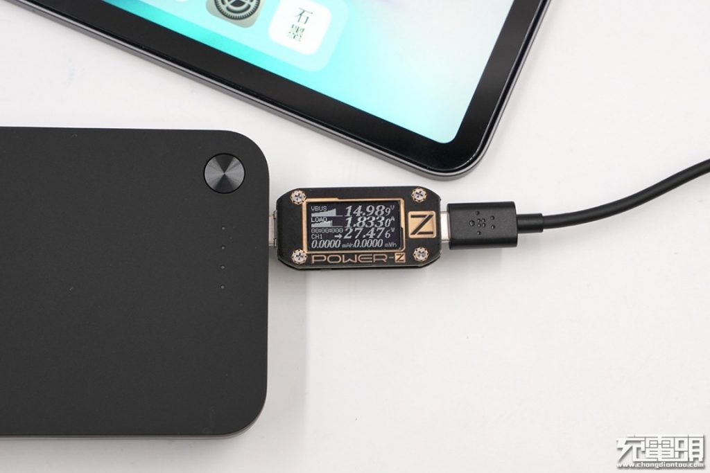

Charging the iPad Pro 11-inch, we are getting 14.98V 1.83A 27.47W, under PD protocol.

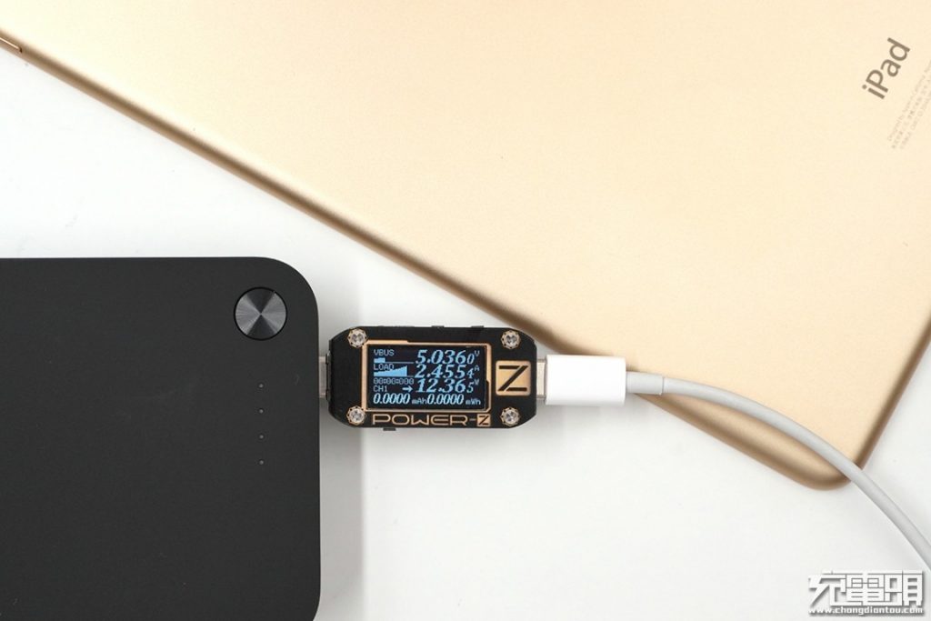

Charging the iPad Air2 which doesn't support PD, we are getting 5.03V 2.45A 12.36W, under Apple 2.4A protocol.

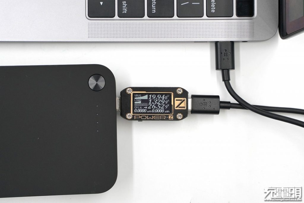

Charging the MacBook Pro 13.3-inch 2018, we are getting 19.94V 1.32A 26.52W, under PD protocol.

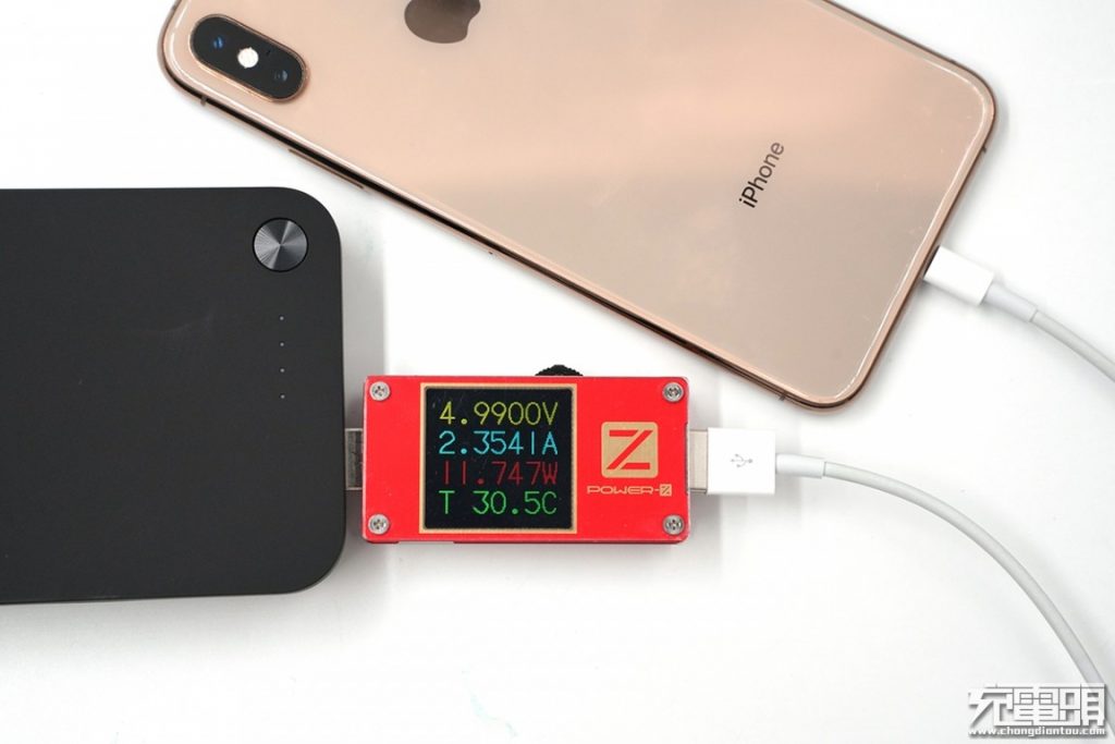

Using its USB-A port to charge the iPhone XS Max, we are getting 4.99V 2.35A 11.74W, under Apple 2.4A protocol.

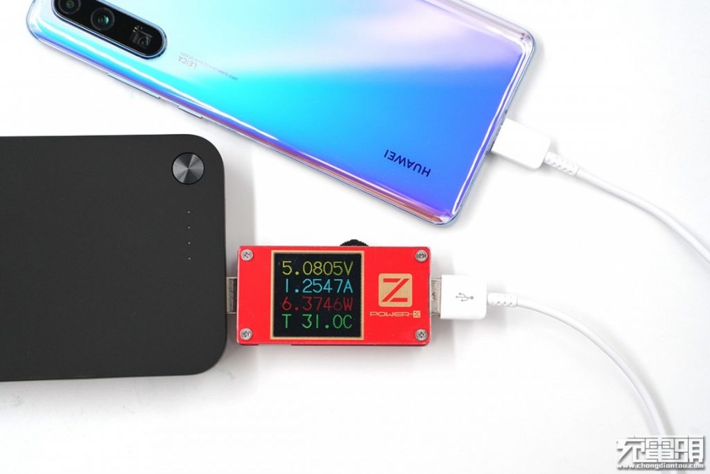

Charging the Huawei P30 Pro, we are getting 5.08V 1.25A 6.37W, under normal charging speed.

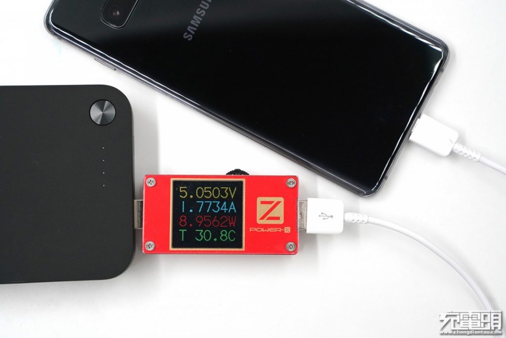

Charging the Samsung Galaxy S10+, we are getting 5.05V 1.77A 8.95W, under normal charging speed.

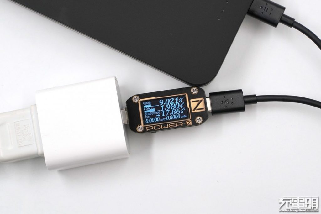

Using the Apple 18W PD charger (A1695) to charge the Belkin, we are getting 9.02V 1.98A 17.86W, under PD protocol.

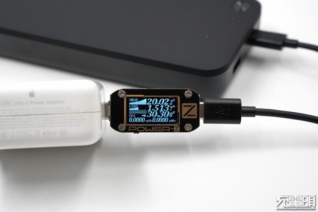

Using the Apple 30W USB PD charger (A1882) to charge the Belkin, we are getting 20.02V 1.51A 30.3W, under PD protocol.

Using the Anker 30W PD charger (A2014) to charge the Belkin, we are getting 20.06V 1.51A 30.33W, under PD protocol.
Using the Apple 61W USB PD charger (A1947) to charge the Belkin, we are getting 20.35V 1.51A 30.82W, under PD protocol.
Using the Xiaomi 90W PD charger to charge the Belkin, we are getting 20.04V 1.51A 30.32W, under PD protocol.

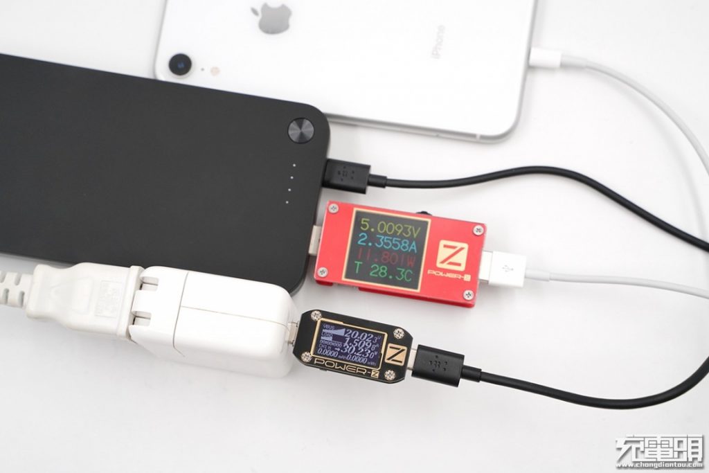

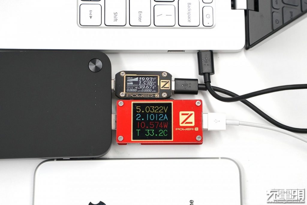

The Belkin can charge two devices simultaneously. As can be seen from the picture, the USB-C port is charging the Xiaomi Notebook Air, and the USB-A port is charging the iPhone XR with power output at 30.67W and 10.57W respectively. So it is indeed a 40W-max power bank. Impressive.
