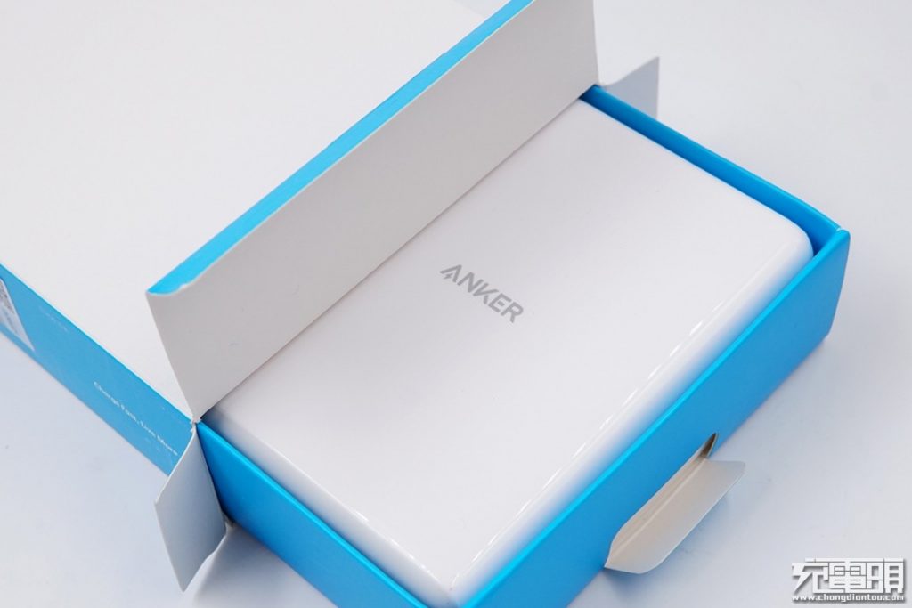

Classic ANKER package design featuring a clean white box with blue accents.

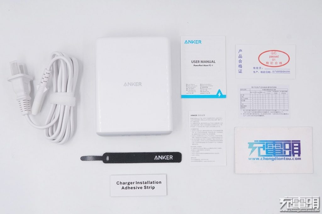

Anker PowerPort Atom PD 4 100W A2041 Hands-on Review-Chargerlab
Package contents: charger, figure-8 power cord, Velcro cable tie, foam tape, user manual, warranty card, qualification certificate, and list of hazardous substances in electronic products.

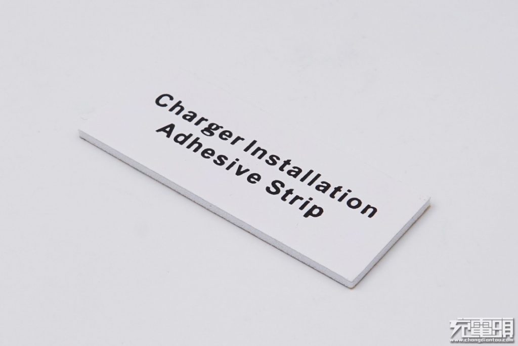

A foam tape to position the charger on the desktop or on the wall.

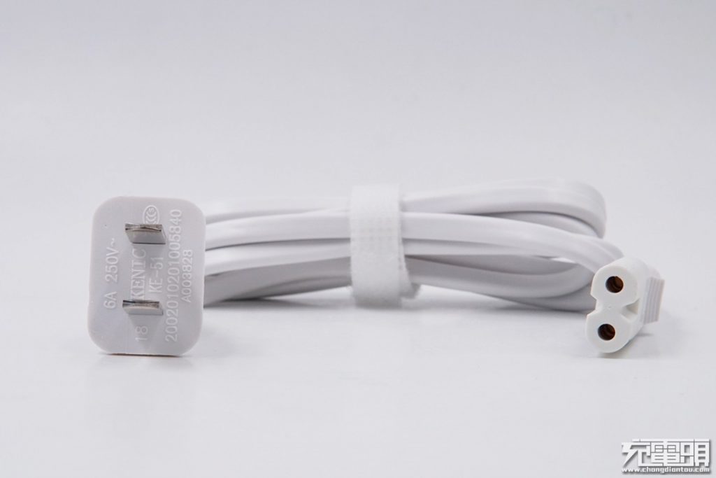

A high quality figure-8 power cord.

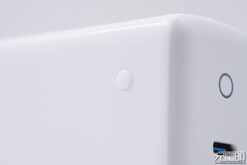

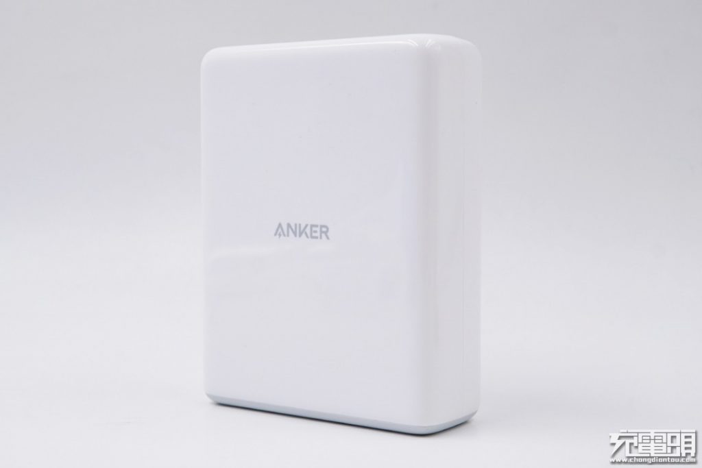

The ANKER PowerPort Atom PD 4 100W charger is made of flame-retardant plastic with glossy piano paint process, offering a delicate touch.
Rounded corners bring nice hand-feel.

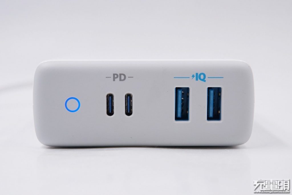

The output panel is light gray with a matte finish. It has 2 USB-C ports, 2 USB-A ports, commonly known as 2A2C configuration. They are all in signature Anker blue color with protocol lettering on the top. There is a ring-shaped power indicator on the left, which emits blue light when the power is turned on.
Four ports plugged at the same time.

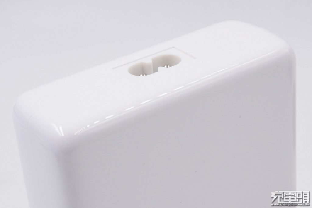

Figure-8 power input port.

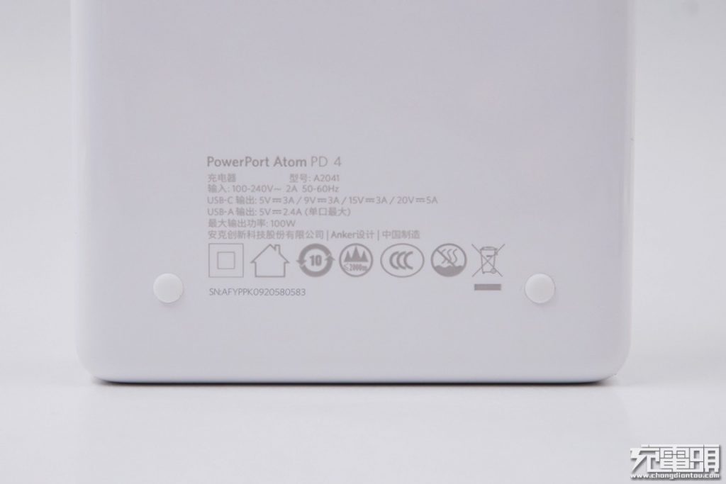

Specifications. Input: 100-240V~ 2A 50-60Hz. USB-C output: 5V/3A、9V/3A、15V/3A、20V/5A. USB-A output: 5V/2.4A (max). Max output: 100W. Designed by ANKER. Made in China.

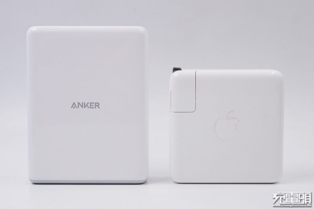

Compared to the Apple 87W PD charger.

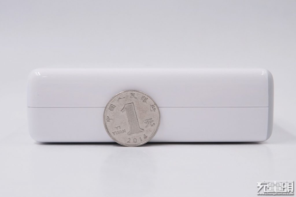

Compared to a 1 Yuan RMB coin.

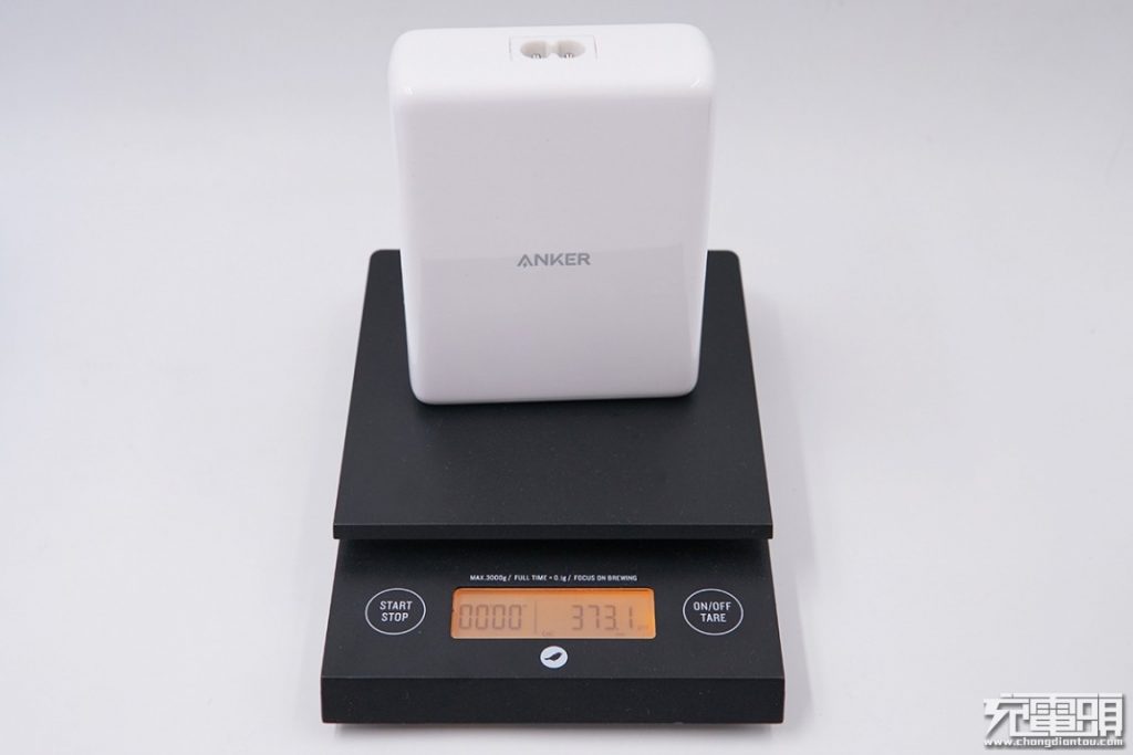

It weighs 373.1g (13.2oz).

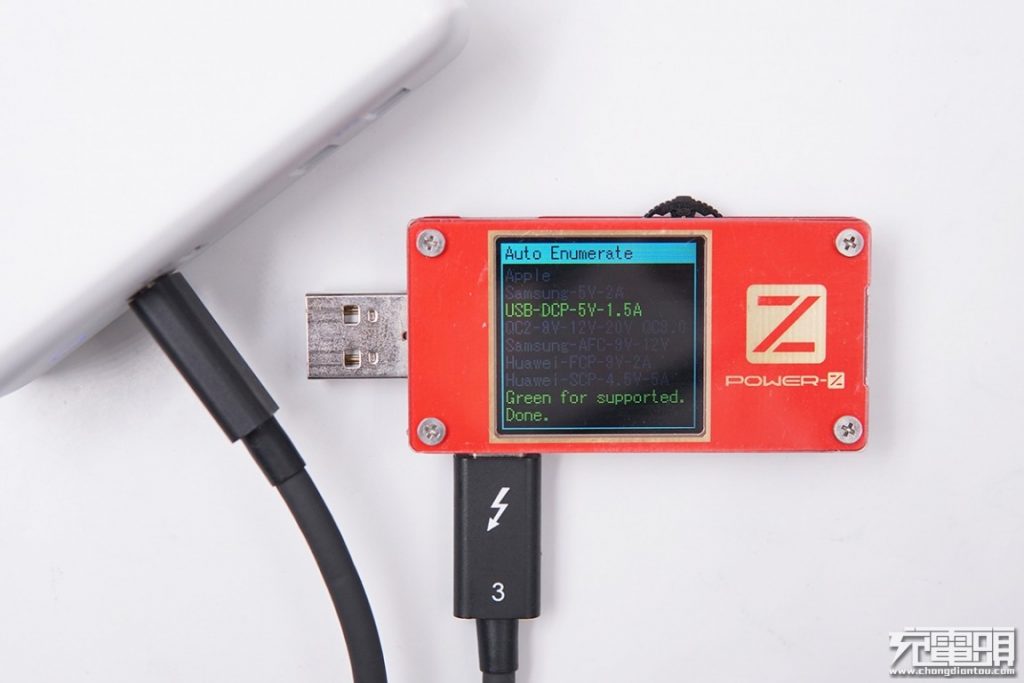

1. Charging protocols test

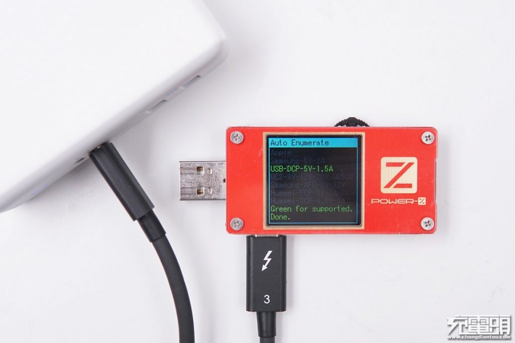

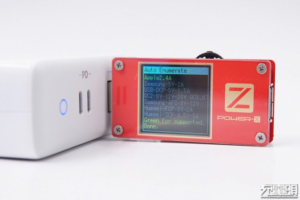

With ChargerLAB Power-Z KT001 USB Power Monitor, we know that its USB-C port supports USB PD protocol and USB-DCP-5V-1.5A.
The two USB-C ports are the same.
With ChargerLAB Power-Z KT001 USB Power Monitor, we know that its USB-A port supports Apple 2.4A charging protocol.
The two USB-A ports are the same.

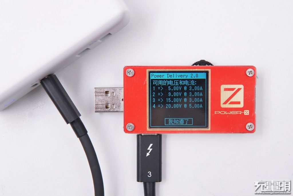

2. PDO reading

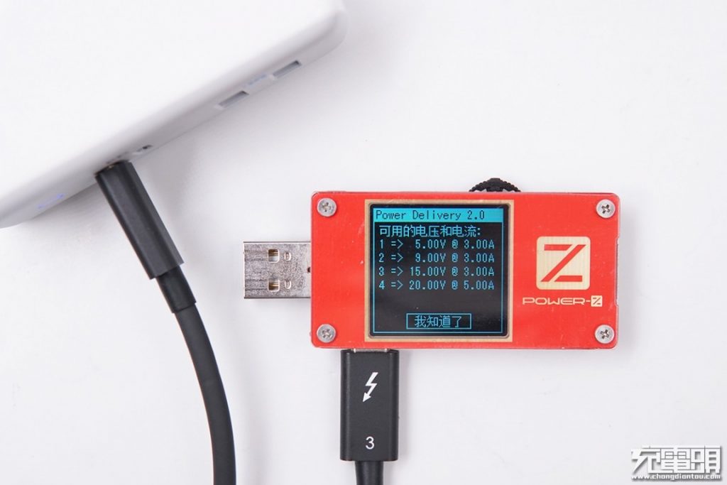

PDO information reveals its USB-C port is capable of PD2.0 quick charging output in 5V/3A, 9V/3A, 15V/3A, and 20V/5A.
The two USB-C ports share the same PDO reading.
