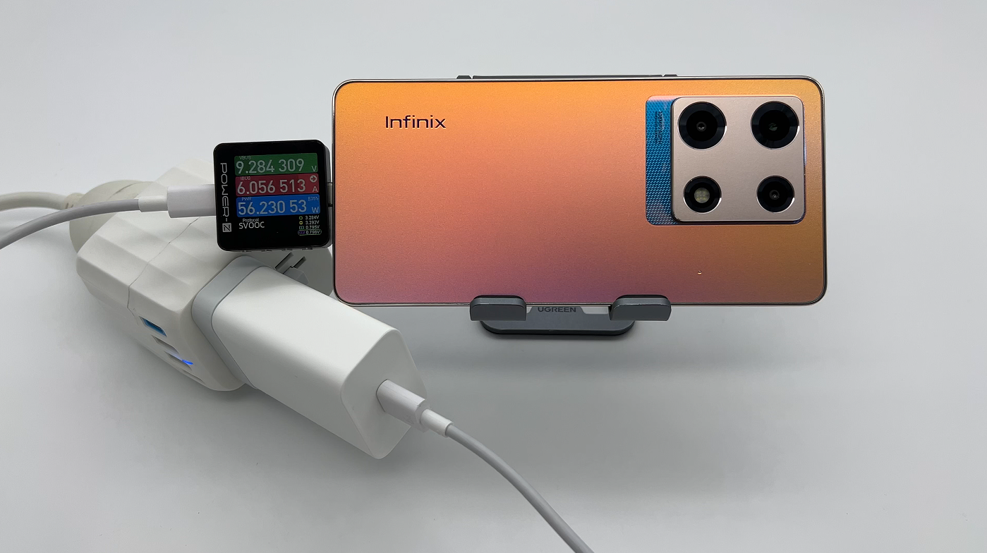

Original Charger
Charging Review of Infinix Note 30 Pro-Chargerlab
Charging it via the original 68W charger, our tester shows the power is about 9.28V 6.06A 56.23W.
