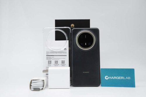

ChargerLAB got the Huawei Mate70 Pro+ as soon as possible. It is equipped with the new Kirin 9020 chip, a 5700mAh capacity battery, and supports 100W Huawei Super Fast Charging, 80W Huawei Wireless Super Fast Charging, and wireless reverse charging. Next, let's take a look at its actual charging performance.
5700mAh + 100W | Charging Review of Huawei Mate 70 Pro+-Chargerlab
The packaging box is black, with the Huawei logo, HUAWEI Mate 70 Pro+, POWER by Harmony OS, and other words printed in gold fonts on the front.
HUAWEI Mate70 Pro+ is also printed on the side of the box.
This side has a sticker with parameter information, model: PLA-AL10.
The box contains the Huawei Mate 70 Pro+, a 100W charging set, and some documents.
