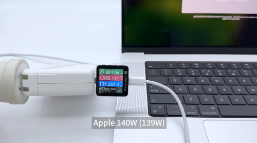

First, let’s test the Apple 140W charger included in the box, using the original USB-C to MagSafe 3 cable. The measured output is 27.88V 5A 139.27W, which is very close to the maximum power.

After summarizing the data from different Apple chargers, it’s no surprise that their compatibility is excellent, significantly enhancing the fast-charging experience for users.
Compatibility Test of Apple 16-inch MacBook Pro (M4 Pro)-Chargerlab
When we visualize the charging data in a bar chart, we can see that the actual output closely matches the charger's rated power. The highest recorded power is 139W from the included 140W charger. Overall, the compatibility with original Apple chargers is outstanding.
