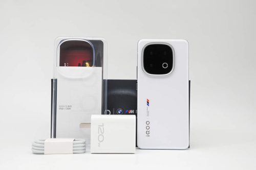

ChargerLAB recently got the iQOO 13. It is equipped with Qualcomm SM8750-AB Snapdragon 8 Elite, a 2K screen, a 6150mAh battery, 120W fast charging, etc. Next, let's take a look at its actual charging performance.

The box contains the phone, a 120W charger, a dual USB-C cable, a phone case, and some documents.

It comes with a 120W charger set. It not only supports 120W wired charging but also 50W wireless charging and 10W reverse wireless charging.
